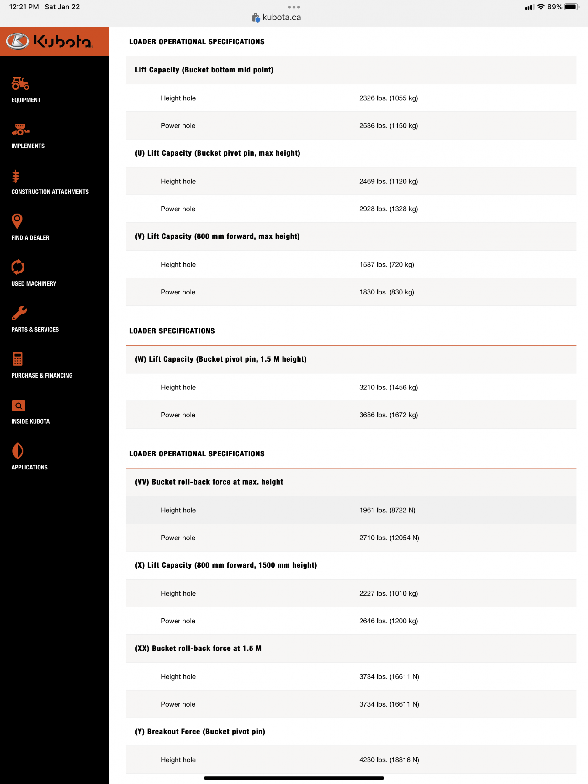

I’m with Jeff on this one. If you want 2,000 lbs go with MX or an M. GL with bigger loader should do it too, but expensive.
Here‘s the CA specs for the 1154E

Keep in mind that most of the loader lift ratings are made at or a fixed distance forward of the pivot point. It is sometimes difficult to compare specs accurately.
I currently have an MX5800 with LA1065 loader. It came from the dealer with the hydraulic pressure set at 10% below spec. The dealer said it was for liability reasons. They had no problem setting it back to spec after I asked.
Even at spec pressure, the LA1065 with pallet forks will lift just slightly more than 1900#. The forks weigh 300# so the actual lift capacity is somewhere around 2200# at the pivot point.
