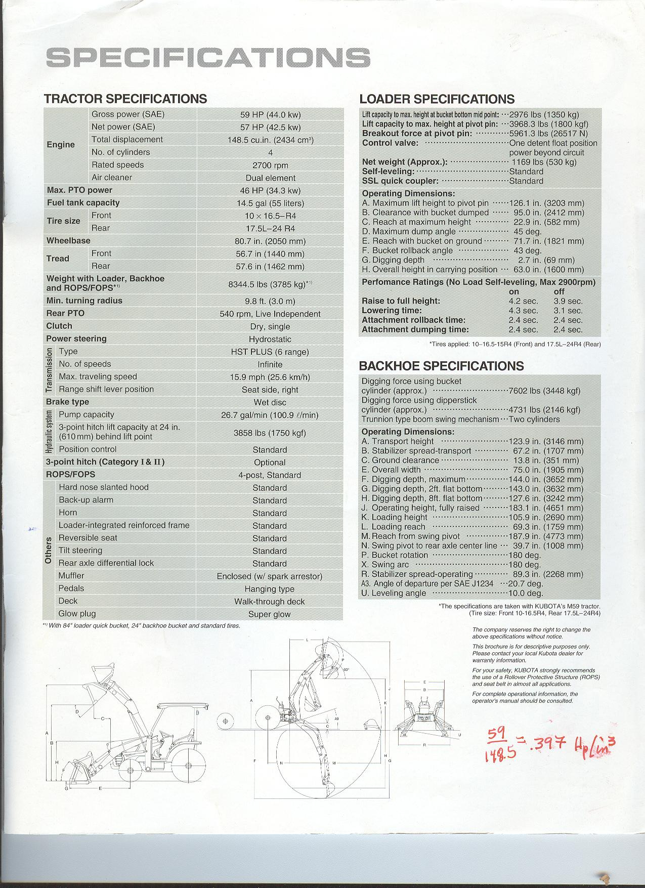

This is for the M59, and these are some serious Loader lifting specs for a 59hp tractor.
Almost 4000 lbs at the pins to the full 126" height, and 3000 lbs at the center of the bucket.
These figures are conservative. It will lift a lot more than that to half height.

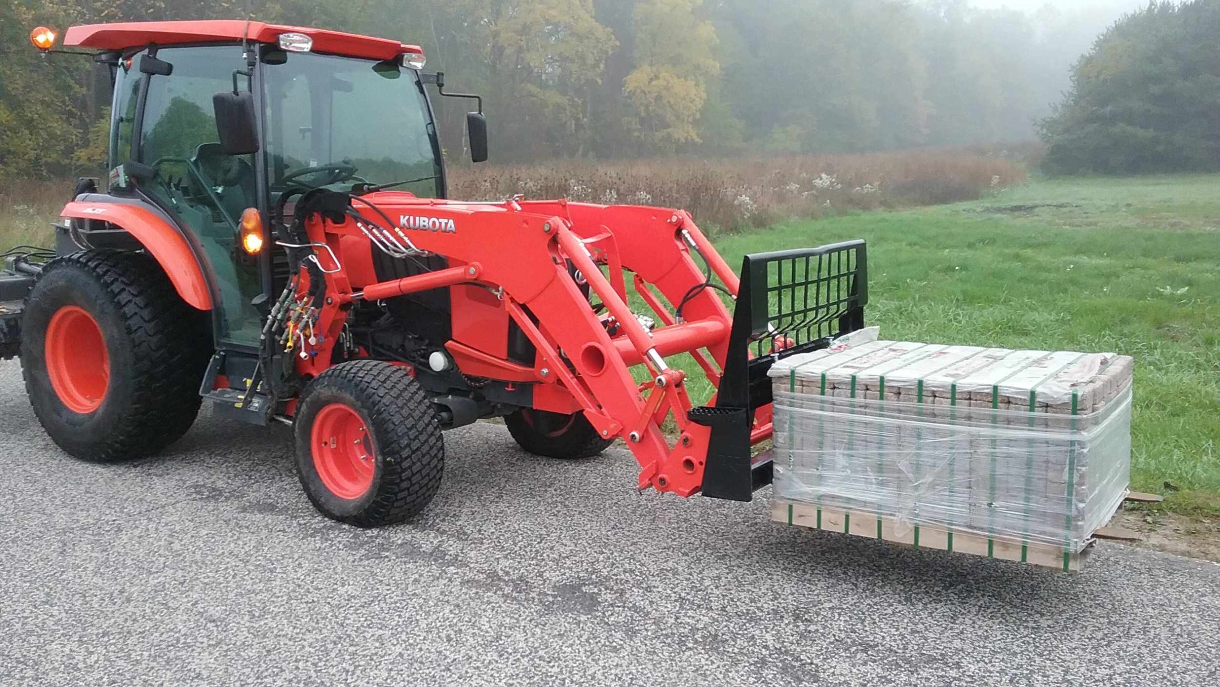

I just thought i'd throw in a real world example for reference. This is a 2200lb pallet. I was only able to pick it up about 4 inches above the deck height of the trailer before it stopped lifting all together. From there, I had to make like a 30 point turn because the steering practically doesn't work. you can see the front tires squashed out. I try very hard to only move this type of weight with a tractor on very rare occasions. Due to this particular job, it wasnt going to work well to use a CTL. This is the biggest L series available and has a 1055 loader. Even if other tractors have a higher rated capacity, its still a massive strain because of how far out tractor loaders are leveraged from the front axle.
If that's the l6060 the specs I looked up for that:
How much can a Kubota L6060 lift?
Lift Capacity (pivot pin): 2361 lb. (1071 kg.) Lift Capacity (500 mm fwd): 1784 lb. (809 kg.)
And it looks like a lot of your load is far forward.
Did you check your pressure vs the spec? It might be 10% low.
Considering the 500mm forward spec is only 1784lbs, I'd say the pressure is right where it should be.
That's right. Don't let anyone tell you that Kubota can't make an FEL.
