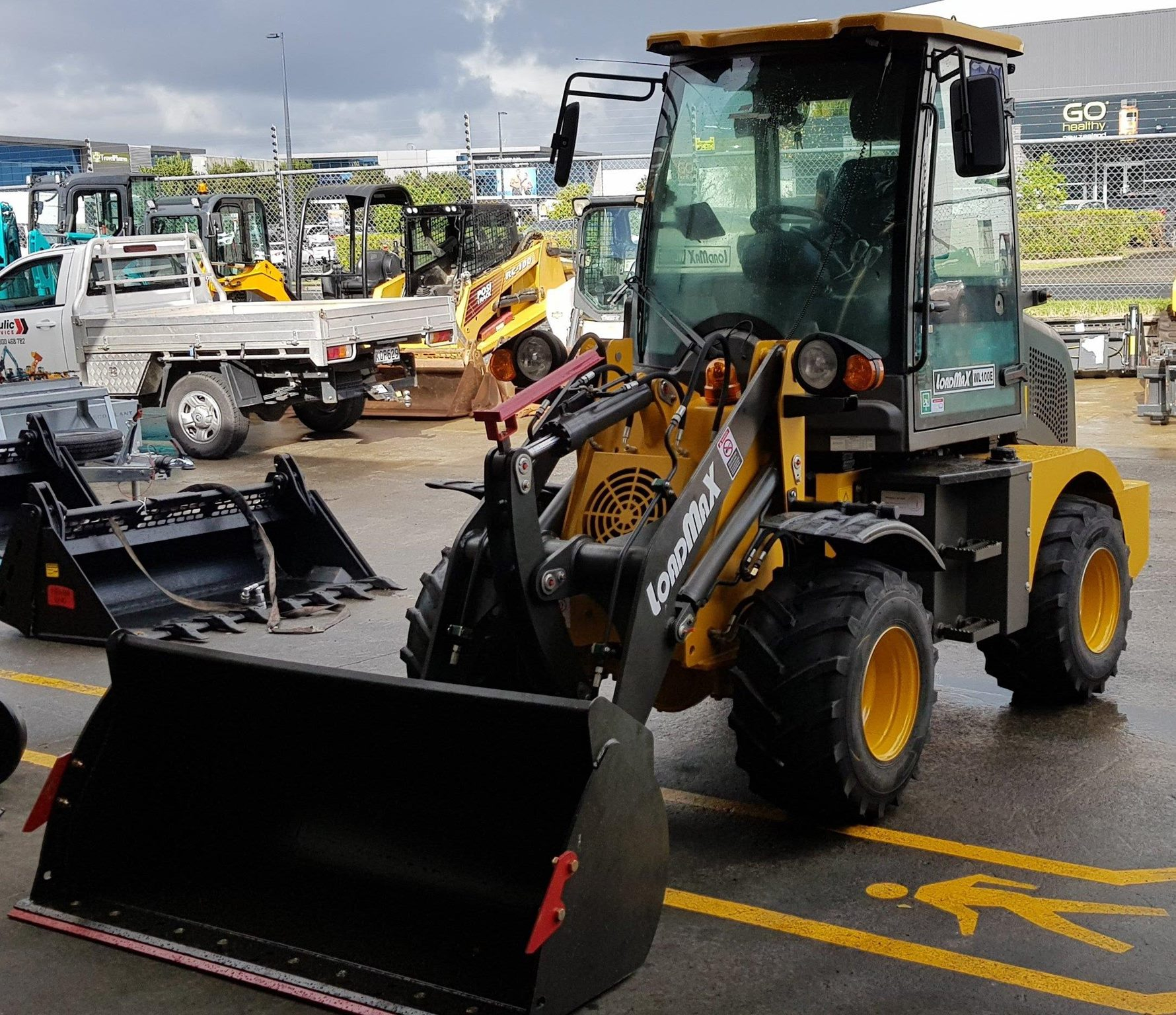

I have no formal lift or reach requirements. I clear lots of snow, move lots of fill, and lift heavy items in and out of my truck and trailer.
Why are you looking at a tractor then? surly a small pivot steer loader would be cheaper more maneuverable and better lift capability
I looked at small loaders from several vendors including Kubota and Bobcat - they are double the price. I have a Toolcat that excels at this task. I thought I was going to buy another Toolcat to find out it was sold only a couple of days prior. It is a tough market out there.
   / CUT Low Loader Lift Capacity #60
If you are primarily wanting a loader, that you sometimes use as a tractor
PowerTrac makes a good machine, that outperforms traditional tractors for loader work, but still relatively affordable.
