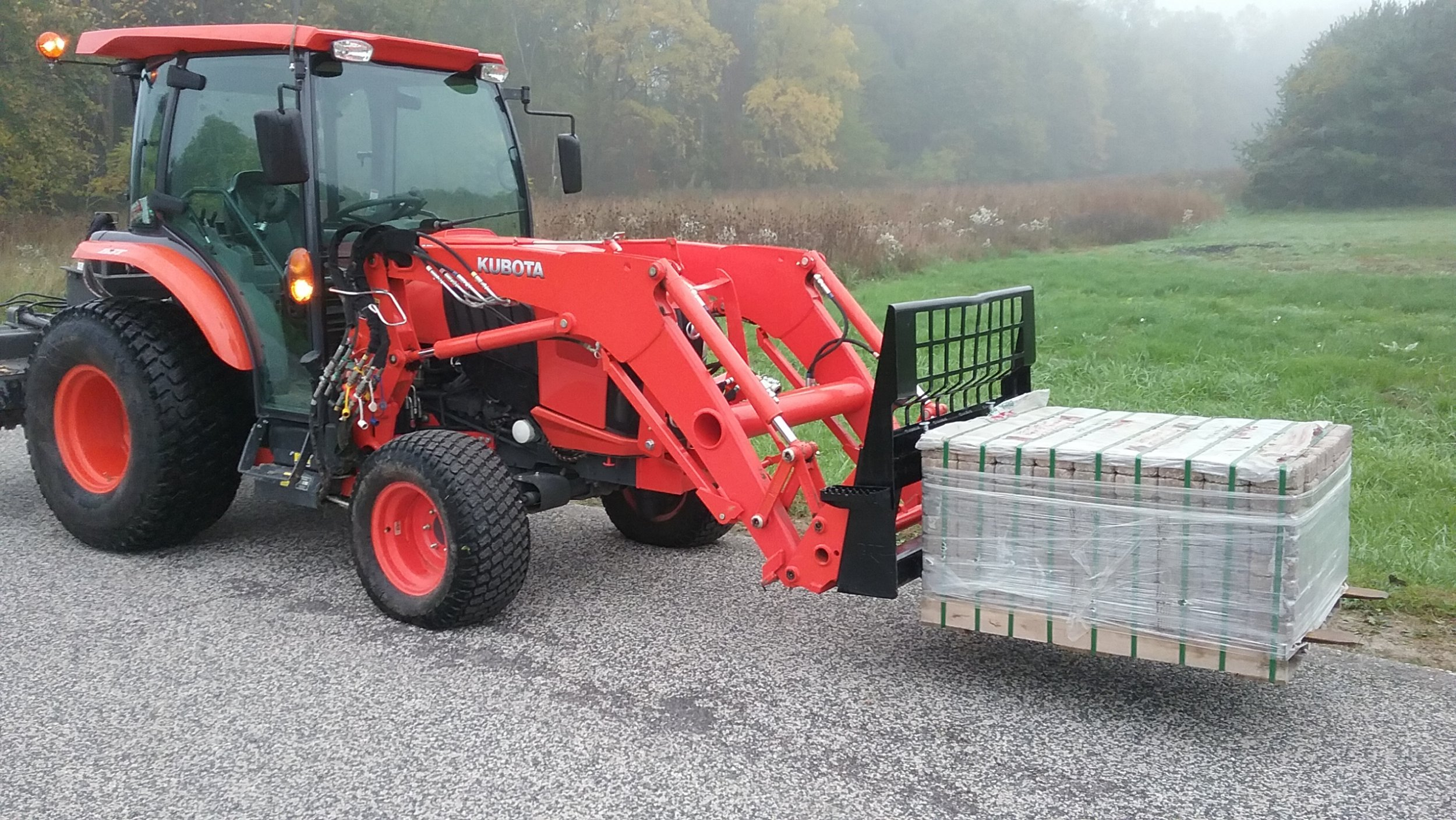

What type of loads? The pallet of bricks/blocks shown will be more stable than a round hale bale or a tank of liquid.
How far off the truck/trailer? Stacking beside, or moving some distance? As noted, moving a heavy load will be hard on tires and drive and suspension components.
Over what type of surface? Level, hard packed or paved will be more forgiving than sloped turf.

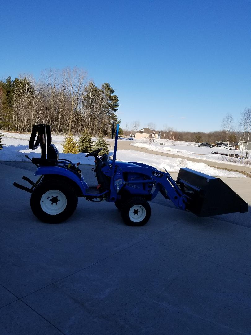

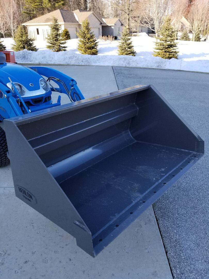

Current tractor is an LS XJ2025H. It is only 4' wide and came with a 50" bucket. Lots of power for 25hp. Lift capacity is north of 1,300#. Bought a heavy 60" bucket used for snow removal. Some items around my camp an hour away are 2,000# which I plan on selling, but need to load onto a semi-trailer. Bought a retirement house with 10 hilly wooded acres and several narrow trails in the woods. The driveway is 200 to 300' long thru the woods. The trails are very uneven so I bought 50 yards of fill to start leveling out. The little tractor is ok with a load but the project may take a couple more years. A 4' wide tractor is not great for uneven terrain. Looking at adding the 8 acre wooded lot next door with more trails. Lost most of the strength in my left leg from the recent VAX shots so mounting and dismounting a cabbed tractor will not work. Also just had a 48' x 56' shed built which will need the grade finished before the slabs are placed next May. New tractor will have a 6' bucket which will help with snow removal and placing more fill in depressions and leveling in a more timely manner. The older tractor will be brought up to camp as a backup to the toolcat which has been challenged to keep running lately.
