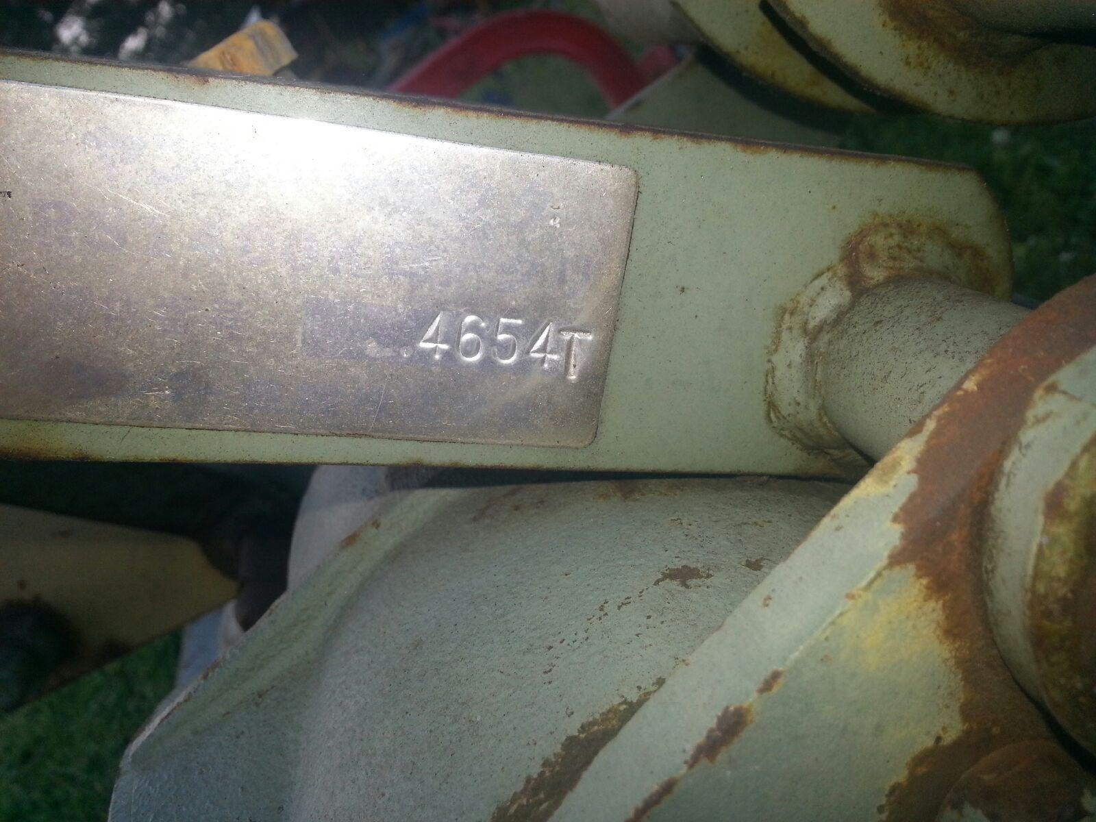

Picked up a yanmar RS1400 tiller pretty cheap. About 1/3 the cost that I see used KK and beefco tillers sell for. Here's what we are dealing with 1.jpg2.jpg
The thing works okay behind my L3400, but not nearly as well behind the 8n. The KKII we always borrowed did fine behind the 8n. The rotor speed on the yanmar is 180rpm. I see 220 is about the norm. So I tore into the gearboxes hoping I could swap around some gears and get a but faster rotor speed. No dice.
So now I am thinking about a plan B. Converting to reverse rotation. I will rotate the gearbox up and over 180 degrees so the PTO is facing out the back. The guarding can be reversed easily. (Sideplates are the same, bolt holes are already there for either side.) Then its just re-configuring the 3PH. I will make new tabs for the TL to mount to the gearbos (cause they will be off), and take the yellow plates off, and weld on the back side.
So......whats your opinions? Think it will work fine as a reverse rotation tiller with 180 rotor RPM?? any other thoughts or suggestions??

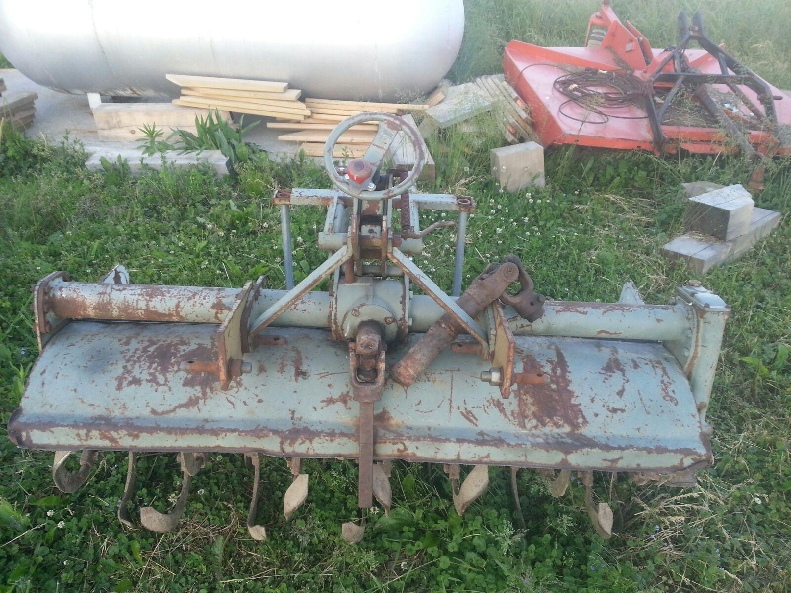

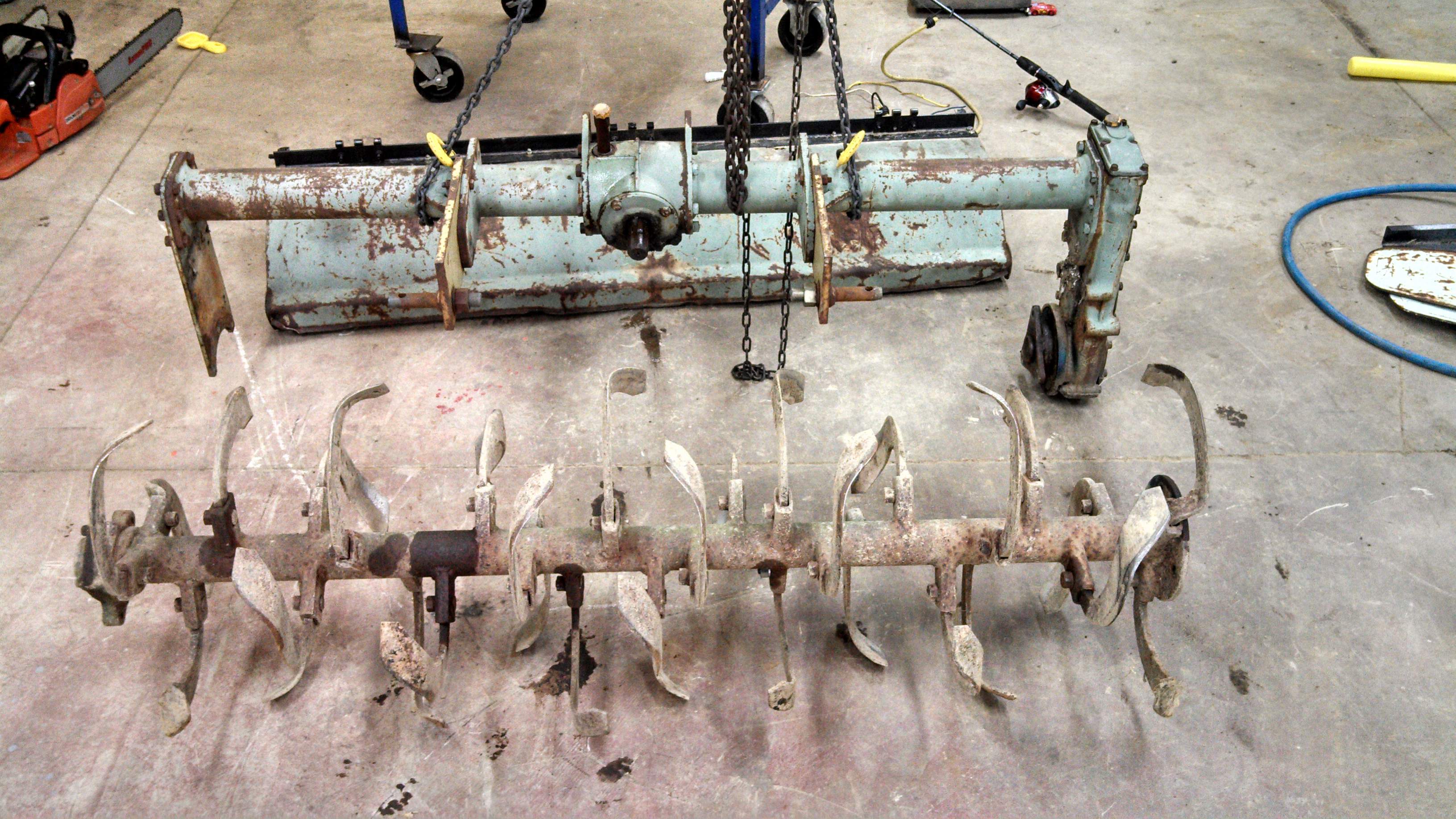

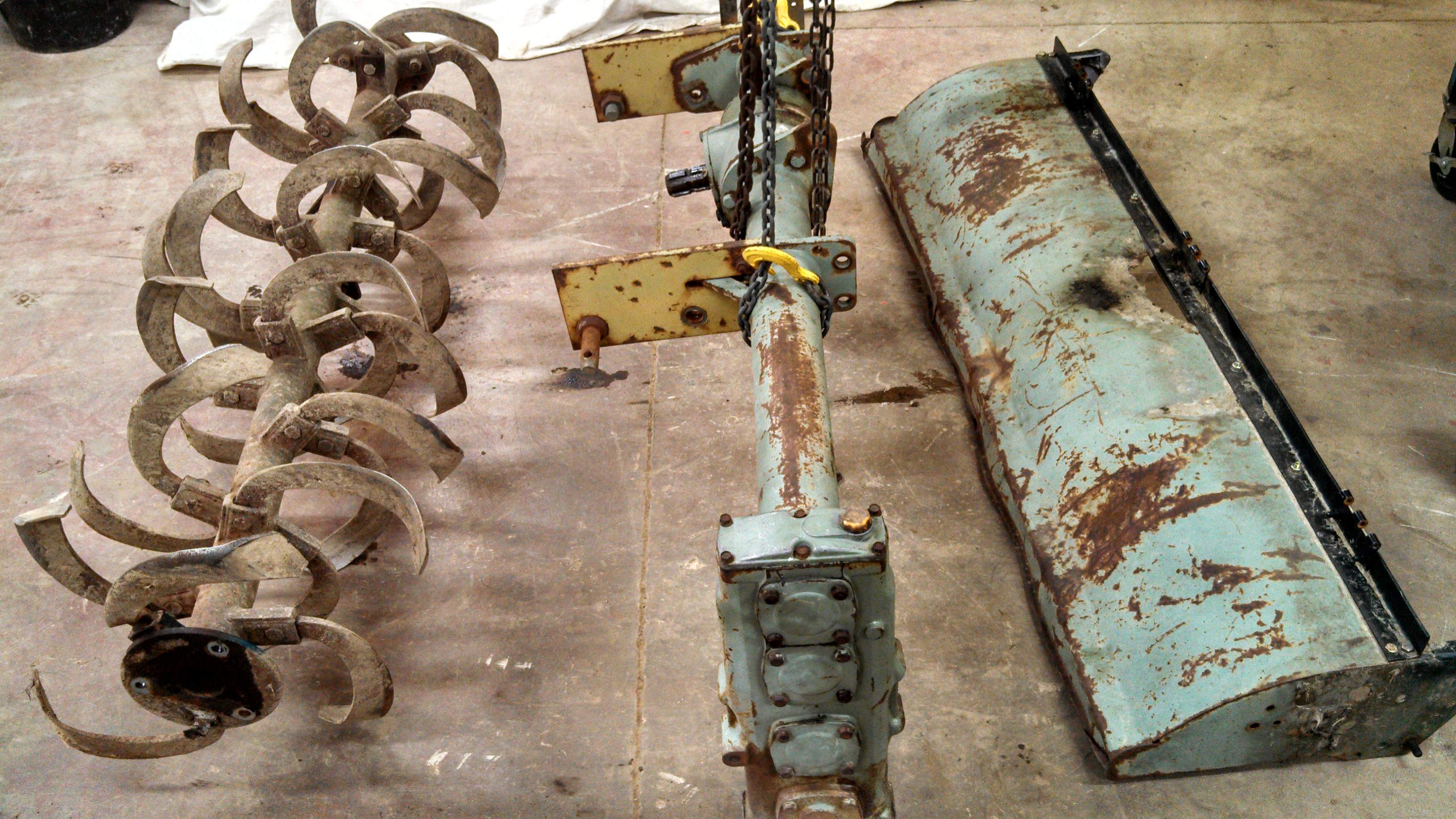

The work is actually all done as far as the "converting" goes.
Everything was already appart. All I had to do was relocate the lift brackets, and two tabs where the tubes meet the gearbox.
Now its just a matter of re-assembly, but I am going to fix a few things on the shield first and give it a painting.

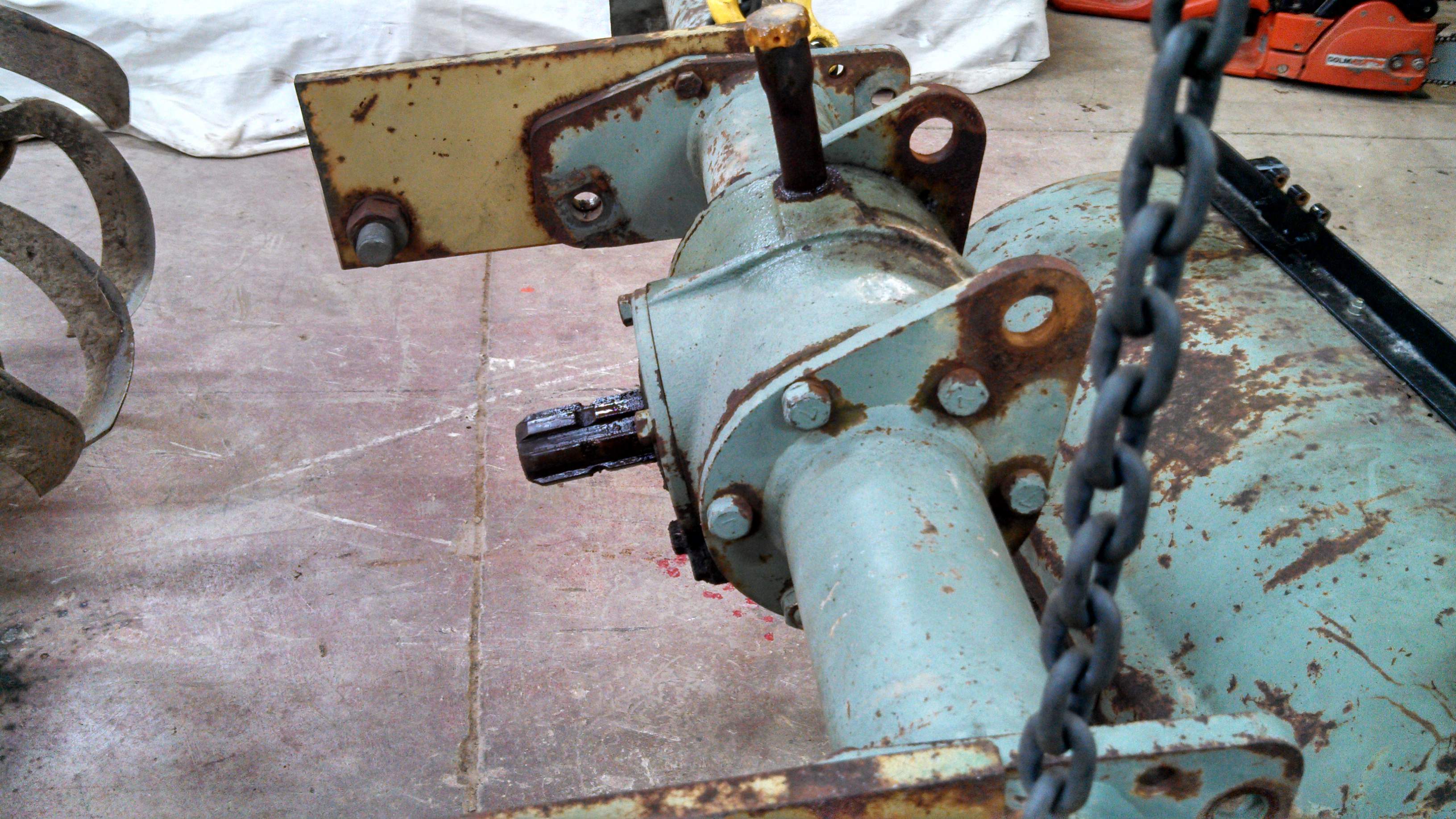

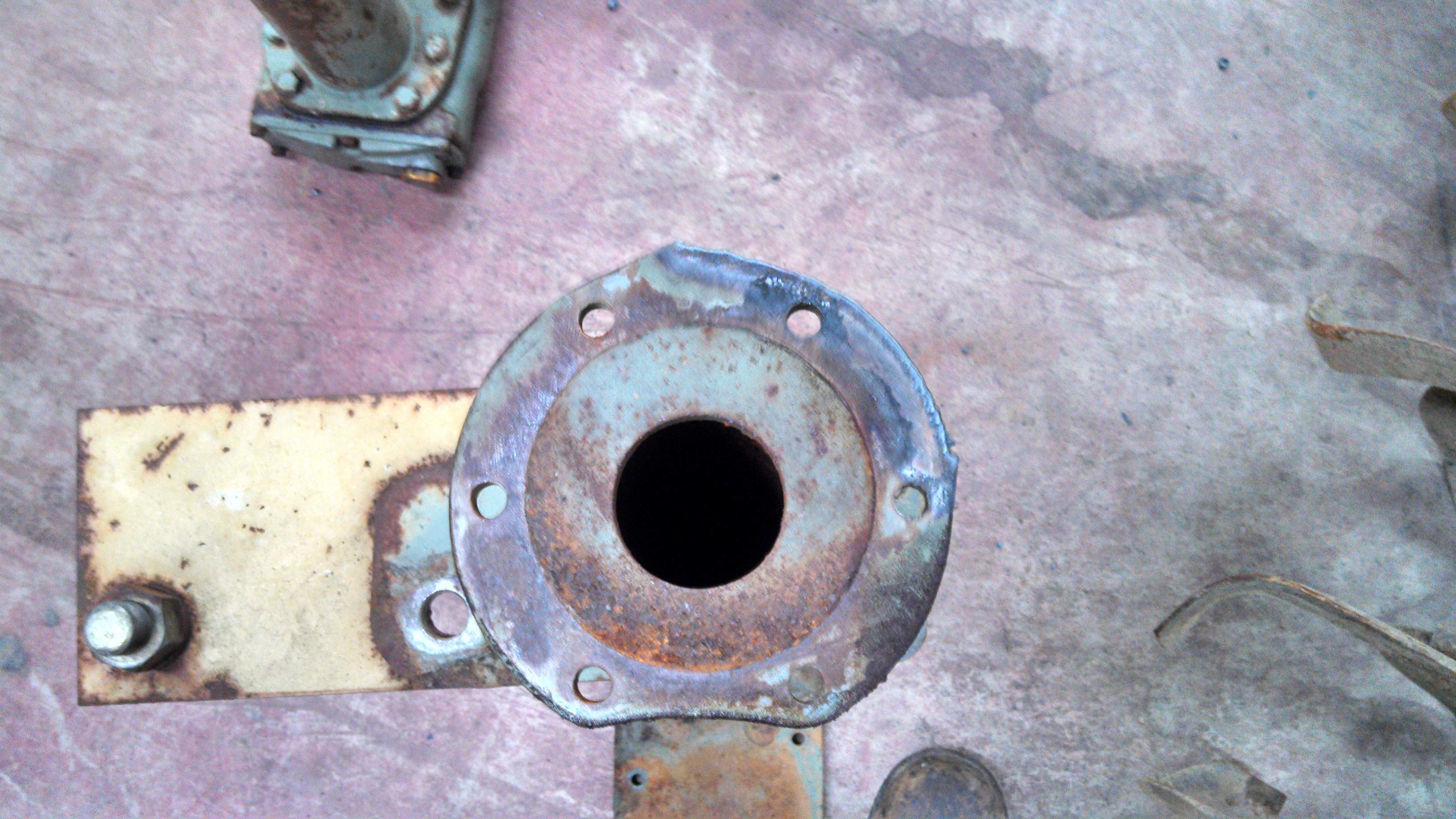

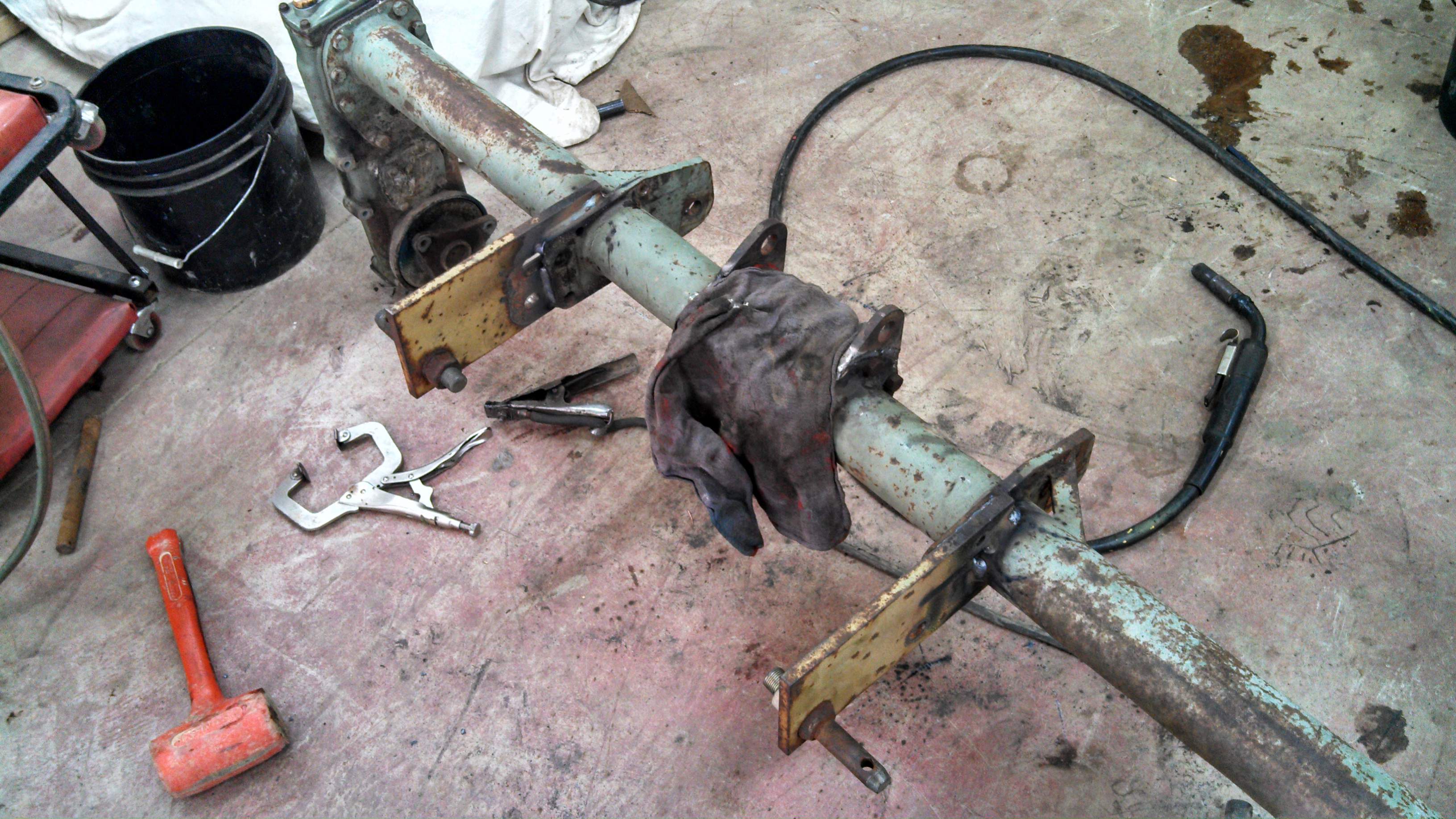

Well, since I am going ahead and doing this, I'll post some update pictures as I go here...

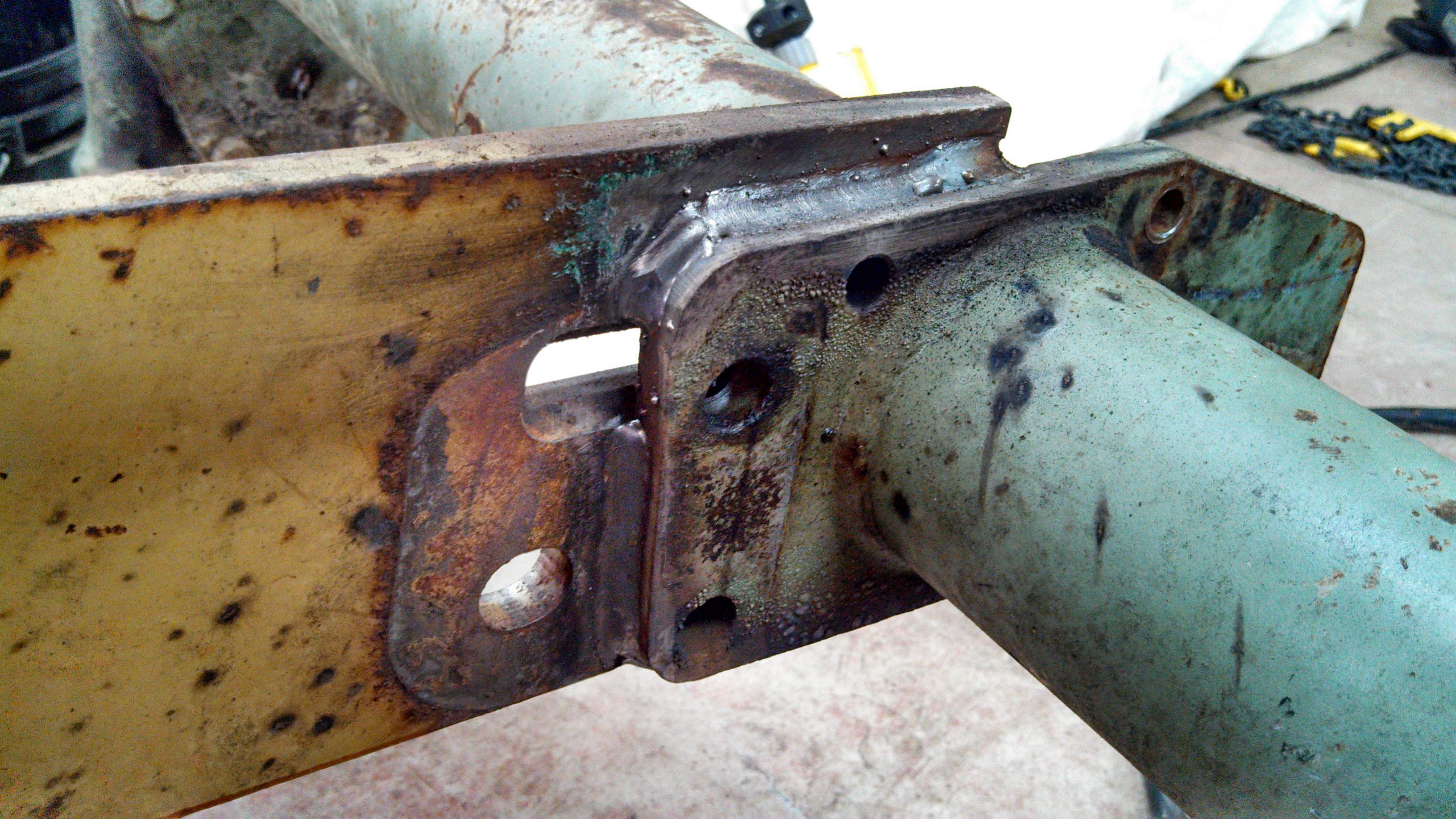

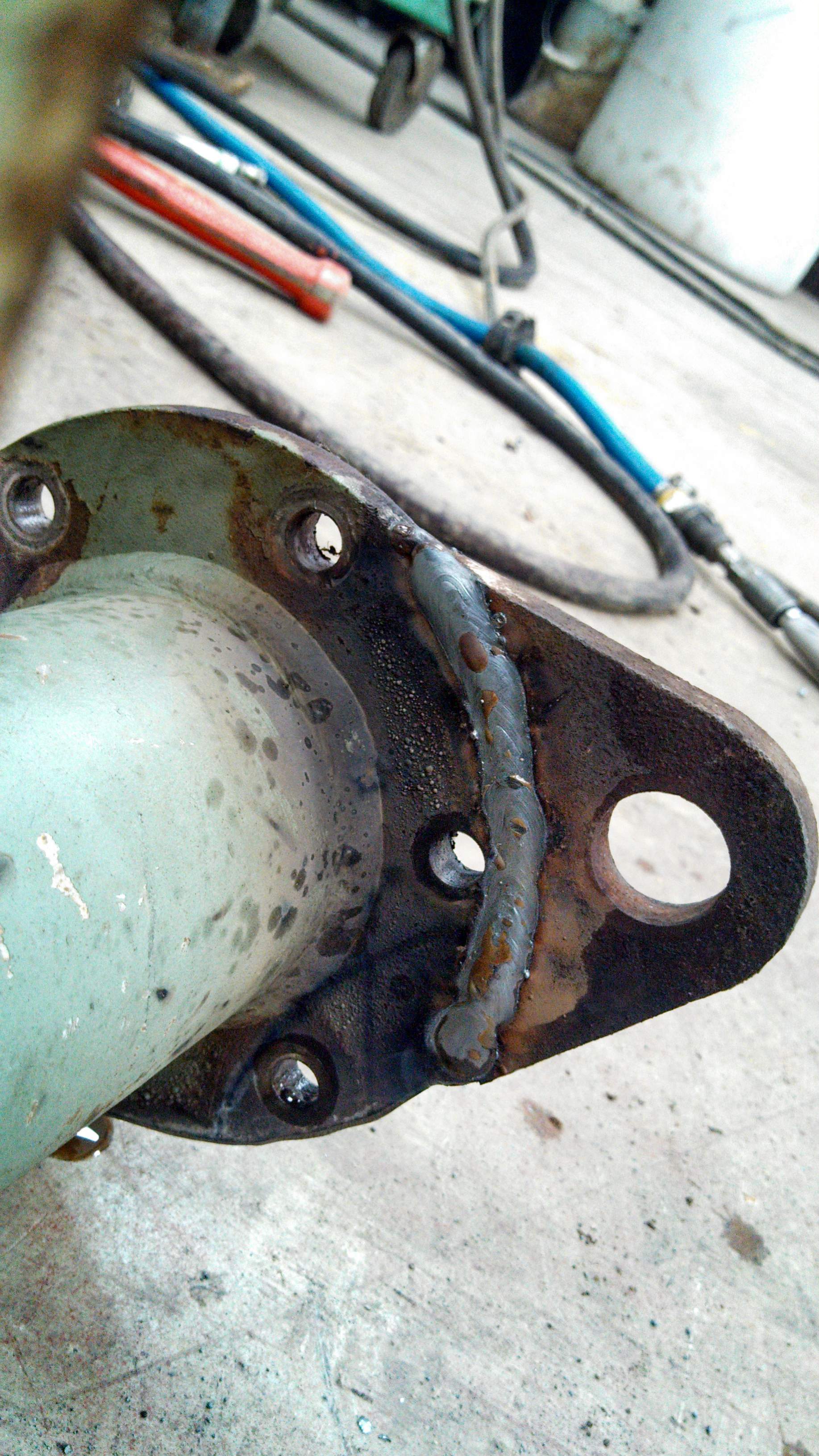

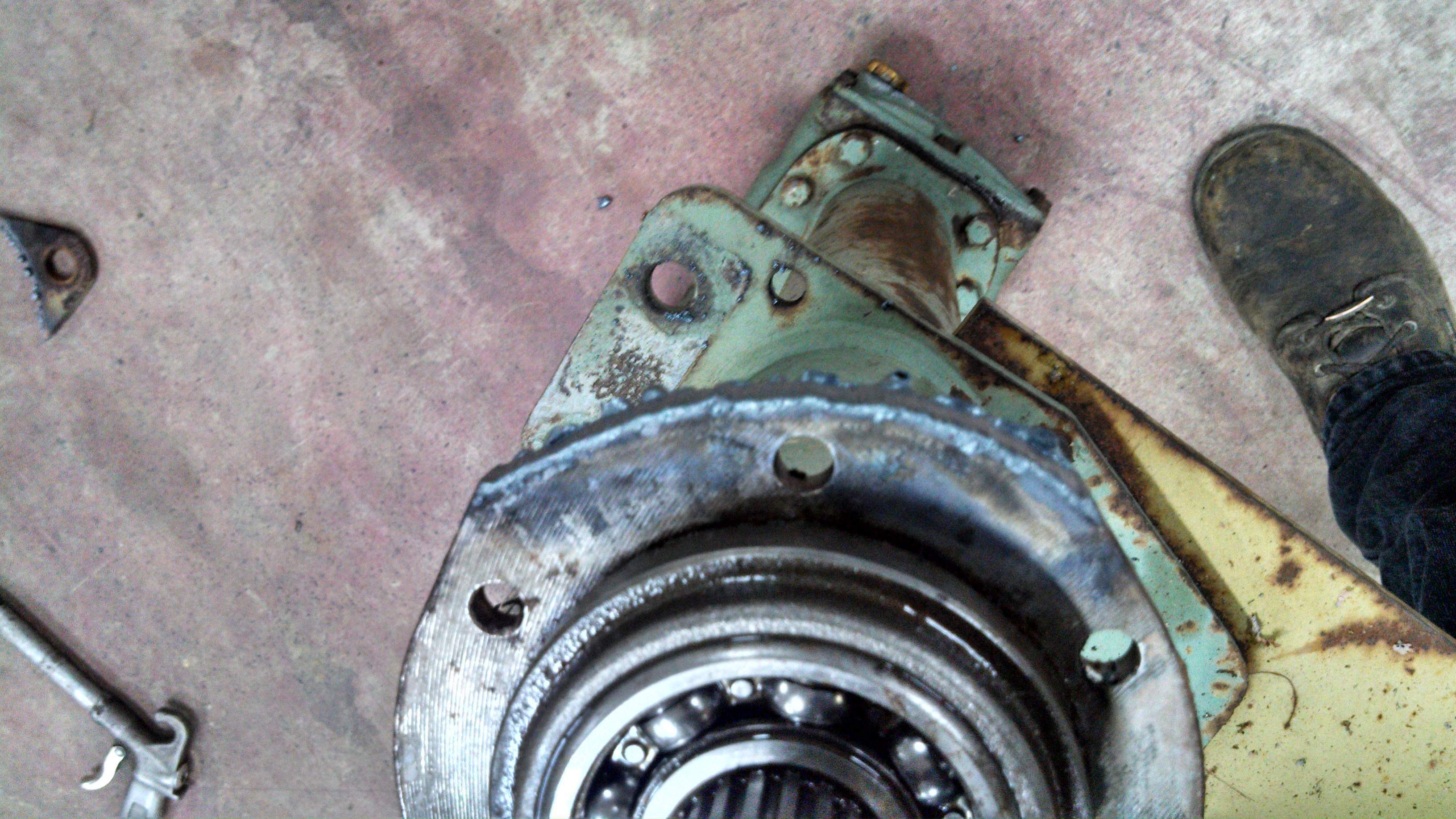

In this pictures, you can see the two things I have to cut off and relocate. 1st is the yellow bracket for the lift pin. It needs to go onto the other side of the tube. 2nd thing is the little eyelet looking mount that comes off the 6-bolt flange of the tube end. This is used for part of the top-link mounting as well as rear deflector. These also need relocated to the back
Here is the eyelets cut off
And re-welded on as well as the yellow brackets

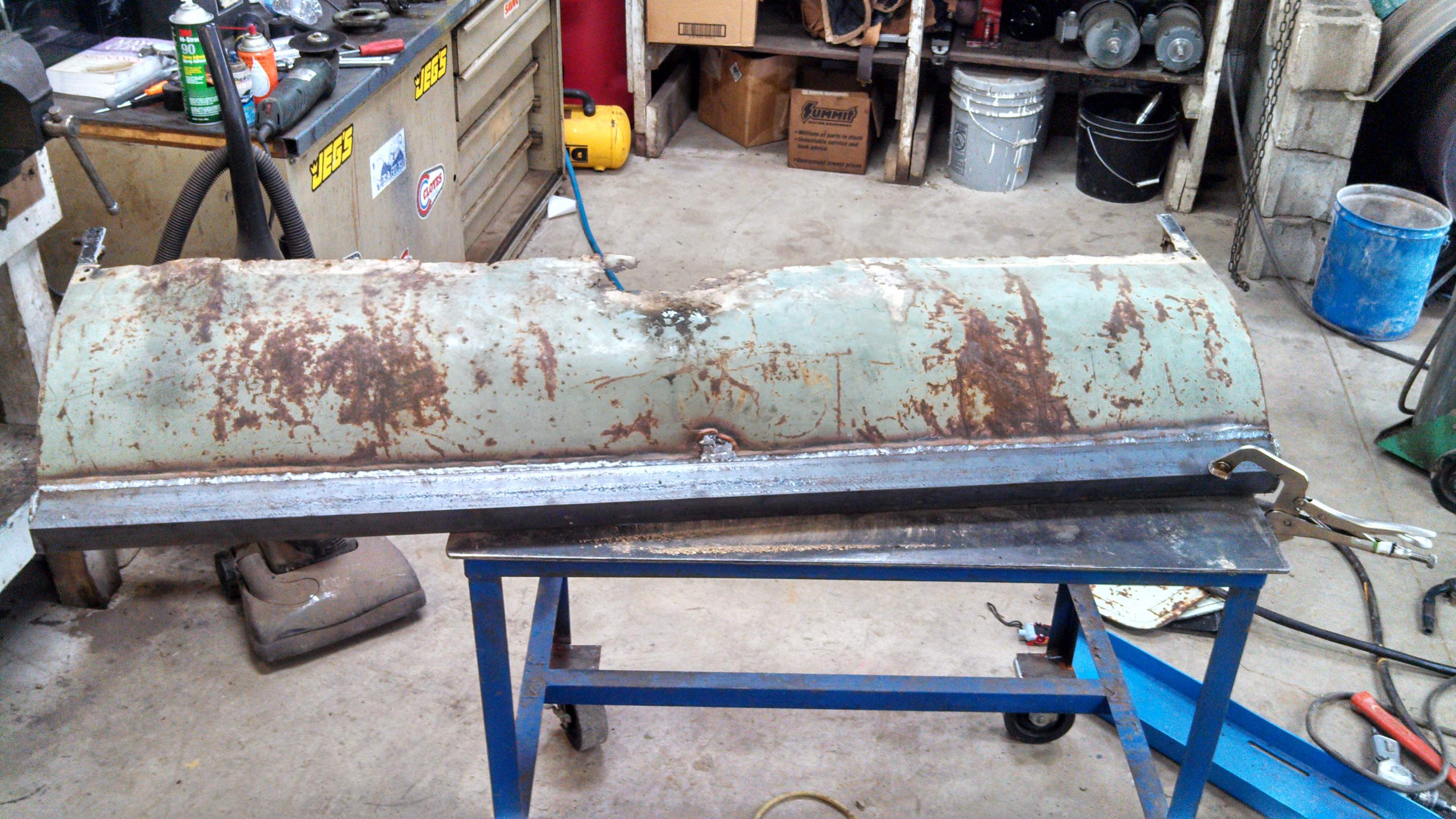

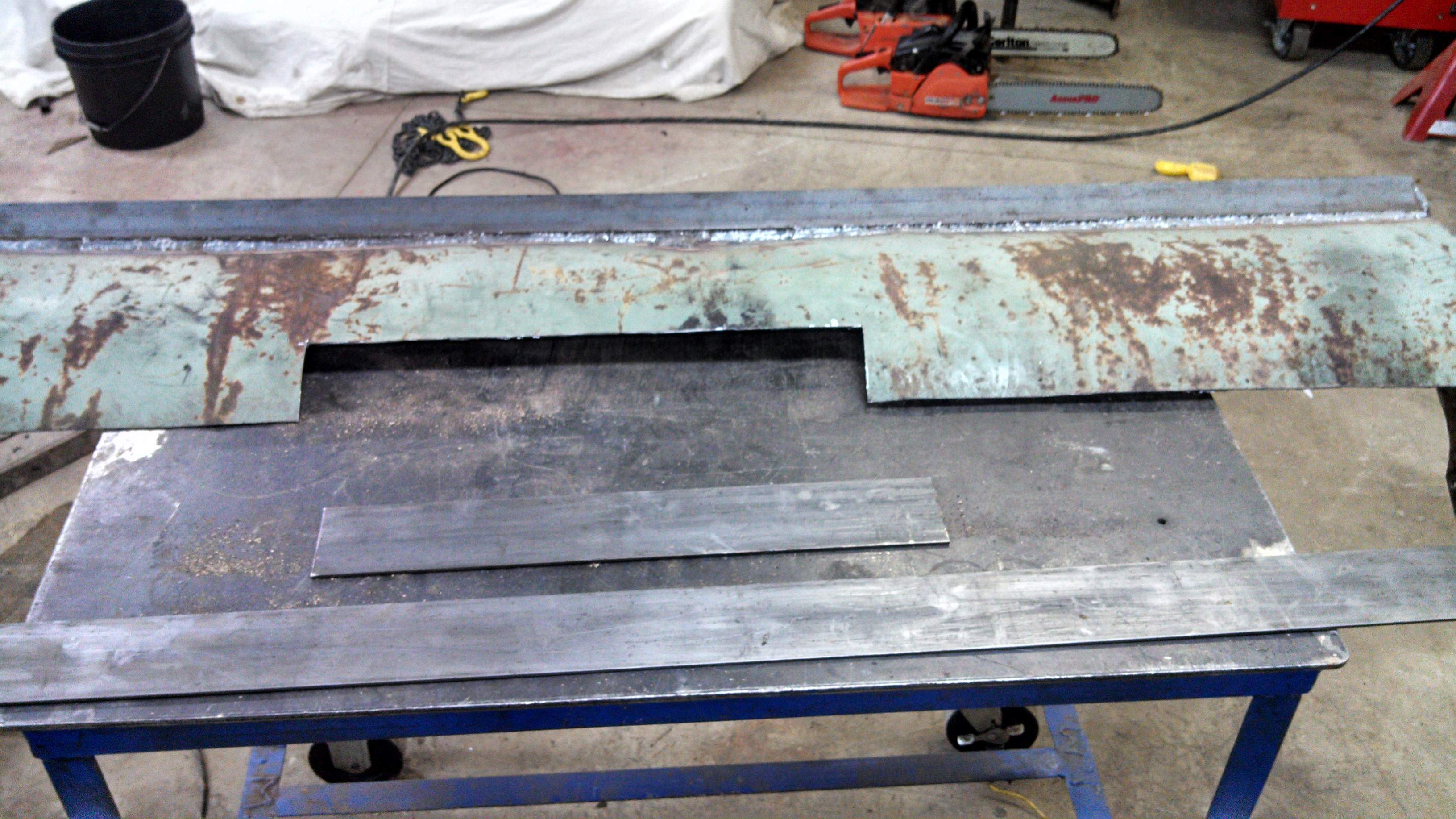

And now todays agenda, re-working the beat-up and rotted shield. If I get this done today, I hope to shoot some paint, and maybe tomorrow I will assemble after my bushhogging job

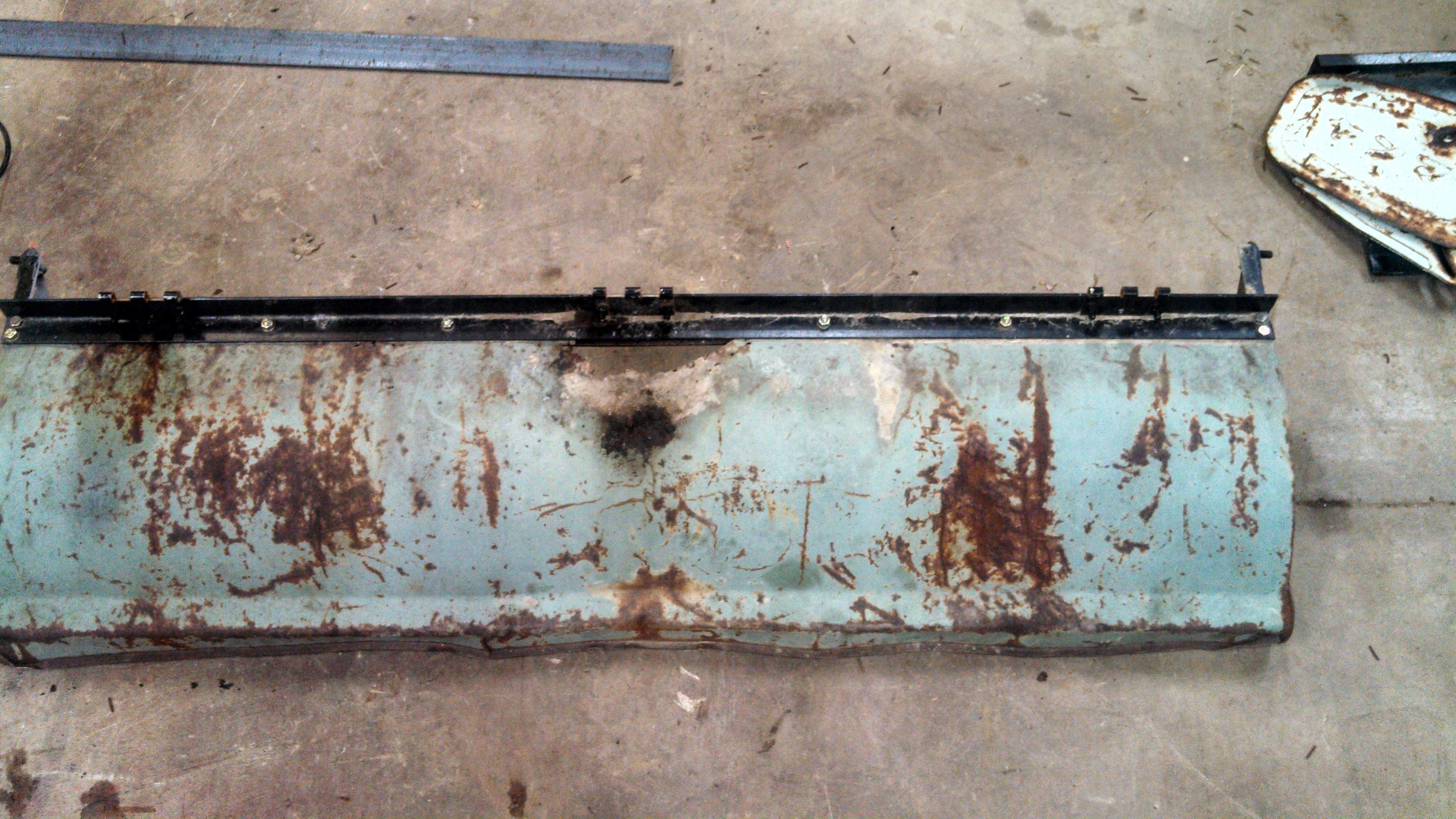

Heres a start on repairing the shield
Peice of 2 x 2 x 1/4" angle laid in there. That should make it pretty ridgid.

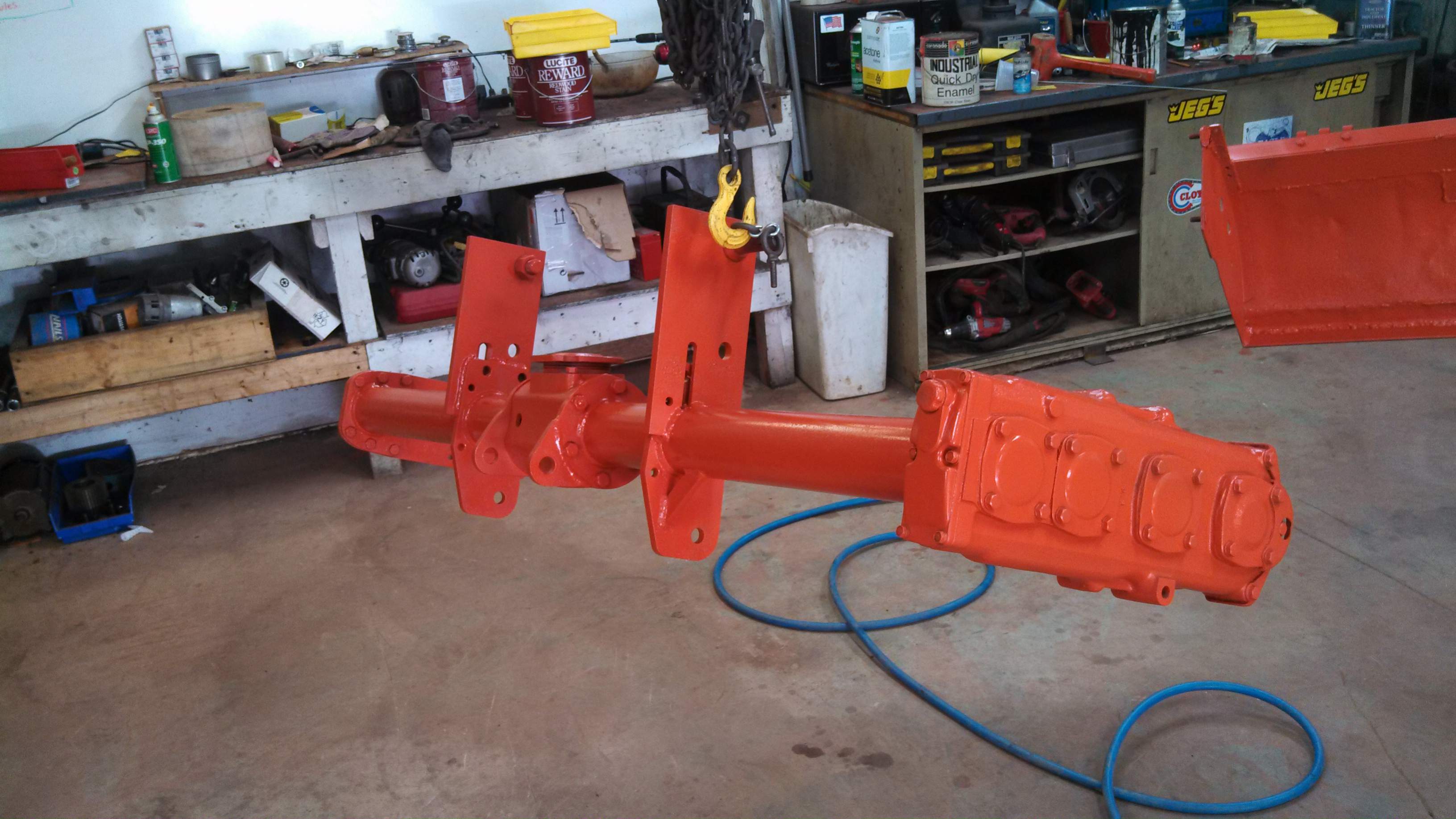

Got the guard all fixed up
And shot a little paint. Its all appart and painted, this is only the gear box and stuff
