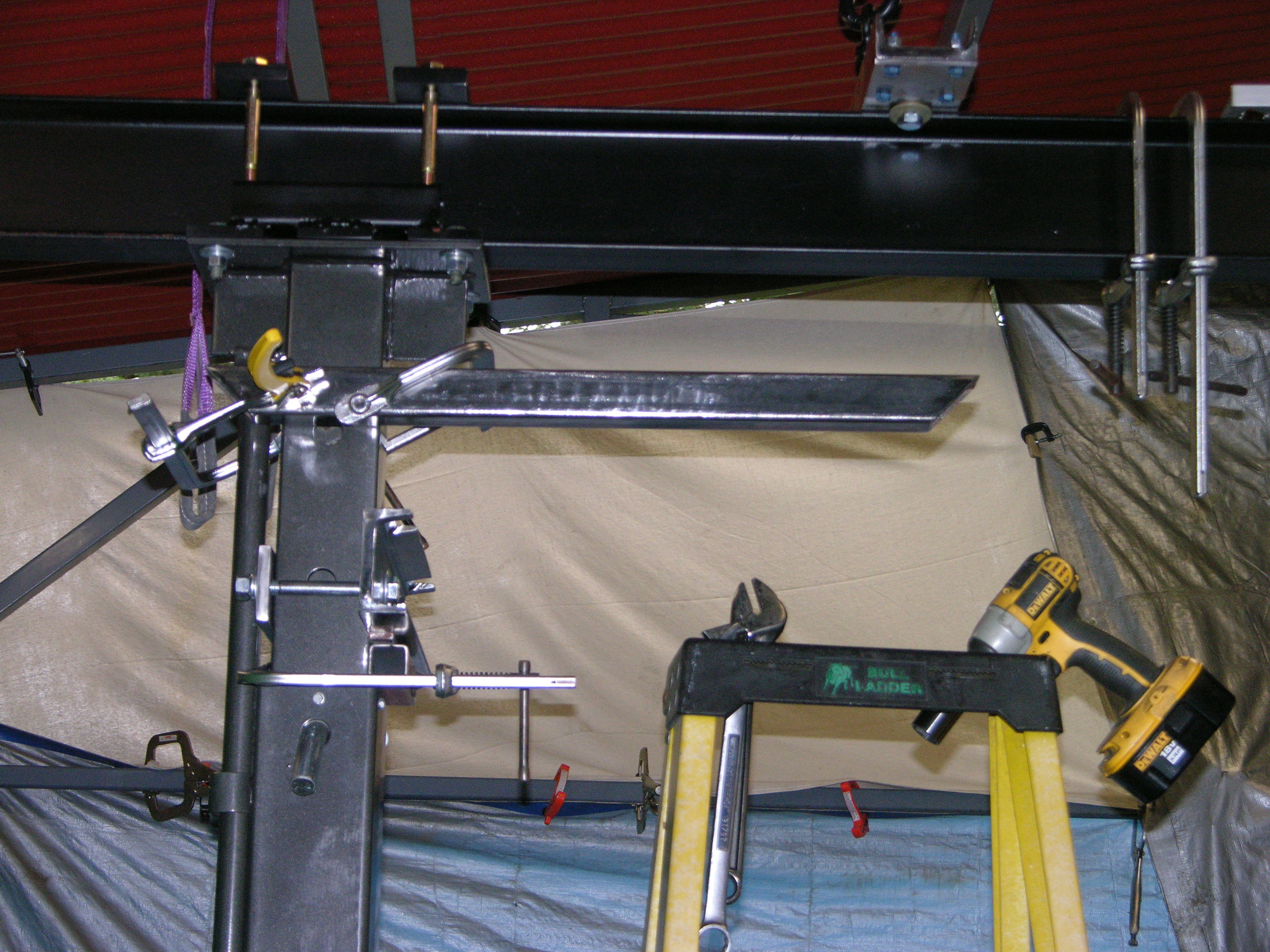

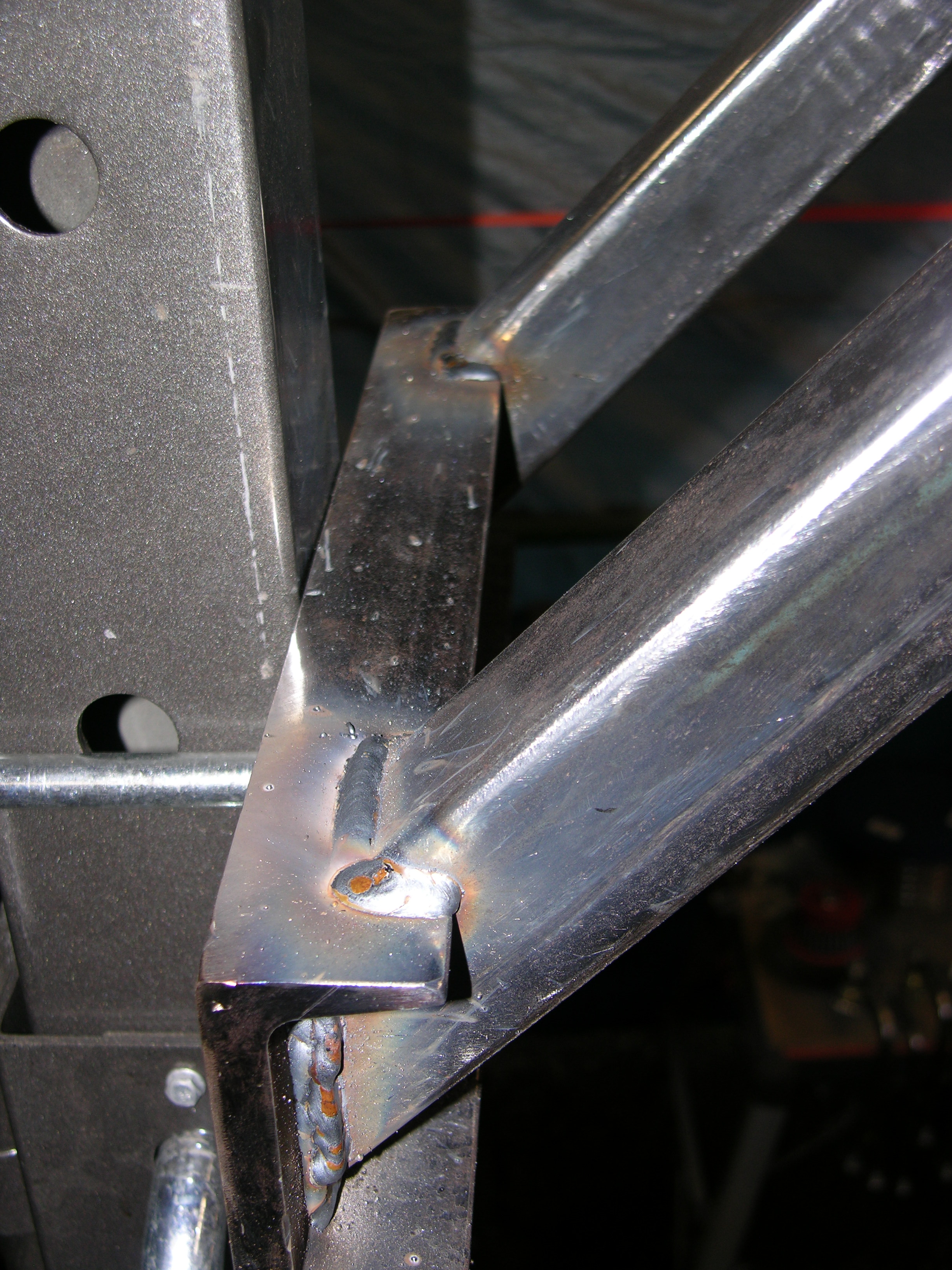

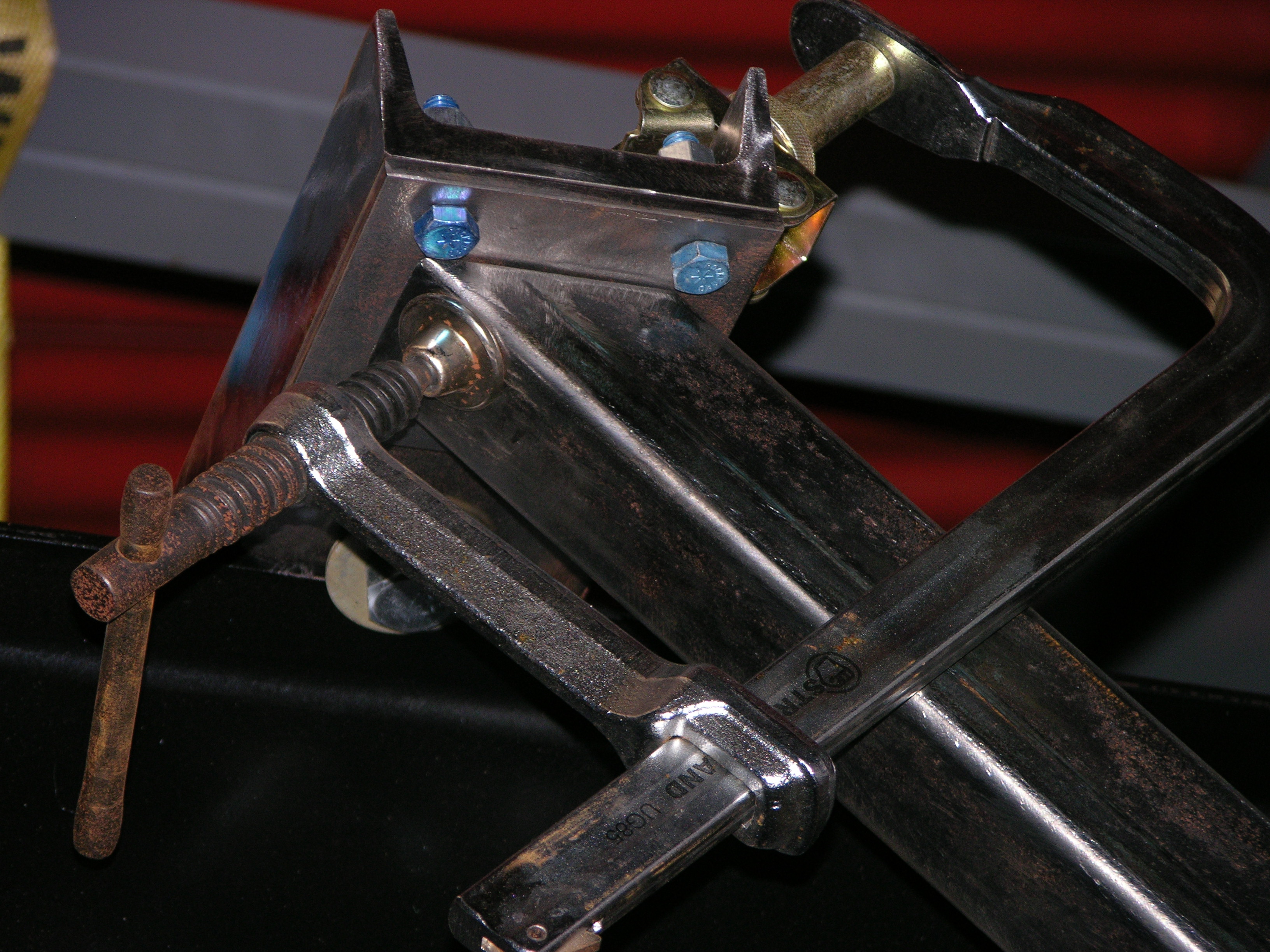

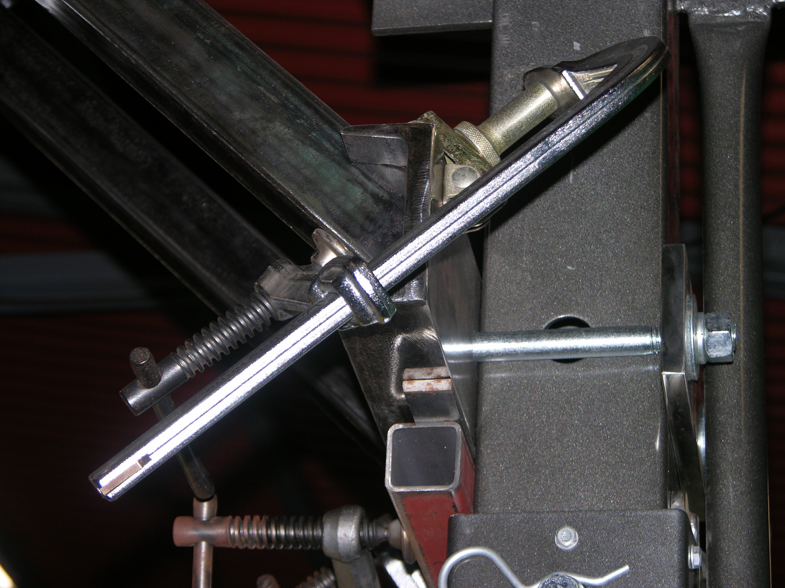

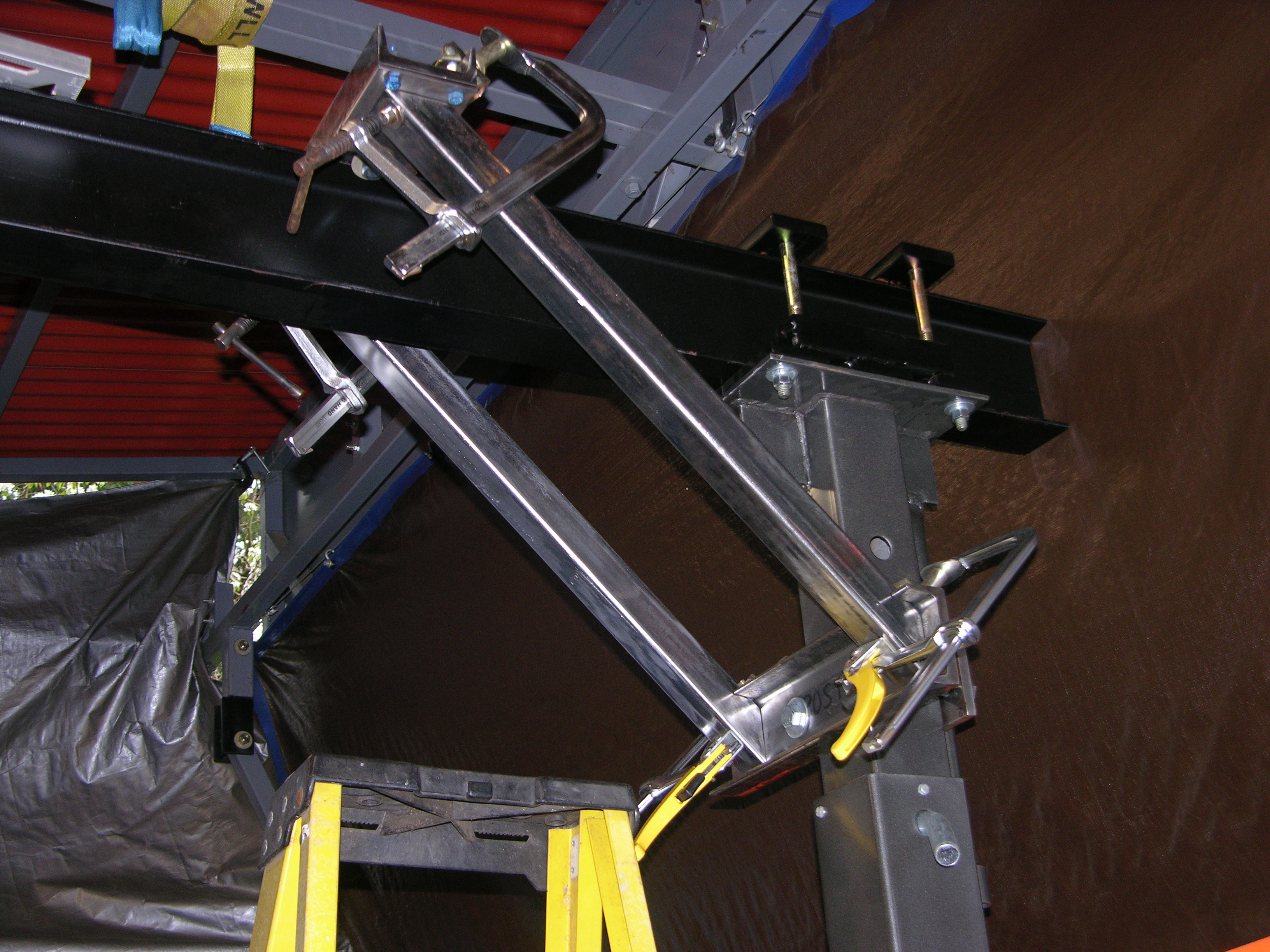

Today I got more done on the corner braces - first thing I noticed is that, even though both of the channel "spreaders" were perpendicular to post and I beam, the 2 identical length 45 degree tube gussets did NOT both end up positioned the same relative to the channel EDGES - meaning, SOMETHING was outa whack...

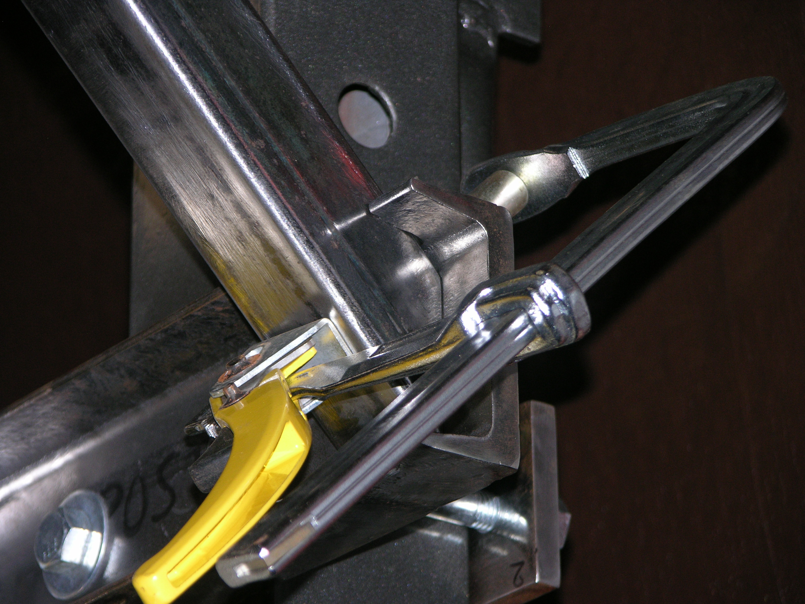

So I clamped one of the gusset pieces temporarily to the post, adjusted it so it was parallel to the I beam (from the side), then looked down from above the I beam - sure 'nuf, the clamped piece was NOT parallel to the I beam - so I loosened the 4 bolts that hold the main I beam clamped to the post, used the clamped tube gusset as a lever and rotated the post (slightly) til the I beam and tube WERE parallel, then re-tightened the bolts -

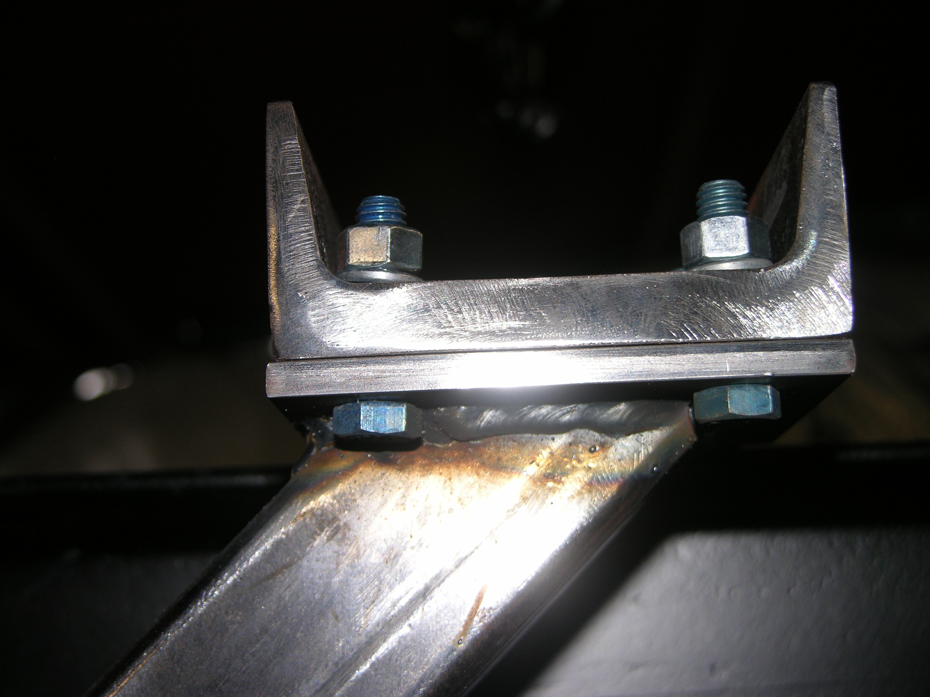

The channel spreader (with 45 degree milled slots) bolted to the post - the piece of 1-1/2" tube and the 1/4" FB below it are just spacers; the channel needed to be 1-3/4" above the larger post tube, these kept it in place til it was bolted -
Got things clamped up, ready to weld in place - I REALLY like those Stronghand 4 in 1 clamps, notice the "pipe" adapters also work on oddball angled stuff -

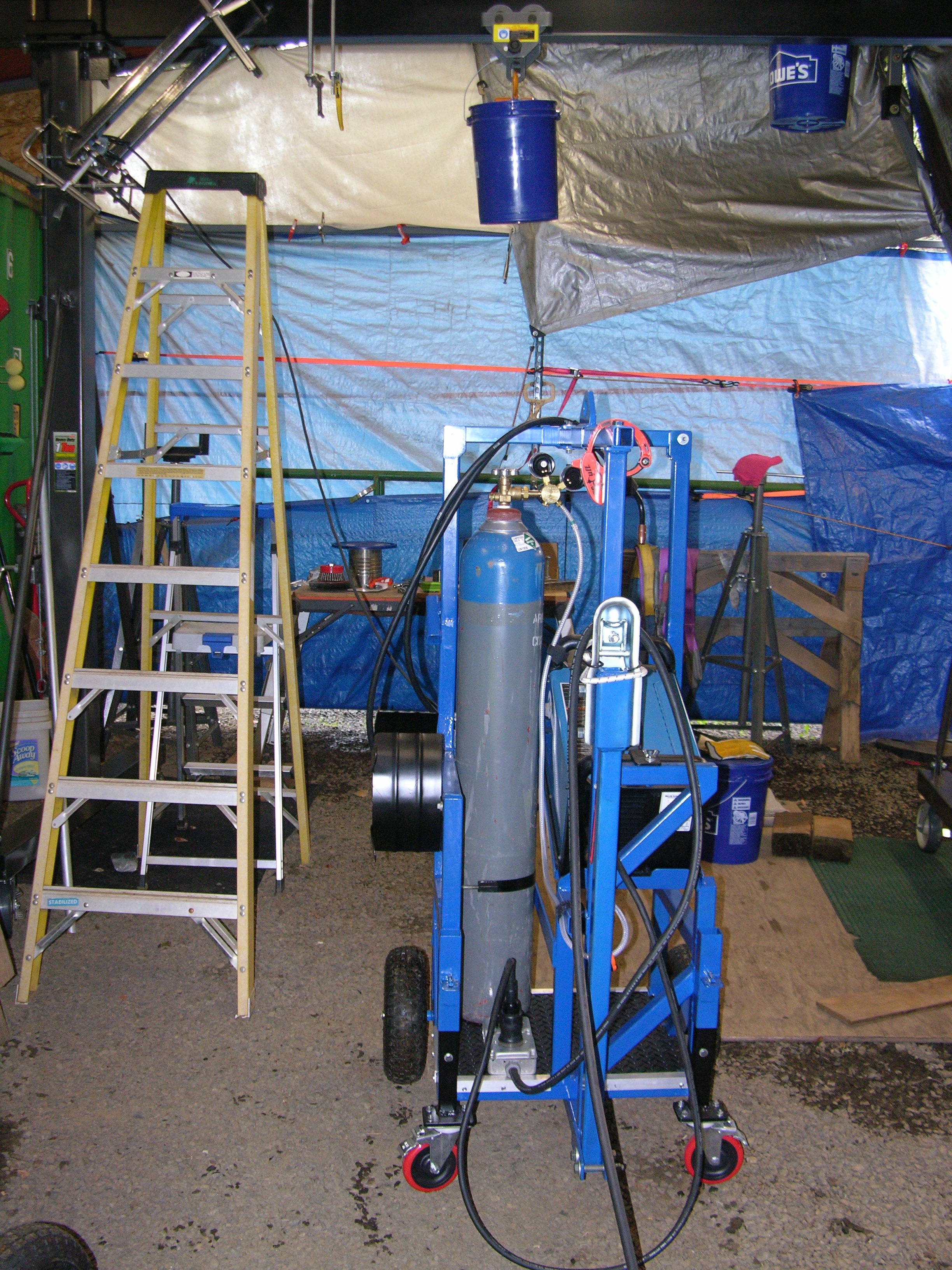

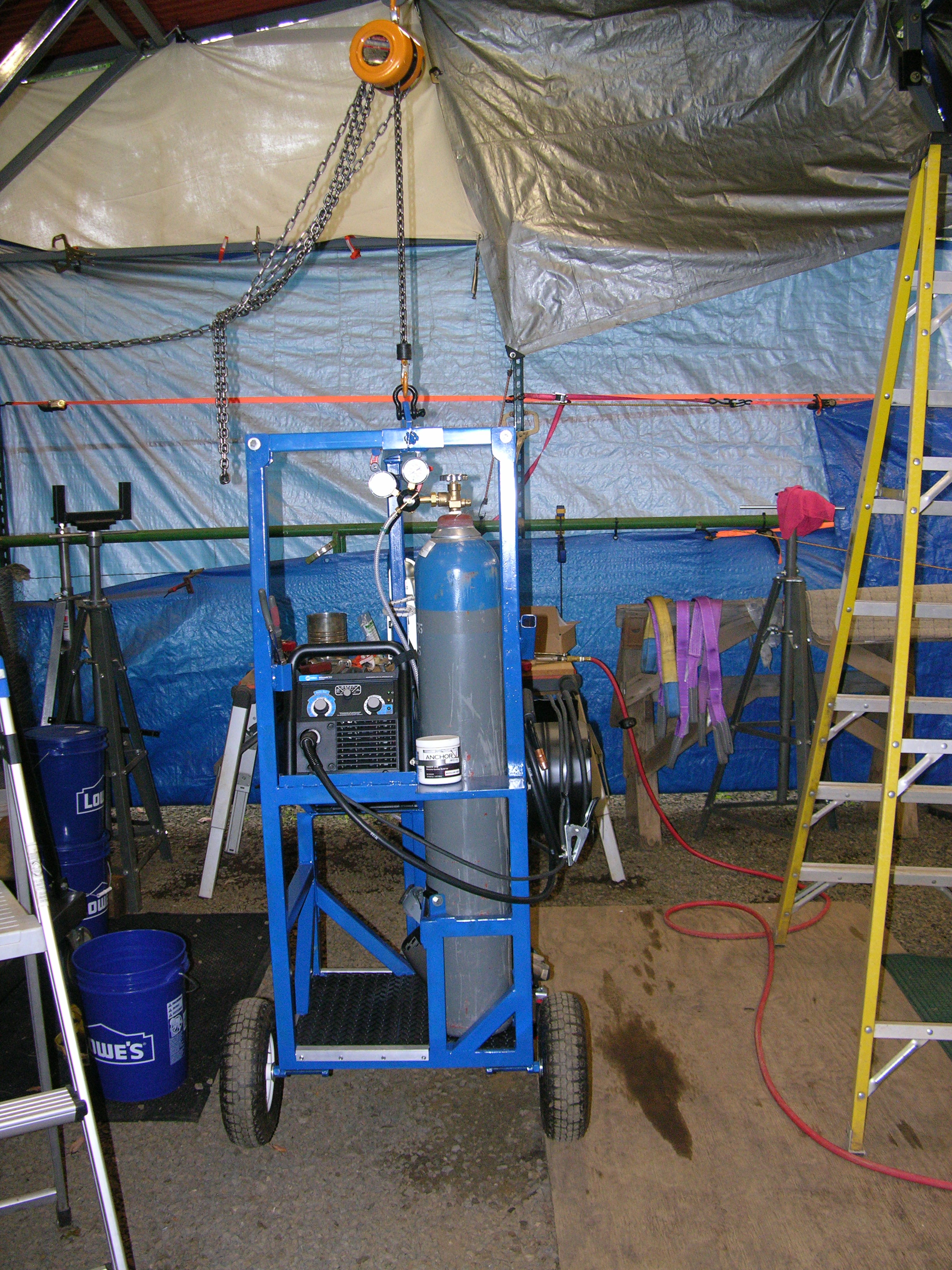

New MM211 and its "4-way cart" moved easily on my "high-tech gravel floor", ready to make sparks -
Manual settings for 1/8" steel -
Welds done (some nicer than others; note to self: get COMFEY, THEN pull trigger :rolleyes:)

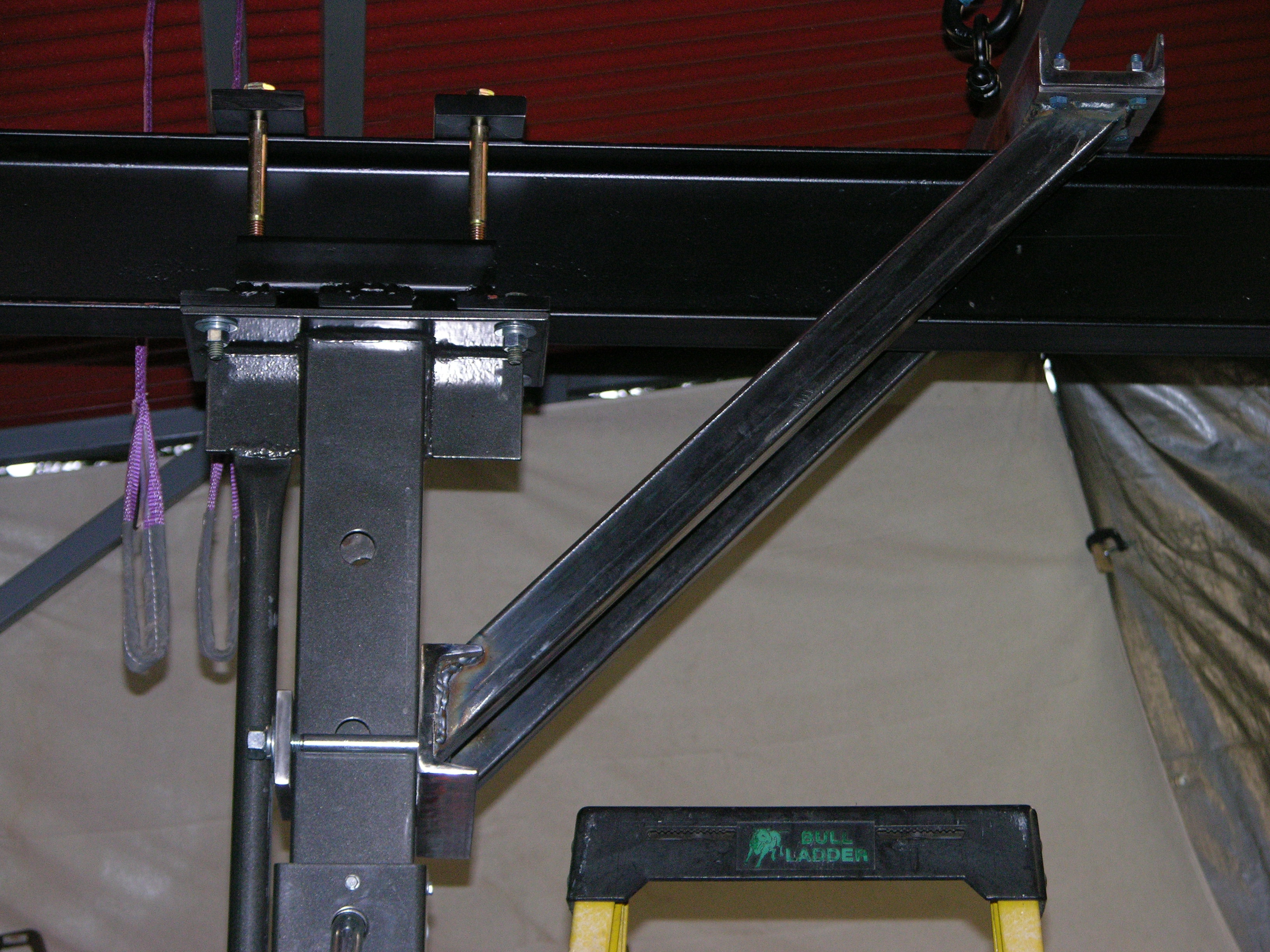

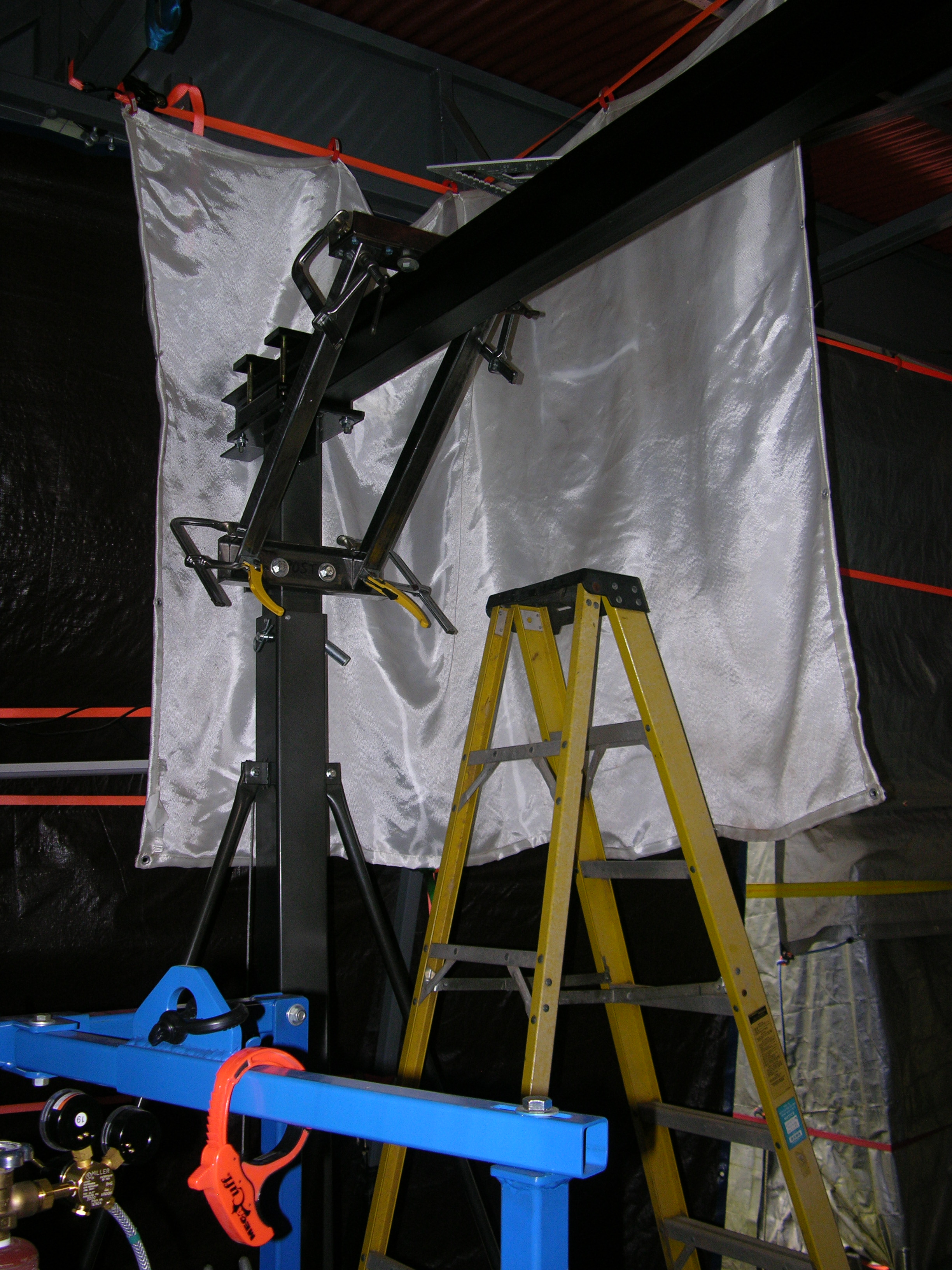

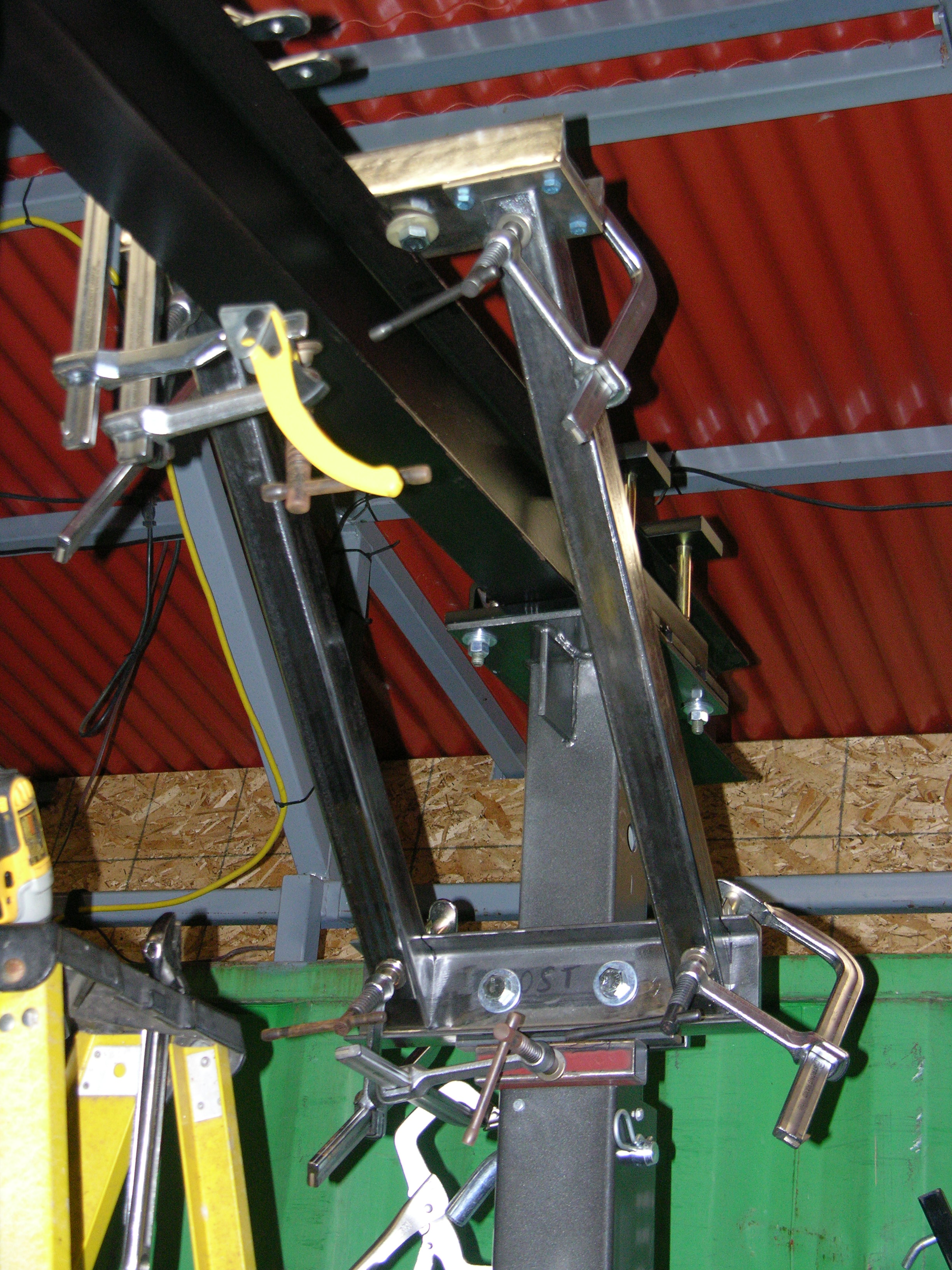

Did the second diagonal brace today; Same problem on a couple of vertical ups as before - looks like I'm gonna have to spend some "quality time" with the little MM211, those welds would've looked like "flatlander" welds with the MM252 :confused: But even so, they're plenty strong for this and I'm ready to move on anyway :rolleyes:
Spreaders bolted up and diagonals clamped (had to do the same "post rotation" as the other one) -
Got the "2 axis balance control) pretty well dialed in on the cart's pick point (yes, the wheels ARE 4" off the ground) :D -

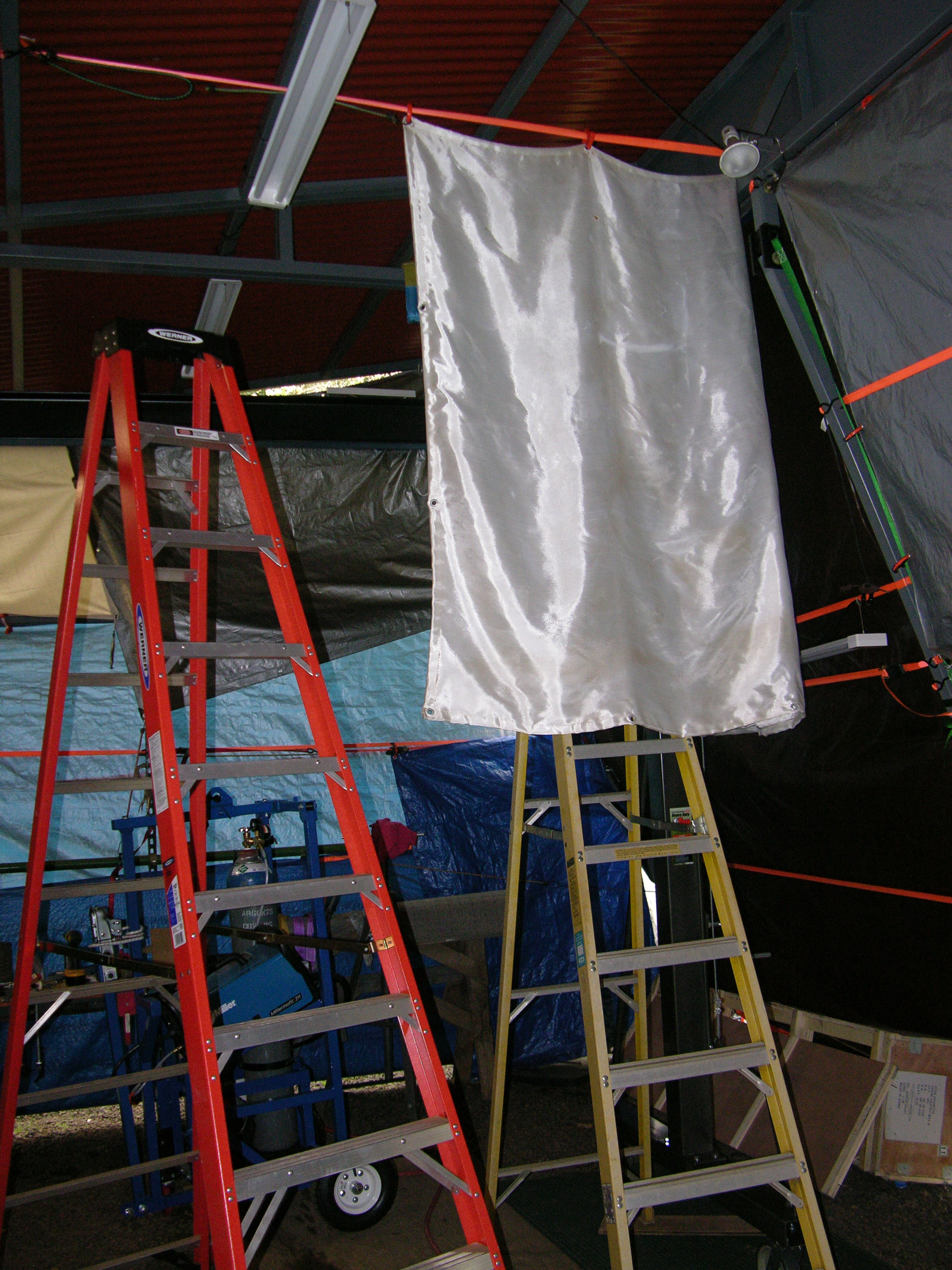

Wind started comin' up so I invoked "plan B" -
All the welds look about the same, so you can just look at THIS one 4 times :laughing:

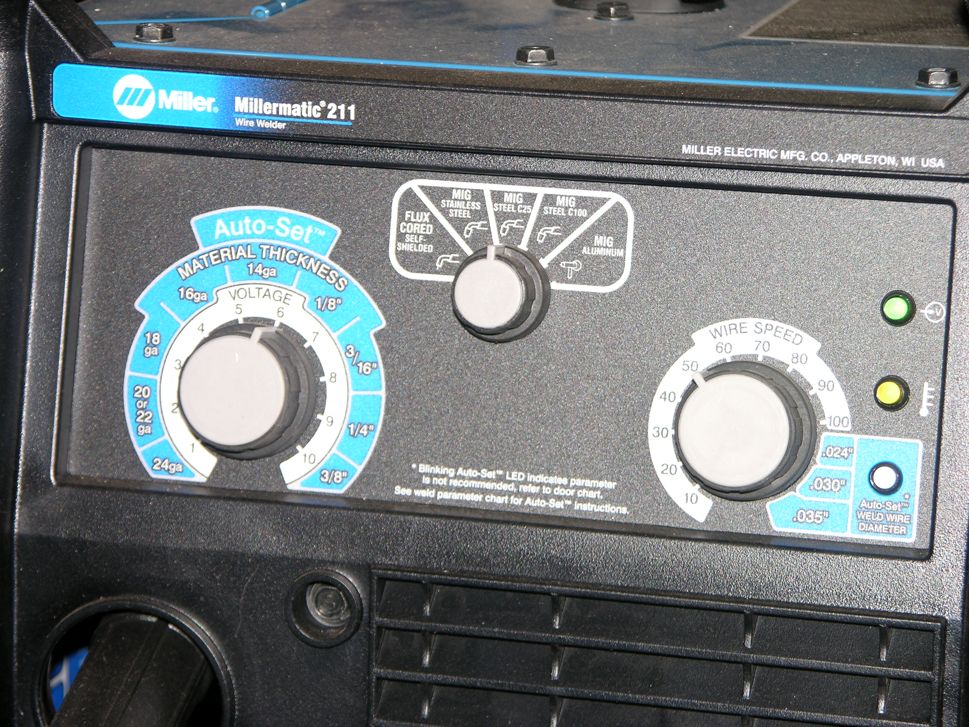

How come you dont use autoset on the 211?
/ Container Weld Shop build -
#289
"How come you dont use autoset on the 211?"
I used to use it on the previous transformer mm211, started seeing things with my welds that that I couldn't see a reason for - then I read somewhere (wish I could find it again :confused:) that Autoset changes parameters DYNAMICALLY depending on stickout??!? - so I started setting it manually (slightly colder than the chart recommends) and my welds started improving -
Then (of course) the MM252 doesn't HAVE autoset, so I just kept doing it the same; then when I started using the DIGITAL MM211 (Really, Miller??!? ya couldn't-a at least put a "D" after the number?) it didn't work quite like I expected. The last batch of welds agree, they SUCK at least a third of the time - but it's a PITA to drag the 252 out across my "custom high-tech gravel floor", and I had this nifty "offroad" cart, soooo....
So now, guess I'll put some of those scraps to good use and learn to weld all over again :rolleyes: First thing I'll try is what worked on the transformer 211; autoset, set about one "notch" thinner metal than I'm actually welding...

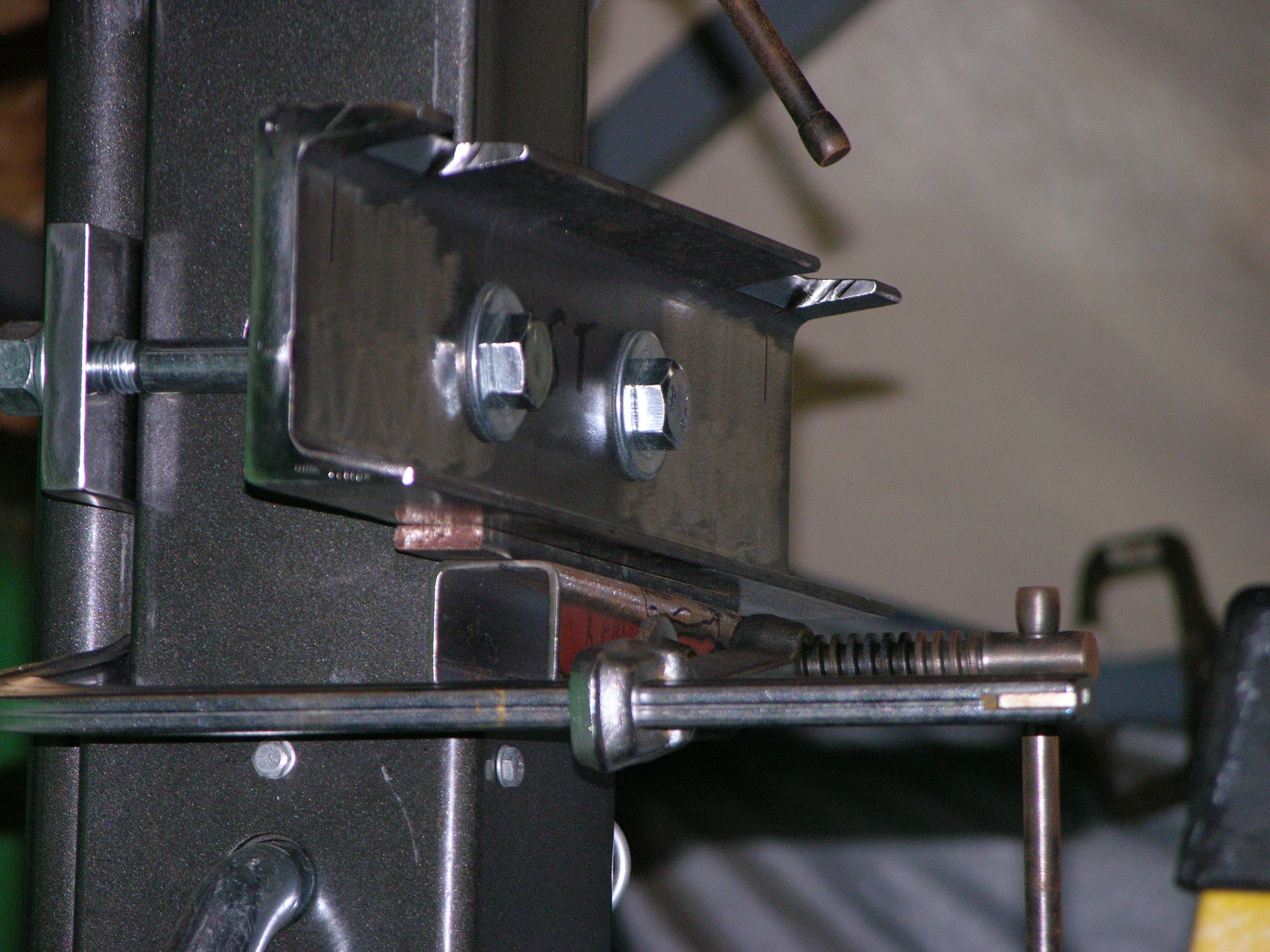

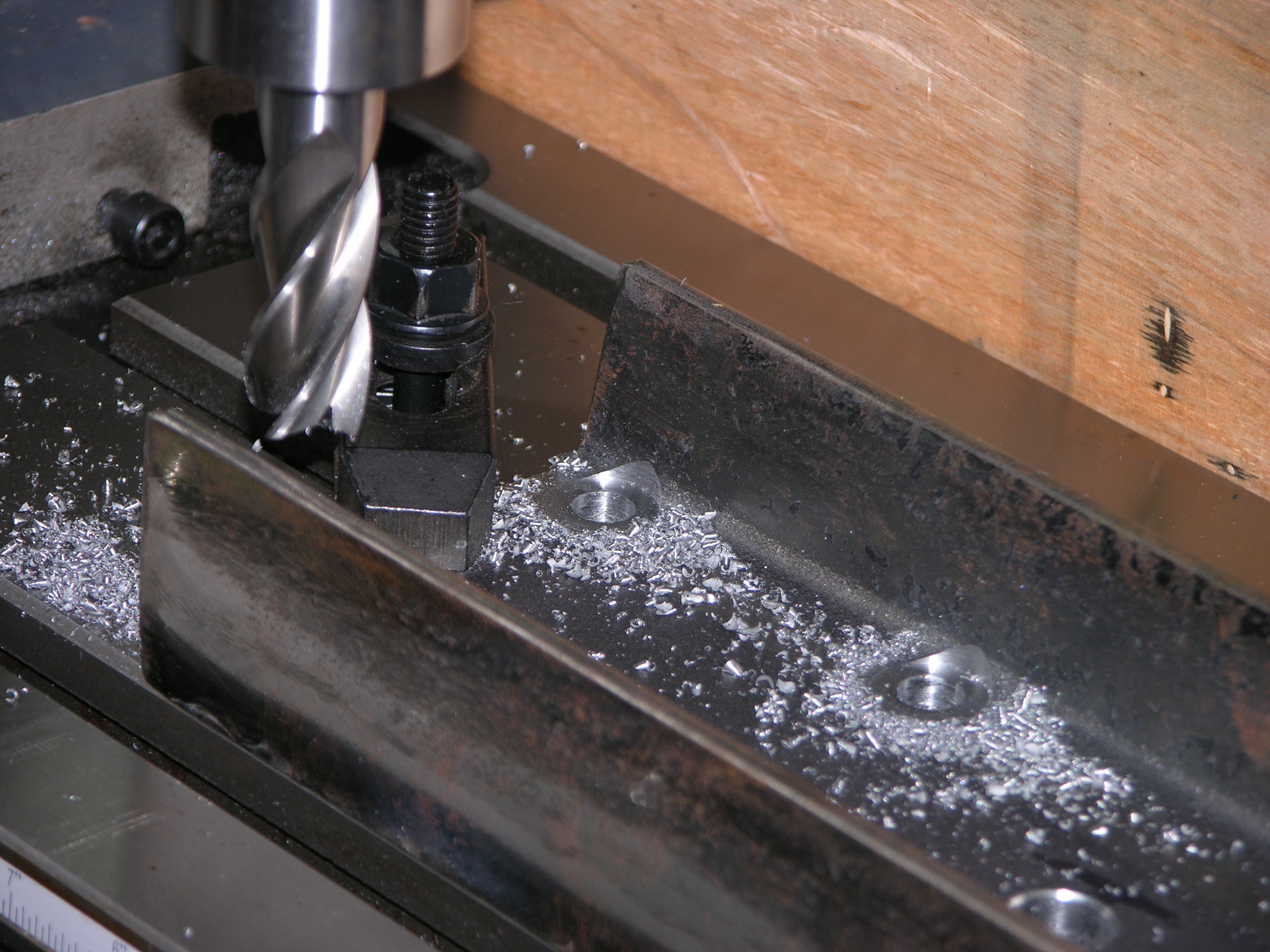

Fixed ANOTHER problem (of my own making) today; I had made the diagonal braces so the upper C channel spreader BOLTS up to a pair of 1/4"x4"x4"flat plates, which are welded to the diagonal tubes - otherwise, if I needed to adjust OR remove those braces I'd have to disconnect the upright posts COMPLETELY from the I beam - (pic is BEFORE welding)
I wanted the mounting bolts as wide apart as possible to minimise any tendency to rock, but I got 'em a little TOO far apart, so the channel legs made it so the nuts and lock washers couldn't sit FLAT :rolleyes:
Milling machine and a 3/4" center cut end mill to the rescue -

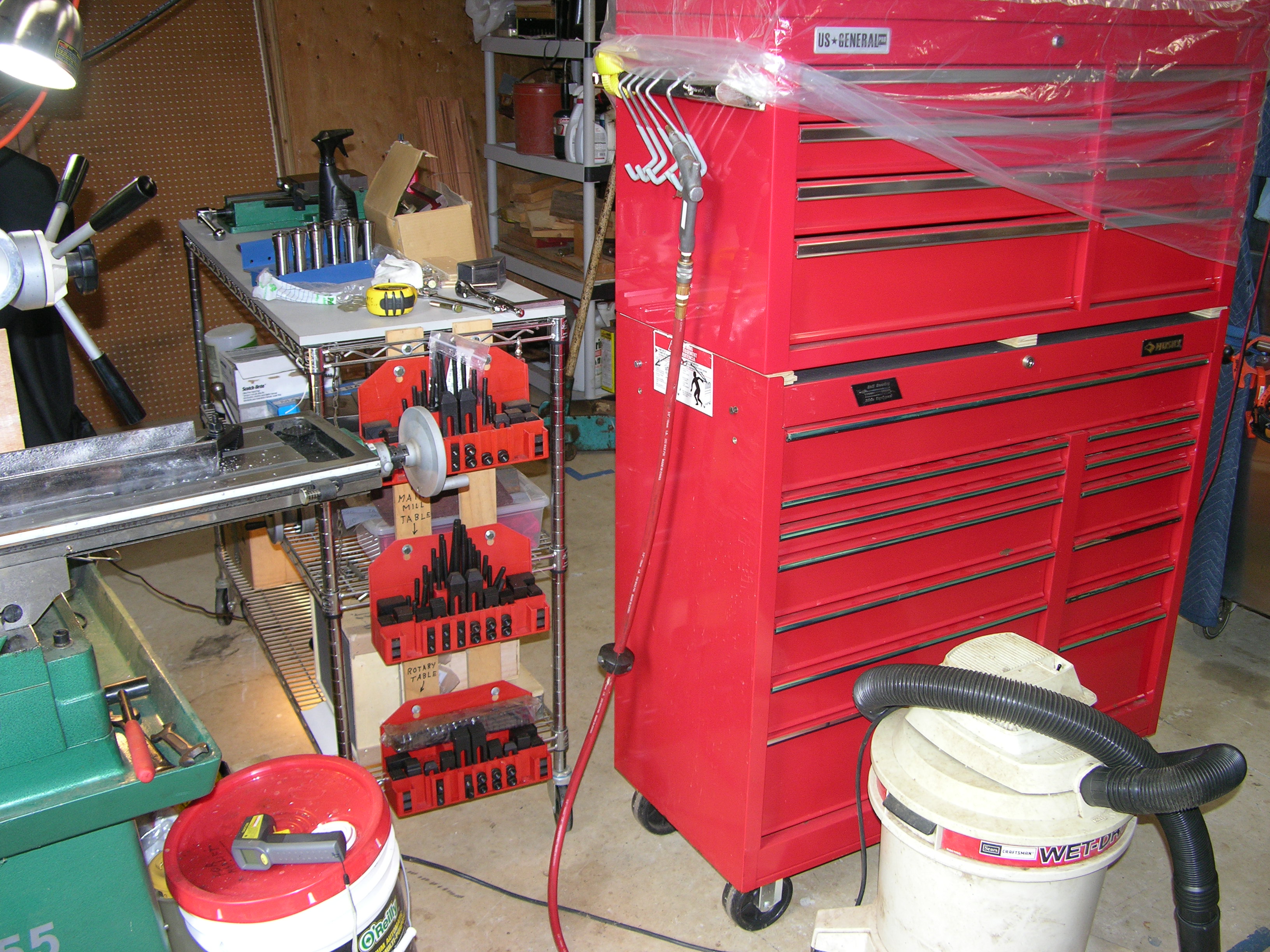

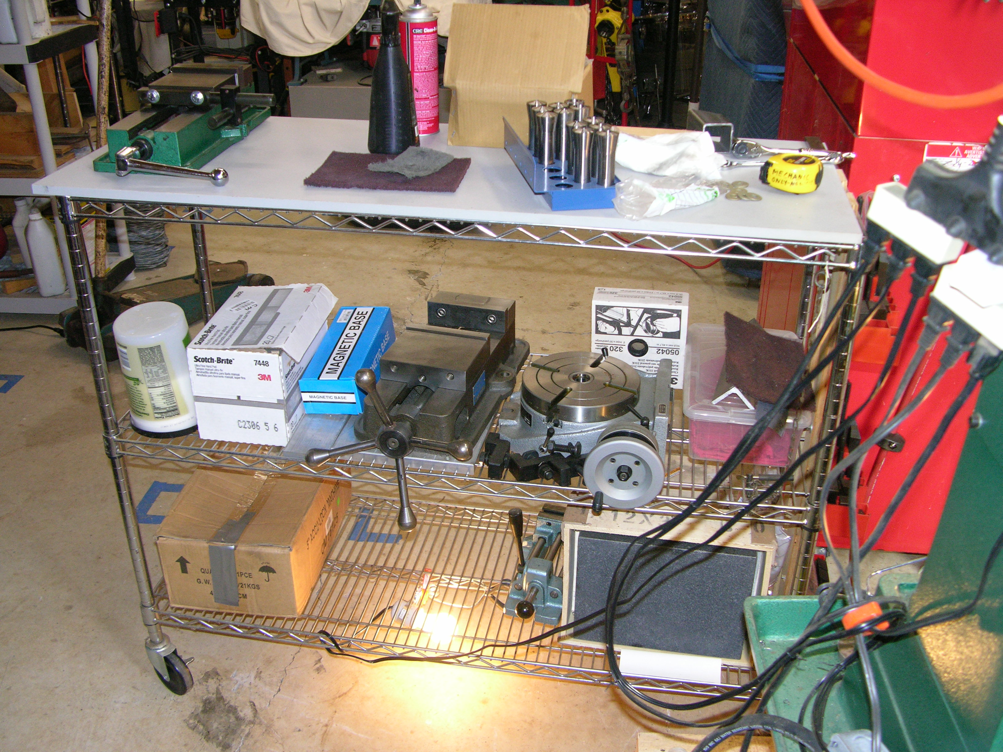

Some of the other goodies the couple years of mandatory OT paid for (the top red box is empty at the moment, bottom one's got boring bars, angle plates, parallels, mills, drill bits, more T nuts, mics, other measuring stuff, tramming indicator, files, center finders, etc, the 6" chuck for that rotary table and all the stuff for the 3 axis DRO (except the time to build it :confused:)

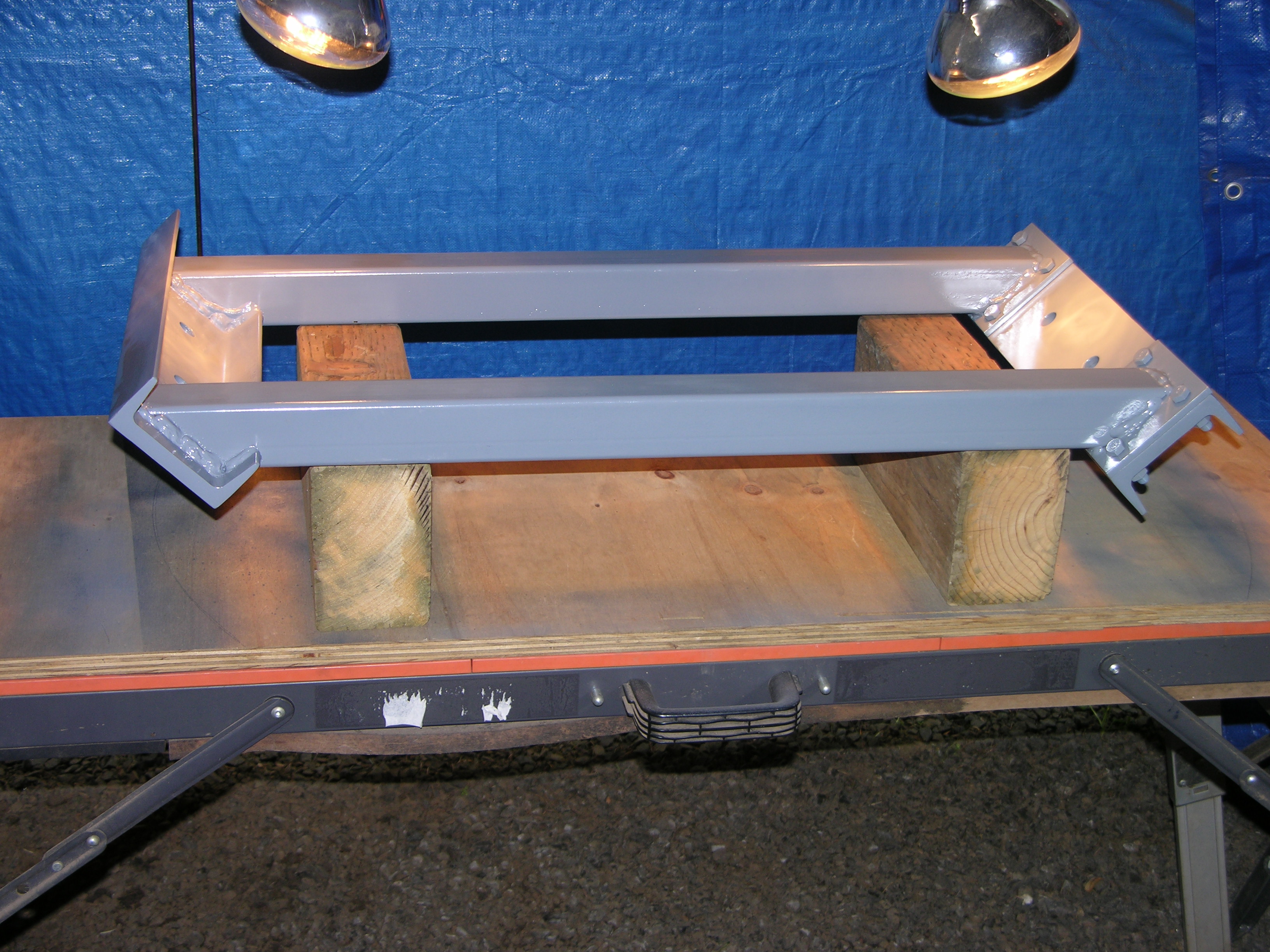

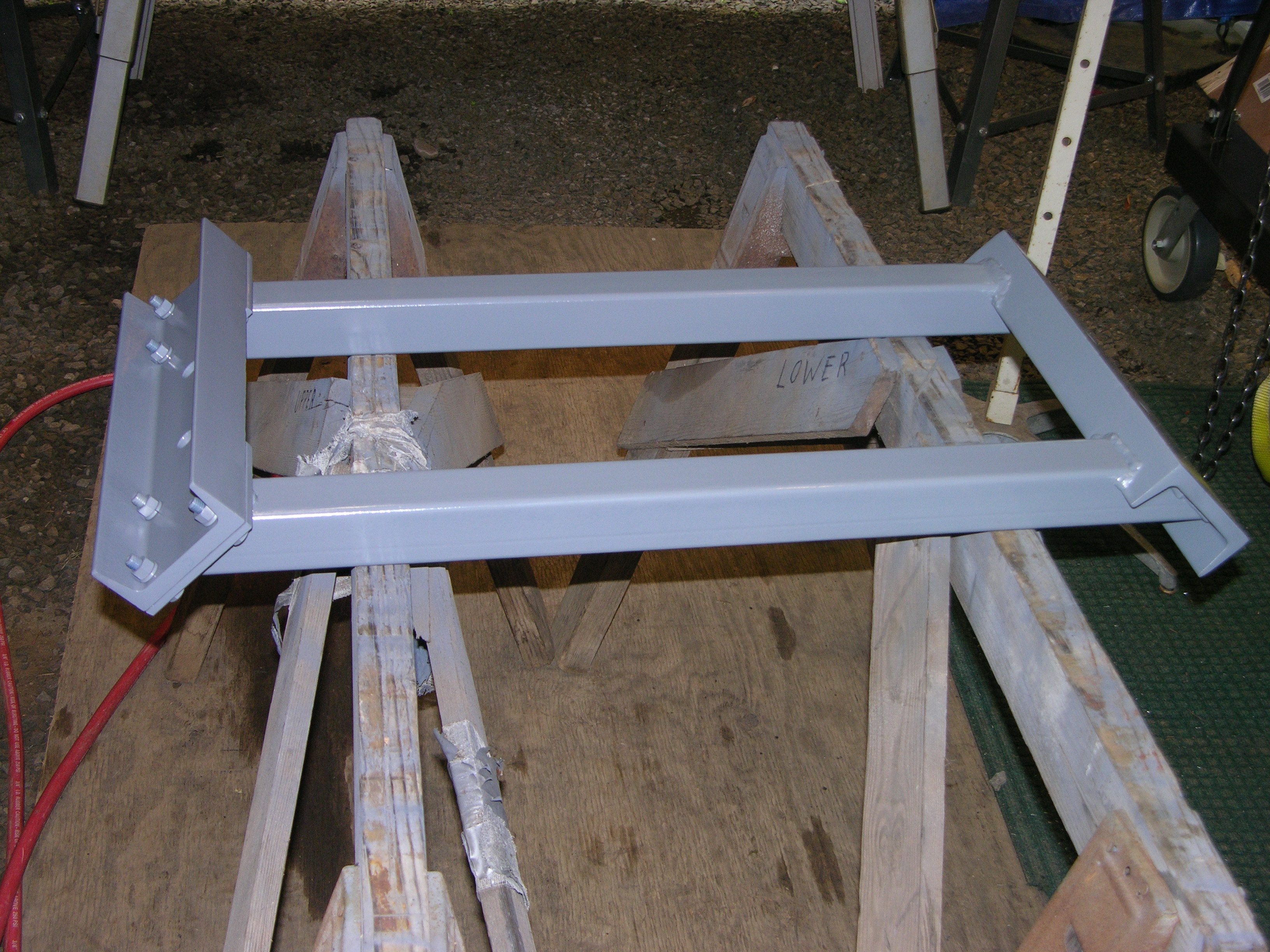

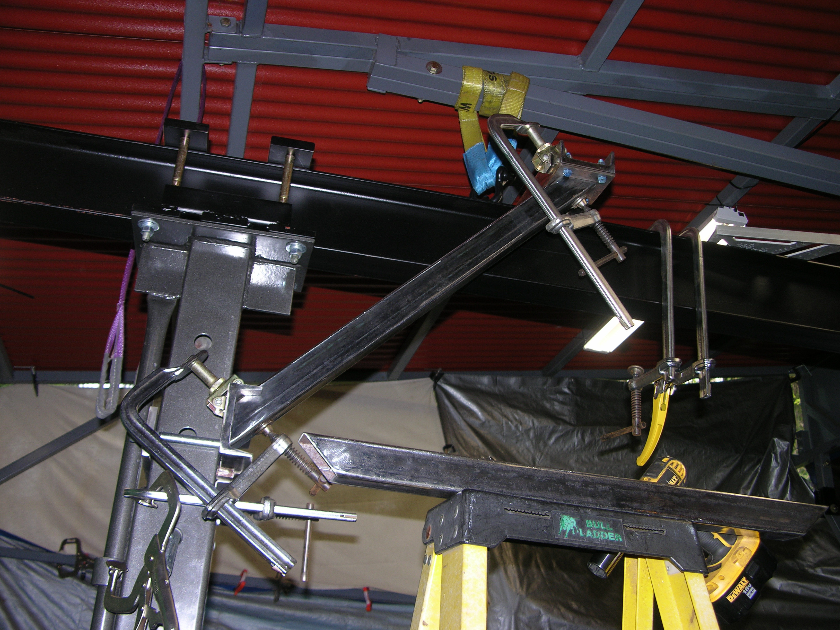

Finally got back to cleanup/paint on the braces for the HF crane - ended up slicing one of the worst "shaky man on a ladder" welds out with a zip disk and re-doing it. Only pic I took was of paint drying ('bout as boring as it sounds :rolleyes:)
When I unbolted the upper spreader channel after welding, the tubes had moved just enough to bind up on the mounting bolts - so I clamped one of the legs in the vise, loosened all the nuts and started pushing the tubes apart with one of the Stronghand 4:1 clamps (add the standoff on the OUTSIDE of the "F" part, reverse the acme screw end, and you get a 1200# spreader instead of a 1200# clamp)
I found out I had to push the tubes apart just over 1/2" BEYOND where they needed to be, before they would line up with the bolt holes on their own. Now I can reassemble the braces around the I beam without having to use more clamps to force things into alignment... Steve
#297

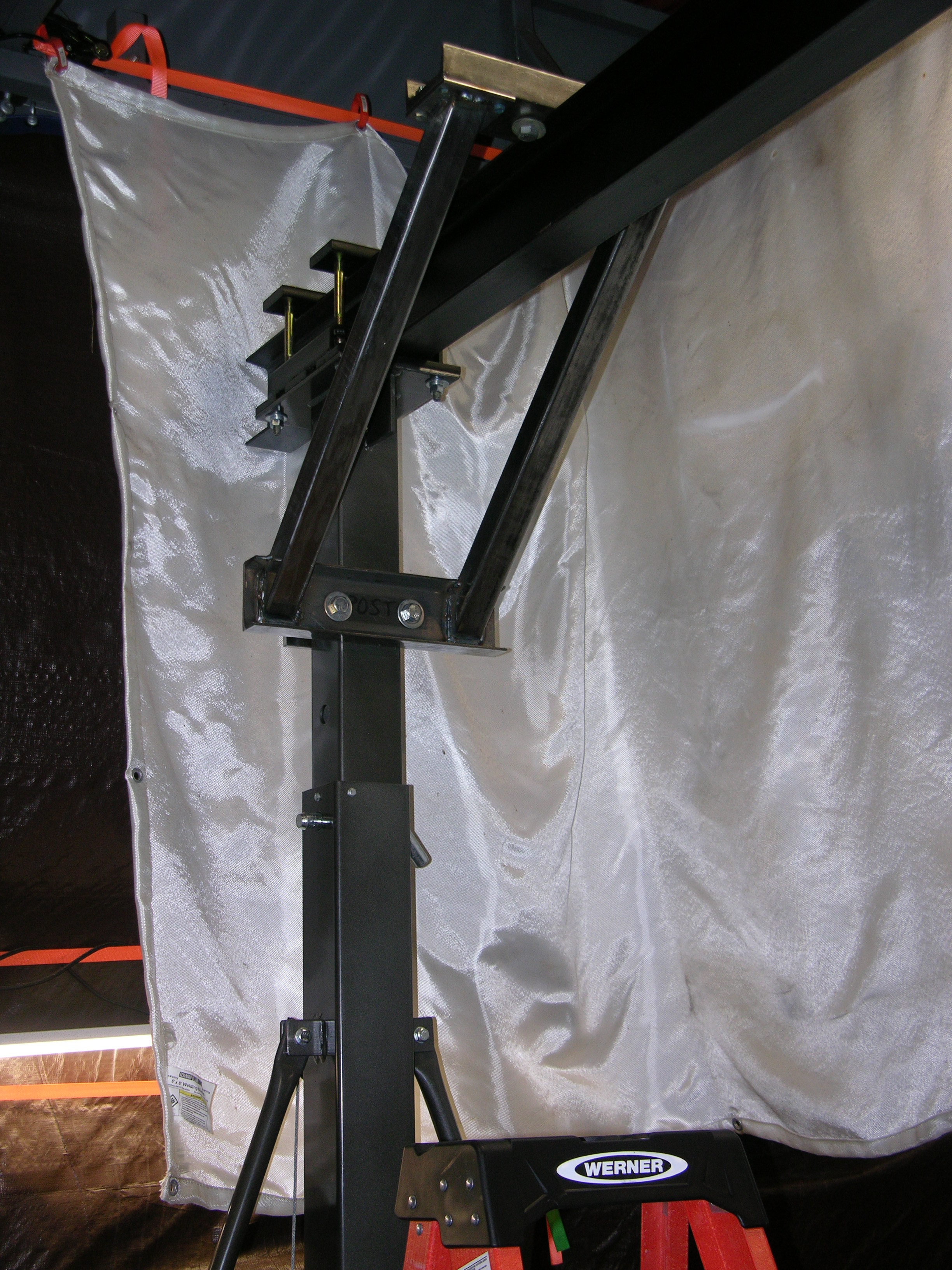

Todays feeble attempt at progress - the first corner brace, ready to re-install. The left piece of channel is the upper spreader, and it needs to be removed from the rest of the brace or I would need to take the entire upright loose from the I beam to get it on; DSCN3224.JPG
so all 8 of those 3/8" bolts came off, then the channel got loosely bolted/clamped onto the I beam; then the rest of the brace got rested on a clamped on piece of square tube just above the outer half of the upright. Once all the OTHER bolts were in and tightened, then the 2 clamp bolts (that hold the upper channel to the I beam) got tightened, and it looks like this -
The second brace spent some time under the IR lamps (bit cool for paint today) and got the rest of its paint;
After supper it'll have been under the lamps for about 3 hours, so it'll get installed the same way; ('cause it didn't hurt me and went pretty smooth :D) - next I'll need to figure out what to do with those incredibly cheesy "winches" HF uses to raise/lower the beam; they're already slipping... Steve
