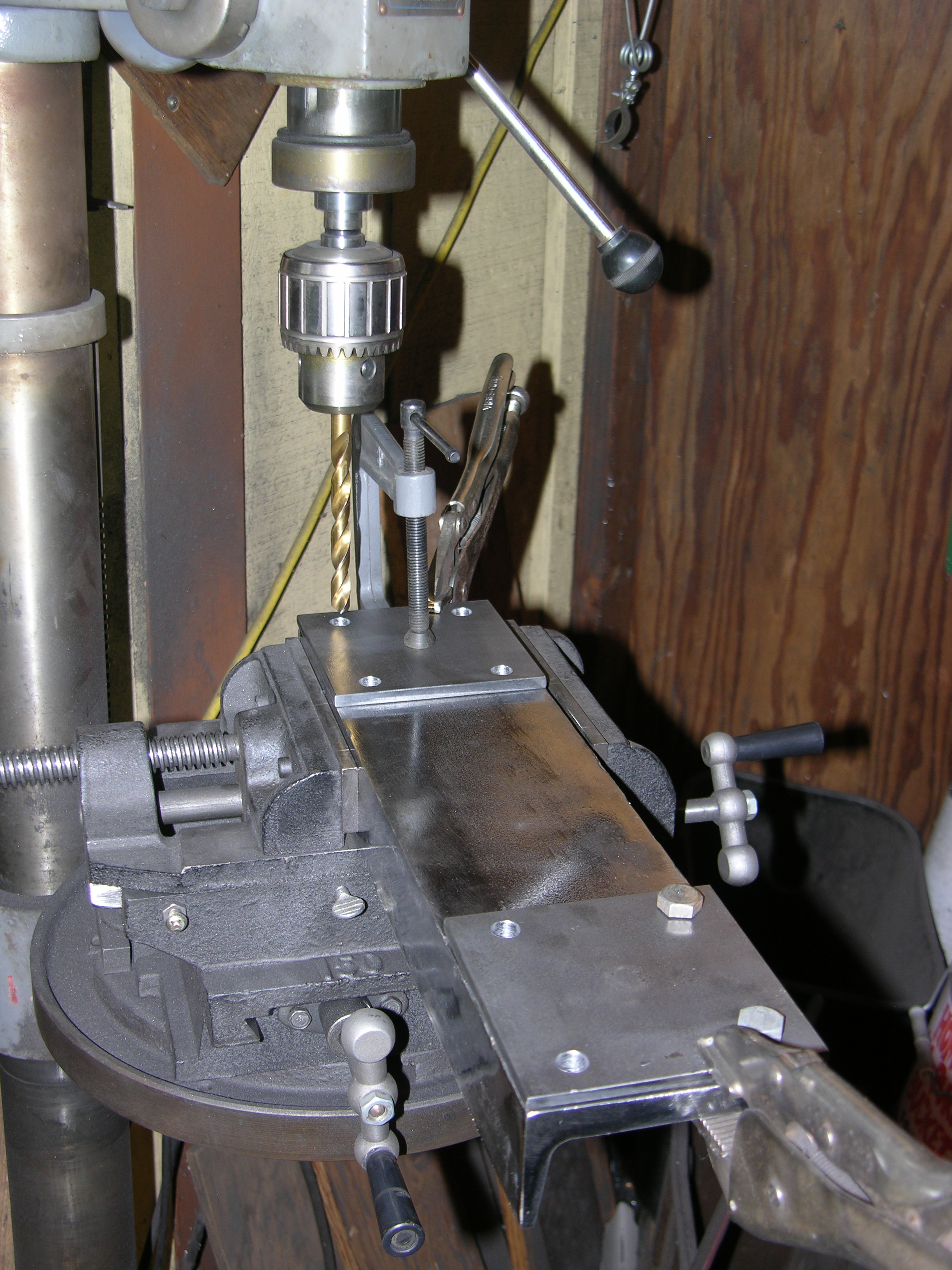

As is my "usual", I've gone a bit overboard - here's my "drilling station", still a work in progress -
http://www.tractorbynet.com/forums/...-table-build-6.html?highlight=mag+drill+table
And I also bought these
Metabo 635 1/16-Inch-1/2-Inch Keyed Drill Chuck - Power Lathe Chucks - Amazon.com
G&J Hall Tools 18Y17 Powerbor Weldon Chuck Adaptor, 1/2"-2 UN Thread Fitting, 3/4" Arbor, For All Electromagnetic Drilling Systems: Drill Press Accessories: Amazon.com: Industrial & Scientific
My Hougen mag drill (+ the "fabricator kit") came with a standard chuck, but you have to partially dis-assemble the drill to change to a regular chuck, which I'm not patient enough to wanna do for a few smaller holes - those two links make it so you just insert the regular chuck in place of an annular cutter, BUT (there's ALWAYS a "but"...)
Twist drills are all different lengths, depending on diameter, which "type" bits, etc, and even tho my mag drill has a fairly long stroke it's not enough to compensate for bits that might be anywhere from 2" up to 6" long.
So one of my "tuits" is to do yet another mod to my setup, but I haven't found a suitable "donor" bench model DP to accomplish that. (Setting the mag drill on a DP table mounted to my "drilling table" would give a LOT of vertical range, and STILL let me use the XY table for repetitive spaced holes)
That's the "short" version, now ya know why my friends all laugh when I claim NOT to have modified some new tool I bought :laughing: ... Steve

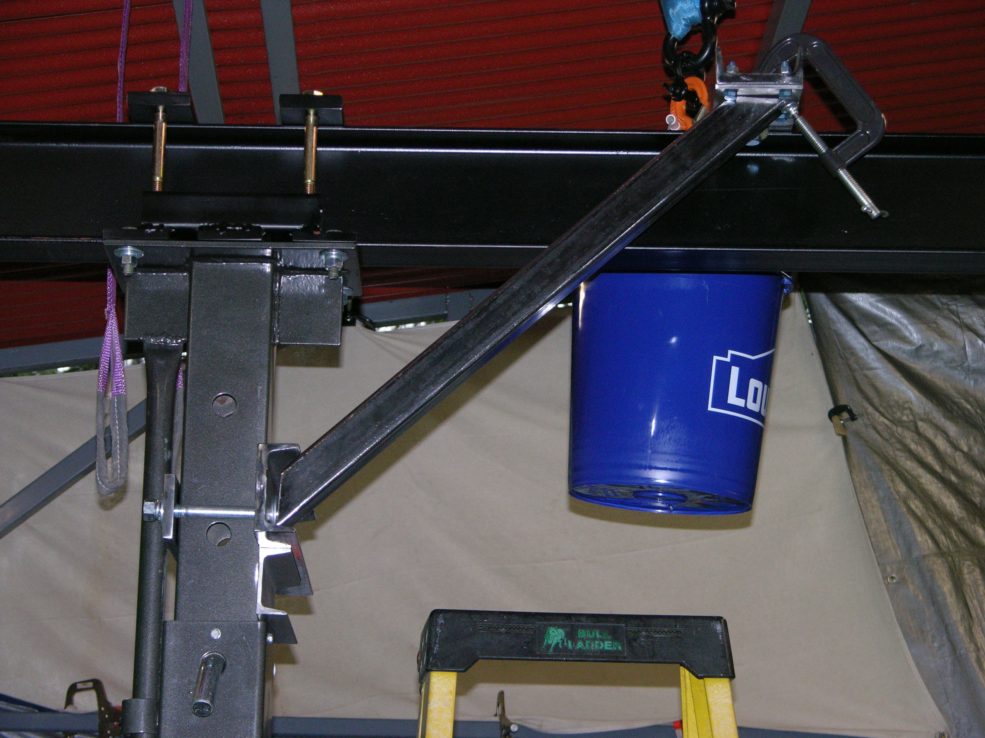

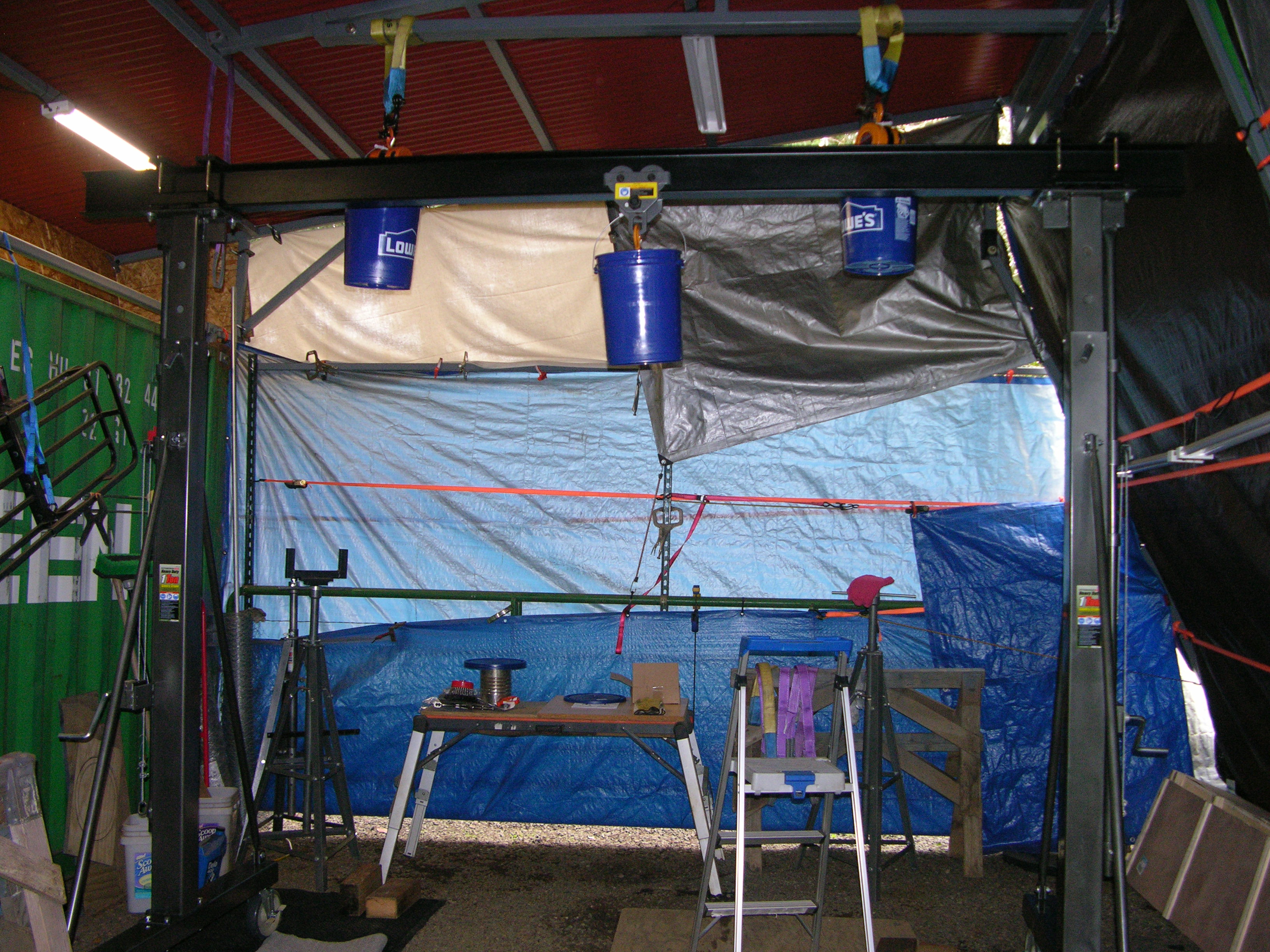

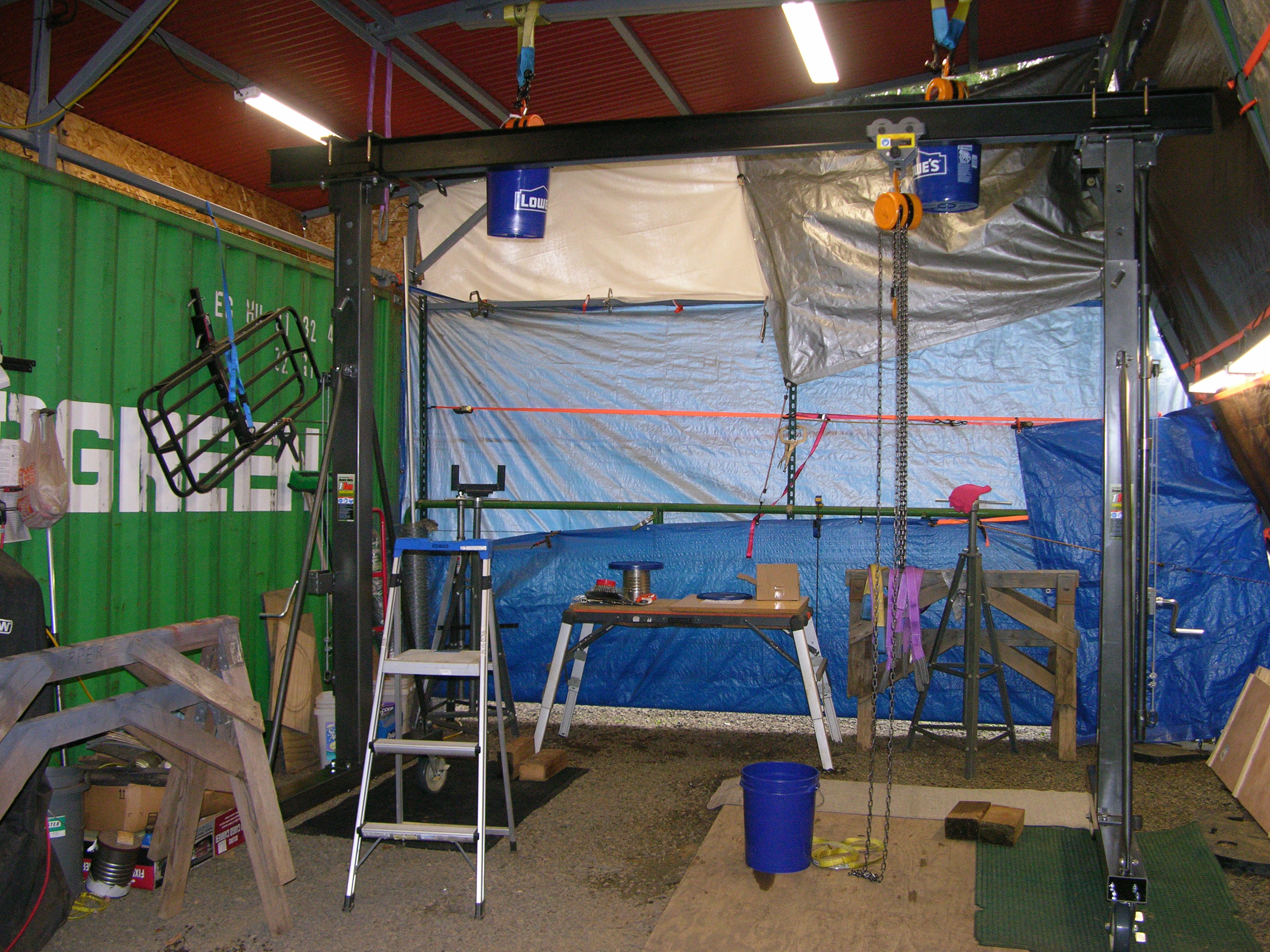

"BTW, my "bucket case" in this instance is working well - keeps all the chains/hooks out of "headache range" when not in use, takes 20 minutes to ready for use"
I corrected your typo error. I keep my hoist chain at hands reach and oof to the side, no need of spending all that time looking for a ladder that I'll fall off from just to get the chain in the bucket 119-15/16 up in the air.:stirthepot:
/ Container Weld Shop build -
#268
Nope, 10 seconds is about right; what is NOT showing in those pics is another 6' (1.83 meters:=) piece of 1" (25.4mm :=) conduit leaned up against the side of the container; that one has a 5/16" (7.93mm) bolt thru one end, I just use that bolt to slip under the 5 gallon (18.92706L) bucket handle and lift up off the hoist, then lower to my hand (I can tell when it's low enough when the 1.83 meter conduit touches the (gravel) floor :D:D:D
('bout got the sides of that pot wore out yet??!? :laughing:)

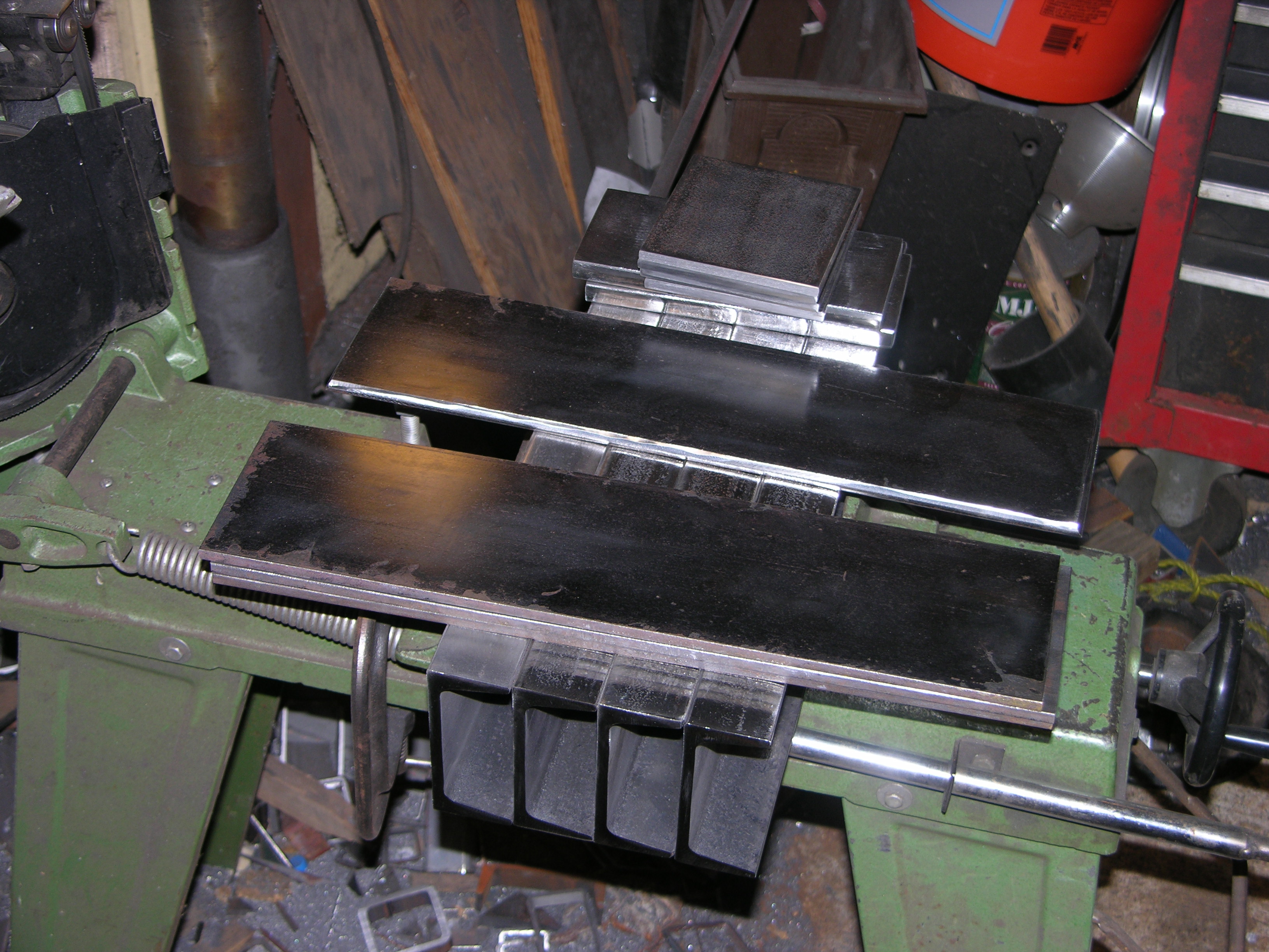

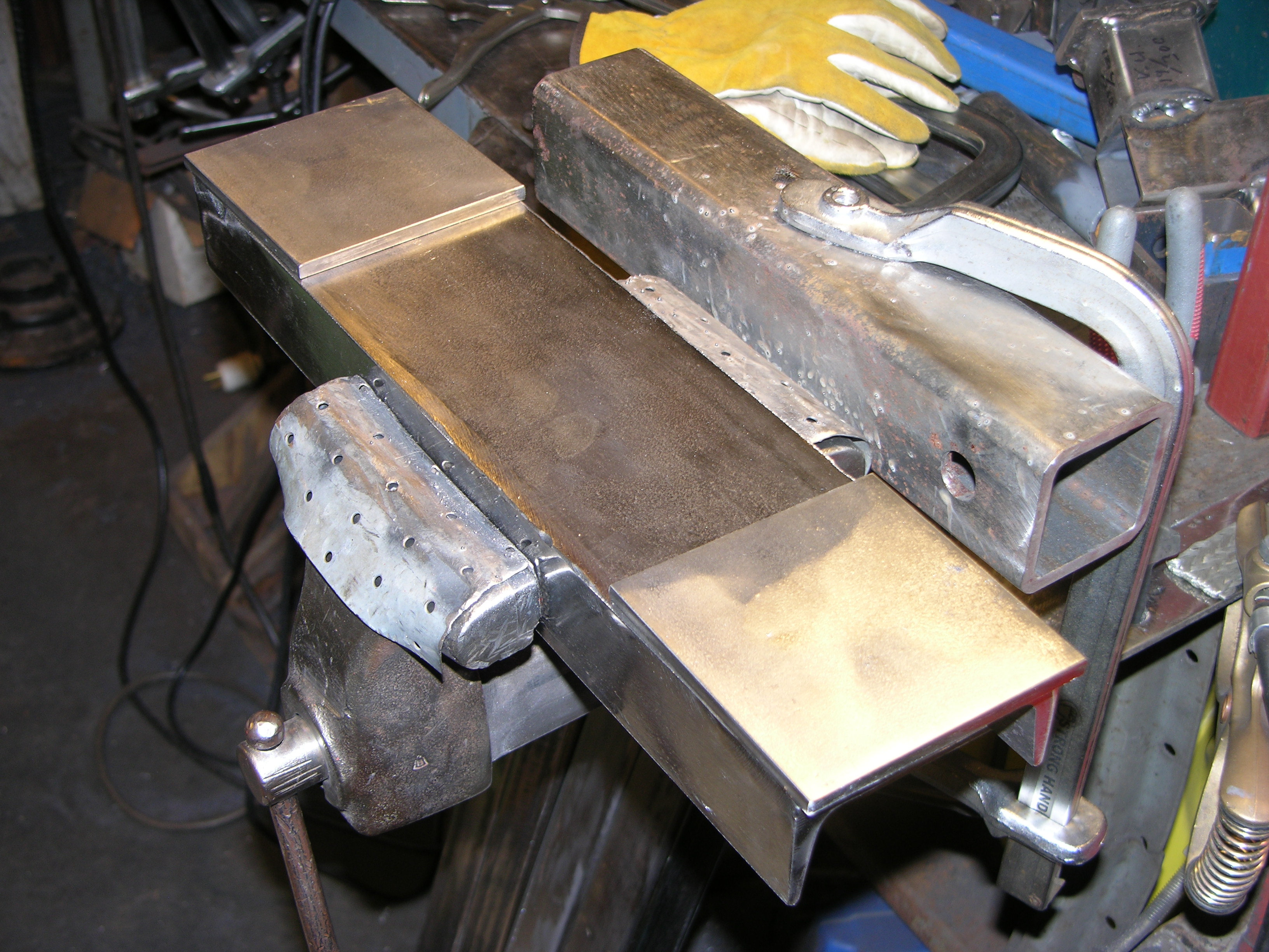

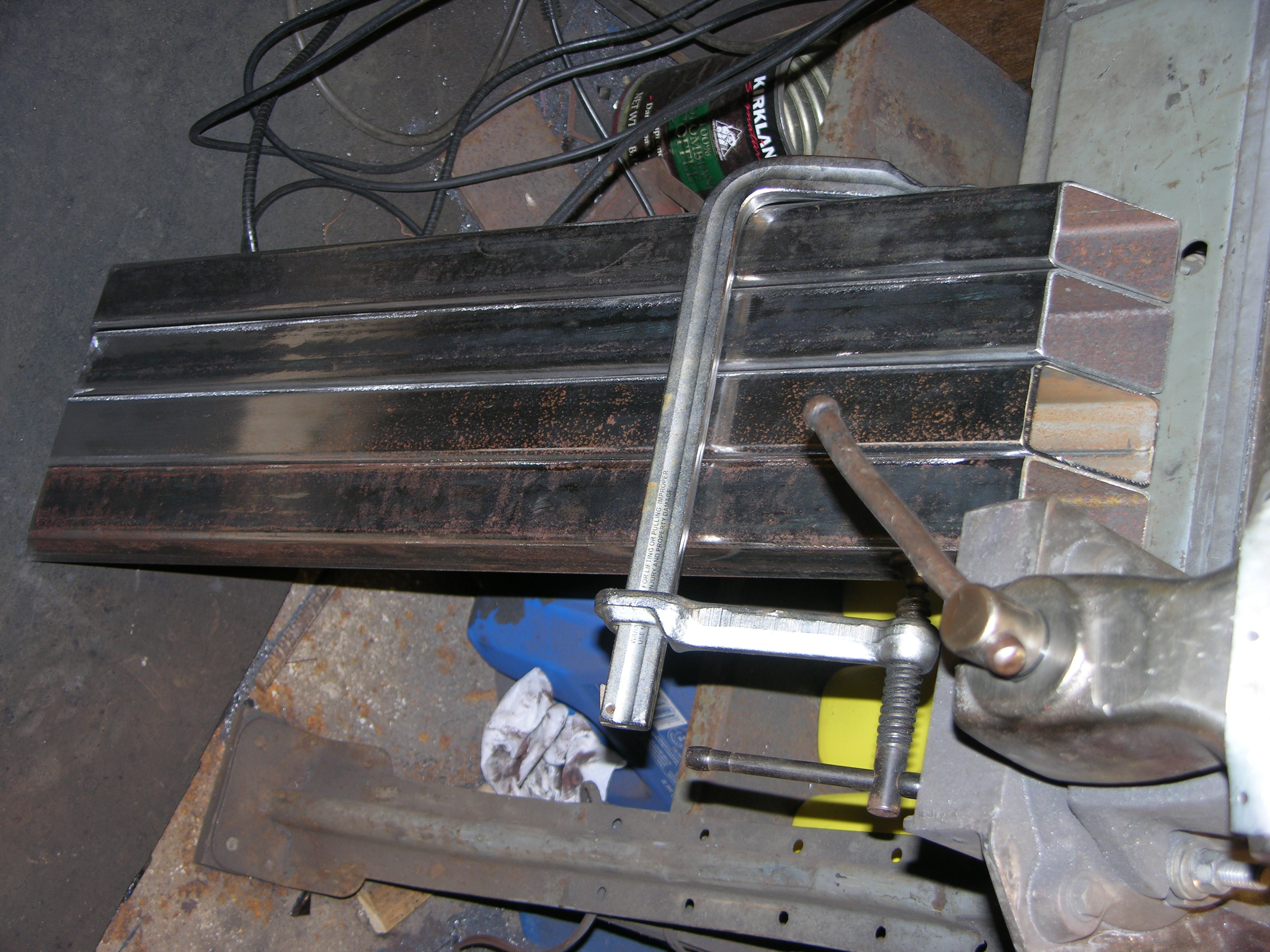

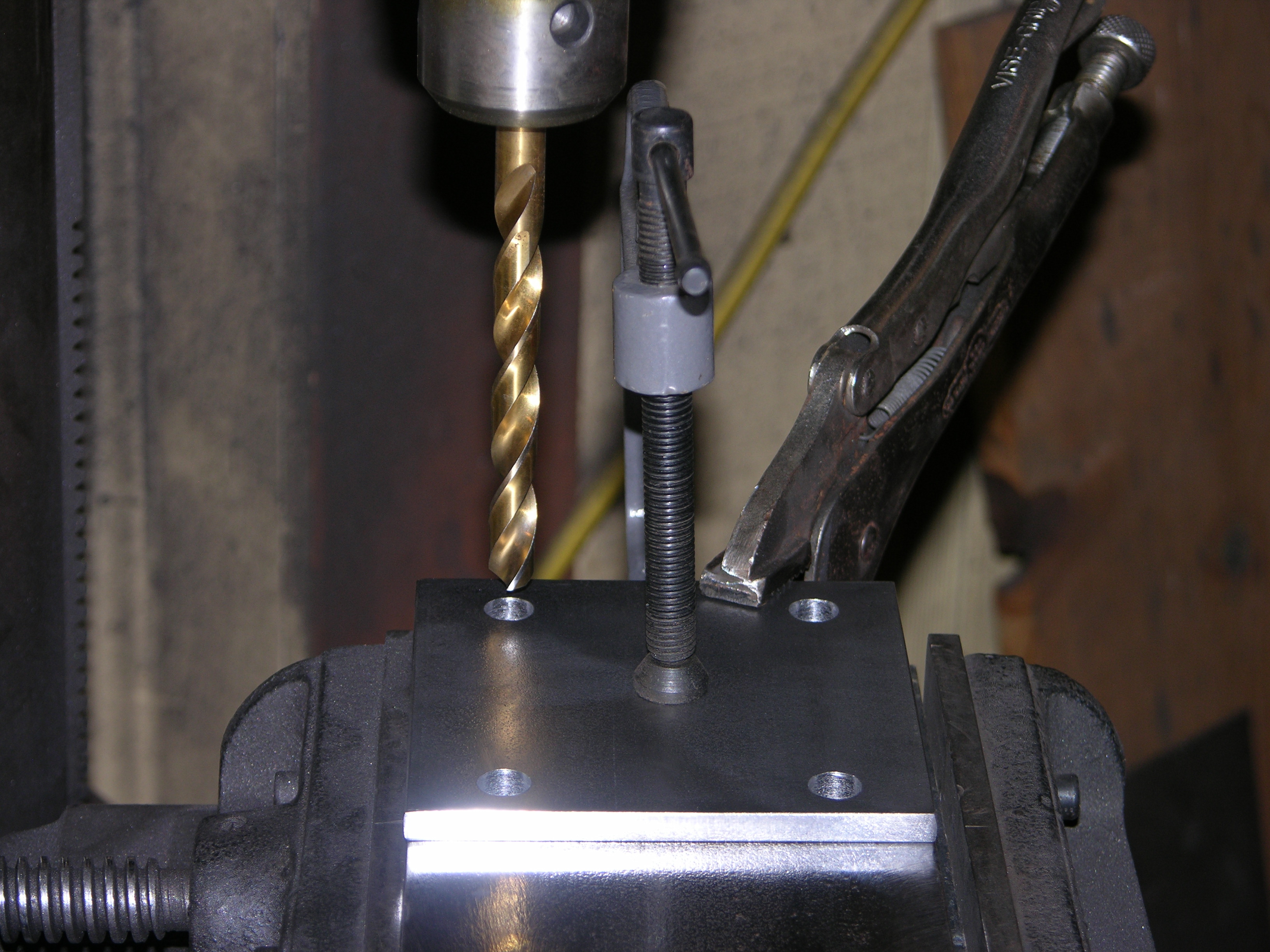

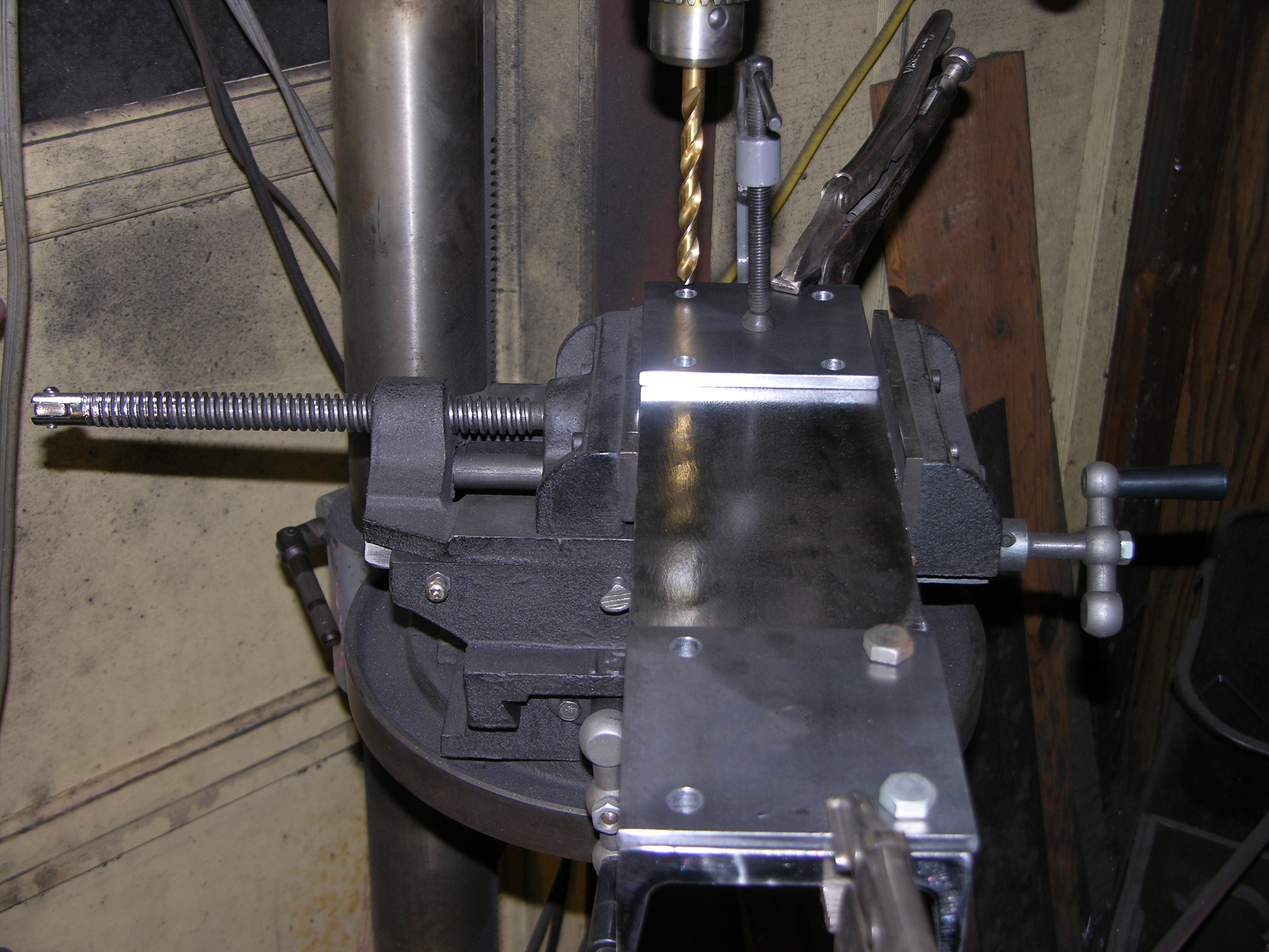

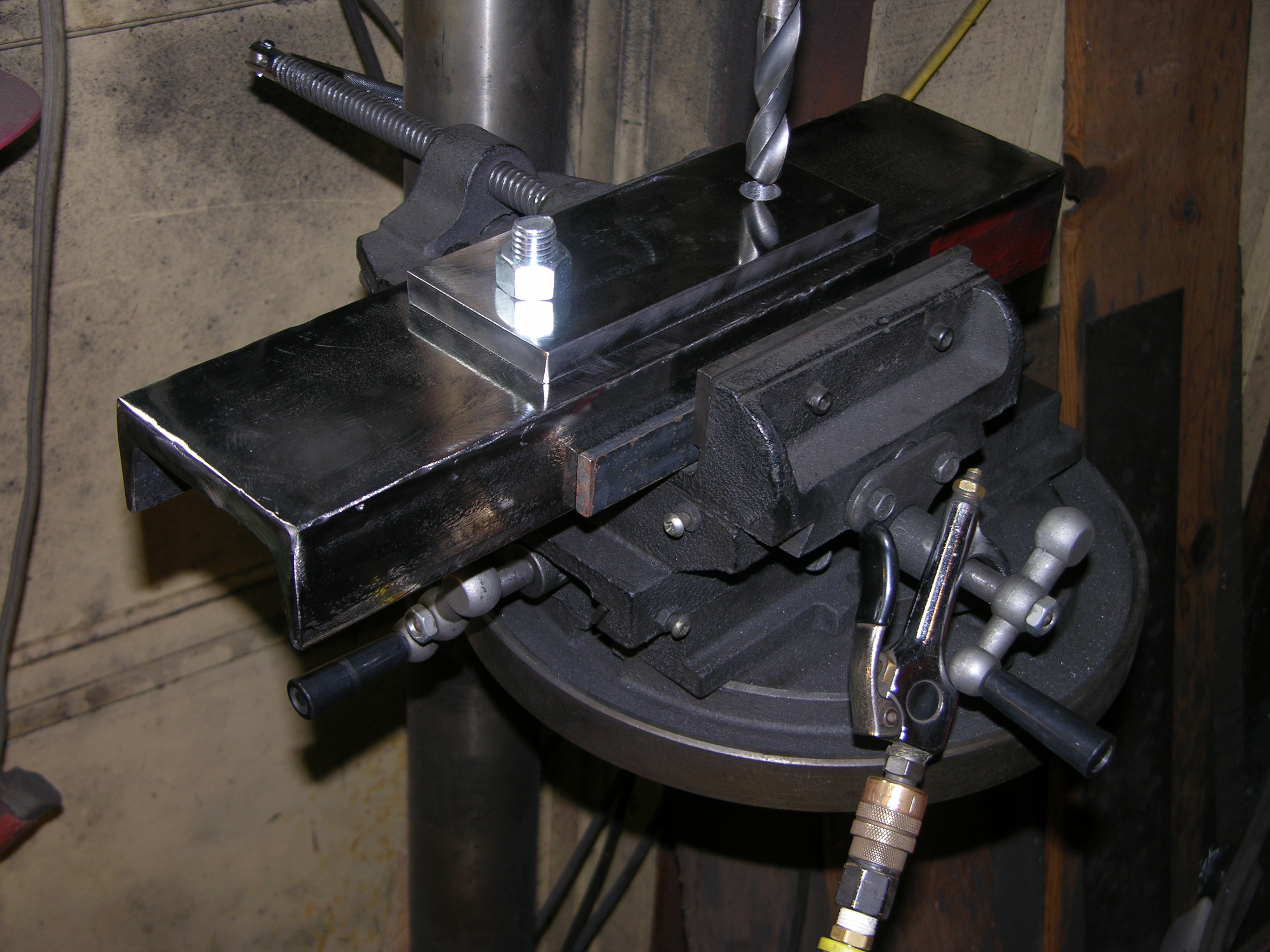

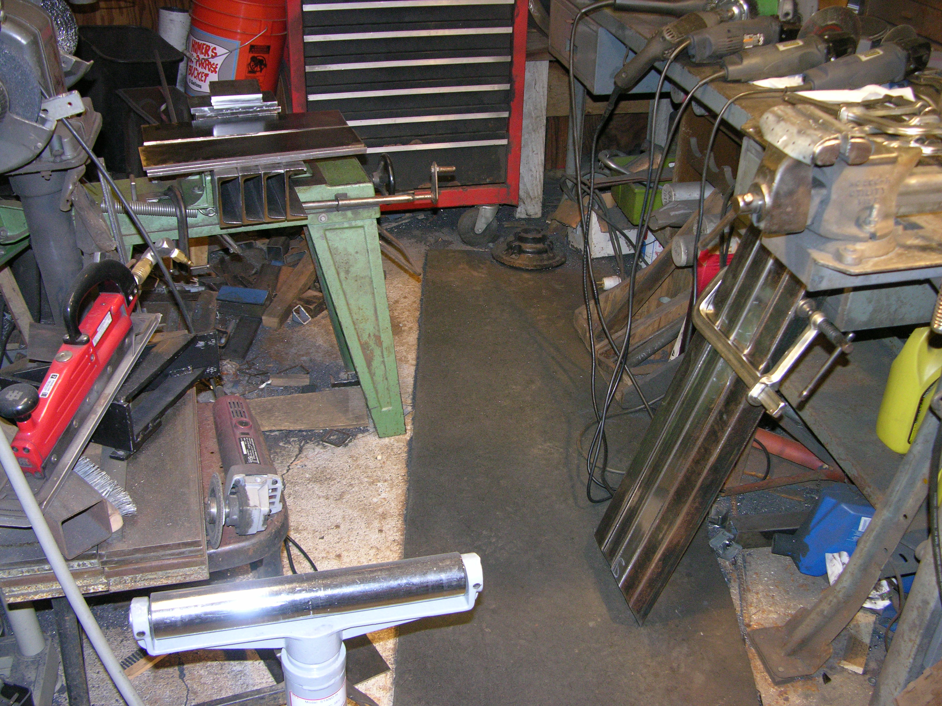

Well, it only took about 4 days of "general malingering" to recover from that little dab of actual work :rolleyes: so I finally got around to doin' some more on the crane braces -
First "spreader" ready to tack - (I wanted a thicker web, didn't have that size, so "winged" it)
Various stages of the process -
On the left, next in line - on the right, done ready for drilling -
Next one in the vise, ready to smooth out -
Next couple of days I MIGHT get far enough along to get a couple pics so ANY of this makes SENSE :confused: ...Steve

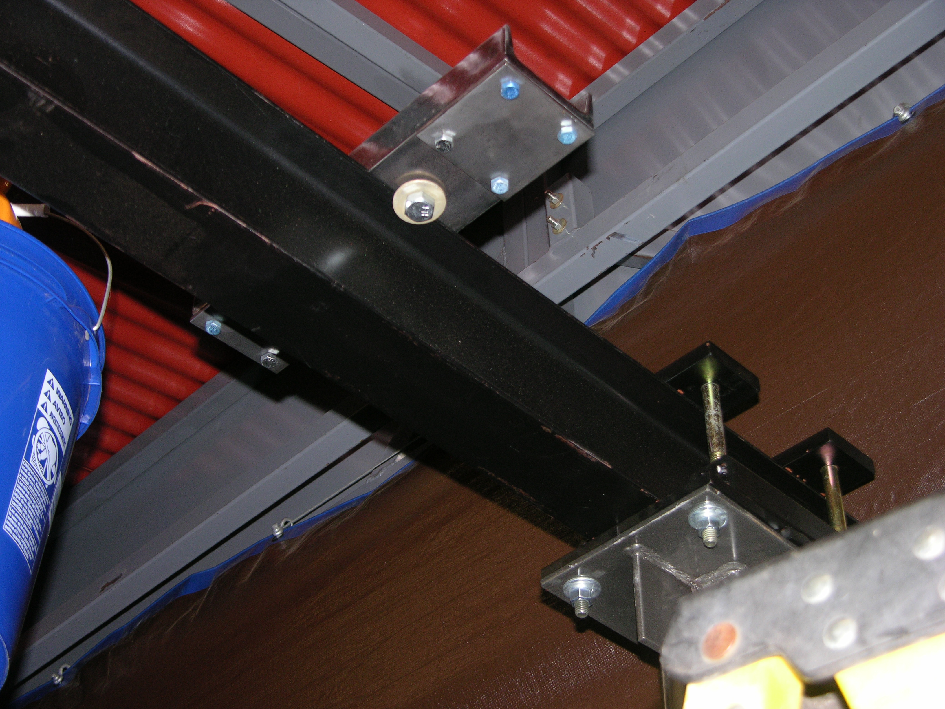

Got some more done on the HF crane mod today, these pieces will clamp crossways to the top flange of the bigger I beam - there will be another pair that're similar, that clamp across the INSIDE surface of the vertical posts - then each end will get 2 45 degree gussets (2" square tube" welded near the outer ends of the channel pieces, leaving a 10" wide gap BETWEEN the gussets so they don't restrict travel of the trolley/hoist -
In order that the braces can be removed or adjusted WITHOUT taking the legs clear off of the I beam (a royal PITA), the ones in the pics will get the angle tubes welded ONLY to those 4" square (BOLTED on) pieces of 1/4" flat bar - that way, the braces can get unbolted at those 4" square pieces, and that will leave everything ELSE on the INSIDE CORNER between post and beam so it can be adjusted OR removed.
I should get enough done in the next day or two so the pics will be self-explanatory... Steve

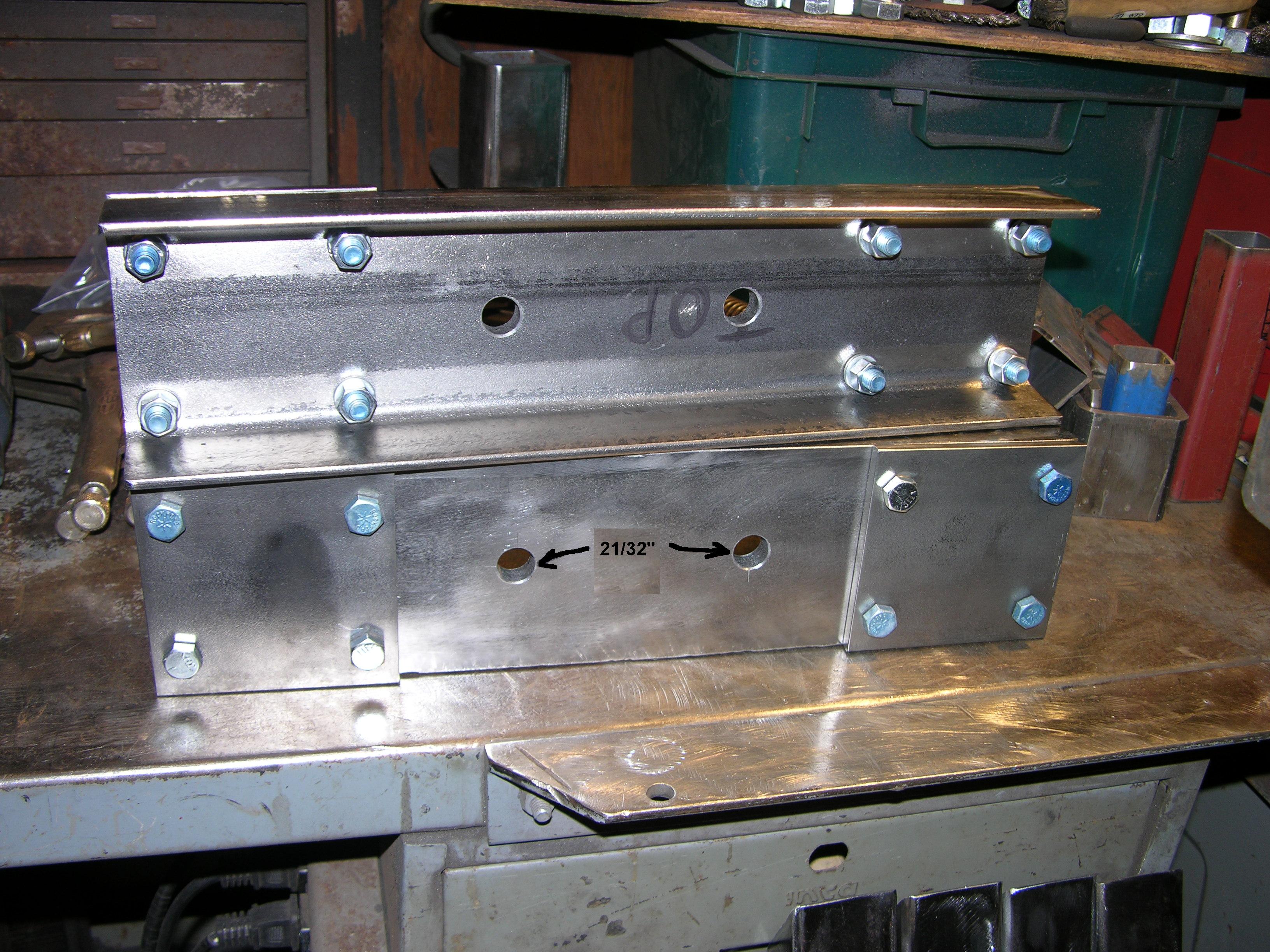

Sort of a "sneak preview", I got just enough done to see where the previous parts will go;
Left and right ends, from below -
Top view, from above the I beam -
One of the post-mounted spreaders drilled -
One of the diagonal tube gussets ALMOST in place -
the post mounted spreader (channel) will get notched out so the 45 deg. angle end can sit flat inside the channel, then everything will get fiddled with til the gaps go away :rolleyes: - then I'll tack everything (with all the spreader bolts tight), then take both braces down and weld 'em out using the "hopscotch" method :D combined with "kopius kwantitys of Klamps"...
But probably NOT today; still have the other post-mounted spreader to drill and chamfer, get all the spreaders square to their mounting locations (and aligned so everything fits), run a 240 extension cord out there, move the MM211 out there using "hand truck mode", wait for the dang wind to pause for a breath :rolleyes:
Still, it was nice being able to get an idea of how it'll go - those gusset tubes will be 10" apart inside, and the biggest hoist I'll be using on this crane is 8" wide - this design lets me get a long enough gusset to really solidify the post mounts WITHOUT having to give up a couple feet of travel on each end of the beam... Steve

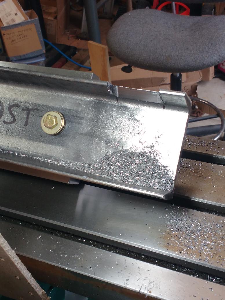

Discovered there was no decent way to cut the slots in one side of the C channel "spreaders" that I need in order to get those 45 degree tubes to sit flat on the INSIDE of the channel (necessary so the FLAT side of the channel can rest against the upright posts on the HF crane) -
The mill is still the "interloper" in the WOOD shop (where the ONLY 240 volt power is :confused:) so I re-arranged things (again) and set the mill up to cut those (45 degree bottom) slots with a 8mm, center-cut, solid carbide milling cutter - used my auxiliary angle table, set @ 45 degrees, bolted the channels thru their (already drilled for mounting) 2 holes, "eyeballed" to the edge of the mill table, locked down hard and "removed everything that did NOT look like a 45 degree slot" :laughing:
The setup -
Closer view -
Fit check (used a 45 degree cutoff, actual pieces are 30" long - dang, good thing I don't FEEL as old as my HANDS look :confused: )
Left the pieces down in the shop last nite, 100' walk in the rain and things rust too dang fast anyway - might get things at least partially tacked before I give up tonite... Steve
