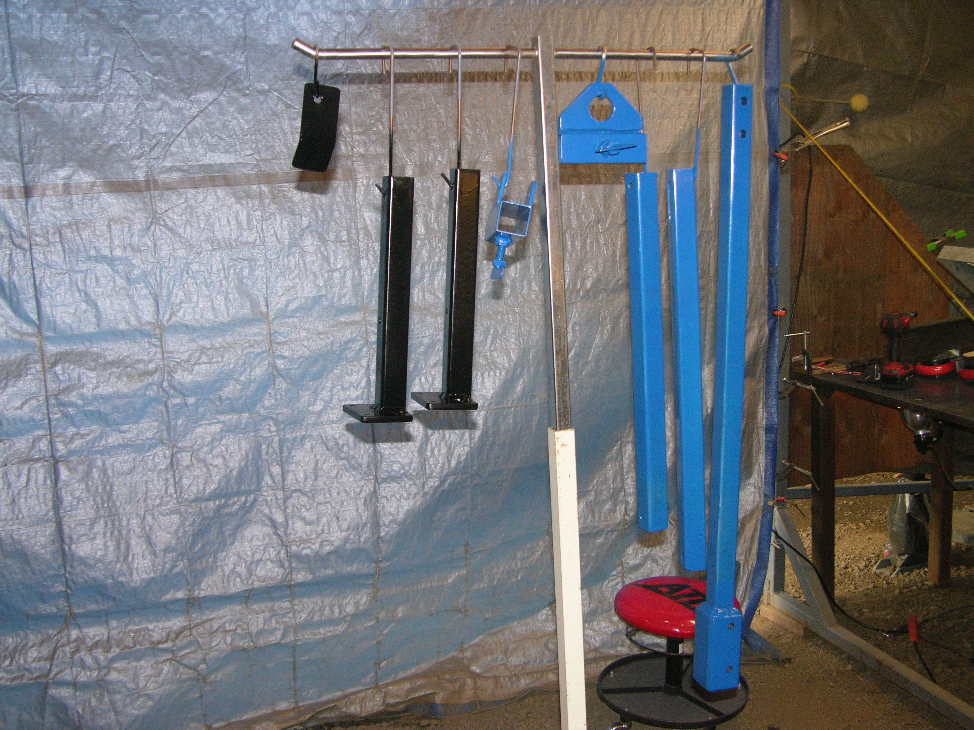

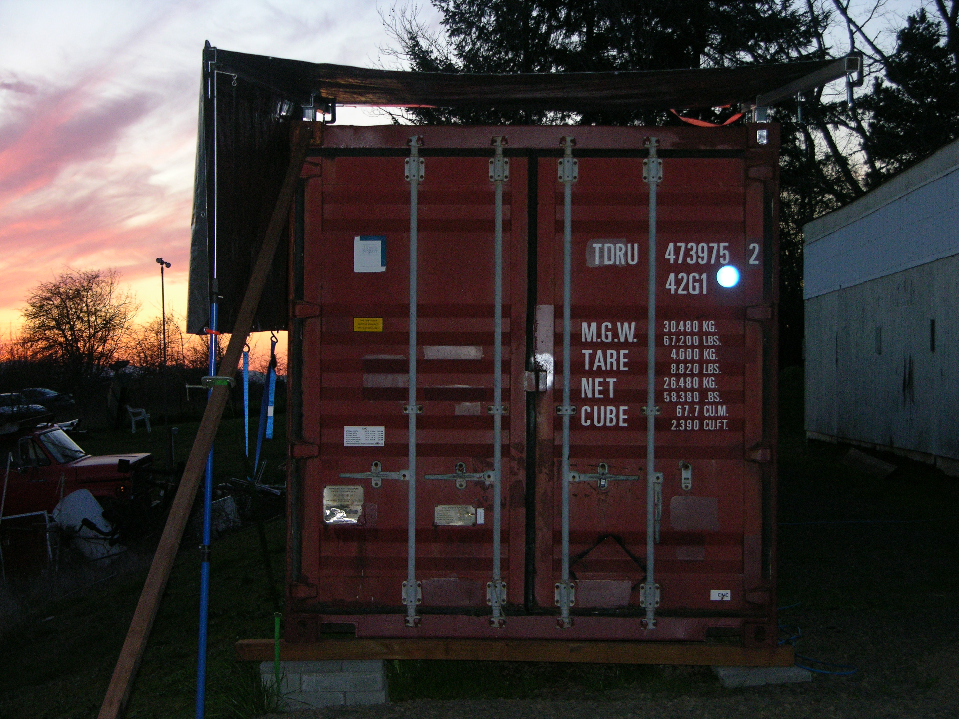

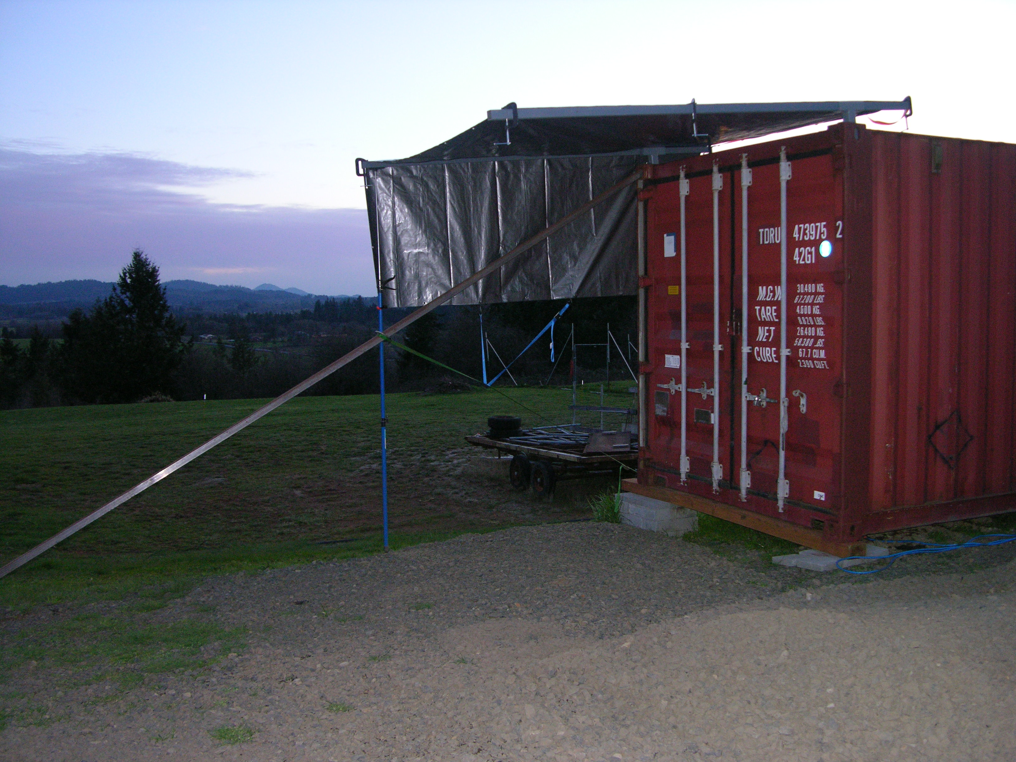

Got the pieces welded up for the "simpler/quicker/cheaper" version of the weld container's "porch roof" done, painted and the 9'x11' tarp clamped up; Guess which side the weather comes from :D - one less distraction on the way to actually doing what the title of this thread claimed eons ago - manana I can get back on the corner braces for the HF crane... Steve

'Sposed to get some SERIOUS "sideways rain" next couple days, guess I'll find out how well my "el cheapo porch roof" is gonna hold up - also opened up the box on that HF crane I'm doin' the mods for, wanted to make sure I wasn't making something that wouldn't fit ANYTHING :rolleyes: -

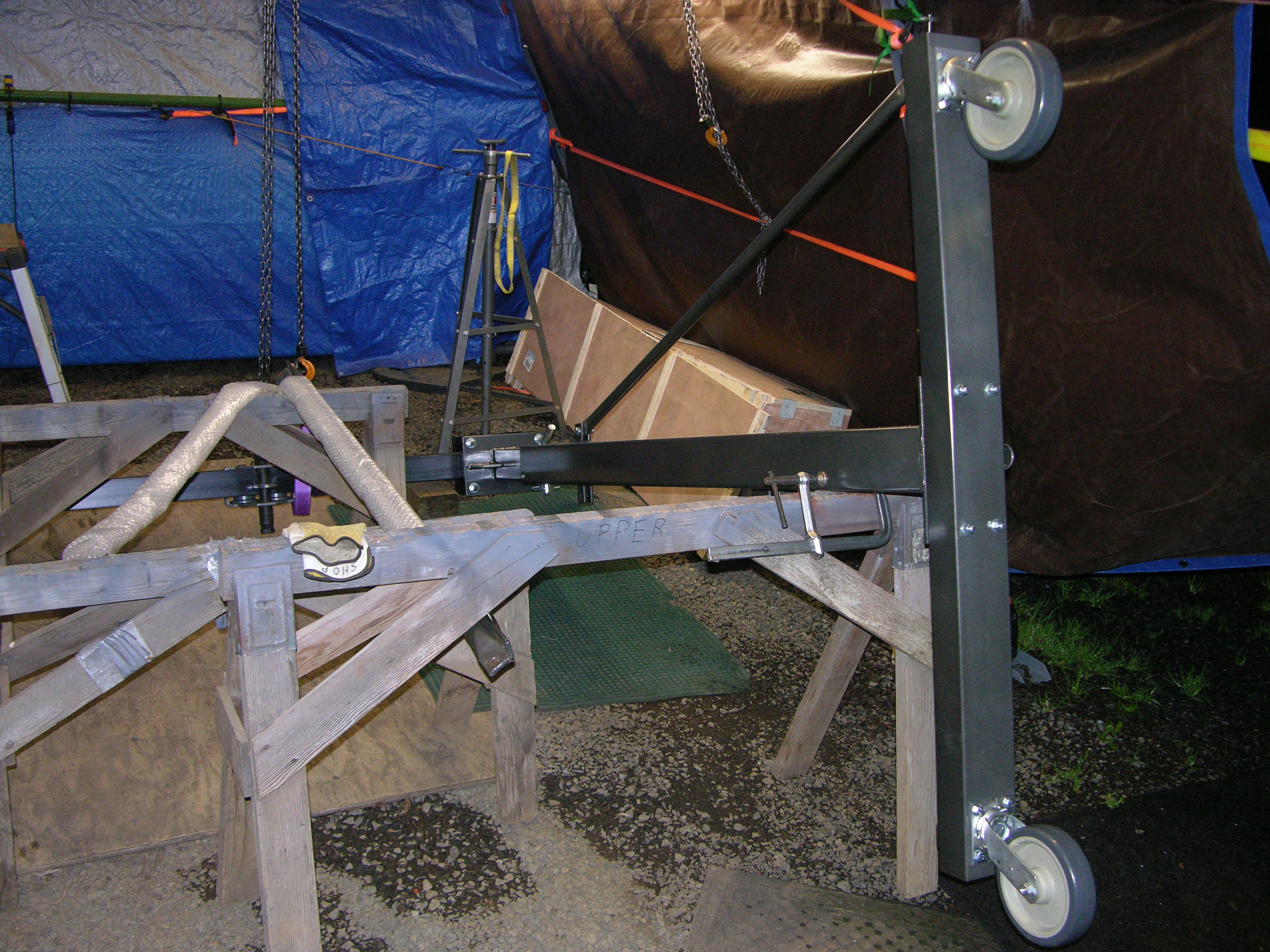

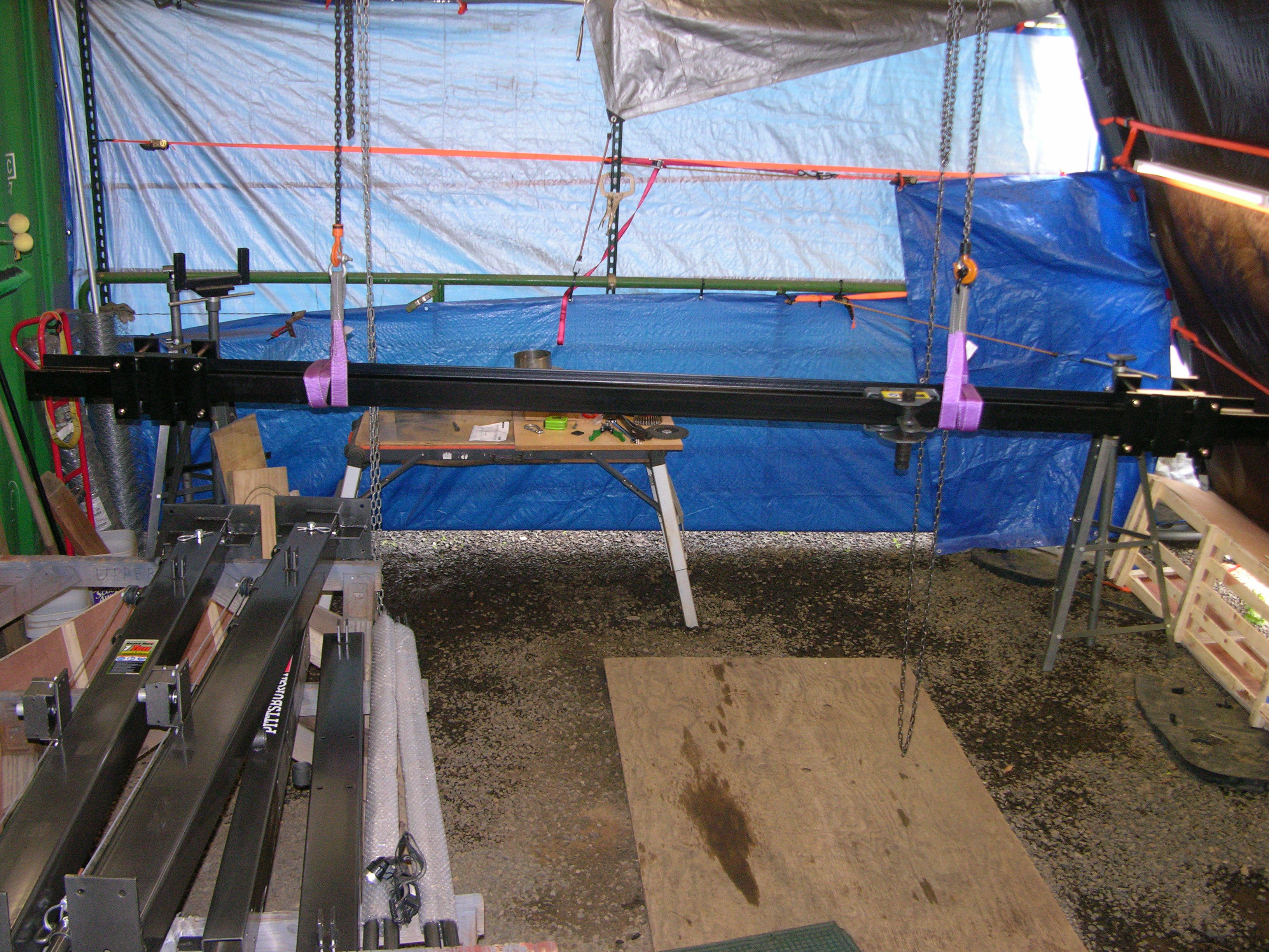

On the subject of the HF crane - There's been a breakout -
But they didn't get far before I had 'em all lined up -
I'm pretty sure they'll wanna "bolt", but there's matching gallows waitin' fer 'em...

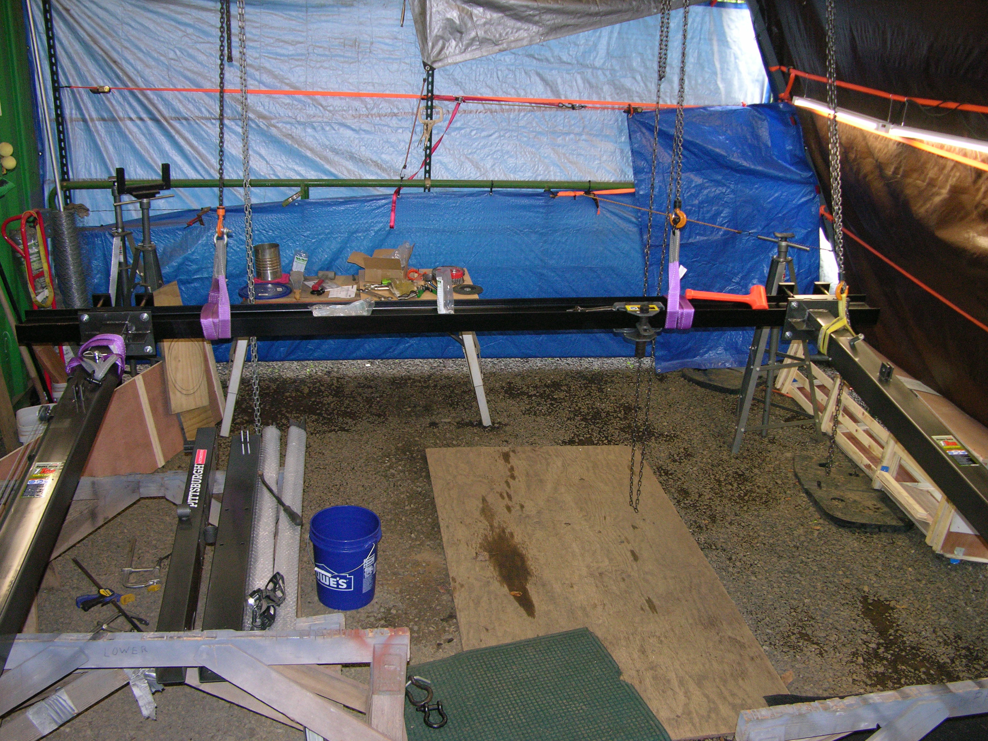

Probly gonna be a while; I'm kinda on a roll (no sesame seeds, tho :( - Been playin' with the HF gantry more today, you'll probly be in bed before I upload the pics. Instructions say to "use your helpers"... what few "helpers" I had are either still workin', dead, or moved to Mexico :rolleyes:
So it's a good thing I have my OWN "helpers", including several straps, shackles, 3 or 4 chain falls, blocks, sawhorses, etc... That's just the "teaser", but as the news liars say, "Pics at eleven" :laughing: ...Steve

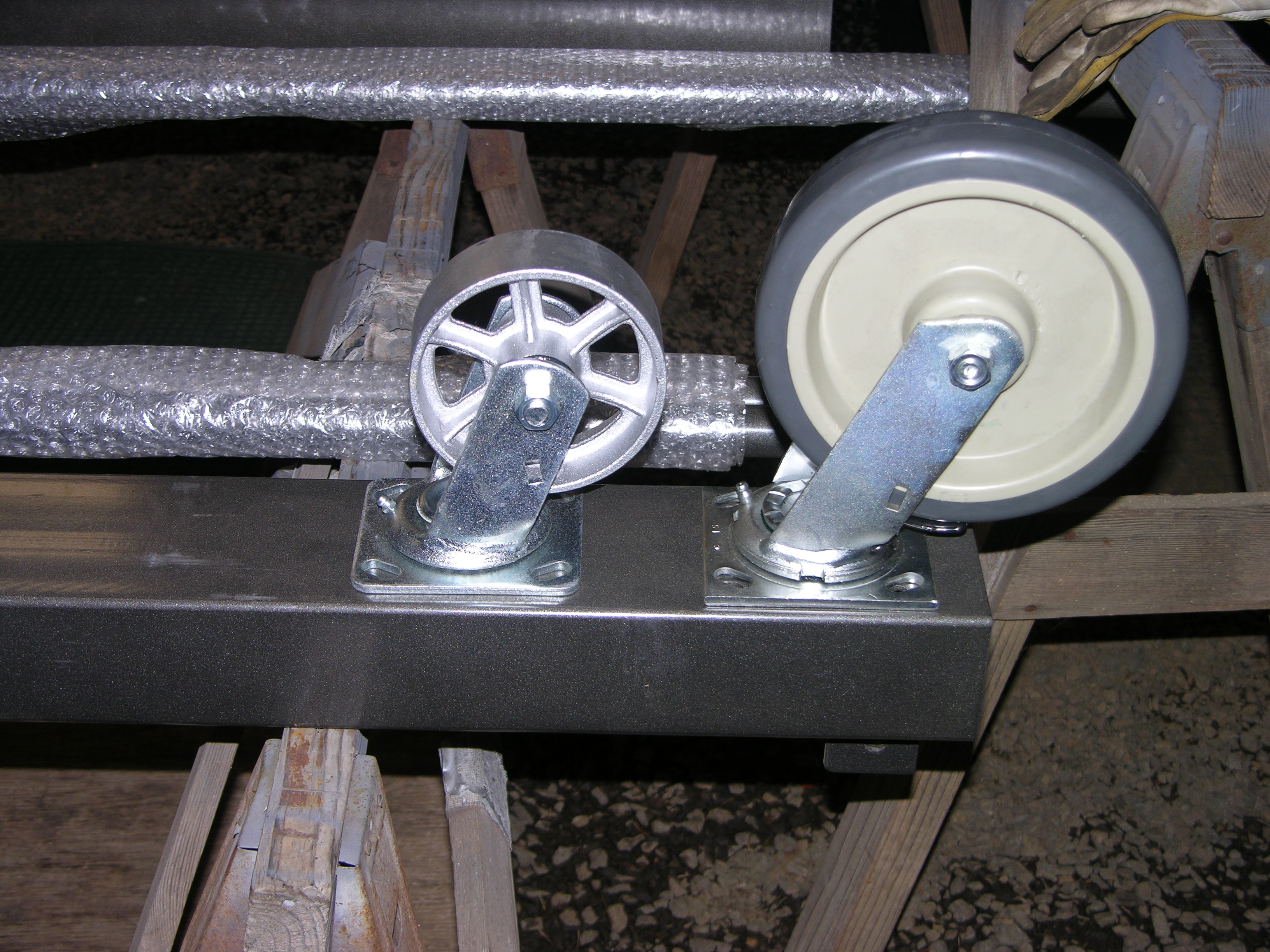

OK, so it's a little past eleven (here, anyway) - Oh well....

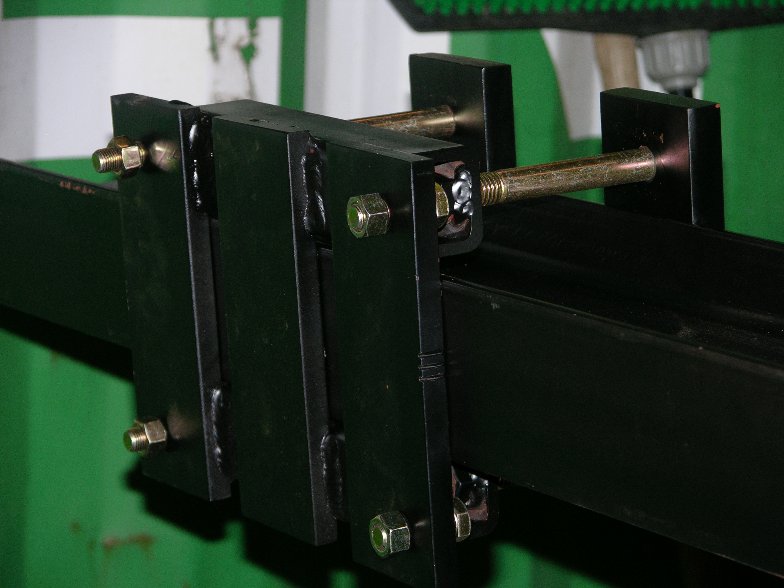

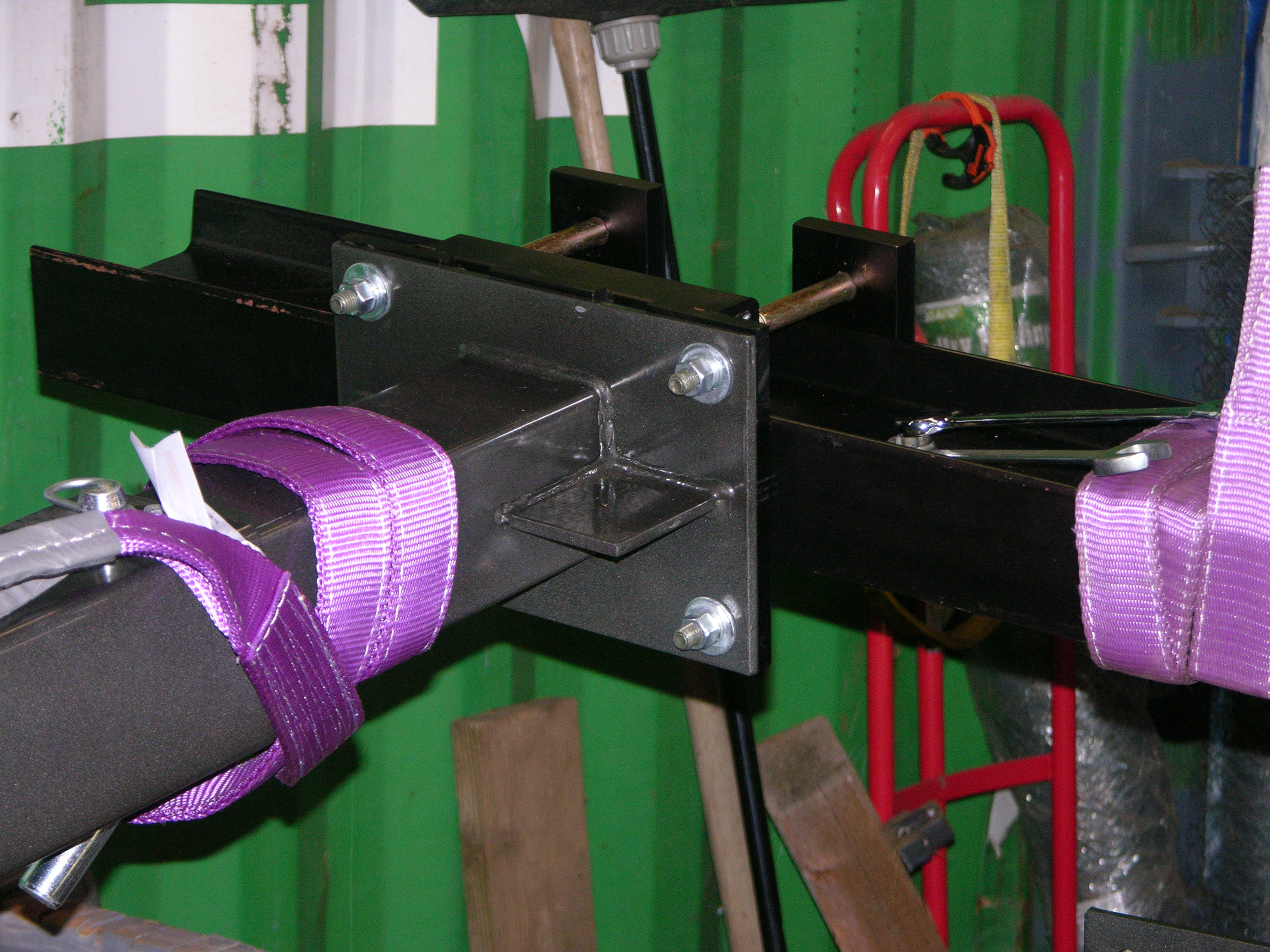

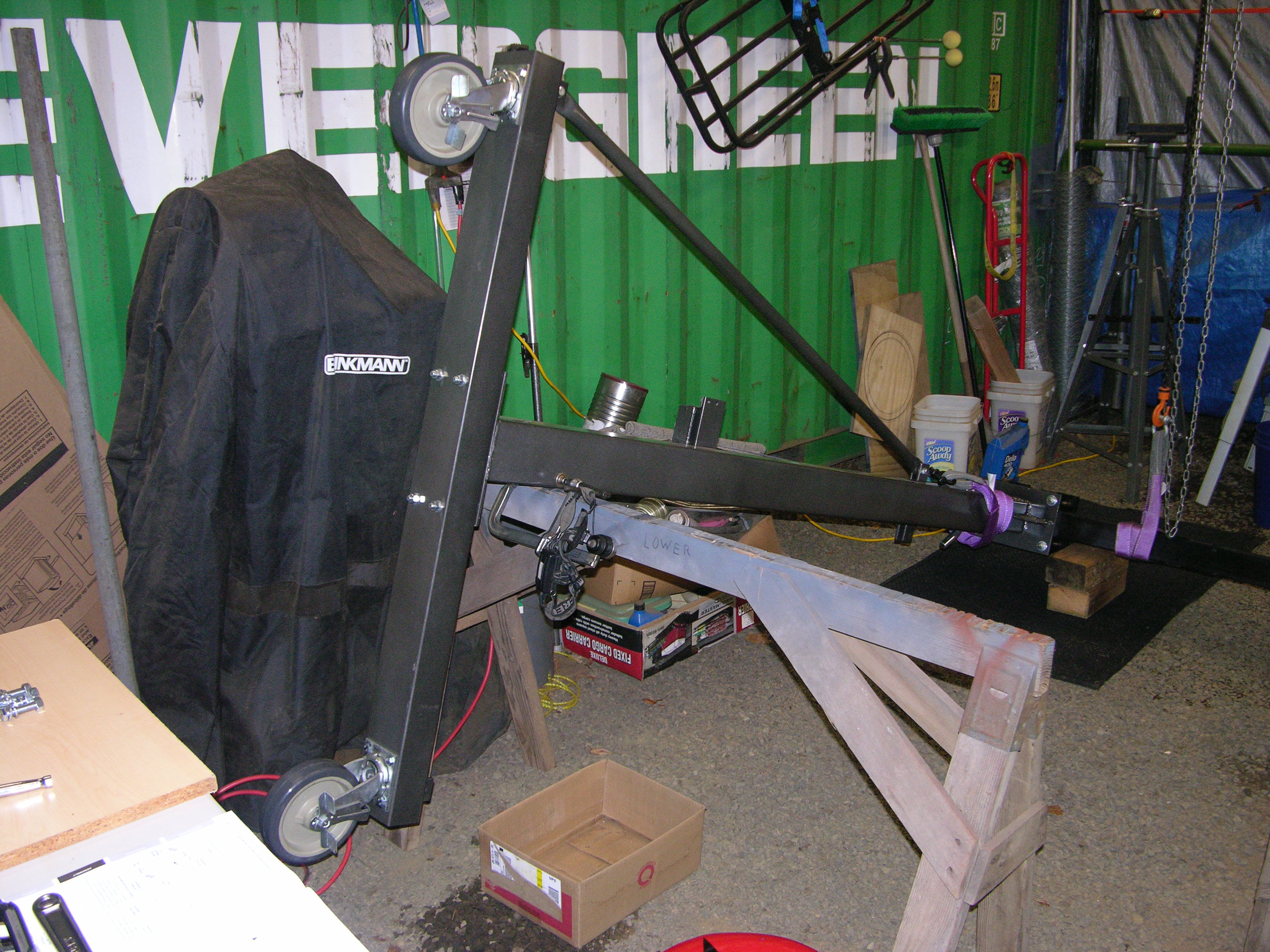

Here we go; first, the (upgraded) I beam, ready to attach the legs -
Then a closeup of the heavier post mount -

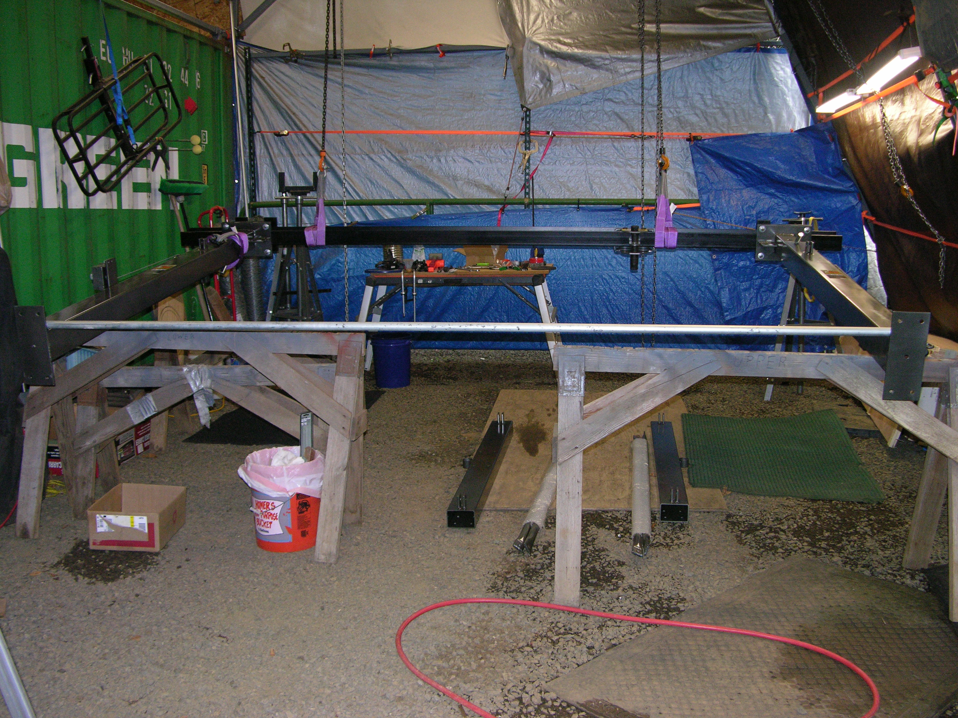

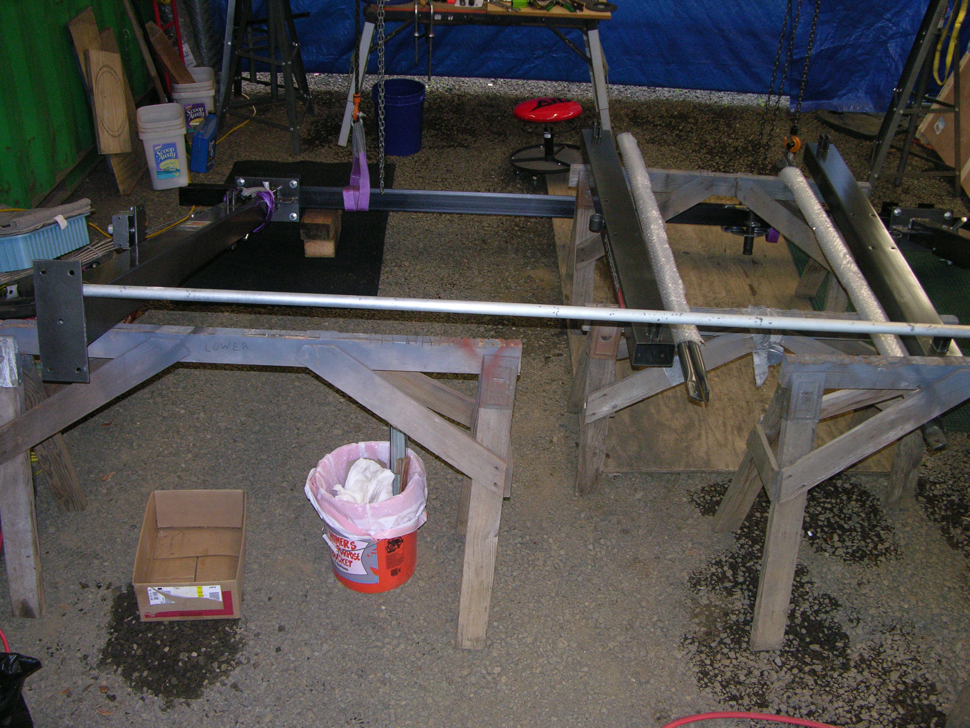

First and second posts attached -
Sometimes things need a friendly tap to get that last bolt to line up :D
A piece of conduit across the post bottoms, to make sure there's no twist -
Ready for feet -

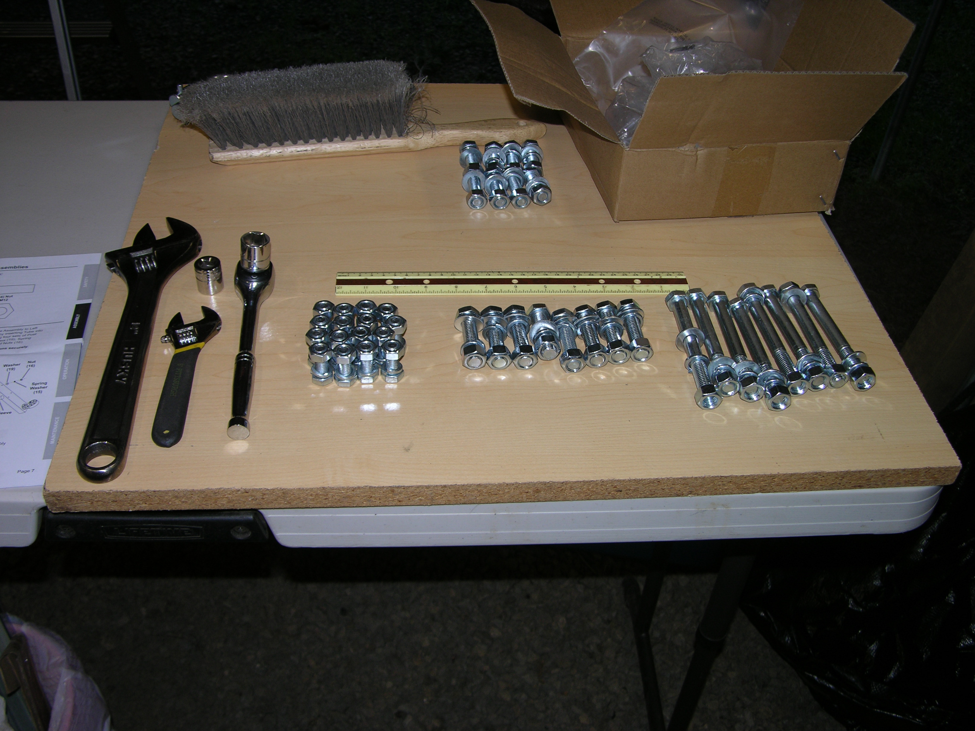

The hardware :rolleyes:

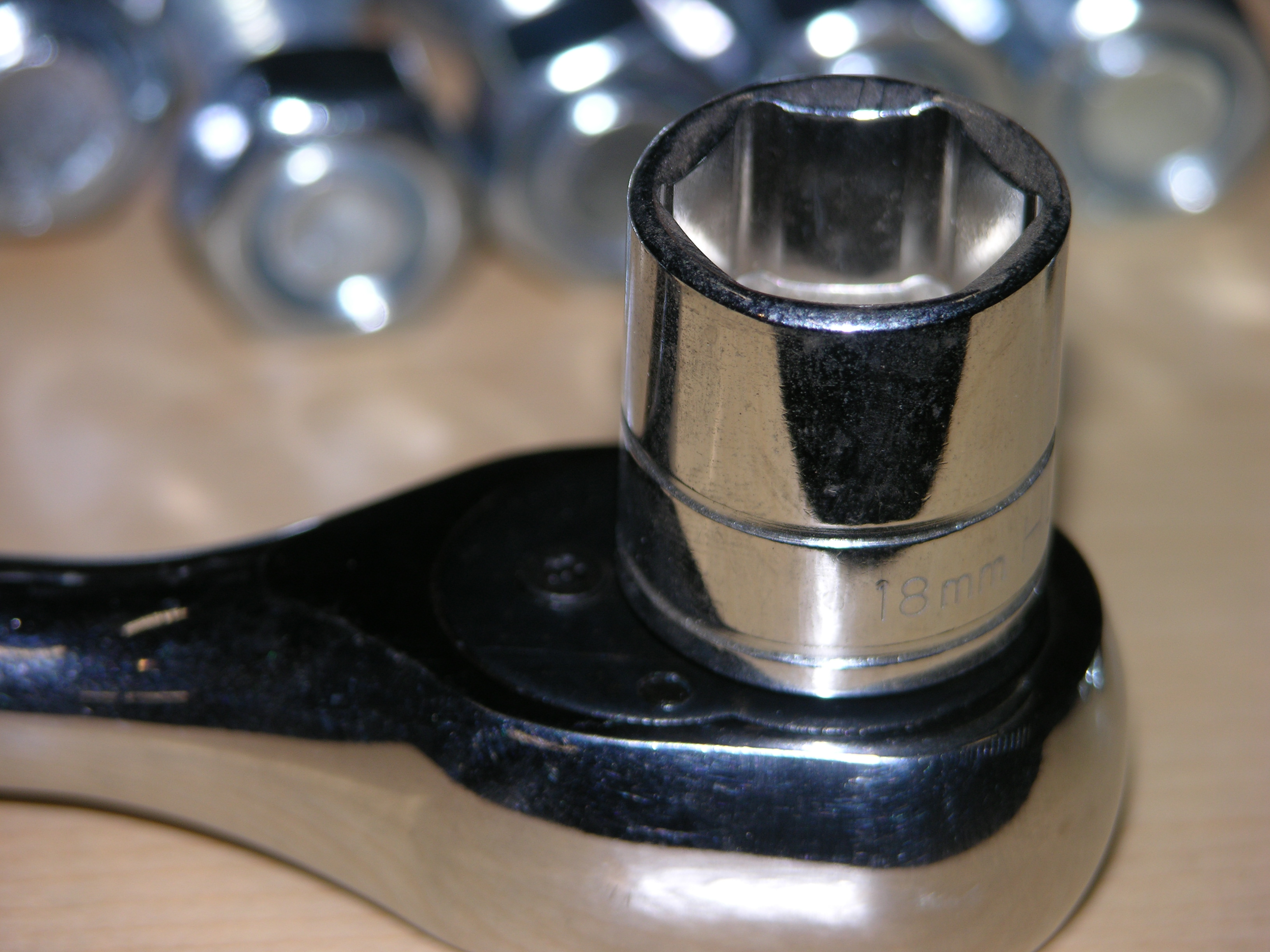

18mm bolt heads? Really??!? Smaller ones were 16mm, I actually found 1 socket in each size, had to break out the "metric fitzall" for the other end - :(
Got lucky on the 8" casters I ordered, bolt holes were a perfect match to the HF 5" that came with the crane - I ordered these from Surplus Center - 8" X 2" Colson Swivel Plate Caster w/ Wheel Brake 881SGS | Plate Casters | Casters | Wheels | www.surpluscenter.com - rated 1000 lbs each, should work better on gravel. Comparison -
Few more pics comin' up... Steve

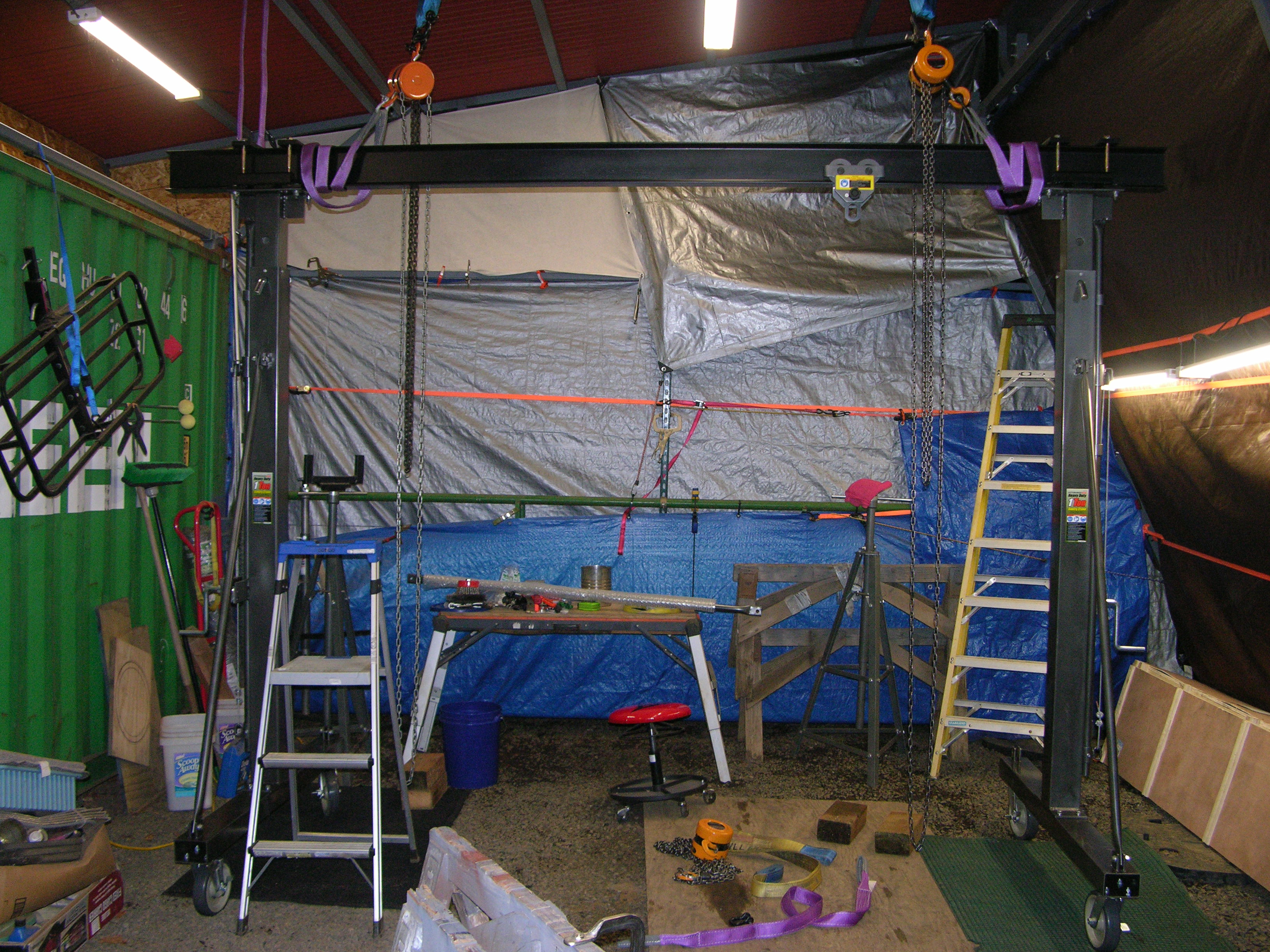

Here's the last batch; gettin' tired just remembering today :laughing:
First side ready to tip up -
The second side, ready to tip up -
And the "money shot" -
I actually added the other two diagonal braces AFTER tip up, they would've interfered with the sawhorses otherwise.
The new heavier beam is also longer, gives me 2 feet more between posts (needed for some of the operations I need to do on the 580B) - the casters raise things by 3", don't care 'cause even with the smaller ones it wouldn't go thru a normal garage door anyway - the area the crane's in now has 11' headroom and the crane will extend to 150" (AKA, 12'6" or 3,810mm ;) )overall, so my roof is the limiting factor in that area.
Next I'll get the corner braces done, then add the 1 ton electric hoist (more mods so THAT'll work like I want it to:rolleyes:
More "horizontal rain" forecast for manana, 'nuther good day for "shinifying" (Sorry, OP; no "golden disks" to play with, just the usual) :D ...Steve
/ Container Weld Shop build - #255
:thumbsup: :thumbsup: How is it rolling? Does it feel sturdy when moving?
#256
I've only moved it a couple feet so far, still want to get the post/beam diagonal braces on before doing too much (ounce of prevention; remember, it's HF's "heavy duty" :rolleyes:)
It does move on that "semi-loose" gravel, and feels solid enough, not sure how much of that is my heavier beam and "mil spec" post mounts; from what I'm seeing, if I were going to use it ANYWHERE but nice flat concrete the caster upgrade is a MUST - the ones I linked have zerks for both axle and swivel, bolt right up and are rated 1000# each...
The height adjustments are kinda hokey, I can see a pair of air/hydraulic shop crane jacks with "two-fer" fork lift type chain doublers replacing those if I need to change heights much -
All in all, it's about what I expected; my mods will make it usable for me, stock version would be OK for stuff that isn't too wide (and on smooth concrete) - and even with the mods, it was probably a month or so quicker than scratch-built (and about 500# LIGHTER :laughing: )... Steve
Oh, and they're RIGHT (in the manual) about having "helpers" - you can see mine in all the pics, and they don't run me out of beer; they are a bit slower, but EITHER kind of "helper" is MANDATORY for assembly, unless you're Arnold (AND schizoid so you can be 2 places at once :=)
Another "helper" option - if your FEL can lift at least 600# at least 9' high. Mine can, but would've required all my "blast doors" to be open and the driveway blocked in order to have enough room; NOT a good option with our "horizontal rain" the last couple days...

Nope, just a time/energy/money/weather shortage - when the weather gets dry enough that I'm not just makin' a gumbo mess, it'll get acquainted with my Gannon box - if you notice the pics that show the upright posts for that shed, they are NOT upright; they're splayed out 4 feet at the bottoms - I purposely put an extra "U-joint" in near the top, and adjustable "elephant feet" on the bottoms - the feet are staked into the ground with rebar for now (so they won't kick out, that'd be a BIG "owieee" -
That's all so I'll have enough room to cut that floor down (and take out the 6" slope from one end to the other) - It'll need to go down about a foot so the finished slab won't cut my headroom down below 11 feet. (backhoe knuckle joint height)
Once that slab's cured, those splayed out posts (and "elephant's feet") will get lagged to the concrete and be plumb - then all the tarps will get replaced with steel-framed sliding doors.
Anybody here NOT understand yet why I'm always sayin' I'm NEVER gonna get BORED??!? :laughing::D:laughing:
BTW, gravel beats the CRAP outa MUDDDD :thumbsup::thumbsup: ...Steve
