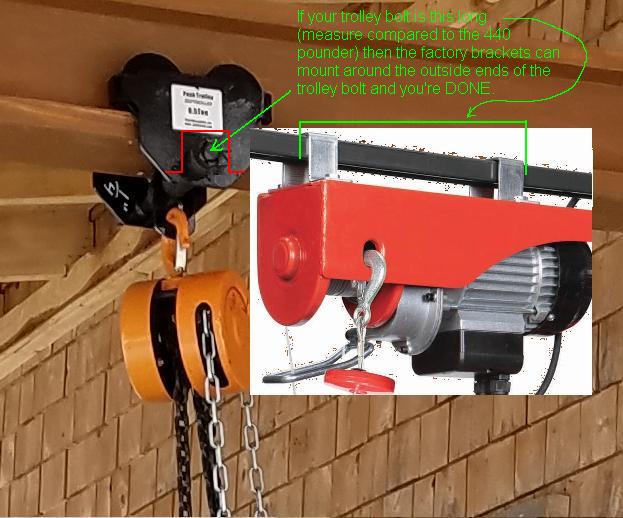

Oh, BTW - if you don't need the winch as close as it can be to the beam, a MUCH simpler way is just find a piece of square tube that'll fit into those factory brackets - then weld a piece of FB to one side of the tubing with a big hole for your trolley bolt, (look at the PINK part in pic3, replace the big pink bar with tube) and you can slide the whole thing around in those brackets til you like the balance...

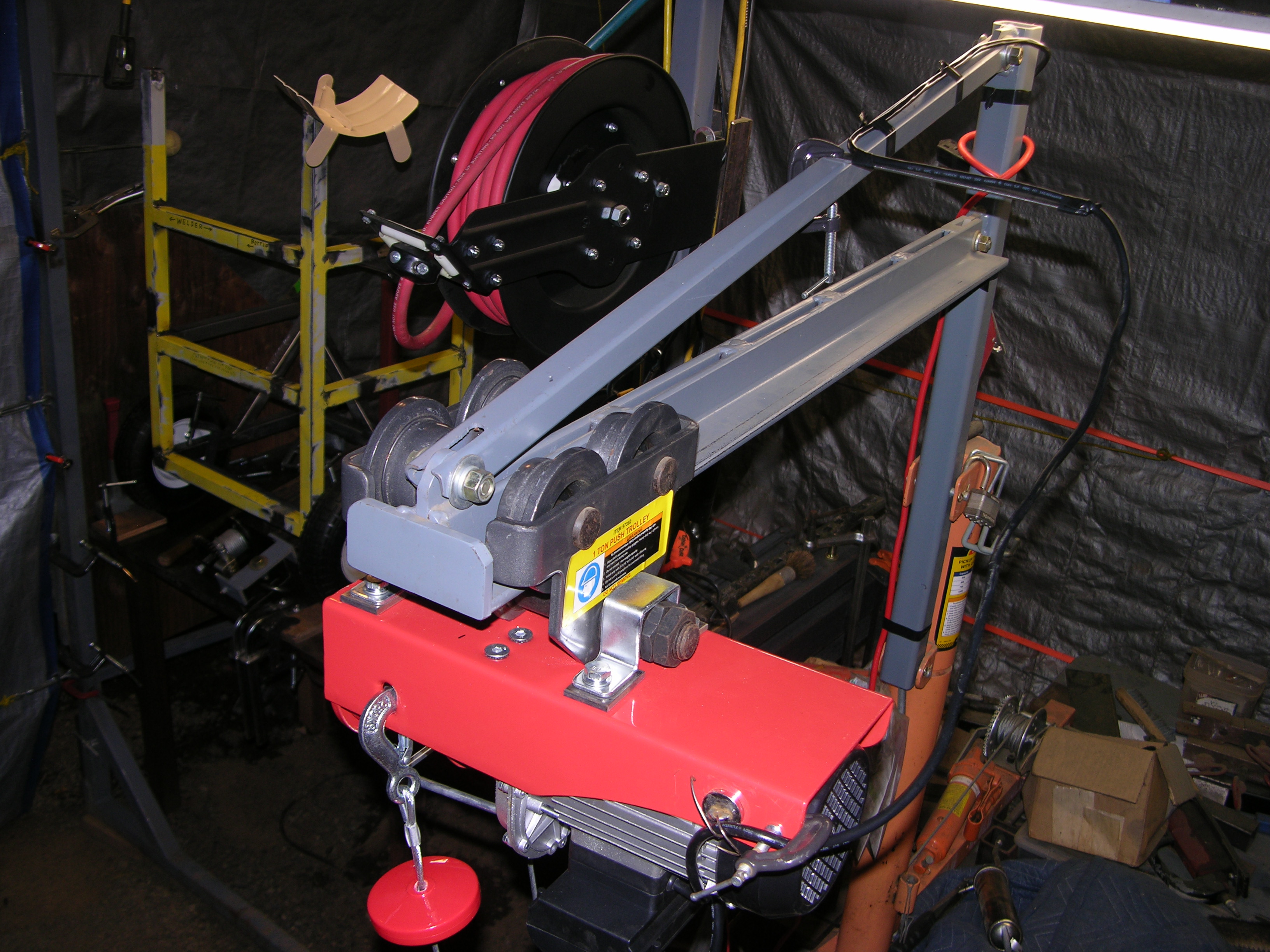

Here's part of your jib pic, with the small winch set next to your chain fall - close as I could tell I got 'em to the same scale, and if you went with my sketch and replaced the "dongle" your winch is hangin' on right now, looks like they'd come out about even for height.
"25 lb isn't that on the heavy-ish side?" - Nope, I just weighed one of my chain falls (same one as yours) - and it weighed just under 25 lbs INCLUDING the 5 gallon plastic bucket it's in, so basically NO CHANGE in weight between the two - if anything, the electric should weigh LESS, since that 25 lbs is SHIPPING weight... Steve

Doing a little movie magic, clever, but shouldn't that winch go transverse so's not to loose travel motion, distance, length, movement?
Here's an updated picture I took this past weekend, I have the chainfalls bottomed out and at times it's just barely high enough. The biggest problem I have with these chainfalls if the the up&down chain only works good when its perfectly around the bundle which at most times is hard to maintain so when the chain is off to the side it jams up and that's when aggravation steps in. That's why if had electric winch there'd be no more Hoover jam, theridicly, but then, seems like there's always a but, I wonder what about the electric cable, will that get tangled up in the trolley, I just dont want to move aggravation from one place to the next, I want it out of here and go bother people on the west coast where they have more patience, know what I mean Vern..........

"shouldn't that winch go transverse so's not to loose travel motion, distance, length, movement?"
It could, but that can cause balance problems - with NO load, the motor is heavier than the cable spool - so if you hang the winch so THAT works, when you hang a LOAD on it that UN-balances the load on the trolley. If you remember the pics of my "mini-jib", I have that problem - somebody on a different site posted a "fix", which I shamelessly "borrowed" -
I haven't DONE that yet, and I'm not sure there's ROOM on YOUR wood beam - I just looked at one of my trolleys, and if you drilled holes for the bearings just below where the side plates angle inward it should work (on YOURS) to keep the trolley from tilting.
Next problem - I do NOT know what the measurements are on those 440 winches, but the 1100 lb one on my "mini-jib" actually HANGS from the long "spacer bolt" on the trolley, using those 2 brackets shown on the factory picture - if the 440 winch is SHORTER, that might not work - you'd probably need to actually TOUCH one of the small ones (dunno how close your nearest HF store is) - if that'd work for you, you should measure the total length of your trolley's big fat bolt fulla washers - here's what I mean (zoom in on that pic, I marked it up)-
"Here's an updated picture I took this past weekend, I have the chainfalls bottomed out and at times it's just barely high enough."
If necessary, it looks like you could maybe raise your jib a few inches fairly simple (easy for ME to say if YOU'RE the one doin' it :rolleyes:
"The biggest problem I have with these chainfalls if the the up&down chain only works good when its perfectly around the bundle which at most times is hard to maintain so when the chain is off to the side it jams up and that's when aggravation steps in."
Yeah, they are a PITA for that; I tend to hold BOTH of the pull chains in one hand, keep tension on 'em and stand to the side a bit and pull one while letting the OTHER one slip thru my glove - still, irritating...
"That's why if had electric winch there'd be no more Hoover jam, theridicly, but then, seems like there's always a but, I wonder what about the electric cable, will that get tangled up in the trolley, I just dont want to move aggravation from one place to the next"
Right; the whole idea of changing things is to ELIMINATE PITA's, not ADD MORE - Here's what I did on the "mini-jib", but it's only 4 feet long; you might need "outriggers" on BOTH ends of the electric cords - it's also how I mounted the 1100 lb winch, but the 440 might be a different distance between mounts - if so, you'd need to fab something similar to my sketches instead - notice that the cords fall BELOW the trolley...
Personally, I'd rather figger out a way to hold a cord out of the way than put up with those chains, specially the way YOU'RE havin' to do it...

Just got back from town, stopped at HF store and measured their 440# winch - the factory "U" brackets and their threaded holes will bolt right onto the fat spacer bolt on their 1 ton trolley - and your trolley looks to be identical, so THAT part should be easy - wiring too, I would just run the winch to the outer end of the beam, fasten any kind of "outrigger" maybe 14" long to the support strut halfway along the beam, and maybe add one to the winch itself to be sure - then the POWER cord would go up the support strut and down the wall, and the control pendant can just hang down. You'd probably need a short extension cord for the power, it's about the length of your BEAM but not long enough to go wherever your power plug would be... Steve

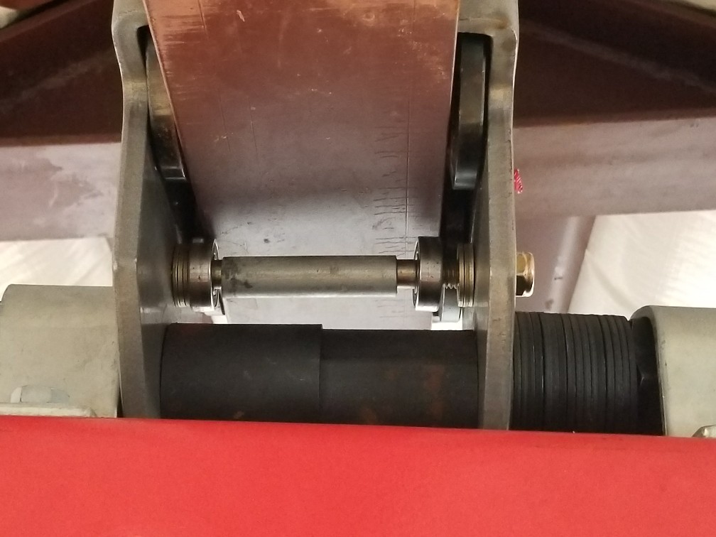

I gave up tryin' to figger THAT part out for the 1 ton version I'll be doing, so I just planned on TWO trolleys - one centered over each pair of mounting holes on the hoist - that way there'll be a trolley supporting the cable spool, and one for the motor. (That 1 tonner is a LOT bigger than the 440# one, right at TWICE as long AND TWICE as wide, plus instead of maybe 23 lbs it's more like 75...
"And did you stick a bering under your trolley yet? "
Nope, haven't got around to ordering the right bearings, etc -
"like in one of the pictures you posted, if not how is your hoist staying level if the motor part is heavier?"
It's NOT staying level; at least, not ALWAYS - I haven't been using the jib a lot lately, other fish to fry. And it doesn't tilt when there's a load on, so hasn't been quite irritating enough for me to push that to the top of the list - PLUS, my jib is just low enough I can reach up and push the hoist around by the motor, so that helps :rolleyes:

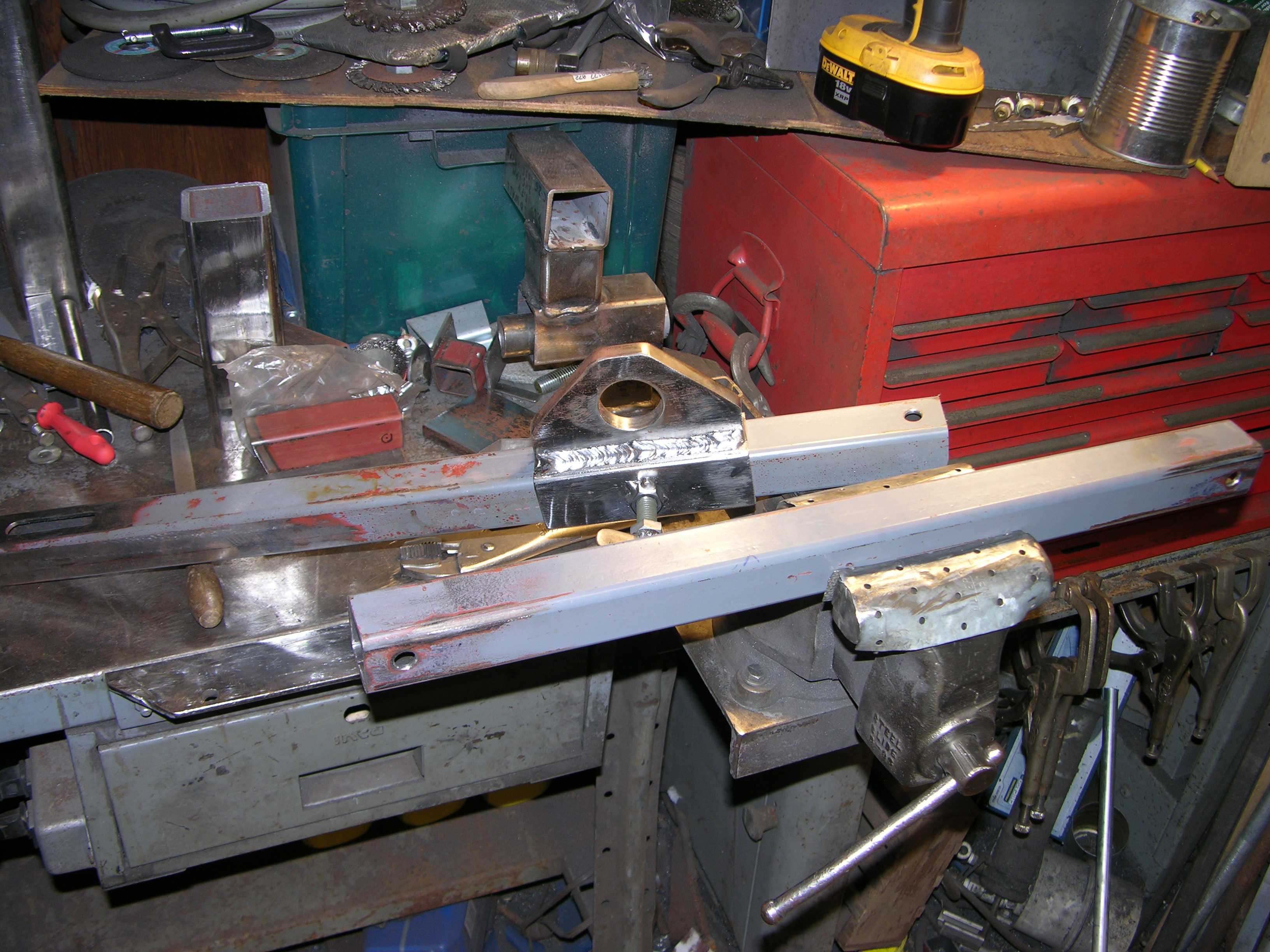

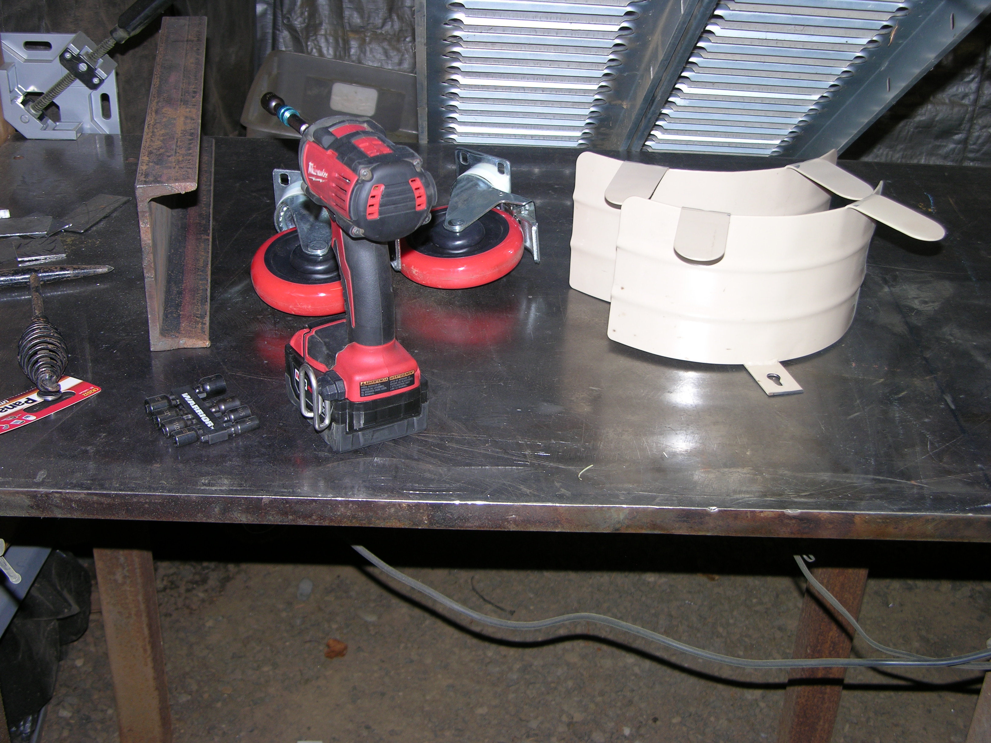

Got most of the parts cut today for the post braces on the HF crane - still need to cut 4 pieces of 2" x 1/8" wall tubing for the diagonals, they'll be 31" point to point, both ends cut 45*. Here's what I got done today, got some more prep to do on most of 'em -
This batch is for the crane braces, all just out of the saw. I'll need to notch 2 of the channel pieces to clear the diagonal square tubes, other ends will come in on the FLAT side -
And these are most of the NEW "porch roof" plan - decided against doing a full-fledged roof frame out of 2" tubing, so these will each get a 10' piece of tubing slid thru the shiny pieces (they're actual .030" over RECEIVER tubing) - then I'll just strap a 9x11 tarp over the long tubing pieces and it'll hang over the doors of the container by about 7 feet. One less "permanent" project for a "temporary" condition :thumbsup:
Guess tomorrow (and probably the next day or two after) will be clean up/weld up/put up time (for the "porch roof", that is - the braces will likely take longer... Steve

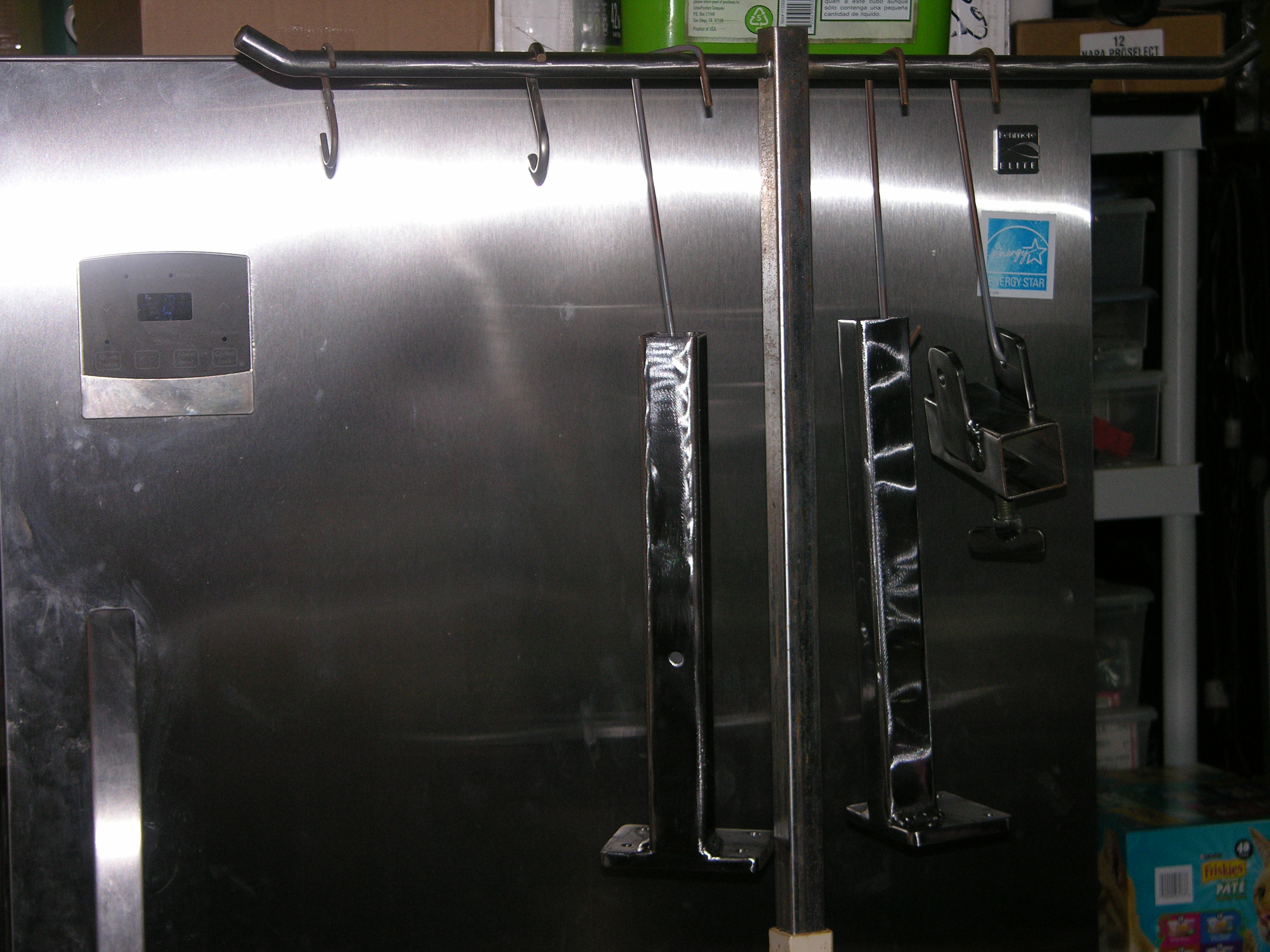

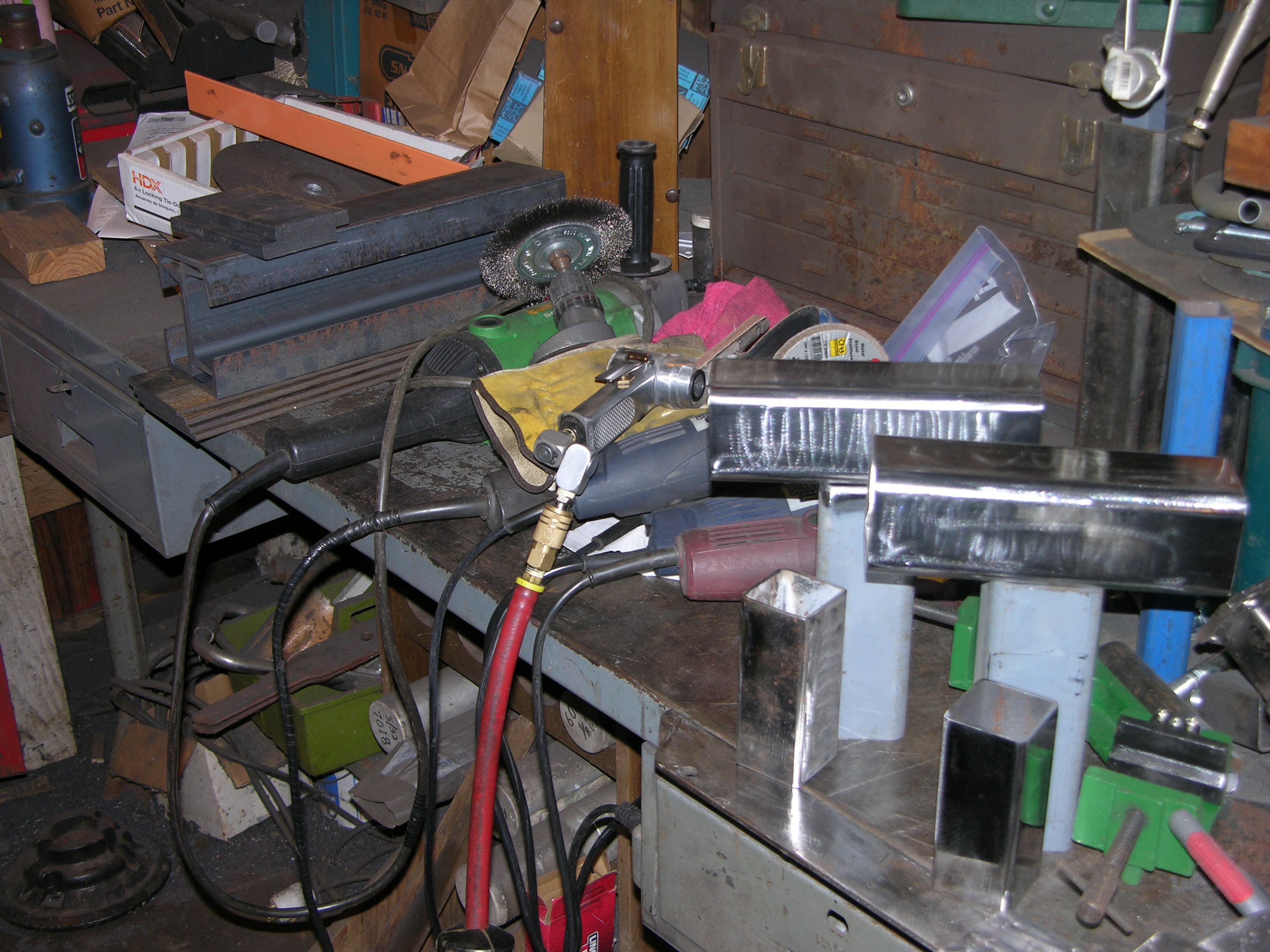

You're welcome Mark - you probably caught the visual proof (first pic in that last post) of my belief in the old adage, "A clean desk is a sign of a sick mind" - :laughing: ...Steve

I gotta say I never seen anyone shine up steel for home projects like you do, show me your favorite shiney steel making tool.
/ Container Weld Shop build -
#240

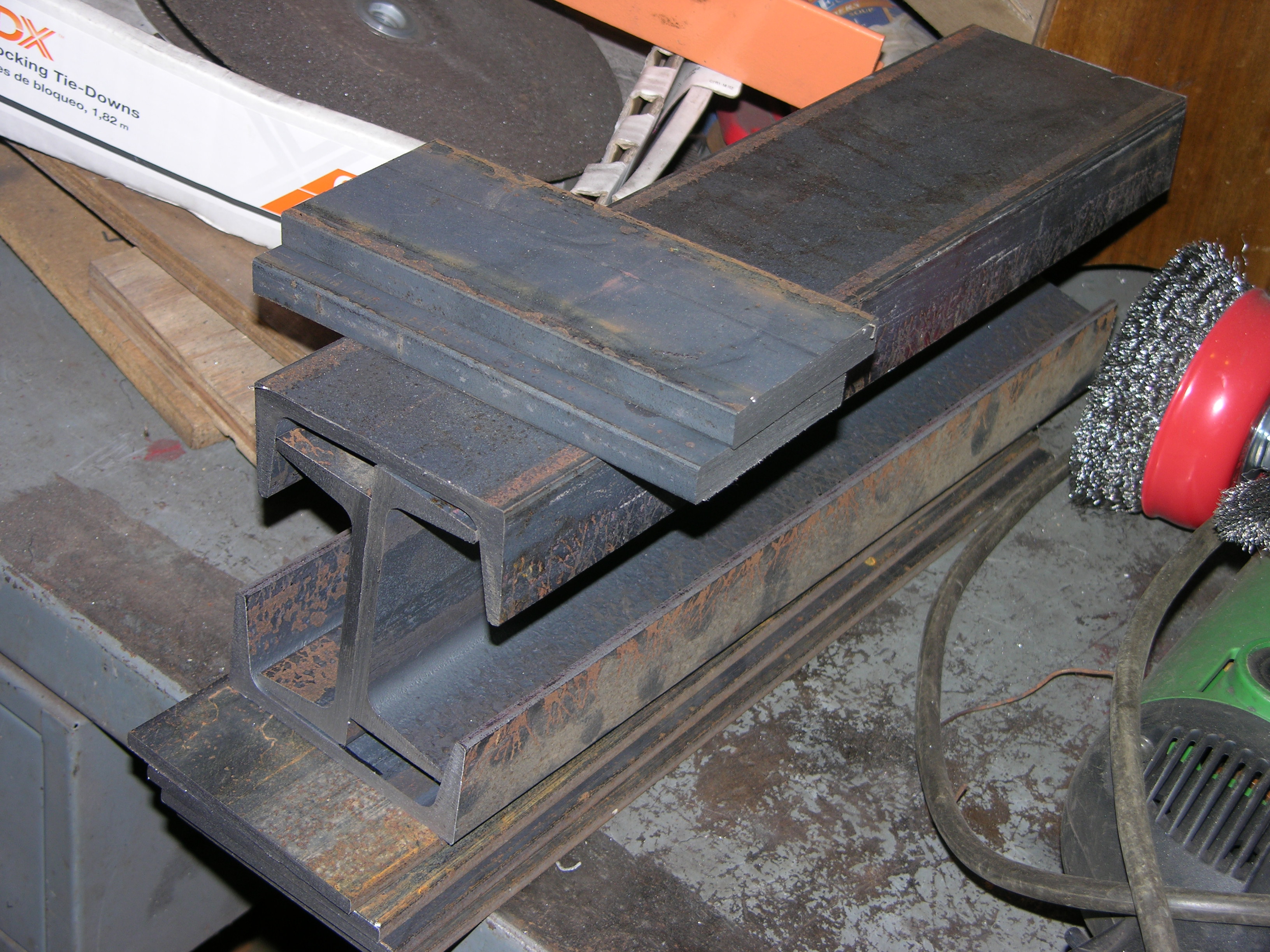

Most of the time I use a Walter zip disk (light touch, constant movement, about a 45* angle) if there's mill scale - then smooth it out with a CGW 40 grit flap disk (same method as the zip disk, only almost flat) - a NEW 40 grit is a little aggressive, so I use NEW ones for bevels, etc, til they "mellow out" a bit, then I use them for the "final shiney" part -
If a part has sat long enough to start a light rust coat before I get around to finishing the job, I have an old B&D "professional" high speed corded drill (came as a 1/4", I put a 3/8 keyless chuck on it) - it runs 4000 rpm, usually keep a 6" wire wheel on it and use it to get REALLY light rust off and add a bit of "tooth" before painting.
There's so much rain and humidity here a lot of the year, if I DON'T do that EVERYTHING is the SAME COLOR (reddish brown) and has its own "non-skid" finish :rolleyes:
My favorite "bb blaster", for FLAT surfaces anyway, is an air hammer with a wide flat chisel, kept pretty sharp - you can just PUSH it along (low angle) til it stops on a more stubborn "bb", then just touch the trigger. That also works really good on the light slag after plasma cuts.
Small needle scaler for corners, fillets, etc...
