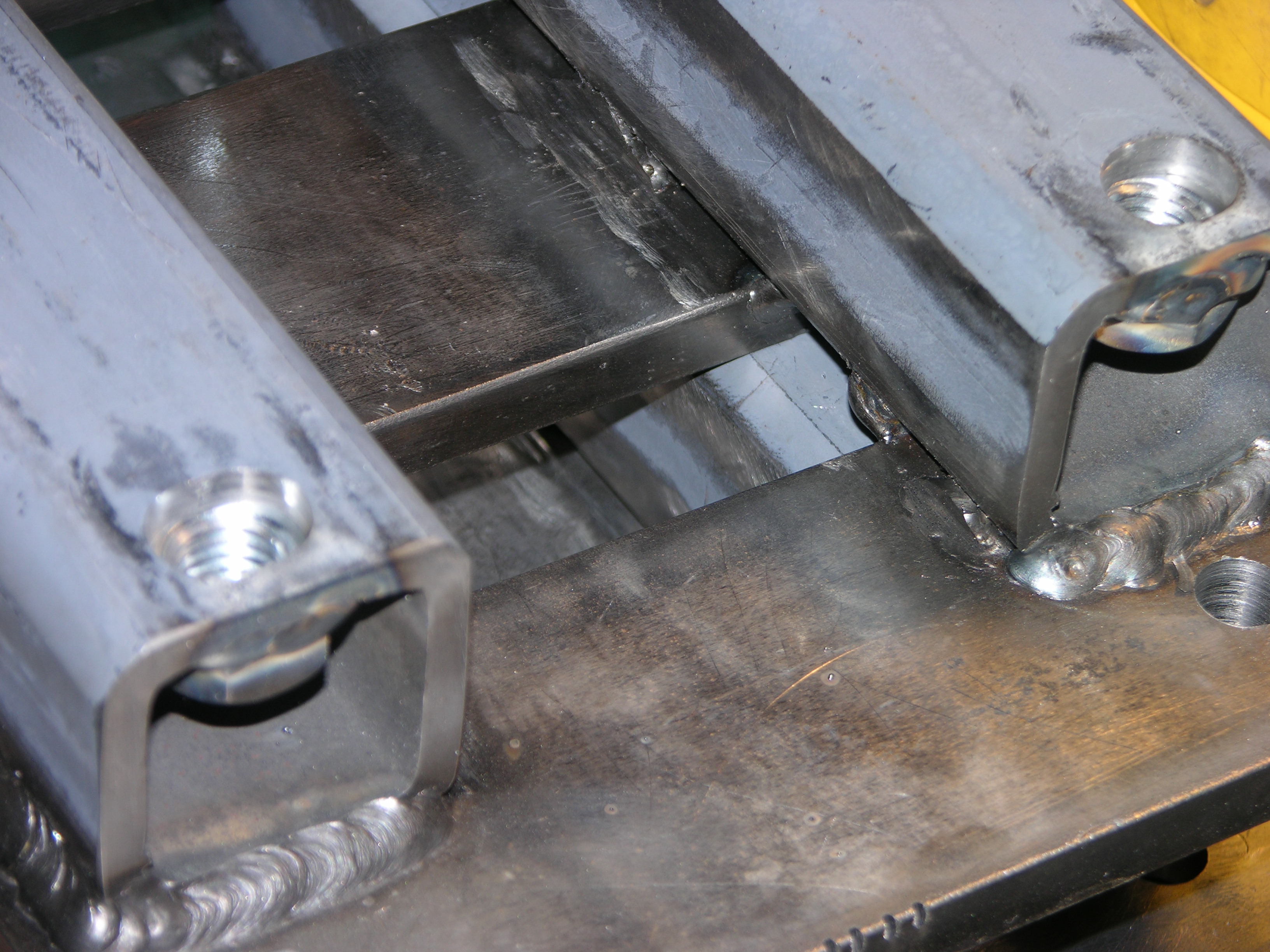

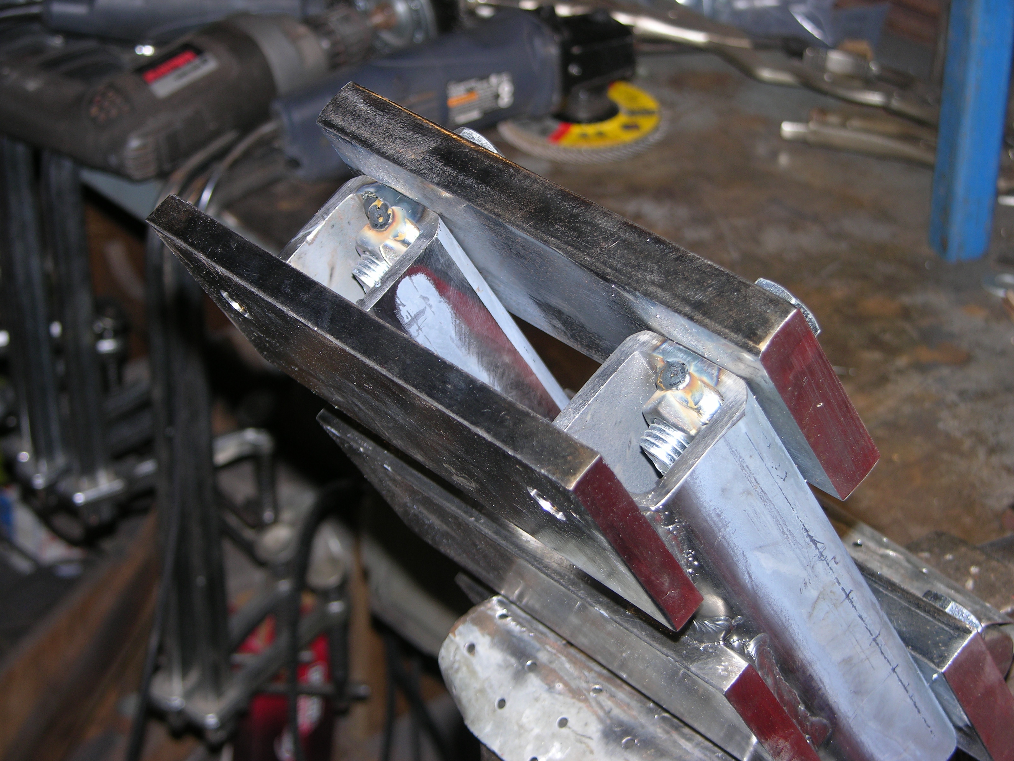

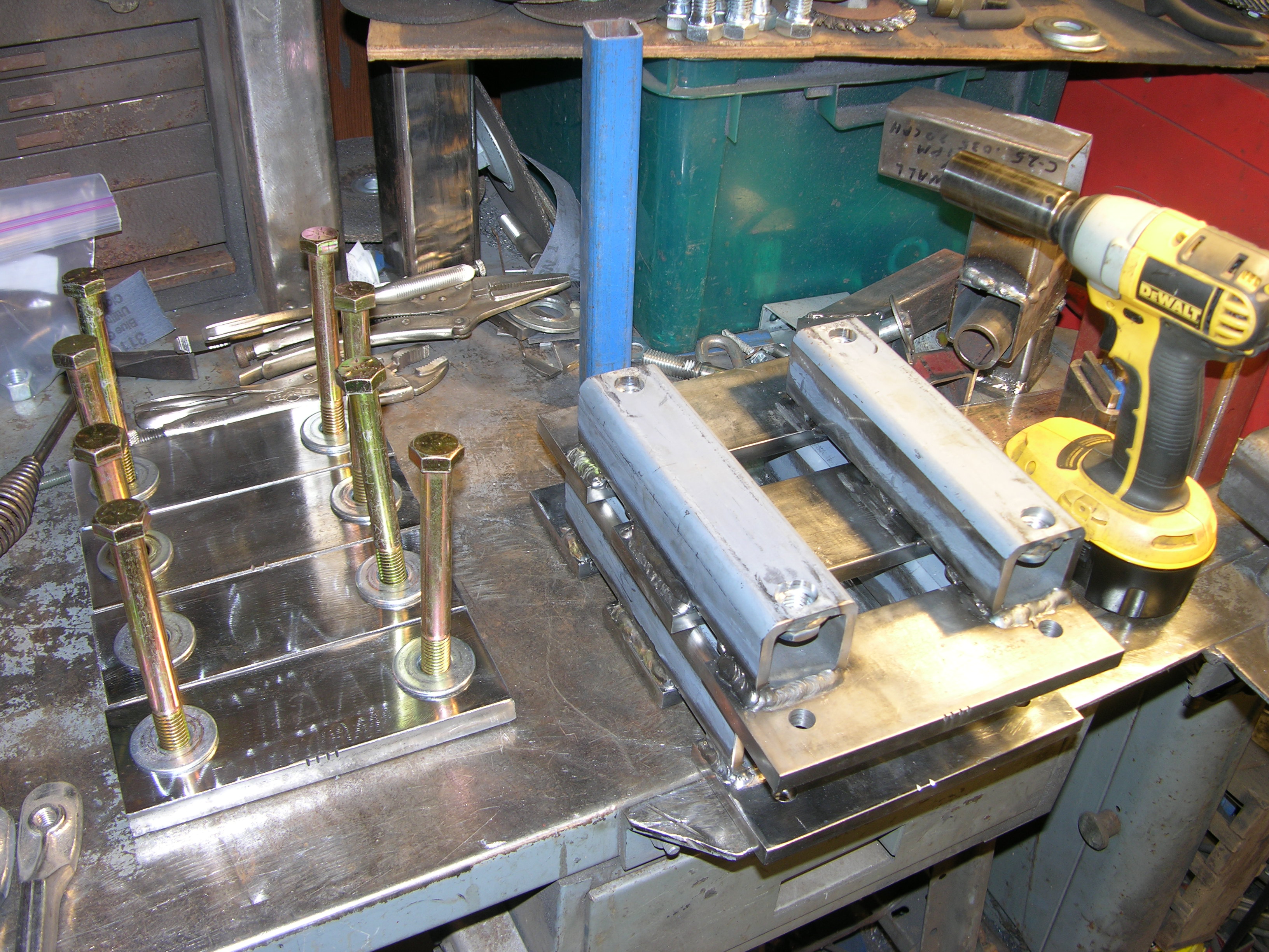

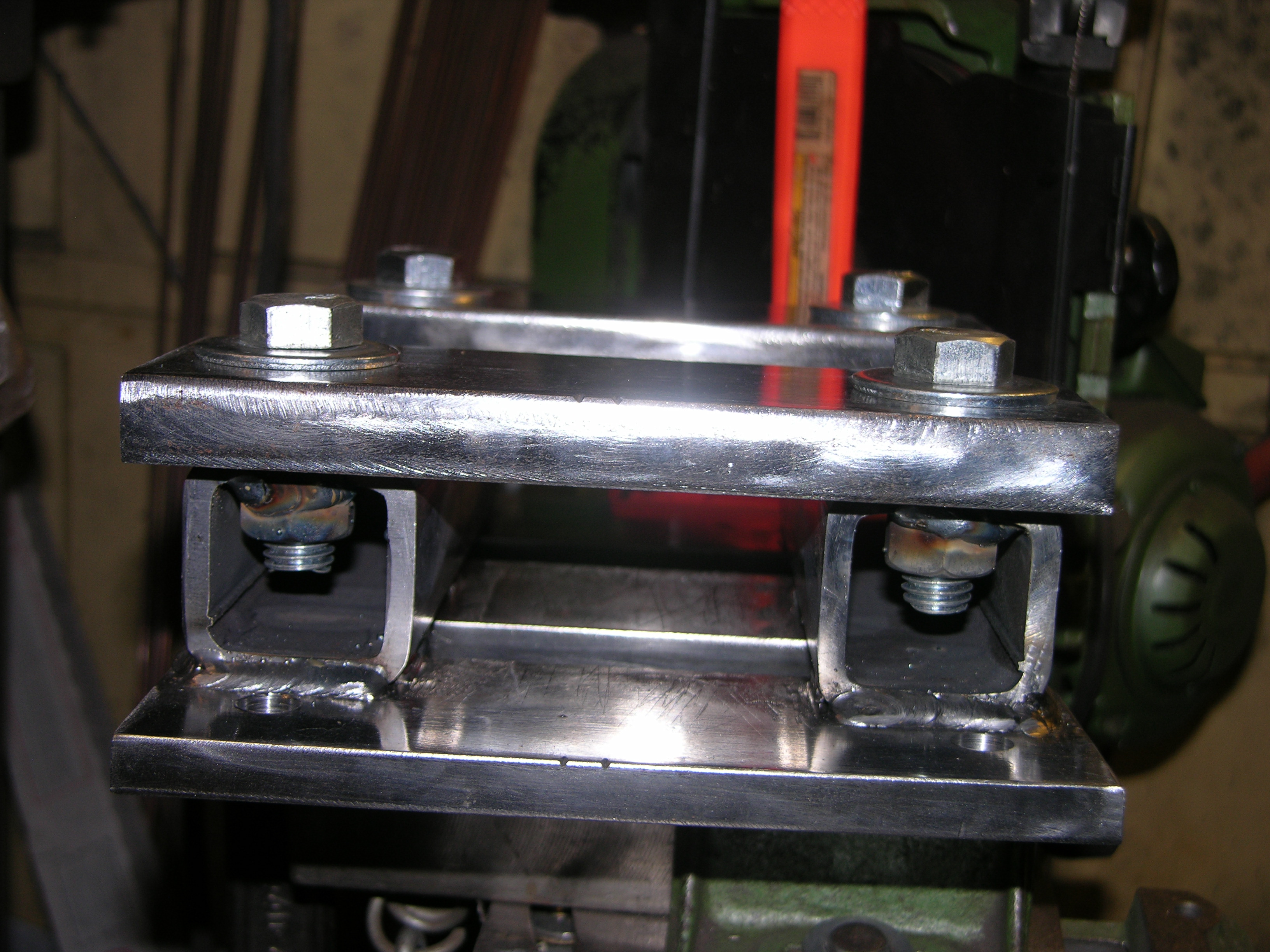

Moving (sorta) right along - Tightened the bars down with short bolts while welding the nuts inside the tubes -
Closer view -
Further back -
Before and after running a 5/8-11 tap thru all 8 holes to clean up threads -

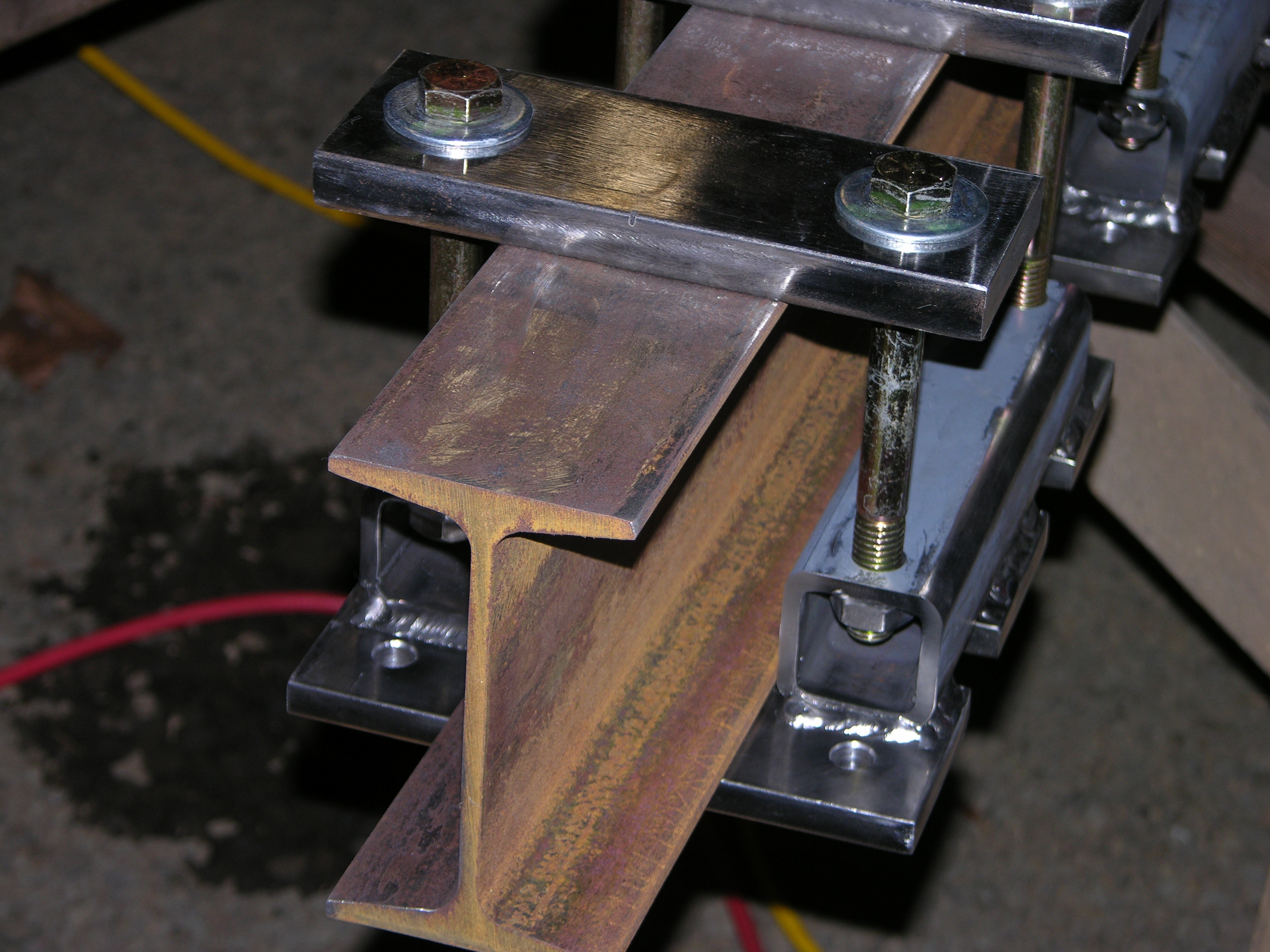

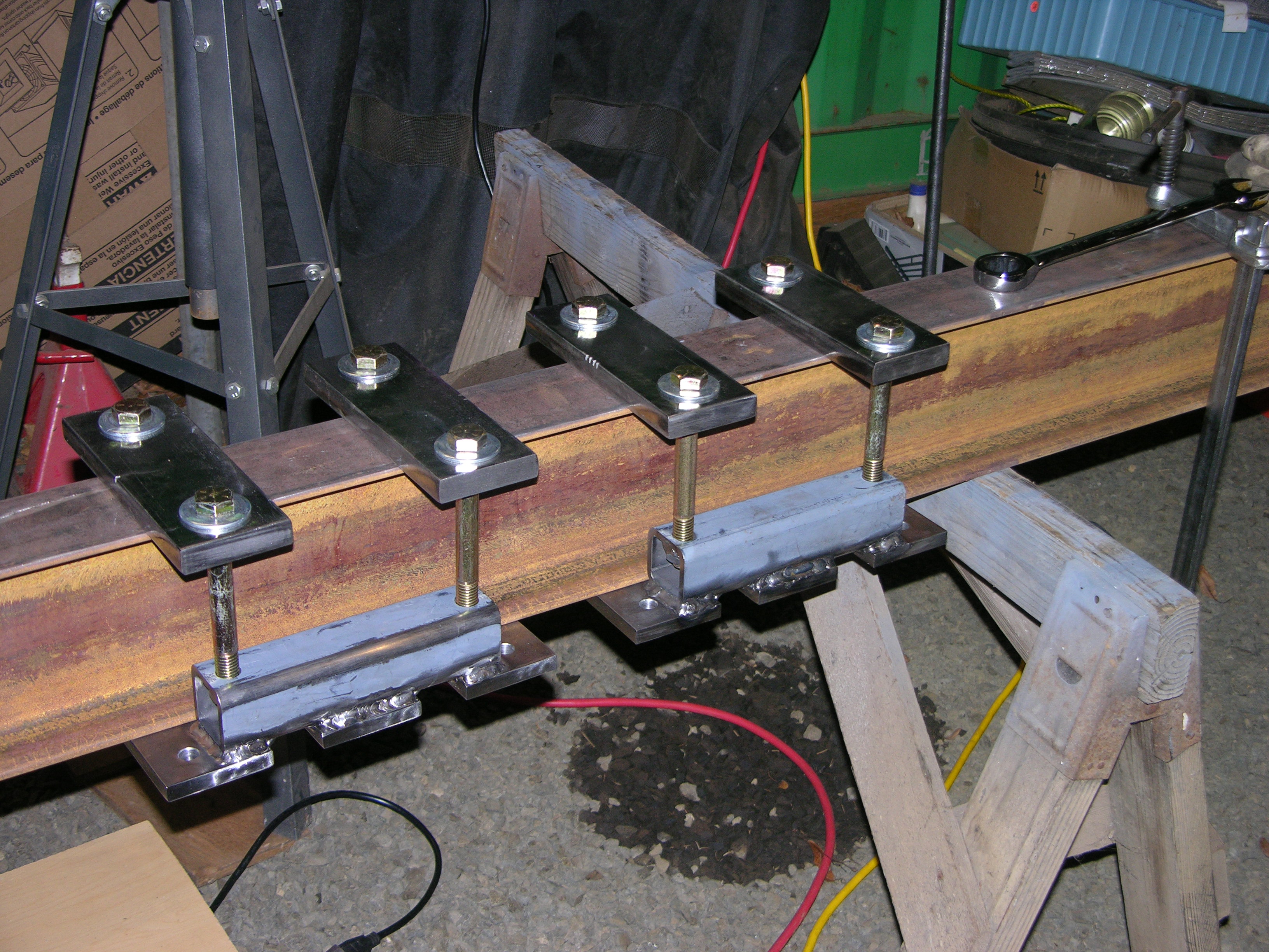

And a couple shots of the sliders mounted on the heavier I beam -

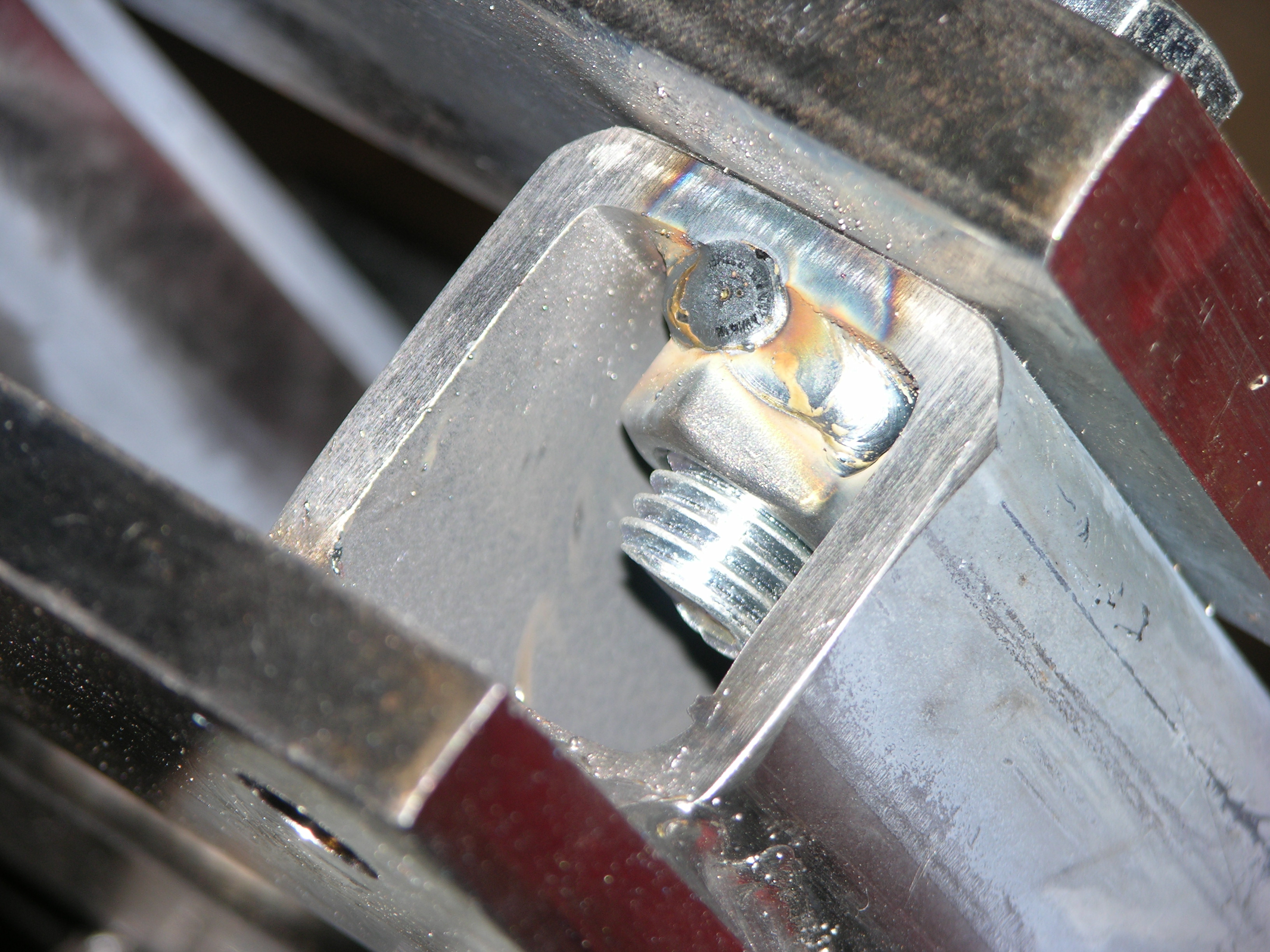

Anybody catch my latest boo-boo yet? in the last pic, the welds are too close to the holes in the lower plates for nuts and washers to sit flat :confused: - I was trying to keep those holddown bars as far apart as possible and still fit the factory plates on the top of the posts - so I (correctly) left enough room for nuts/washers at the ends of the tubes... Then I INCORRECTLY forgot to NOT weld across the tube ends :rolleyes: - I think it's called "LABTYD" - as in, Life's A *****, Then You Die...
Seems like it's always my NICER welds that end up havin' to go bye-bye :drool:
The GOOD news (sorta) - just stick a 1-1/16" cutter in the mag drill and "kiss" each end, centered on the holes - might even look like I PLANNED it that way - Any dissenting opinions on that should re-read my very first sentence in my very first post in this thread/odd-isy :laughing:
That's it fer now, I'm 'bout done for the night... Steve

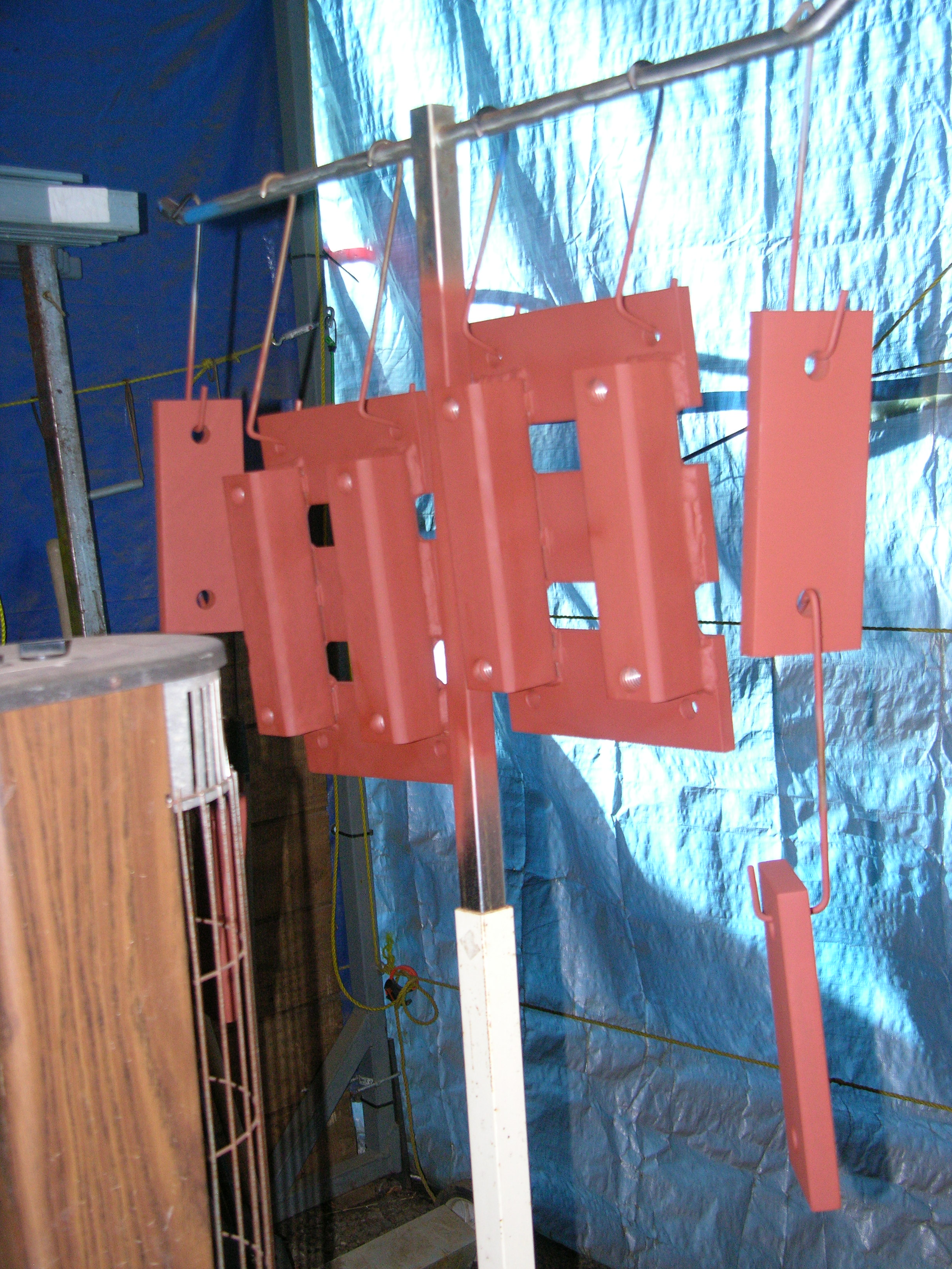

On second thought, who said ya can't put lipstick on a pig??!? :laughing:

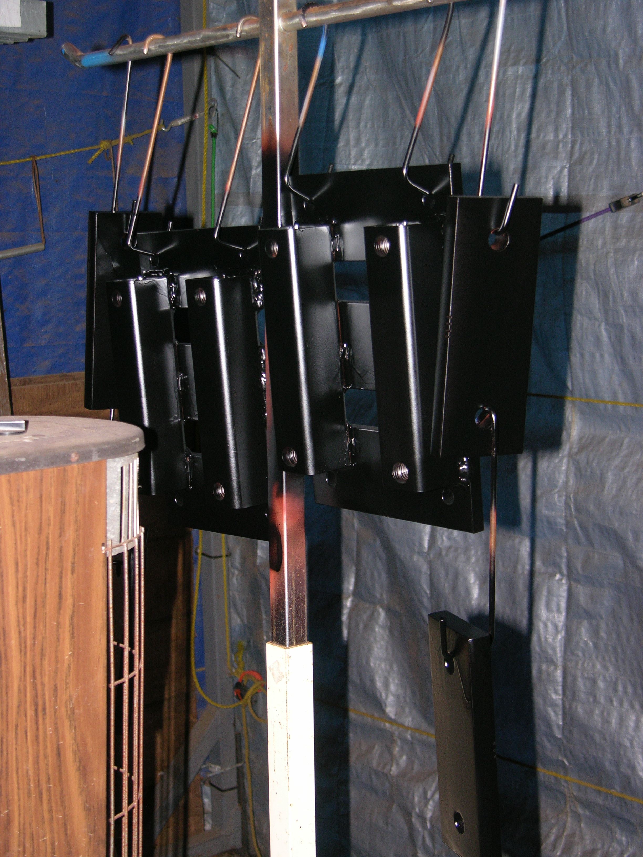

Fixed the previously mentioned boo-boo easier than I thought; those holes only get 1/2" bolts (the HF supplied ones will be replaced with Grade 8's) so all it took was a few gentle "kisses" with a cutoff disk held flat against the flat bars those tubes are welded to - I'll put locks and nuts on THAT side, and the bigger FLAT washers on the thinner (HF "industrial duty") side (the top plates of the uprights)

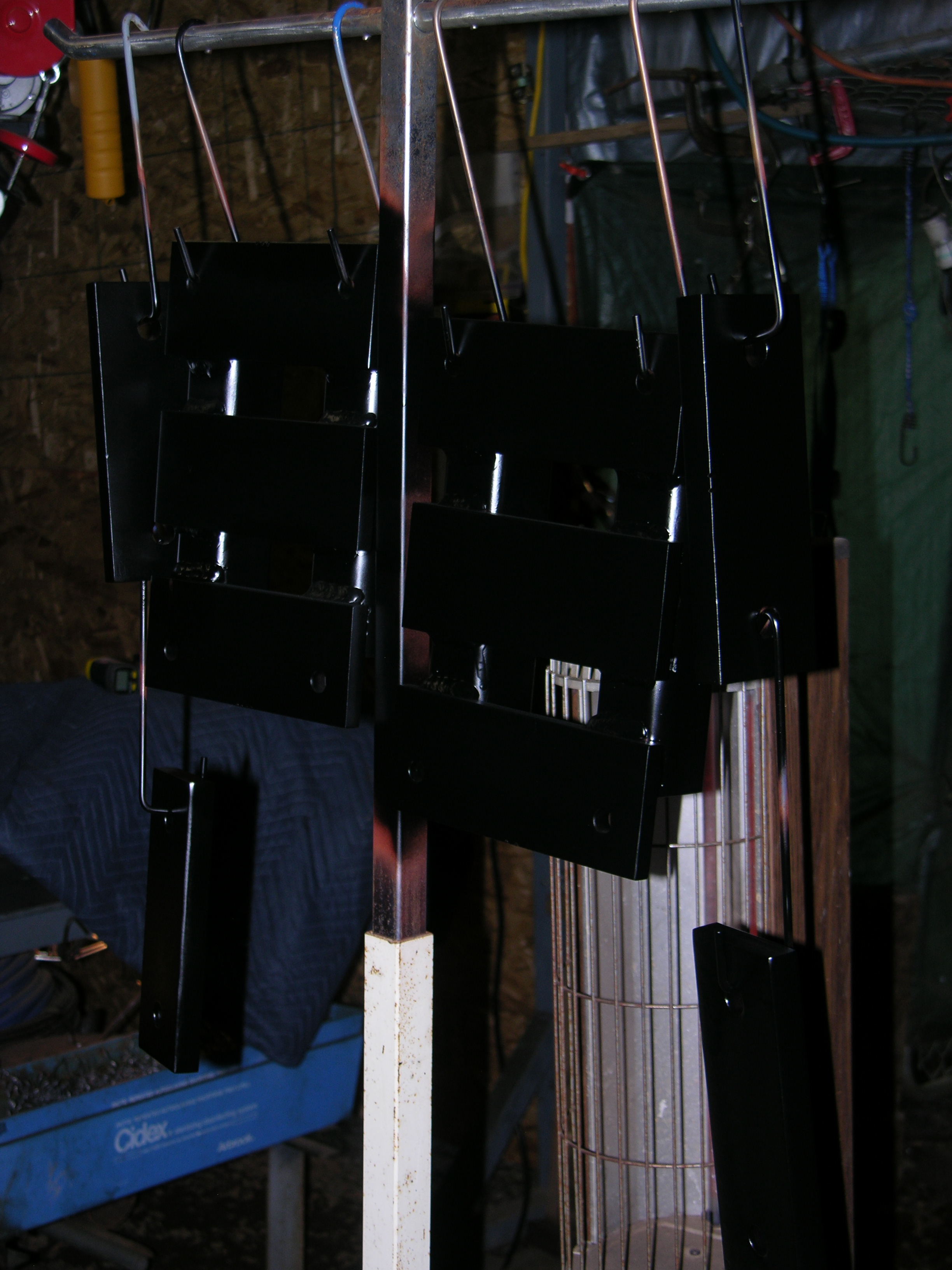

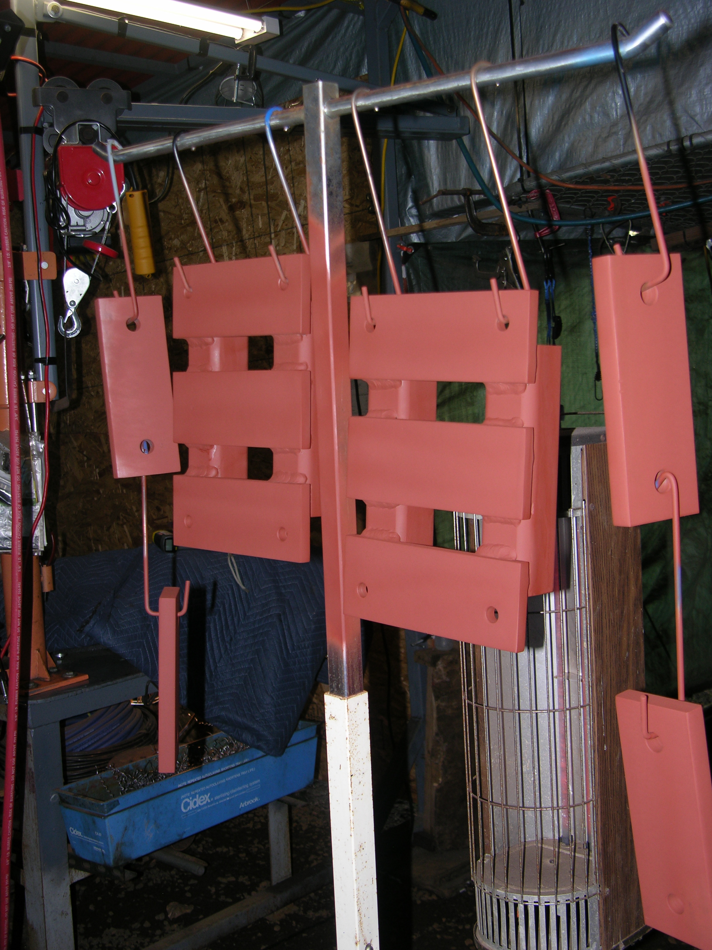

Over the primer with satin black -
It's only about 52* out, so I'll leave the quartz heater on 'em til after supper ('bout 3 hours), then they'll have a few days to finish curing out while I get the I beam prepped for paint... Steve

Well I wasn't too thrilled with the Krylon primer I used the other day, the cover coat kept wanting to "slip off" and leave reddish marks; had to go back and touch up several places... so I found Rustoleum "rusty metal primer" (works on clean metal too) on Amazon for $3.98 a 12 oz. can, ordered 8 cans - some of that'll get used on the HF crane's upsized I beam, but the paint won't be here for at least a week :thumbdown: - so I spent today puttin' a few more LED shop lights under the small container roof, lot better vision there now.
While I'm waitin' fer paint, I'll get back on the weld cart, get the floor mat and aluminum trim on it and it'll be (semi) done for now. I did find the full-suspension drawer glides I knew I had, but I think I'm gonna hold off on that drawer til I get some hood time with ANOTHER "OT goodie" - I've had this

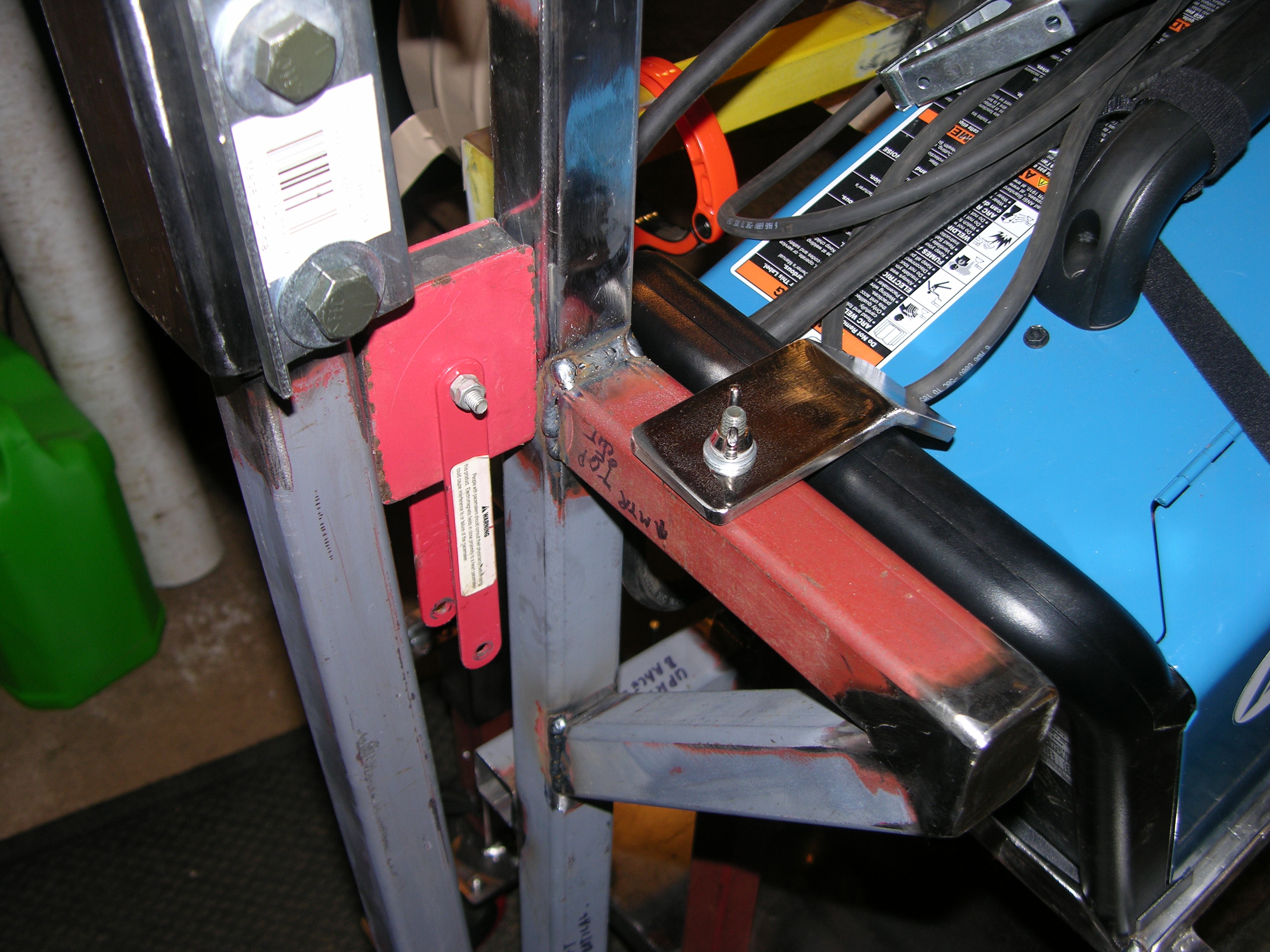

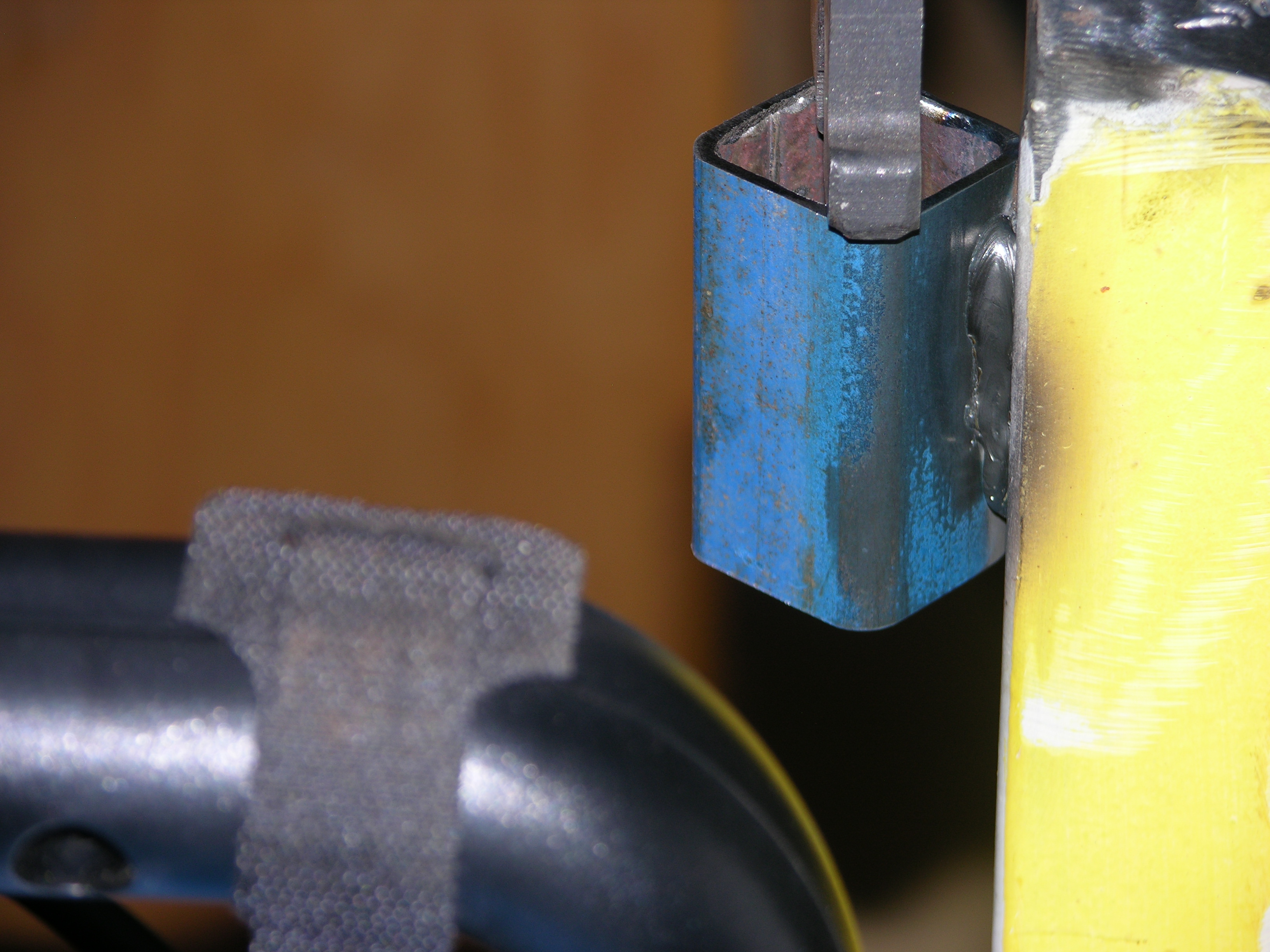

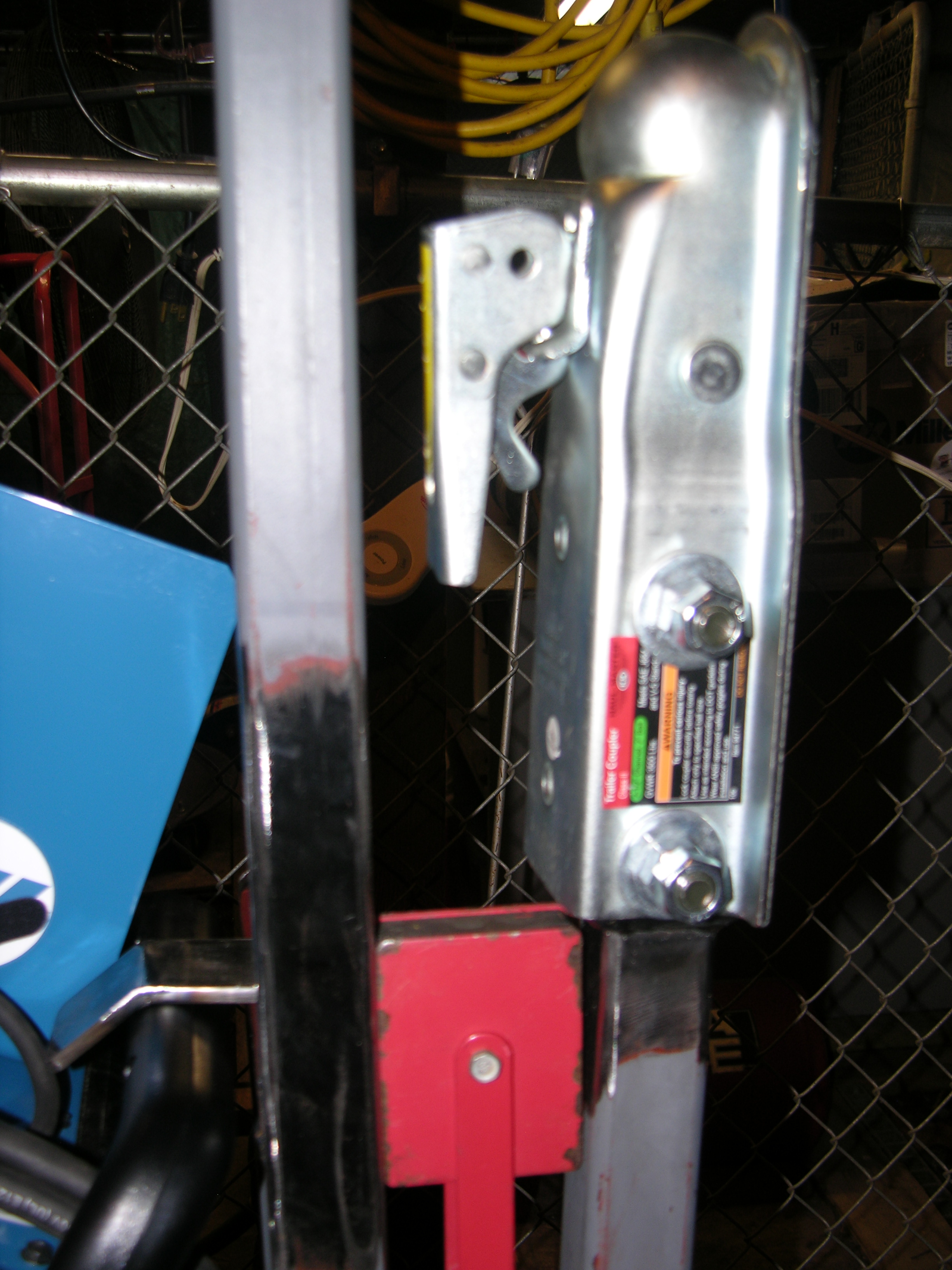

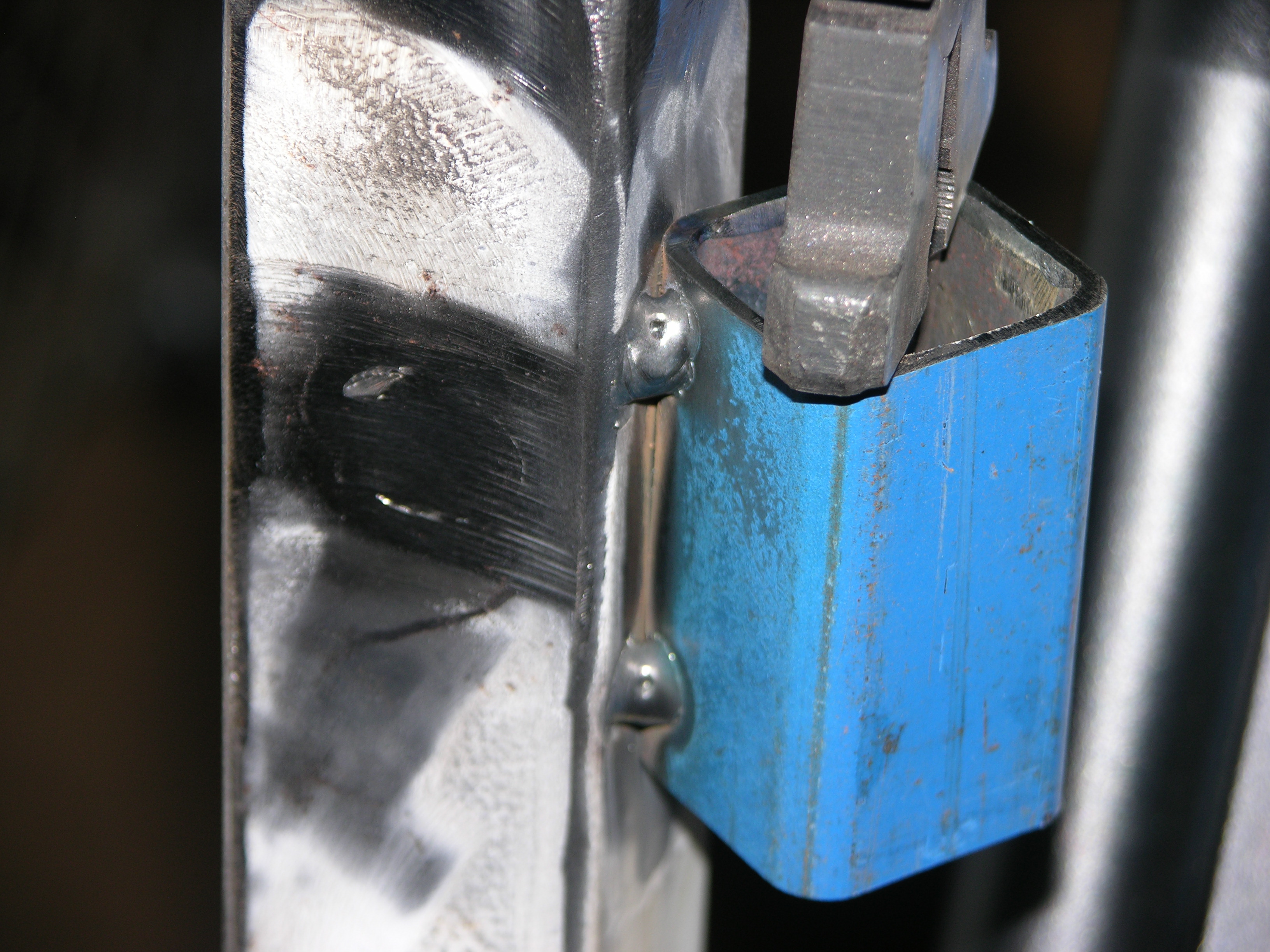

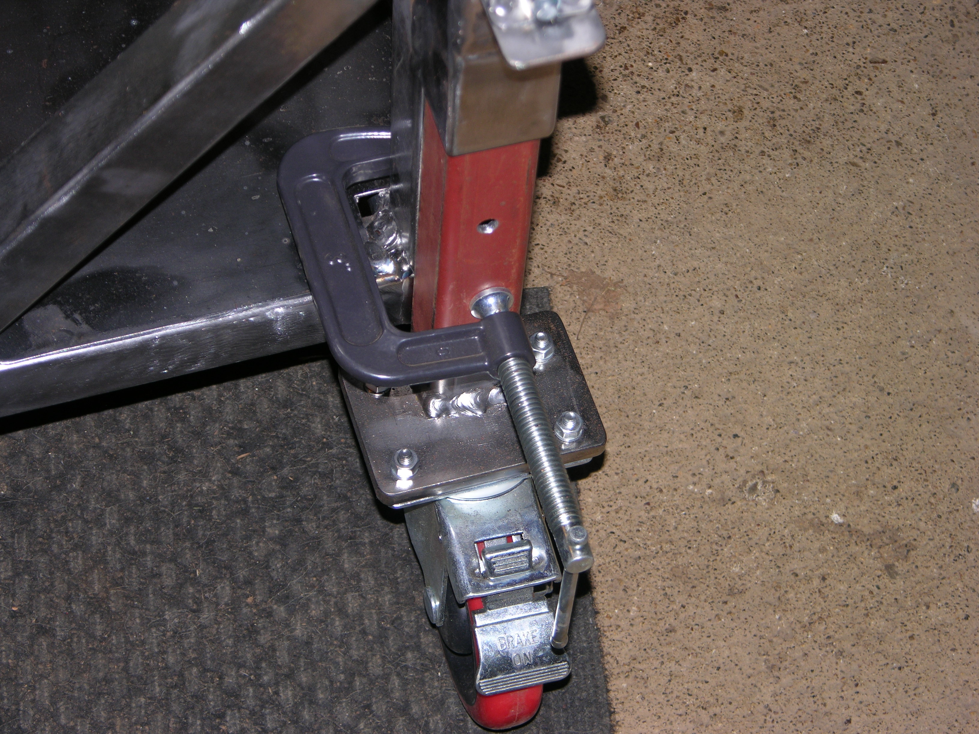

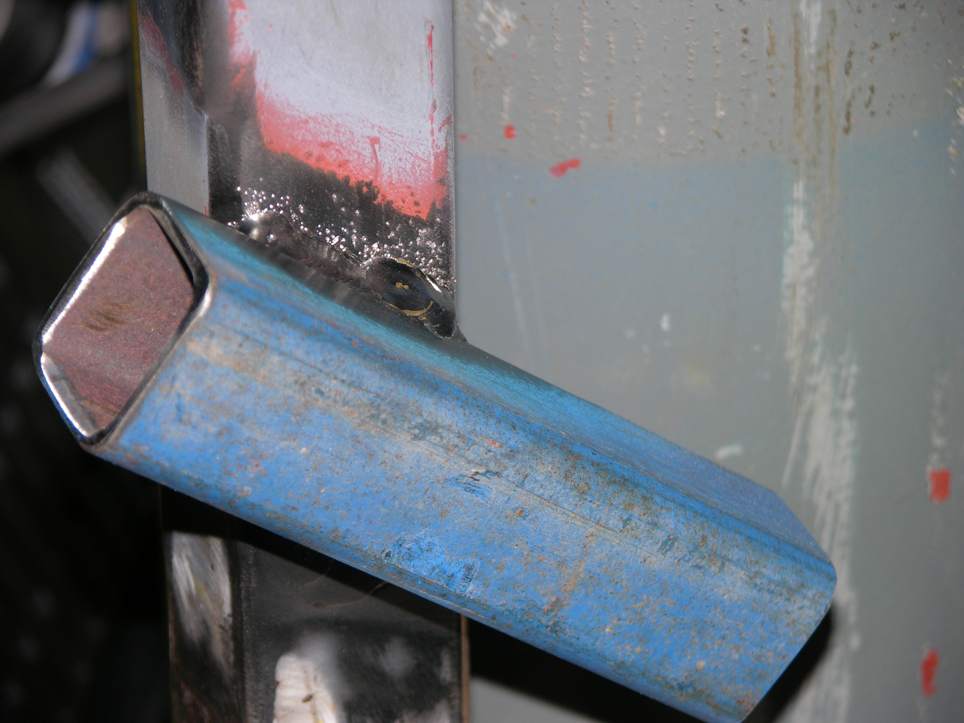

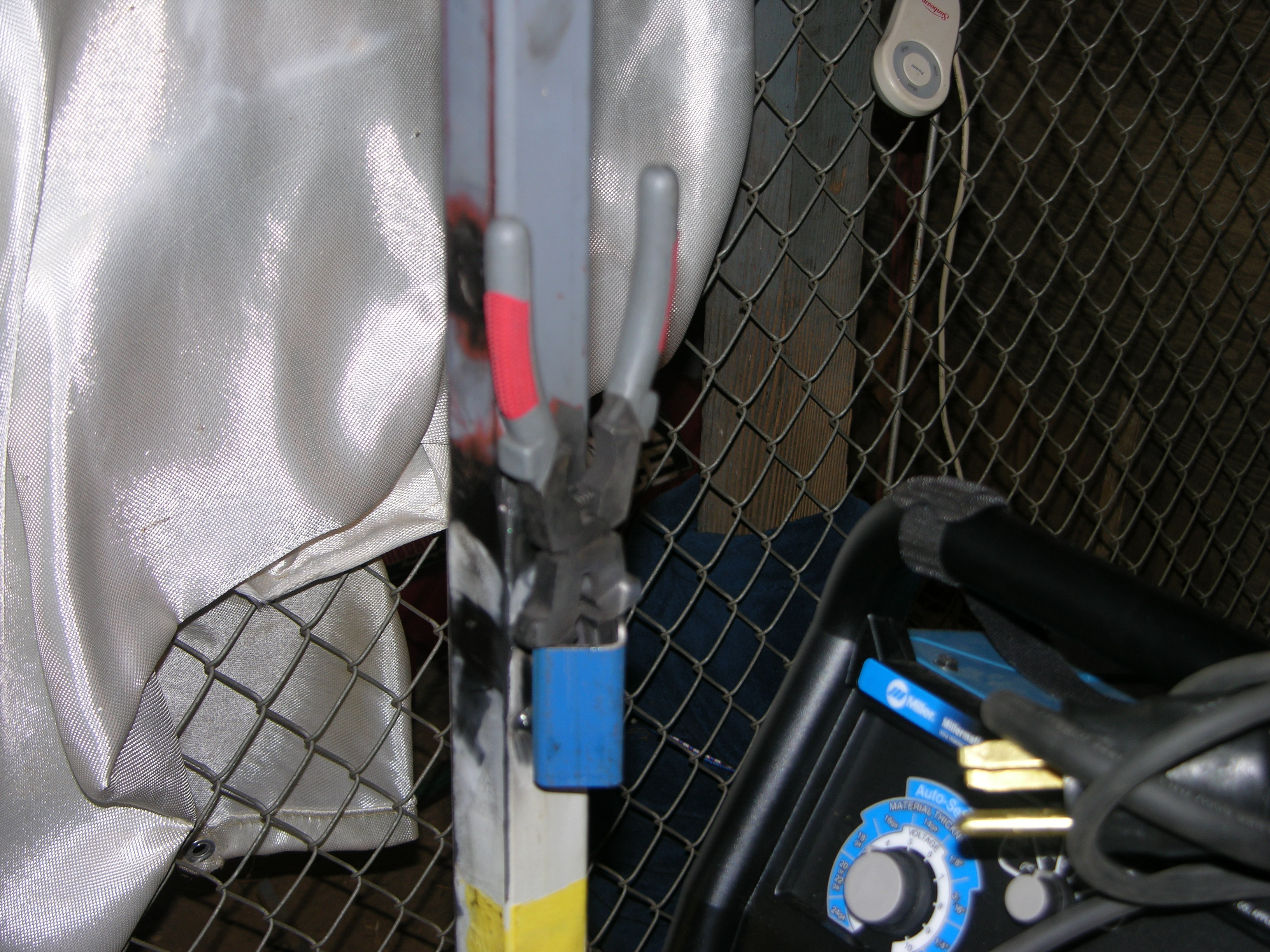

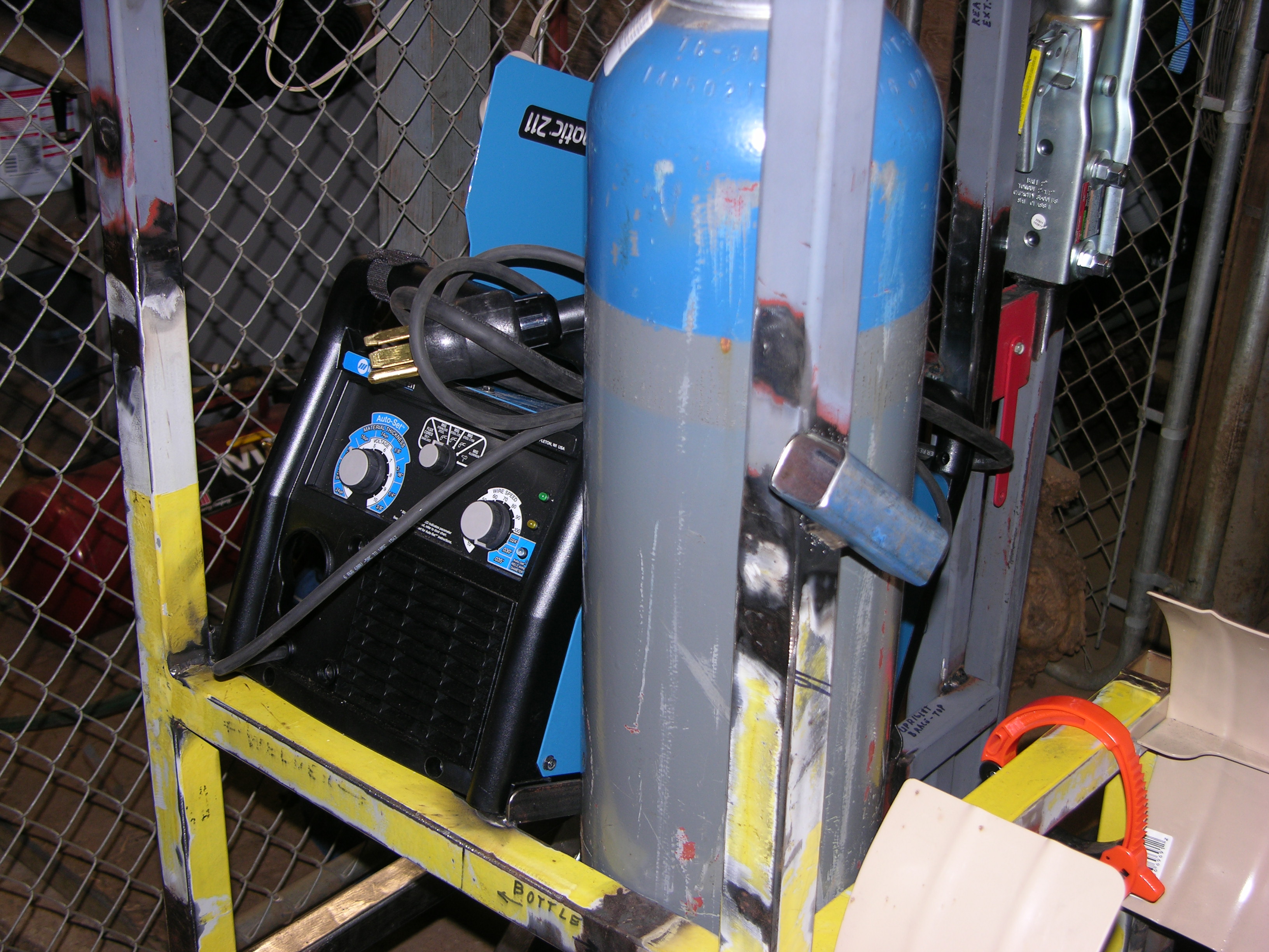

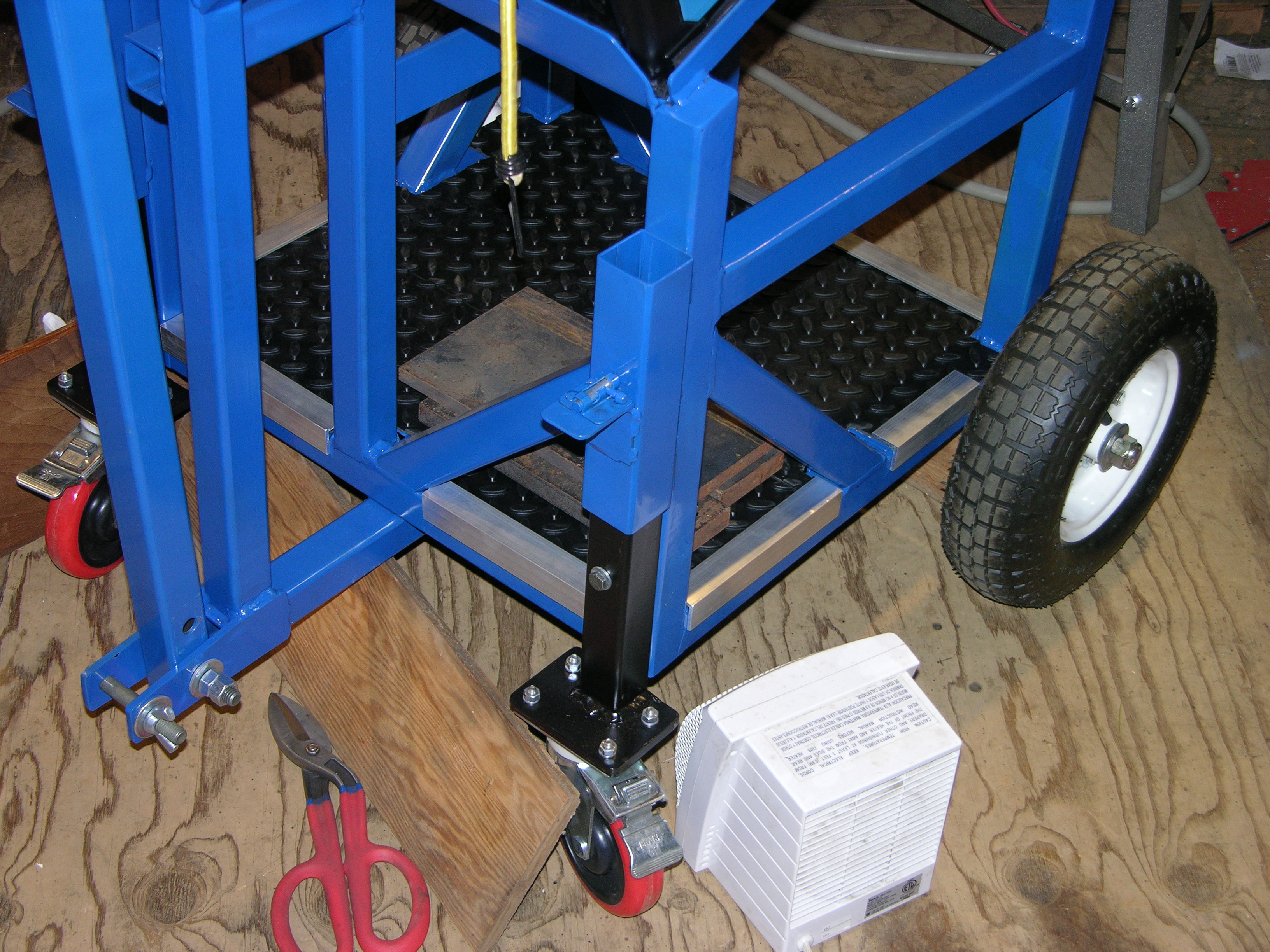

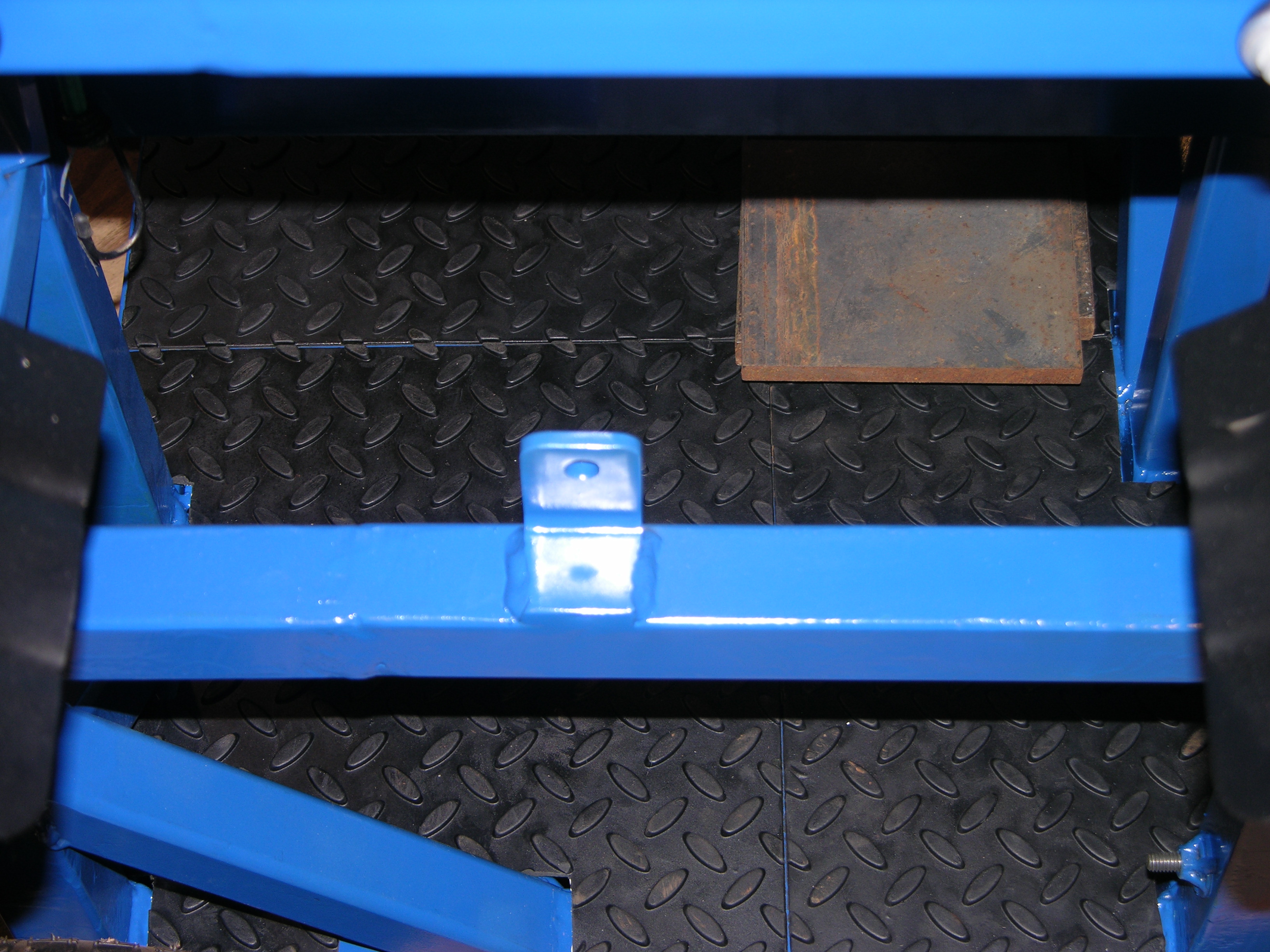

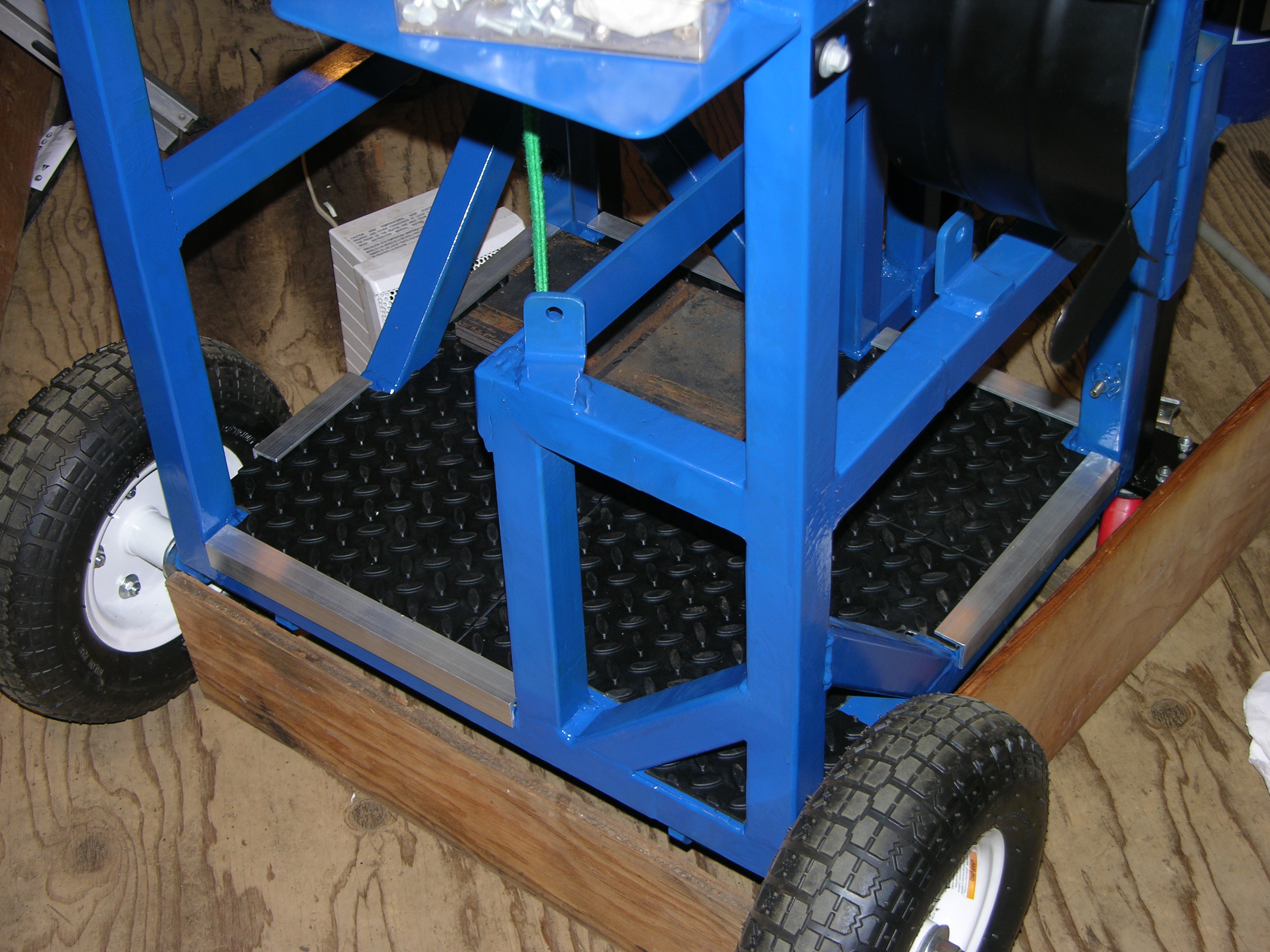

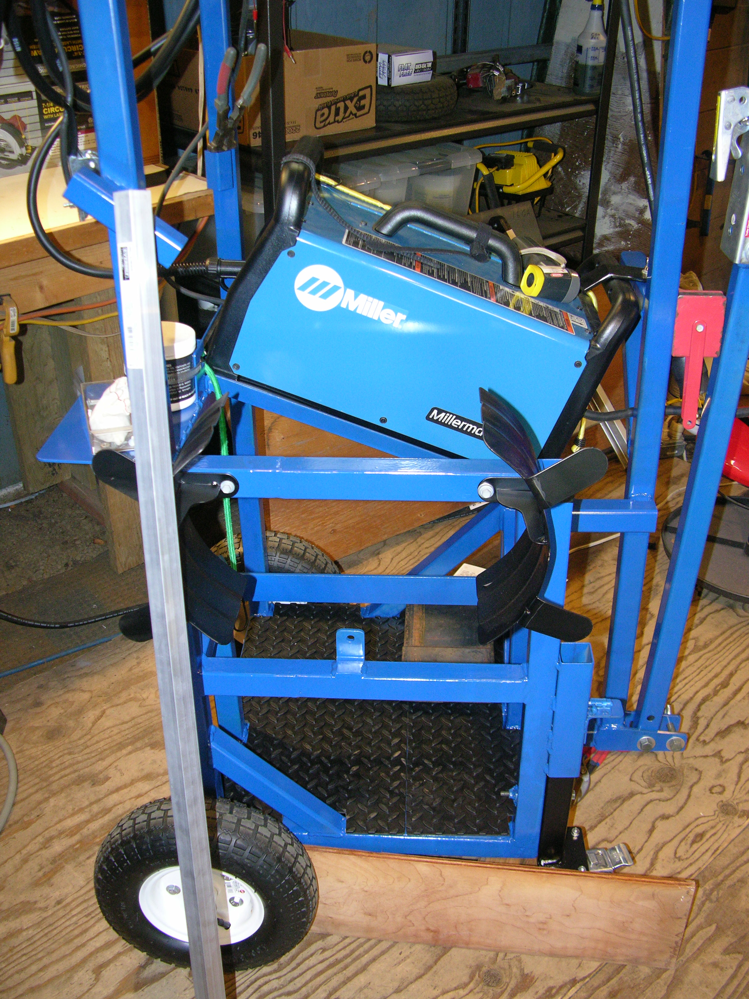

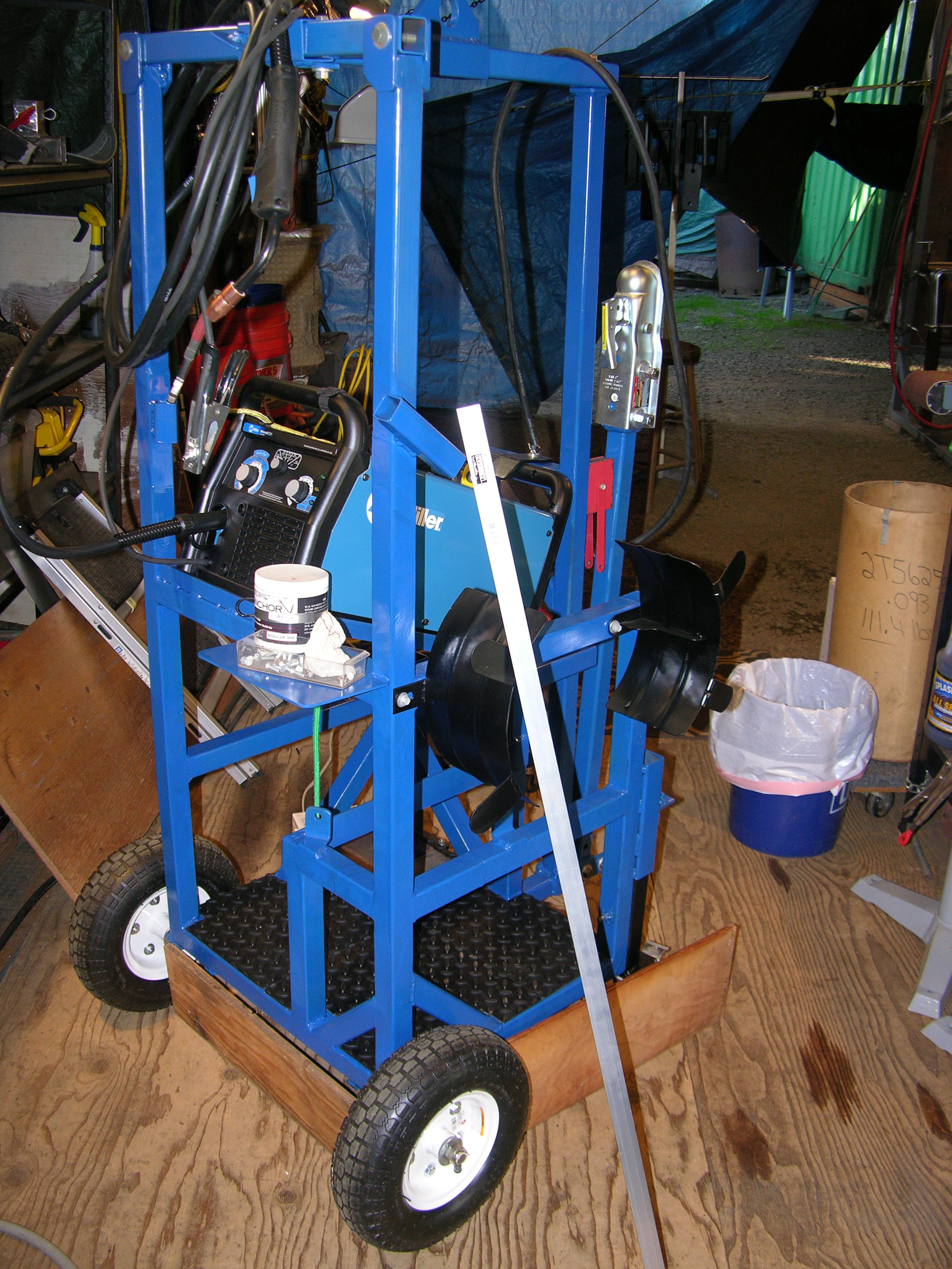

Fairly productive day today, weld cart is pretty much as done as it's gonna get for a while -
Got the aluminum angle screwed down, should keep the mat from curling around the edges -
Next, left and right rear view, left and right front view - Notice the "lift cage" also doubles as a "roll bar" to protect the gauges...
Couple closeups of holddown angle...

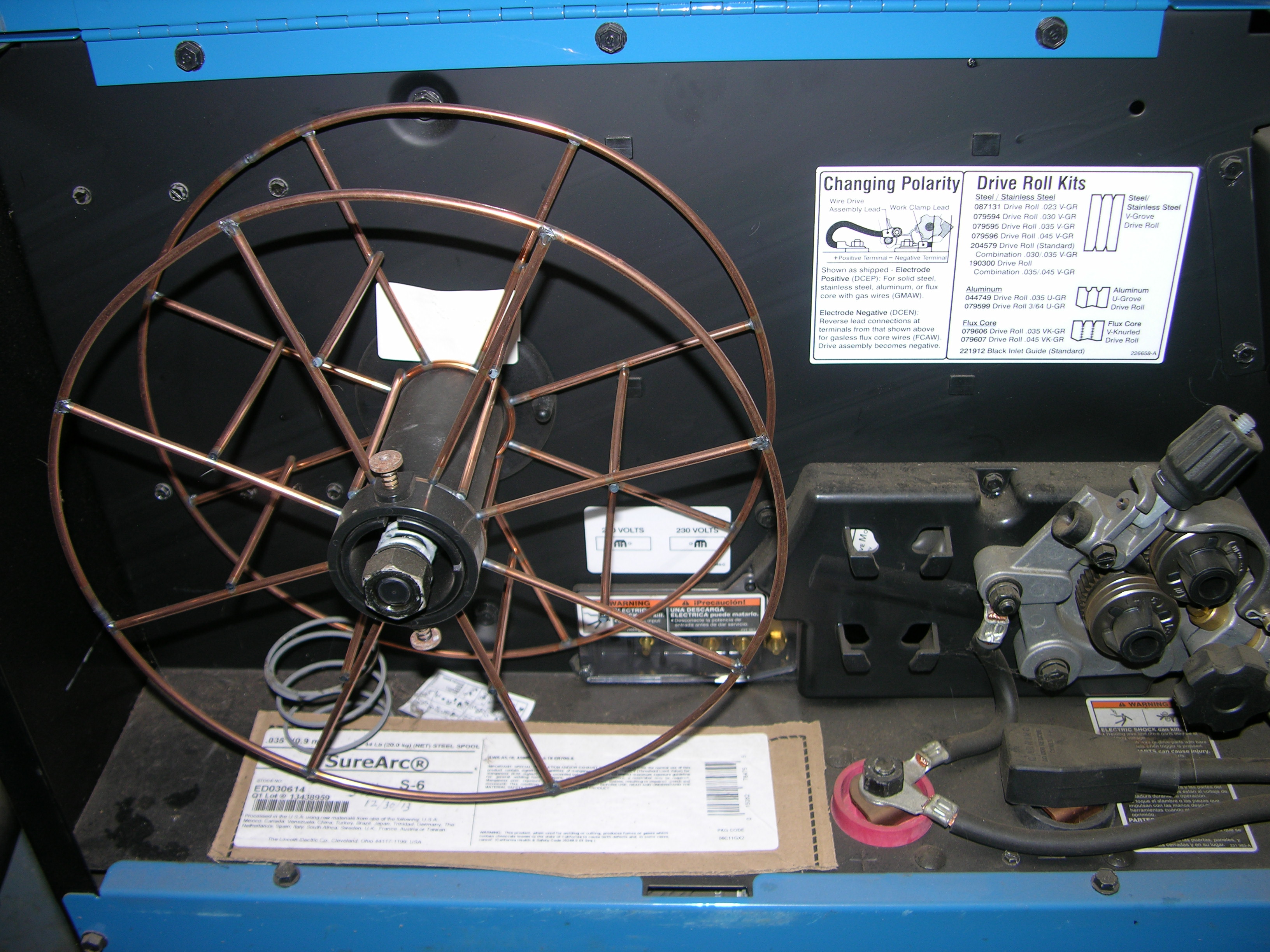

MM211's ready to go, fresh 12-1/2# spool of .035 L56, tension set, new tip, etc - next I need to get the I beam "upgrade" for the HF crane de-rusto'd enough for primer and paint so I can get THAT assembled and out of my way - not sure how far I'll get on THAT before the 20 yards of rock shows up Monday morning.

Wow... looking good. Too fancy. See you have the new 211. How are you liking it? I have the 211 transformer. My stand is a modified HF cart to also hold my plasma cutter. A bit top heavy. Might need to go 'balls out' on a stand like you did. :thumbsup:
/ Container Weld Shop build -
#197
Thanks; yeah, probably a teensy bit over the top :laughing: - but every "feature" has a purpose (for ME, anyway) - I needed max portability in a reasonably small footprint, since at times I'll be either trying to lift the whole thing onto a trailer or truck bed, towing it around the property with a tractor or lawn mower, tilting it back onto the big tires for moving over gravel (relatively short distances)... I'm not sure how well it'd work with the older MM211 - I had one, and it's almost TWICE as heavy WITHOUT a spool of wire as the NEW one is, WITH a 12# spool...
Only thing I DON'T like (about EITHER version) is that autoset is too hot (a common complaint) - I just recently learned that (reportedly) the autoset "assumes" you'll be doing FILLET welds, which would explain the "too hot"...
The newer one lets me use a 15' gun - has the down-firing feed and a stronger drive; autoset has a LOT more options including all THREE wire sizes, + flux core, stainless, mild with C25, mild with CO2, and spool gun/aluminum. IOW, nearly everything I DIDN'T like about the OLD mm211, got fixed on the NEW digital one -
They both spec the same (24.5 amp/240 volt) draw at rated output, BUT - the transformer version is NOT recommended for 50 hZ, while the digital version is rated at 50-60 hZ - and I spoke to a Miller tech about generator THD, he claimed the digital version "didn't care" - I hope he's right, 'cause ONE of the "eventual" projects is over 3000 feet of new fencing with welded-in-place H braces every 20-rod roll (330 feet) and my genny is 7kw continuous but NO spec on THD - that project will probably be the ONLY time it sees flux core wire (if I LIVE that long :rolleyes:) but it's possible it'll hafta run on the genny for other indoor projects (my son's garage doesn't even HAVE a 240 outlet so if he ever needs something welded I would probably put both the welder AND the genny on my small trailer to do that)...
"Might need to go 'balls out' on a stand like you did." - Well, ya got a LOT of pics and "features" to pick and choose from - but given the weight of the transformer 211, I think I'd be tempted to do a lower slung, "over-under" setup - the 211 low, but angled up like I did - then the PM45+ above that on a second set of angle "rails" -
Things I watched VERY carefully for, was ZERO interference with side door WITHOUT having to take the welder off the cart, zero interference with air flow, gas connection, power cord, etc - and no metal-to-metal connection between welder and support angles (found some EPDM self-stick weatherstrip at Lowes, goes on BOTH surfaces of ALL the angles) - NO reason ELECTRICALLY, just didn't want scratched up paint on either Miller's creation or MINE :D
IF you do one, you probably DON't need EVERYTHING I did - like a trailer hitch, maybe not even an adjustable balance picking eye - but the larger wheels and "hand-truckability" is nice, in that it also provides a "roll cage" to protect gauges AND a way to support a dust cover - also, the locking casters are something Miller shoulda thought of on their carts...
Man, now I'm startin' to sound like a freakin' SALESMAN, and there's NO WAY I wanna build MORE of these :eek::laughing: ... Steve
