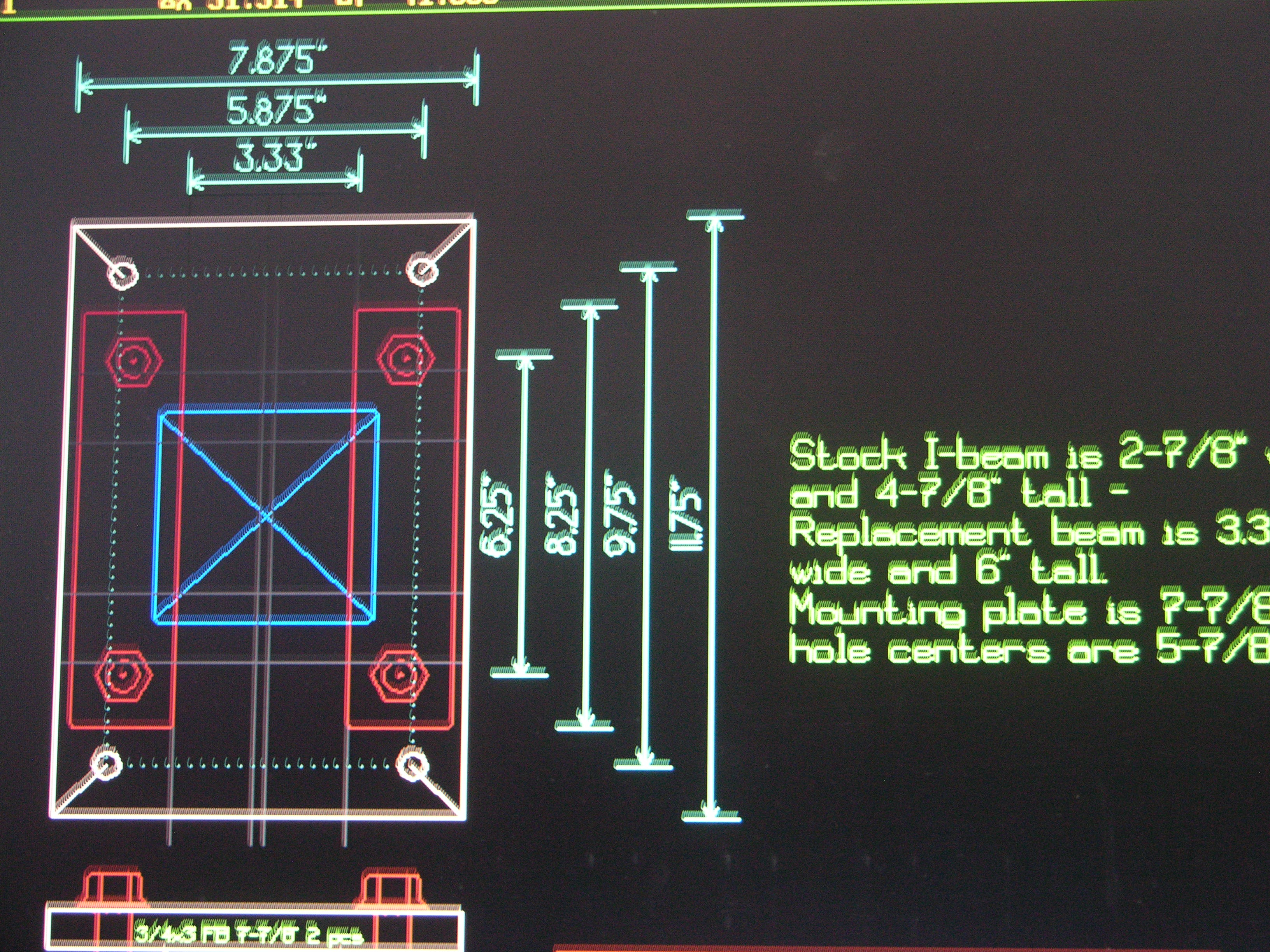

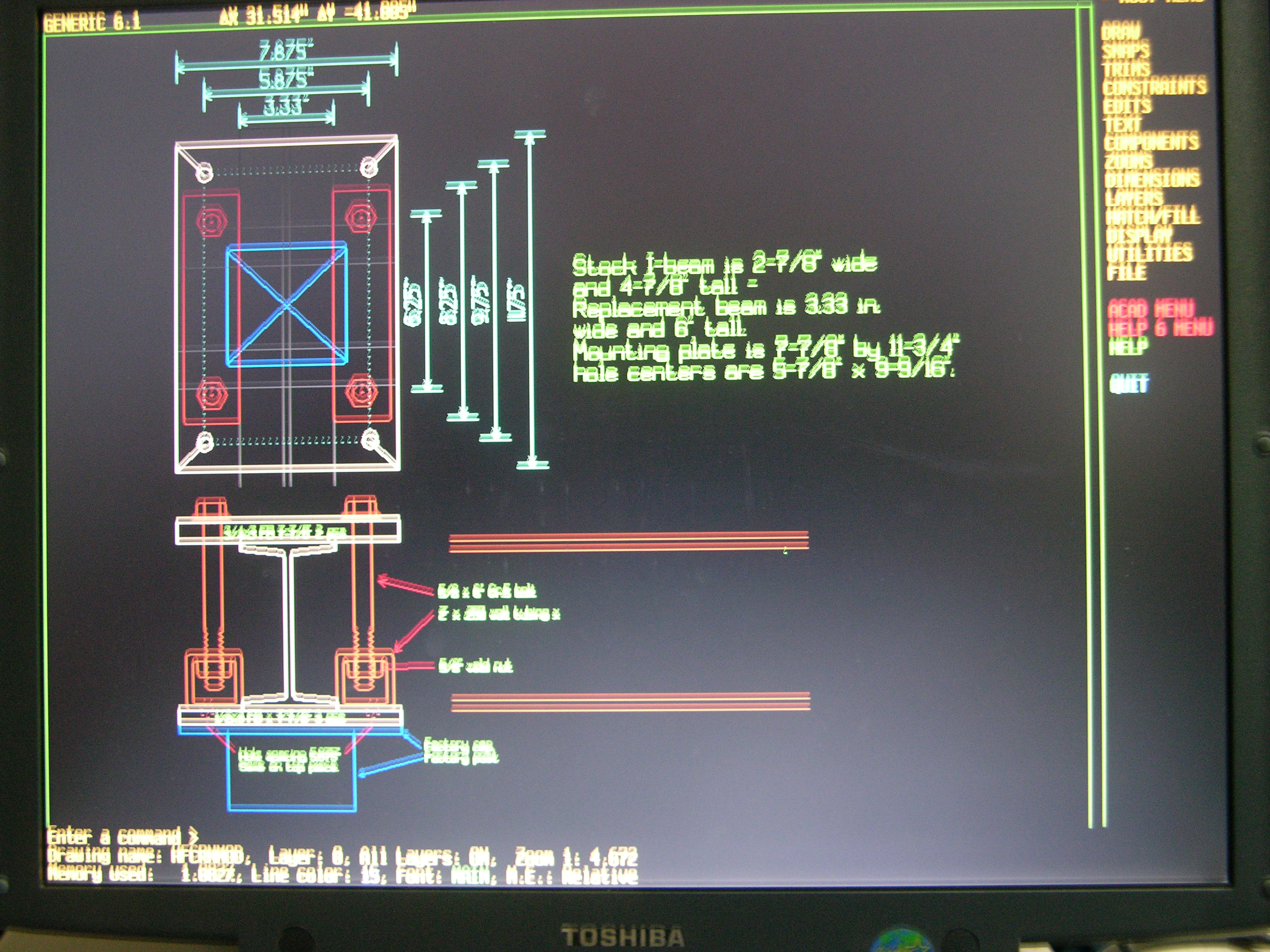

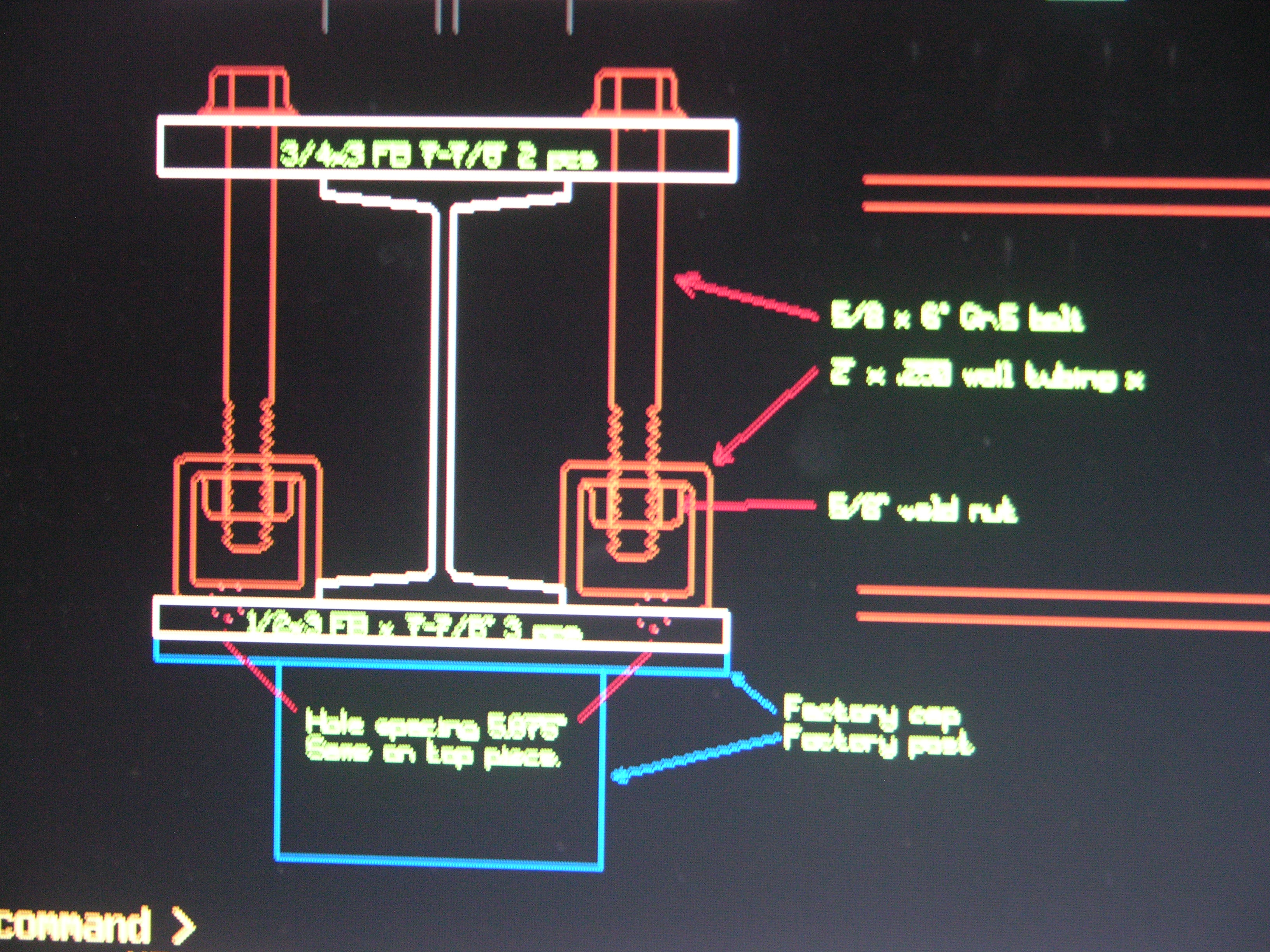

Fergot to mention; I finished the CAD drawing for the bigger I-beam mounts (HF crane mod) but haven't got around to converting to a "web friendly" format yet - Hoping to get all the pieces cut out and drilled manana (nuthin' like an eternal optimist, huh??!?)
Oh well, since everybody LIKES my "blurry pictures", here's 3 attempts at screen shots, hand held @ 1/4 second, no flash (washes out the screen) - DSCN3060.JPGDSCN3061.JPGDSCN3062.JPG -
at least it's a general idea of what I'm doing to the HF crane for NOW - probably a few more mods before I'm done, but we ALL KNOW it's STILL quicker than my "from scratch" stuff :rolleyes:... Steve

Ouch... that hurts the eyes. Are you on a Mac by chance? If so, for screen shots, hold down [shift][command]4 and then and drag to frame as appropriate. Much better screen shot.
/ Container Weld Shop build -
#146
No Mac, it's an older Toshiba laptop, the ONLY Win XP machine I have that'll run my ancient DOS-based Generic Cadd prog - to get ANYTHING other than a really old DXF file out of it I have to export to DXF, then pull that into a (relatively) newer windows cad prog (I have a couple) that (with MORE massaging) can output a jpg. I bought QuickCad a year or two back, but haven't had enough time/desire to spend ANOTHER couple years learning a new drawing prog.
The original programmers of Generic Cadd got together after the 10-year non-competition thang and brought out General Cadd for Windows, and it uses MOST of the same 2-letter commands I'm used to - but they want $600 per single license and I'm not doing any of this for $$ anymore, and in retirement $600 could be better spent on shop toys....
Anyway, since the CAD I actually KNOW only runs in a DOS window, I haven't been able to get the usual "suspects" to gimme a screen grab so I guess I'll have to bite the bullet eventually and learn the crap I HAVE (I HATE when that happens :( -
Oh well, at least I know what it's gonna look like; guess you guys'll hafta wait for actual PIC-CHURs :chillpill: ...Steve

Messed around with file conversion a bit tonite, DXF out of Generic Cadd into Autodesk's "quick cad" (old) then select all, change object weights from "default" to .05mm, save as .jpg (1280x960) - 'bout the best so far, at least it's readable... Steve
Well that is much better :thumbsup: but now I forgot what I was supposed to be looking at. :D. Guess I got to go back and read your last few posts. :stirthepot: Kidding.

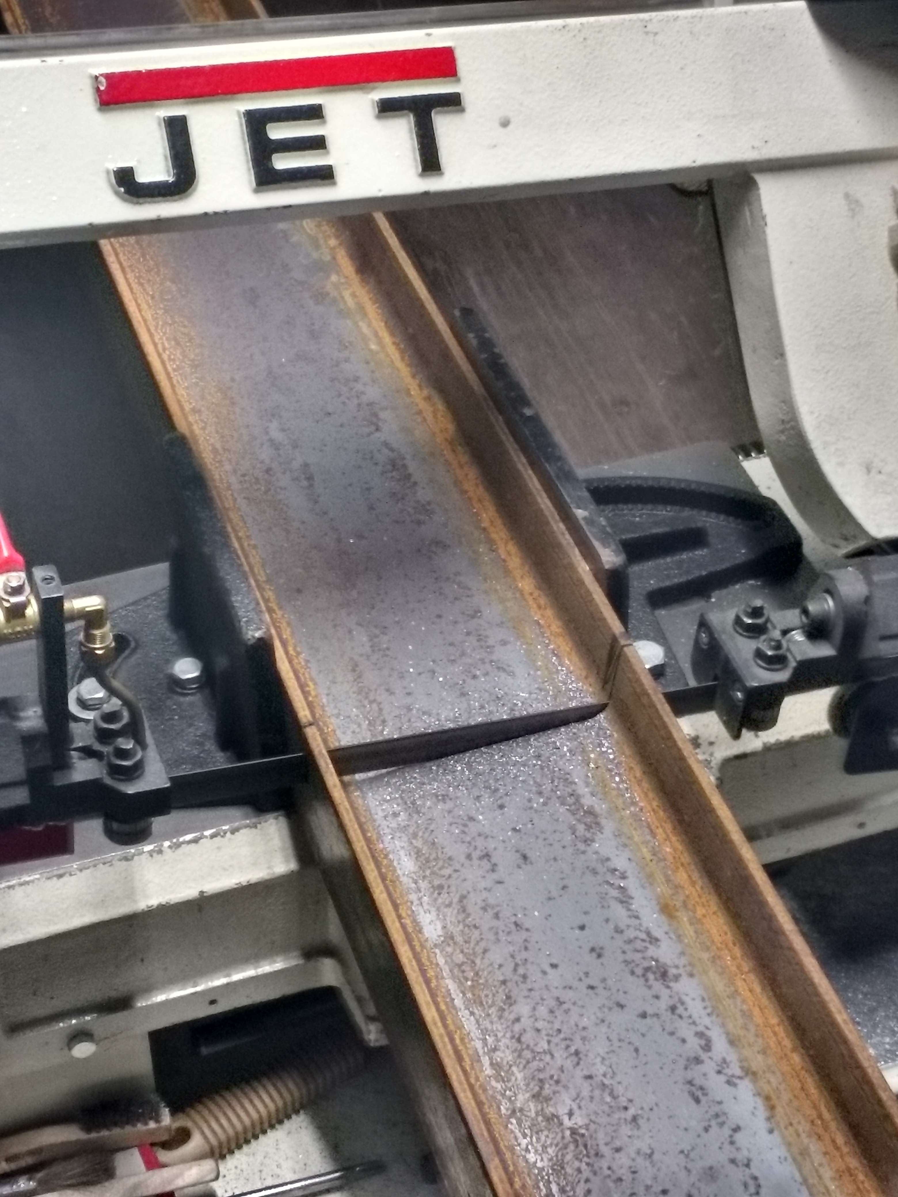

Mark, I can "HOLD" one for a LONG time, unless I try to LIFT it :laughing: - in this case, that's the weight the 20' beams are for the bridge crane - (6" x 12.5# per foot) - in order to cut one into 92" and 148" pieces (short piece is bridge beam for the container crane, long one is to make the HF "gantry" crane usable for ME) I used 3 jack stands - 2 are modified with "mini-log-bunks" so things won't slide off the tops -
Sequence of events: I have 2 pairs of these
Vehicle Dollies - 2 Piece, 15 Lb. Capacity
I use 'em anywhere I need to move things I can pick up but shouldn't actually CARRY around, they come in handy for different things...
Pick up ONE END of that 250# beam, kick a dolly under it, set it down
Repeat for other end
Roll it over near the saw
Place jack stands, 2 on outfeed, one on infeed, in line with fixed vise jaw
Roll beam lengthwise til the CUT mark is CLOSE to same plane as saw blade
Lift end of beam that's FURTHEST away from saw and place it on a jack stand (other end rolls AWAY from saw temporarily)
Repeat on OTHER end, need to lift higher to clear "log bunks" and saw vice
Lower saw close enough to see where to move beam cut mark to blade -
Lift ENTIRE BEAM enough to clear (non-roller) jack stands and saw bed about an inch, and line up cut
(Beam STILL weighs 250#, whether you lift it an inch or a foot :D) Notice I did NOT say I bench pressed said beam:eek:
Tighten vise, flip switch, make the cut
If it makes ya feel more manly, even the 12' (150 lbs) piece got a bit chunky by the time I (actually DID) carry it about 20 feet to set it on the little 5x8 trailer so I could take it up to the house area :D:D:D
Sorry, no "action" pics, wife isn't much of a photog plus she gets nervous around me when I'm doin' stuff... Steve

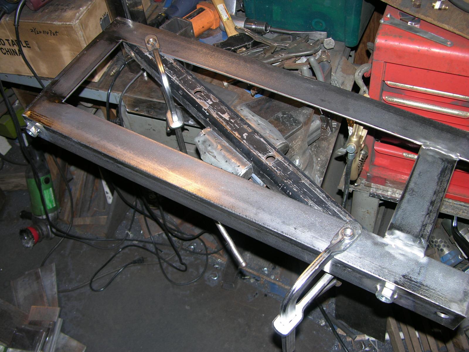

After supper I'll probably see if I can find the sand blast pot, there's 100# of 30 mesh silica in the back of my Outback...

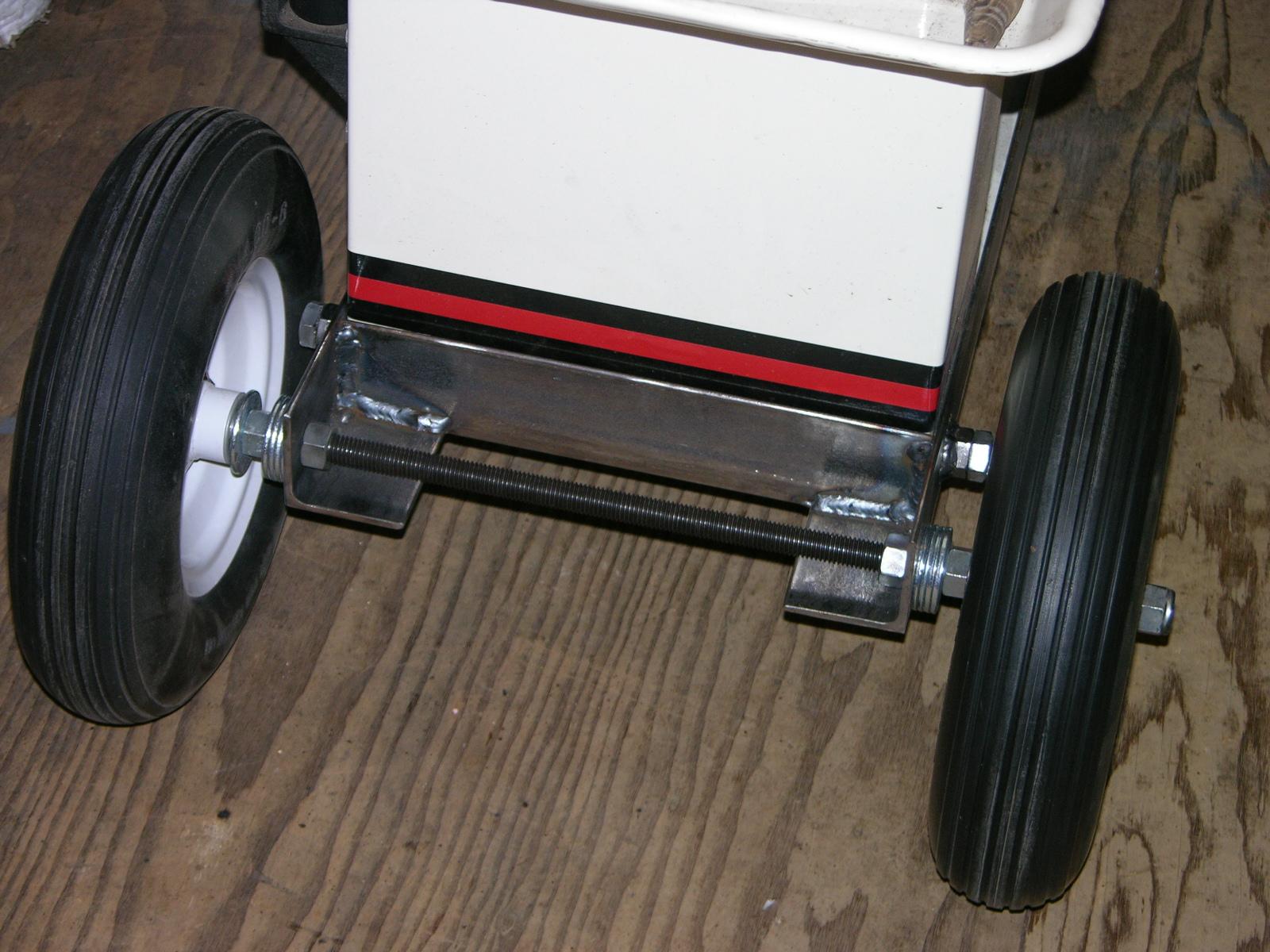

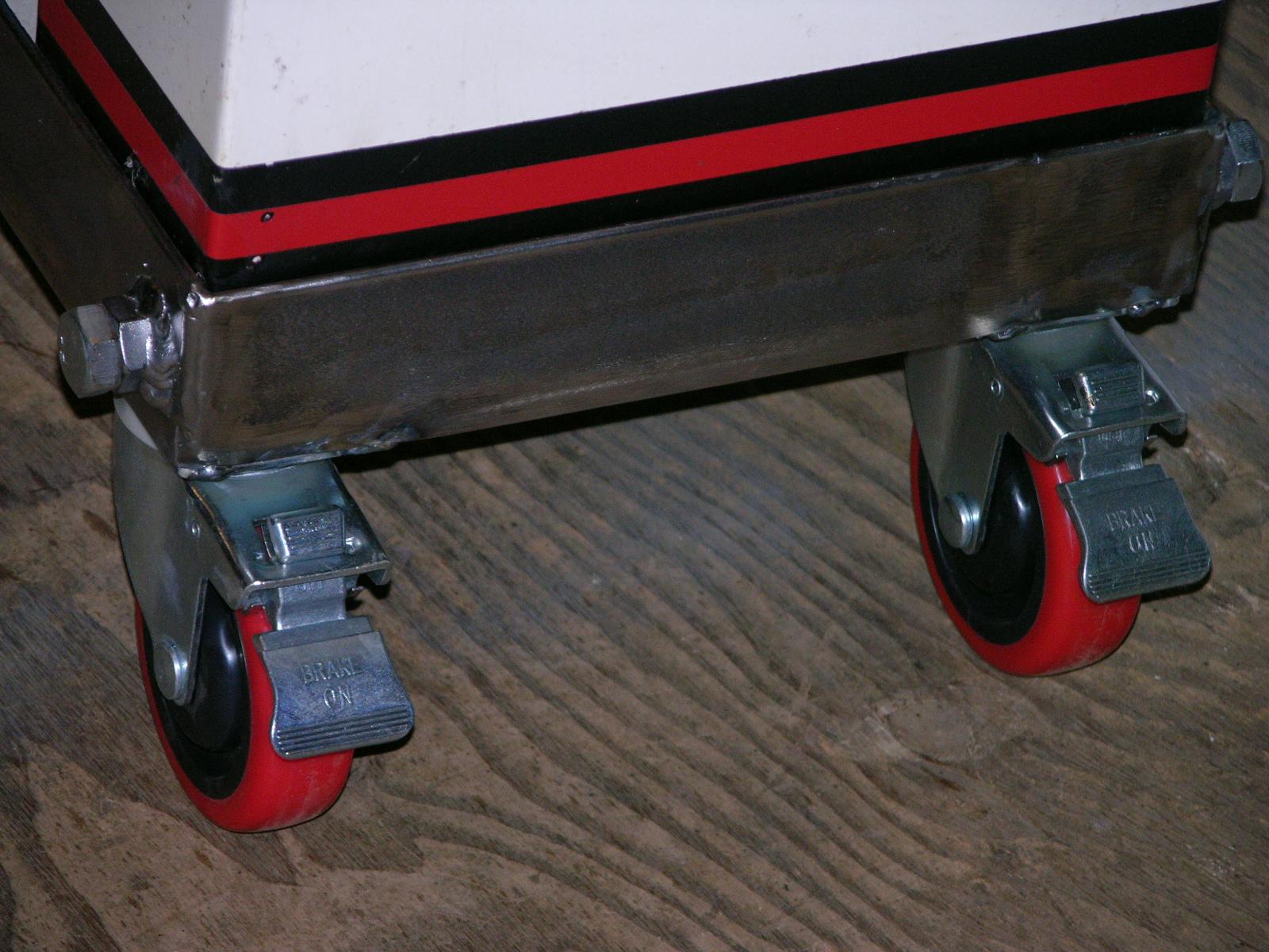

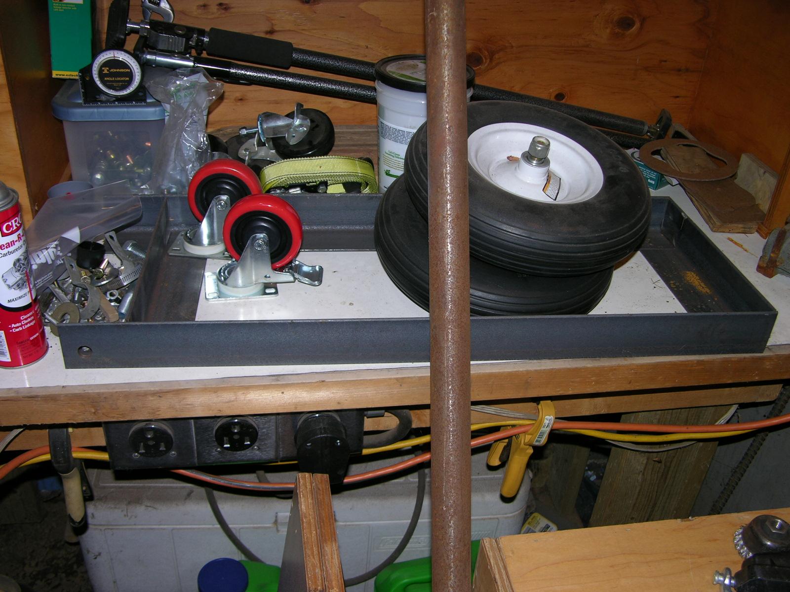

Band saw - I'd say more around 5 minutes, I usually keep a 6-10 tooth variable pitch bi-metal on it and cut thinner stuff with one of the little HF saws - I really like that Jet saw, it's another of the "perks" of that last couple years of MANDATORY overtime :rolleyes: -
You'll notice I did one of my "off-road" mods to the Jet too - flat-free rears and 5" urethane SWIVEL/LOCK casters in front, angle frame - the holes for the original, NON-steering wheel axles are now used to lock the saw frame into the caster frame. MUCH better - (got tired of picking up one end and changing direction instead of just steering it) the mod also raised the saw about 4-1/2", good for us 6' cranky ol' farts -
Rear wheels and lock-downs - the extra washers were necessary to keep the wheels from rubbing on those frame lockdown bolts; the extra track width doesn't hurt stability either - DSCN2052.JPG
(Notice the sneaky way I tossed in some OLD pics just to keep ya happy til I get off my tush and actually PRODUCE sumthin' ??!?) :D ...Steve
