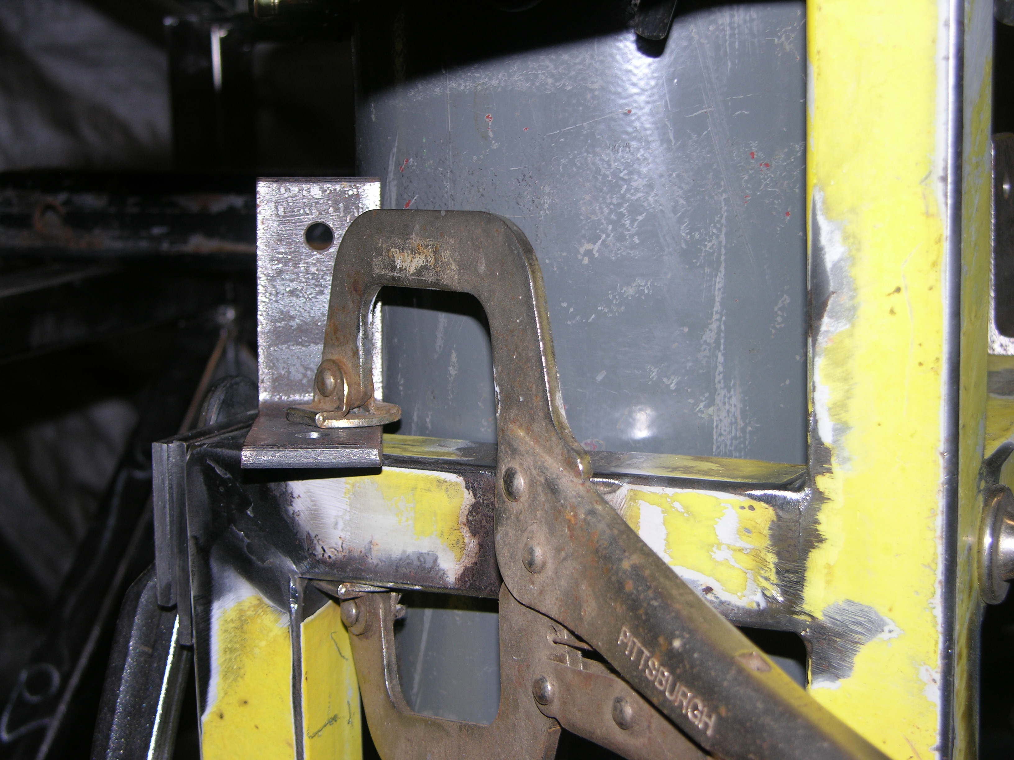

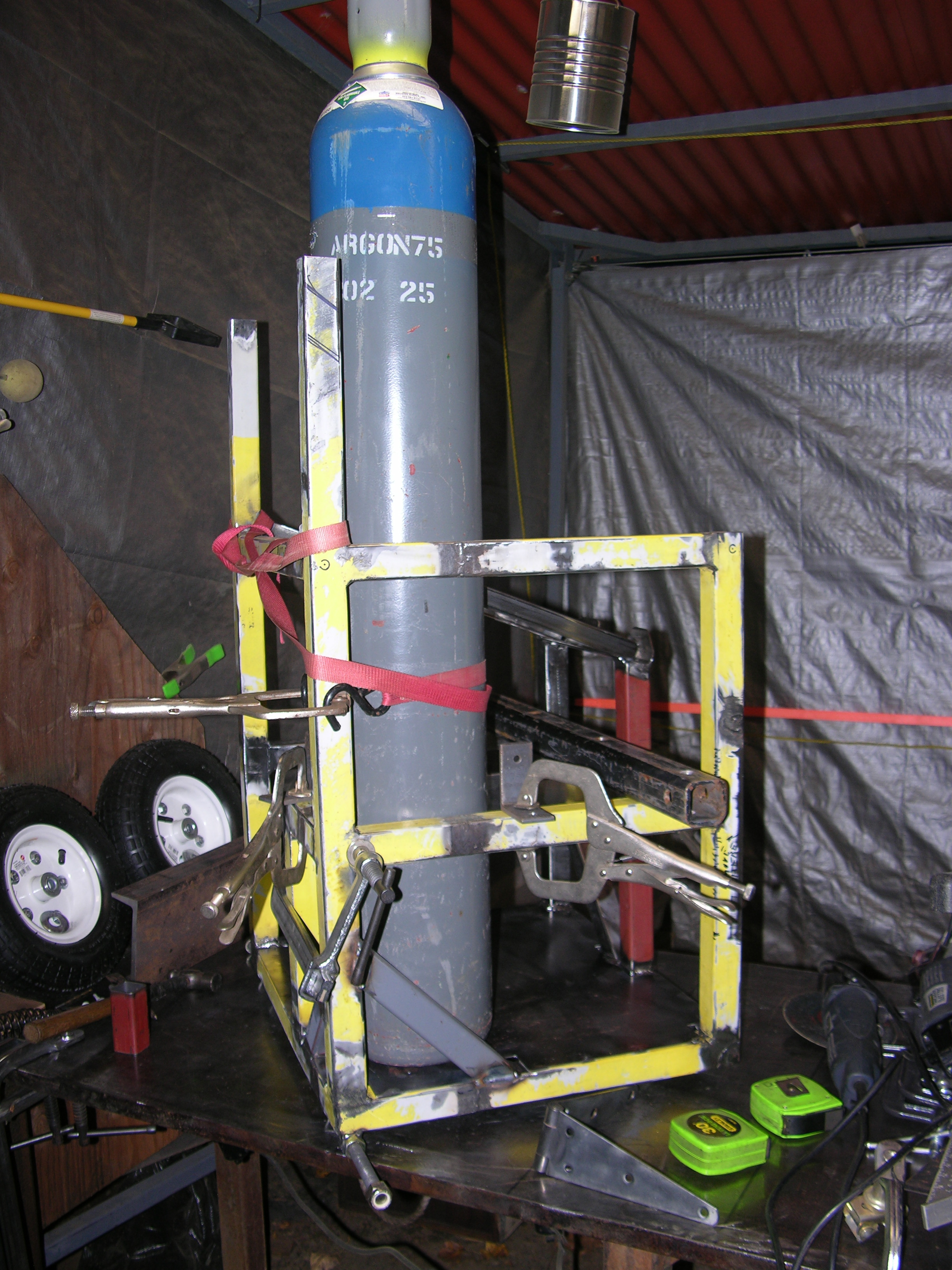

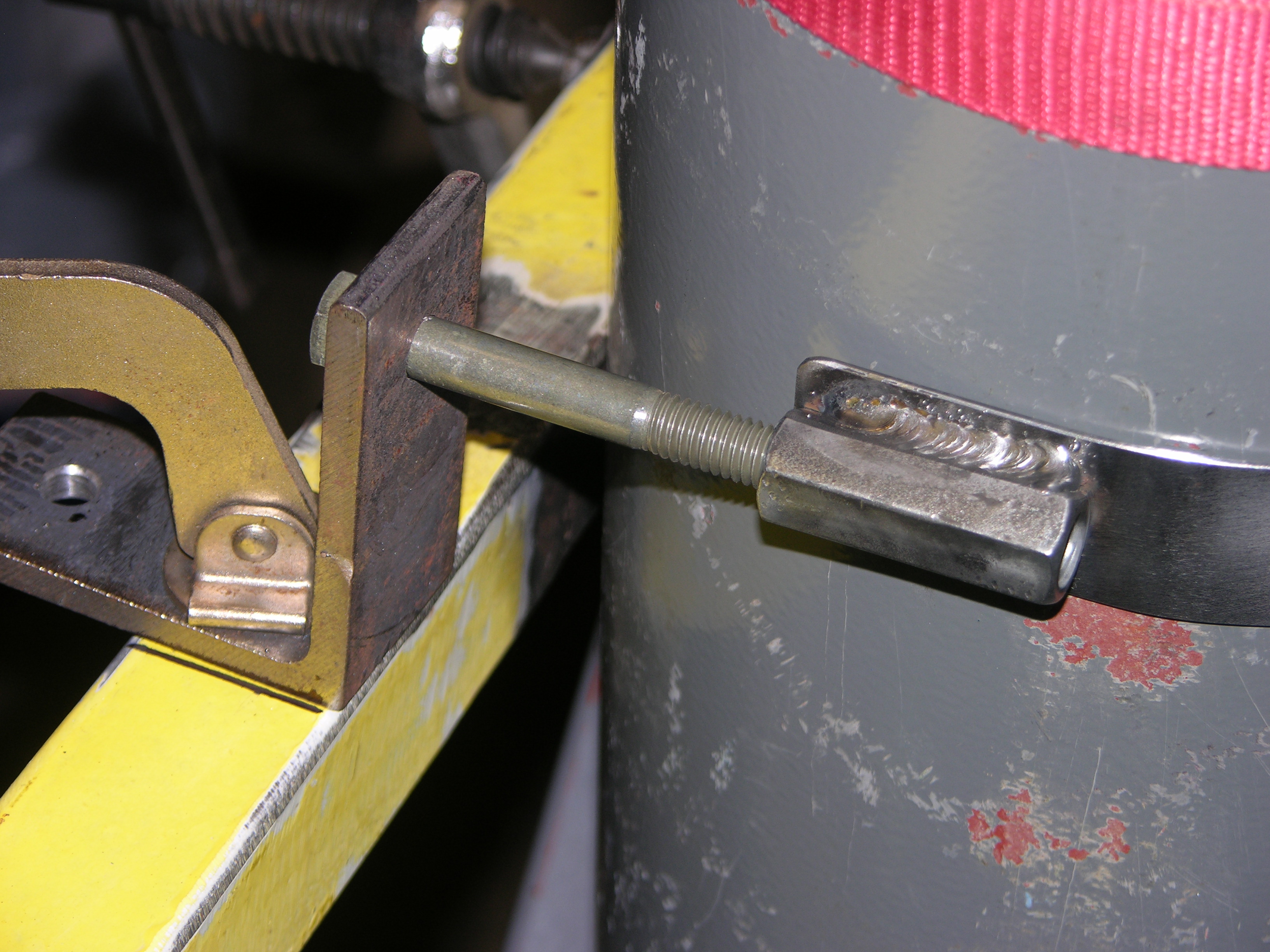

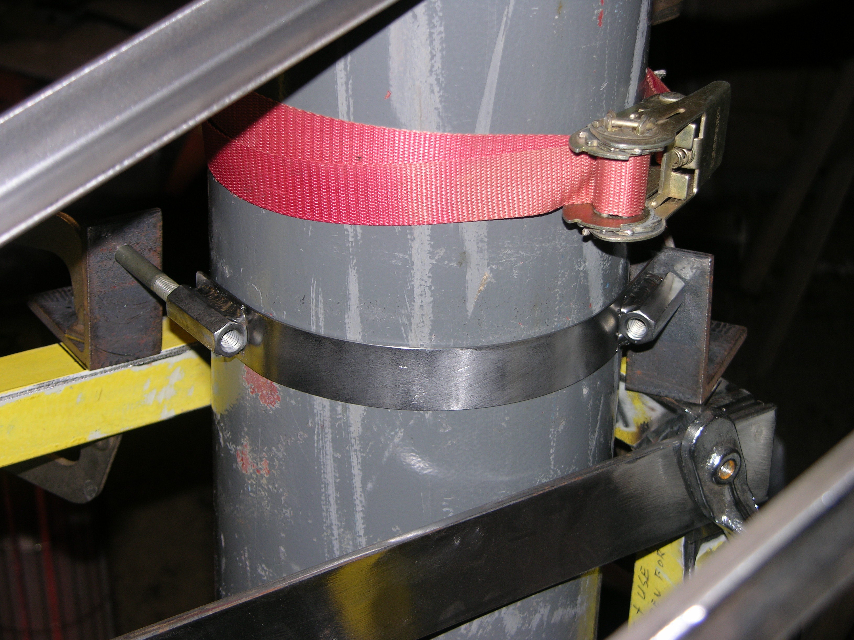

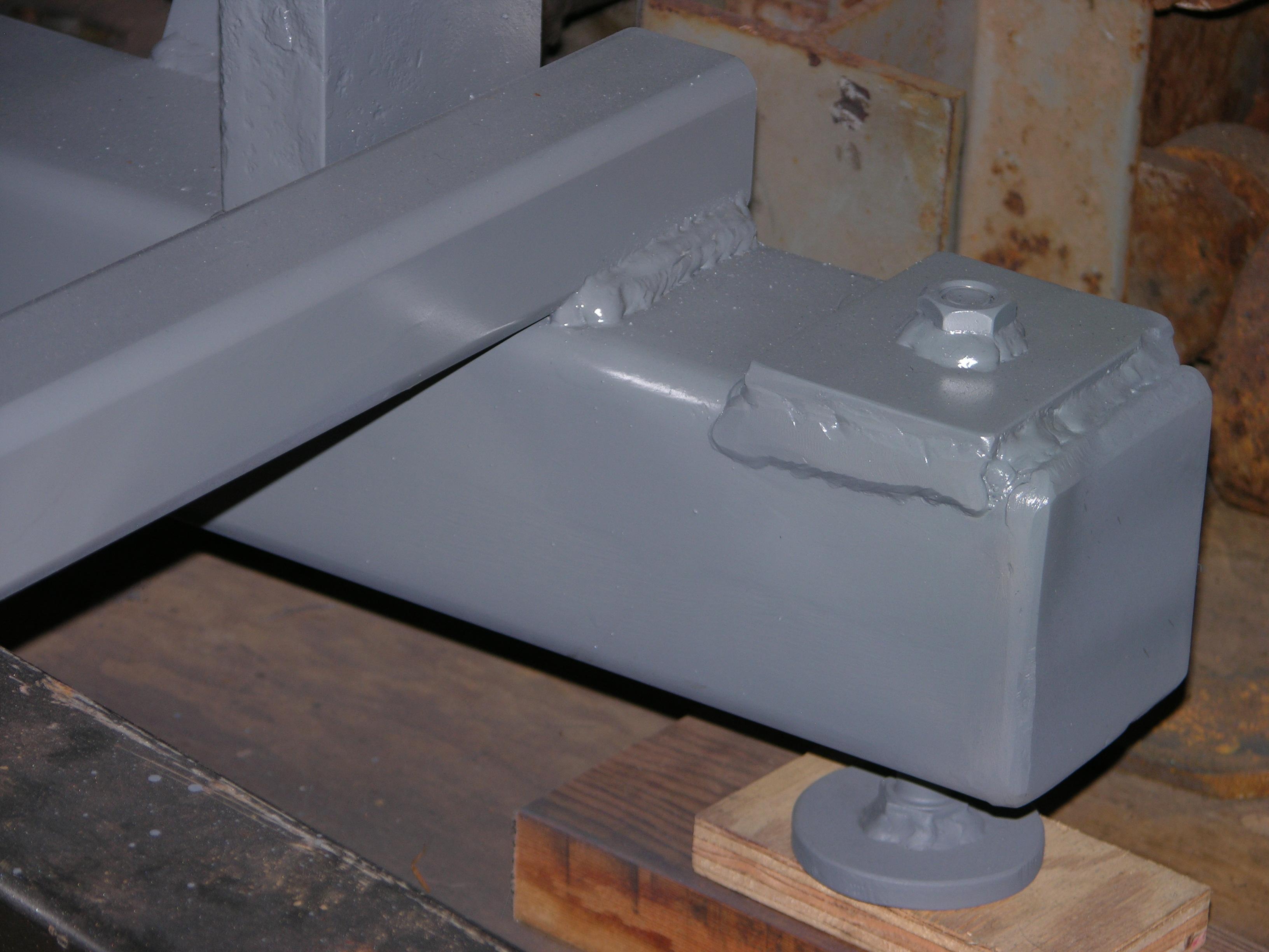

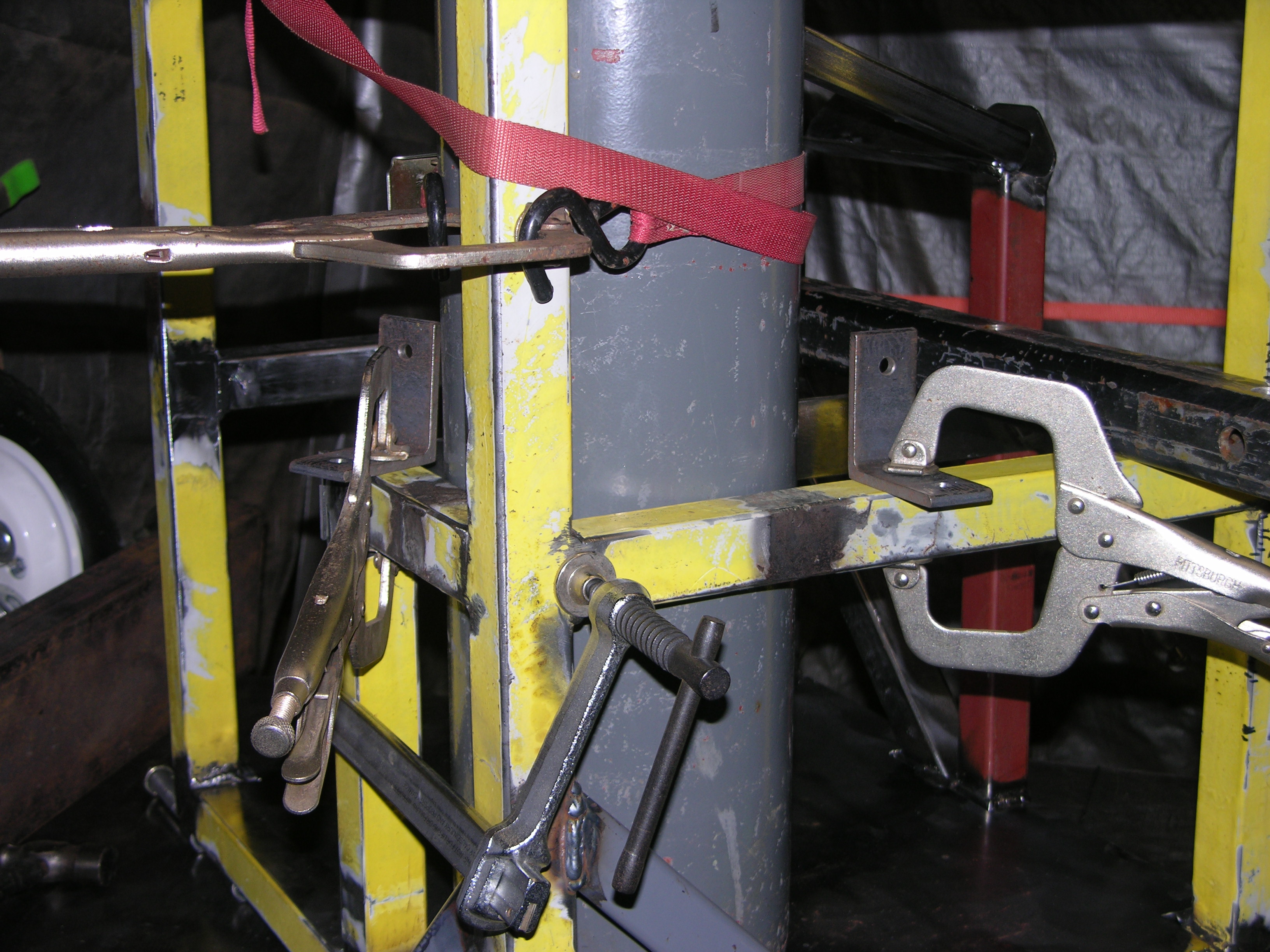

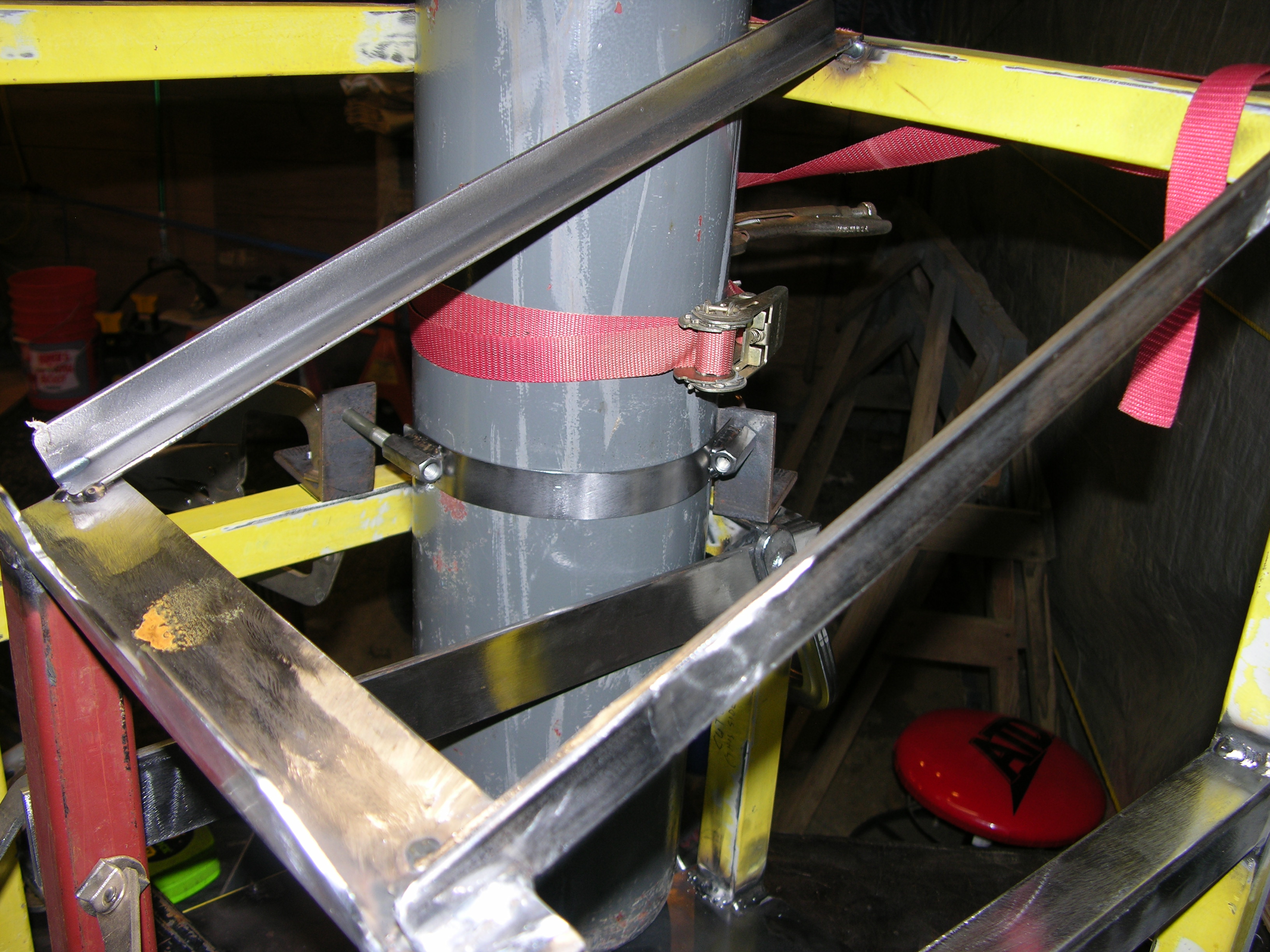

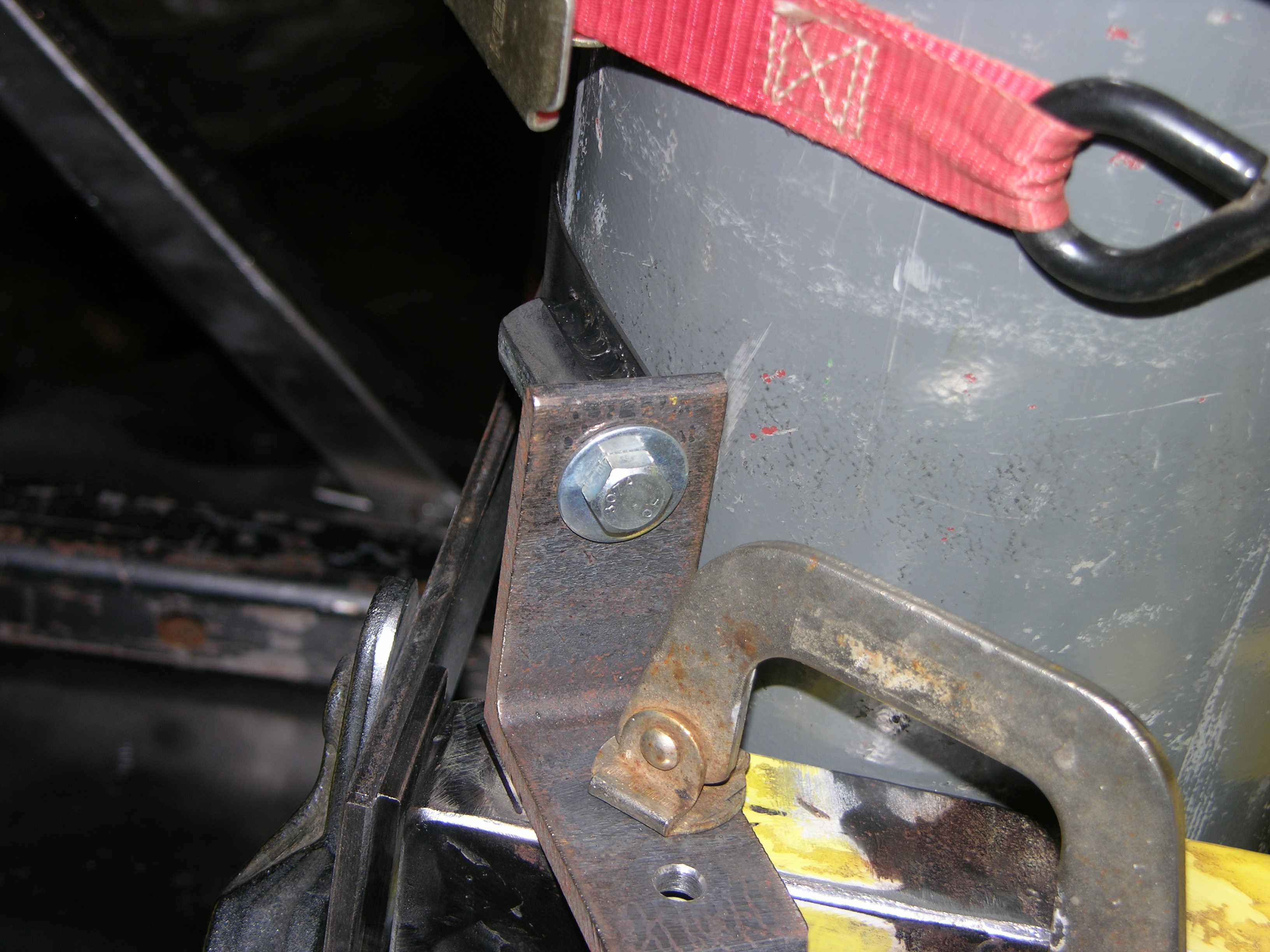

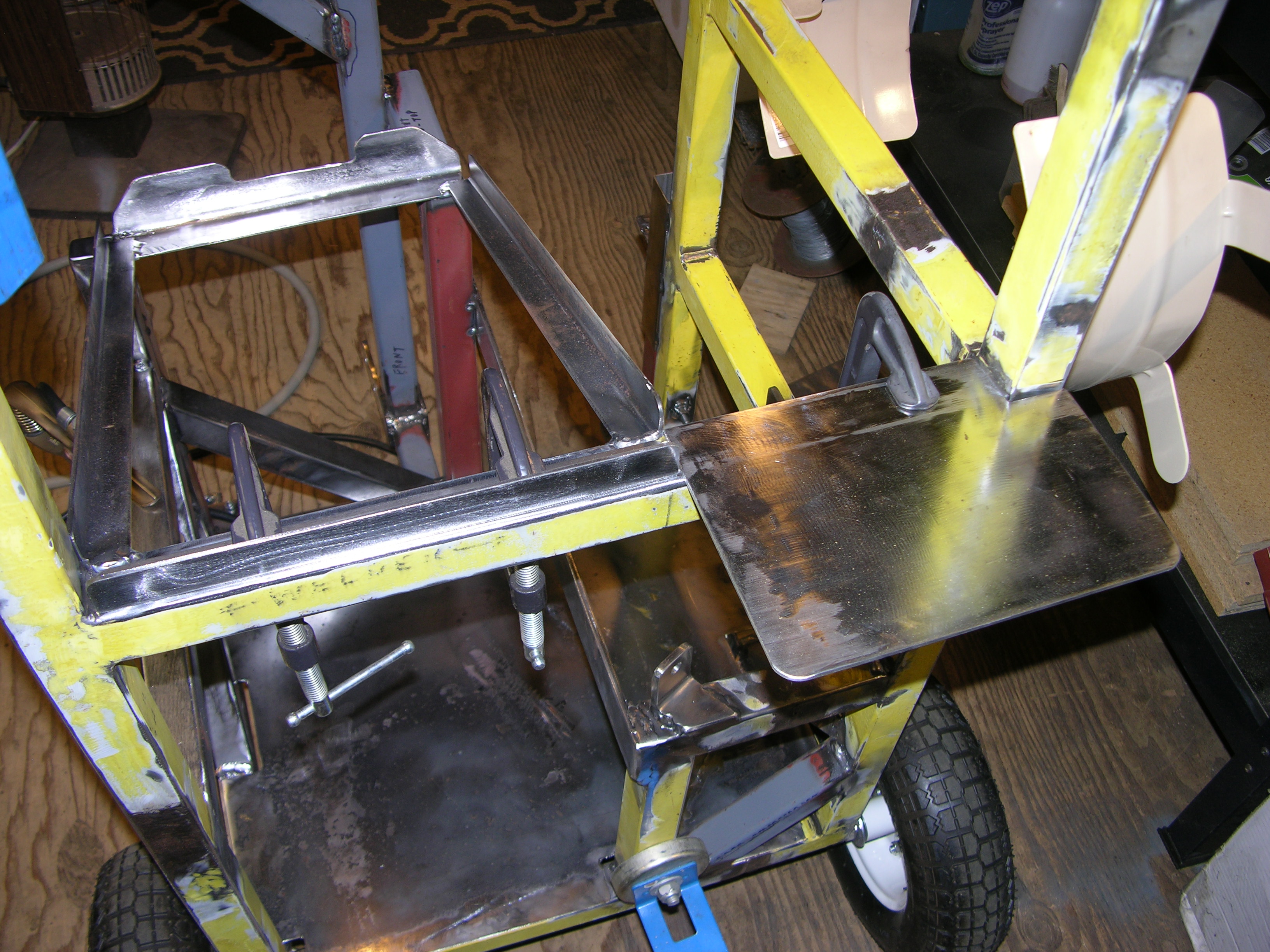

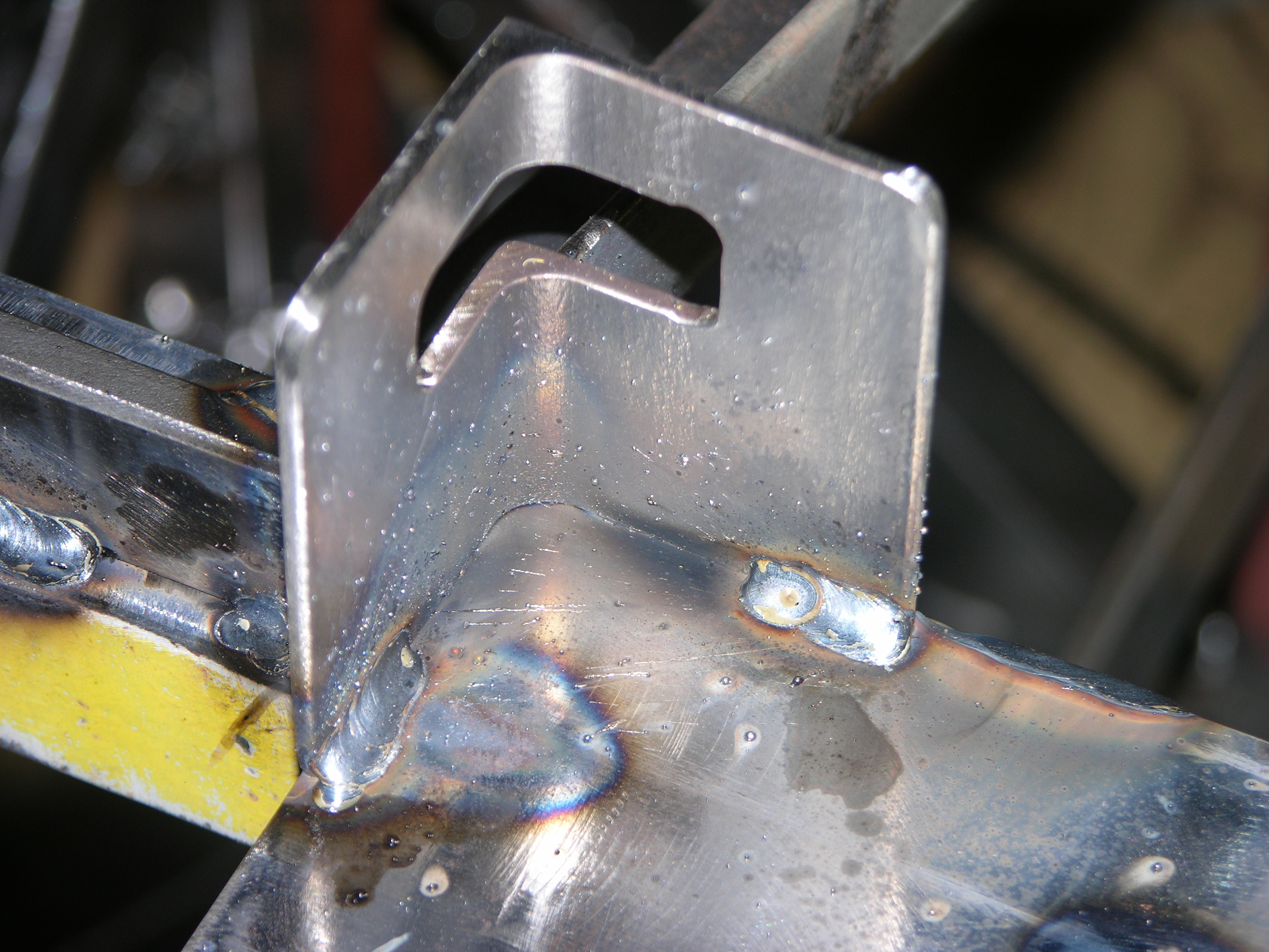

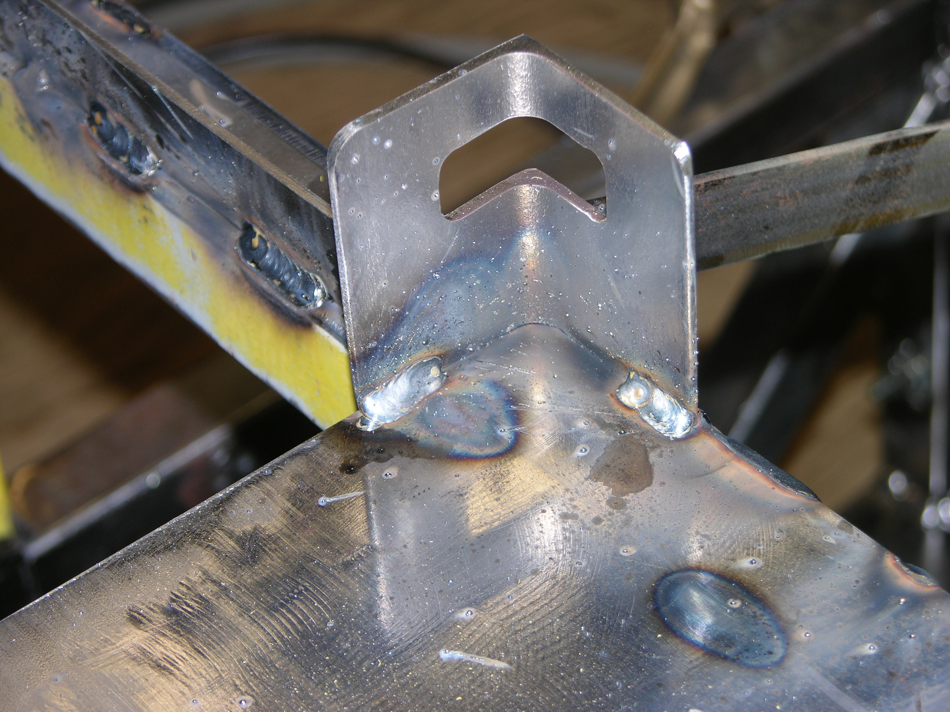

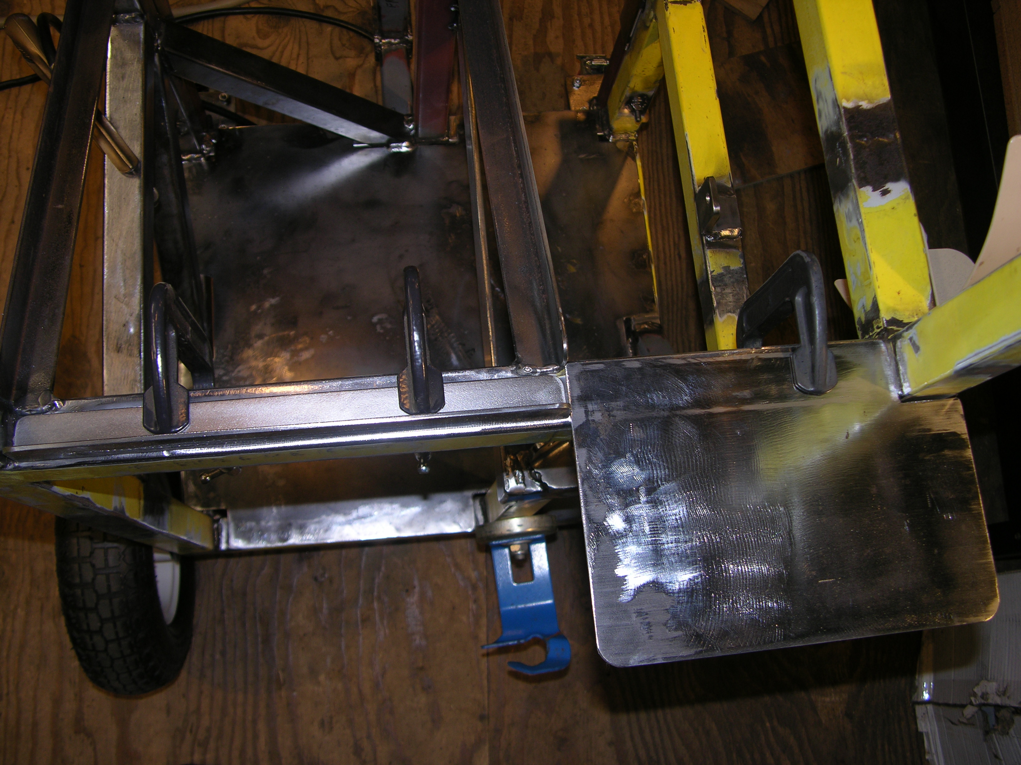

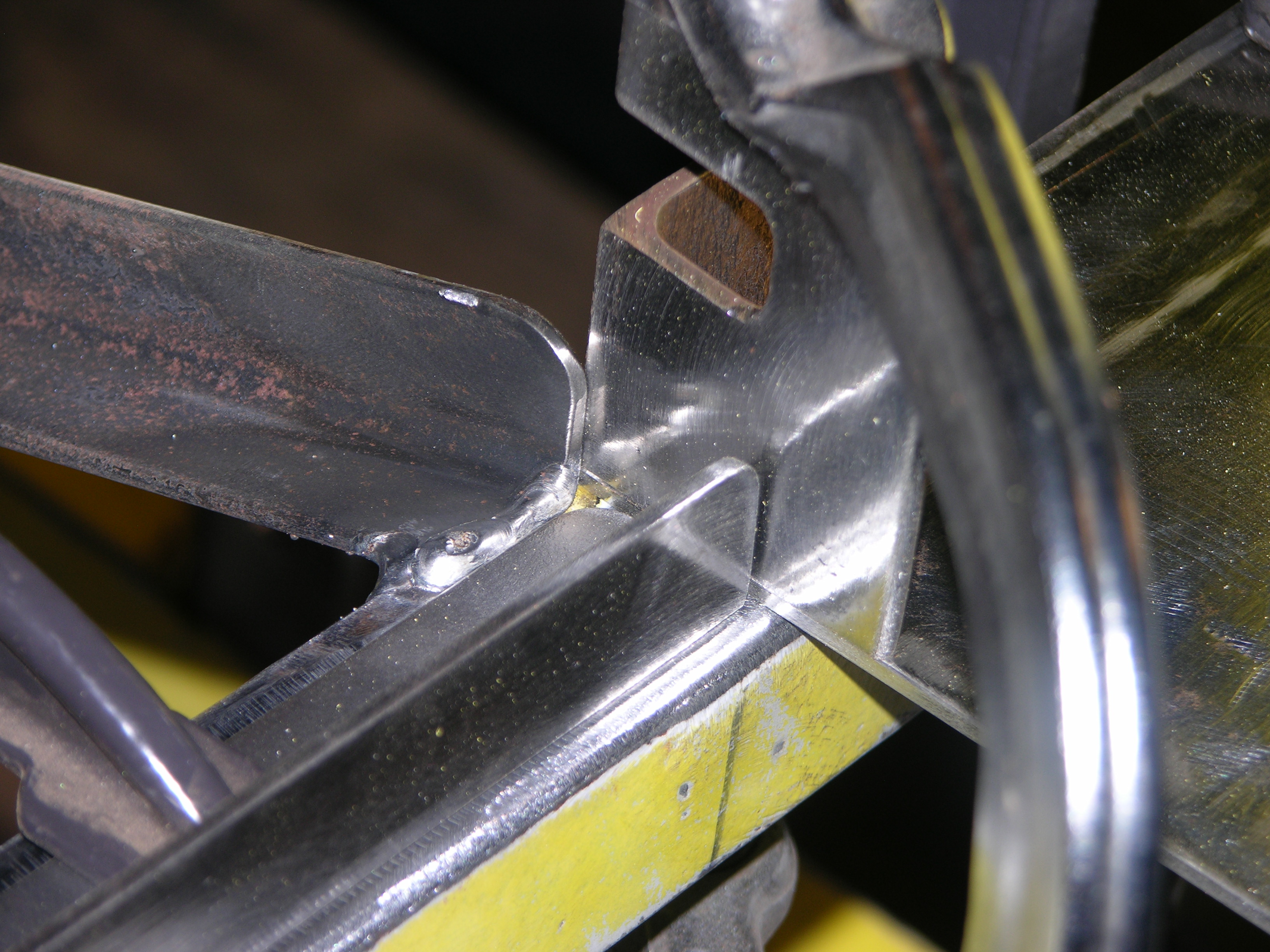

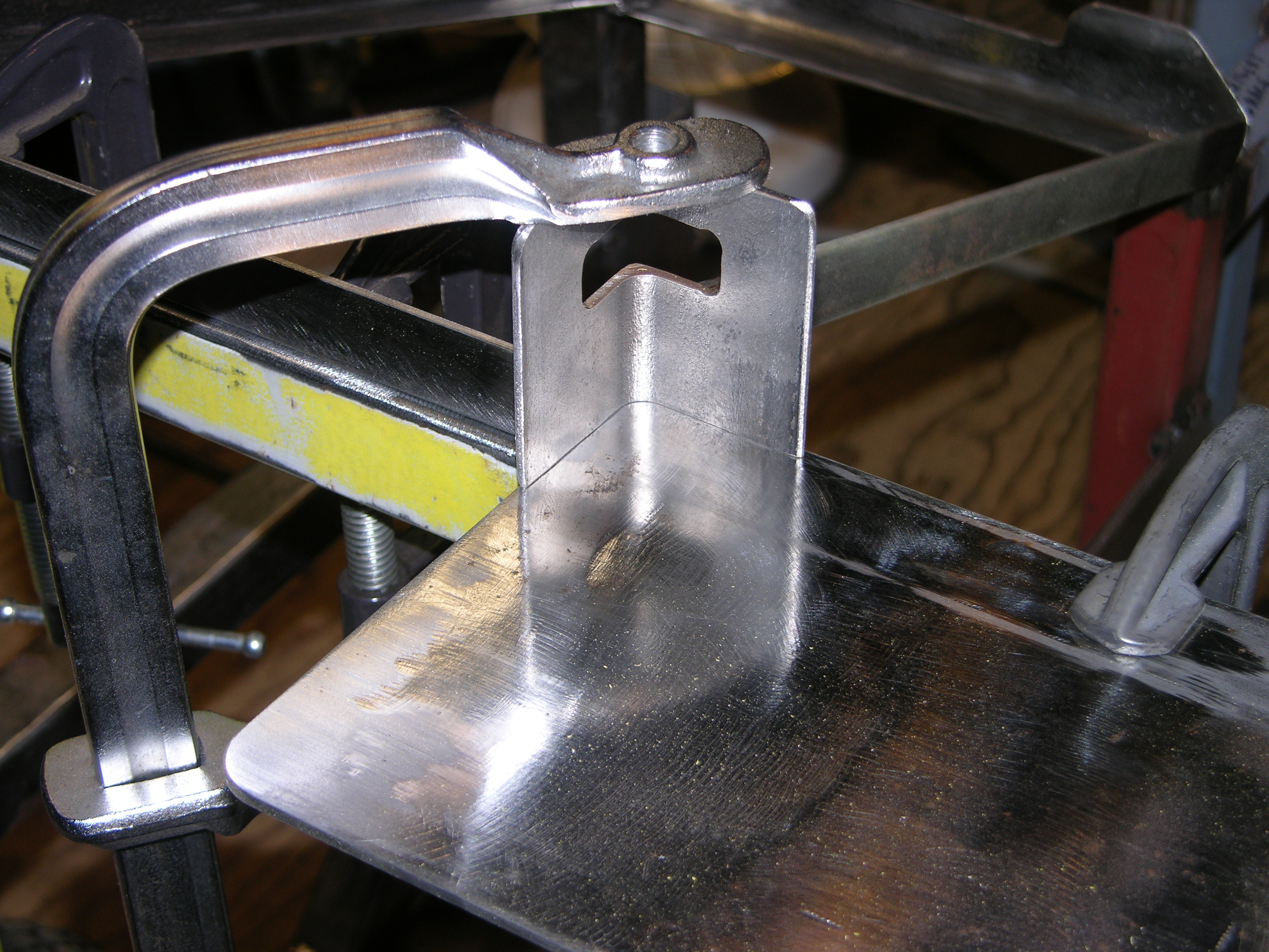

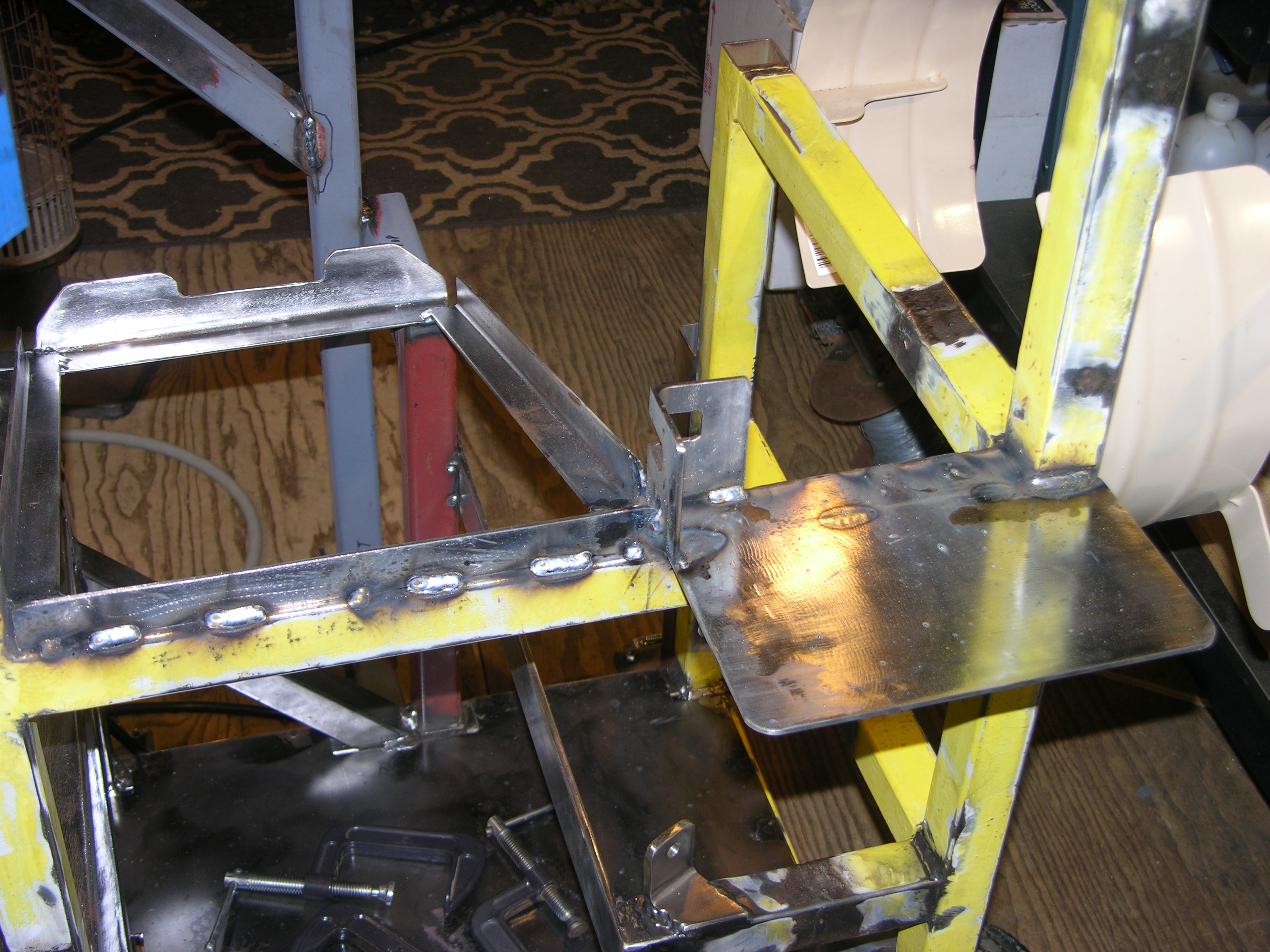

Finally got back to it - pieces for welder front lip and aux. shelf, clamped - DSCN3028.JPGDSCN3029.JPGDSCN3030.JPGDSCN3031.JPGDSCN3032.JPGDSCN3033.JPG -
Welded - DSCN3034.JPGDSCN3035.JPGDSCN3036.JPG - rear view - DSCN3037.JPG -

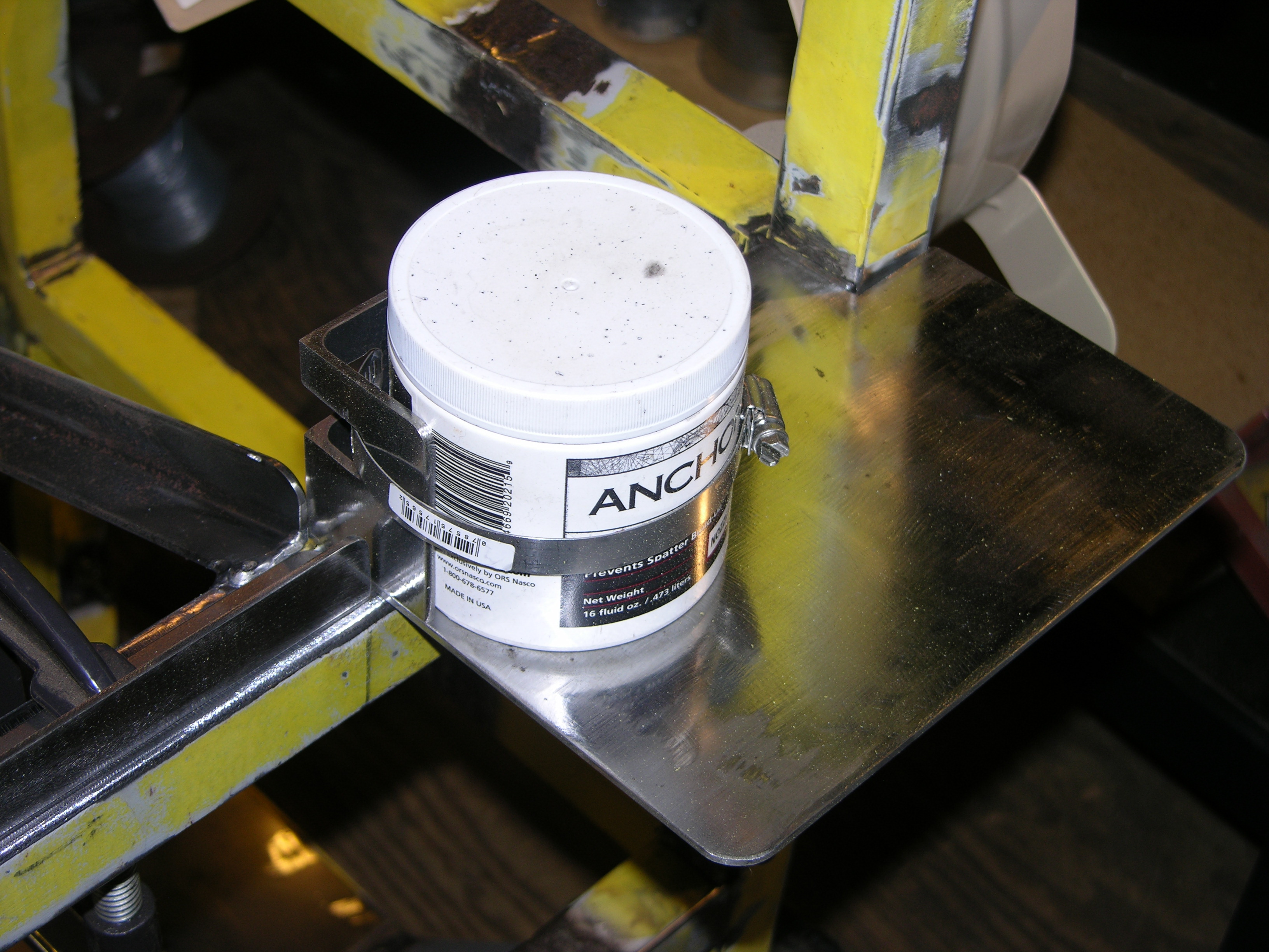

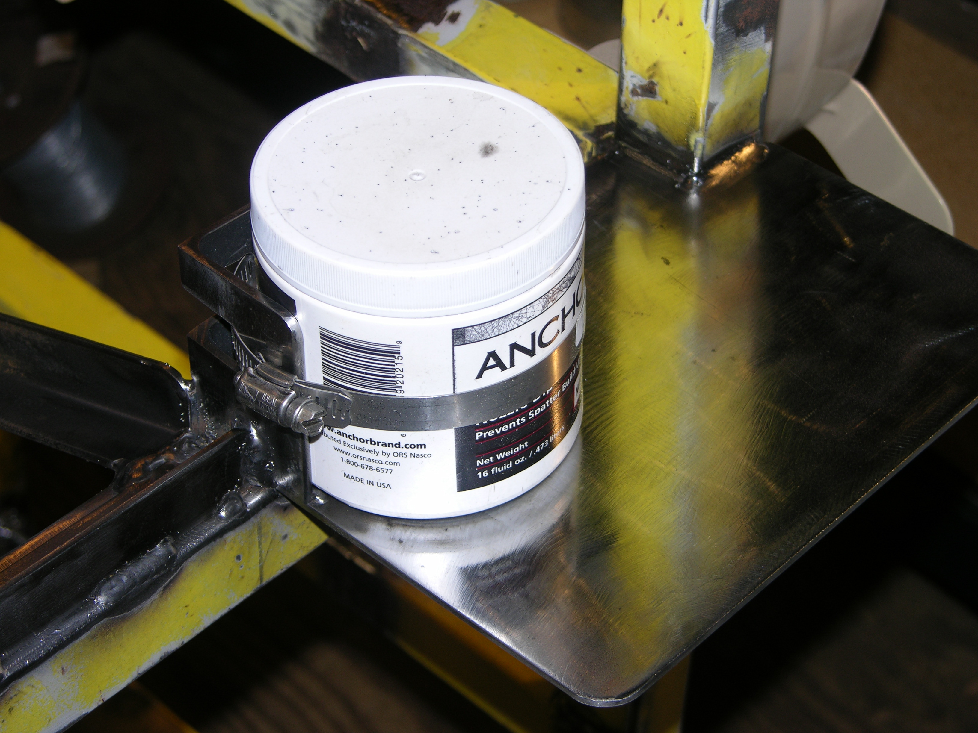

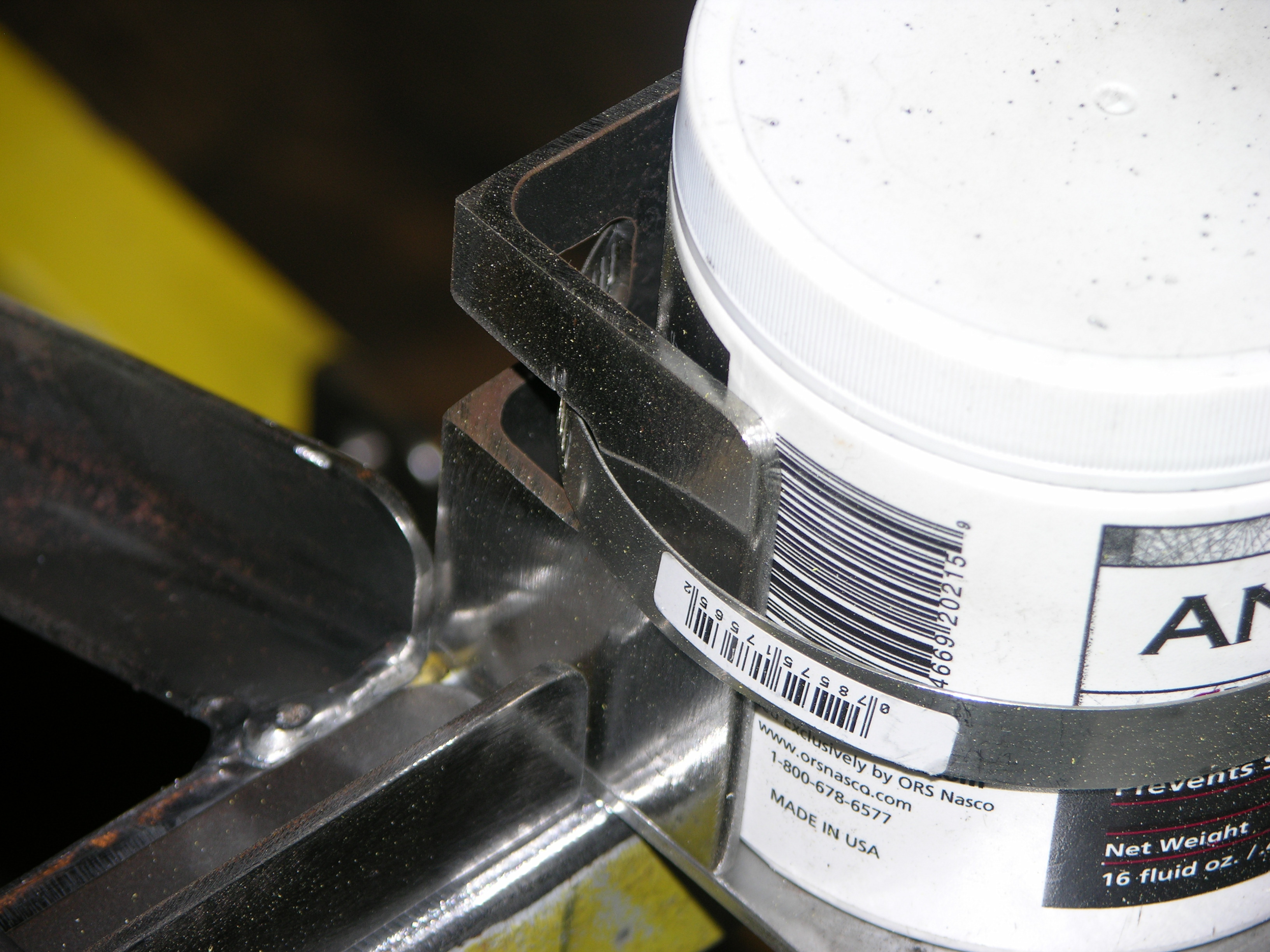

And the (tastefully restrained :D) nozzle gel, with room for temporary accessories (small ones, that is :thumbsup:) DSCN3038.JPG
FYI - the "restraints" will let me R&R the lid WITHOUT having to set the gun down - otherwise, that jar takes two hands to open... Steve

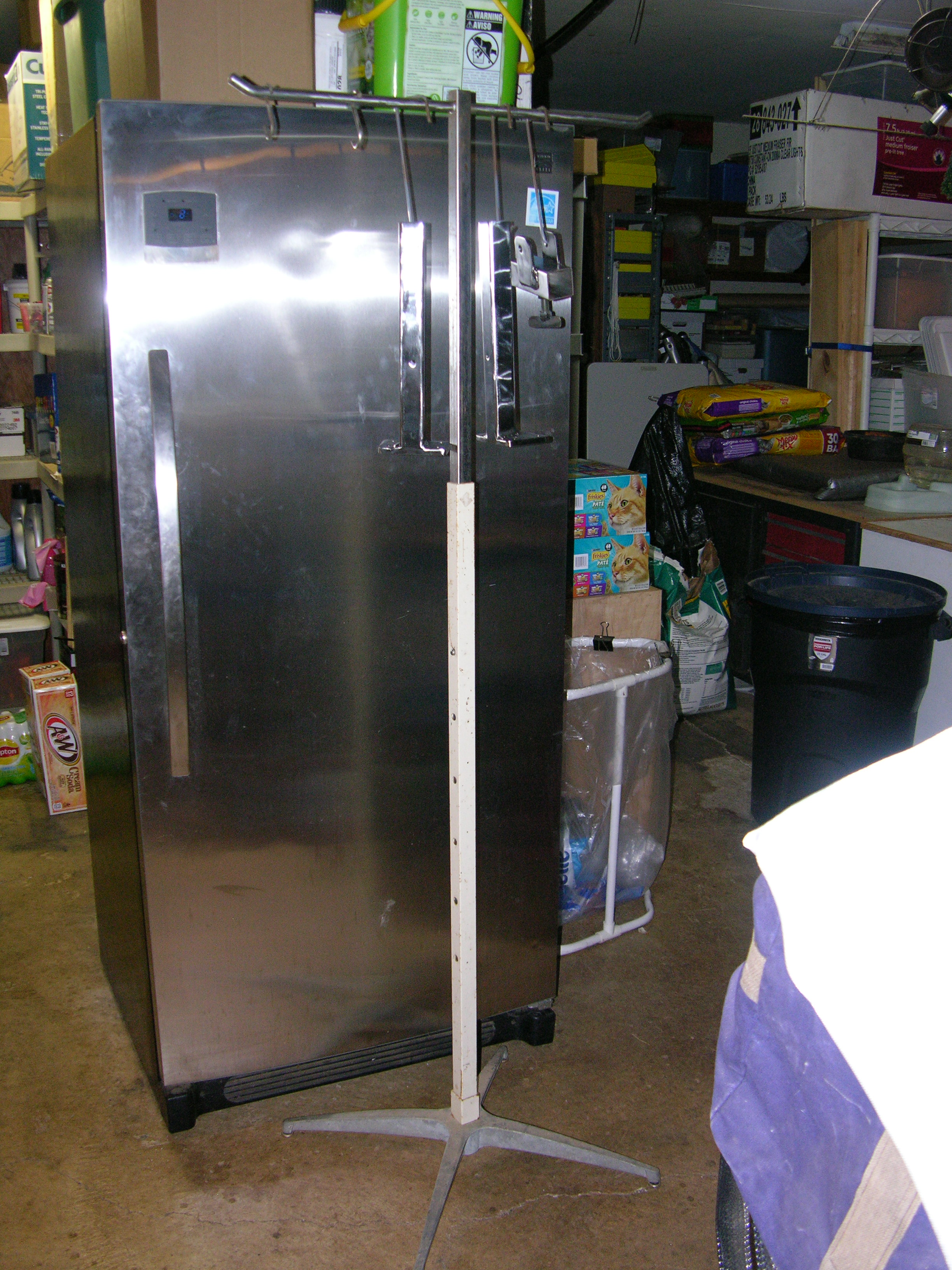

I have 2 different hanger scenarios - for the upright version, I have an old thrift shop find - a base, upright with height adjusting holes every 6" or so, upper piece has a tee out of slightly bigger than 5/8" rod - cross piece is about 3' long and sturdy enough to hold a couple steel pieces each side, at least 100 lbs total maybe more. goes to about 5' high.
For heavier things (like the main frame on the "eternal weld cart") I can hang 'em from my "mini-jib" and use BOTH half-sheets for a lid, one on each side of the winch cable. If they're too tall for that, I have a 1 ton chain hoist hanging from one of the cross pieces in the "porta-shed" I built; 12'x12', roof is 9' to 11' height, hoist is about 9' to the max lift point.
For the horizontal mode (more pieces but not as tall) I have a few sticks of unistrut and TONS of angles, spring nuts, pipe clamps, etc, (a CL deal, $100 for about $250 worth of strut and about 250# of fittings, total worth around $2k)) so a few minutes with a couple wrenches and a rattle gun and it's a done deal.
I buy 3/16" gas welding rod at my LWS (used to get 1/4" too, no longer available) I call that stuff my "mil-spec coat hanger", use it for all kinds of band-aids that're too much for mechanic's wire - in this case, I'll make up a bunch of hanger hooks; they'll fit either the solid rod on my thrift store hanger or thru the holes in the unistrut. Even the 1/8" weld rod will support at least 50 pounds per hook.

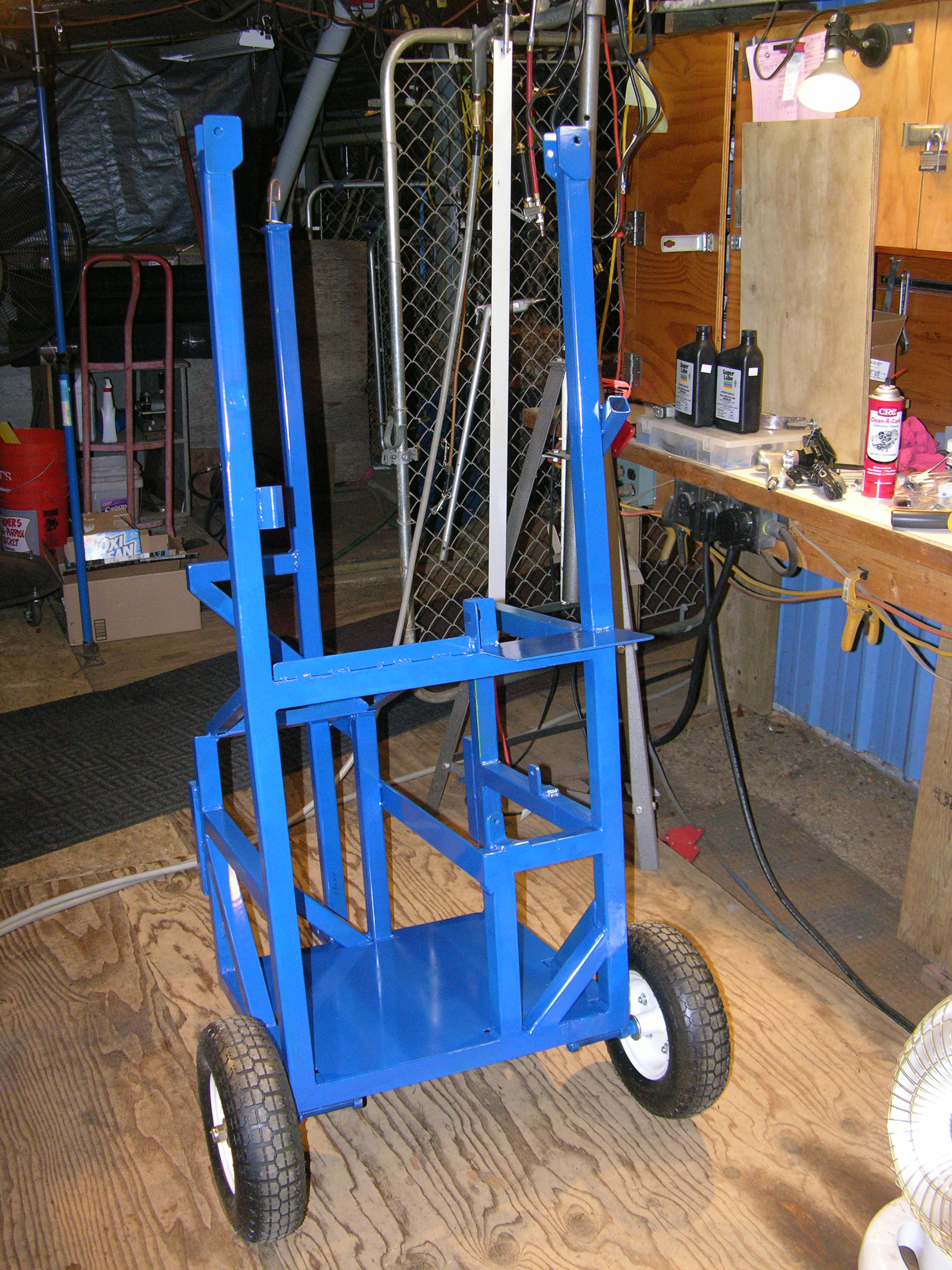

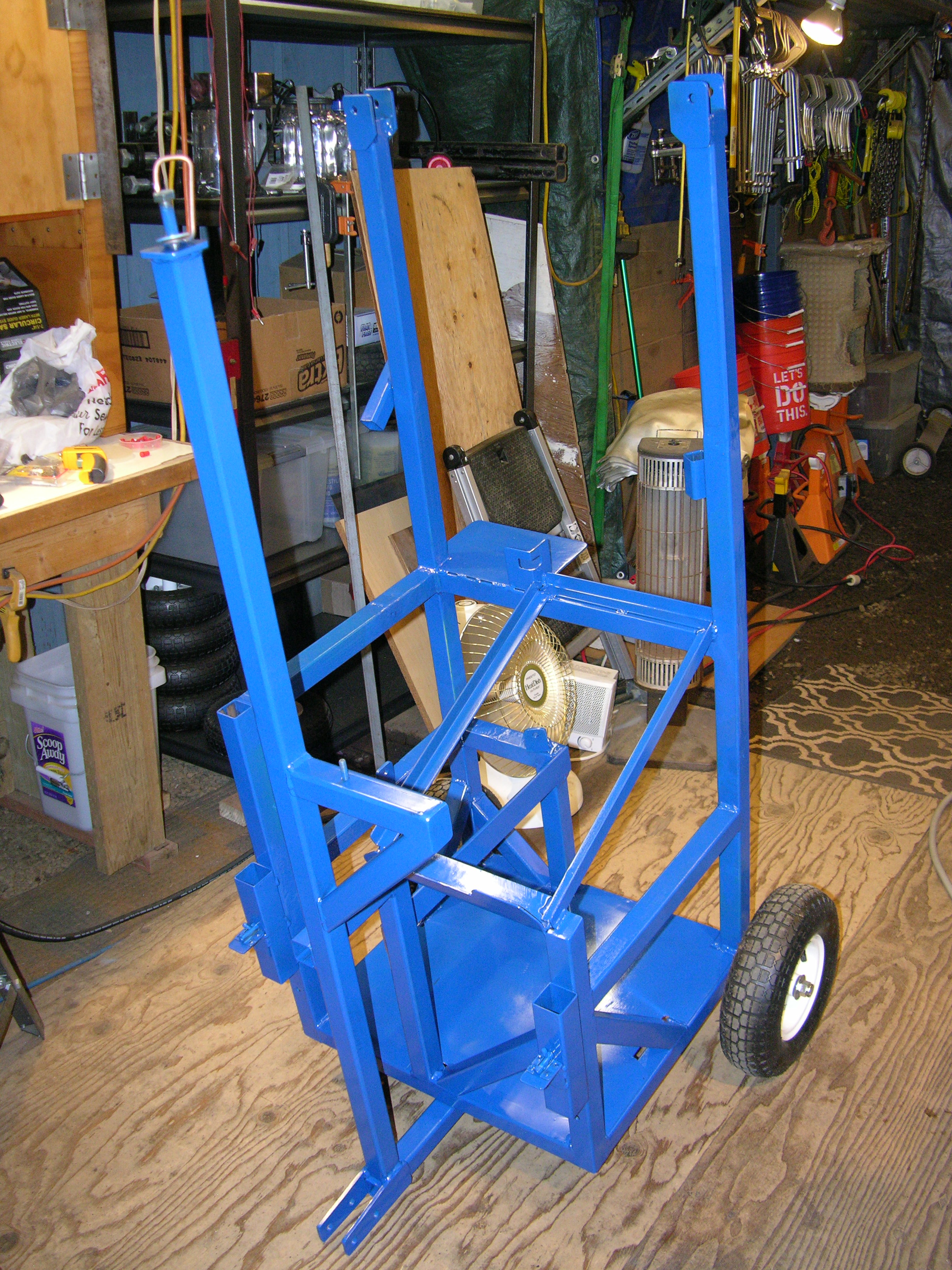

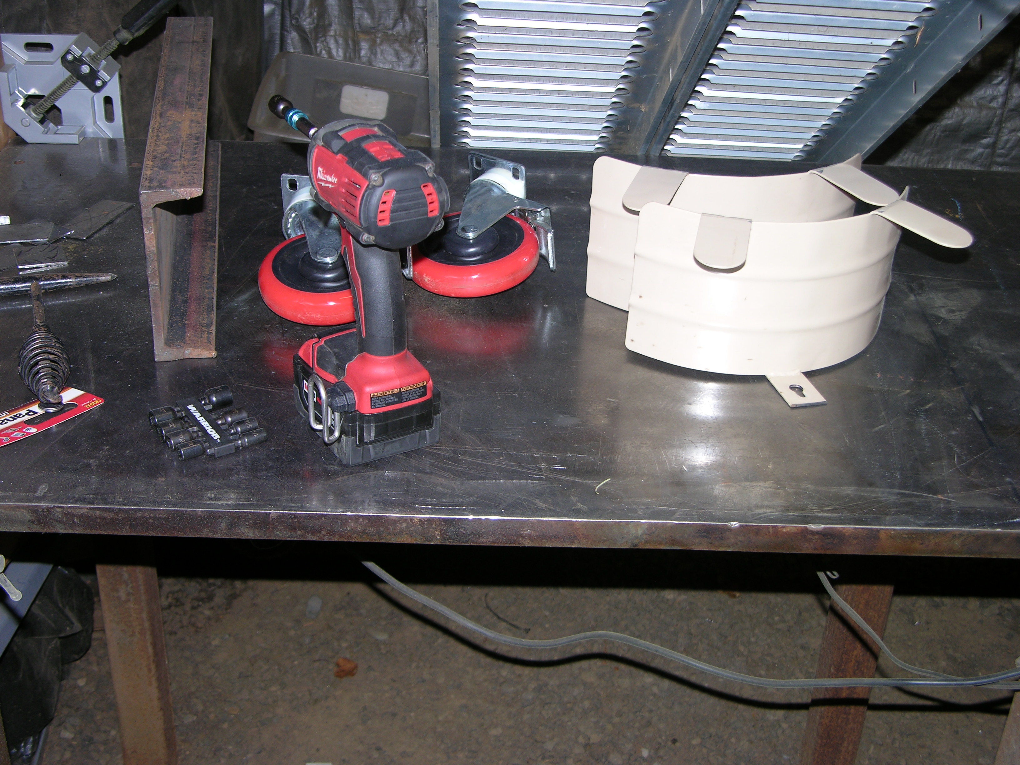

Well, it finally warmed up enough to get a little painting done - DSCN3039.JPGDSCN3040.JPG - and a couple smaller parts ready to paint - DSCN3041.JPGDSCN3042.JPG - And some that still need "shinified" - DSCN3043.JPGDSCN3044.JPG - manana's 'sposed to be warm (above 50) too, might actually get somethin' done TWO days in a row :rolleyes: ...Steve
