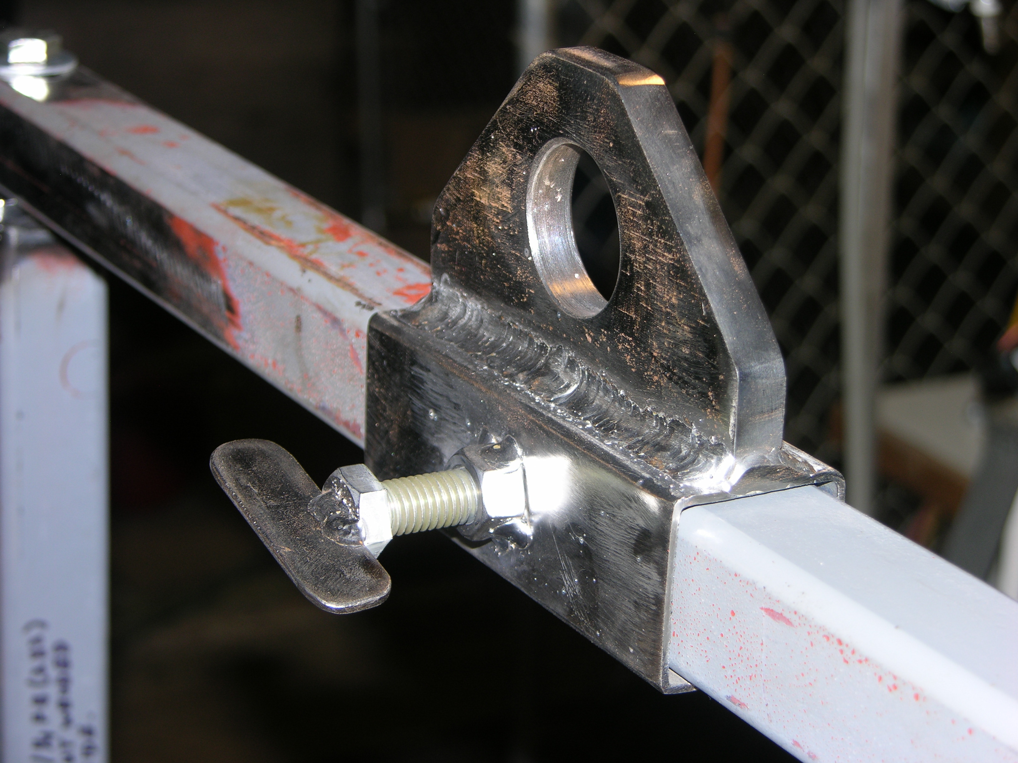

#82

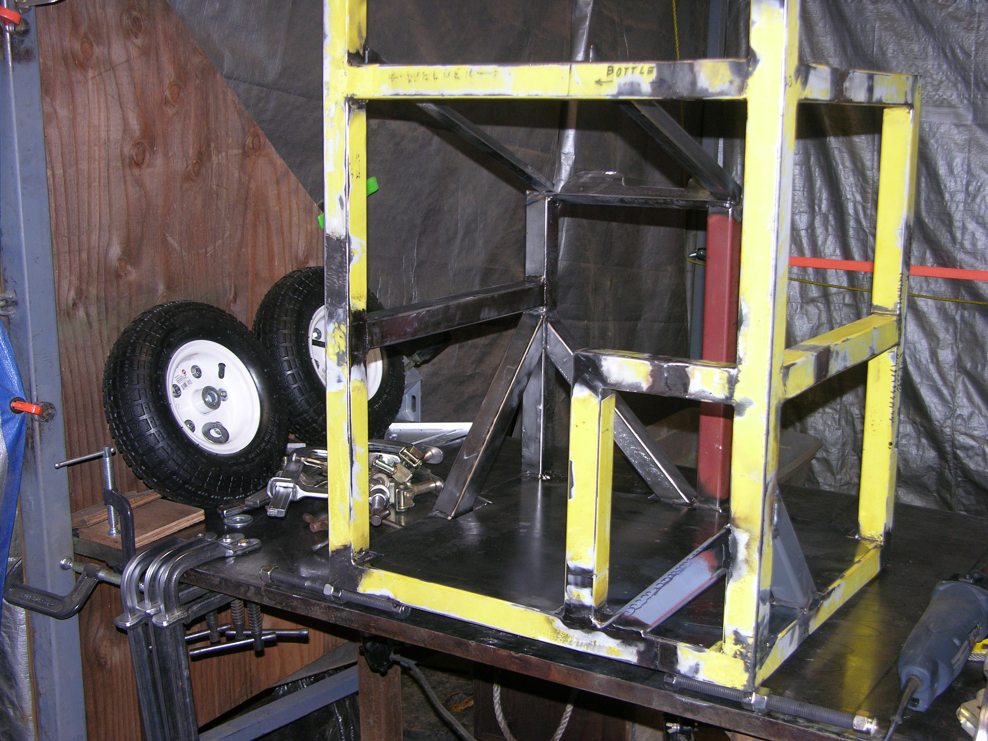

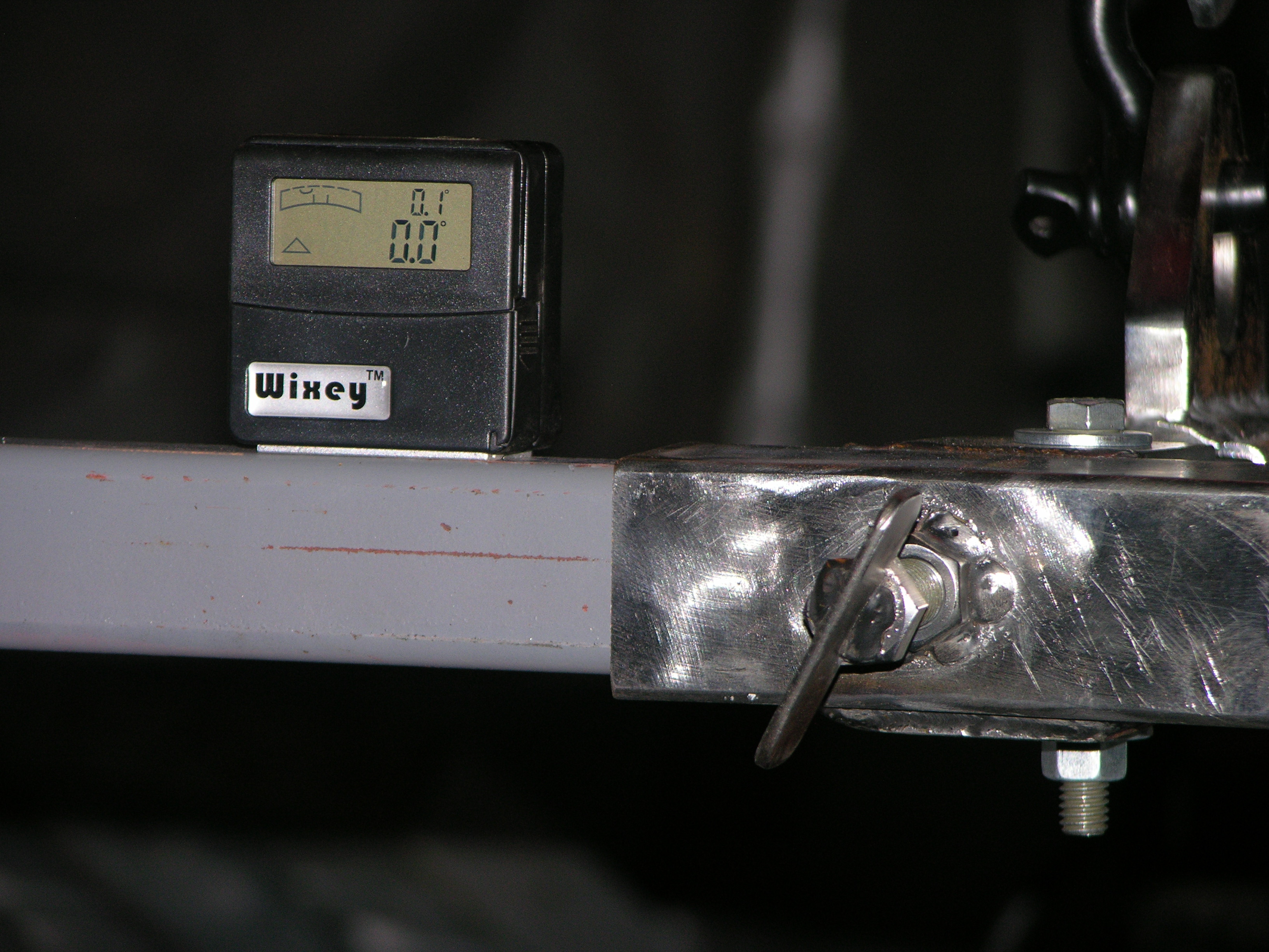

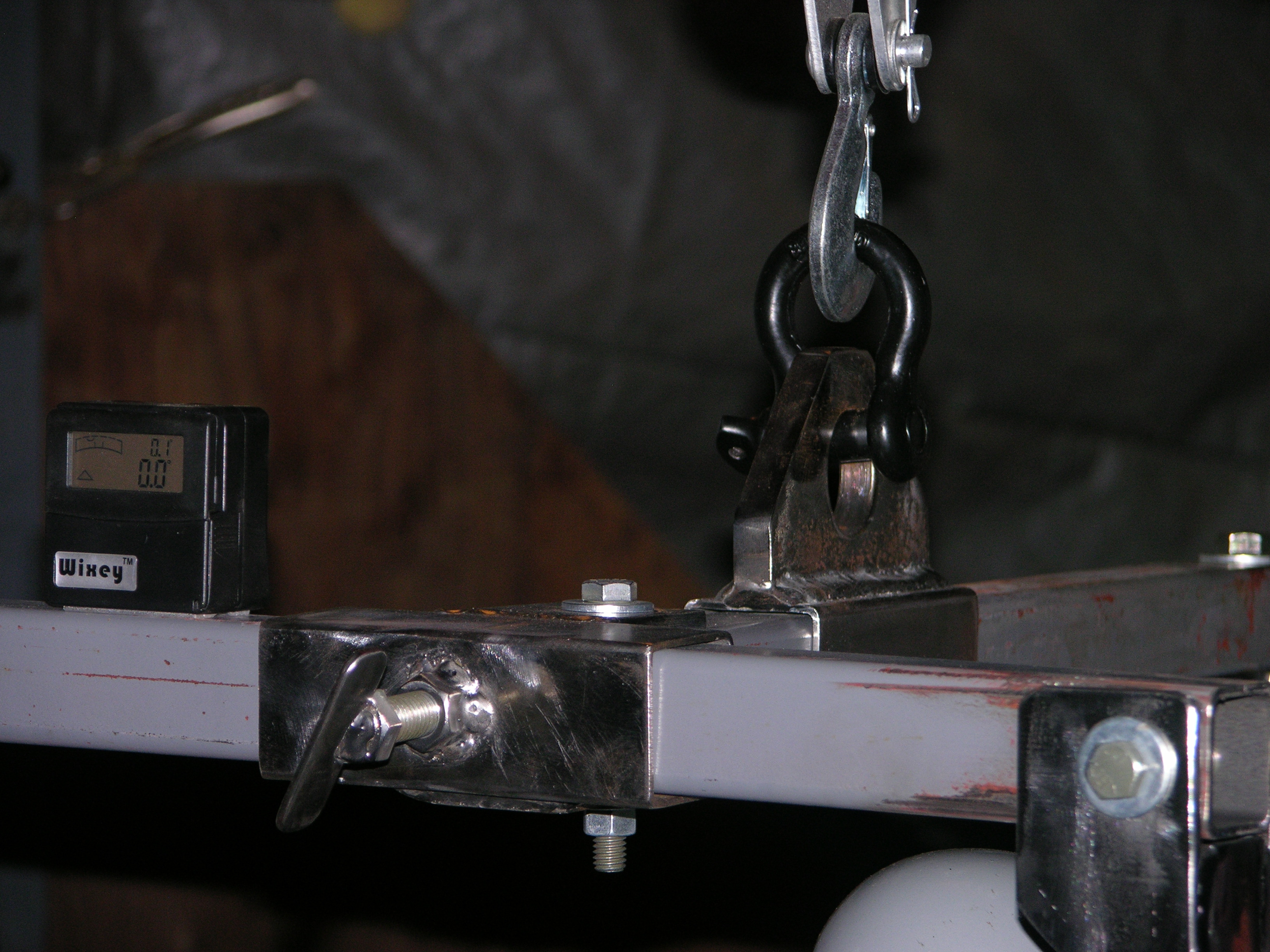

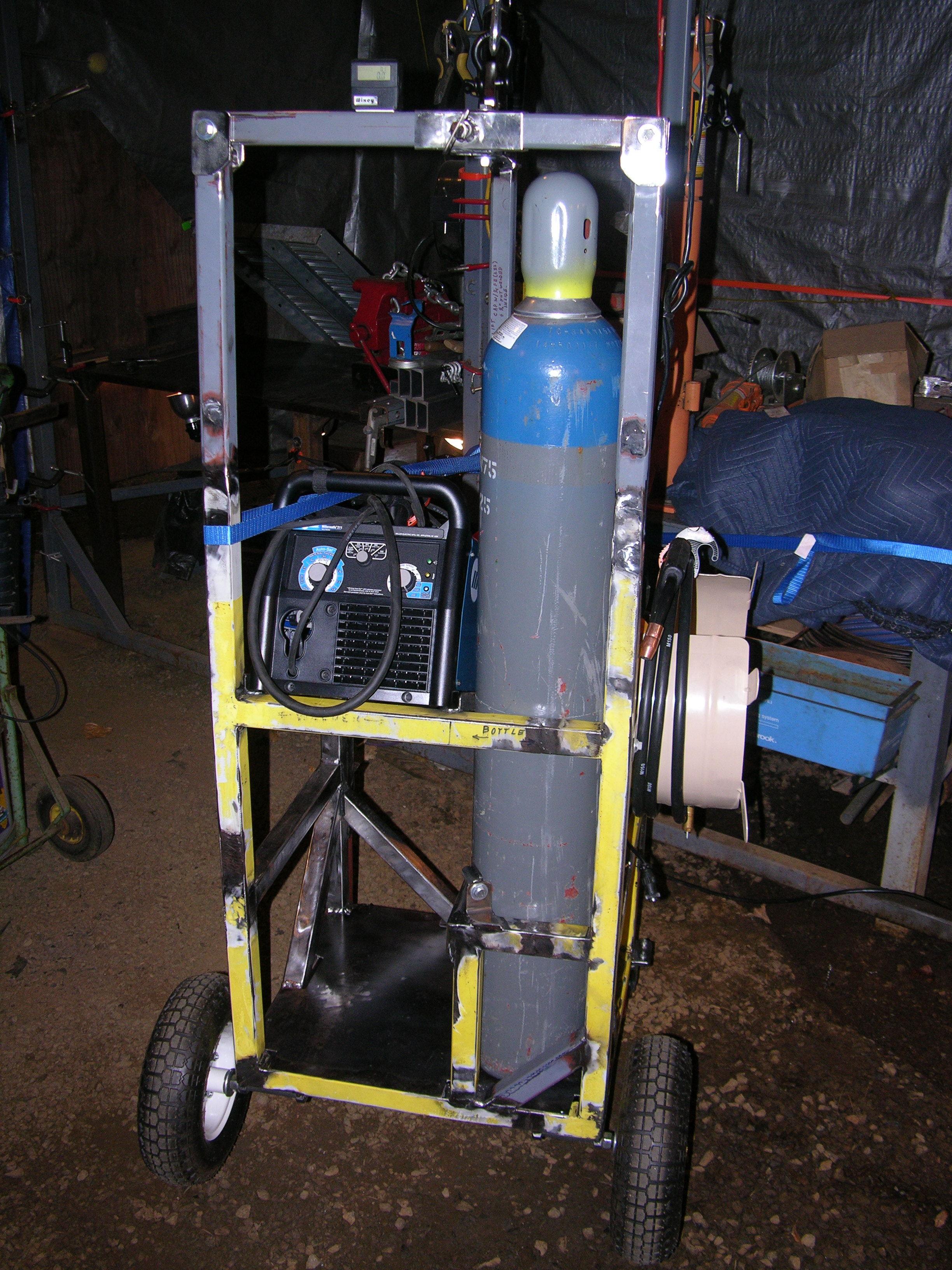

Freezing rain today, all of my various work areas are un-insulated and mostly un-heated - so I picked the smallest area, ran a 240 volt cord to it for my biggest (6kw) electric heater, and finished welding up the various subassemblies - got them clamped in place but I'll need to lay the cart on its front in order to get/keep things lined up til I can tack it all - decided I'd had enough of Ma Nature for one day, so grabbed a few pics and came back in the house.
Front overall view - DSCN2982.JPG - rear overall view - DSCN2983.JPG - side to side balance adjust - DSCN2984.JPG - Lifting eye/forward/aft balancer - DSCN2985.JPG - Other side of lifting eye - DSCN2986.JPG - Upper view of sideways balancer - DSCN2988.JPG - The underside of same - DSCN2989.JPG - Closeup of one of the handtruck handle mounts, will get welded where that clamp is - those thin pieces are just to keep those joints from getting too tight from the welds, will be removed afterward. DSCN2991.JPG - And finally, the rear sliding mount for the lifting tube (you can just see that in the background in the pic of the lifting eye lock screw)DSCN2992.JPG
That's it for now, feet are about thawed out so it's time to watch a couple episodes of CSI - hope to get more done manana, not sure what Mrs. Bukit's planning though :D ...Steve

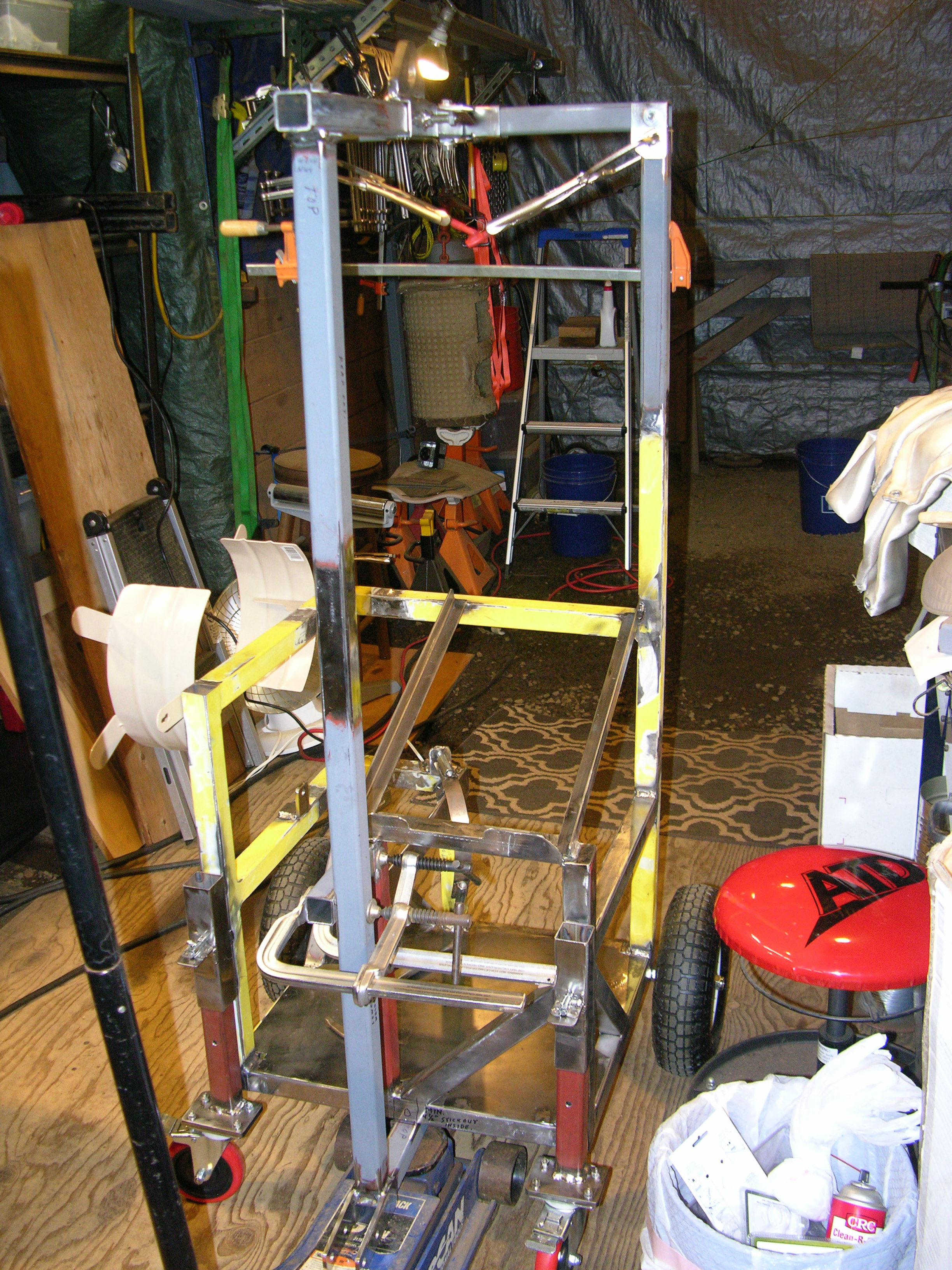

#83

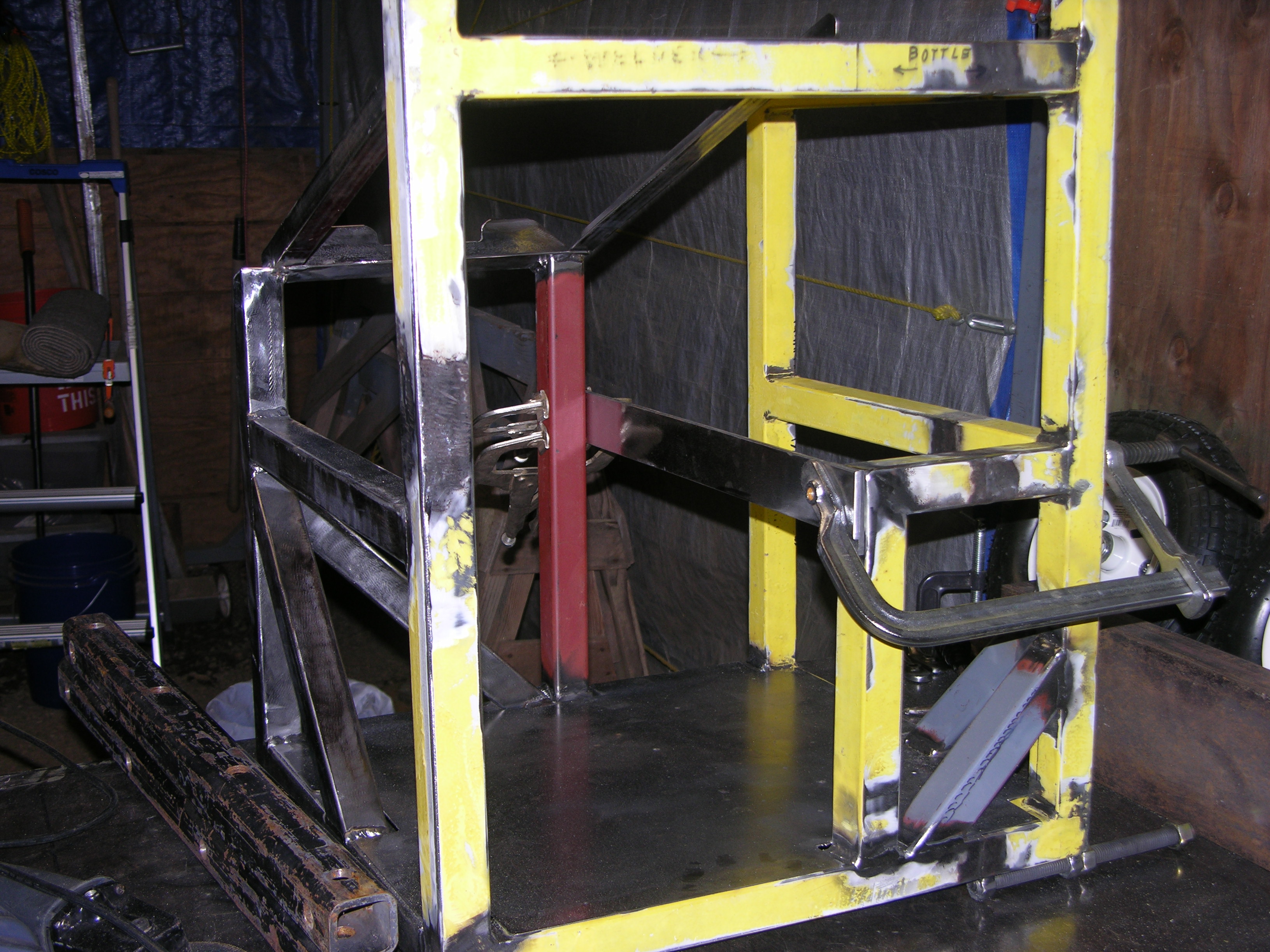

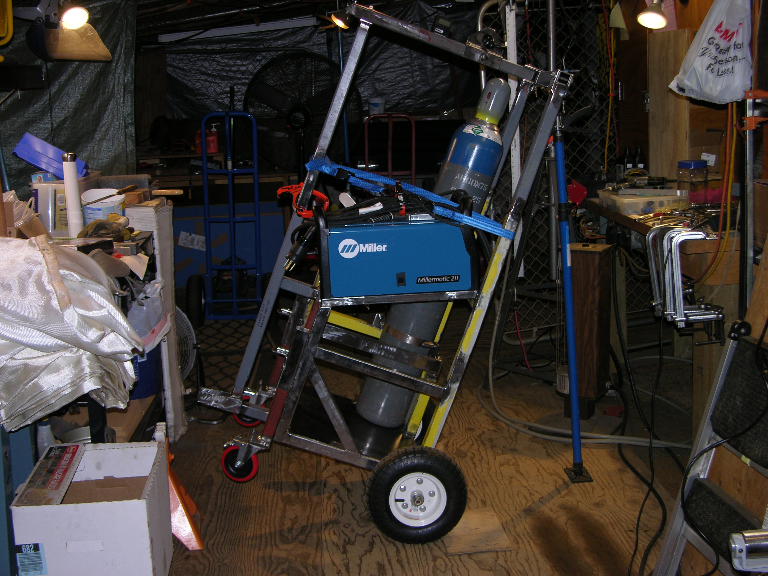

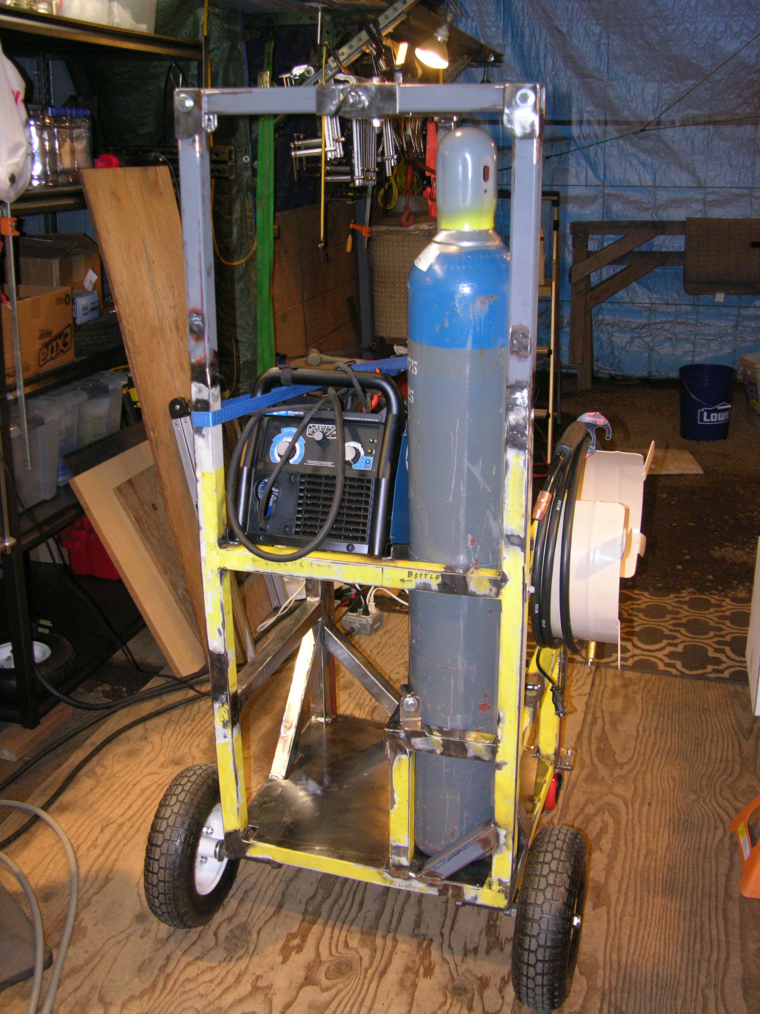

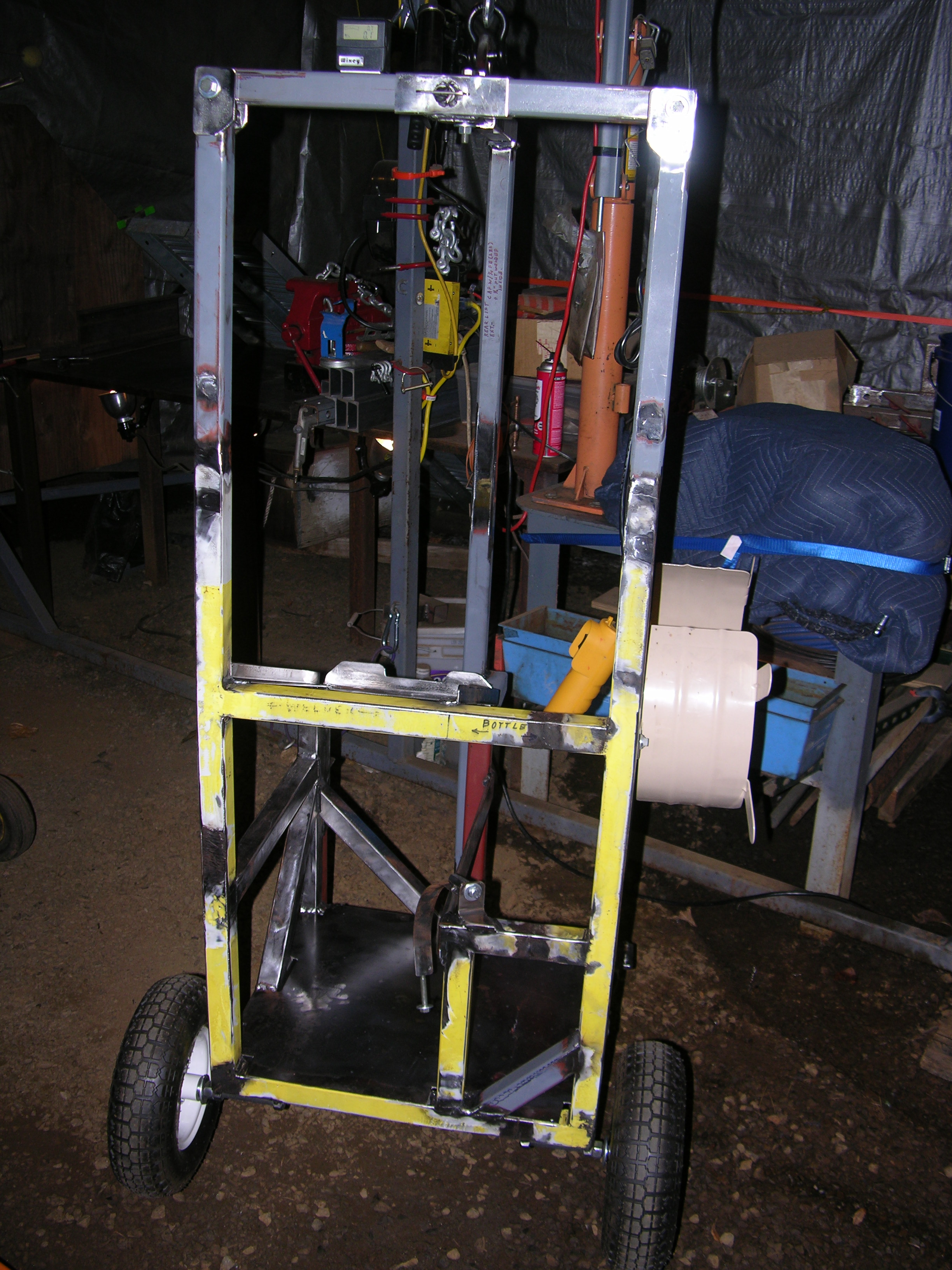

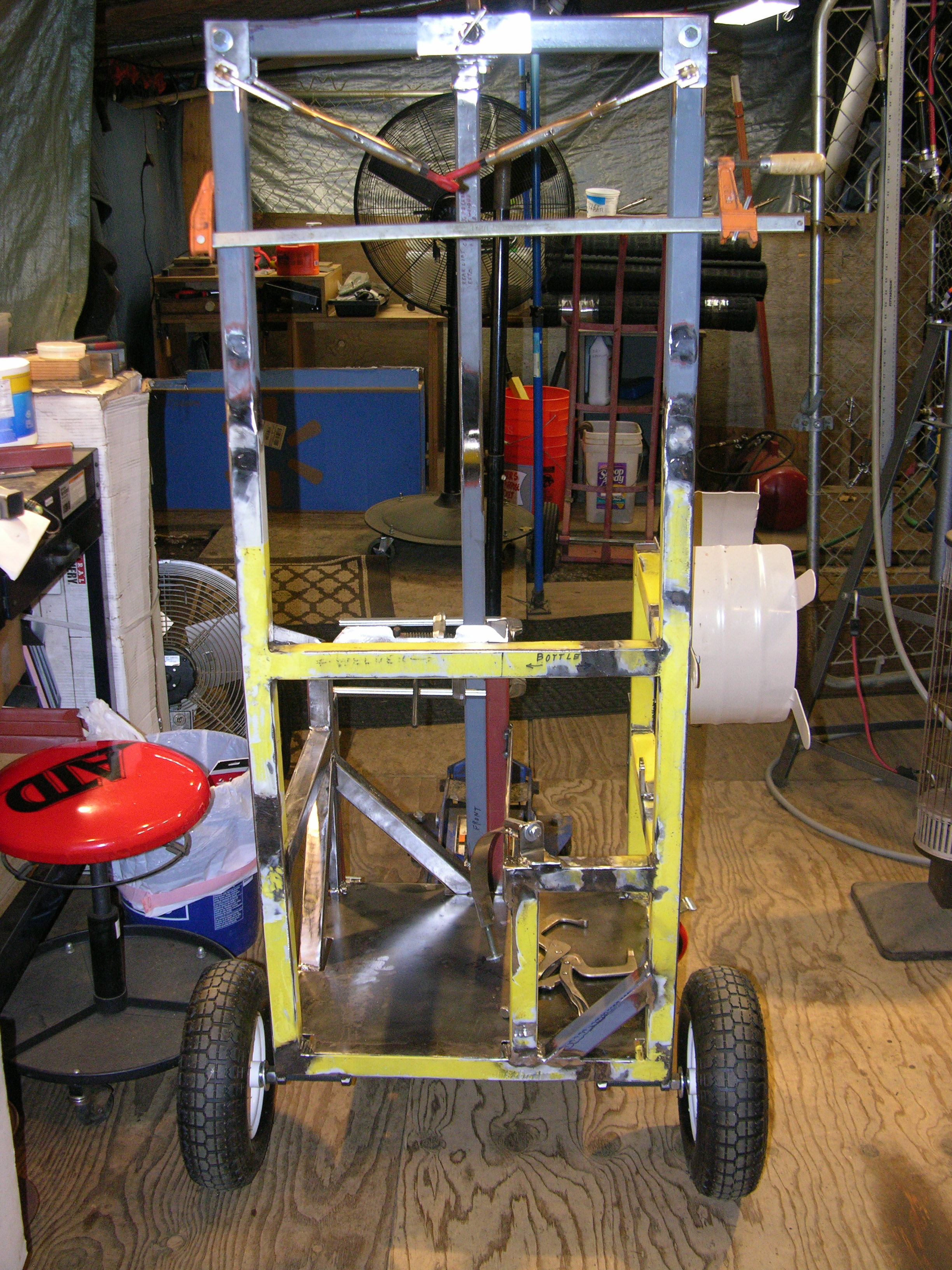

Well, got a bit more done today -
Front of the cart, all subassemblies welded up - DSCN2993.JPG - Cart, loaded - DSCN2995.JPG - Cart loaded, rear view - DSCN2996.JPG - Hanging from mini-jib, both sliders adjusted for level - DSCN2997.JPG - OK, I lied - off by 0.1 degree - DSCN2998.JPG - Showing angle, both sliders and rigging - DSCN2999.JPG - Actual "hand truck" balance point when loaded - works GREAT! - DSCN3000.JPG -
Next comes the front retainer lip, a better rear hold-down that won't get in the way
of air flow, the trailer tongue, then paint - Merry Christmas everybody... Steve

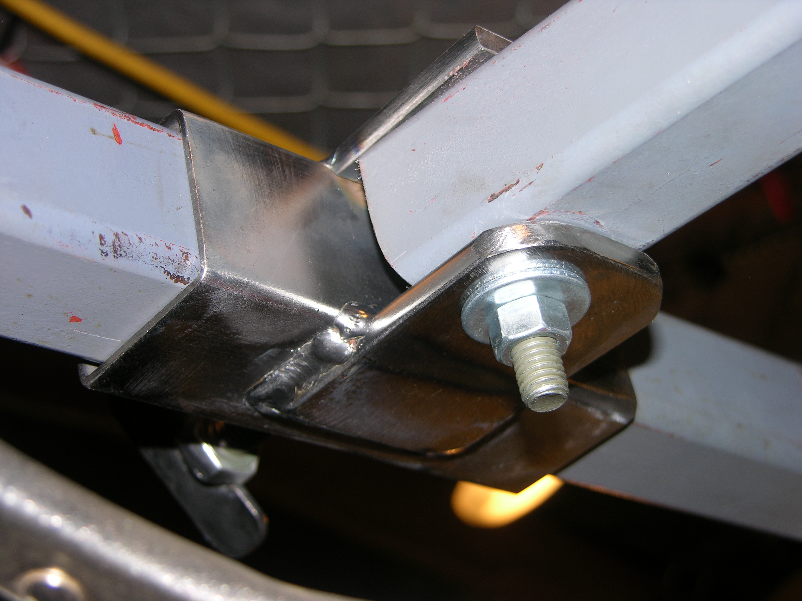

#86

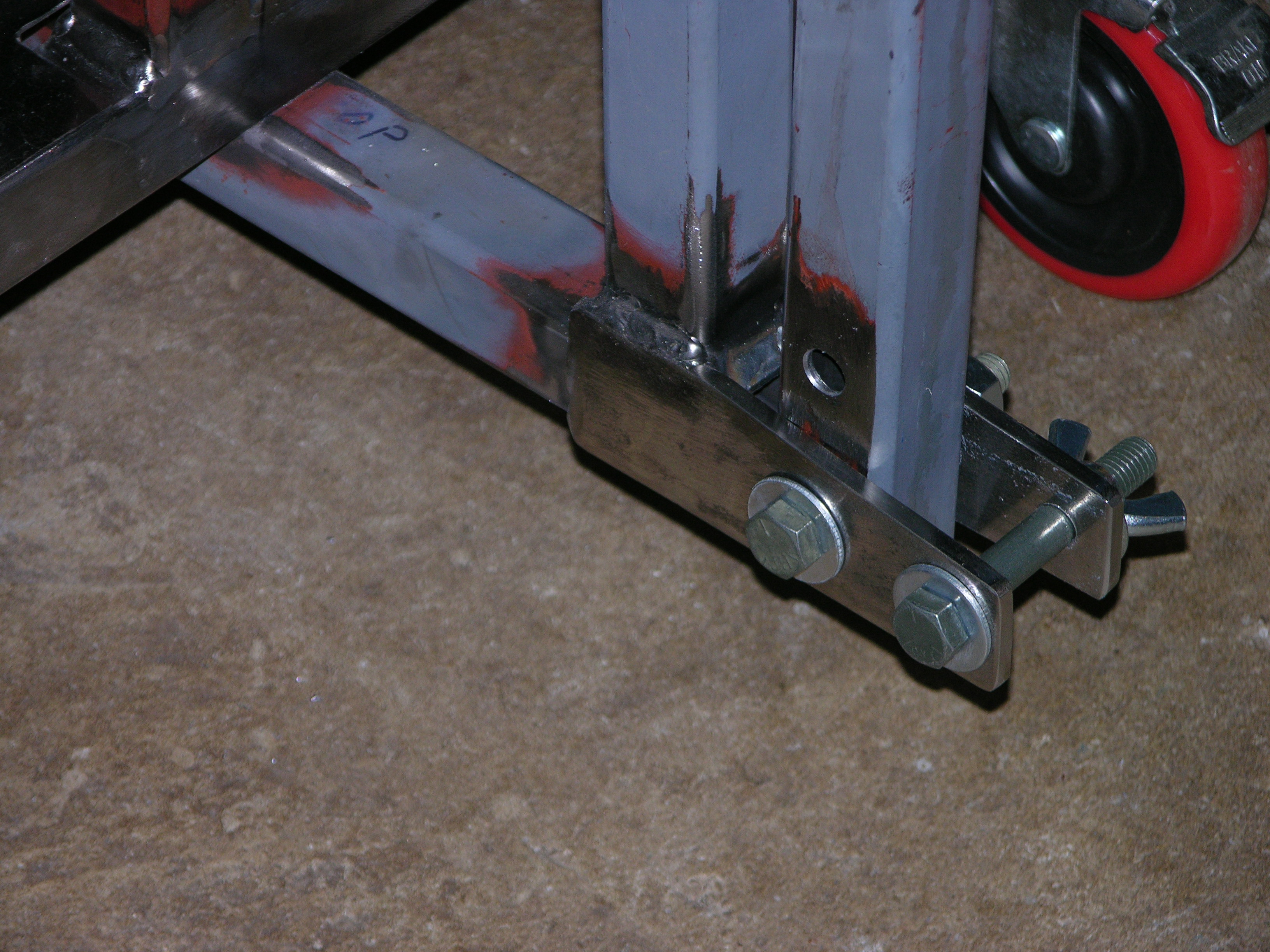

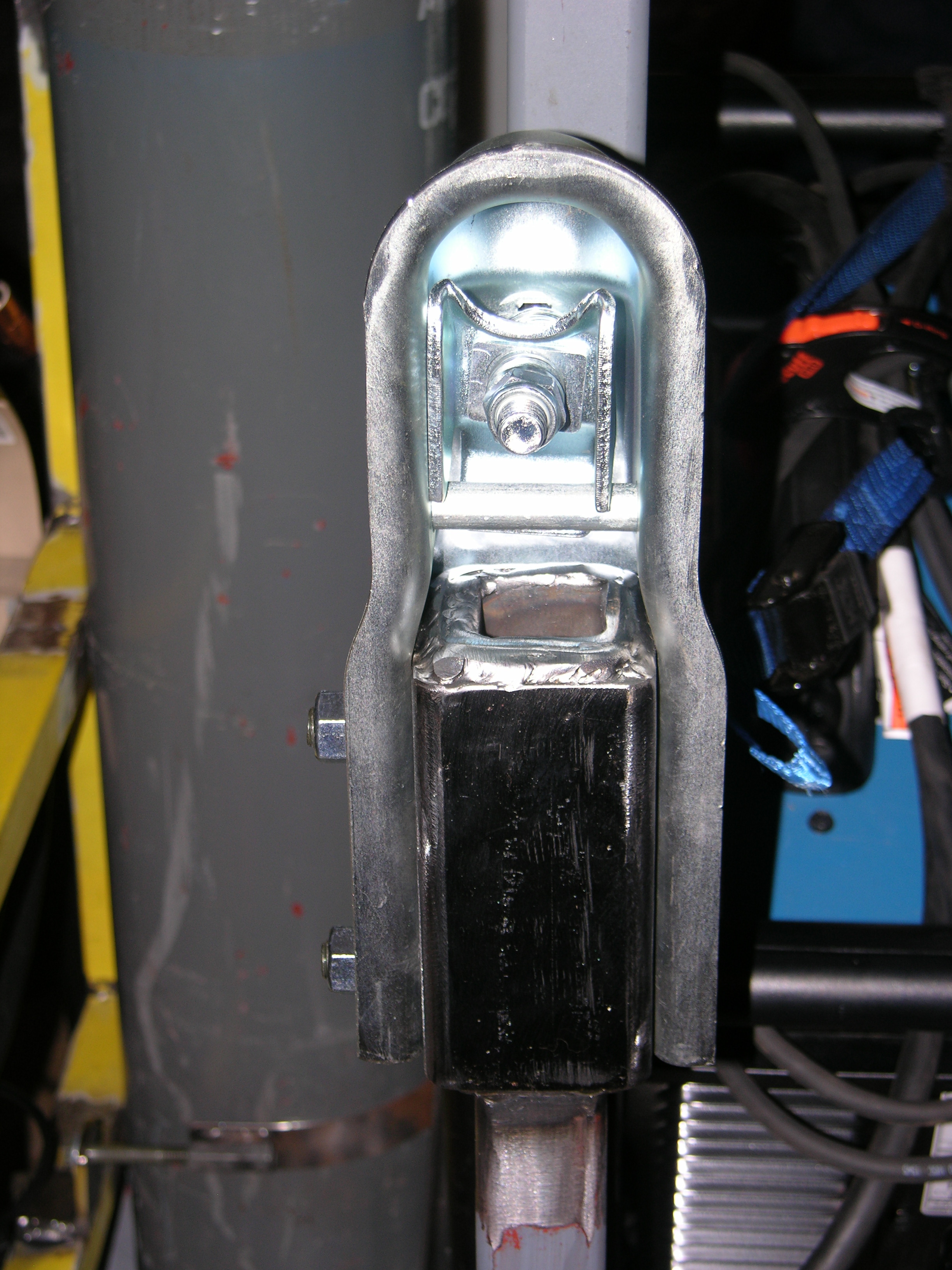

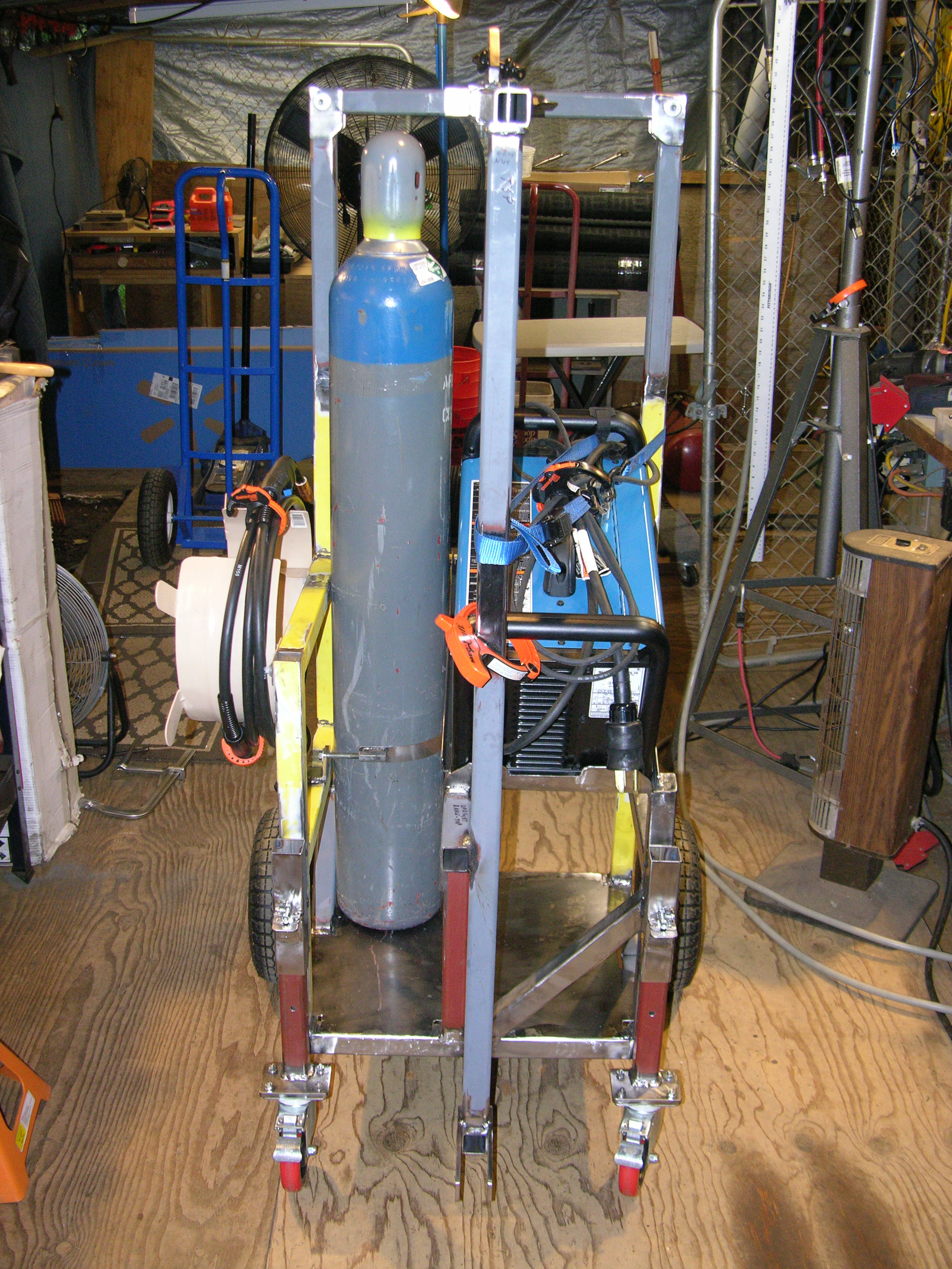

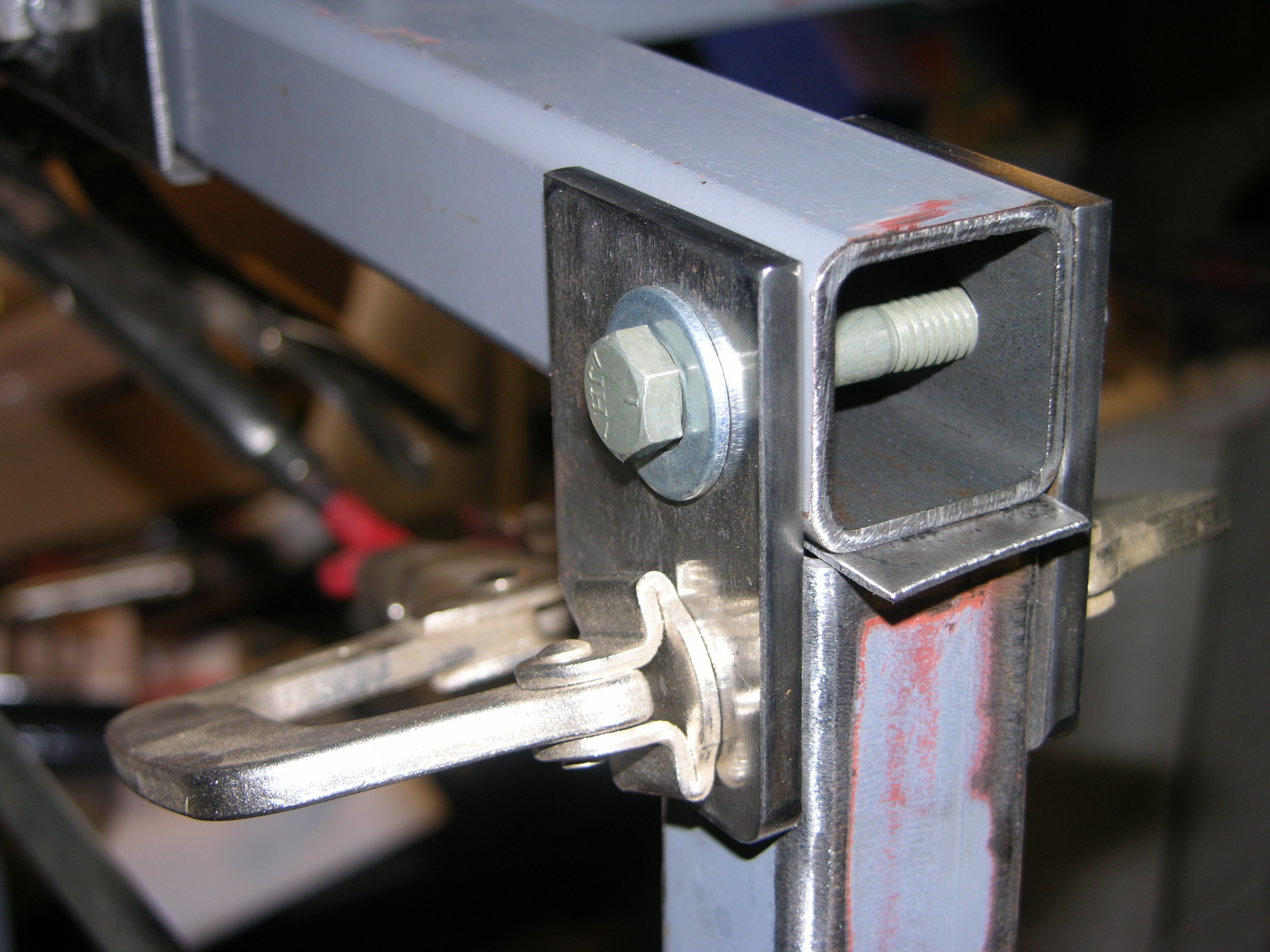

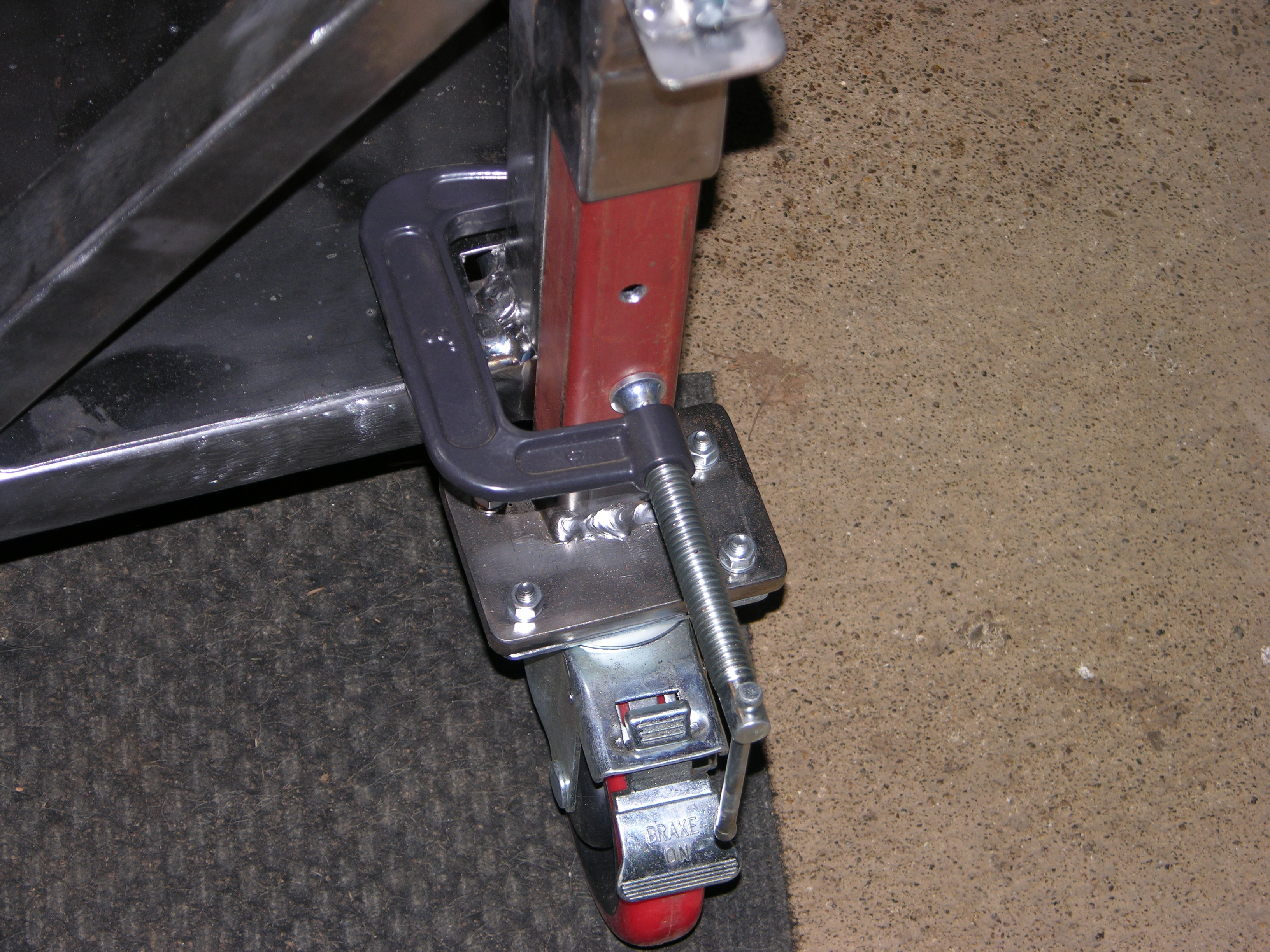

It's TOWABLE :) - The hitch is done except for a latch to hold it in the up position - DSCN3001.JPG - Hitch pivot - those are 1/2" grade 5 bolts. Pivot is double nutted, tow mode is the one with the wing nut. - DSCN3002.JPG - Ball hitch - tongue is 1-1/2" tubing, ball hitch is 2-1/2" - Hmmmm.... - DSCN3003.JPG - Hitch in the tow position - DSCN3004.JPG - Locked in place - DSCN3005.JPG - Hitch raised to be same height as the ball on my ZTR - DSCN3007.JPG - Which takes the weight off the casters so they can be retracted - DSCN3008.JPG - Casters retracted, more ground clearance than the frame itself - DSCN3009.JPG -
The way it's set up, I can use the tongue to lift the back of the cart up onto the ZTR's hitch - with the weight off the casters they can easily be unlatched and raised into "travel" mode and latched.
Arrival at the destination I'll lower and latch the casters, THEN lift the tongue off the hitch ball, then raise and lock the tongue and move the cart like a hand truck OR on wheels AND casters, depending on smoothness of the surface... Steve

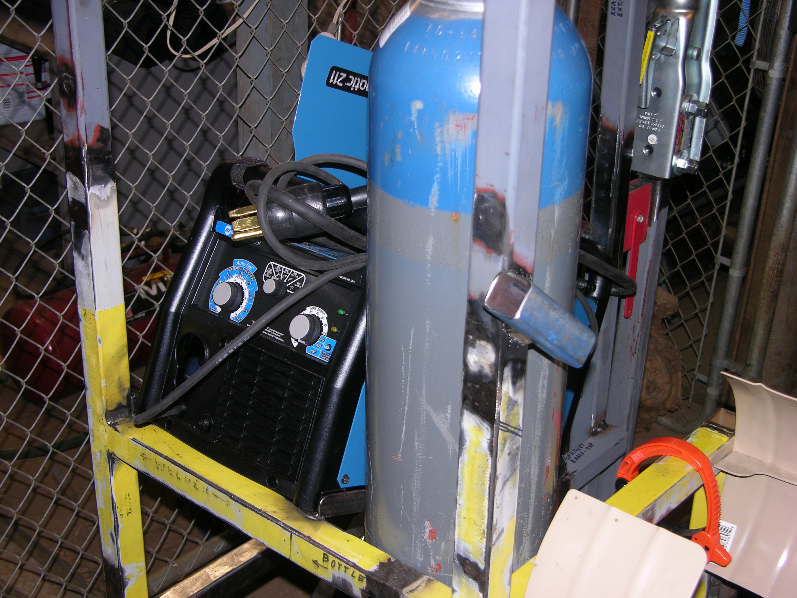

#88

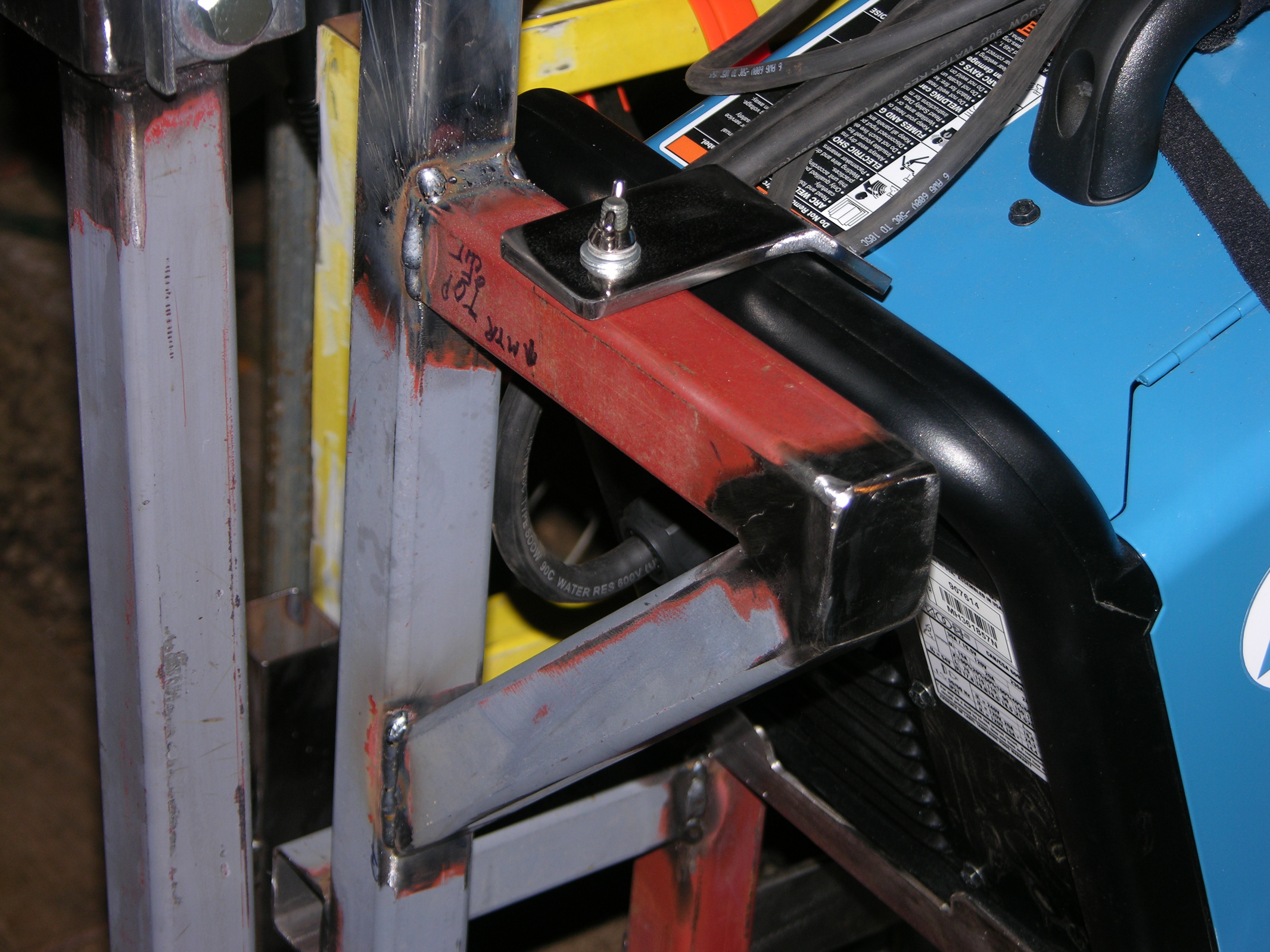

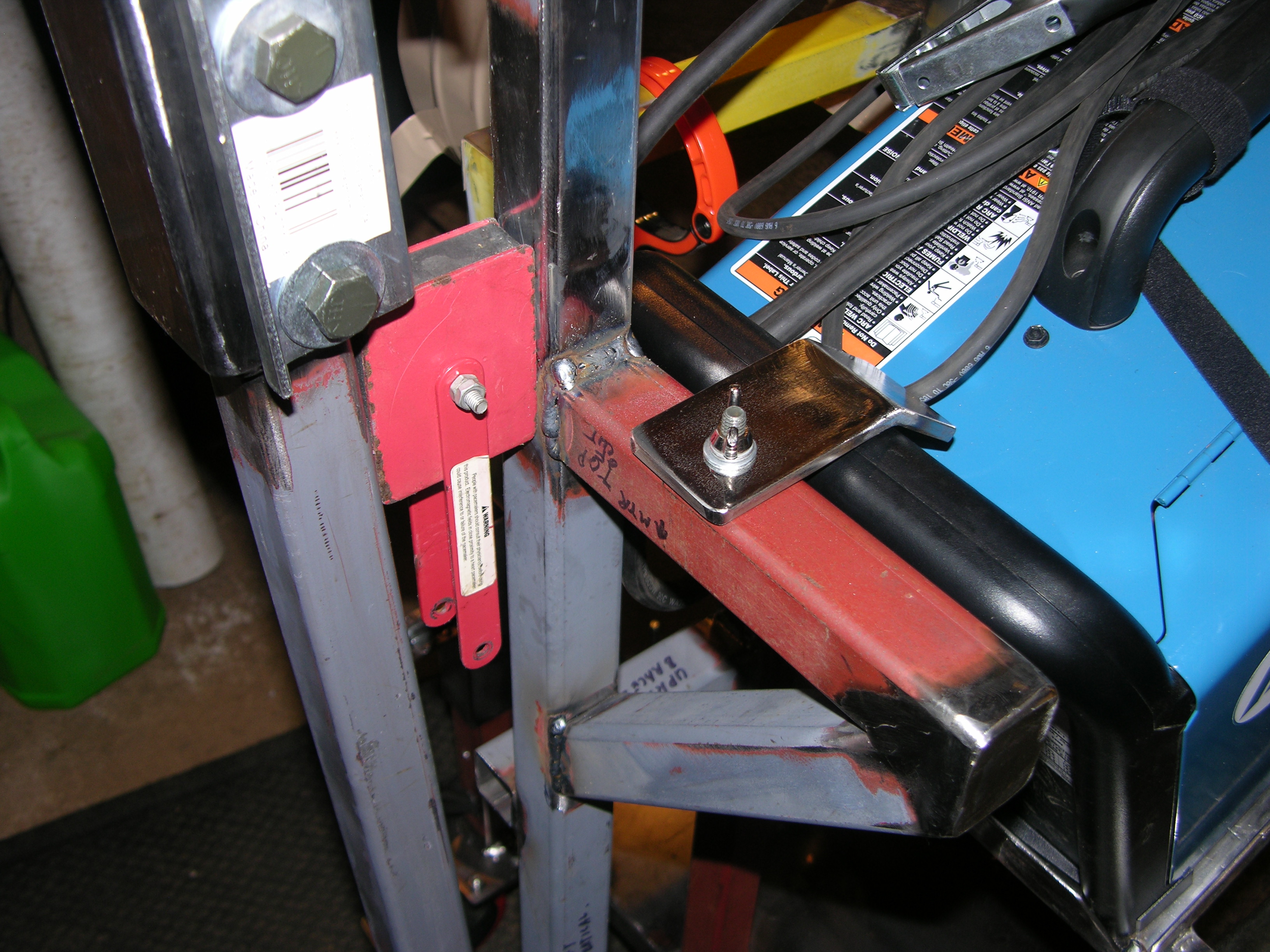

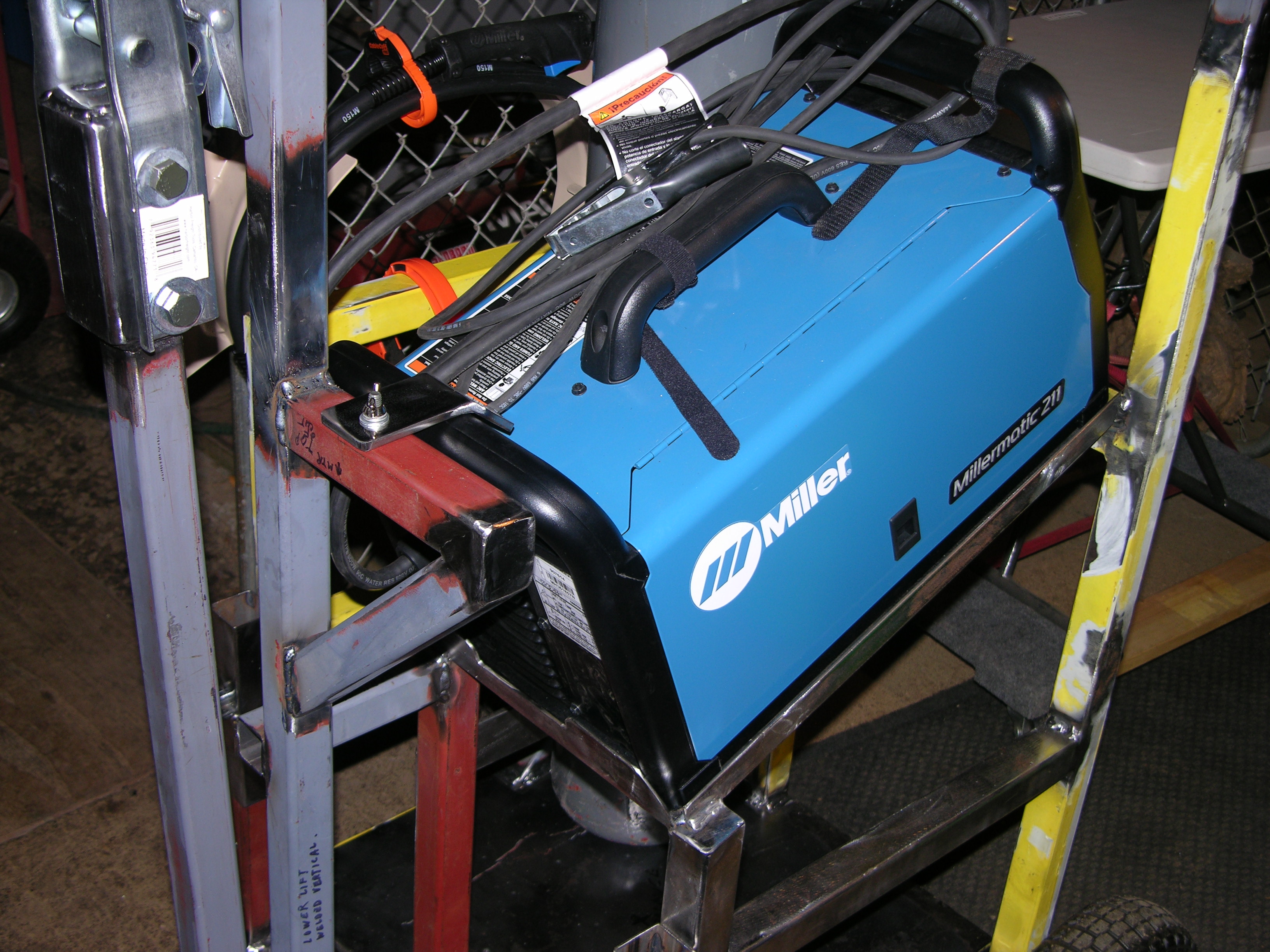

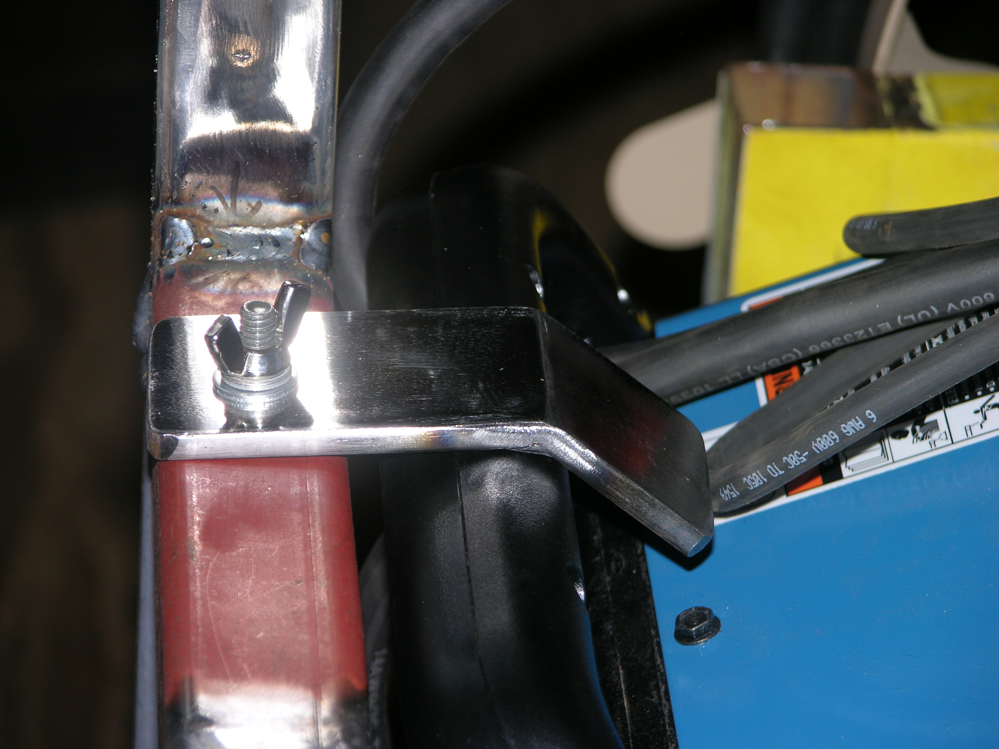

Not quite ready for paint yet; spent today fabbing a positive hold-down that locks the welder in its cradle and does NOT interfere with ANYTHING - any straps I tried either made me take 'em off to open the side door of the welder, or blocked front back or BOTH vents.
After I finish that I wanna come up with a lock for the tongue when it's NOT being a trailer, and still need a front lip on the welder cradle. Still, feels good seeing it come together -
Paint - dunno about kumquat, wuz thinkin' more ecru with alternating puce and vermillion stripes; there's enough blue just with the welder, and since I never get the same tanks back I'll hafta ask Mrs. Bukit to knit me a cozy for the tank - might be a bit tricky to match those paint colors with yarn, but that can be my NEW excuse for it not bein' done :laughing: ...Steve
/ Container Weld Shop build - #89

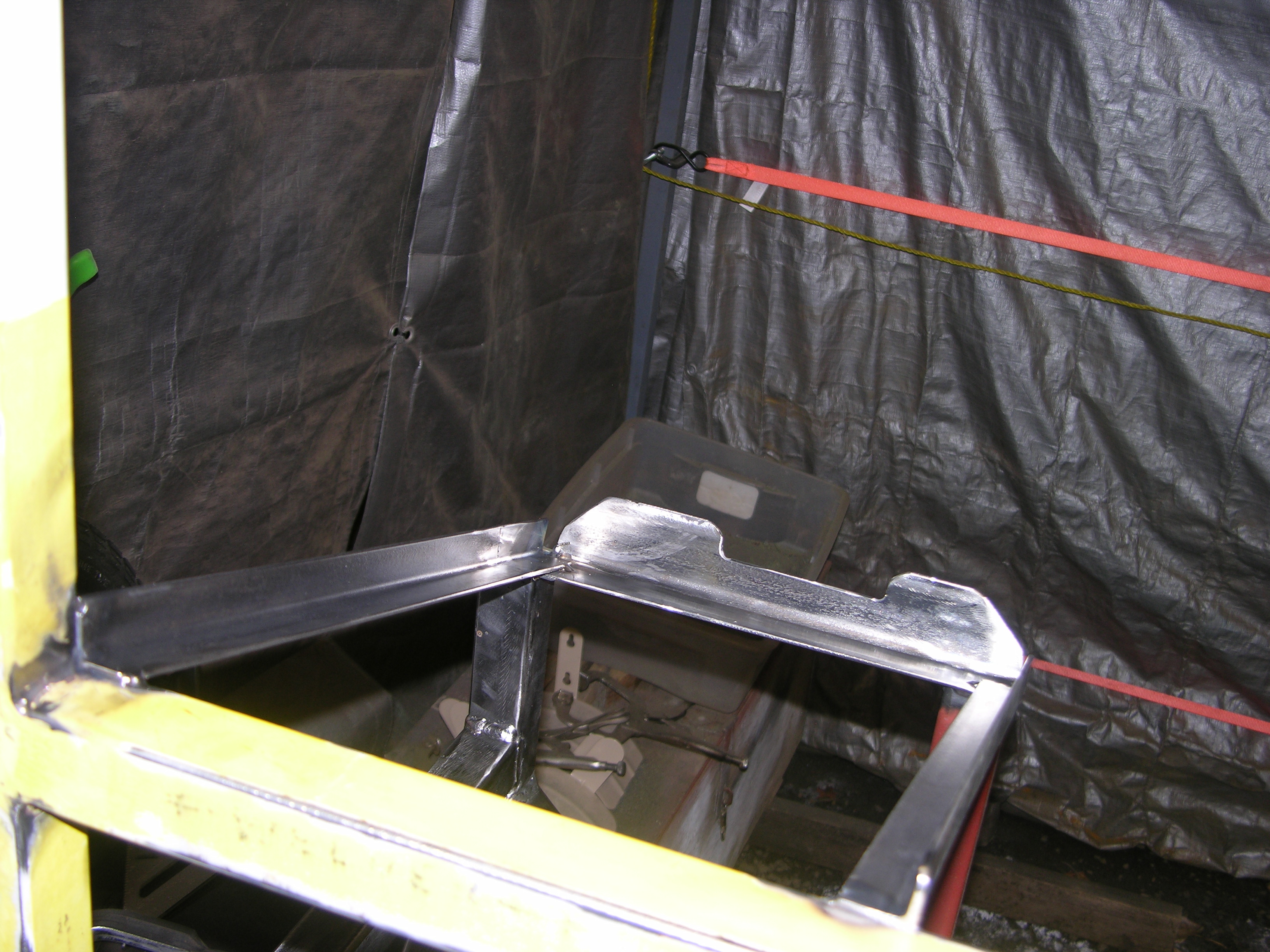

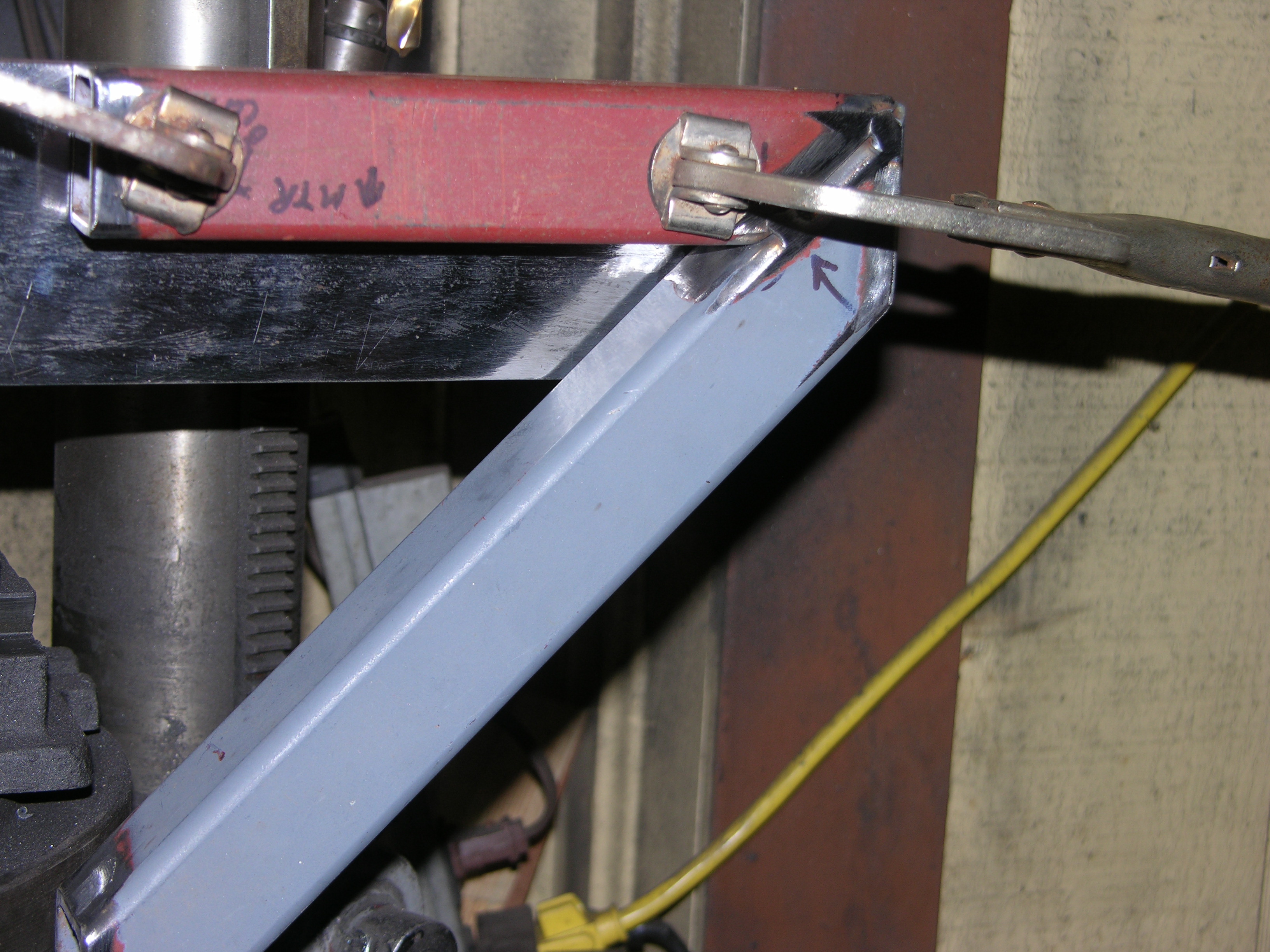

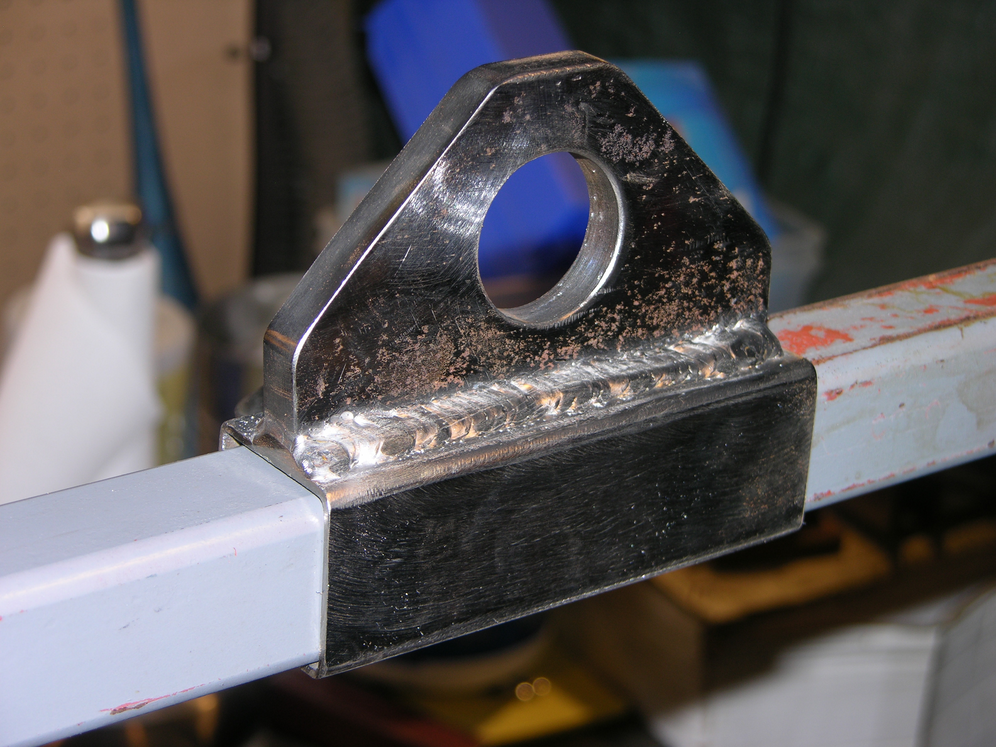

All seriousness aside, managed a bit more on the "CFH", aka Cart From H*** (saved the censor bot some work there ;) )

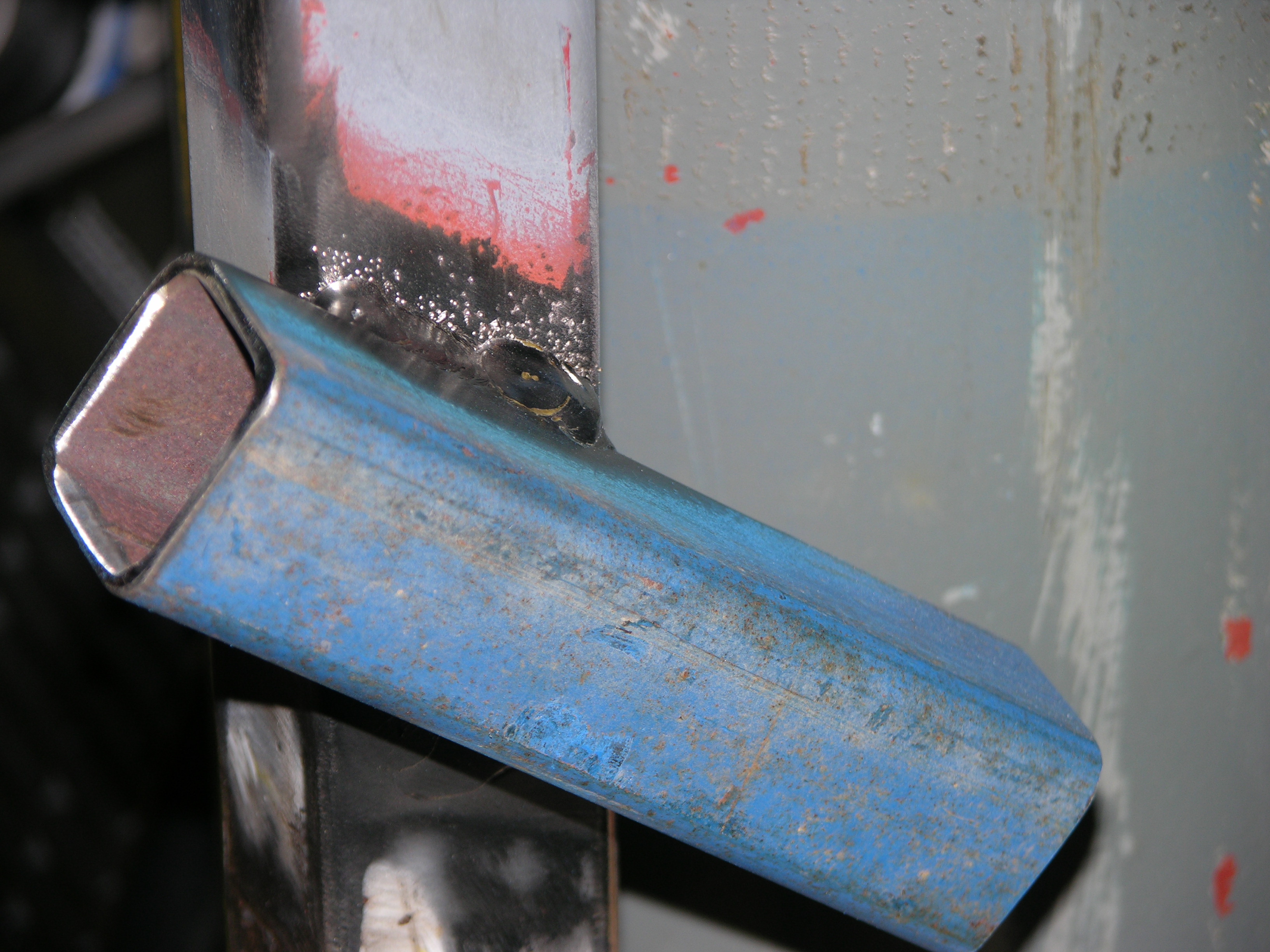

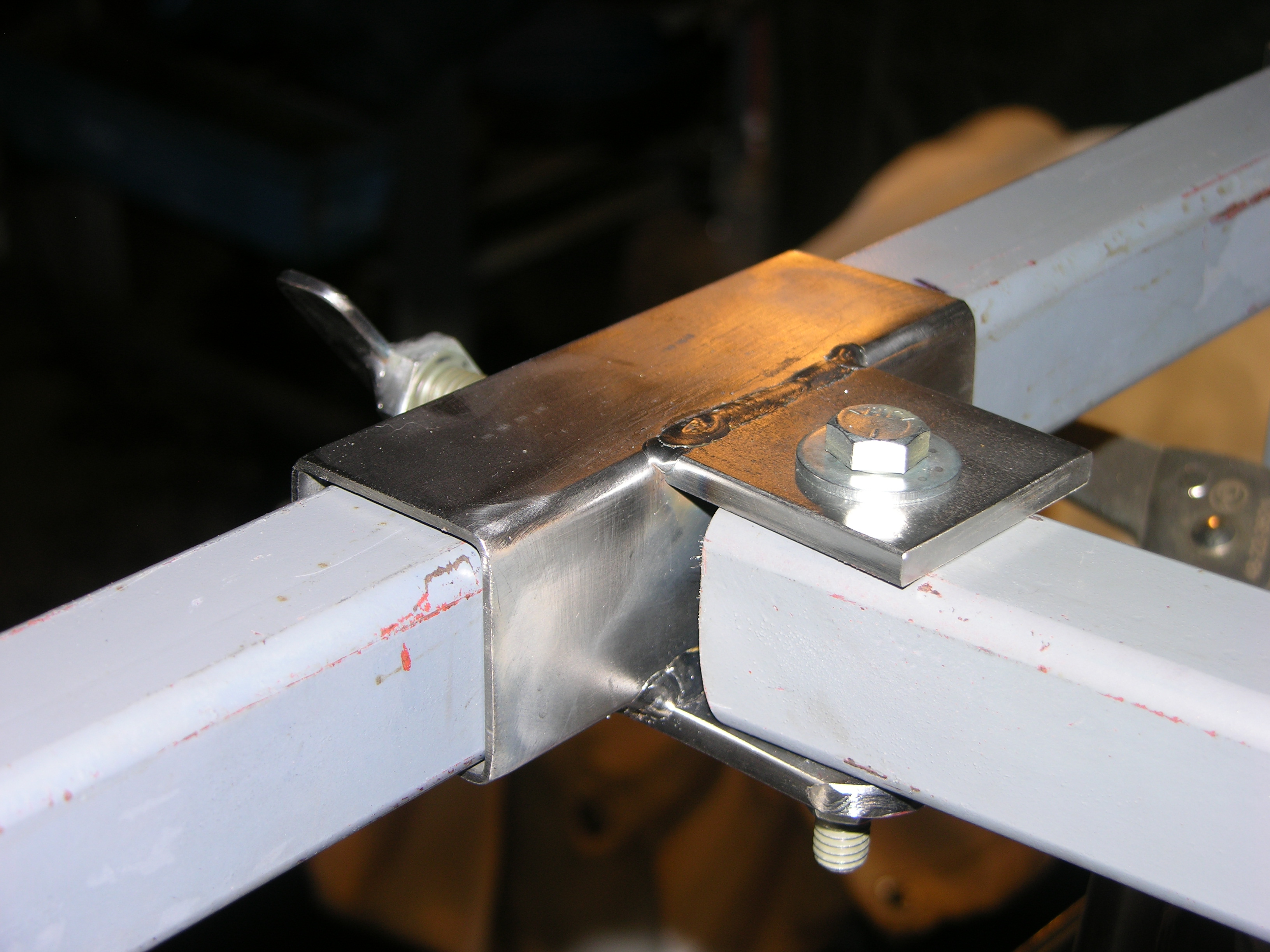

One way to fix it when you weld 2 pieces too soon and don't wanna do it over - DSCN3011.JPG - One of these two pieces needed a hole, but the other one's in the way of clamping in a normal vise - DSCN3012.JPG - This setup saved me from having to cut these apart and start over - DSCN3013.JPG - So I could finish this hold-down that solidly locks the MM211 in its cradle - DSCN3014.JPG - I didn't want a "Mr. Pointy" to walk into later, so tucked the 45* brace UNDER, and capped the end instead - DSCN3015.JPG - Closer look - DSCN3016.JPG - And showing the slight "crush" achieved by welding the brace slightly lower than the welder handle - DSCN3017.JPG -
I don't have a press brake for the 20 ton press yet, so that hold-down is 2 pieces of 1/4x2 FB welded together at an angle and the welds blended .

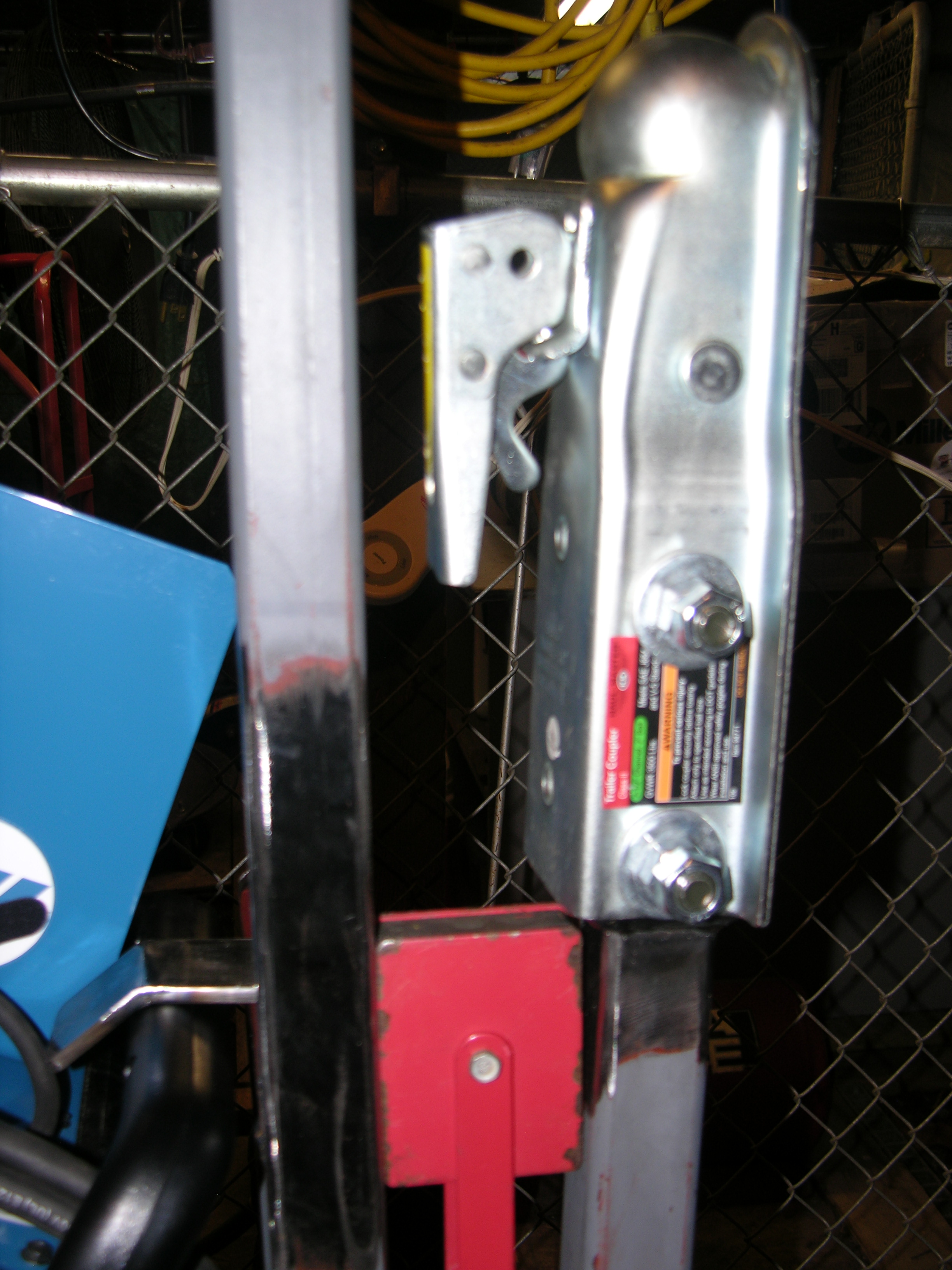

#91

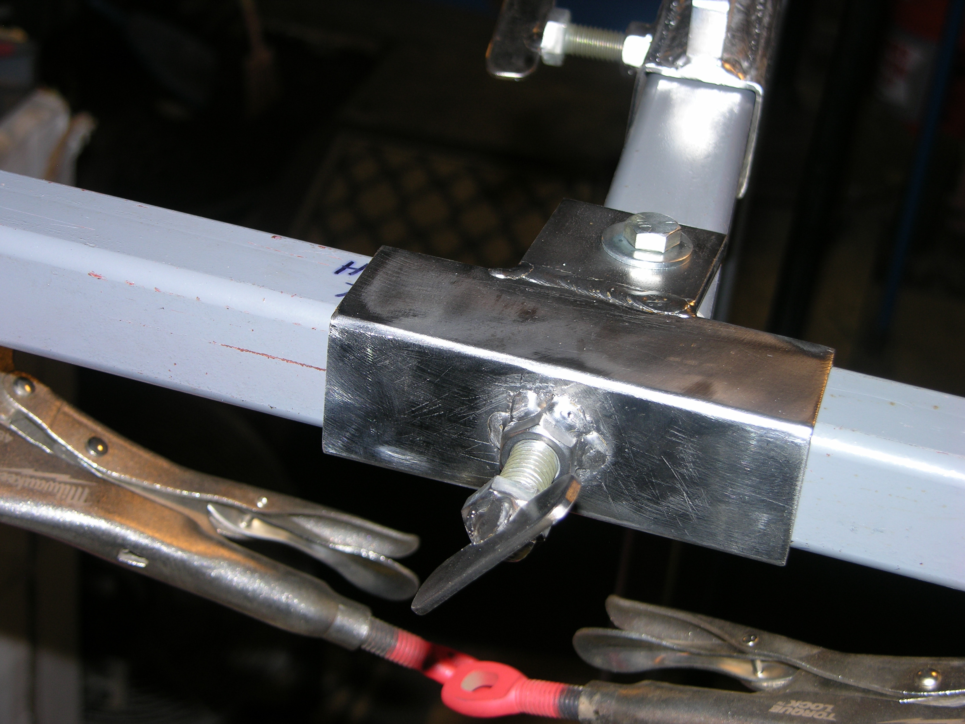

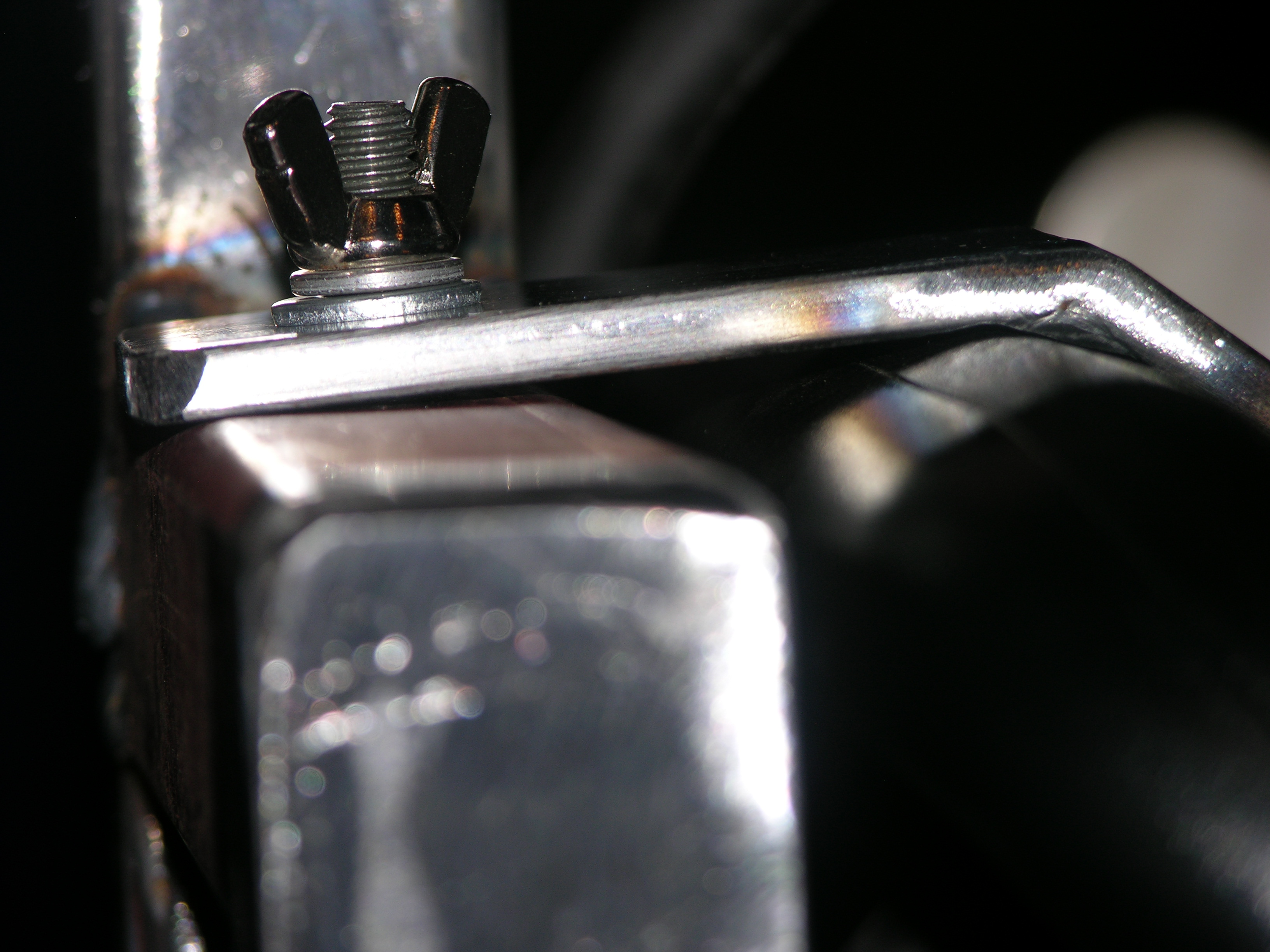

Well, it took me about 5 minutes to come up with a "acceptable for now" tongue latch, and 4 of those was getting all the filings/brush wires off that magnet :laughing: - DSCN3021.JPGDSCN3022.JPG - Then I cut a short chunk of 1-1/4" tube and "softened" the end for a torch holder - DSCN3018.JPGDSCN3019.JPG -
'Bout one more item, then it's time to remove all the loose items and prep for paint - my steel supplier does NOT carry .105" wall tubing in ANY size, so the caster sockets (.095" wall) let 'em wobble around more than I'd like - that clamp is for a test to see if taking out that wobble makes a difference in ease of movement, and it DOES - quite a bit. So I'm either gonna shim 'em up with some 16 ga. scrap or run that bolt hole below the socket - DSCN3020.JPG - all the way thru the frame, weld nuts on the back side and make a couple wing bolts to lock the casters down. It won't be as much of a PITA as it sounds, because once the welder's in the container it will likely LIVE there most of the time (still will have the mm252 up at the house) - but things're gonna be a bit snug inside the container, so I DO want the cart to move around as easy as possible... Steve

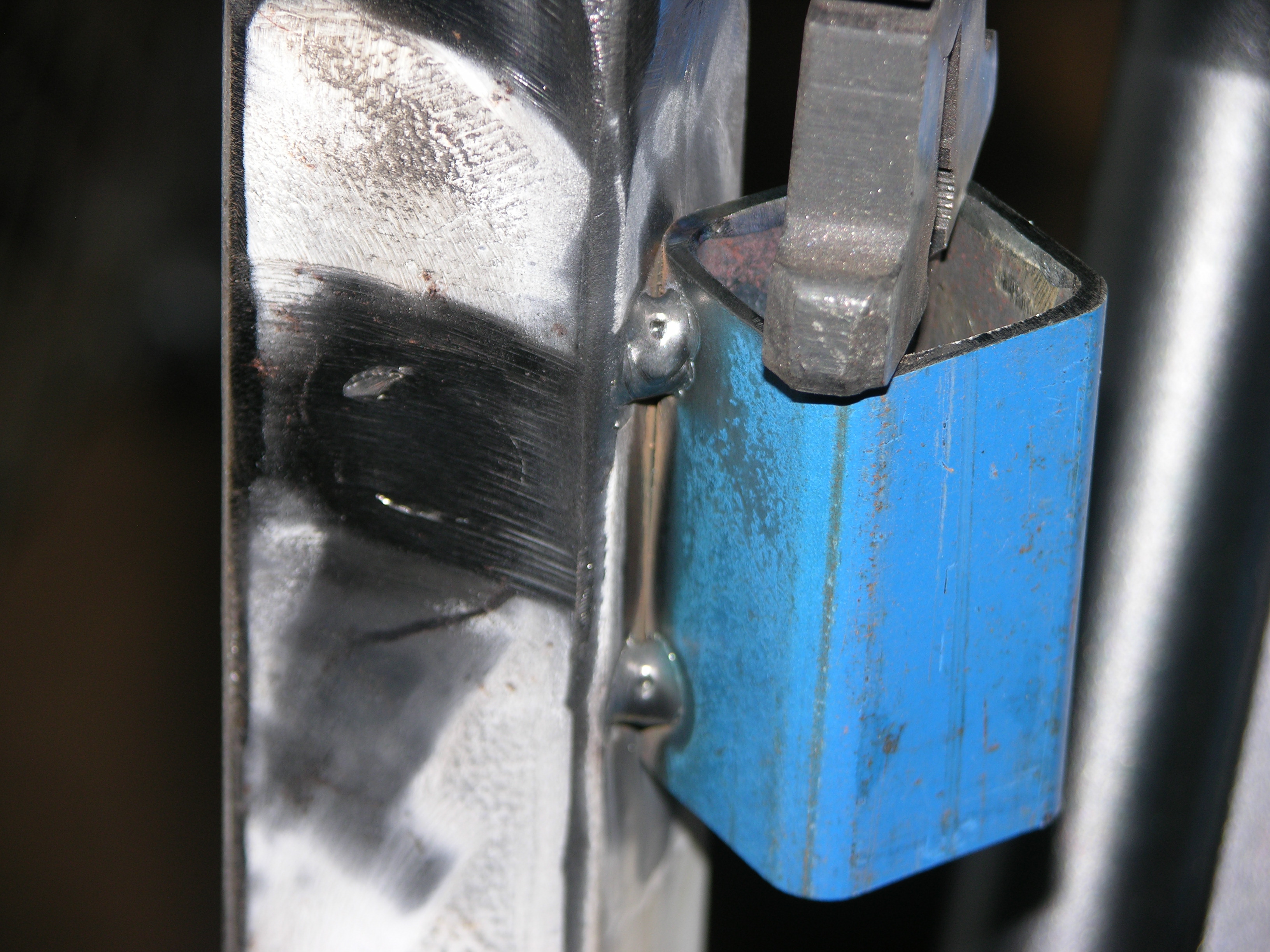

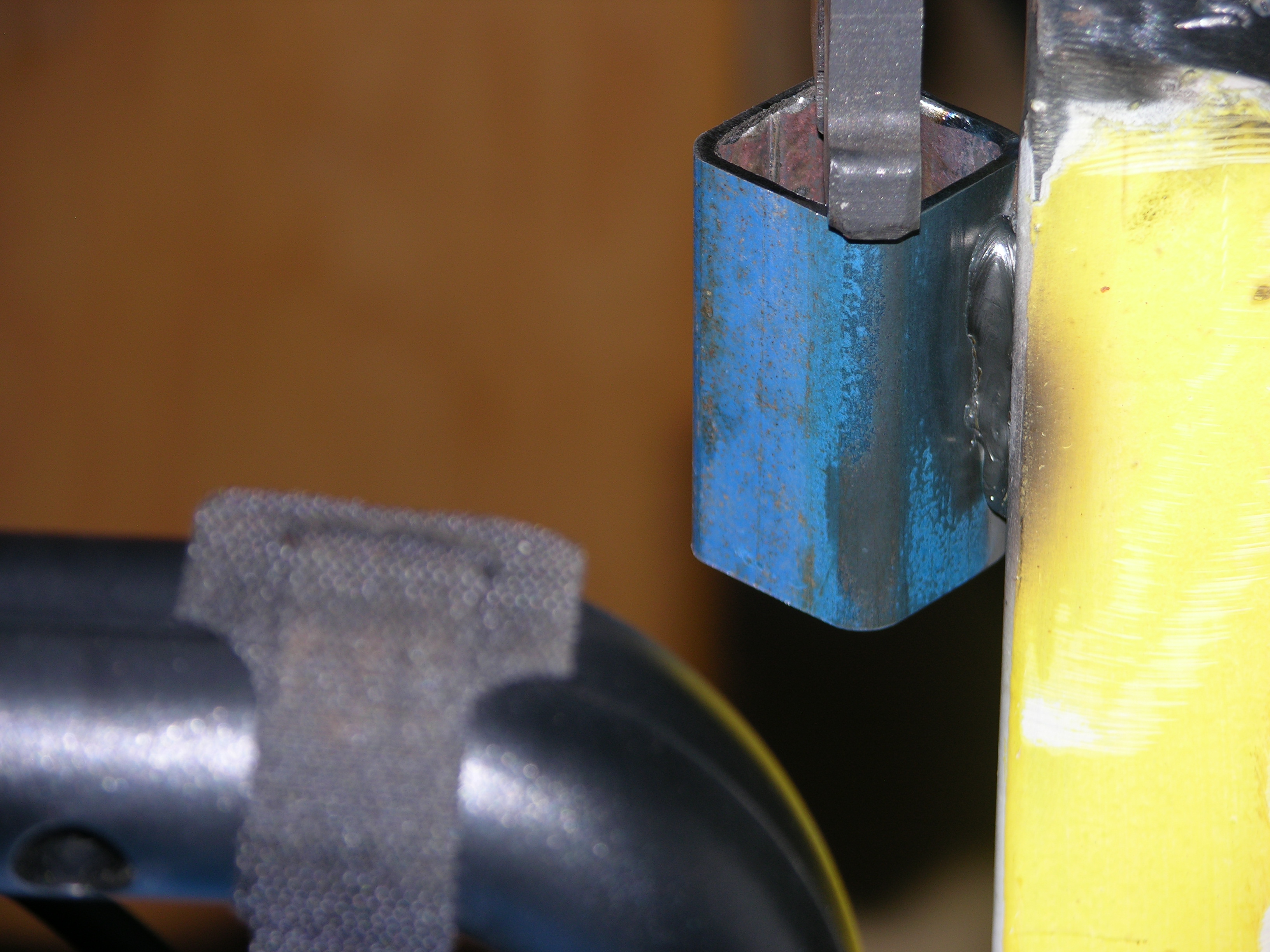

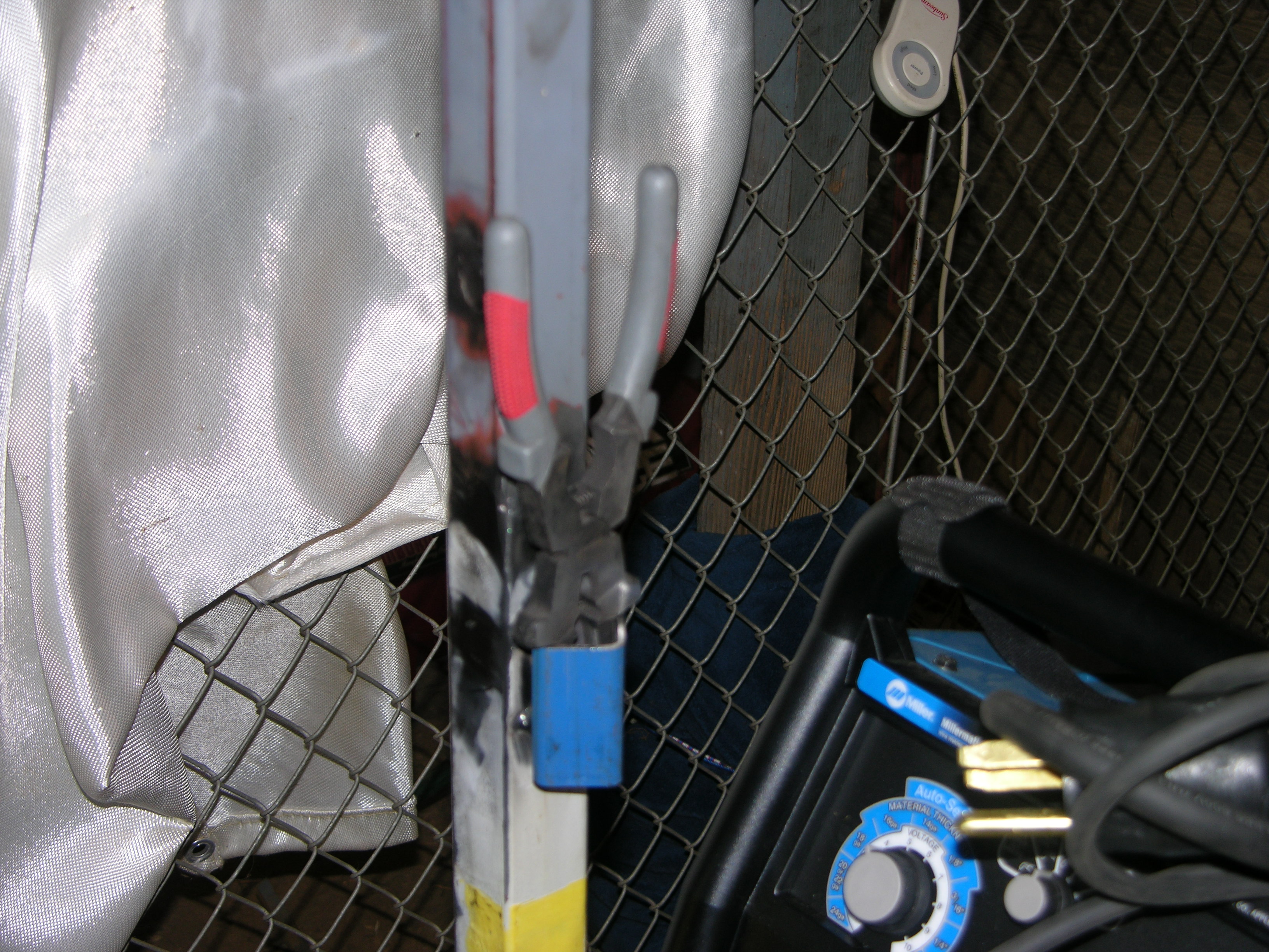

Haven't got to the "caster stiffening" thing yet, remembered I wanted a convenient place to keep my mig pliers - so I cut a 2-1/2" piece of 1-1/4 square tube, belled out the upper end a bit, shined up one of the corners and welded it on one of the uprights - DSCN3023.JPG - Tacked the front - DSCN3024.JPG - Welded the back, had a hiccup near the end - DSCN3025.JPG - Figured I'd had a burnback, happens once in a while; but the wire was NOT stuck. My "five-star troubleshooting" led me to the culprit - DSCN3026.JPG -
Last time I looked, that 44 lb. spool still had about 1/3 left to go; guess I've been kinda busy (for a hobbyist, anyway) - Oh well, the mm211 has almost a full 12 pounder in it, guess I'll set it on top of the 252 and finish with it; nothing left to do that needs it sitting ON its cart anyway... Steve

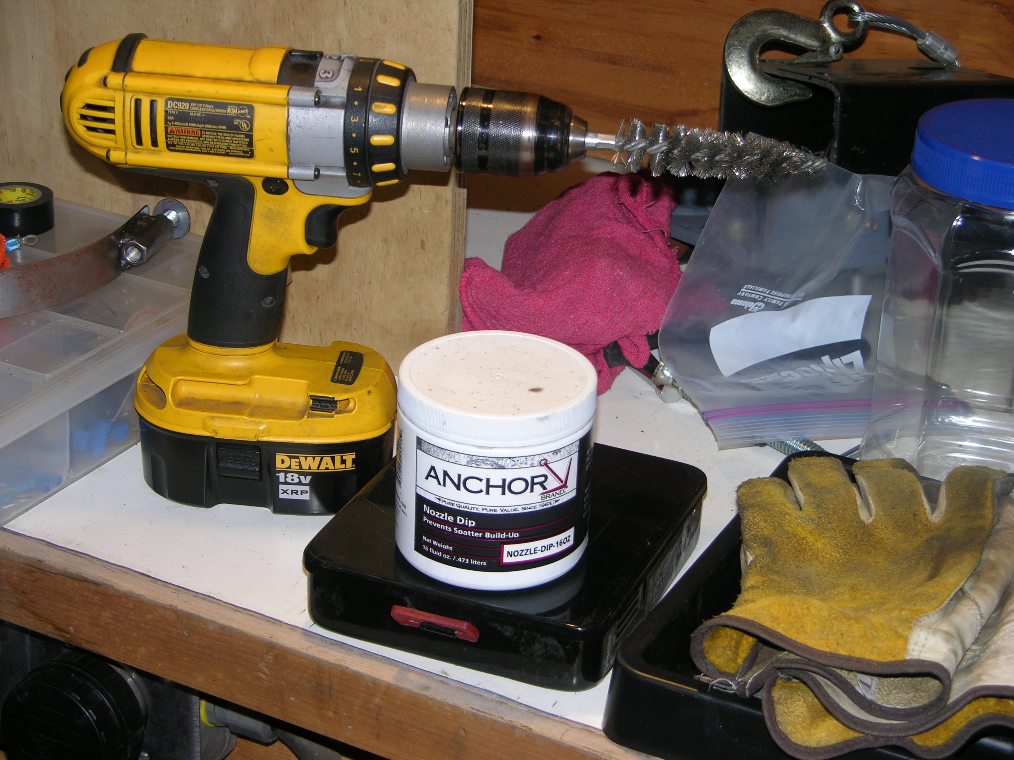

Torch stuff - I use these - DSCN3027.JPG - the brush starts out all the same size, but a couple uses makes it look like the pic :) - But I'm glad you mentioned that, I WUZ just gonna keep that stuff in the (yet to be cobbled up) drawer, but now I think I'll add a "mini-table" in front of the bottle - make it big enough to hold the stuff in the pic, tack a short piece of small angle vertically and hose clamp my nozzle gel to that (just in case they decide to change the jar size, wouldn't wanna hafta grind a circular ring off just for that :rolleyes: ) - The drill/brush could just SIT on that table, except when "4-wheelin"...
BTW, one of the millwrights on my old crew uses PAM spray for anti-spatter, etc - says it works fine and is a little cheaper. He borrowed my cement mixer a couple times, used PAM on it first and it came back cleaner than it left. Said it only took less than a minute with the garden hose...

I DO like your drill-chucked wire brush idea though. That should work WAY better than the plumbers wire brush I use now.
