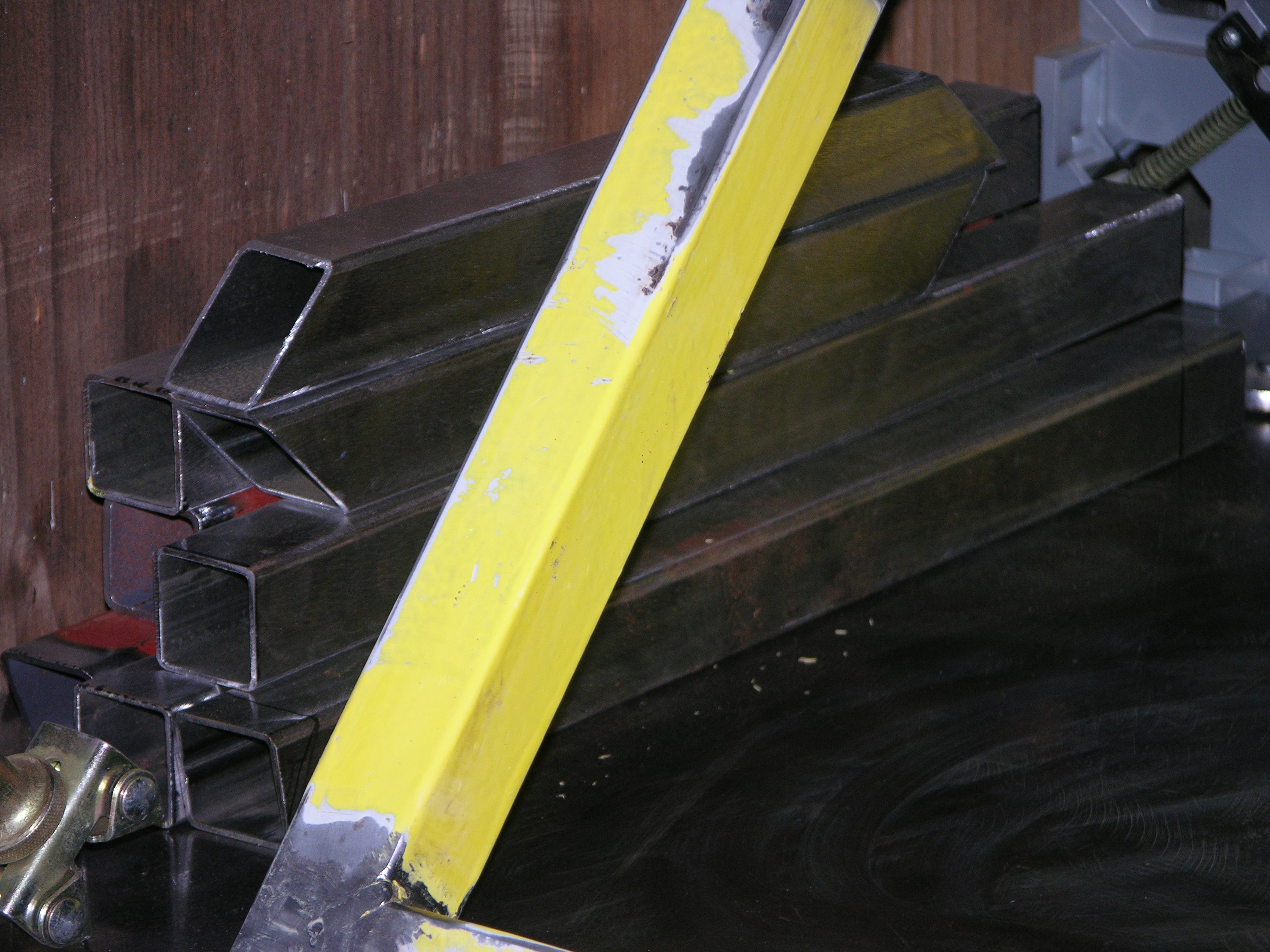

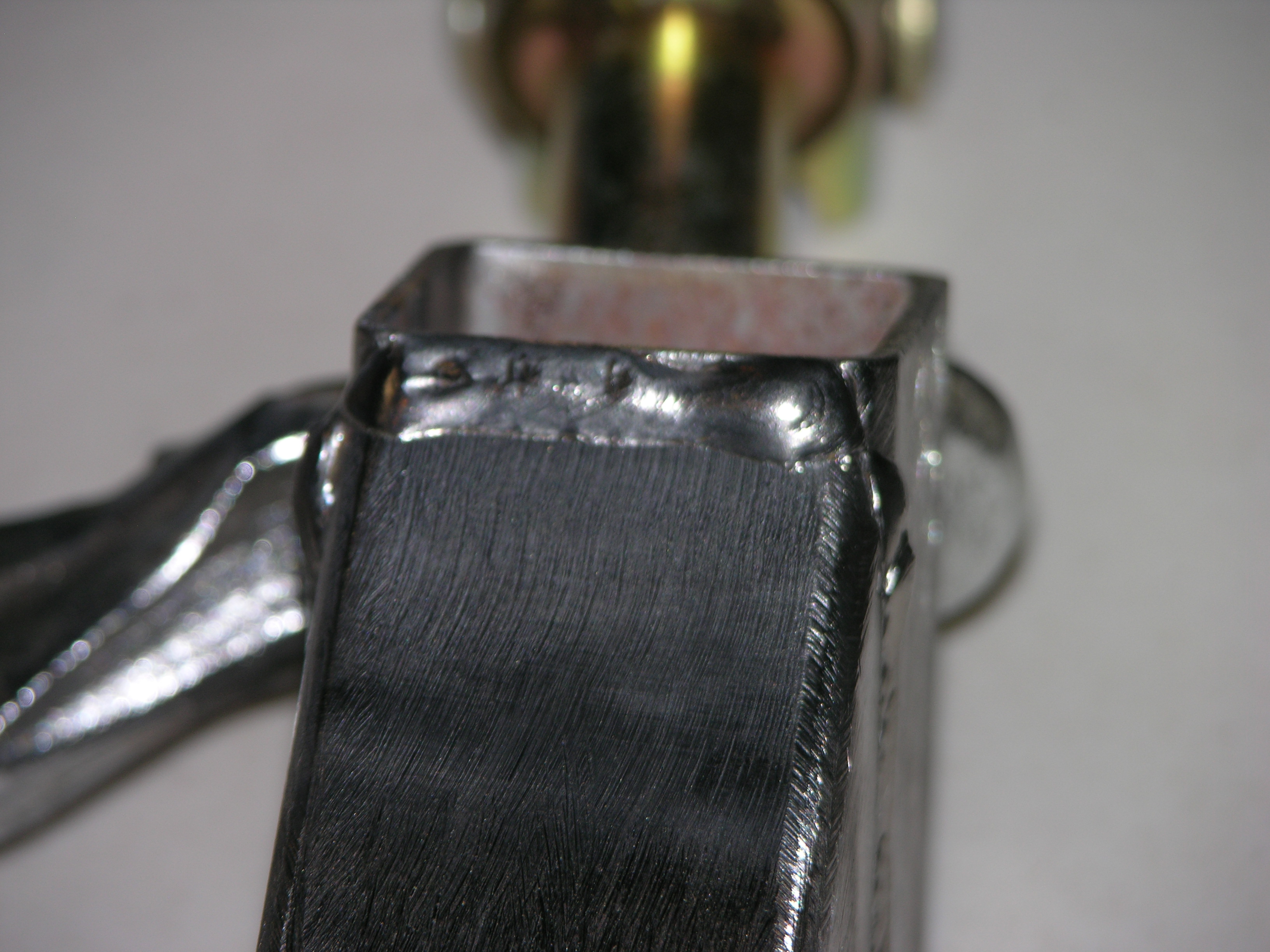

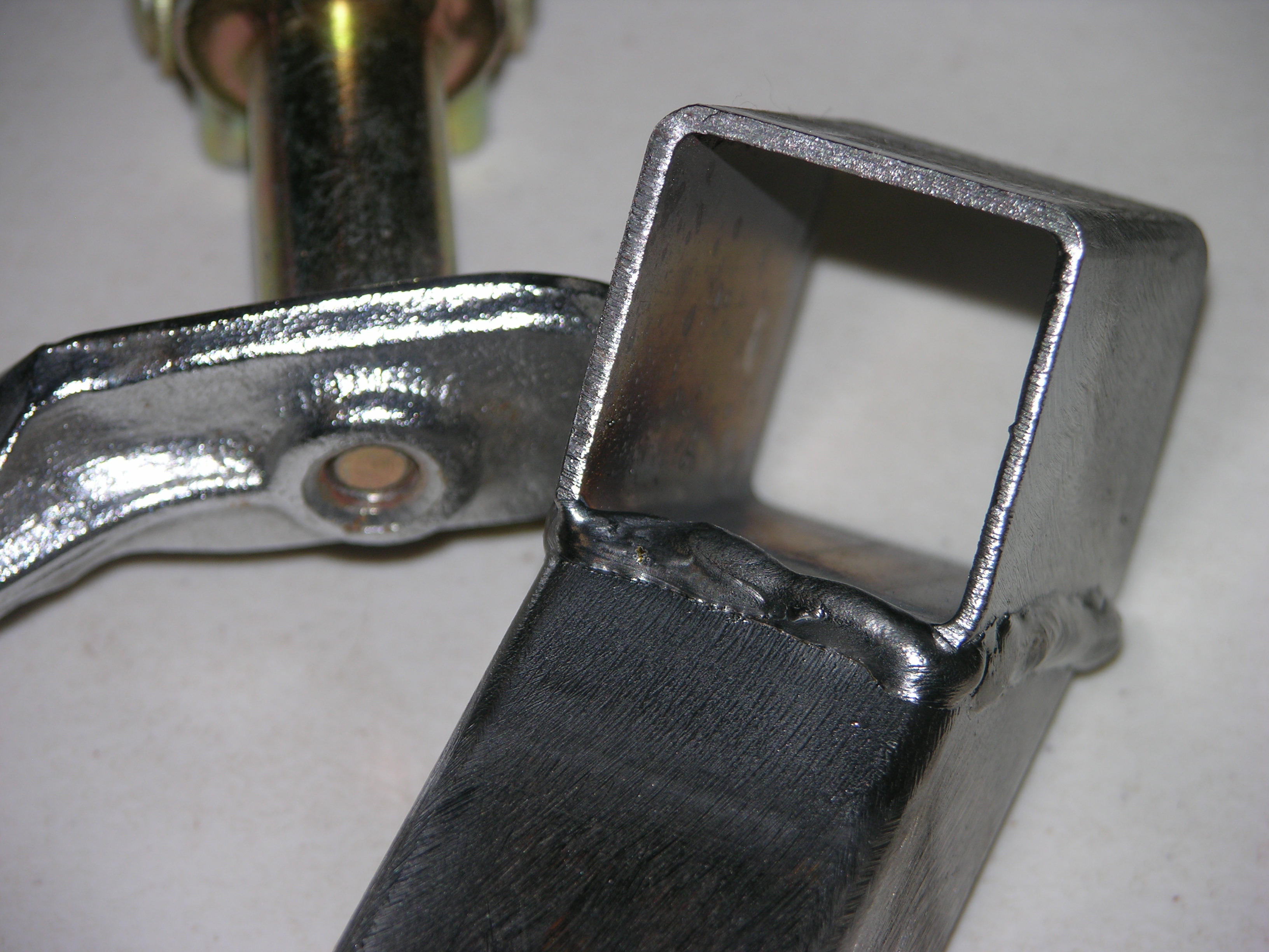

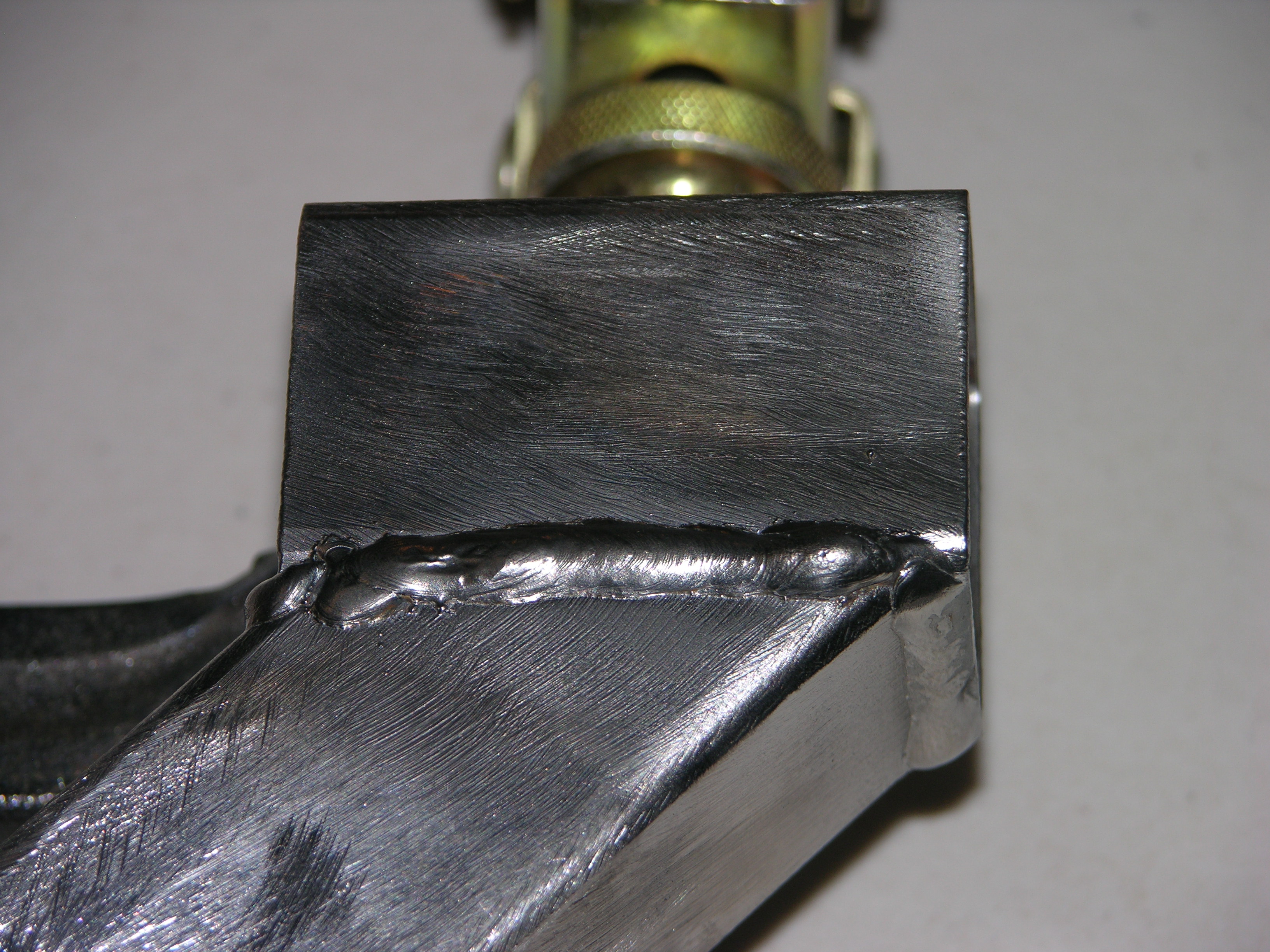

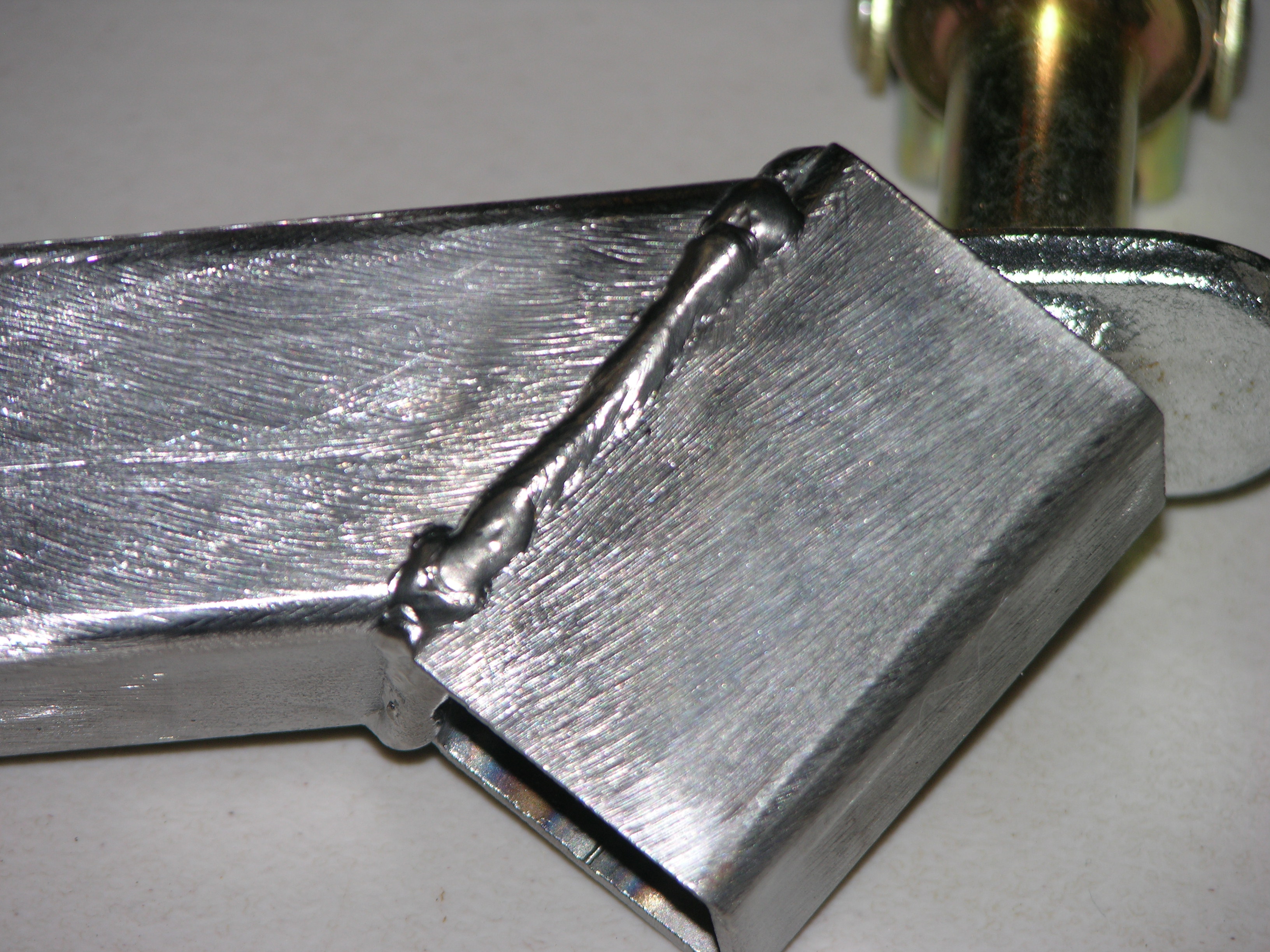

Cleaned up a couple scraps of the same tubing the cart's made out of, these are the first 4 beads using the new MM211 - to me, the autoset tends to run hot so if I use it I set it for one size thinner than I'm welding - but I messed up and wuz thinking the test pieces were .120" wall and they're .095" - beads woulda looked better if I'd NOT done that, or just moved faster. Oh well, caught it before doing any ACTUAL welds -
Second pic (woulda been first one, but pic uploader is STILL retarded) shows that I understand the unwritten law that "thou shalt use thine new welder to maketh its own conveyance", other 4 just show how NOT to turn off BRAIN before turning ON welder :rolleyes:
Probly also woulda helped if I'd done ANY welding in the last month (that's my story an' I'm stickin' to it :mur: ...Steve

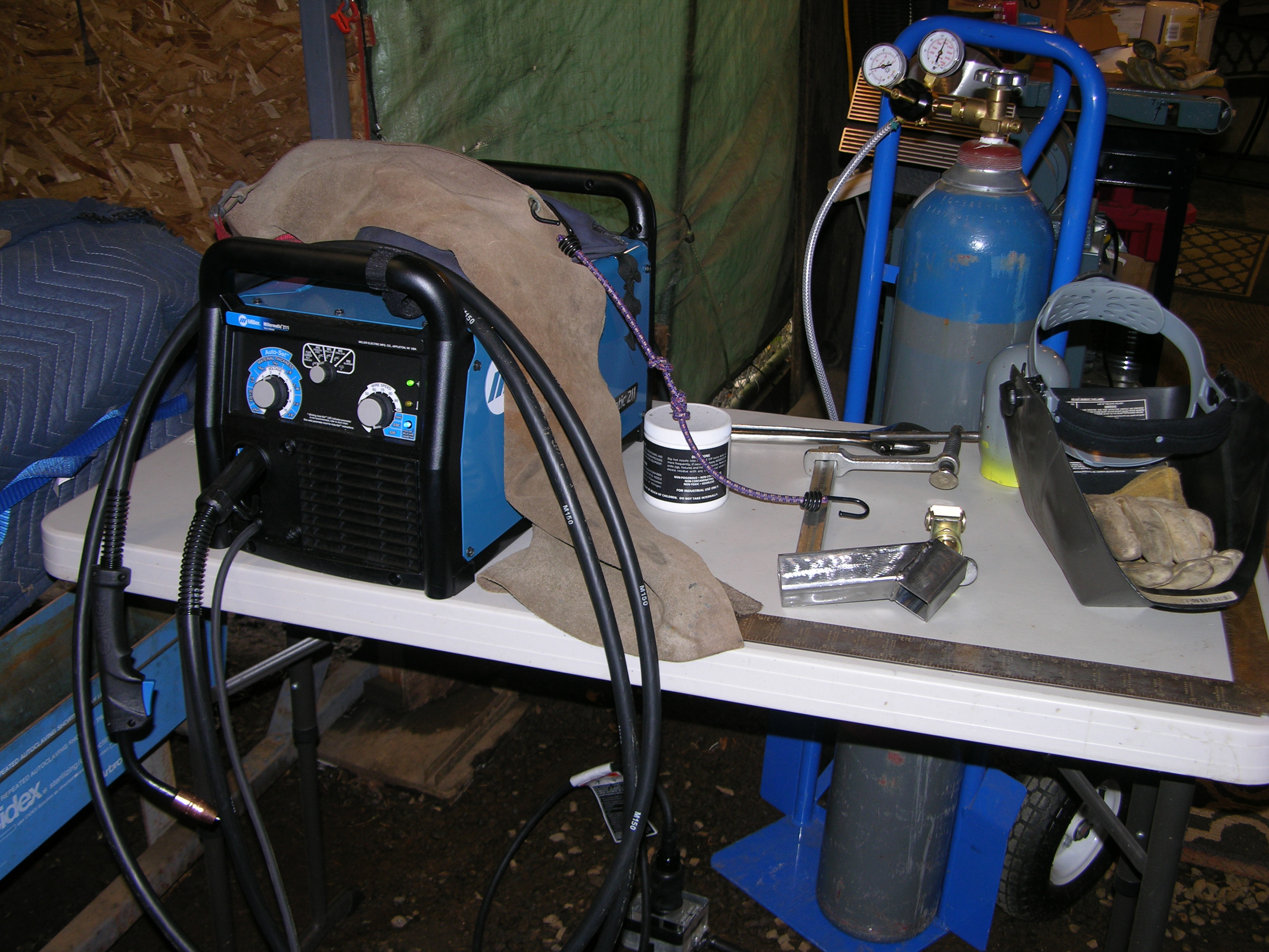

I had the earlier transformer version of the mm211 too, sold it to a buddy for as good a deal as I got when I found the MM252 with dual running gear, a never-used 30A spool gun, 3 bottles (2 were full) all for $2200 - I liked the early 211, but would have liked it MORE if it could handle a 15' gun without voiding the warranty, and had more options on the autoset, etc -
The newer version's autoset does .024 up to .035 wire, flux core, mild steel (with either C25 or straight CO2), stainless, and aluminum. The drive rolls are rated for a 15' gun (NOT included, no option to swap, you just gotta buy a separate one of you want the length) and the rolls are down-firing like the other newer machines, and without a spool of wire it weighs about 50 pounds LESS than the older version, and will run full amperage using less than 25 amps @ 240 volts, either 50 OR 60 hZ (another advantage of inverters)

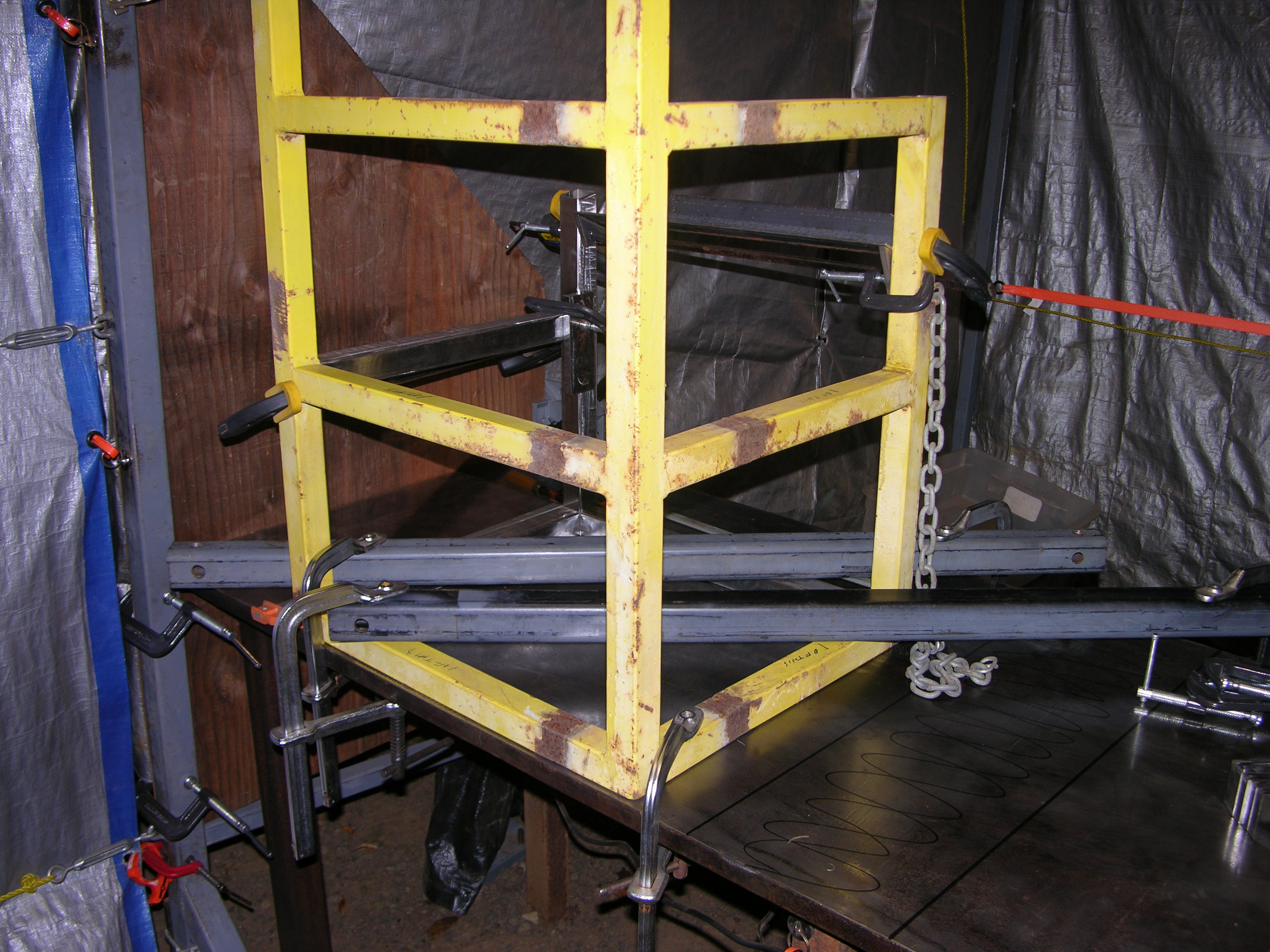

Speaking of which, got just about ready to tack pieces together for the cart - right now everything's clamped down to the 1" thick table and will only get UN-clamped when it's stone cold - when it's done, the 211 will sit on neoprene pads and be strapped in place, the 150 CF bottle will get locked into the corner beside the welder, and the two tallest uprights will get 1-1/4" tube inserts and a cross bar that's about 2" taller than the top of the gauges - it'll act as both a "roll bar" and a "hand truck handle", wheels will be 2 13" tires (offroad use, sorta) and 2 locking urethane wheeled casters for when it's upright.
I should get most, if not all, the welds done manana (doesn't mean I WILL :laughing: ) Anyway, here's today's doodles... Steve
(Oh, the unistrut is NOT part of the design, it's just holding the spacing between the rear uprights til it's welded out)

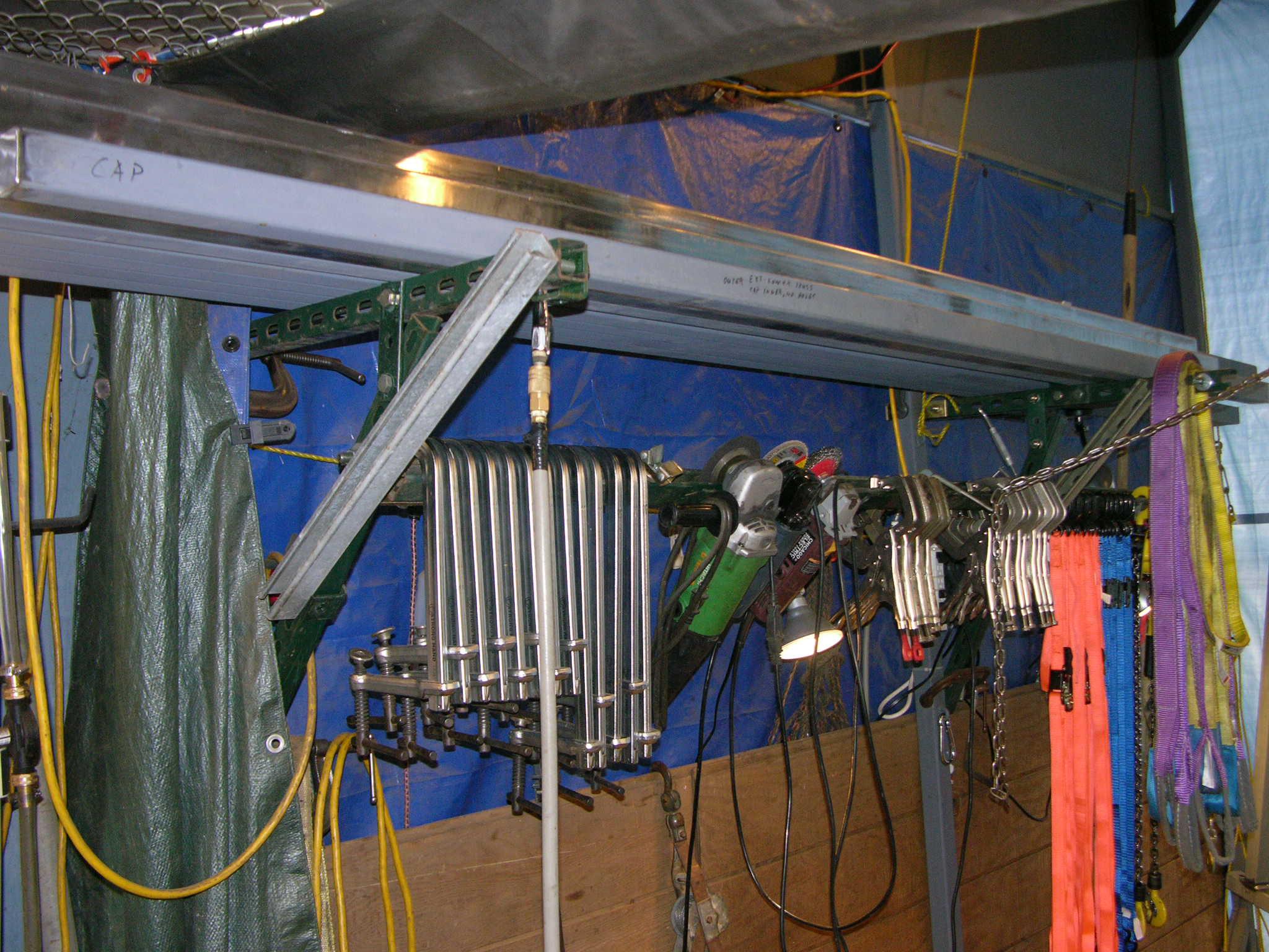

Clamp-a-holic??!? What gave it away? :laughing:
IMO, ya can't EVER have too many clamps; just maybe not enough room ta STORE 'em :D

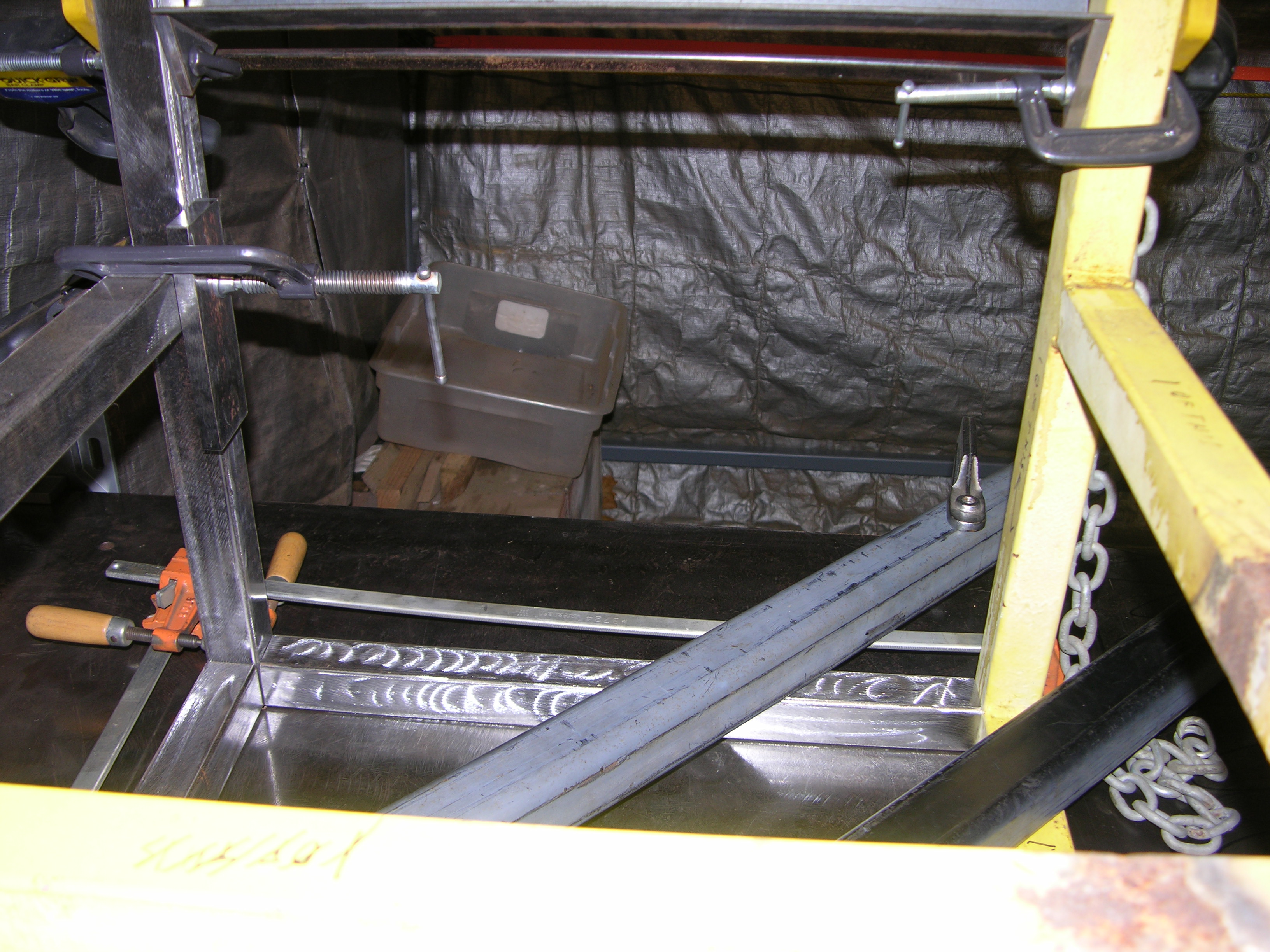

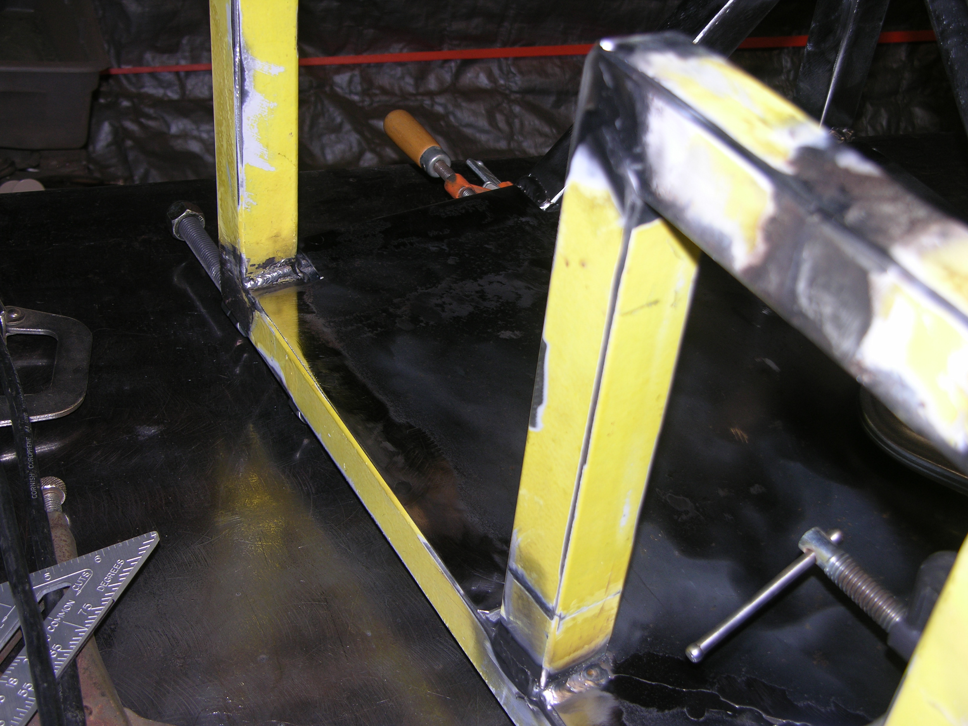

Oh, made a little bit more progress on the cart - one thing that's nice about a 1" thick table and a couple dozen good weld clamps is bein' able to only be about HALF as careful pickin' your next weld when doing the tack-up and weld-out... Steve

/ Container Weld Shop build - #25
Dewalt DWHT83186 24 in. Extra Large Trigger Clamp - - Amazon.com <<<<<<<<<For wood working these are the best clamps I have, in several lengths, but for steel have to becafull with hot work. I like those steel bar clamps in your second picture, I need to get couple of those, what are they called, steel bar clamps?
What size wire you using on this thin tubing, .030 70s?, if I use use .024 I have to use the 120v adapter plug or my M211 is to hot.

MM211 - I don't do "body work", and .035 wire's cheaper than the smaller sizes so that's what I keep in both machines, AND in the 30A spool gun most of the time (use the spool gun ONLY for things I can't reach with the 15' gun (no feed problems if I watch for kinks)) - the little 2# spools cost more to run than 44# or 12# spools.

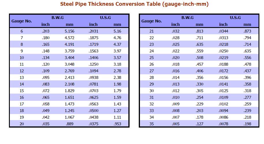

My older MM211 was too hot on autoset too, so's the NEW one - .095 wall tube is 13 ga., and I had the autoset down to the lower side of the 16 ga. setting before I was happy. Burned one small hole in the tubing til I got it right...

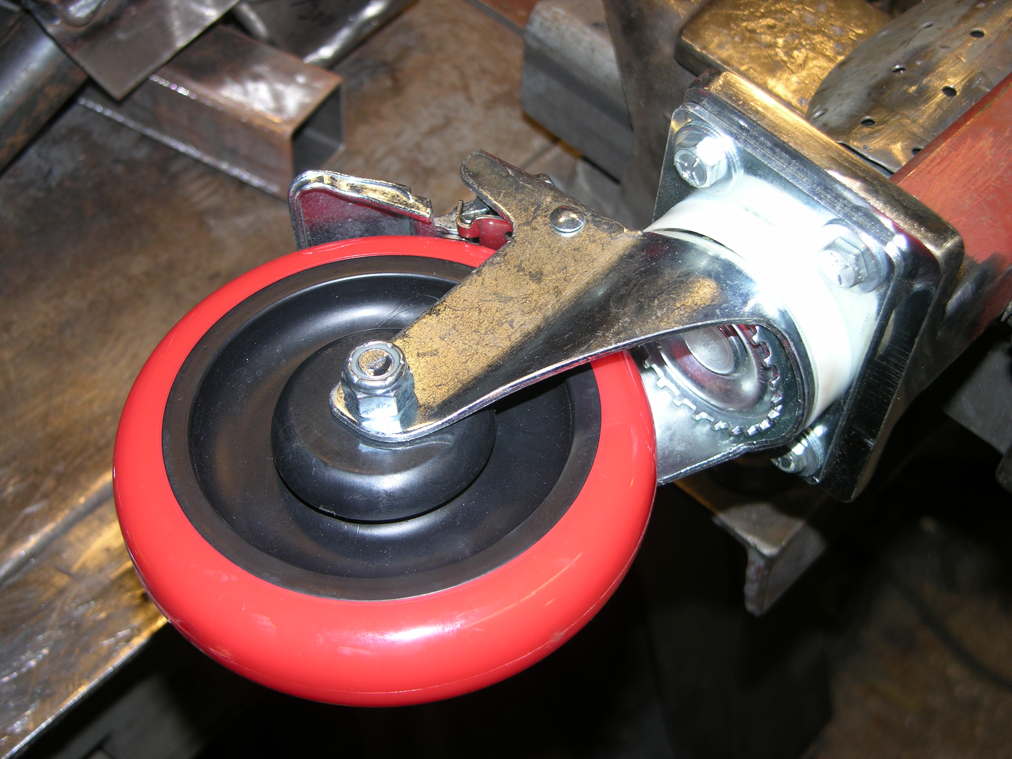

Casters - the back wheels are 13", so they'll set the frame bottom on the cart about 6-1/2" off the floor - I like Woodcraft's double locking urethane casters for shop stuff, no flat spots and lock better than most -
5" Caster, Double Locking, Swiveling with 4 Hole Mounting Plate
so when they go on sale (like NOW) I make sure I have at least one extra set of 4" and 5" ones "in stock" - the 5" ones give 6-1/4" of floor clearance, so I'll tack a piece of 1/4" FB at the back corners of the cart (front is where the 13" and the handle go) that'll keep the cart level when on flat floor, and the "offroad handtruck" approach will work on my "not so flat" ground between various shops/containers/trailers... Steve
Oh, I found this chart helpful; don't always remember these equivalents -
Also, if you DON'T have a previous Enco deal at MSC, Amazon has them about $10 cheaper than MSC - STRONG HAND 4-IN-1 CLAMP KIT~ 8-1/2" 12lbs ~ UG85-C3 - Bar Clamps - Amazon.com

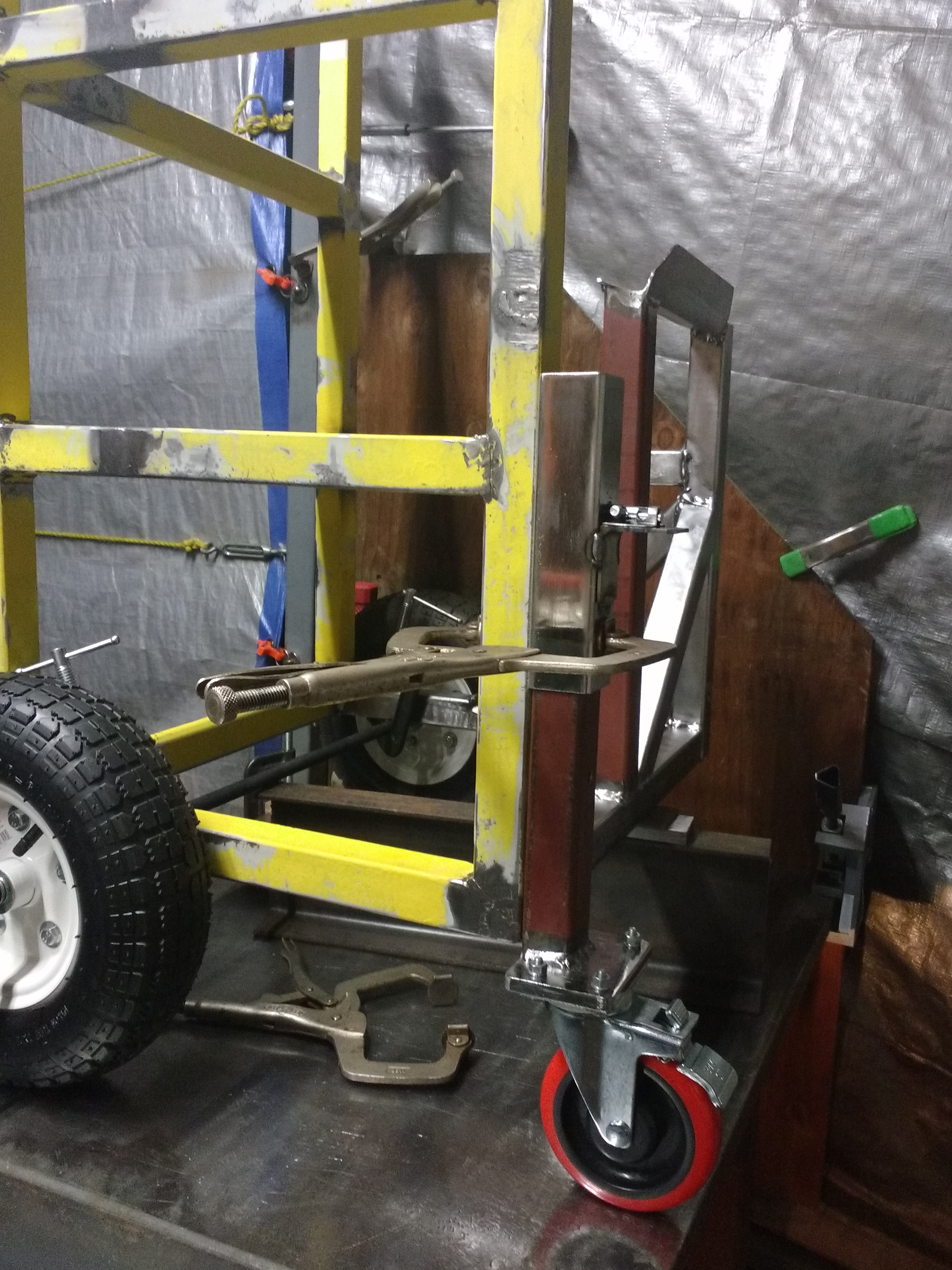

Been fighting a crappy sinus cold the last couple weeks, not a lot of initiative to brave what passes for winter around here; but the 5" casters FINALLY showed up yesterday so I drug my sorry butt out and made a little progress - since the mm211 cart's gonna be its own "trailer" that can be towed with the mower, I wanted the small casters to be out of harm's way when it was in "trailer mode", so they get an "UP" position (towing) and a "DOWN" position (rolling on flat smooth places) - in "smooth mode" the hitch will pivot up to keep the (relatively) small footprint.
Hitch design itself is still rattling around in my head, but got both 2-position caster mounts fabbed up today and clamped one to the cart to check fit - looks like it'll work as intended, here it is in up and down modes... SteveWeldCartCasterDown.jpgWeldCartCasterUp.jpg
Hoping the sinus crap's almost done screwin' with me so I can get the rest of the cart done pretty soon...

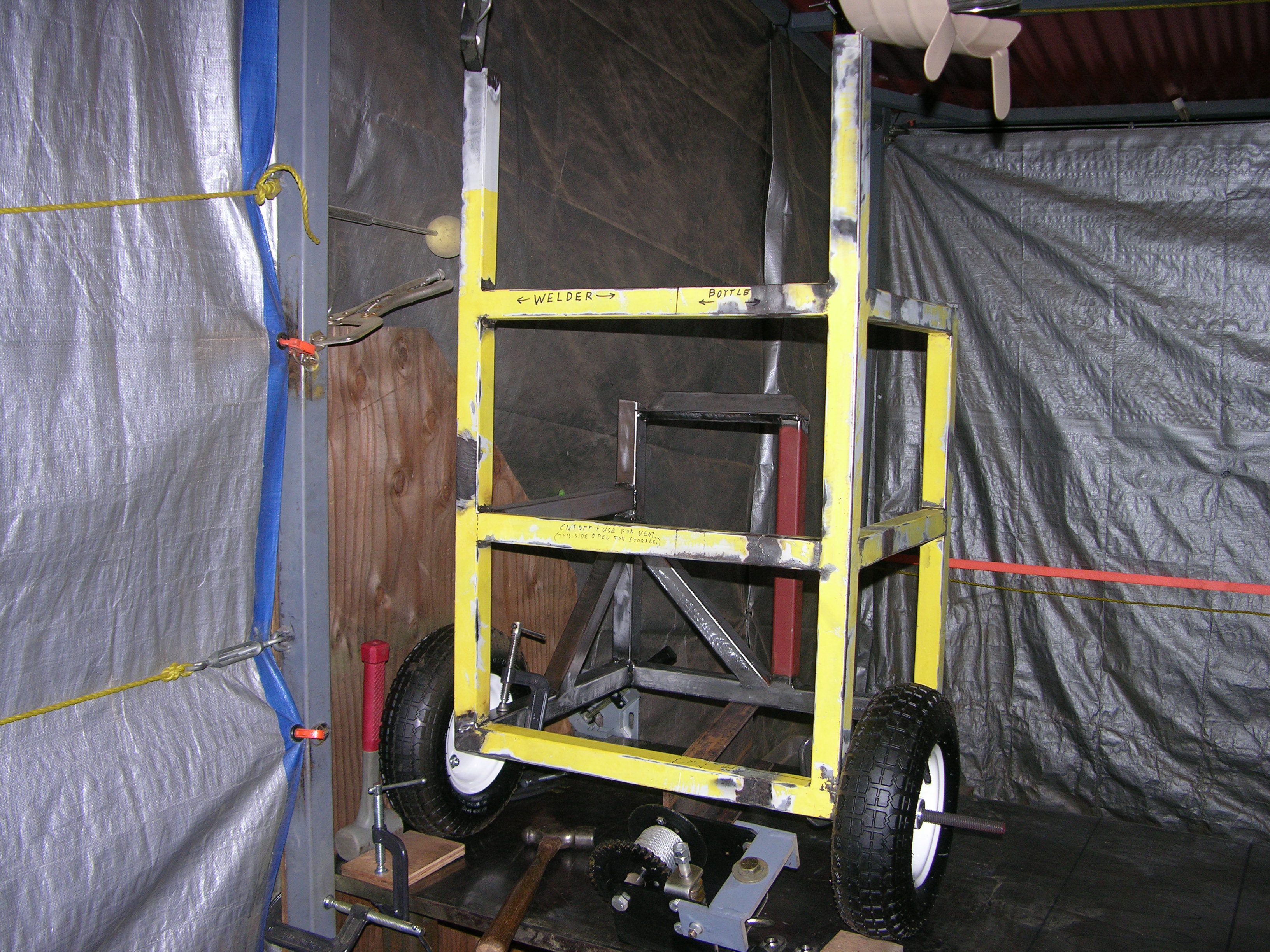

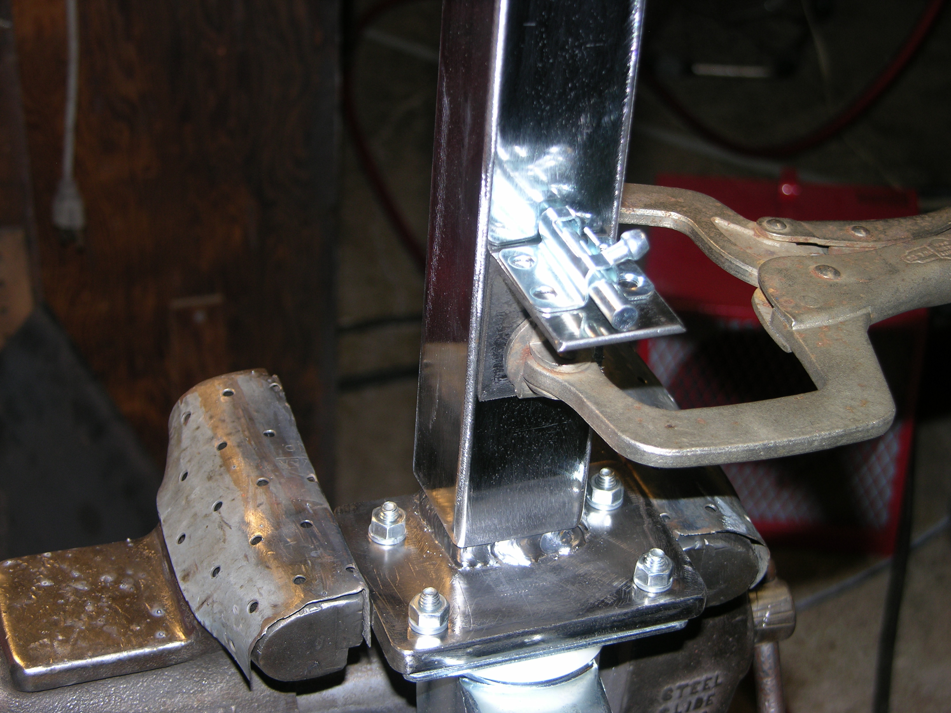

Strong - yeah, the part I "re-purposed" is .095" wall 1-1/2" tubing, should be fine with that light a load. Most of what I had for add-ons is .120" wall :rolleyes:
Casters - 2 positions, up has the bottom of the wheels FLUSH with bottom of cart frame, down puts 'em against the floor when the cart is level.
Handtruck - yeah, that's one of THREE modes - the two tallest uprights at the front are the .095" wall, makes for a slightly loose fit for 1-1/4" tube nested. Once the rest is done I'll add a hand truck handle that slips into those uprights and STAYS, top of the cross-bar will be just high enough to protect the tank regulator WITHOUT obscuring the gauges. The big tires axle will likely end up right at the front corners.
Then, on the BACK side I'll add a 1-1/2" .120" wall square tube "trailer tongue" just under the frame bottom - 1/4" plates on both sides just where it exits the cart, with a pivot and 2-position pins - down for trailering (2" hitch ball) and up for "flat country" - the tongue will be long enough for easy maneuvering, it can stick up at least 4 feet without getting in the way of anything. It'll also make a nice "lever" so I can take the weight off the casters for raising/lowering. With the hitch pinned UP, footprint of the cart will stay minimal (container, remember?:laughing:)
I figure "trailer mode" will get it up/down the slope between house/garage and the 2 shops (towed by the ZTR), "hand truck mode" will get it up ramps to the container, a trailer, etc, and "flatlander" mode for actual use.
Good thing I don't plan on FLYING anywhere to weld, THAT might get a bit more complicated :rolleyes:

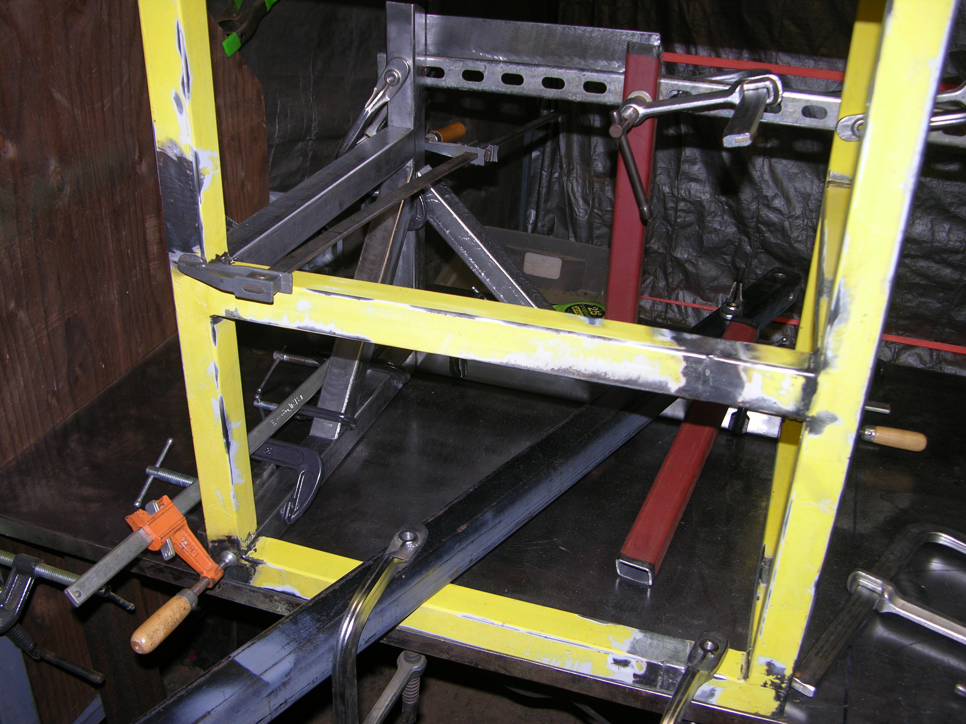

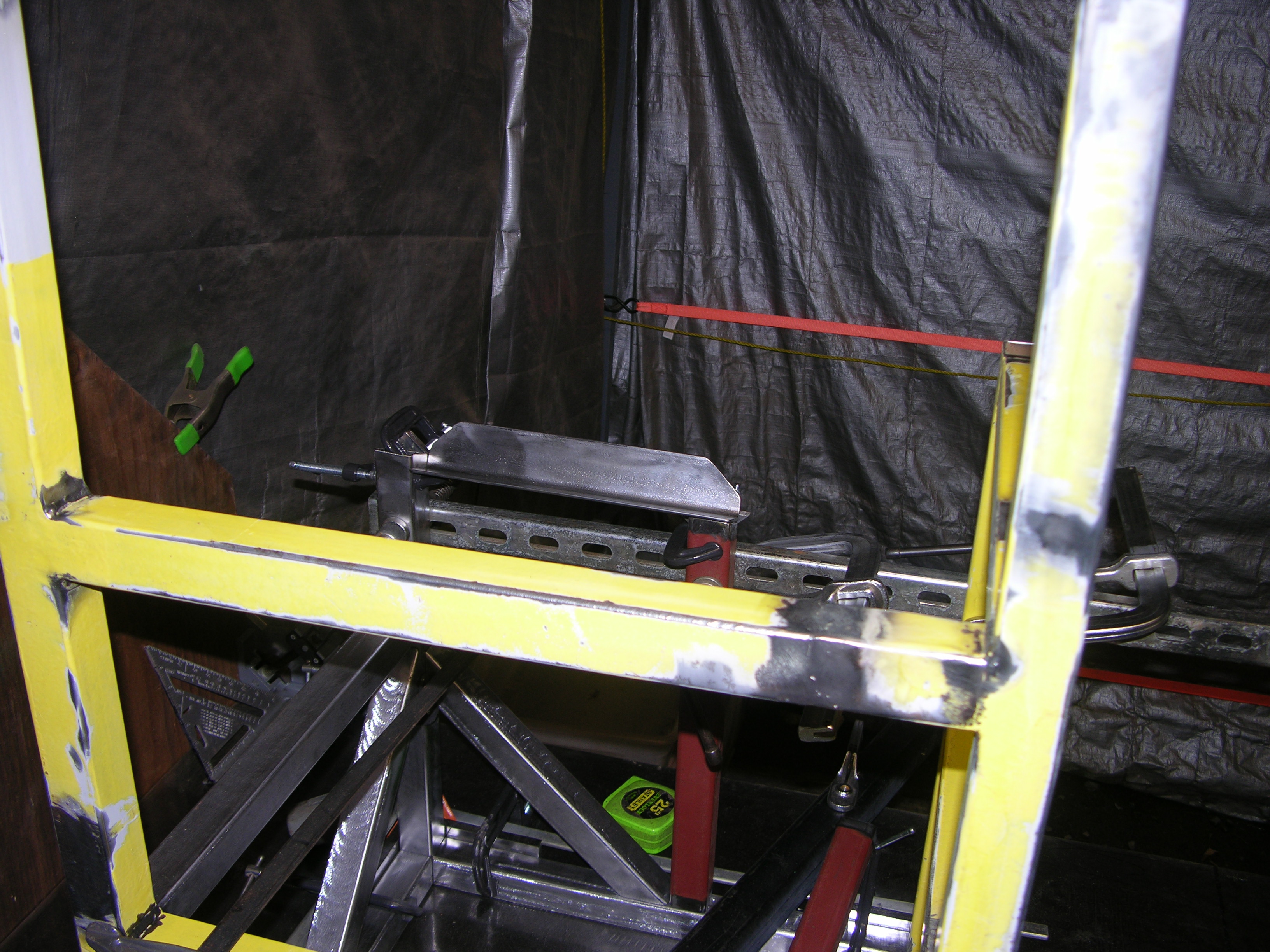

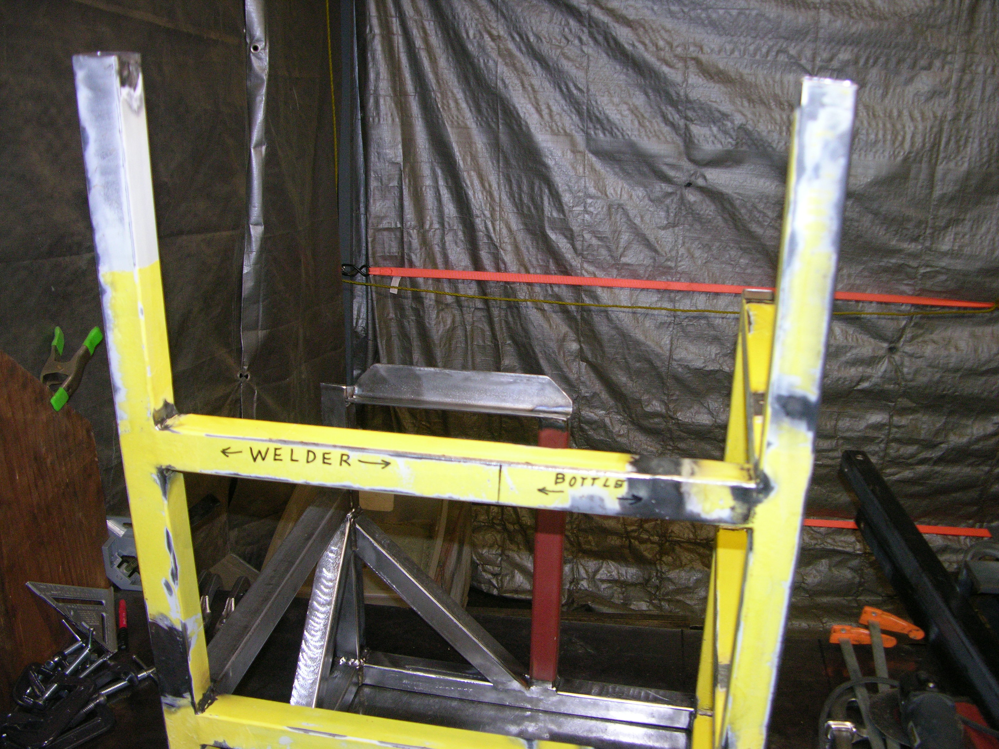

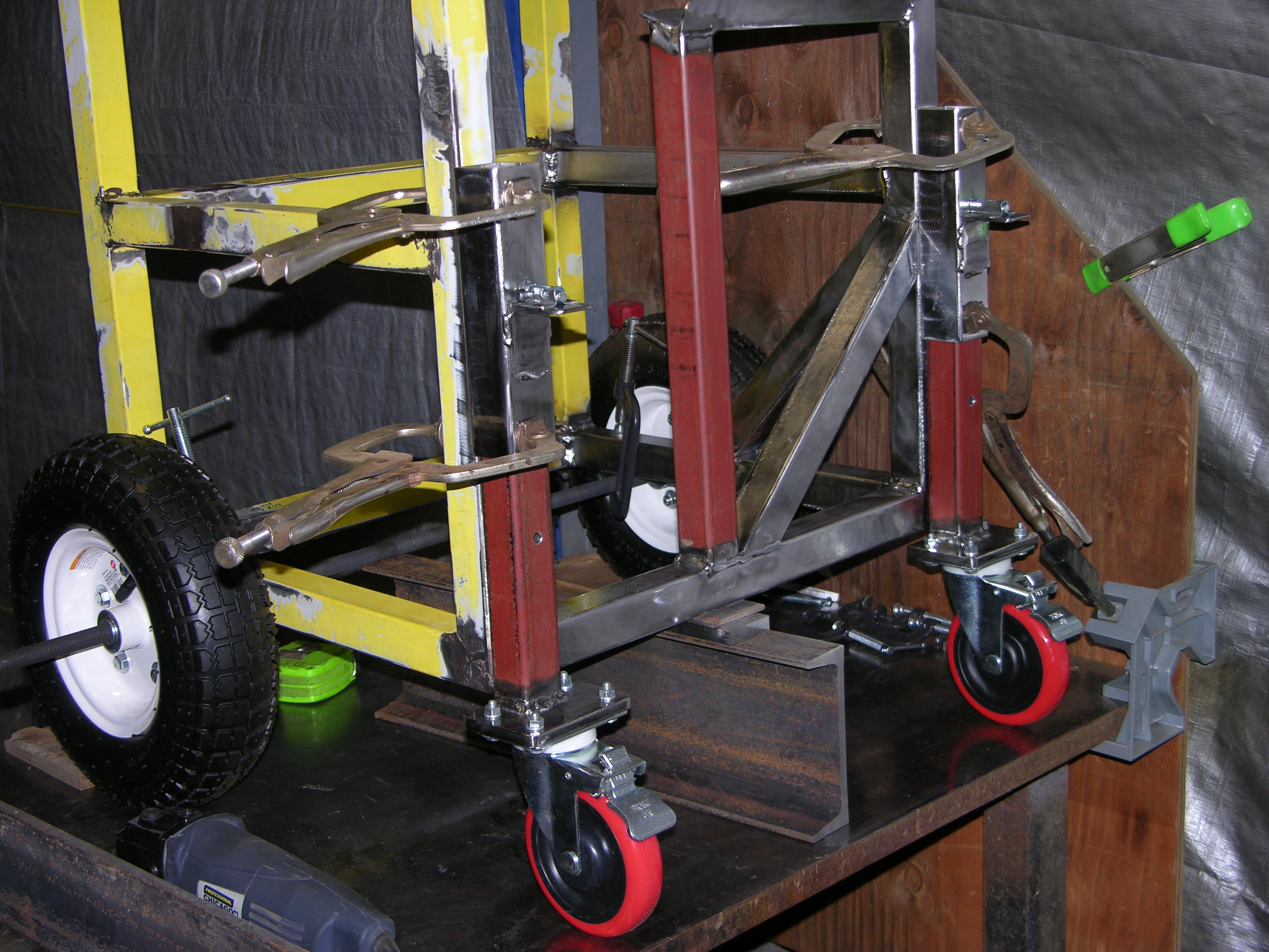

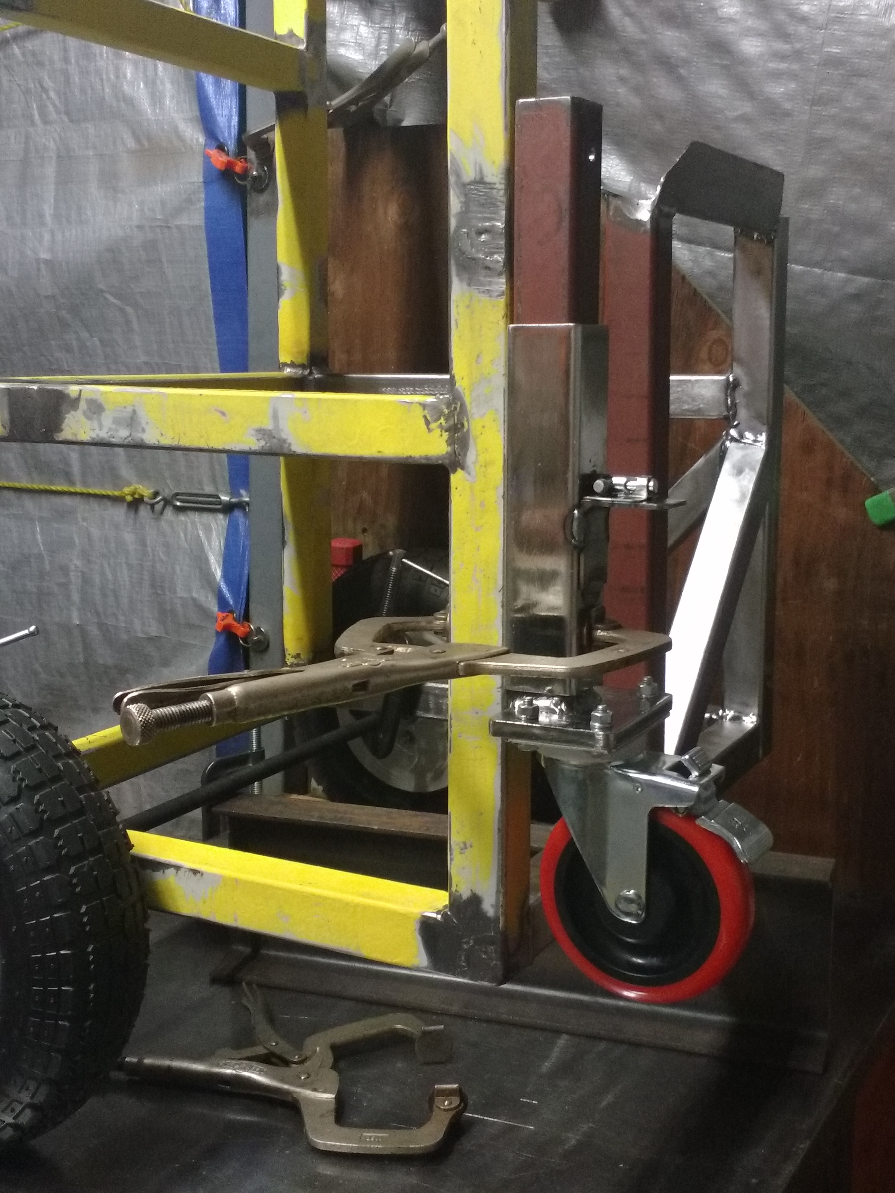

Here's today's progress - finished the second caster mount; the mounting plate needs to be FLUSH with the 1-1/2" tubing it's welded to so it'll retract alongside the cart vertical corner. Didn't wanna mess with gussets, had some 3/8" FB. Figured it'll be plenty strong that way. A small piece of 2" angle mounts the small barrel bolts, didn't wanna mess with more screws but 4 holes told me it wuz OK to do quick plug welds :cool2: I plug welded (more like a quick tack) the barrel bolts AFTER drilling the locator holes, bit tricky OTHERWISE :rolleyes:
From the back, the left side gets the 150 CF C25 tank (locked into the YELLOW corner, right next to the big wheel) and the welder goes on the right - This will keep the side door accessible WITHOUT having to remove the welder.
Between the frames there's about 1/2" left over (that isn't taken up by either the welder or the bottle) - kinda snug, but doable. The trailer tongue (fixed part) will exit just under the bottom of the frame, center is between the red upright and the shiny gusset piece. I'll get everything else (including the welder) in place BEFORE deciding how much stick-out the tongue's pivot point will need - I'm keeping a "pick-point" in mind as I do the hand truck handle part AND the trailer tongue part, it'd be nice if I wanna set the whole thing somewhere with the loader.
OK, 'nuff blather - here's the dirty pitchurs y'all been waitin' fer :D ...Steve

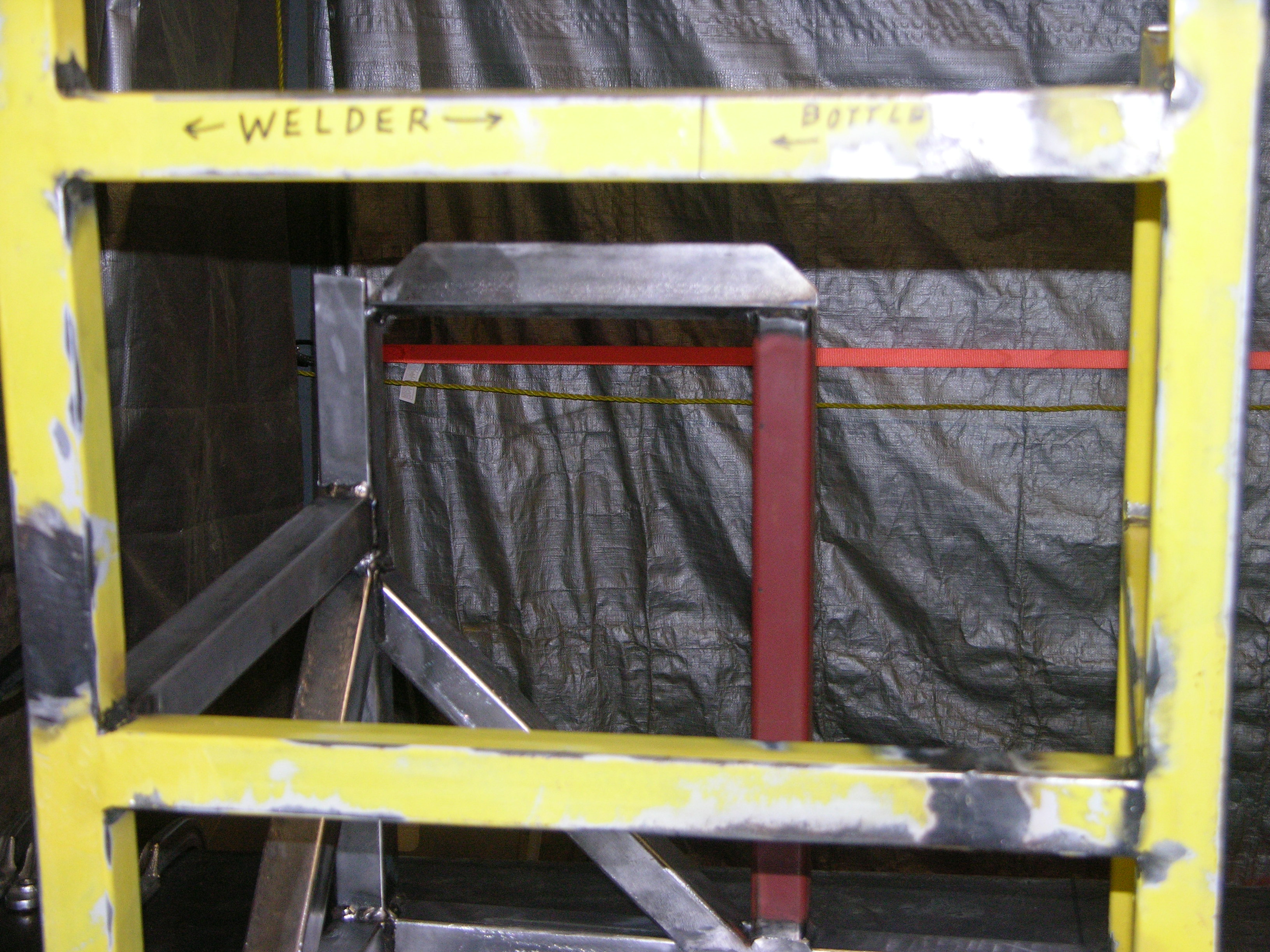

"I'm still having visual difficulty on where the welding machine is going, probably cause I cant see the side door in the pictures or maybe it's an invisible door and the trailer hitch cant quite see where which how that's going is either, I know you haven't made that movie yet. Pick point, now that's good planning.............PS Thanks for posting the pictures, looking like an awesome weld cart! "
I re-read my post, wasn't very clear - I was referring to the side door of the WELDER - didn't wanna hafta remove it from the cart to change wire, adjust tension, etc -
Positioning - check the first 4 pix on the first post of this thread, they are "pre-surgery" - as in, BEFORE I started "removing everything that isn't an elephant" (oops, I meant isn't a weld cart :D)
Also, look close at this one DSCN2900.JPG - it's marked where welder and bottle go; face of the welder will be angled up for better visibility, rear sets on that un-painted piece of angle at the back.
I'll add two "rails" along the sides of the welder (1" angle) so the welder can be positively strapped in place (Handtruck mode might get ugly otherwise) - Anywhere the welder touches the cart will get 1/4" neoprene glued in.
Also, because of the "offroad" options I didn't want the leads to be flopping around much, hence the dual hose hangers (no, they are NOT on wrong - mig gun will exit the welder front, wrap over the top of both, back around til it's almost all wrapped, then the gun goes in that piece of clamped on tubing (also used as a gun holder BETWEEN welds). Similar for ground and power leads: I typically plug in power, then ground, then gun, open gas, power up, set purge flow, go - so for shutdown, torch lead wraps first, then ground, then power.

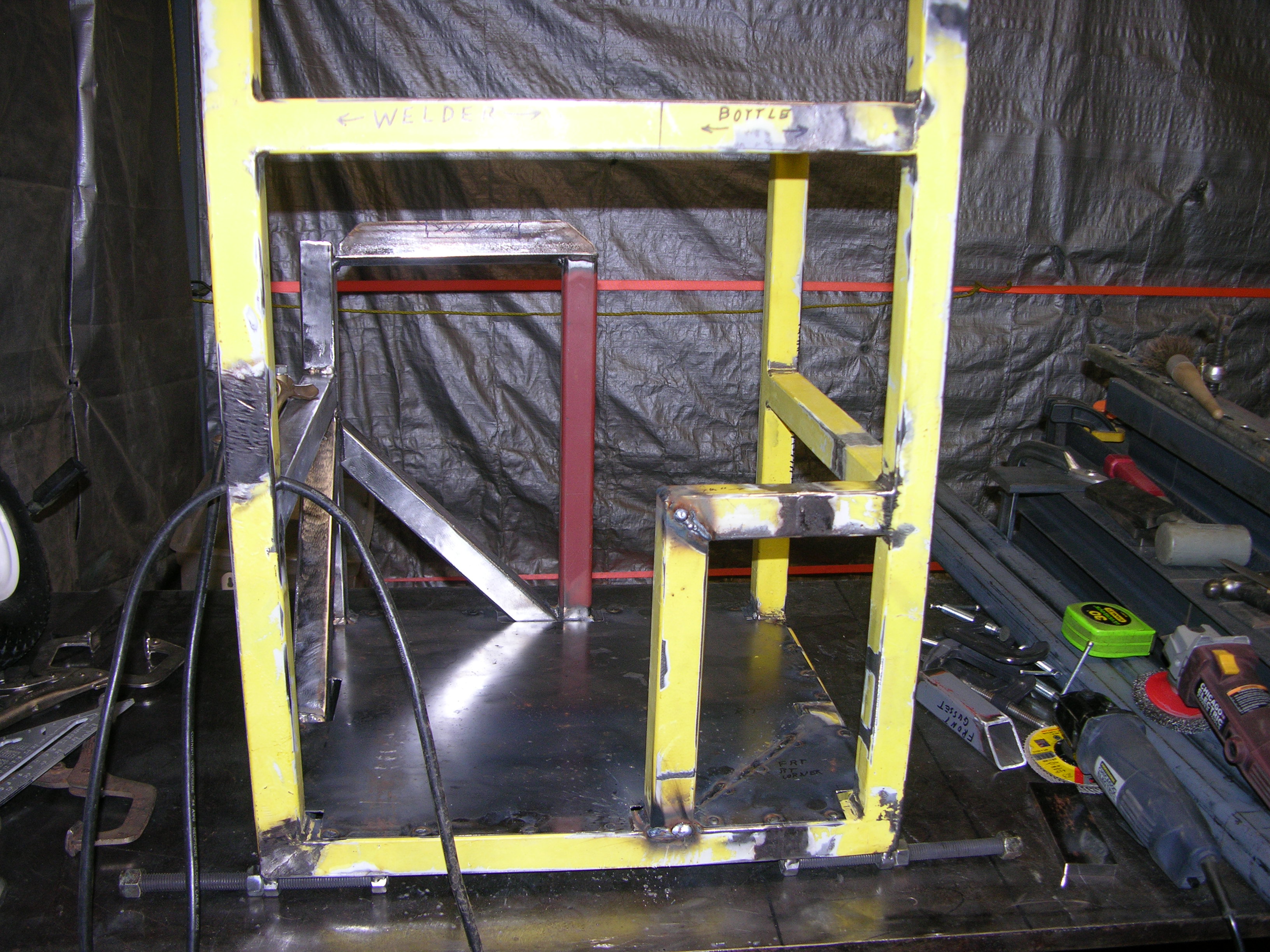

Couple more pics, all I did today was set the axles for the 13" wheels and weld in place, clean up a bunch of flash rust, punch the hose hangers for mounting screws, weld a few tacked joints I'd missed - Tomorrow I need to cut out about 60% of the front middle cross-bar and reinforce what's left for bottle cage - that way there'll be room for a good-sized drawer under the welder that'll hold leathers, hood, gloves - and if it's tall enough, another Short drawer for nozzle gel, mig pliers, etc...
Trailer tongue will be 2 pieces - one piece will have FB on both sides, drilled for pivot and position pins, and will be welded to the underside of the frame - from center on the front to about 3" OUTSIDE of the rear bottom of frame. Second piece will have a hitch on outer end and will pin into the first piece. Both halves are 1-1/2"x.120" wall square tube. And you're right, the script for THAT movie is "still in re-write" :rolleyes: -
But in my head, the horizontal handle for the hand truck will get a sleeve that can move left-right to balance between welder and bottle, as well as one that slides front/back on a tube that'll connect the hand truck handle to the hitch end of the tongue when it's in vertical position. That should let me compensate for balance in BOTH directions so the picking eye will let it hang level. Both of those "leveling sleeves" will get set screws consisting of 5/8" dog pointed wing bolts for locking the sleeves to the picking frame parts.
Might get far enough tomorrow or the next day to set everything in place, then it oughta be clear as mudddd... Steve

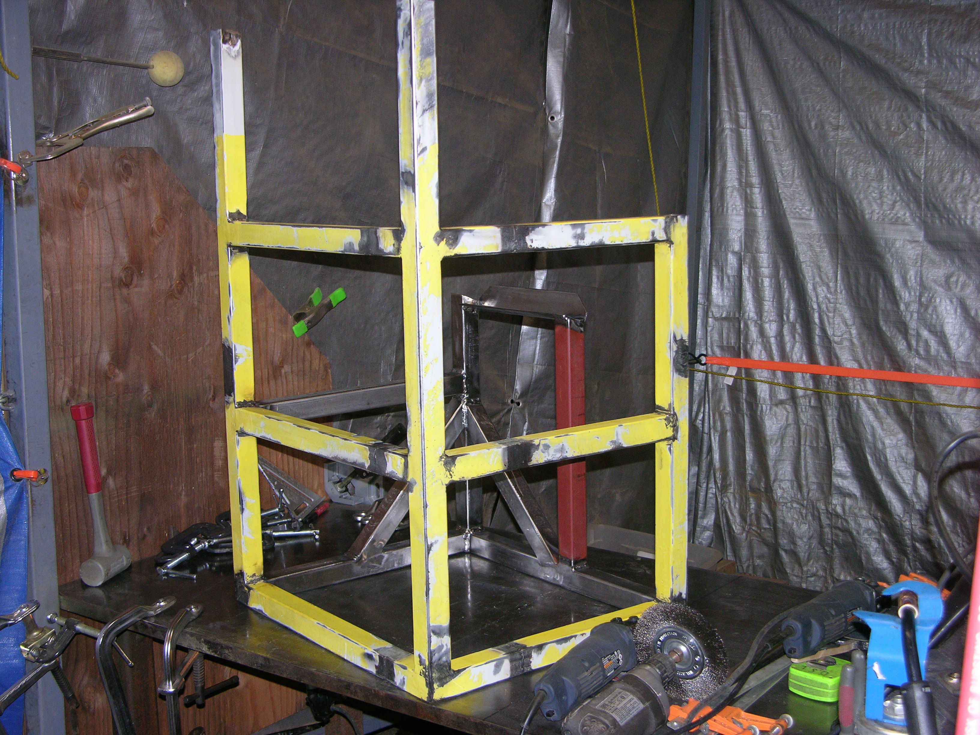

OK, who am I kidding - I'm old, tired and just a teensy bit OCD, no WAY I'm EVER gonna get as much done in a day as I THOUGHT I would :rolleyes:
Oh well, probly woulda got MORE done if some bozo hadn't forgot and welded out a joint that was gonna get partially cut away :confused: - finally got THAT cleared out, and the changes lightly tacked. Then made 2 gussets for the bottle area. Those will NOT get welded in til the FLOOR is in place (piece of 16 ga. 20" x 22") - ONE of those gussets will go UNDER the floor where the bottle sits, other one will brace the corner where the bottle goes. By putting the floor in first, I only have to notch out for 4 corners and TWO other "intrusions", instead of three.
Having to re-think the pick point design, previous idea woulda made the trailer tongue almost 5 feet long, I really don't want it more than about 36". Gotta get a couple more things done before I get back into that - But it WILL happen :D

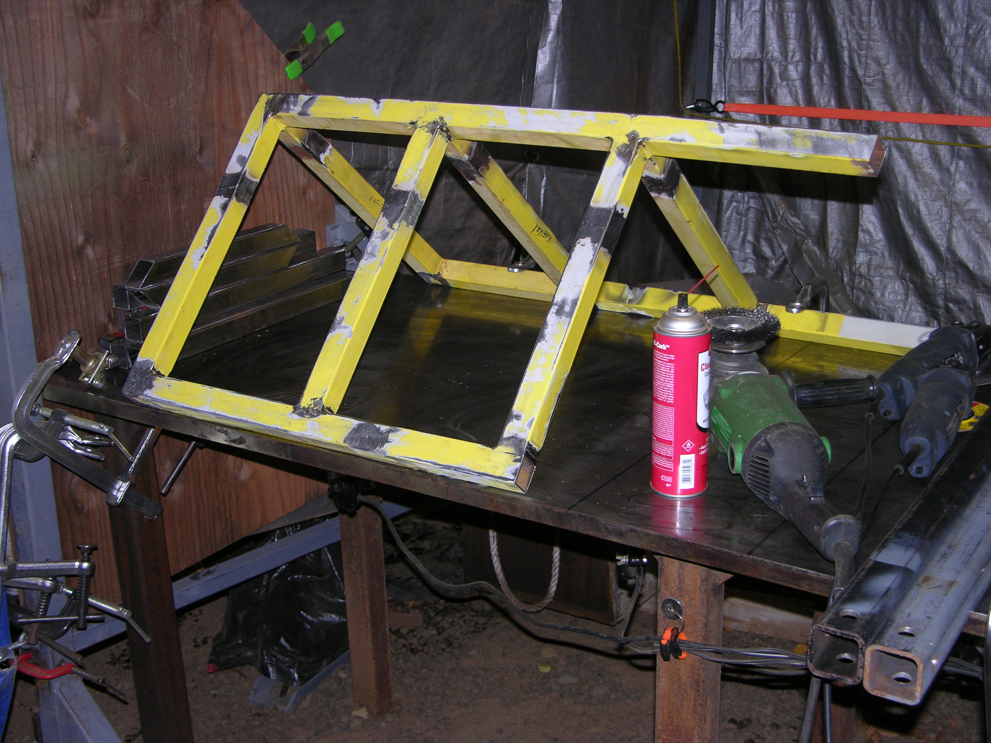

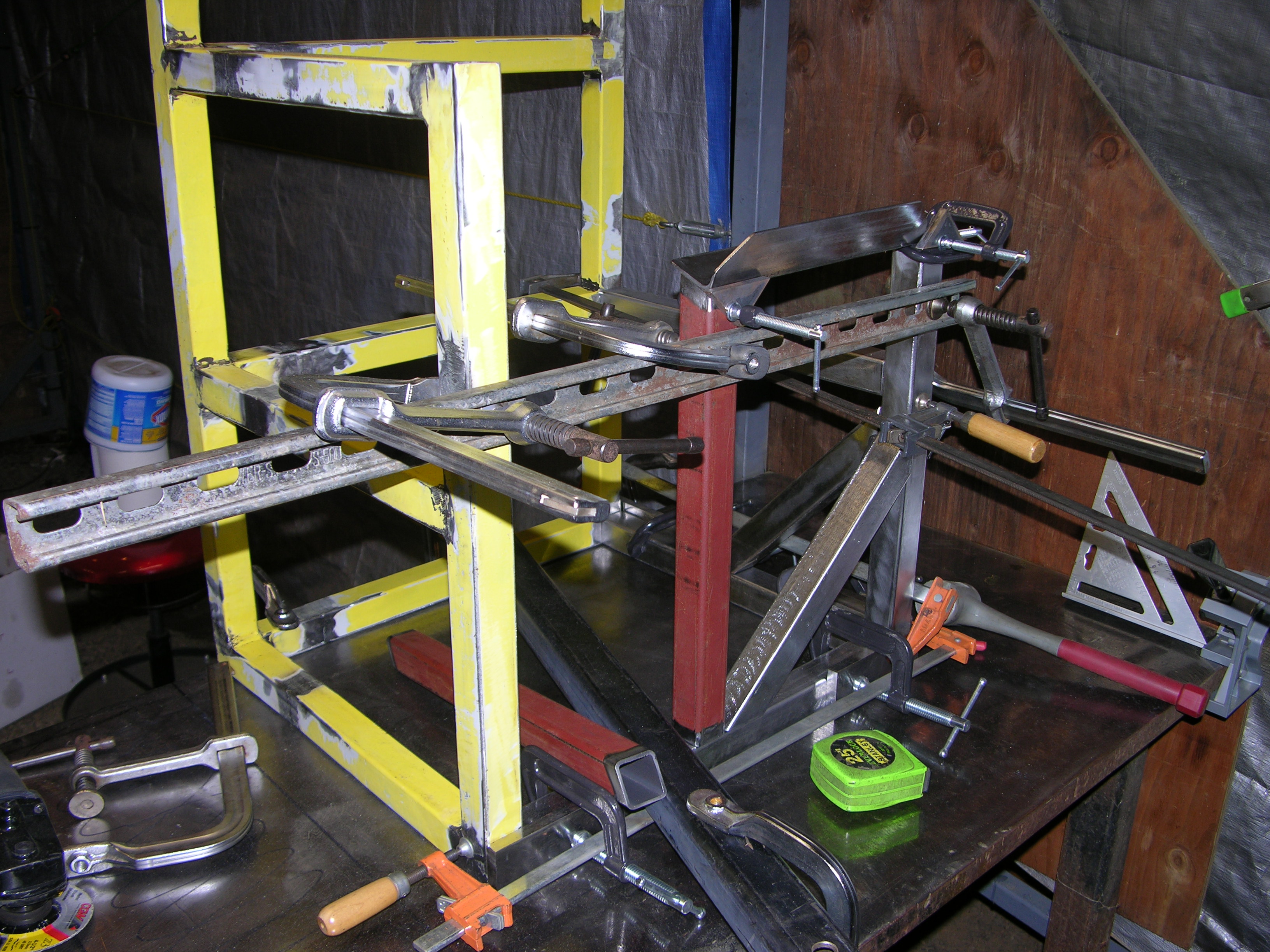

Anyway, today's pics are of axle mounts (5/8" gr. 8 allthread) and the way the front is after I made room for my deep drawer. The 13" tires are at the FRONT of the cart/front of the welder, BTW... Steve

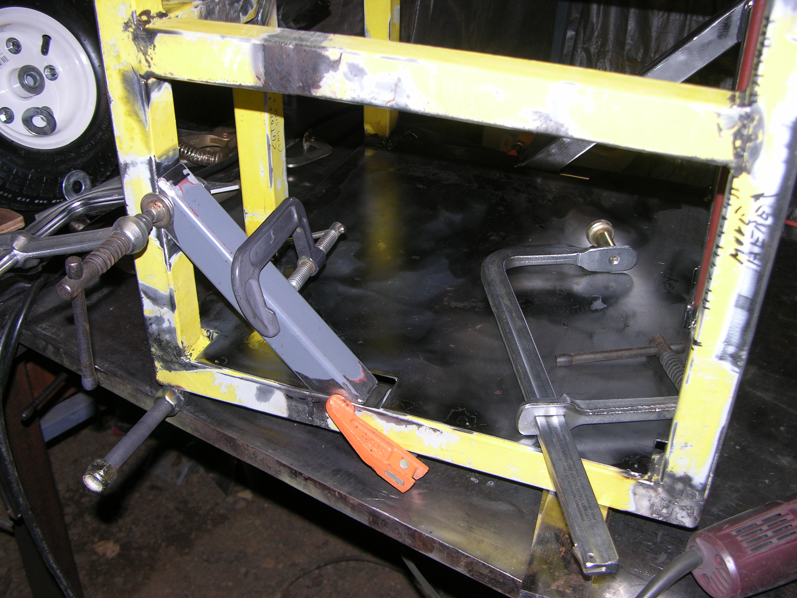

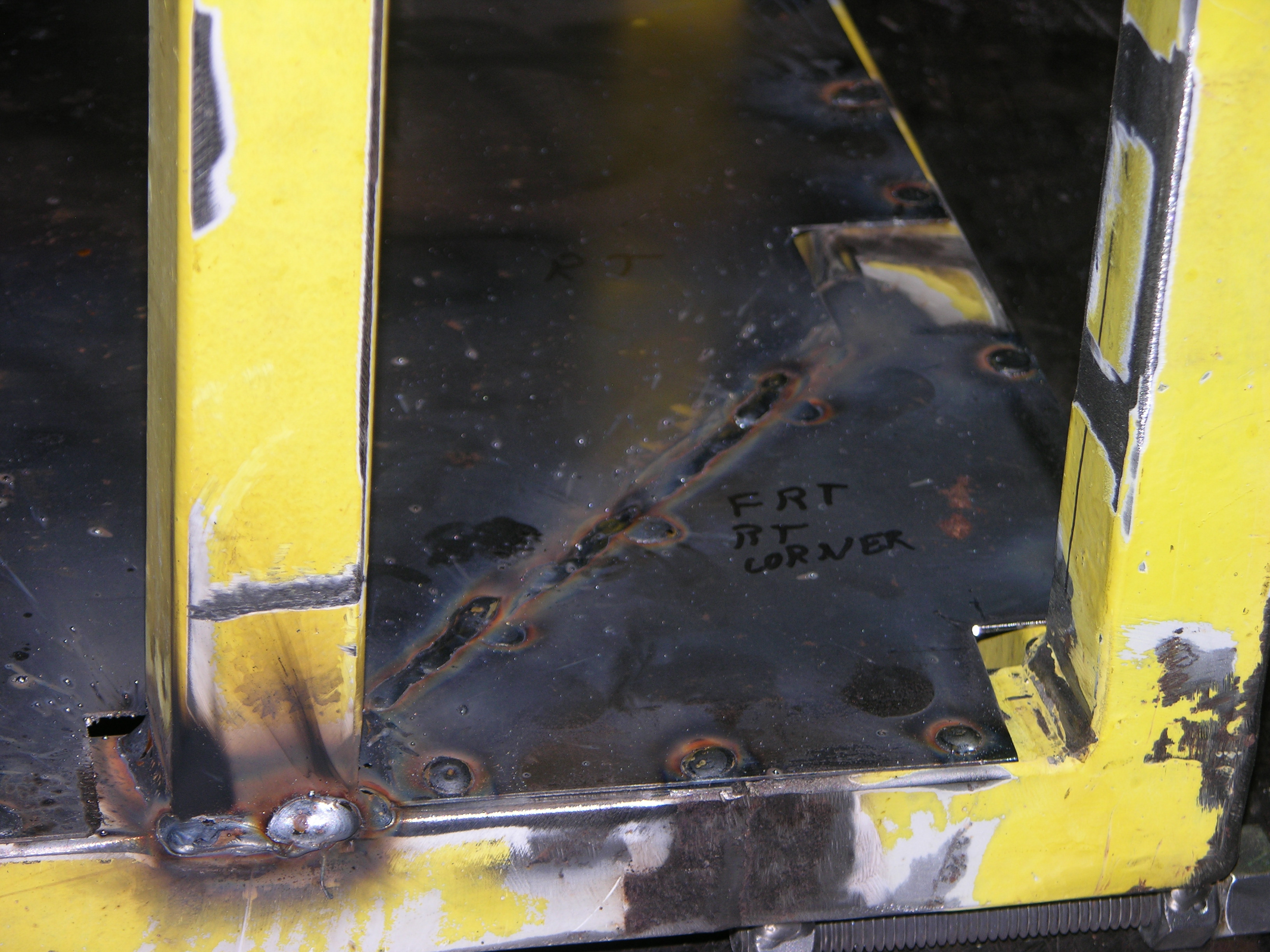

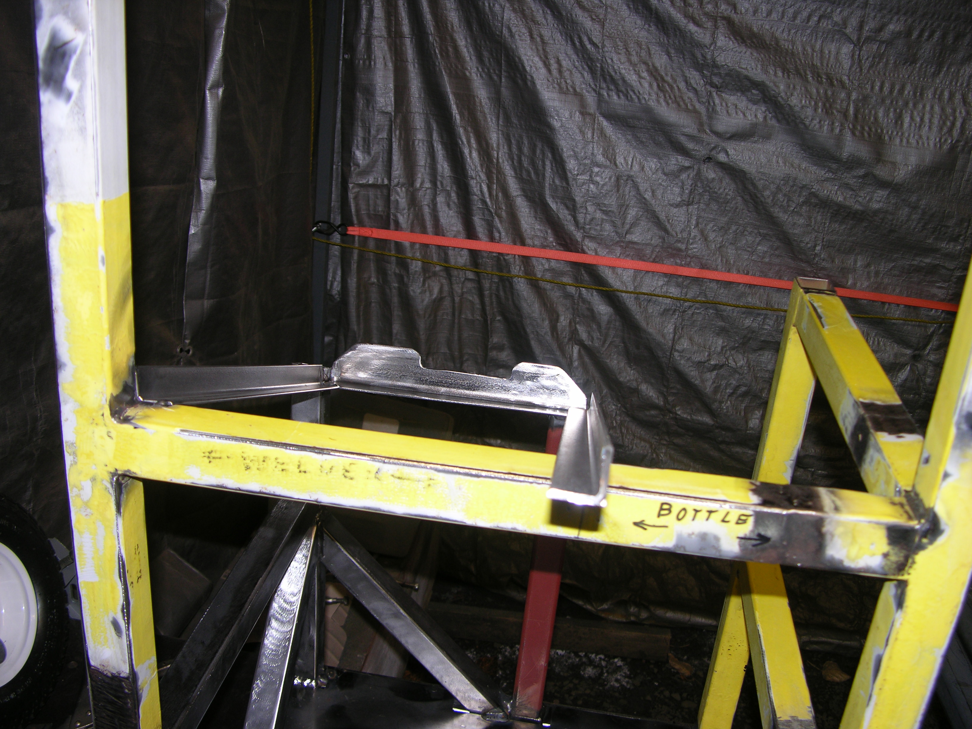

Three steps forward today (right AFTER at least TWO BACK :rolleyes:)
I cut out a piece of 16 ga. for the "floor" of the cart - marked and cut out all the "interference" parts where uprights and angle braces are - which is when I found out for SURE that the diagonals shoulda NOT been welded in til AFTER the floor was in place...
tried every angle I could think of, NOTHING worked. Not even close. So then I looked at the corner brace that goes beneath where the bottle sits (rather than expect 16 ga. to handle that all by itself) - and marked where it'll contact the floor piece - then I cut that corner OFF of the floor piece and tried again.
STILL no cigar, but ALMOST - another minor trim on the floor piece and it fit :cool2:
So the new "plan" is to weld in the diagonal that goes under the bottle, then plug weld the larger piece of the floor in place, and finally plug/seam weld the triangular piece whose ABSENCE lets me "win" - the plug welds will be easy - I bought one of those HF pneumatic punch/flangers a while back, with a 20% coupon got it for $30 and some change
Air Punch Flange Tool
16 gauge is its max, but that's limited more by the slot size; it has no problem punching 16 ga. steel. Once the edges of my floor are punched every 2-3 inches around the perimeter, I'll lay the floor back in and mark thru the holes with a sharpie so I'll know where to shine up the frame for best plug welds.
Once the floor's in and welded, those "notches" around the perimeter will let me put the REST of the bracing back, welded to the FRAME instead of to the 16 ga. floor.
I guess as long as I manage at least ONE more step forward than back, I shouldn't get TOO depressed - but I think it'll BE awhile before I "wing it" on another project, instead of actually PLANNING what I wanna do :rolleyes: ...Steve

"I watched the video on HF, looks to me that punch flange tool is good way of making holy steel, does it come with different size punches? "
Nope, it's basically a "two-trick pony" - the throat on the hole punch isn't very deep, puts a 3/16" hole about 1/4" from the edge, max is 16 ga. I haven't used the other side much, just on a piece of scrap but it seems to work well too.
I used it earlier today around the perimeter of the cart "floor" as I mentioned earler, did about 16 holes in under a minute. I also used it a while back to pre-punch holes in some 16 ga. panels for the "clerestory" parts of the container roof, made it MUCH easier to get those up using self-drilling screws - DSCN2758.JPG - the bottom row of screws had to be too far in from the edge and got drilled, but both ends and the top edge of each 2'x8' panel were done with the air punch.

It finally warmed up to 37 about 3pm, so decided to get a couple braces and the floor welded - it's 'sposed to be dry but cool here for the next week or so, 30's at nite and about 40 tops midafternoon. Old and cranky wuss that I am, it sounds like a good time to do more drawings :rolleyes:
Meantime, here's 2 from topside and a couple from the bottom; I'll do cleanup manana, maybe more if a rare fit of machismo strikes (yeah, right :laughing:) ...Steve

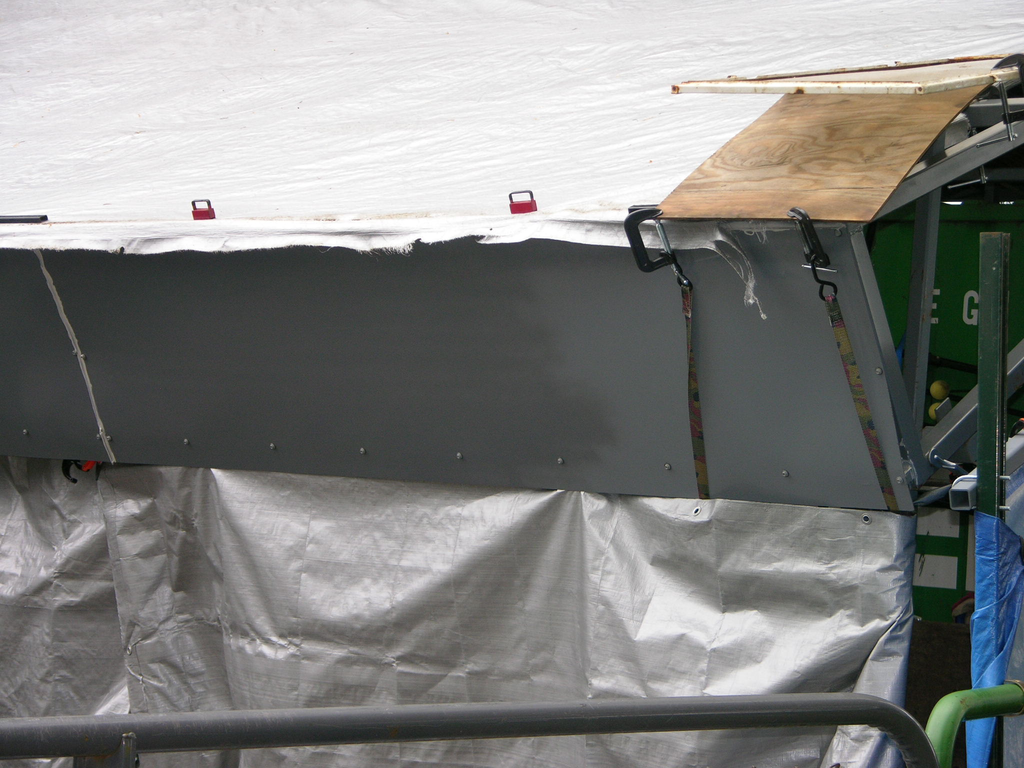

OK, you just HAD to bring up Murphy's Law, dintcha??!? - I went back out after supper and checked a few measurements, discovered the piece of angle I so carefully fitted and WELDED, was NOT square to the rest of the frame - it wouldn't be a big deal, but I MUST have a minimum of 7-1/2" clearance on the BOTTLE side or it won't FIT - so manana, I'll cut the outside piece of 1" angle and do a bit of surgery on that back corner tube (Thank God for thin slicer disks), then I can add 2" onto the angle I need to cut off and move that lower end OUTBOARD about 3/8" - that way, the two pieces of angle will be parallel AND square, and I'll STILL have just enough room on the bottle side to make it work....
Today's pics; making another corner brace, using the 45* adapter I fabbed for the smaller saw - I also made one for the bigger Jet saw, best thing I ever did - Then, brace ready to weld; floor plug welds smoothed off; Angles set in place showing where the welder will sit.
I think instead of 1/4" neoprene strips I may cut 1" pipe insulation in quarters (lengthwise) - it'll take a little less room between those angles and keep things a snug fit... Steve
