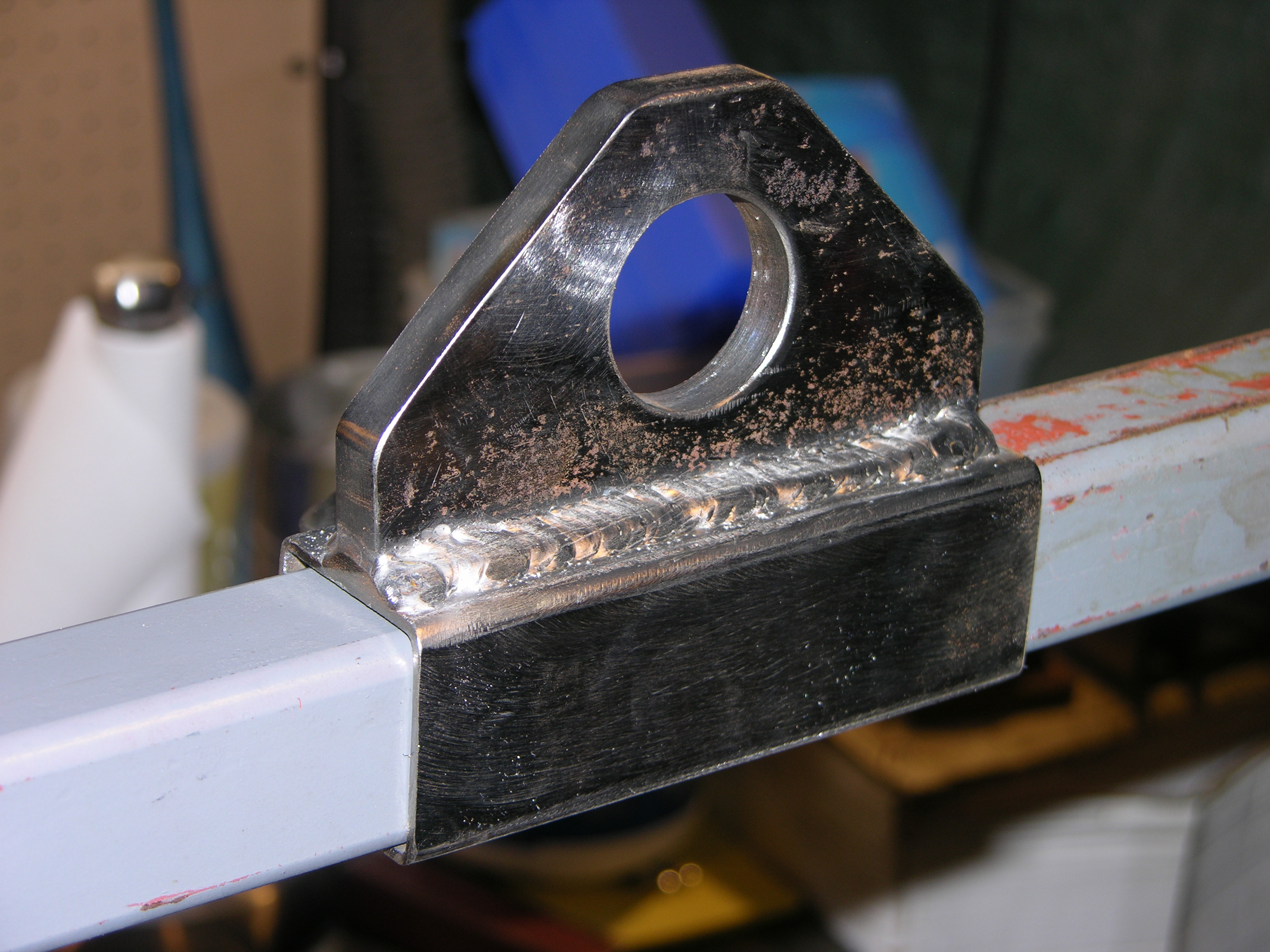

Your weld looks incredible - to my (mostly untrained) eye, it looks too purty/even to not be a machine weld (if it's NOT, consider that a COMPLIMENT for sure) - mainly it looks multi-pass (straight line down the center) and maybe ground down in the middle (pattern along the sides, less down the crown) - I've got maybe 5 MINUTES experience with SPRAY, and it didn't look like that (no real pattern, looked more like the joint was CAULKED with a really smooth bead) -
Sooo, now that you accomplished your "shock and awe" mission, how 'bout some DETAILS??!?

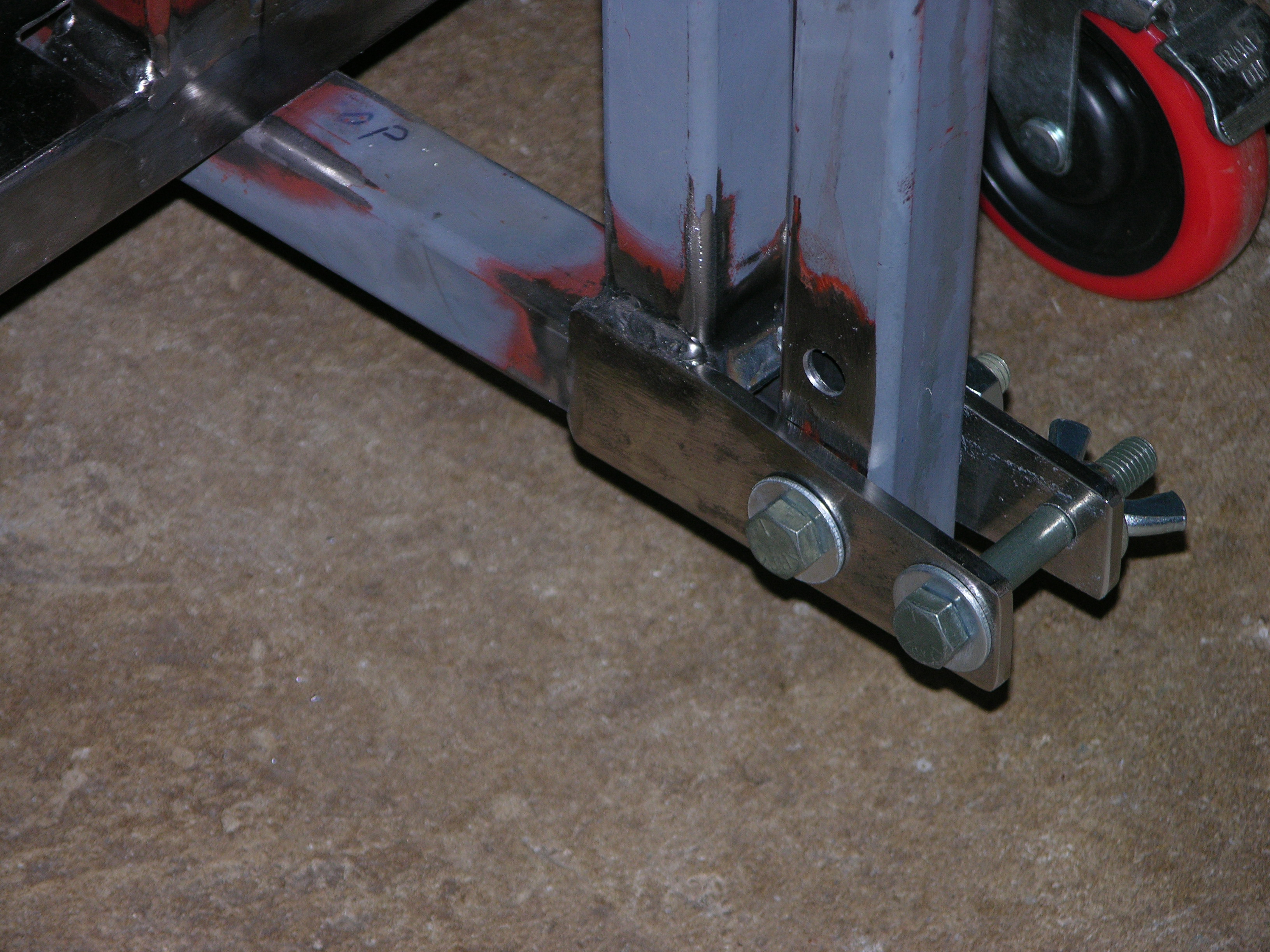

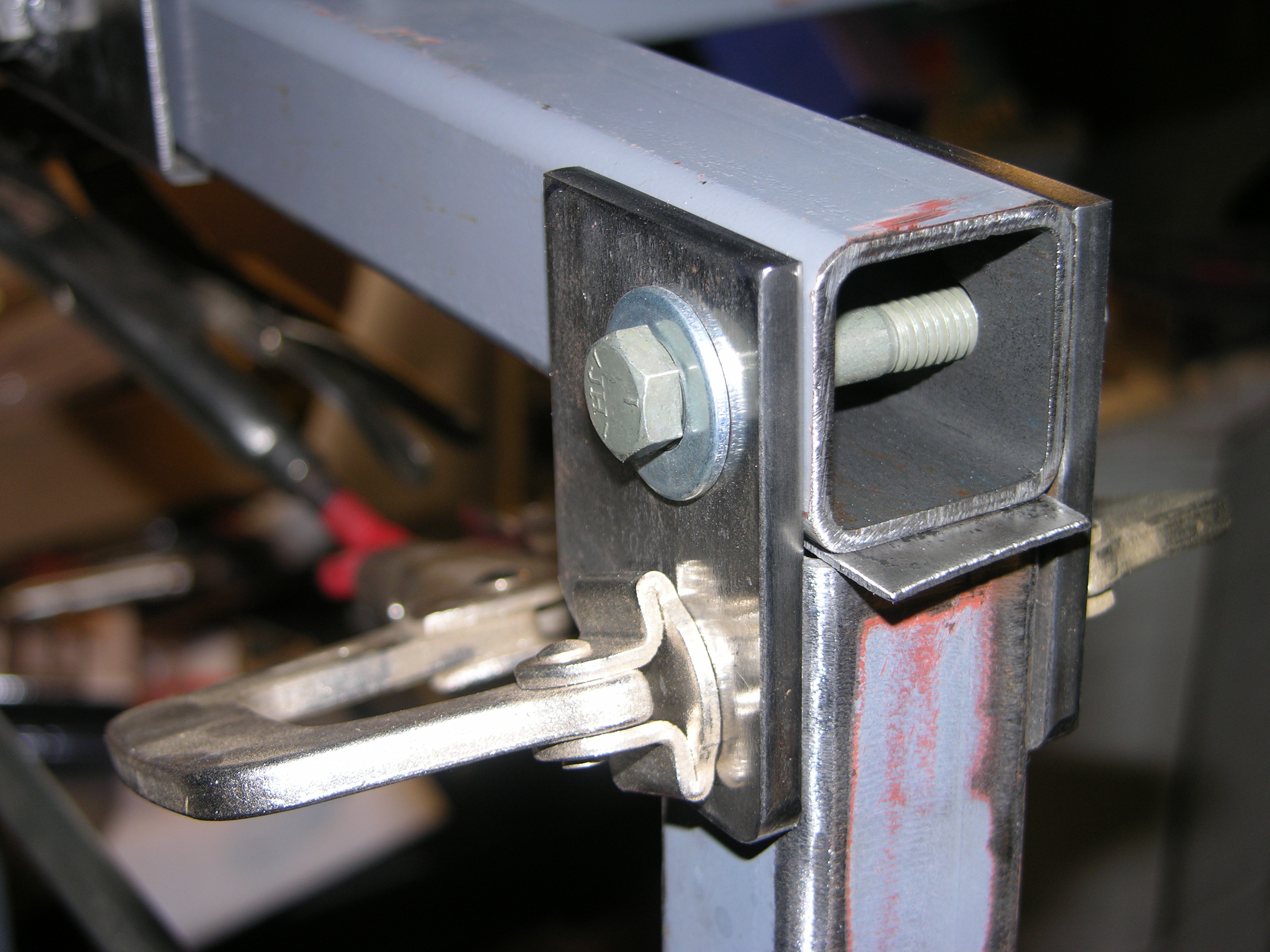

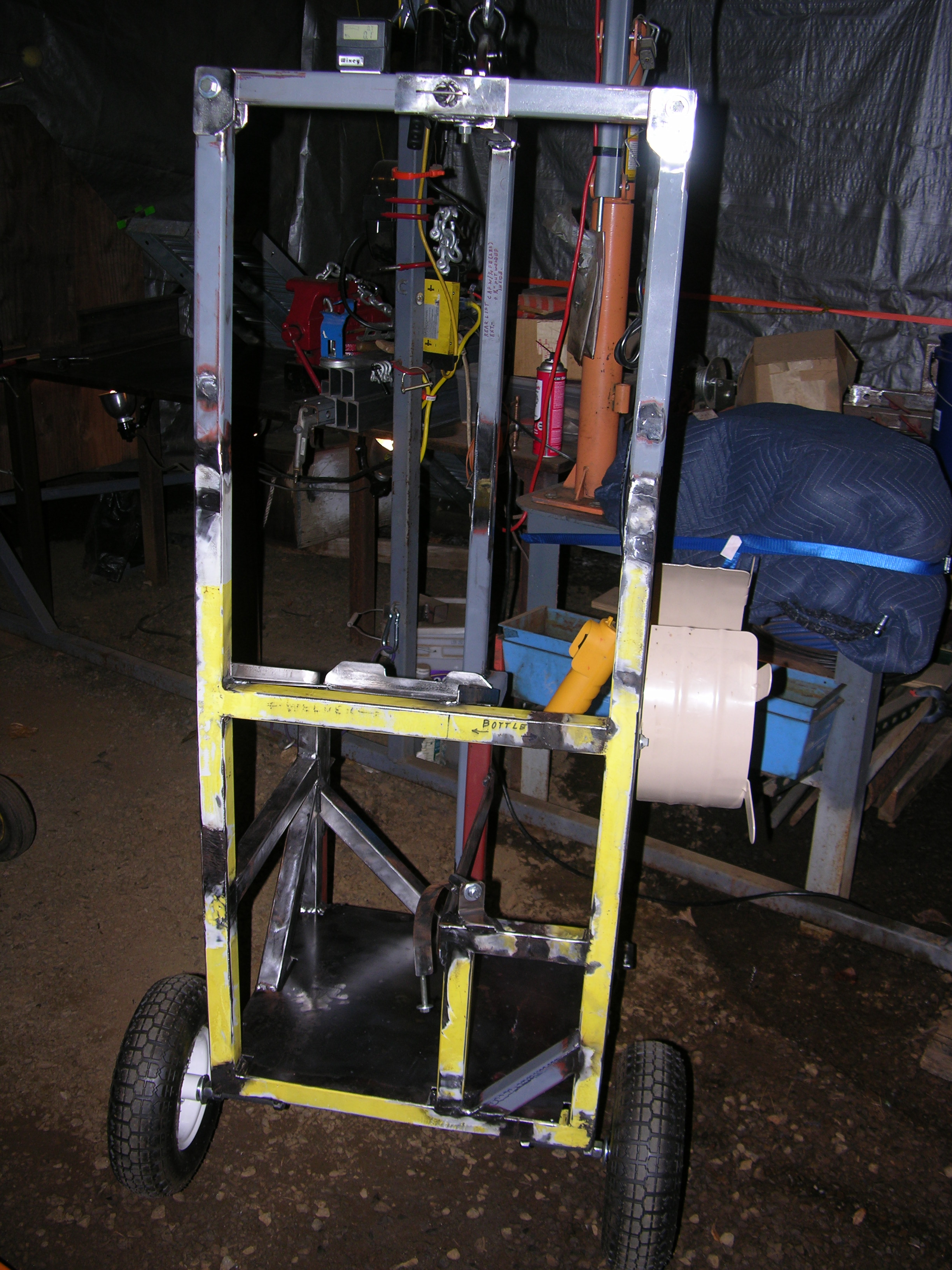

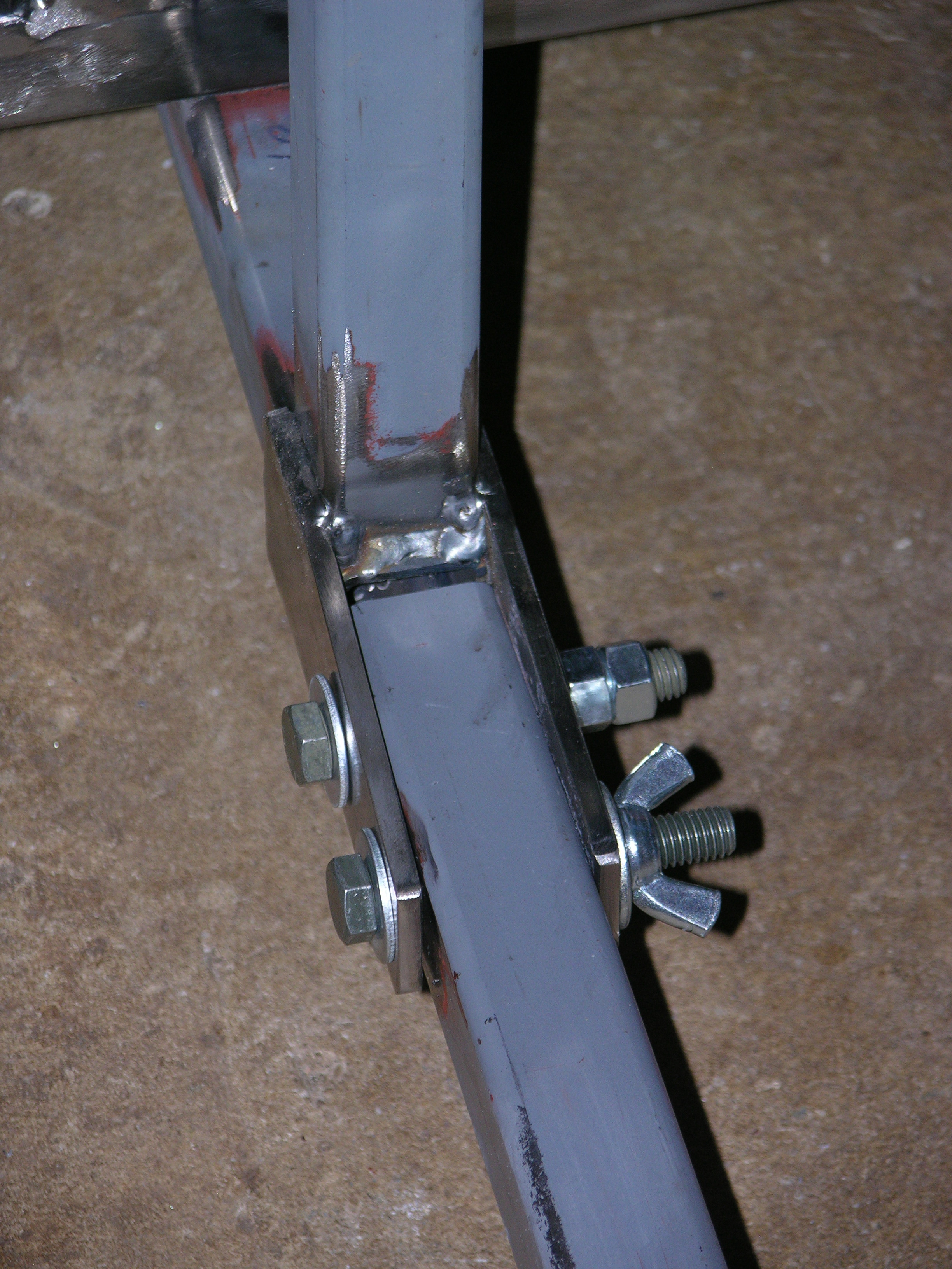

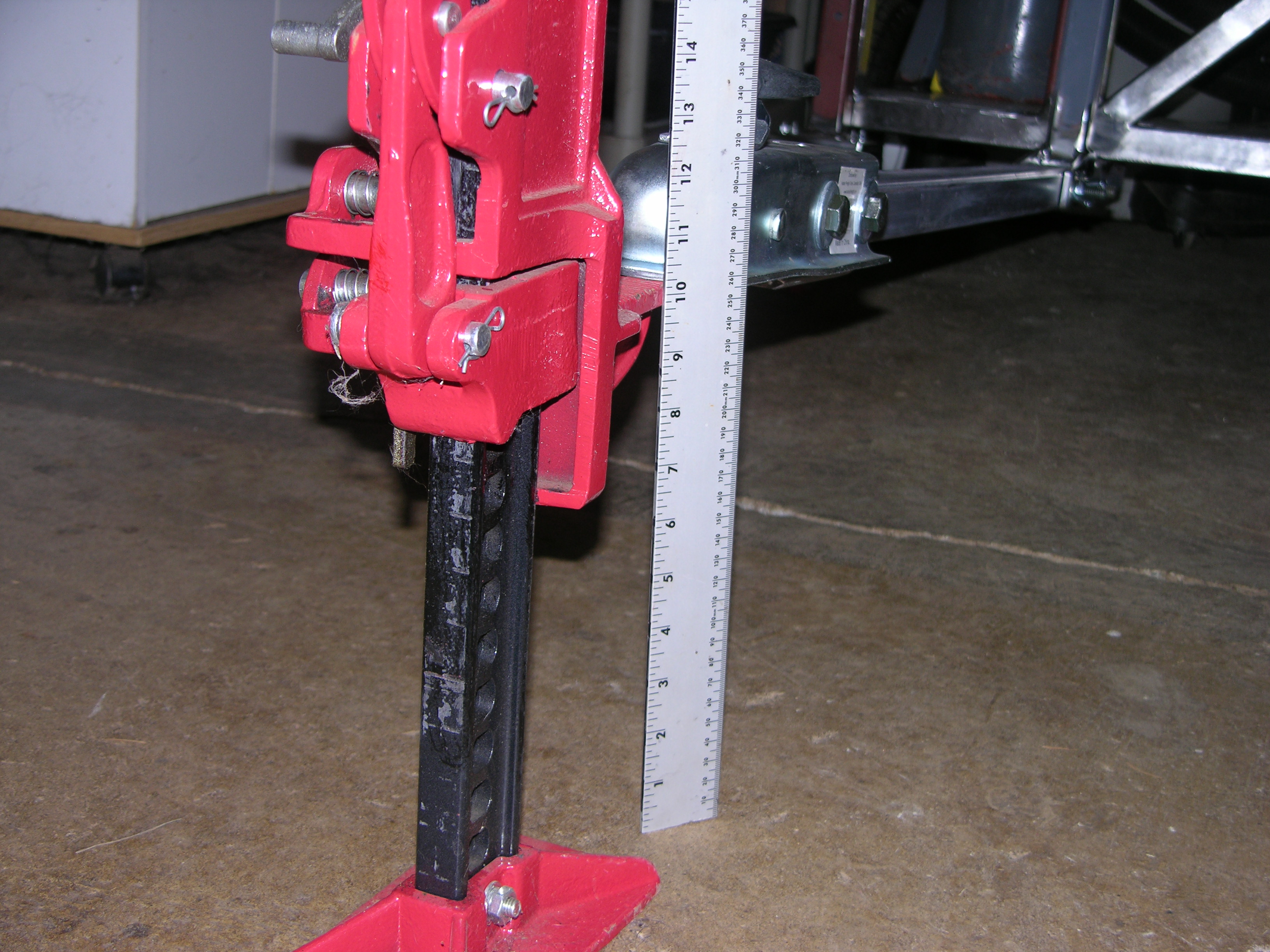

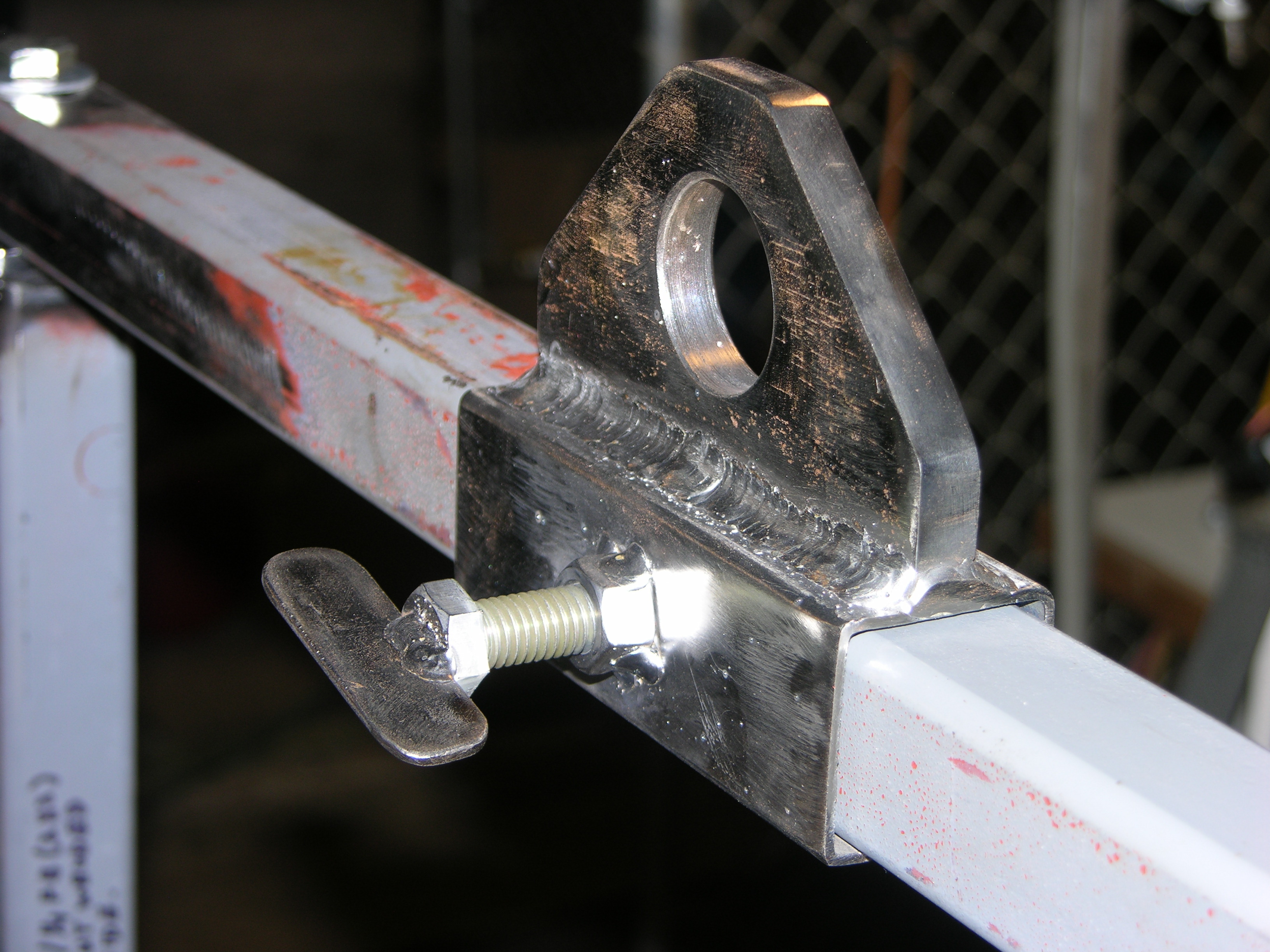

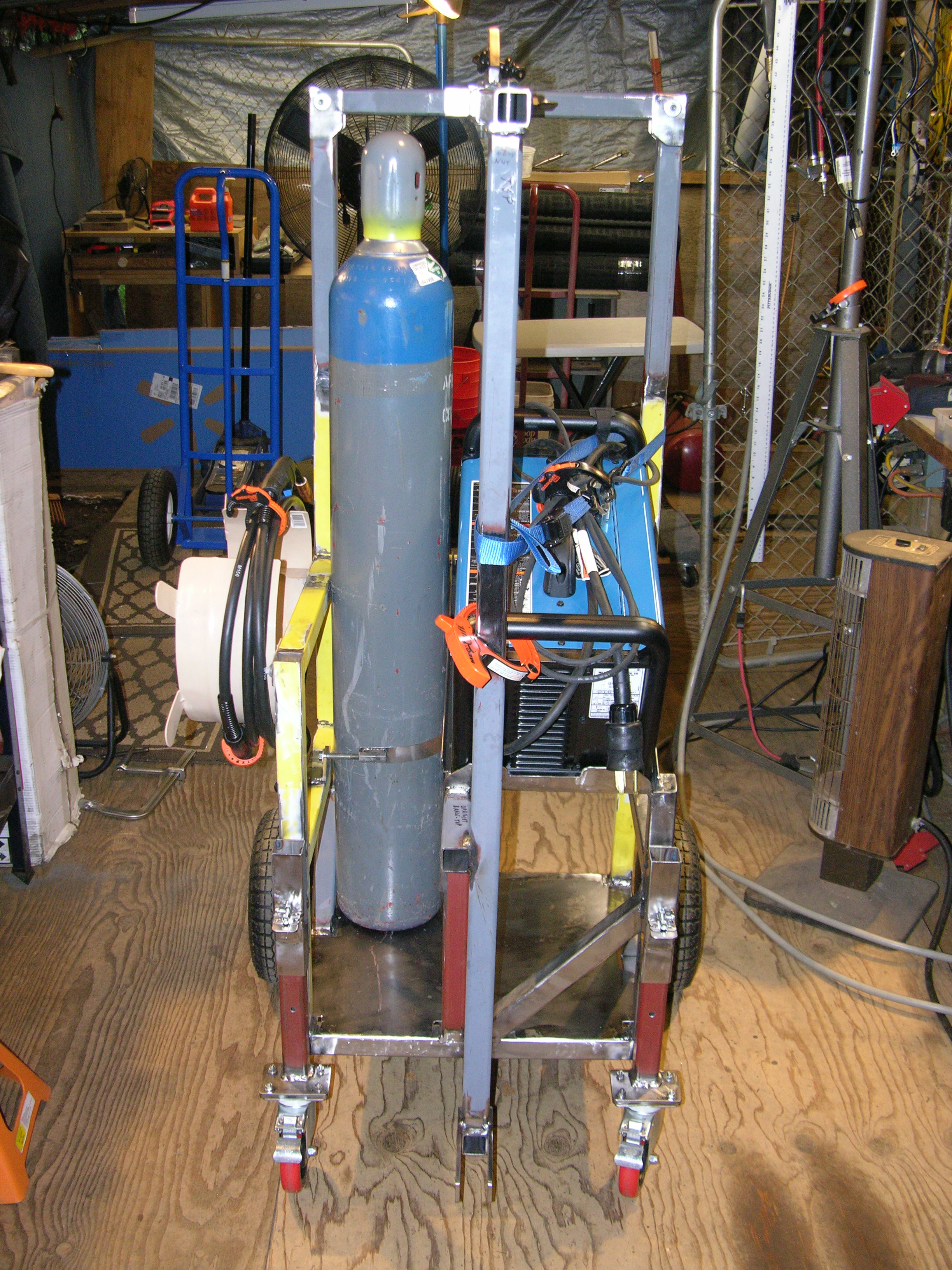

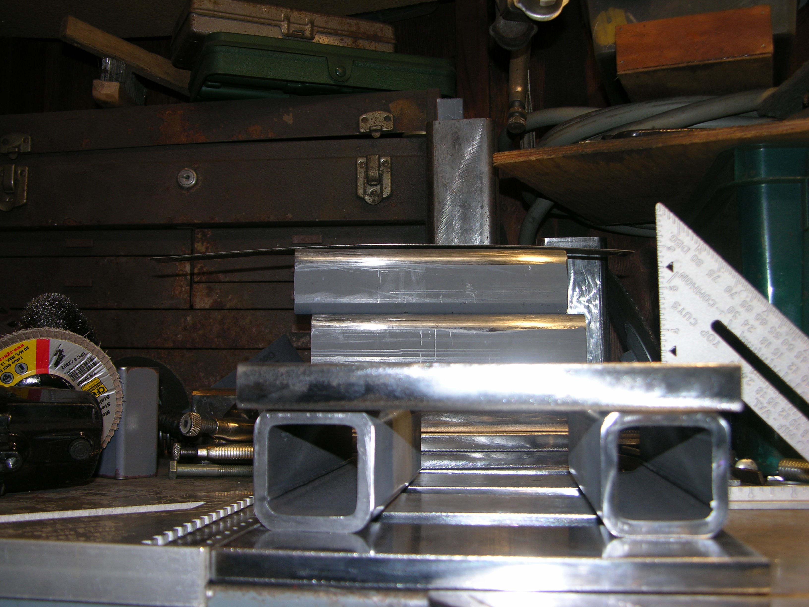

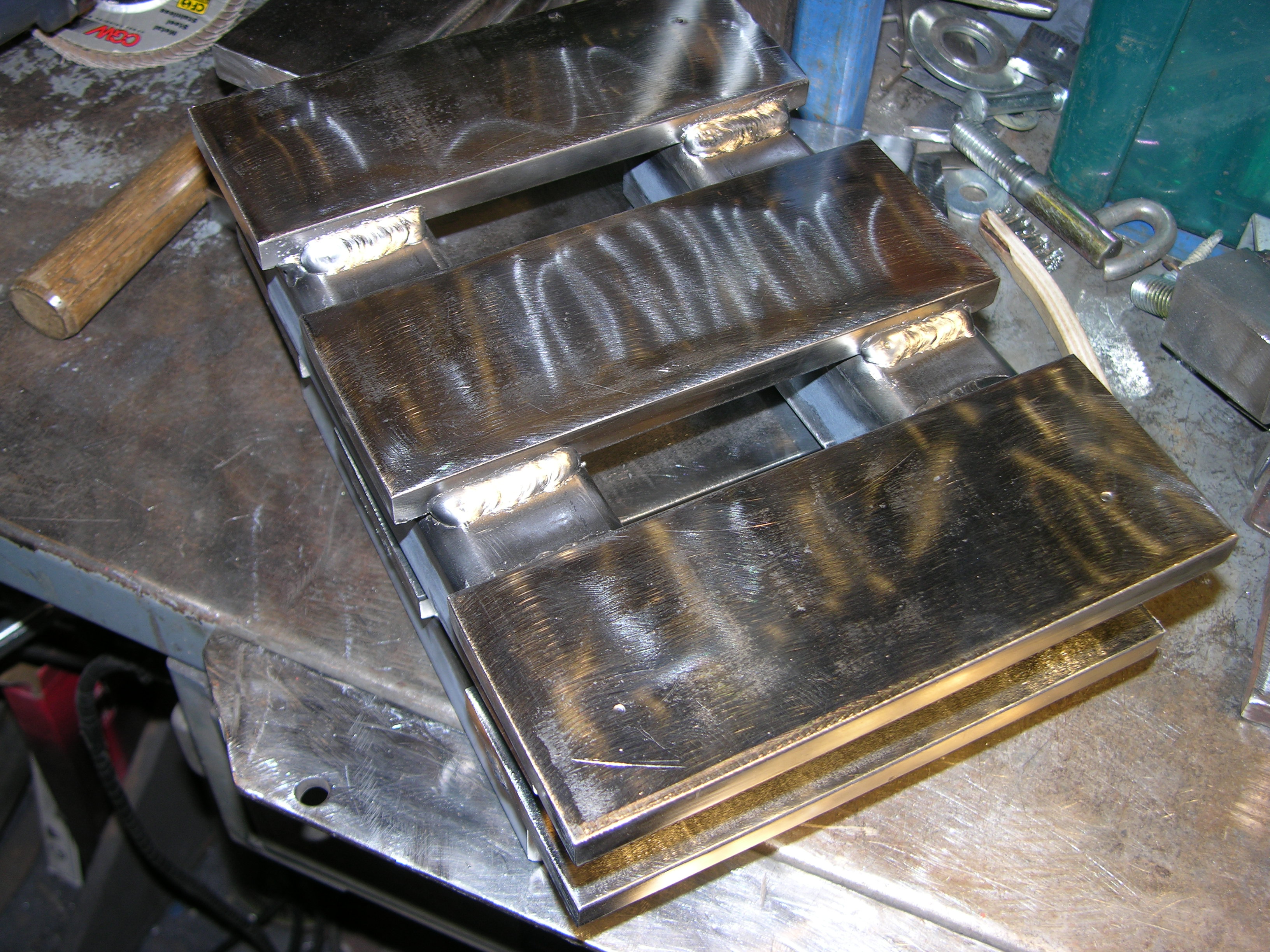

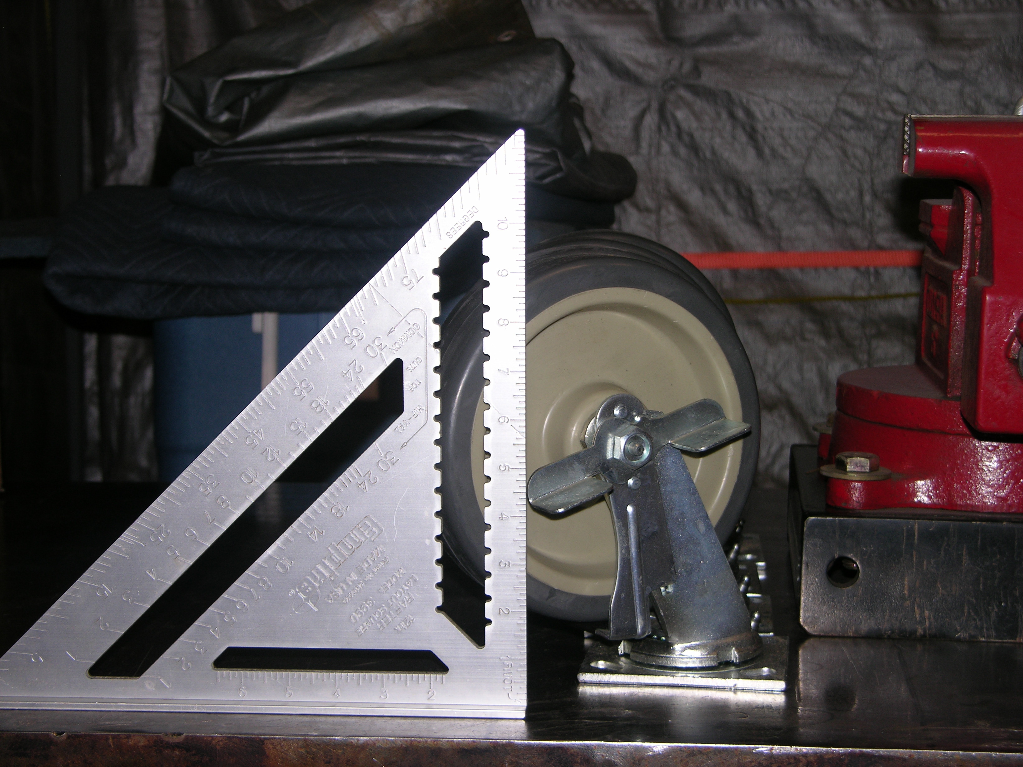

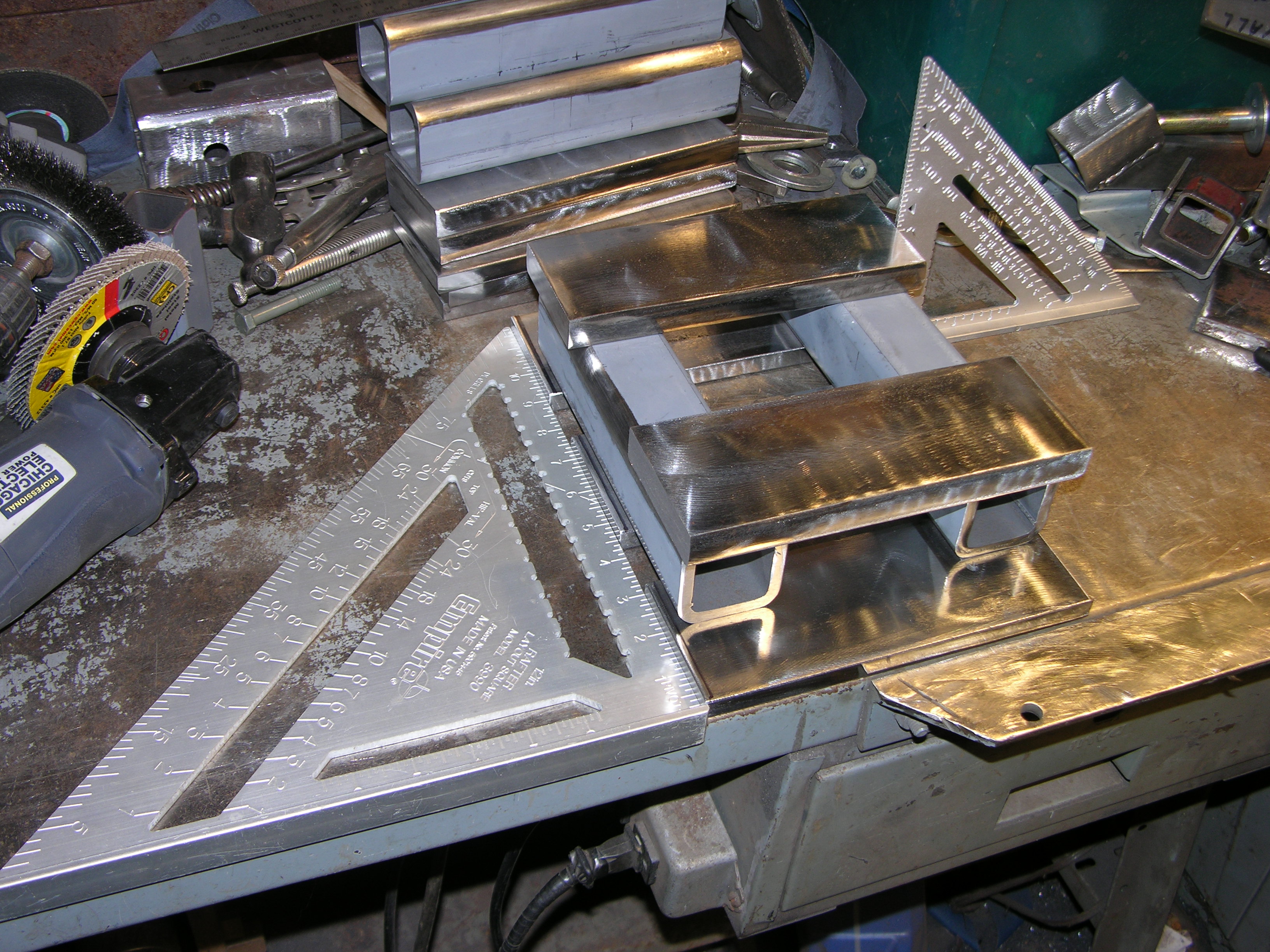

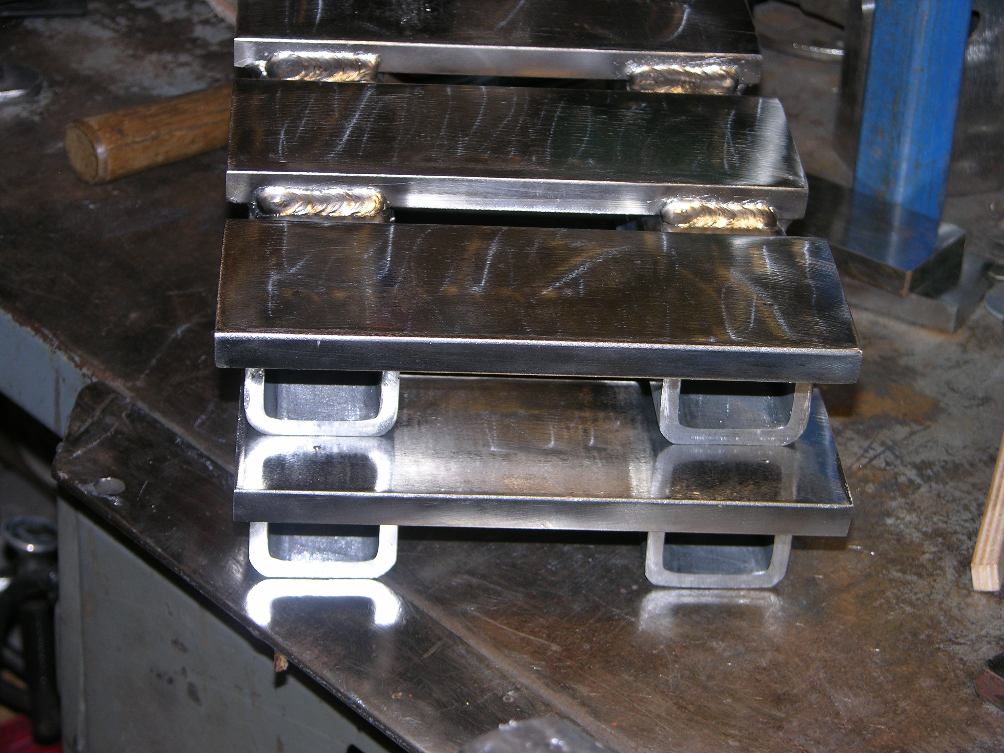

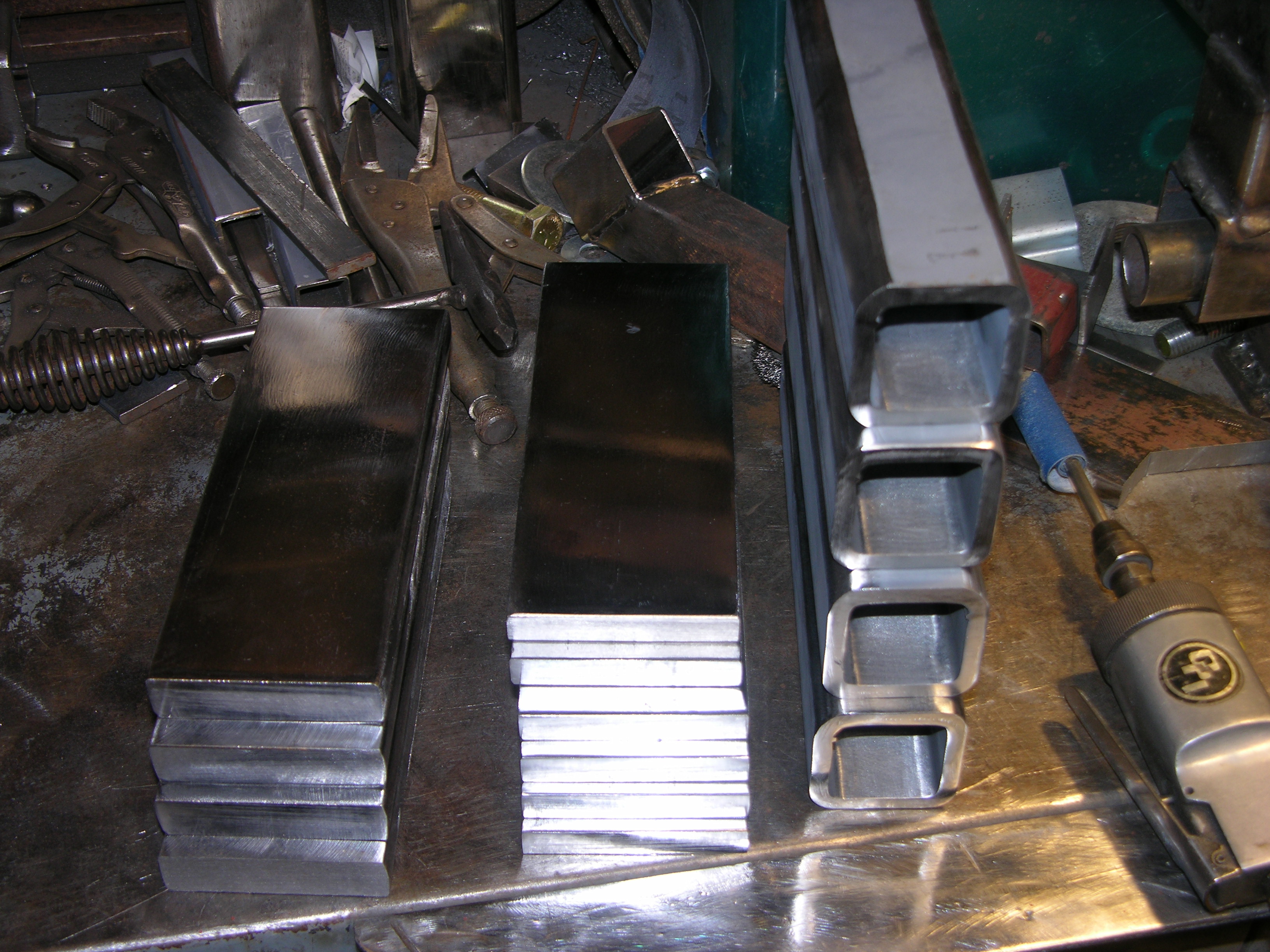

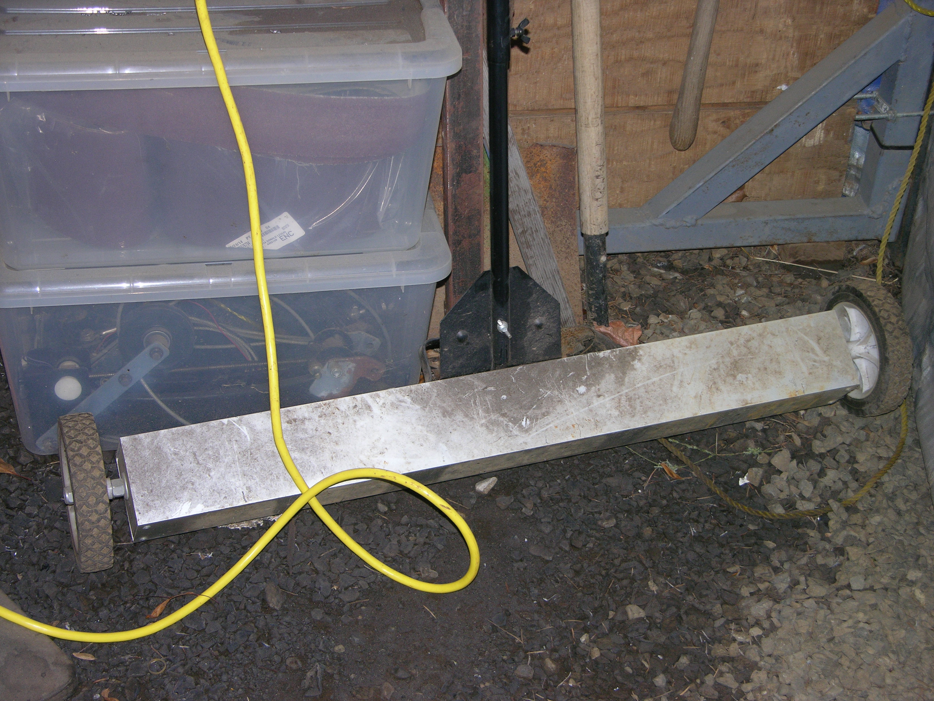

OK, little progress today - got the rest of the pieces de-scaled, insides of the tube ends shined up where nuts will be welded, layout of the 3 3" pieces of FB ('cause I don't have any 1/2 plate) laid out along with the 2 pieces of tube that'll be the "beam channel" -

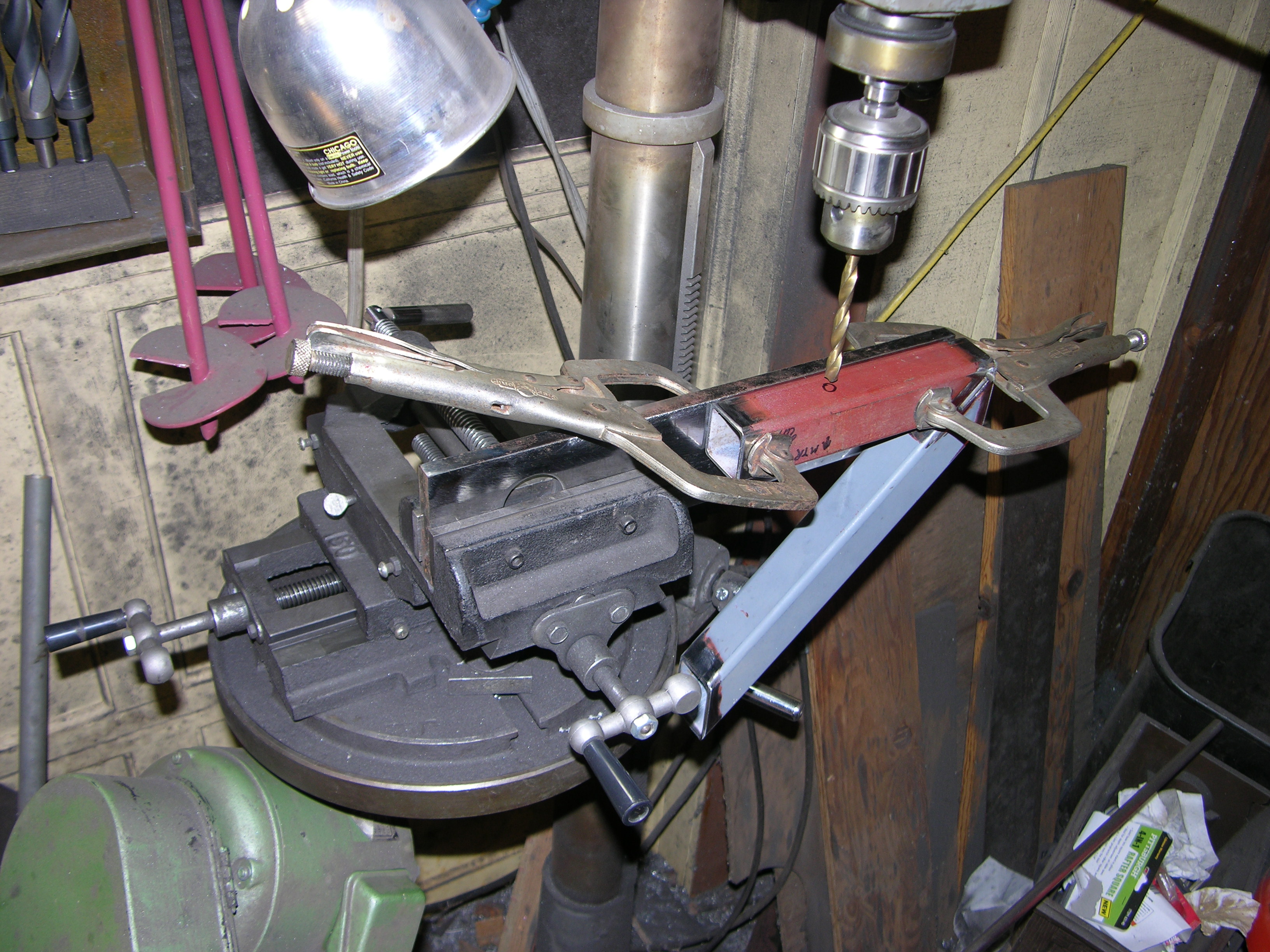

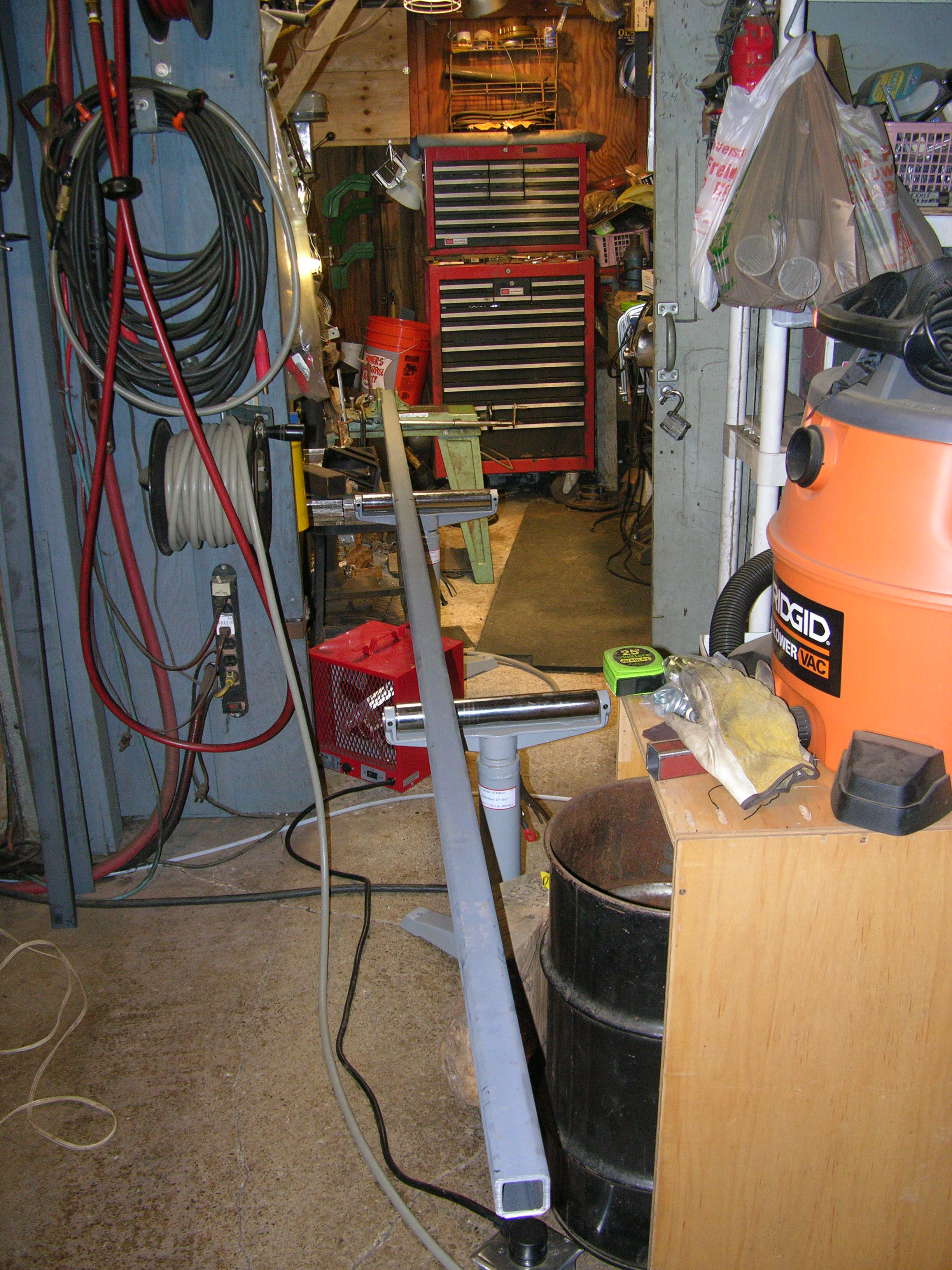

First, looking into the 8'x10' "phone booth shop" where I do most of the fab work (unless it won't fit :rolleyes:) -
DSCN3064.JPG -
The cleaned up pieces, including insides of tube for weld nuts - DSCN3067.JPG

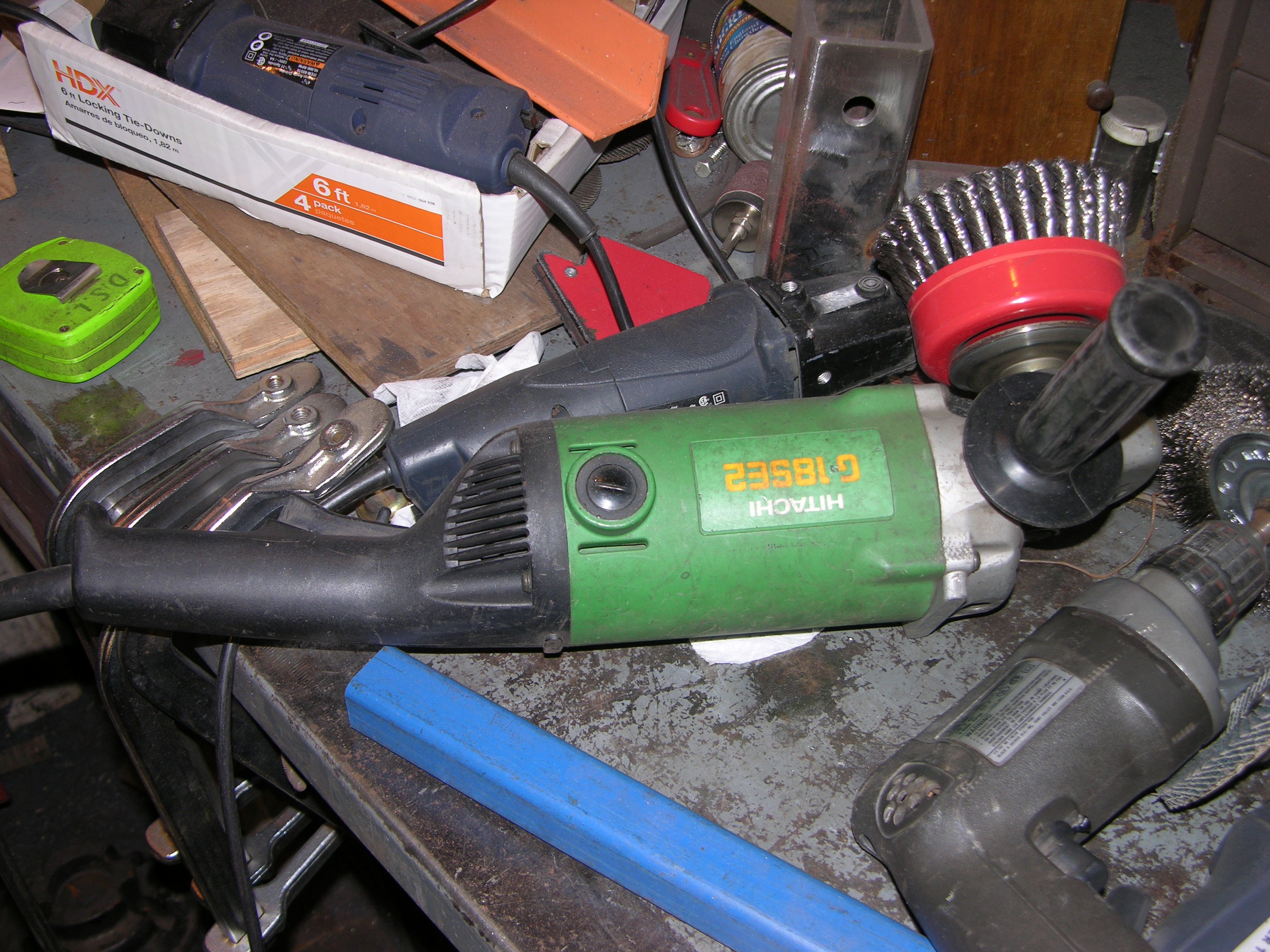

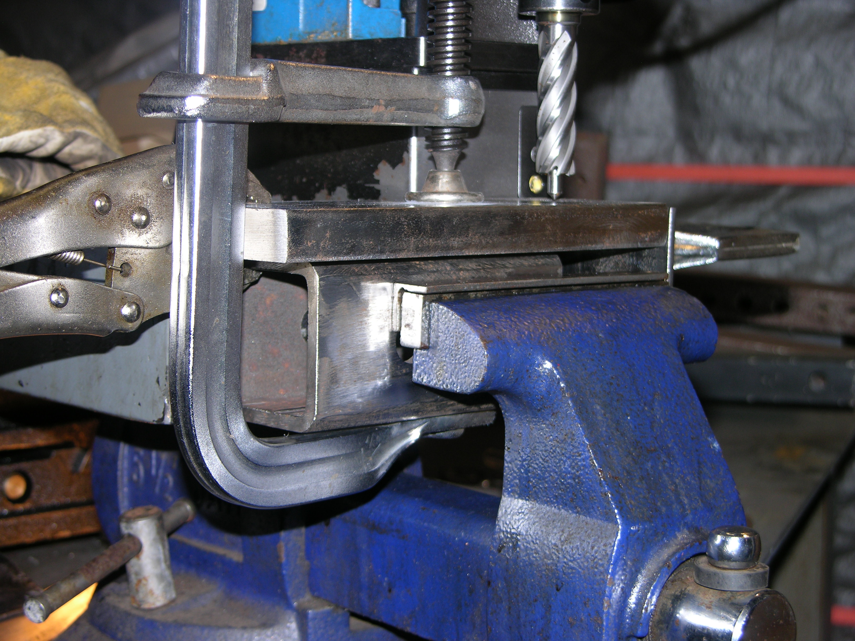

Then, the "back breaker" I mentioned a couple posts back - that cup brush weighs almost as much as one of the smaller grinders :thumbdown: - DSCN3068.JPG

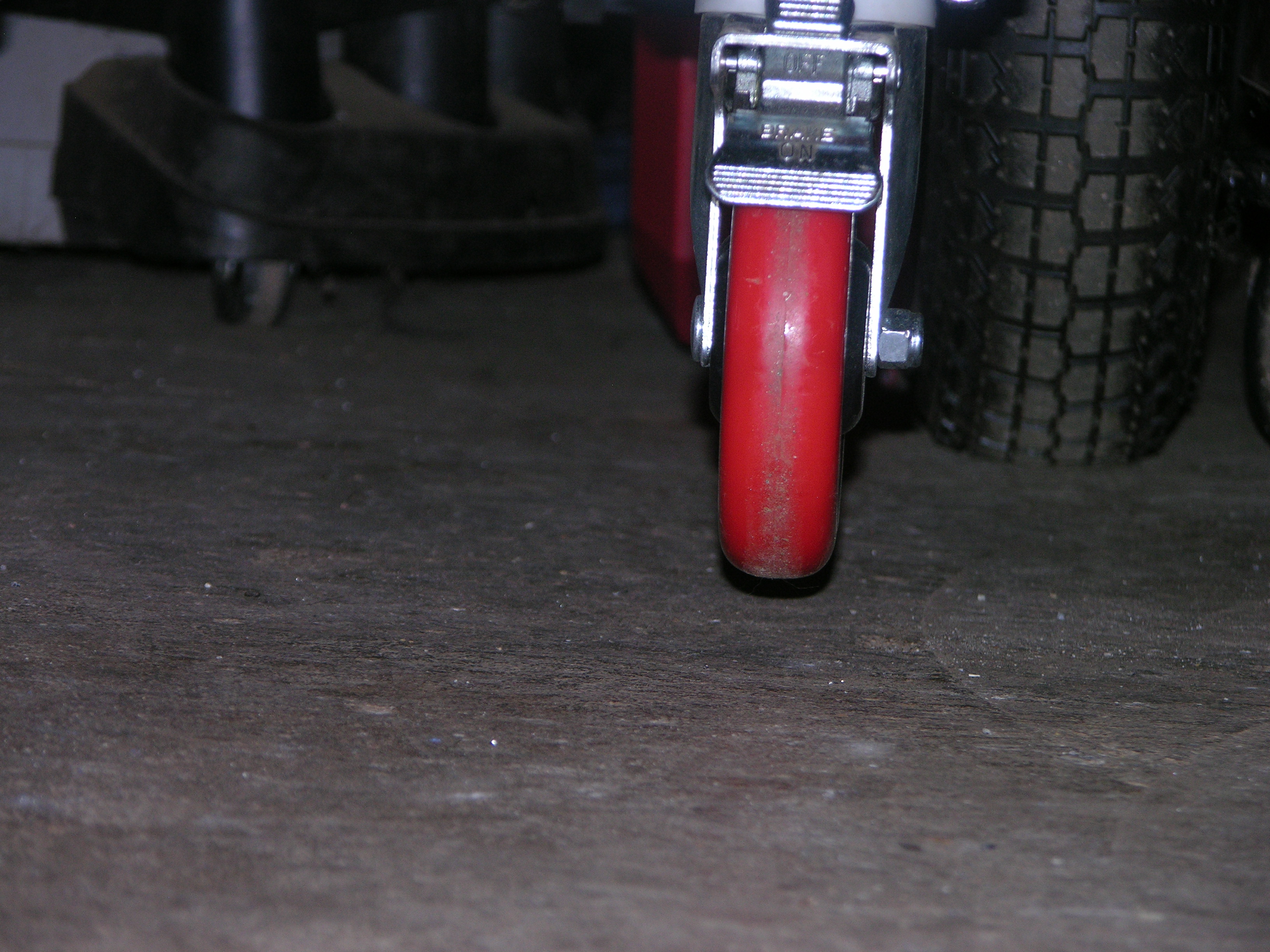

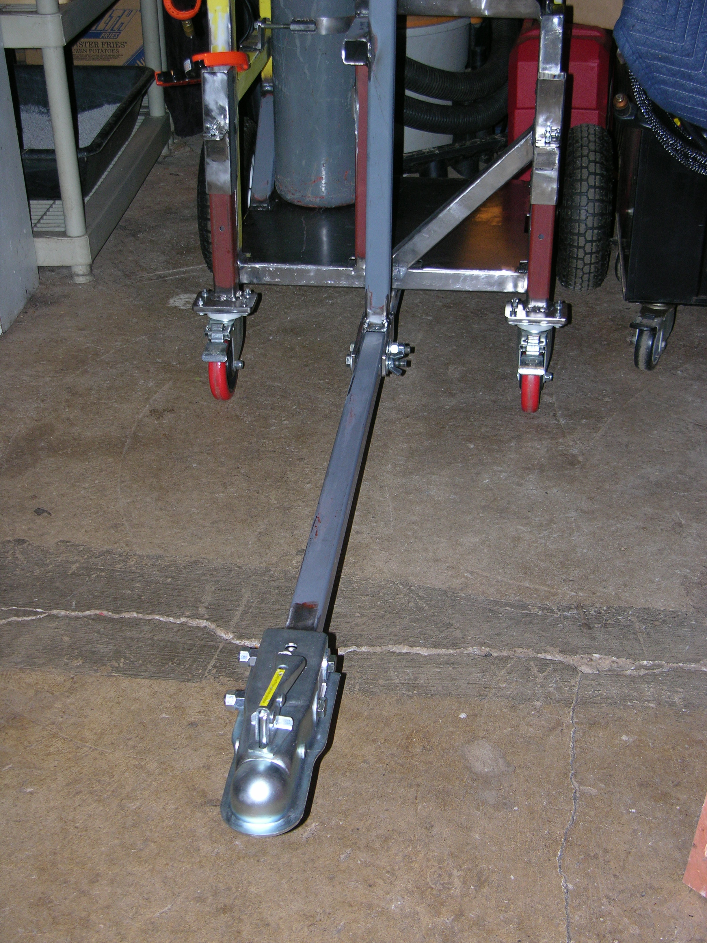

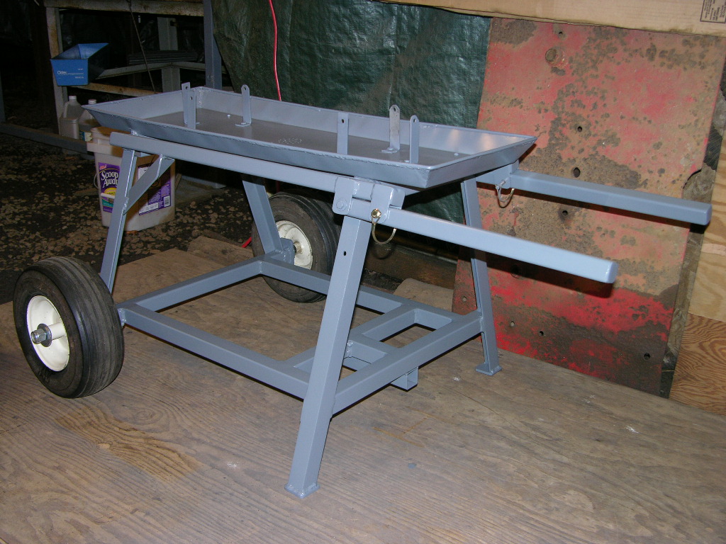

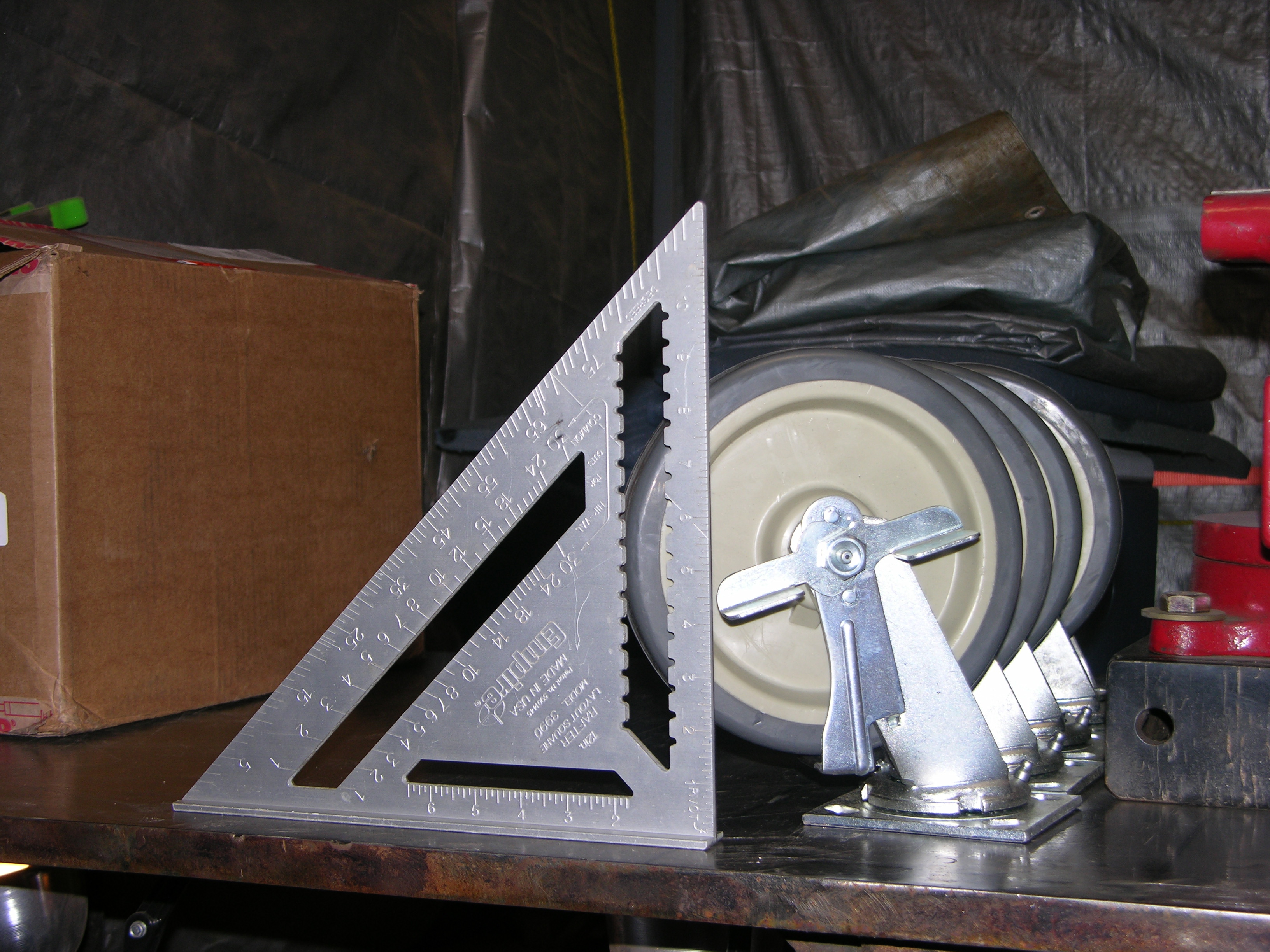

The caster "upgrade" for the HF crane - 8", zerks on wheels and swivels, all 4 lock instead of HF's only 2 locking - Surplus center, $17 each (but UPS finished ruining a $100 bill) - I'm still working on gravel, plus my old cherry picker needs new shoes so the 5" off the crane will go there - DSCN3070.JPGDSCN3071.JPG -
Layout - the 3 bottom pieces of 1/2" FB will get tacked to ONE of the 2" tubes, then that'll get clamped to the actual I beam with a 16 ga. "shim" between the tube and the beam (so it still fits after full weld) - then the SECOND tube will get clamped to the other ends of the 1/2" FB's, the whole assembly will get HARD clamped to the big weld table (1" thick, 3'x7') and won't get UN-clamped til everything's welded out and cooled - finally, mag drill will take care of holes thru the base that match the posts on the HF crane; also holes in both ends of both tubes for weld nuts to go inside - I did a little editing in Paint on the last one for clarity -
'Sposed to be dry tomorrow afternoon and Monday morning, and warm enough for paint - keeping fingers/eyes/toes crossed :laughing:... Steve

Yup you caught on, that weld was done by machine, one of these time's I'm gonna sneak out a video of it. Now that I'm getting up in years and half worn out, my favorite kind of welding is with buttons, switches and knobs.

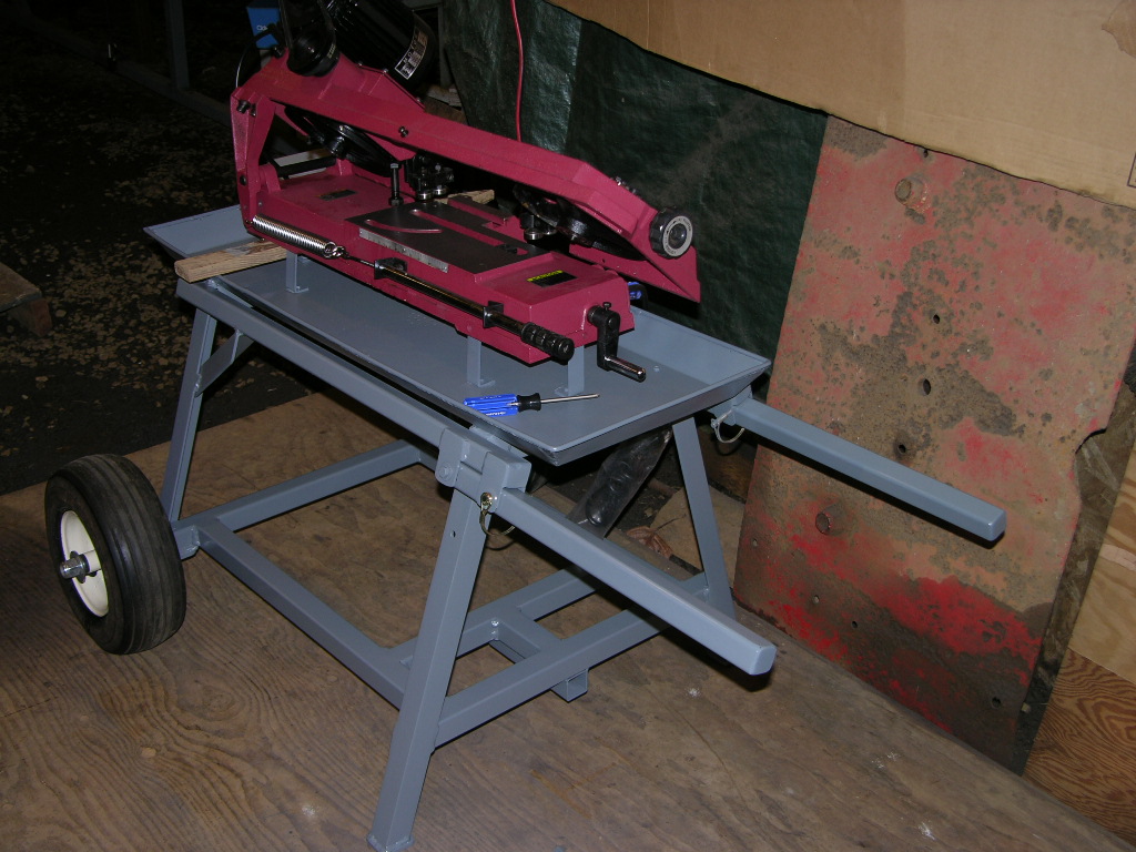

DSCN3064.JPG - that little green saw is one of their first 4x6 band saws, had it since '80 or '81 - still going strong, better made than their newer stuff...
They put a store in only 40 miles from me (back roads) 'bout 12-14 years ago, but their $7.99 FedEx shipping was cheaper than driving 80 miles round trip; then about 4 years ago they put one in Albany, which is where we usually shop anyway. I like bein' able to "kick a tire" and know I should run away, better than finding out I shouldnt've ordered that thing at all...
Cutting - bigger stuff gets the Jet, smaller stuff gets the "Ole reliable" HF bandsaw - no cold/dry cut yet, later on I'll either get one of those or the Grizzly swivel band saw; might be a while though - I got both band saws tuned up so you can lay a square across a cut in any direction and not see daylight, hard to ***** about that...

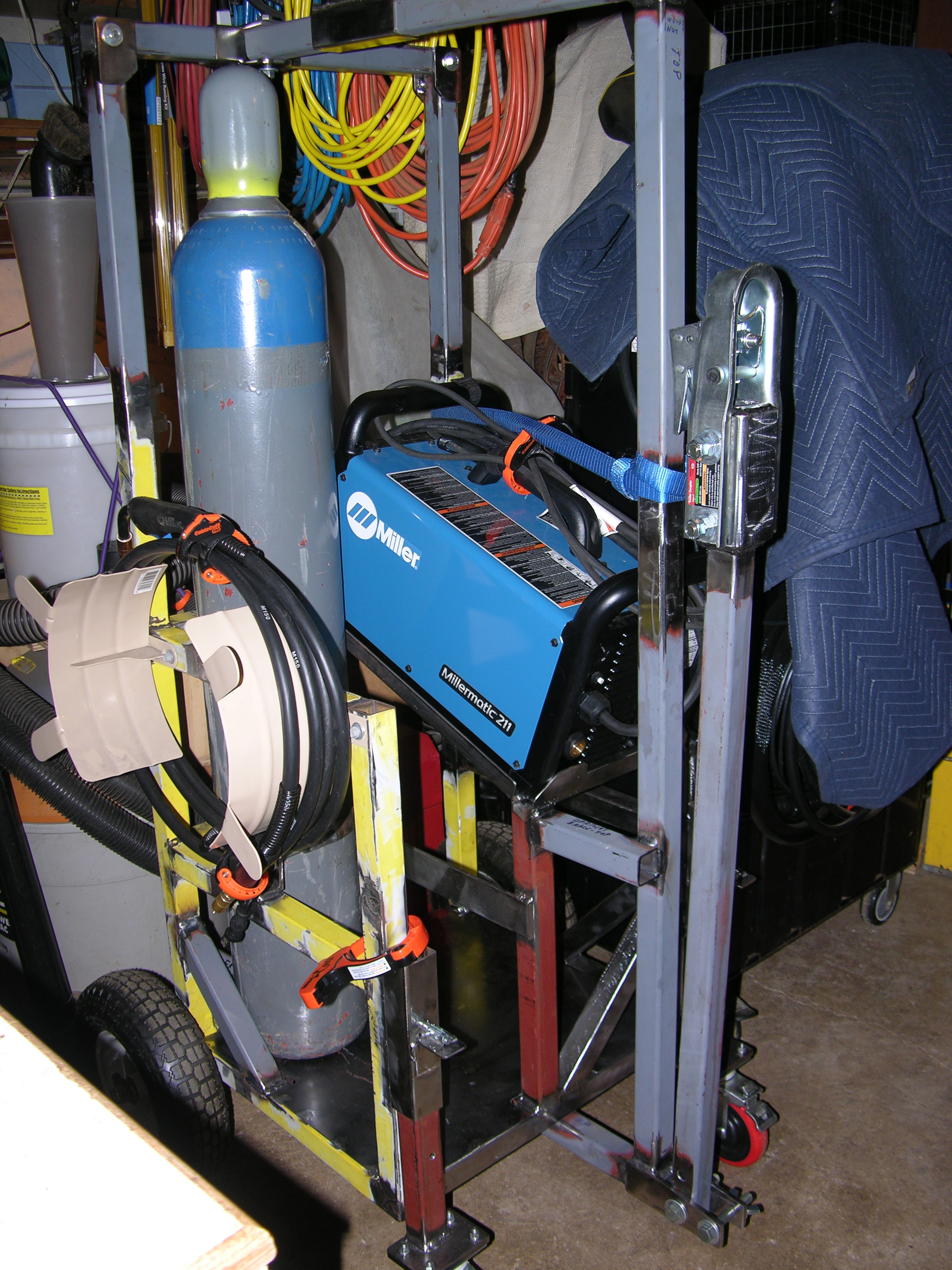

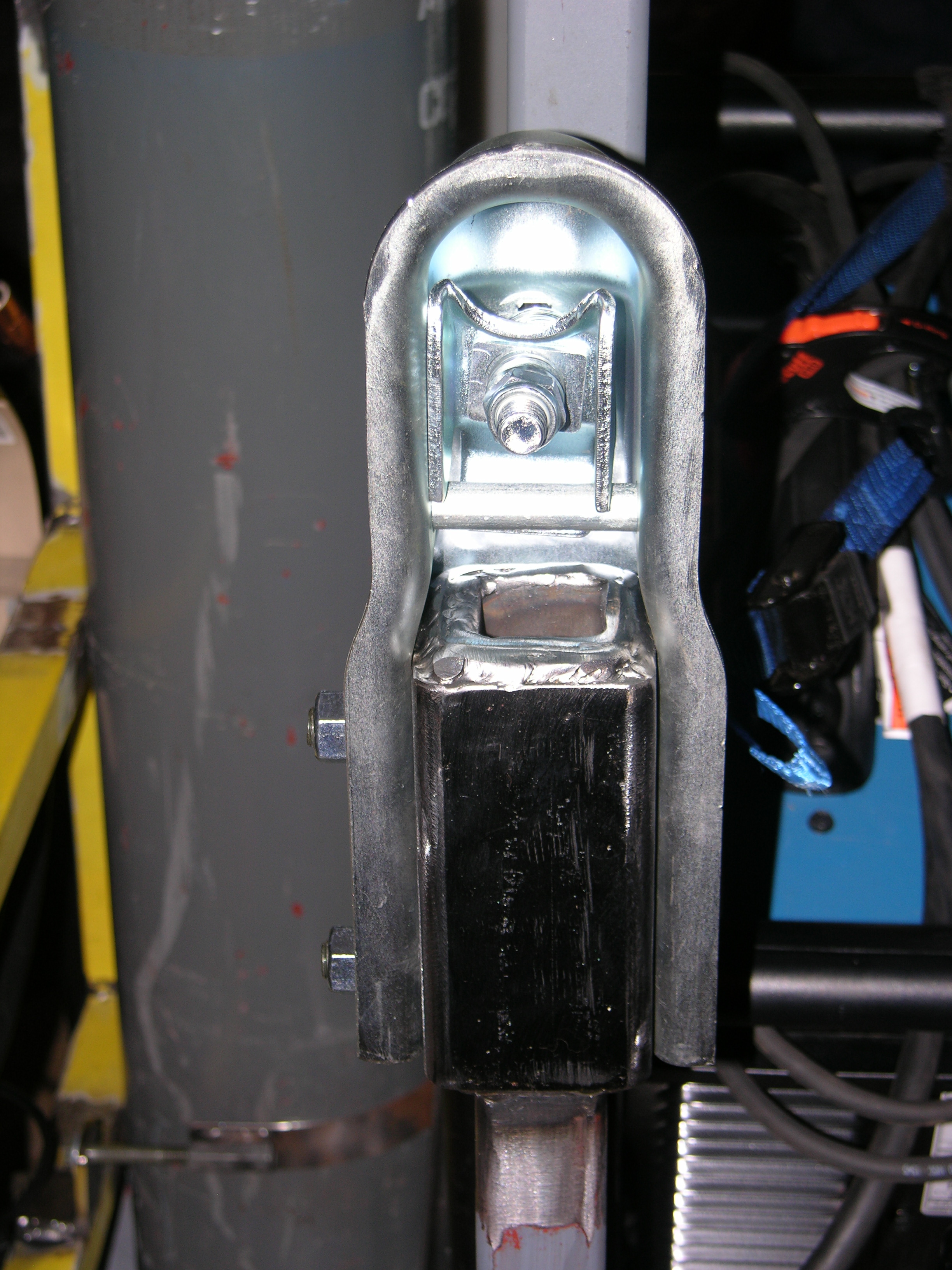

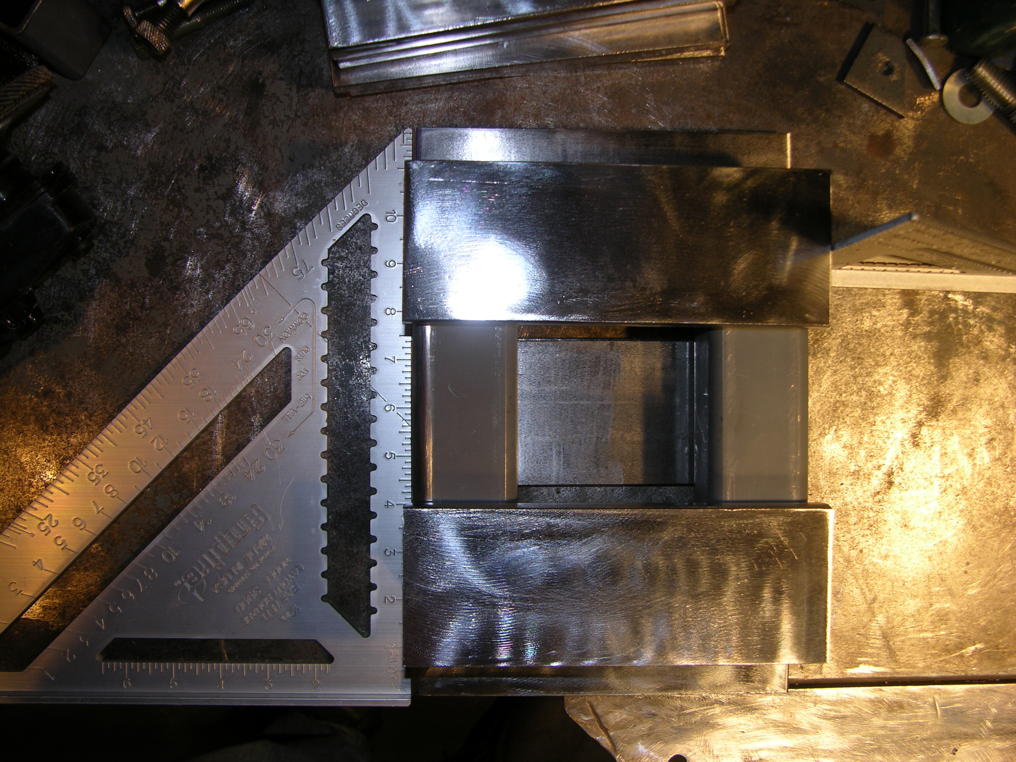

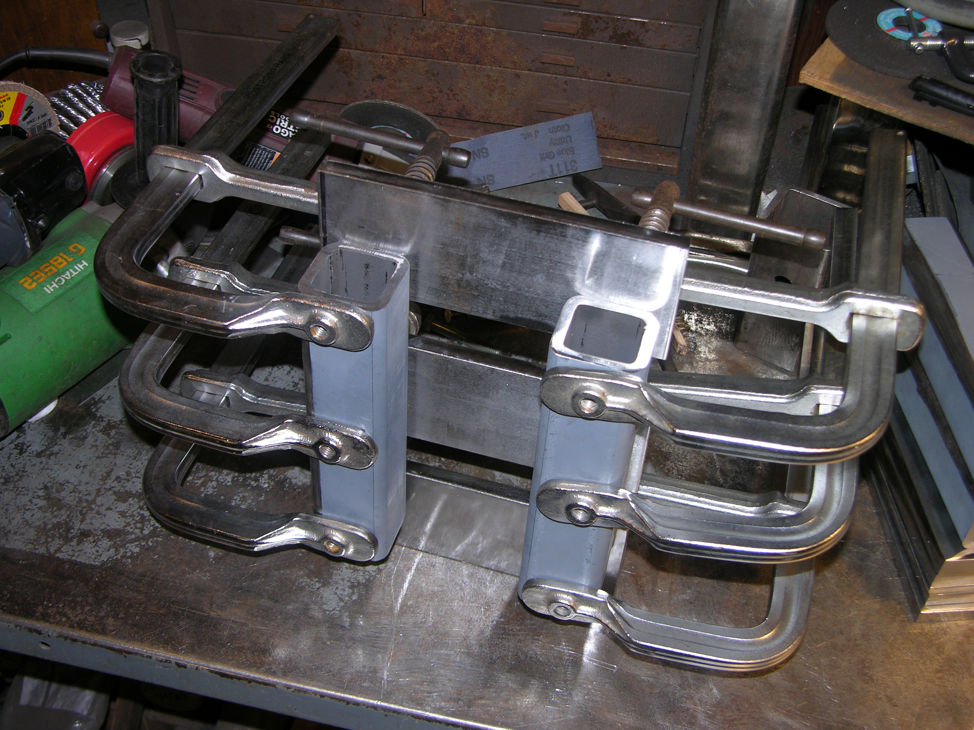

Spent about 4 HOURS this afternoon learnin' how to do the SECOND crane post top in maybe 20 MINUTES (or more correctly, how NOT to do it AGAIN the same way :confused: - anyway, first one's ready to tack manana - DSCN3076.JPG
Once that's done the second one will get clamped to the heavy table with the 3 1/2" FB's and ONE of the tubes, trued up, tacked THEN taken to the 12' I beam in the other shelter (for "fit-up"), the SECOND tube clamped up with a 16 ga. "shim" between it and the beam, then MORE clamps and back to the big table - then I'll hard clamp BOTH post tops and weld 'em out, let 'em cool, then set up "maggie" and drill all the holes, then weld the nuts inside the tubes.
Then finally paint, then it'll be time to put the rest of the MOBILE crane together and move on... Steve

Newer small HF bandsaw - I give it about a 1.03 - I bought one to make an "off-road" version, spent my usual OCD amount of time building this - DSCN1495.JPGDSCN1496.JPGDSCN1498.JPGDSCN1502.JPGDSCN1503.JPG
That's when I discovered that my OLD saw (early '80's) has CAST IRON blade guides and holders, but the NEW ones are POT METAL. Won't hold a setting, can't get it to cut straight for more than a few cuts if that :mad:

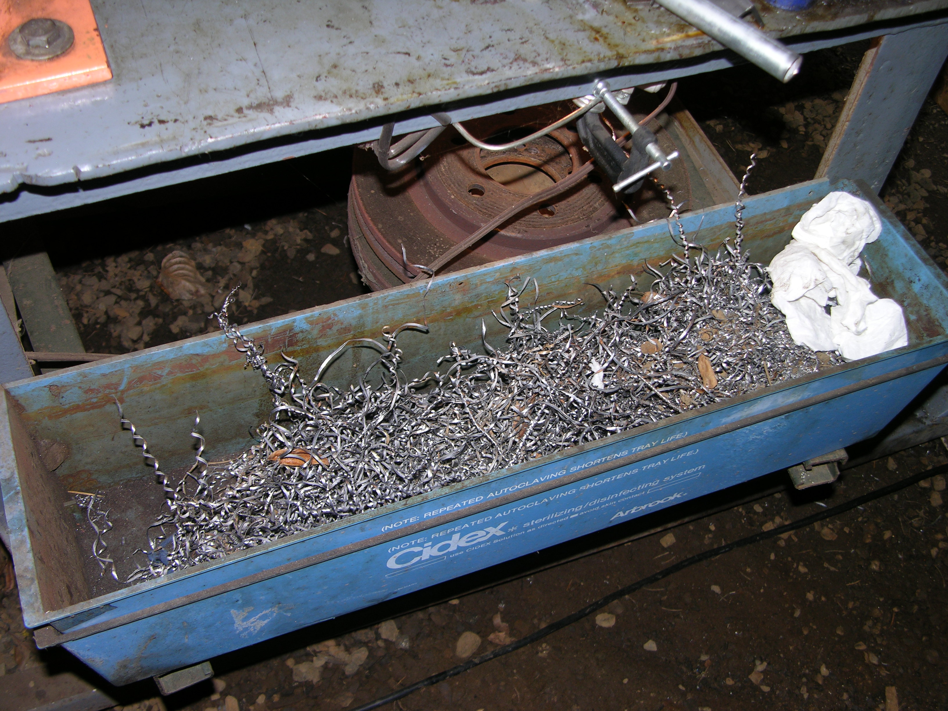

Fortunately for me, that chip pan was part of ANOTHER mistake - bought an older saw off CL, foolishly thought the only reason it didn't cut straight was 'cause the PO didn't know how to set one up - but it DID have that chip pan and an actual FRAME of angle under it - the saw itself rapidly turned into a "parts machine" - turned out the thing I did NOT notice was the crappy welded break in the saw frame :eek: - so no alignment, but that saw IS OLD ENOUGH not to be pot metal on the blade guides, so hopefully I can swap some parts and get my "off-road" saw going some day...
So, my advice to you is either find an OLD version on CL and make sure you actually watch it cut something, and check the cuts in both dimensions for SQUARE - if it's close and priced right, and (this is REAL important) you check to make SURE the castings that hold the guide bearings will attract a MAGNET, then it can probably be a good saw. Otherwise, you'd probably have better luck payin' a little more for the Jet version of the 4x6; not sure about Grizzly's version...
You might wanna save this pdf file if you're gonna get ANY one of those saws - View attachment Basic_blade_adjustment_and_tracking_-_rev-1.pdf
Dry cut - I've pretty much settled on the Evosaw 380, a bit less than other "real" saws in that class, and built pretty solid - Evolution EVOSAW38 | Evolution Power Tools | Evolution 15
If I get another band saw, it'll most likely be this one

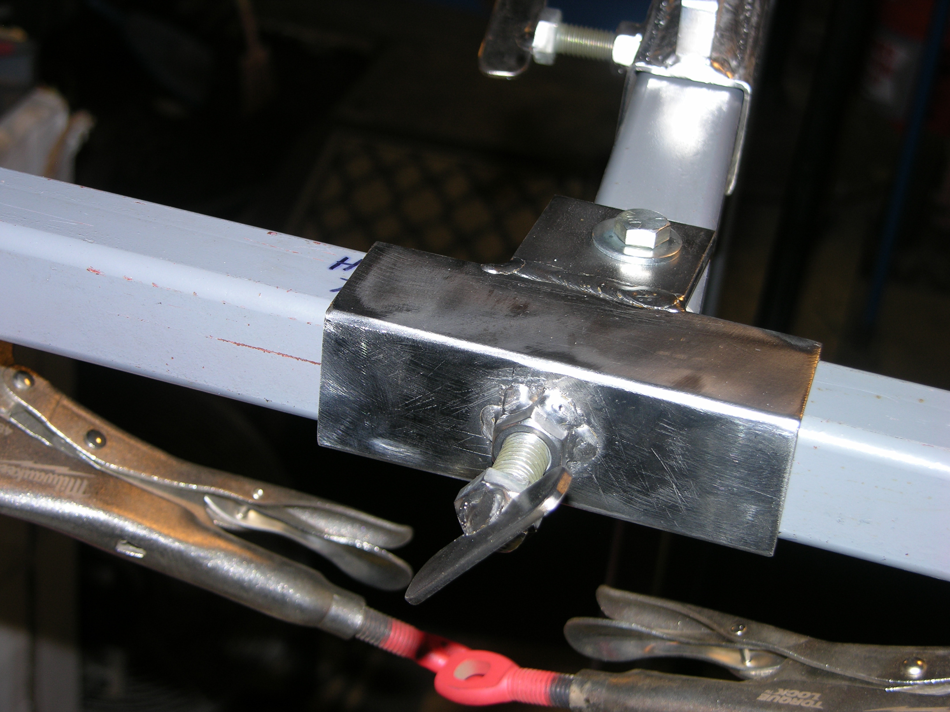

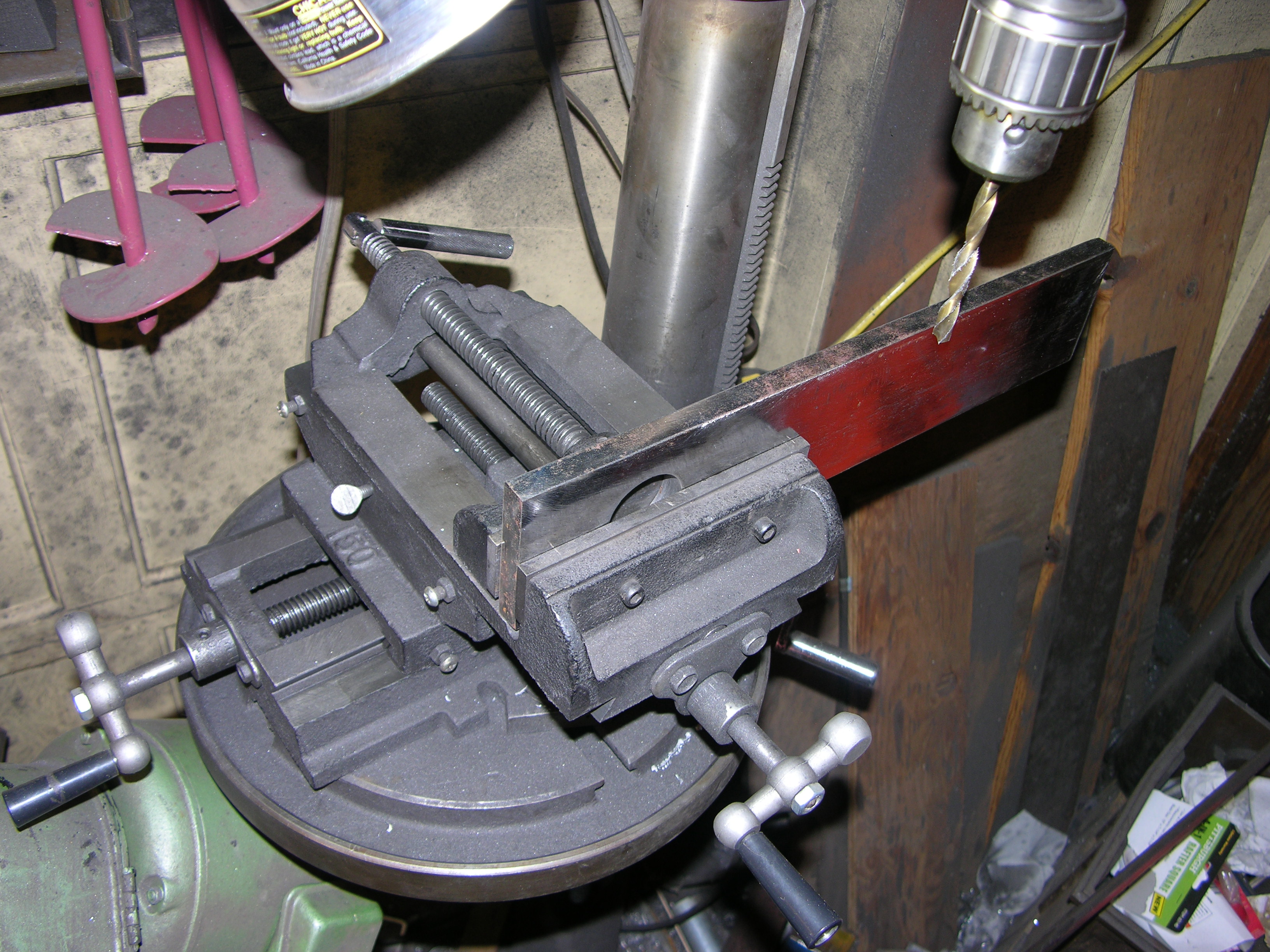

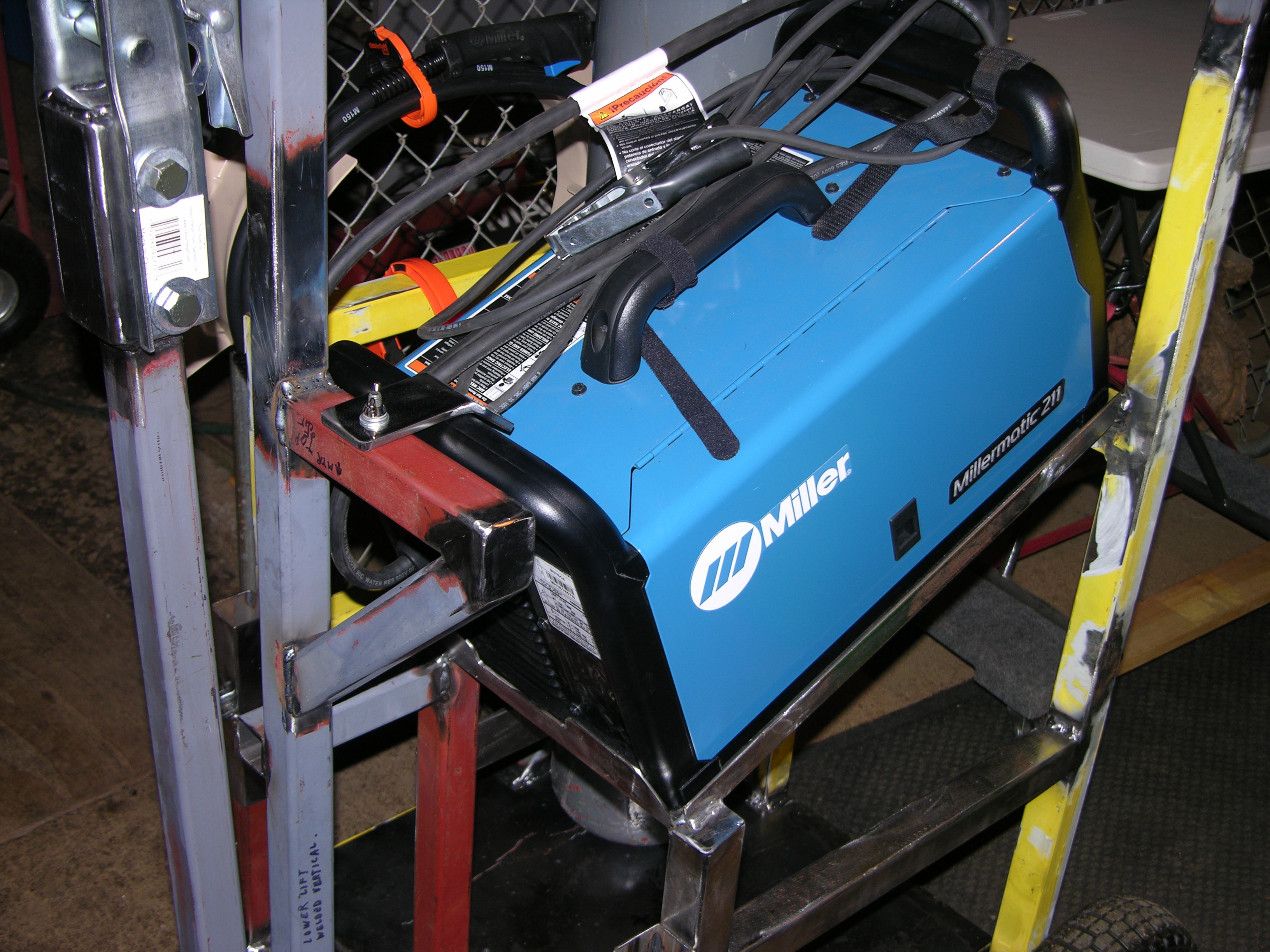

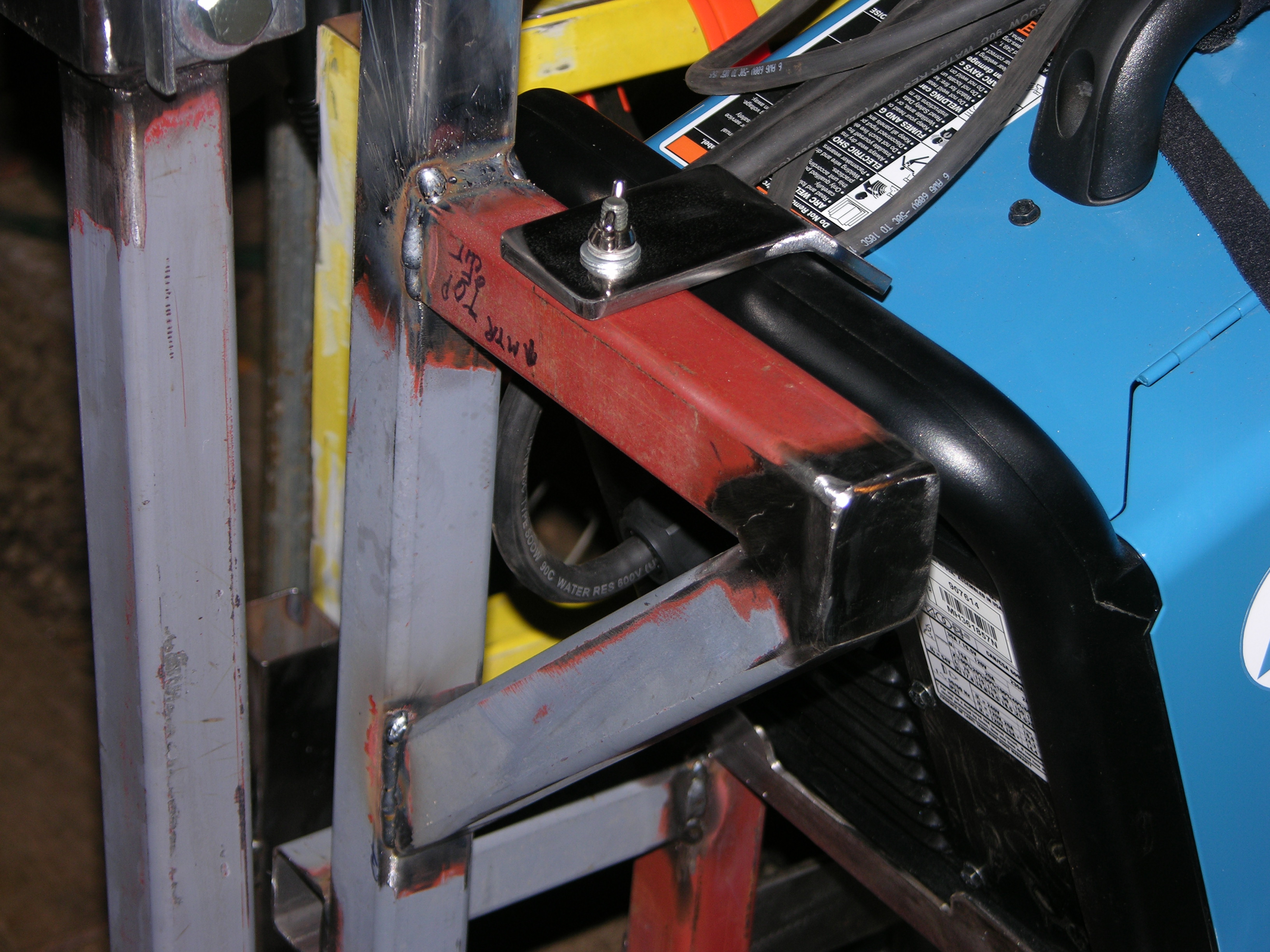

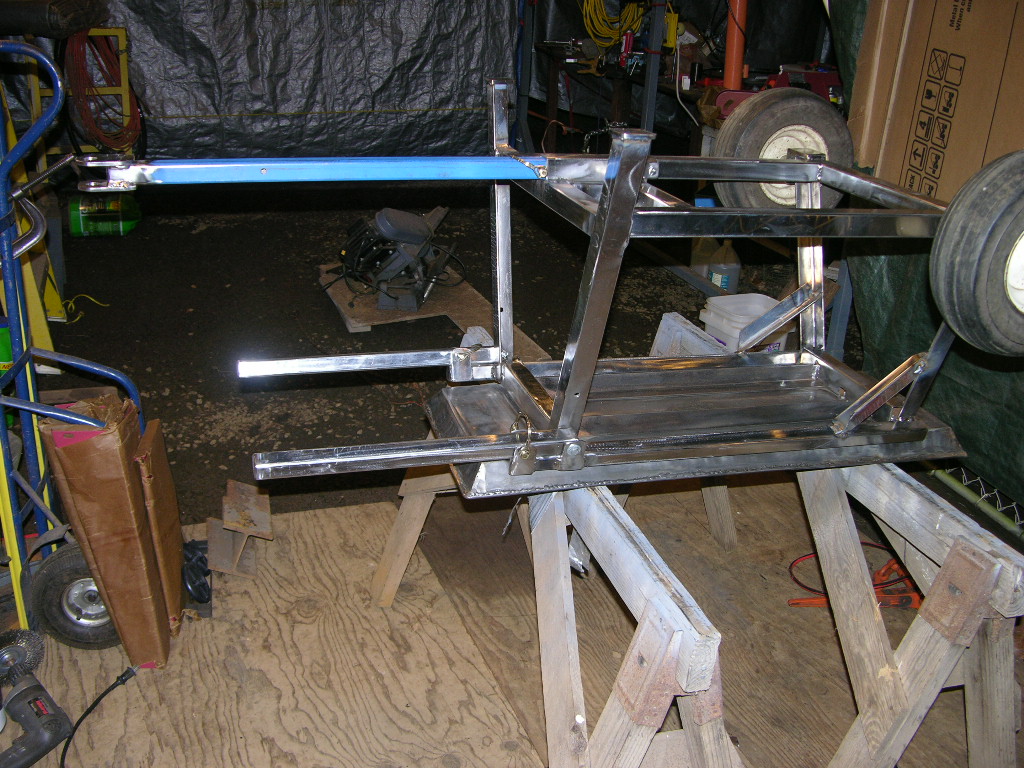

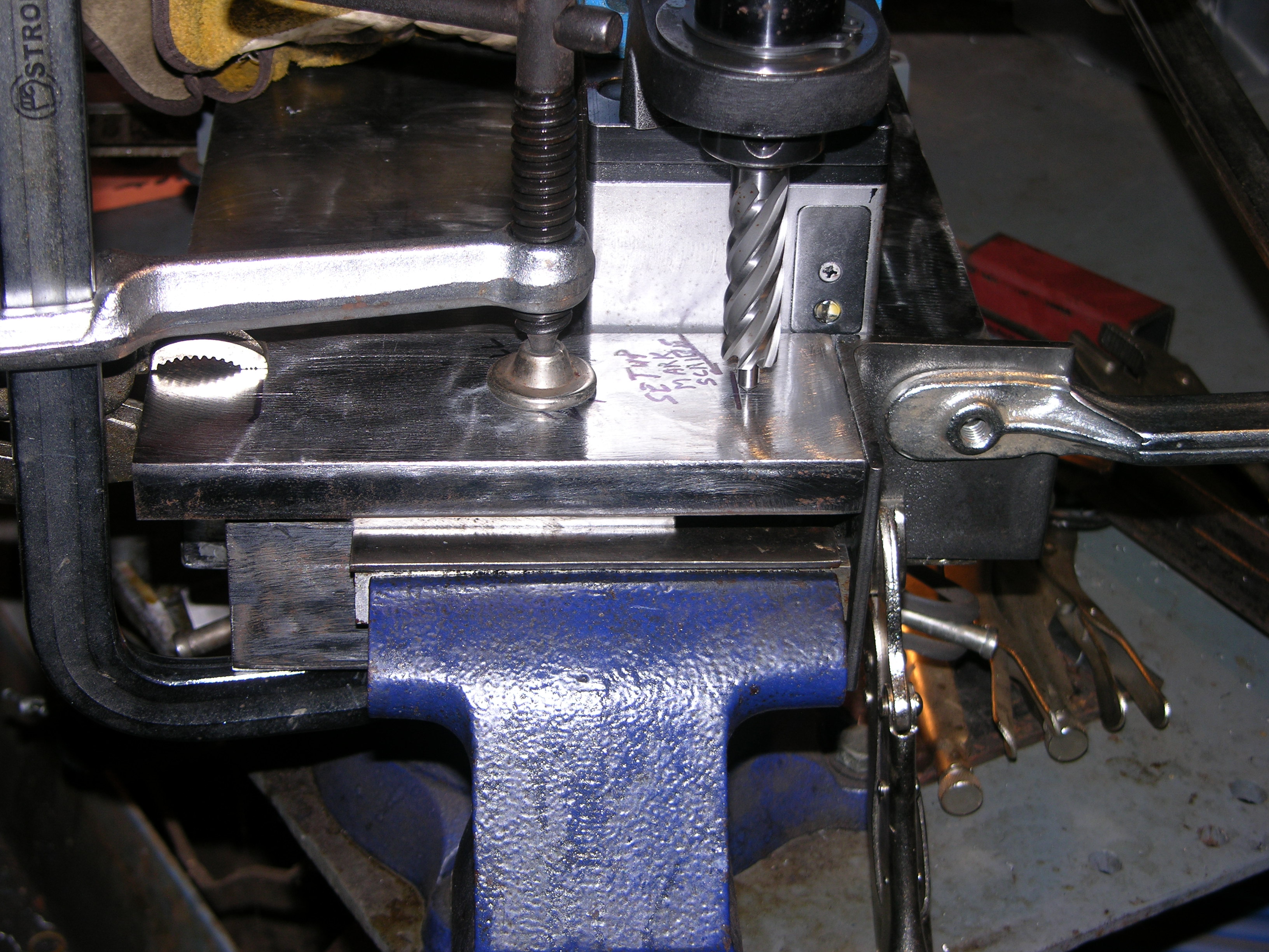

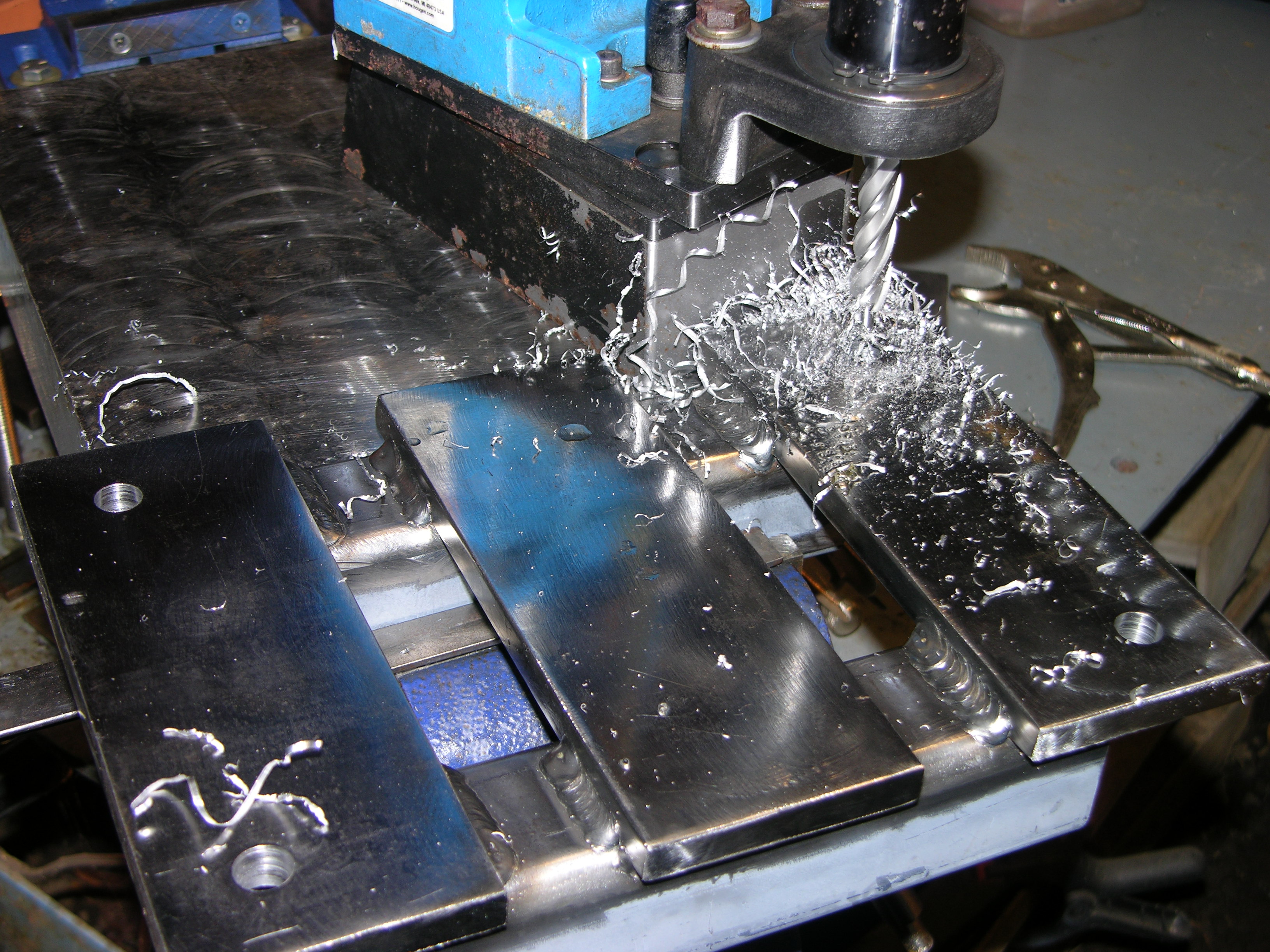

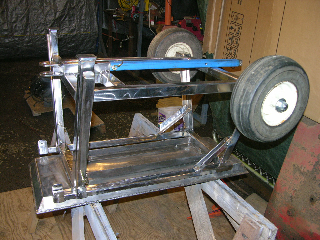

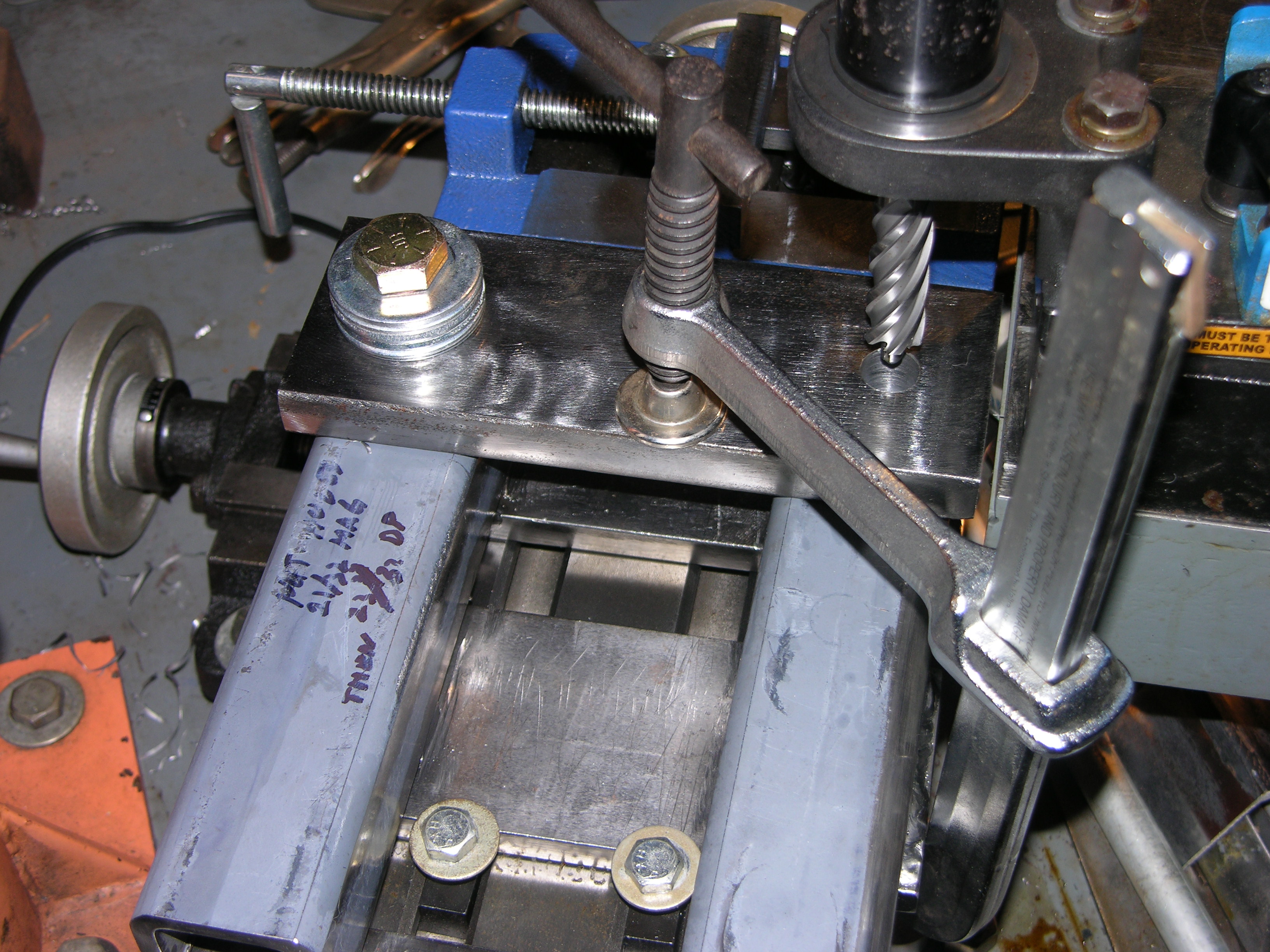

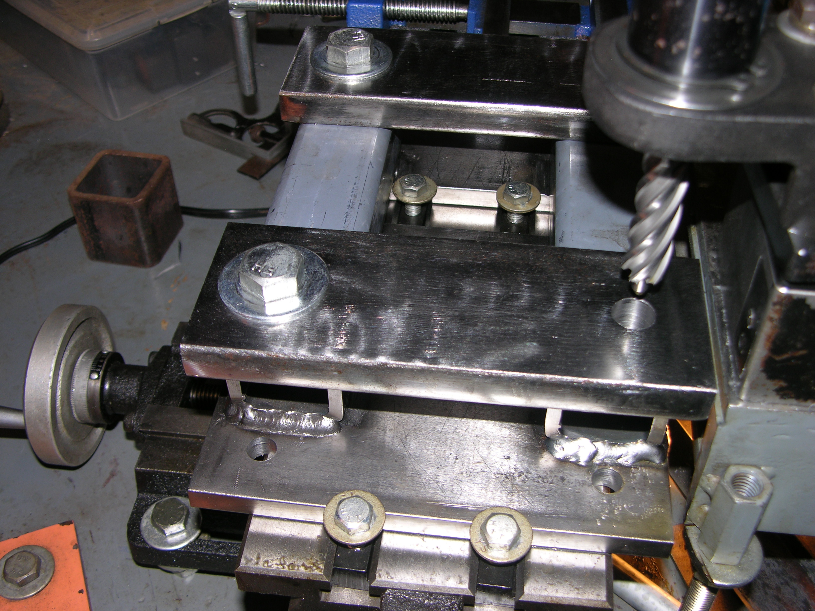

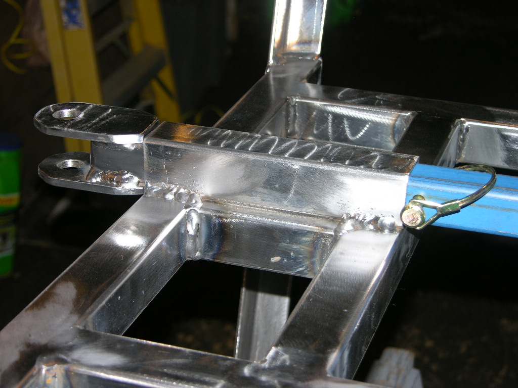

Oh, BTW I got a little more done on the HF crane mod - got all welded up EXCEPT for the nuts inside the square tube, need to drill for those FIRST - DID get hole locations punched - used the original I beam end plate for a guide, clamped to MY "sliding clamps", 1/2" transfer punch, 4 whacks per slider, done - DSCN3077.JPGDSCN3080.JPG - Sorry for hurtin' yer eyes with those "sloppy HUMAN welds :laughing:
So manana I'll "wake up Maggie, I think I got sumthin' to say to you" :D - 8 11/16" holes at ends of those square tubes for 5/8" weld nuts, 4 21/32" holes in the ends of those 3/4" FB lockdown bars, 8 17/32" holes for bolting to the legs (plus opening up the stock holes in vertical post plates to match) then it should be time for degreaser (carb cleaner) and paint... Steve

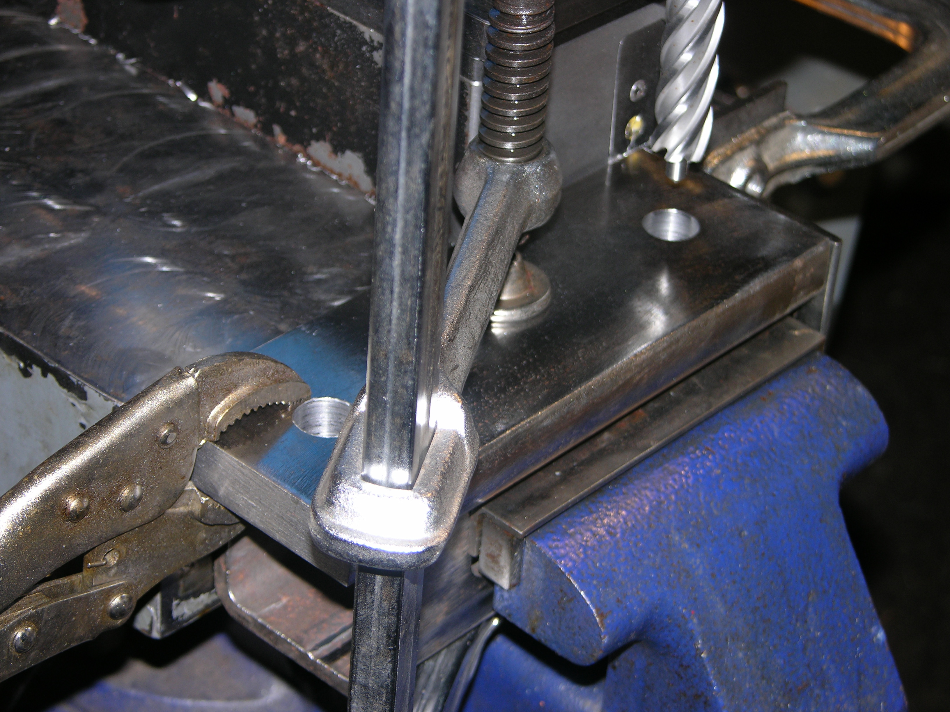

"Transfer Punch?????????" - Nuthin' fancy, just really handy when you're needing to match holes EXACTLY in 2 different pieces - Transfer Punch Set - 28 Piece

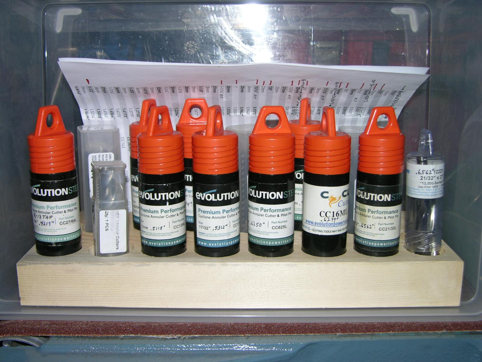

"Instead of 21/32 holes I'd go with 43/64", holes drilled in 64s" are more rust resistant."
Guess I'll hafta settle for rusty holes :confused: - my cutters of choice only come in 1/64" increments in a few sizes, intended for tap drills. Same with 1/32" increments, only a couple of those. When I want a slight clearance for normal inch sized bolts I can usually find a METRIC just a few thou bigger - here's the list of cutters I have so far; mine are highlighted in red on pages 15 and 16 - p.16 bottom of the page is all tap drills, but I use 'em anywhere I need that size. I like that their charts are arranged in increasing diameters, whether inch or metric. That's also the order I keep mine in - DSCN1966.JPG
View attachment AnnularStevePg-15-16.pdf
Next up: "Maggie gets to come out and play"... Steve

Are you implying that maggie will be using some sort of cutters instead of drill bits?

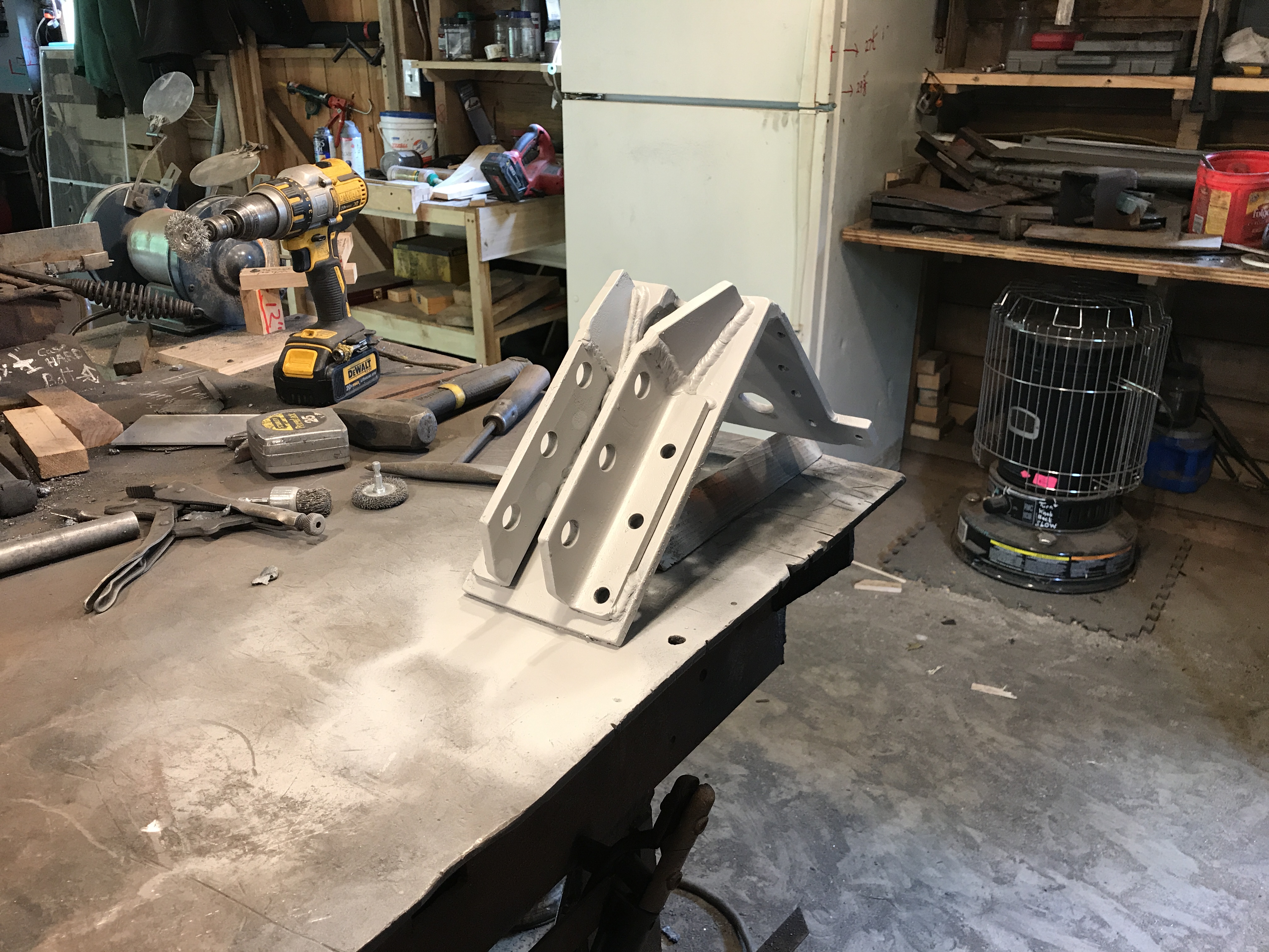

Now since my alarm didn't go off this morning and missed work, story picture time. In the process of fixing a major repair on my tractor trans case another poster (Teg) posted a picture of a Top Link Reinforcement plate for older Kabotas. So after acquiring the steel I started making it last fall. With 6> 1/2" holes on the vertical part down behind trans, and 6> 9/16" holes on the flat part under seat, two pieces , an L>shape welded together in the corner.
Now the 6 holes on top was the easiest-ish and would've been if I new about Transfer Punches. I take the seat plate off that holds the seat, lay it on the plate on the bench, very carefully traced out the 6 holes, then very carefully center punched all six holes, see where I went wrong, after drilling the 9/16" holes, I still ended up reaming out several holes so that half of top plate would bolt on top of transmission. The vertical bottom plate wasn't traceable so that required precise-ish measuring and also required reaming a couple holes.
So I go to work on Monday, chatting with the tool gribb keeper, one of them rare friendly types, I'm telling him about how hard it was to transfer those 6 top holes on that top plate, he goes that should of been easy, I go no it wasnt, you know how hard it is to transfer holes, you have to hold that center punch just right and steady, he looks at me with his head half cocked with a half cocked grin, he says no your suppose to use a TRANSFER PUNCH, I go what you talking about, he goes wait here, he goes to the tool draw section comes back over slaps a case of round punches down on the counter, he says THESE ARE TRANSFER PUNCHES, see the point on the end on all these punch sizes. I go well I thought those were just another style punch, I said anit that a site how come I never knew what these was, he about laugh his head off, and I can here you laughing to.
Now I'm the process of doing firewood hauling testing, it's a 3/8'' thick plate, around 6" wide, total length is around 18", with reinforcment toe brackets in and on the conner, my transmission case shouldn't crack again, I hope/pray, cause it's $850.00 for new trans case +someones labor.
The first picture is what (Teg) sent me, I use that for a pattern/idea, the second picture I had to do twice because when I welded the small toe brackets on the inside on my welding bench, it suck in the conners about 1/4" and the plate wouldn't bolt up, so cut apart, do it again, weld it back together on the tractor, then unbolt, place it back on my bench, but this time I tacked two diagonal braces from both ends so it wont fold in, then I rewelded the inside toe bracket, checking squareness as I was welding, then welded the outside top toe brackets. The only way to keep steel from moving is tack on temp braces.

"Are you implying that maggie will be using some sort of cutters instead of drill bits?" - Yup, I have a chuck adapter for the mag drill to use twist drills but haven't used it yet - that'd take another mod to my drilling setup that hasn't happened yet, so any hole I can make with annular cutters gets drilled that way. Cleaner, faster, easier and does NOT WANDER, with or without a punch mark -
"the 6 holes on top was the easiest-ish and would've been if I new about Transfer Punches" - True, and $10 for that HF set I linked isn't too hard to swallow - if those won't work it gets more "spendy" fast -

"The vertical bottom plate wasn't traceable so that required precise-ish measuring and also required reaming a couple holes."
Maybe - depends on what you have available - They ALSO make things called "Transfer SCREW sets" -
Transfer Screw Sets | MSCDirect.com
If you follow that link, you'll see that you need a DIFFERENT set for EACH SCREW SIZE - more than a couple sizes needed and you REALLY start $pending :( Plus, most of those screw sets are too LONG to help you on your VERTICAL plate) - but there's ANOTHER way, if you have access to a metal lathe - I DON'T, but I have a small chuck that fits my mill - here's how -

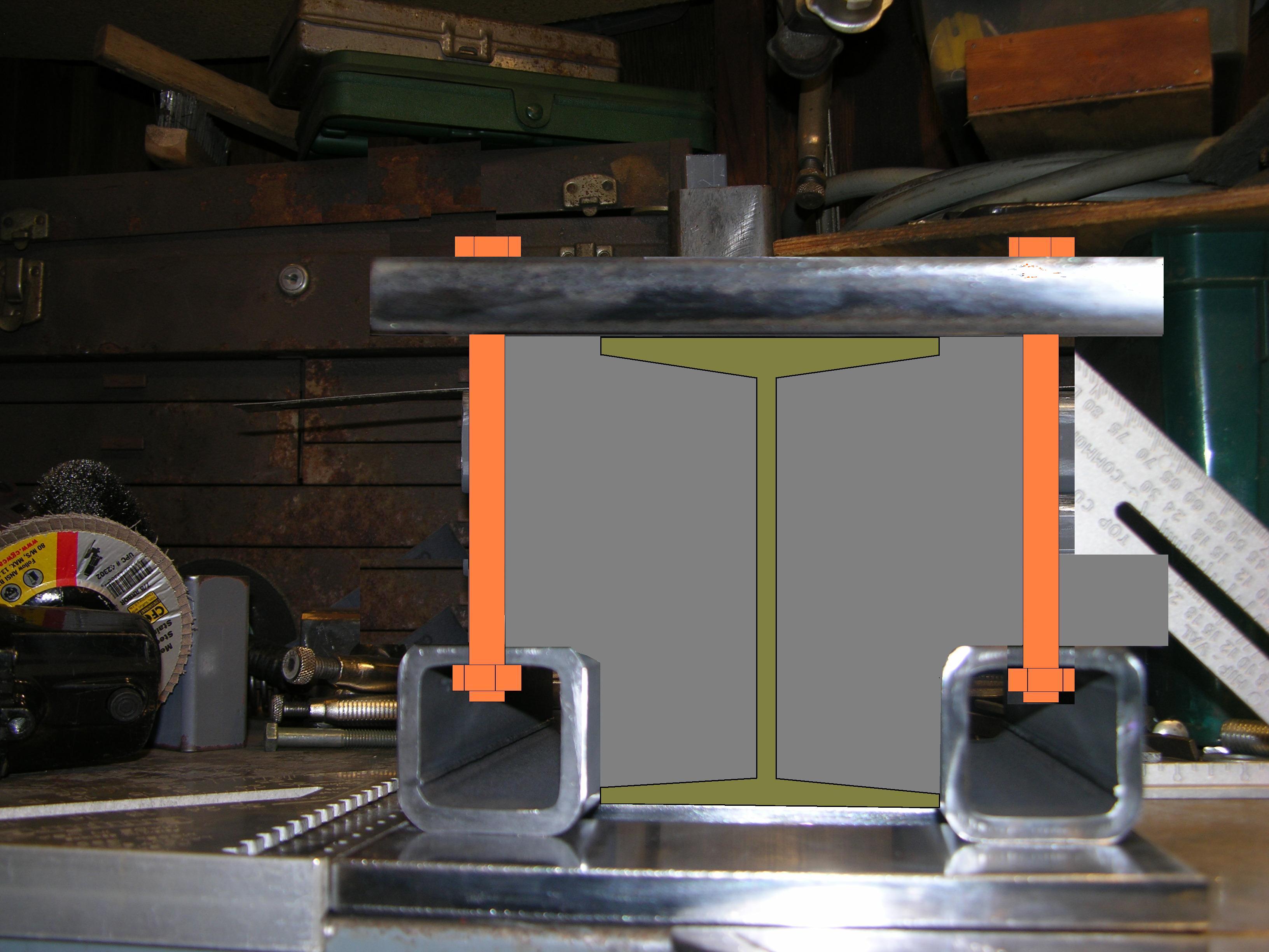

First, you'd need as many EXTRA BOLTS for that vertical piece as there are holes (6, in this case) - you'd ALSO need at least 2 NUTS in that same thread (like 12mm x 1.25 pitch, or whatever yours are) - The goal is to end up with 6 short bolts, but with NO HEAD, just a POINT -
So you'd want to use short bolts (more accurate "transfer") - double nuts on the threads, JAM hard together - chuck the NUT in the lathe, turn the OTHER END (where the bolt head WAS) to a point - take the nuts off and repeat with the other 5 bolts.
Now you can screw those "short transfer screws" into the threads on the Kubota - kinda tricky, but you'd need to get ALL of 'em sticking out as close to even as you can -
Next tricky part is to figger a way to hold YOUR VERTICAL PLATE against the points of those screws WITHOUT THE PLATE SHIFTING, til you can tap the plate with a hammer over each "transfer screw" -
Another trick that can help with this - do just ONE punch, like bottom left hole - drill a pilot hole in the plate, not too big - then back THAT "transfer screw" out a bit so it's higher than the rest, the POINT of the screw will then fit into the pilot hole so it doesn't shift - REPEAT this on the TOP RIGHT hole - those two RAISED screw points will keep the plate aligned, so you can tap where the other screws are and mark the rest of the holes...
You'd probably STILL need to go slightly oversize on the holes when drilling, you know how hard it is to get things EXACT -
And yeah, I know it's already DONE - but tricks like these have a way of helping you out of the NEXT jam :thumbsup:

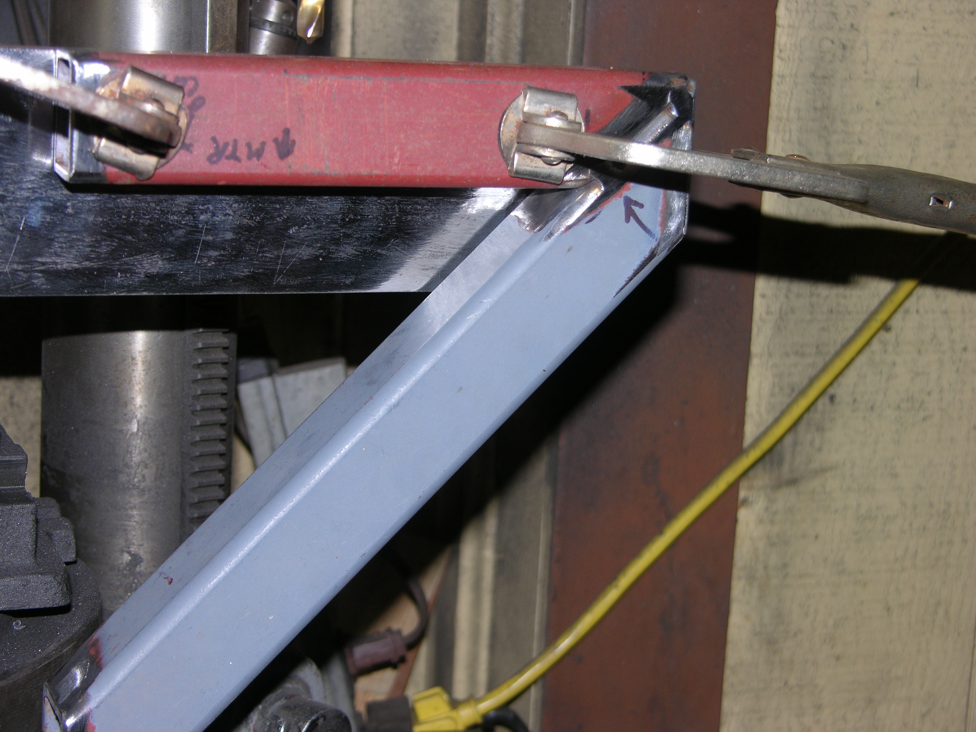

"so cut apart, do it again, weld it back together on the tractor" - "but this time I tacked two diagonal braces from both ends so it wont fold in, then I rewelded the inside toe bracket, checking squareness as I was welding, then welded the outside top toe brackets. The only way to keep steel from moving is tack on temp braces."
Pretty much, although having all those "high dollar" weld clamps has helped me too - all these "roof frame modules" -

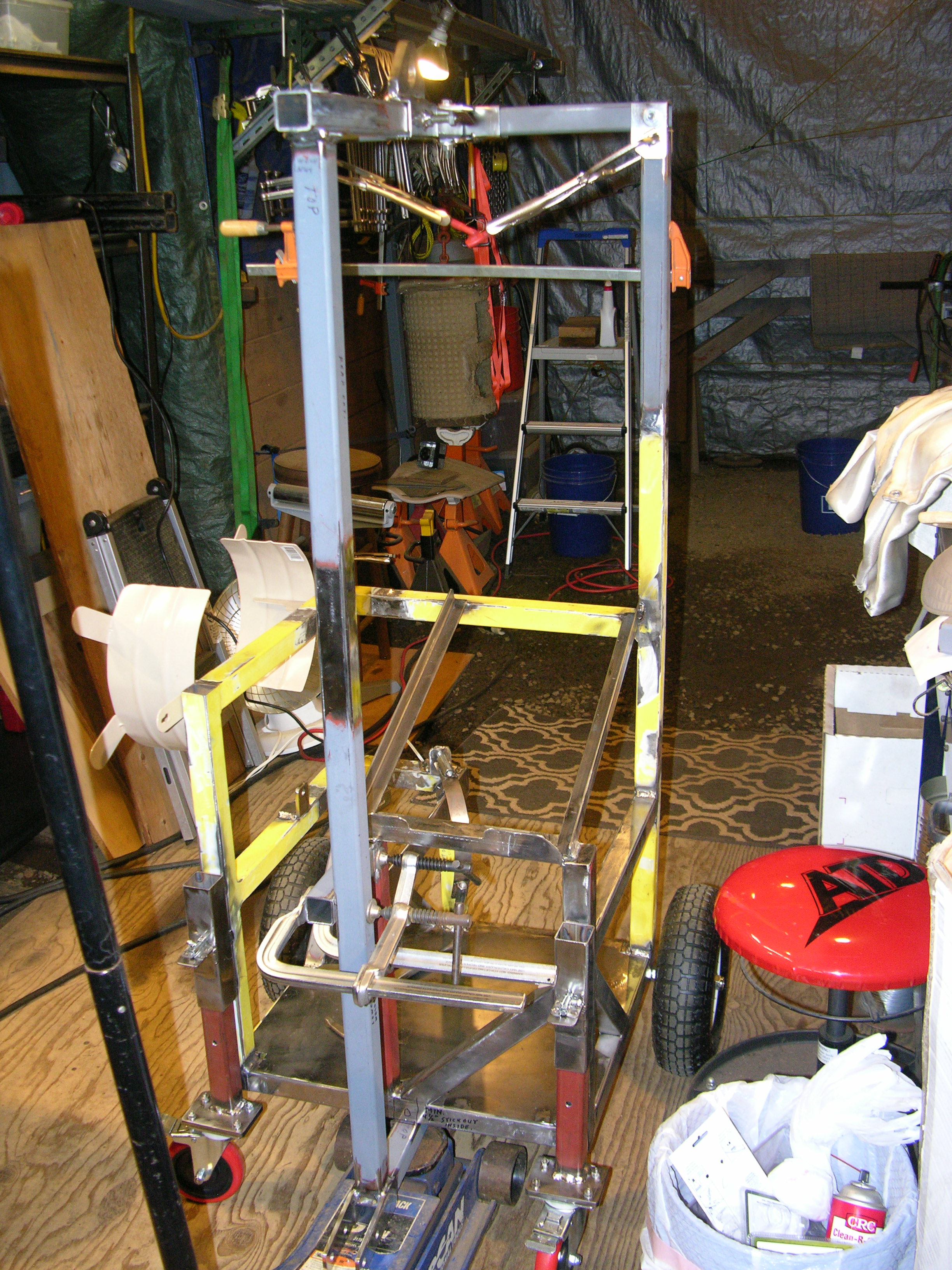

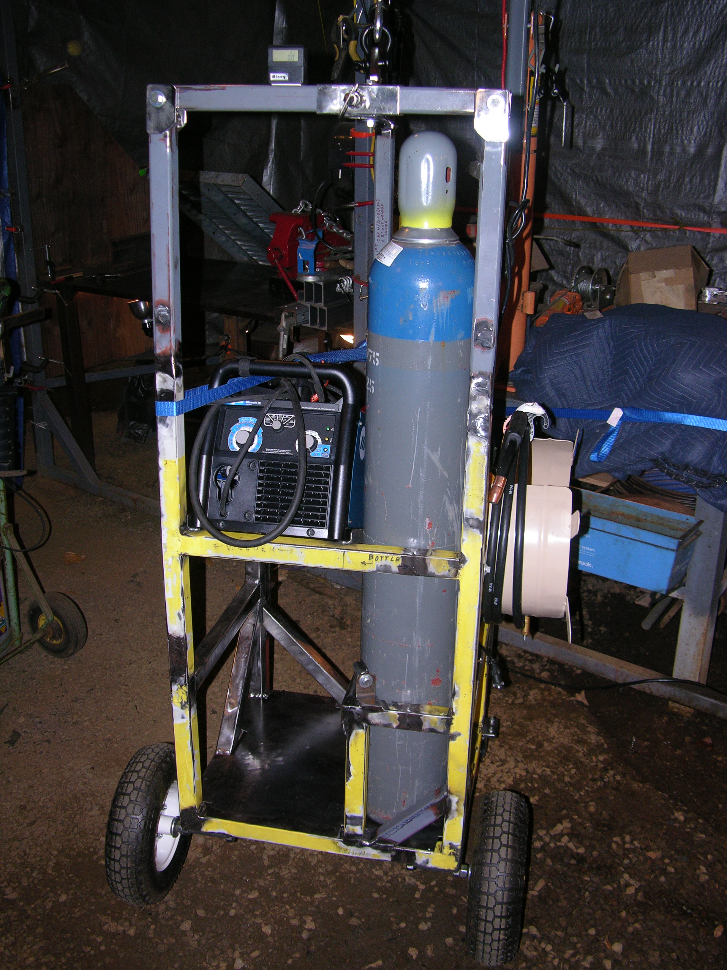

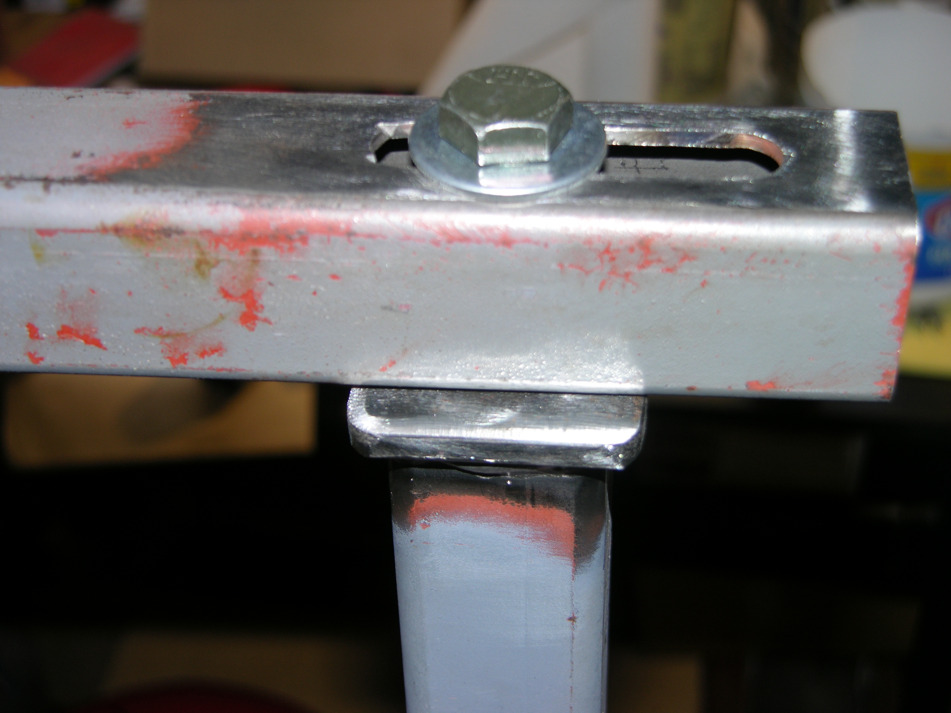

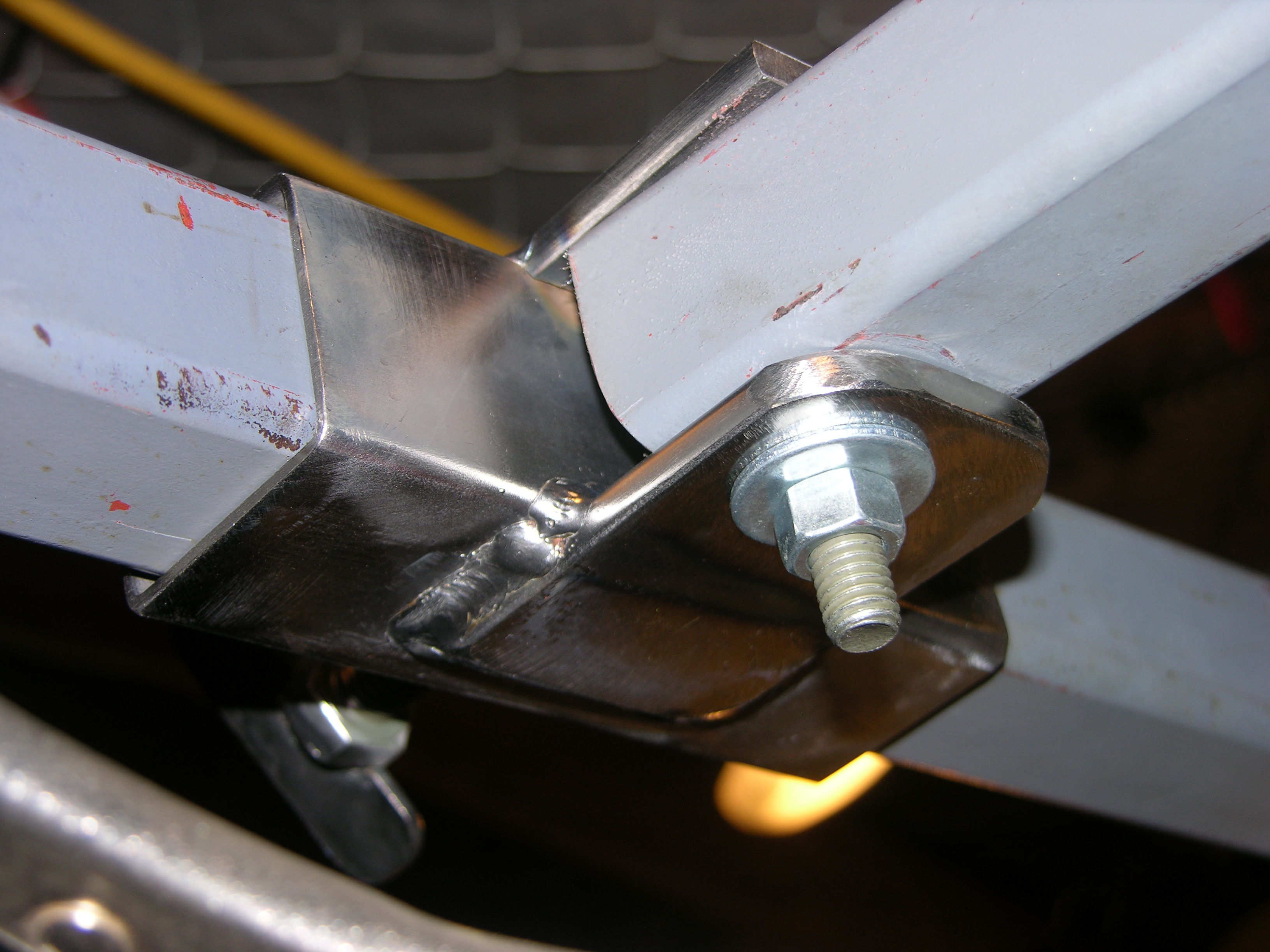

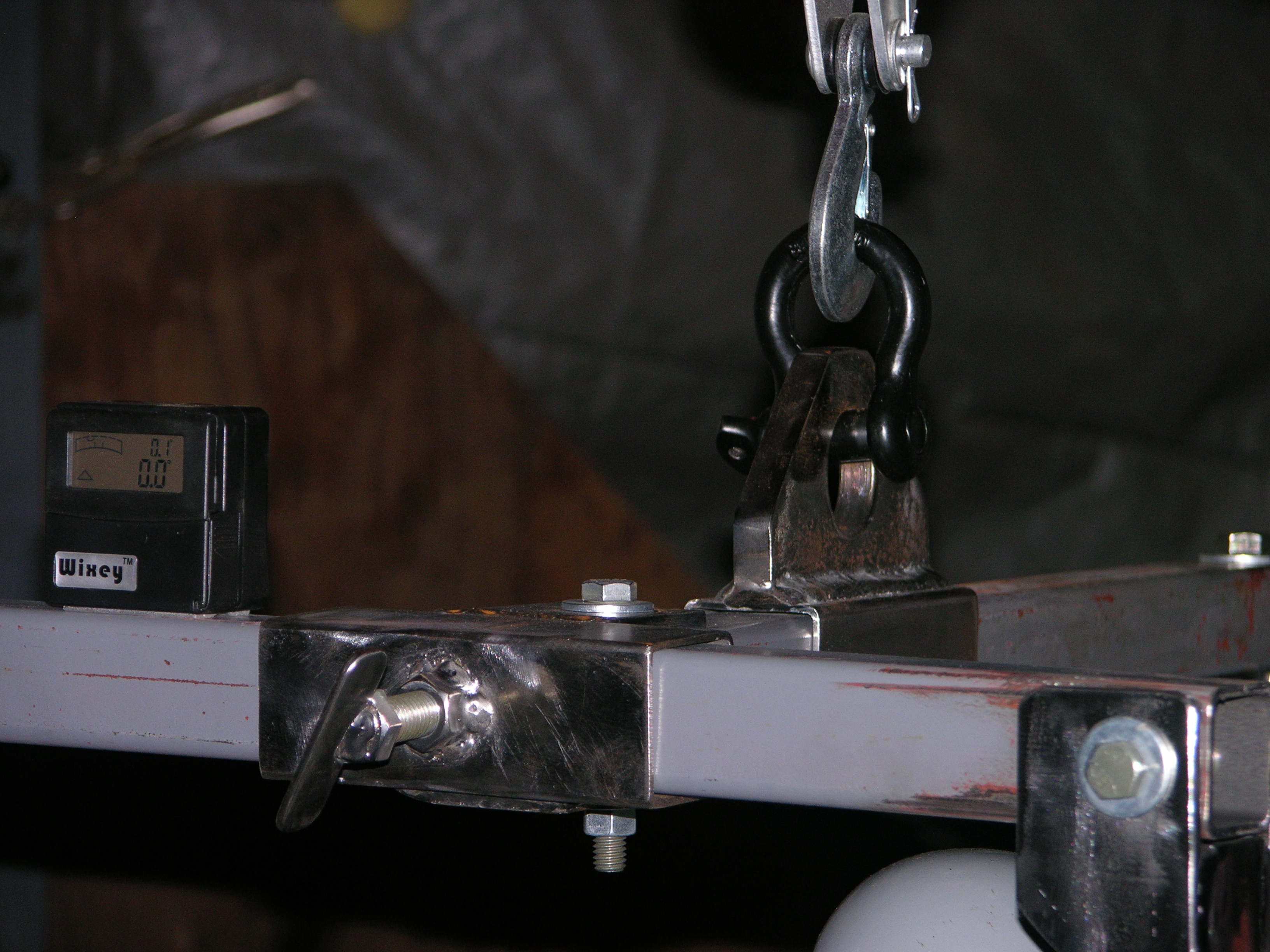

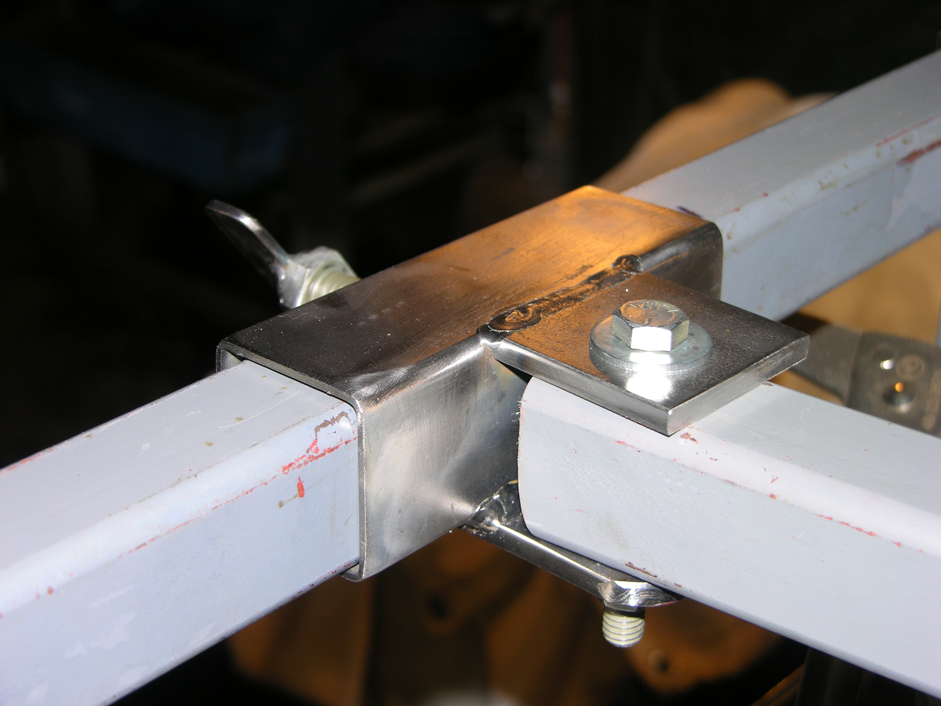

DSCN2325.JPG - came out near perfect - note the diagonal brace that's clamped at EVERY CROSS MEMBER - also, with no flat/level surface to fab on, I used one of these

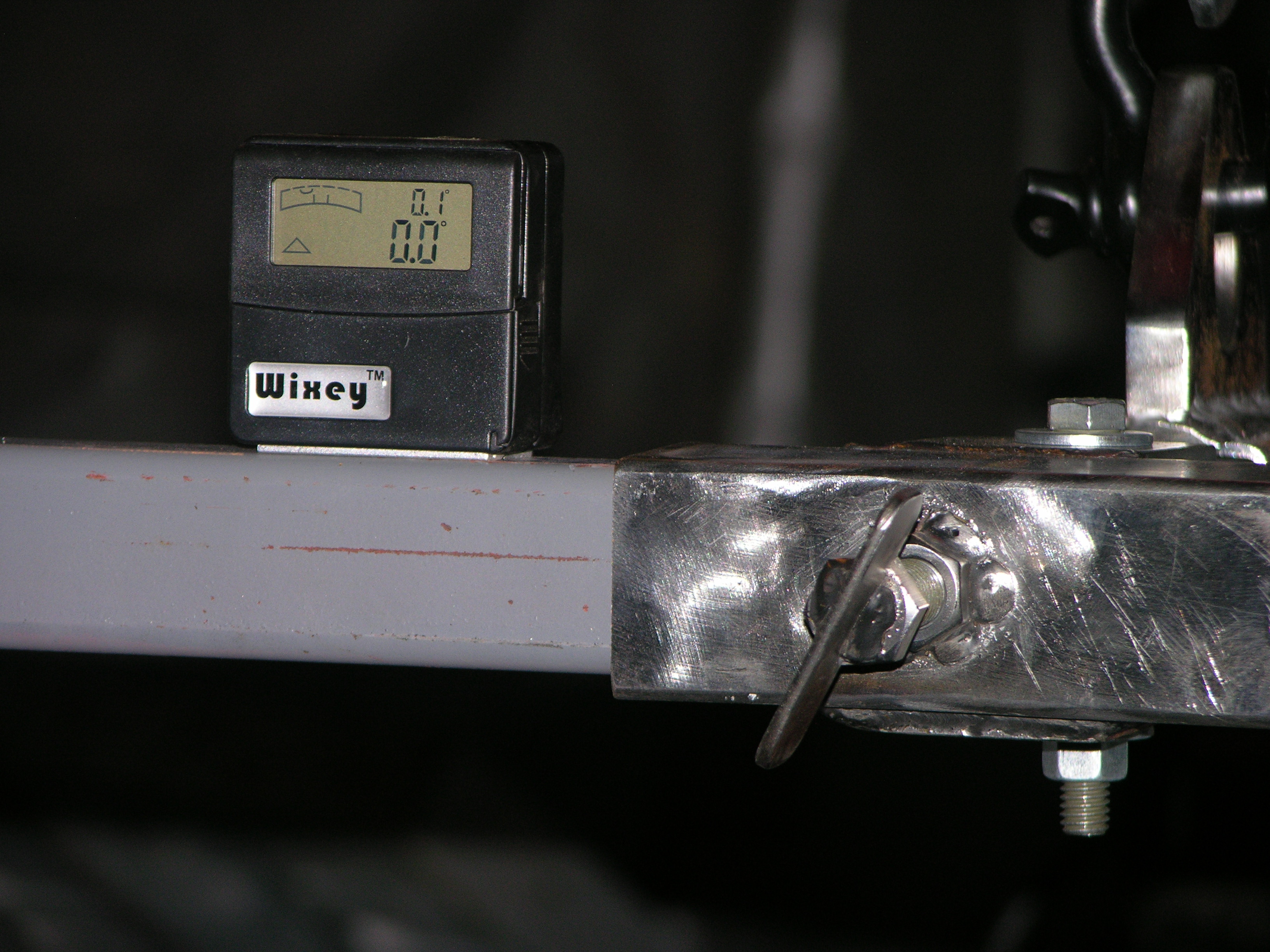

Wixey Digital Angle Gauge with Flip-Out Display | Rockler Woodworking and Hardware
- set up the perimeter pieces on jack stands (with shims for "in-between notches" - Got it level all the way around, then tacked everything, alternating tacks so if one tack would pull left, the next one should pull RIGHT, etc - but the heavy clamps held as good as tacks on that diagonal...
Think that about covers it, guess I better get off my butt and "install some holes" - Oh, speaking of which - another thing I've learned in the last few years is to (if possible) weld EVERYTHING I can FIRST, THEN drill - specially if it's not a good idea to weld close to what I'm adding onto... Steve

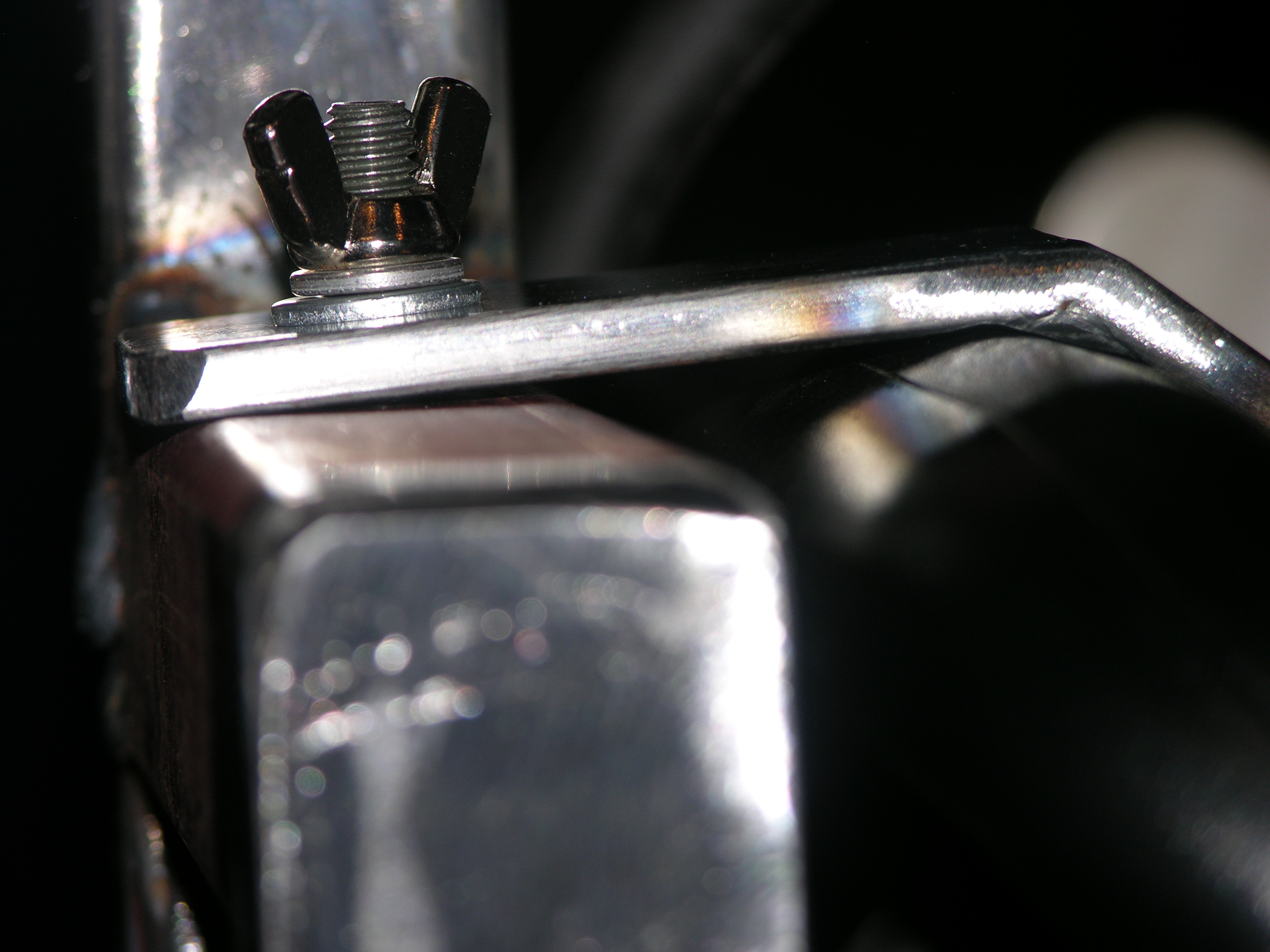

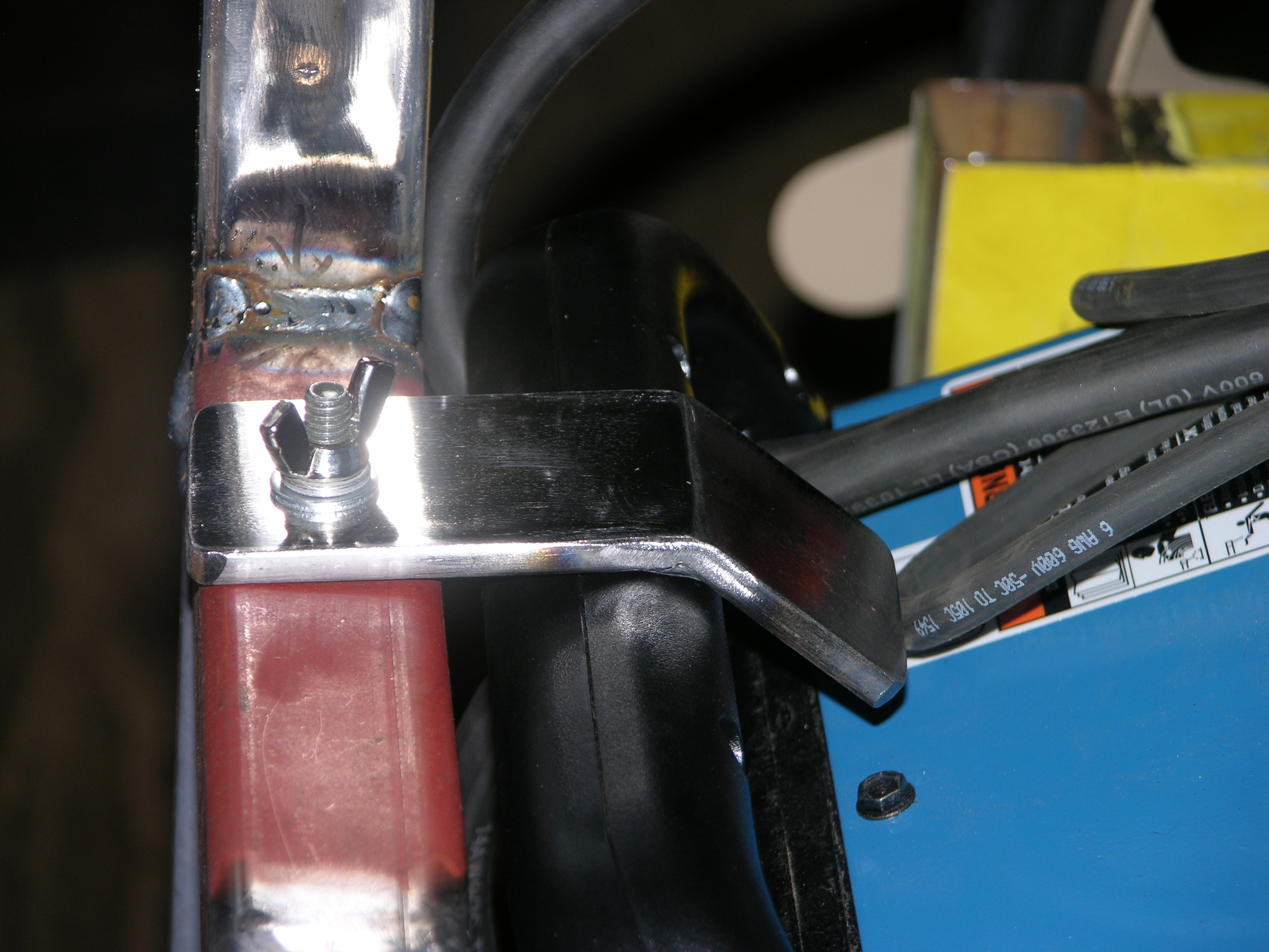

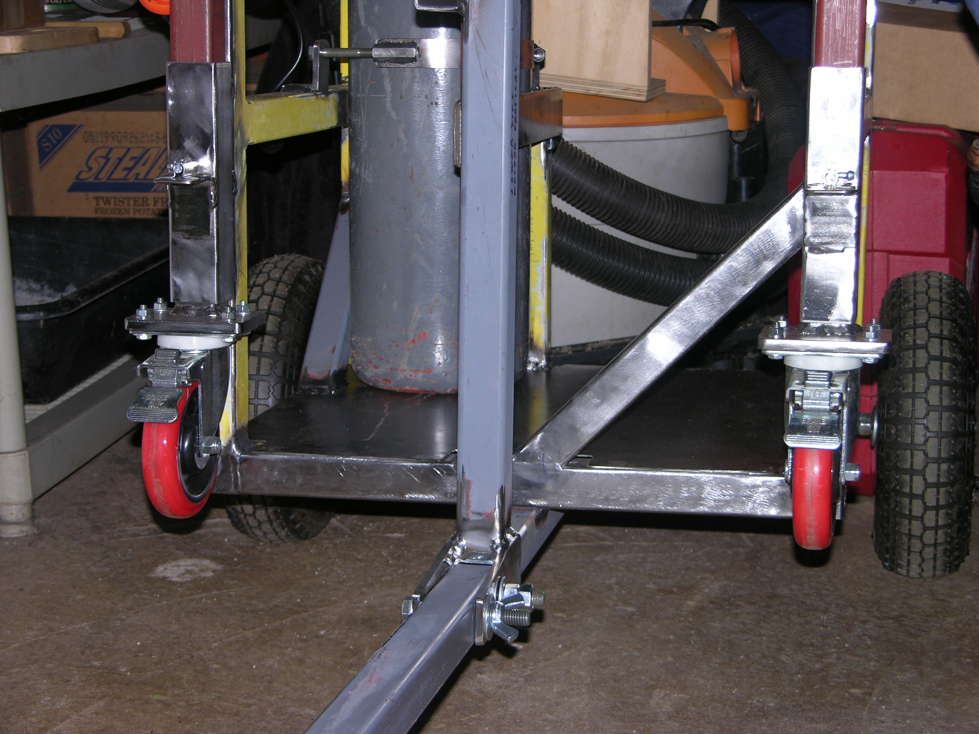

Once I figger THAT out, I can bolt those hold-downs onto the square tube with SHORT bolts long enough to goober some weld on the nuts, it's startin' to look like that "light at the end of the tunnel" is NOT attached to a locomotive :D
I'll grab a few more pics after, probly get 'em posted manana... Steve

Been awhile since I got much done, finally got back into it -
The holes that'll mount the "sliders" to the factory posts on the HF crane; showing ONE HOLE's worth of chips - DSCN3082.JPG -
Overview of the "MDVT" showing the fixed vise and the XY table - DSCN3084.JPG -
Getting stops set up to drill all 8 holes in the 3/4x3 holddown bars - DSCN3086.JPG -
Different view of same setup - DSCN3087.JPG -
Holes drilled in one bar - 16-18 seconds each, ZERO cleanup other than blowing chips away with air - DSCN3088.JPG -
Using pre-drilled bars as a guide when drilling the square tube they'll bolt to, so things actually line up :thumbsup: - DSCN3091.JPG -
Since the holes in those square tubes are 7" apart and the XY table is mounted parallel to the mag drill's table, and since that XY table's lead screws are 10 TPI, the second hole in any of the tubes can be indexed by just cranking the index wheel 70 turns - DSCN3093.JPG -
Chips from the operation so far (minus a few still on the ground) - DSCN3095.JPG -
And the easier way to pick chips out of gravel floors (doesn't work too well with aluminum :D) - DSCN3096.JPG -
