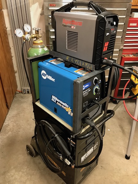

So I went out and measured my PM45 vs. the "dead air space" ABOVE the MM211 - it's do-able, but do I WANNA "do-able" it??!? NFW, but Hmmmmmm.... - Pm45 is NARROW enough it'd fit above the welder WITHOUT interfering with either bottle in/out OR fully opening the mm211's side door; it's "un-tall" enough to NOT stick above the "roll cage", SHORT enough front-to-back to NOT hit the rear vertical OR stick out past the front handle on the MM211 - AND, there's room on the other side for another lead hanger.....
Just WALK AWAY Steve, go look at the purty I beam that actually NEEDS your attention - big heavy grinders and wire cup brushes can be FUN; FUN, I tell ya :confused:
It's working; MAYBE... Steve

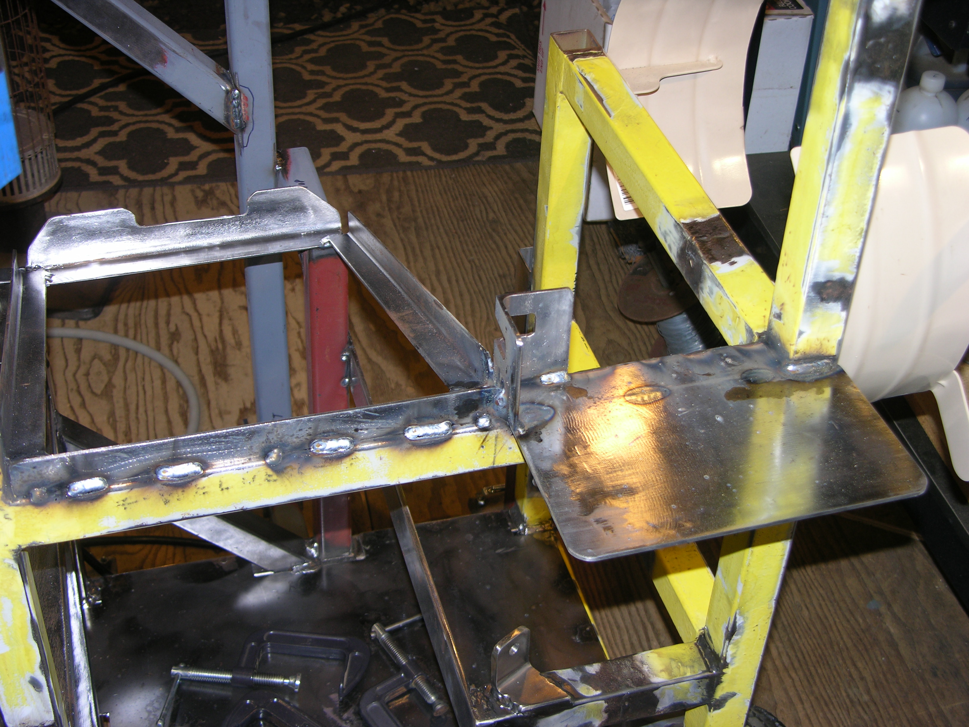

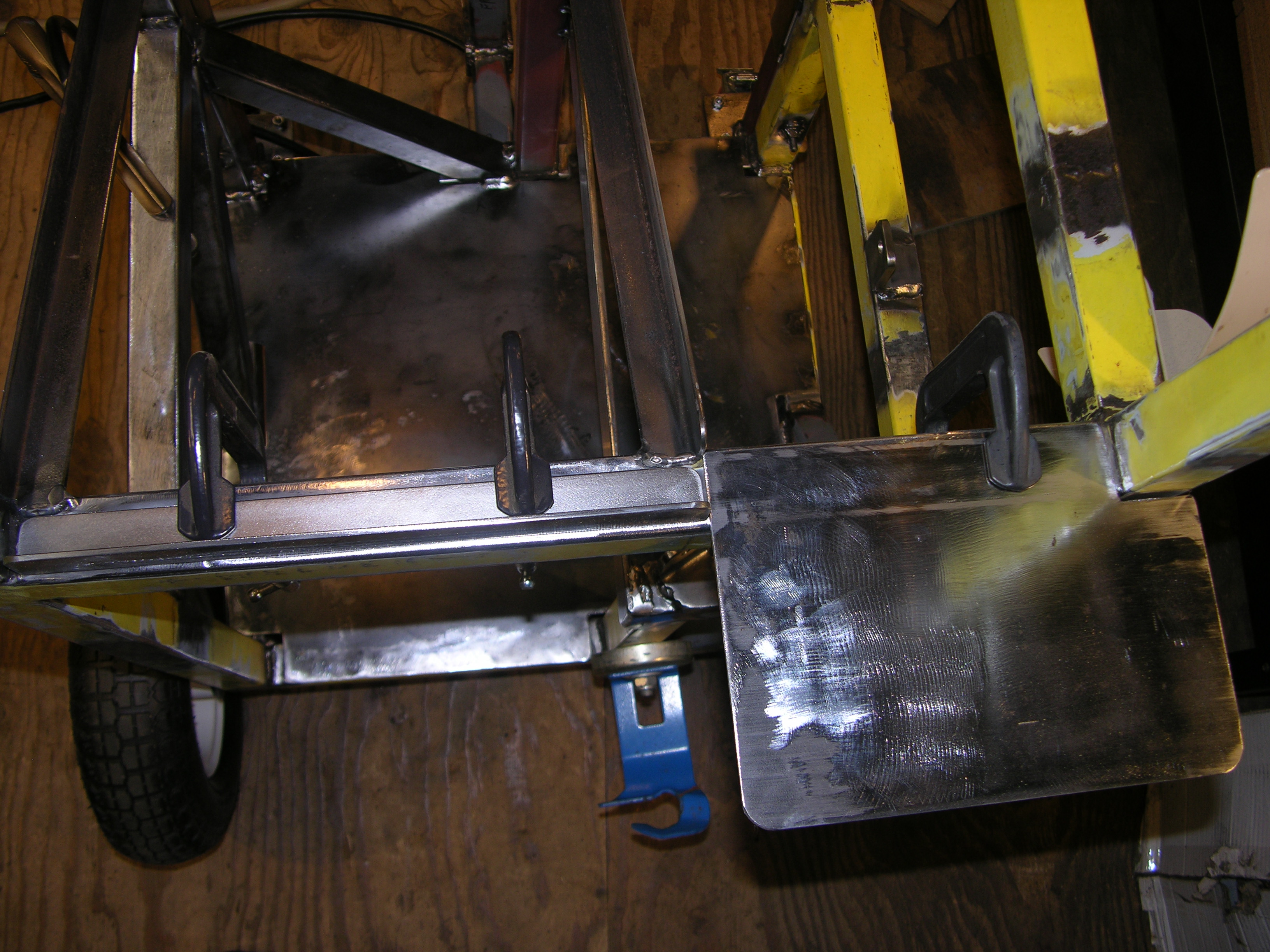

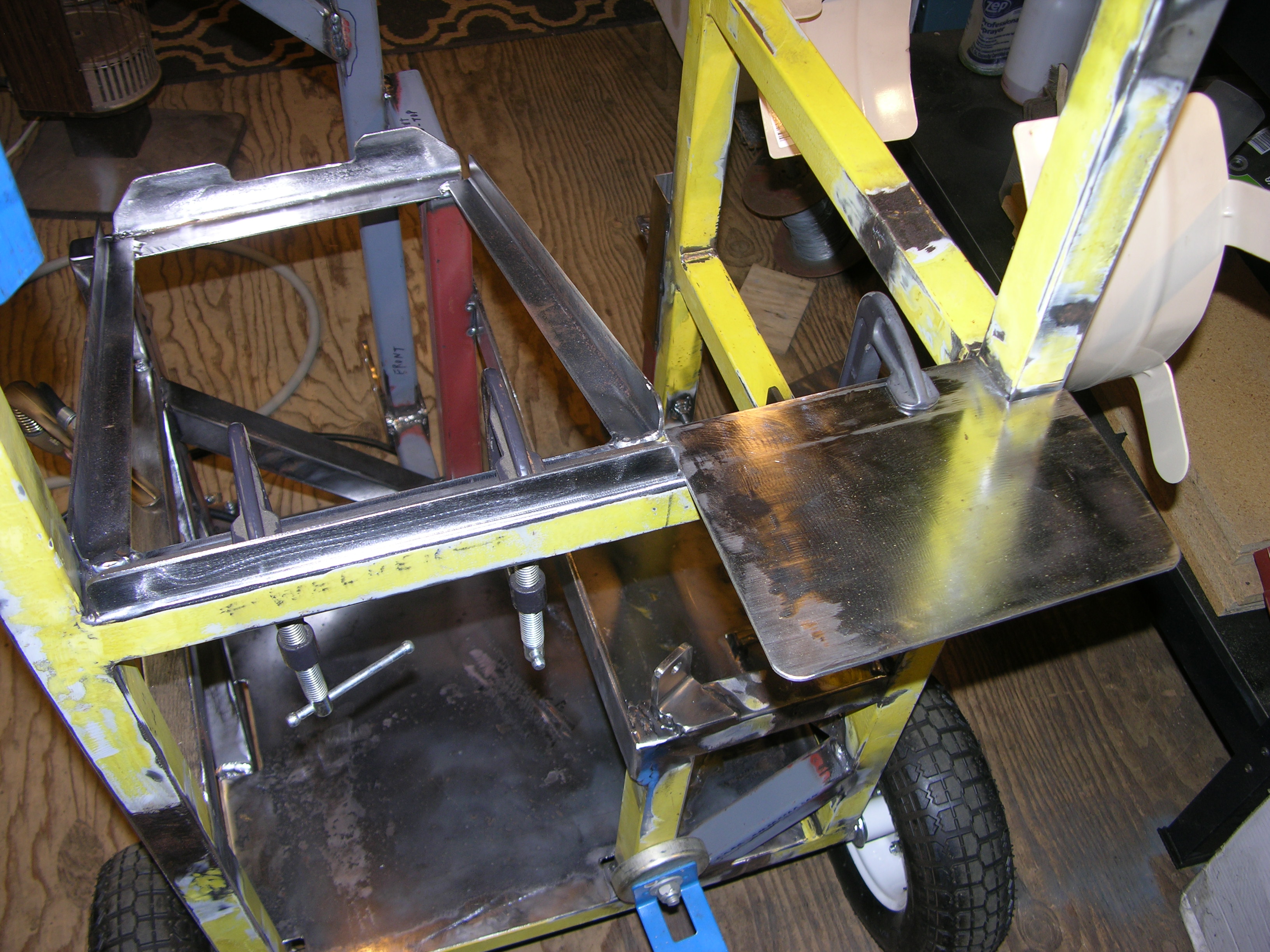

Here is my simple rack I built to fit on top of the HF welder cart. It allows the 211 door to open fully and I have a view of the tank gauges. It's a great space saver but it scares me a bit because of its height. I am considering putting a thick steel plate on the bottom to lower the C of G and some better casters.

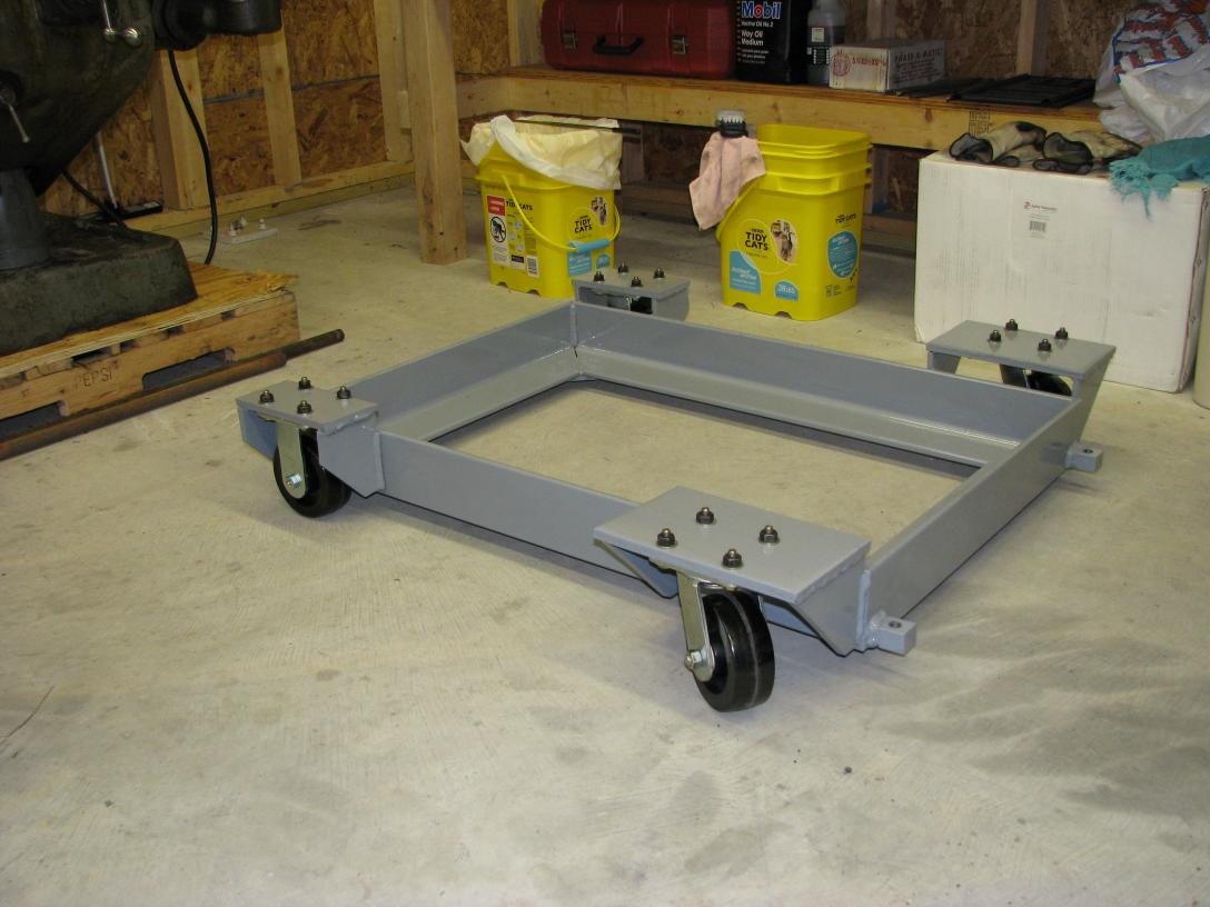

"I am considering putting a thick steel plate on the bottom to lower the C of G and some better casters."
Those would be my first choices also - and LARGER too - casters that small tend to STOP when they hit a BB, not to mention anything larger - and the combo of sudden stops AND top-heavy is a perfect recipe for disaster...
These 4" Caster, Double Locking, Swiveling with 4 Hole Mounting Plate
Are my favorite REAL casters, got 'em on several tools - they come in 3-4-5" wheel, 4" is usually the smallest I'll use (BB effect) - they lock in BOTH axes. Not cheap, I typically "stock" a couple sets, Woodcraft has 'em on sale a couple times a year.

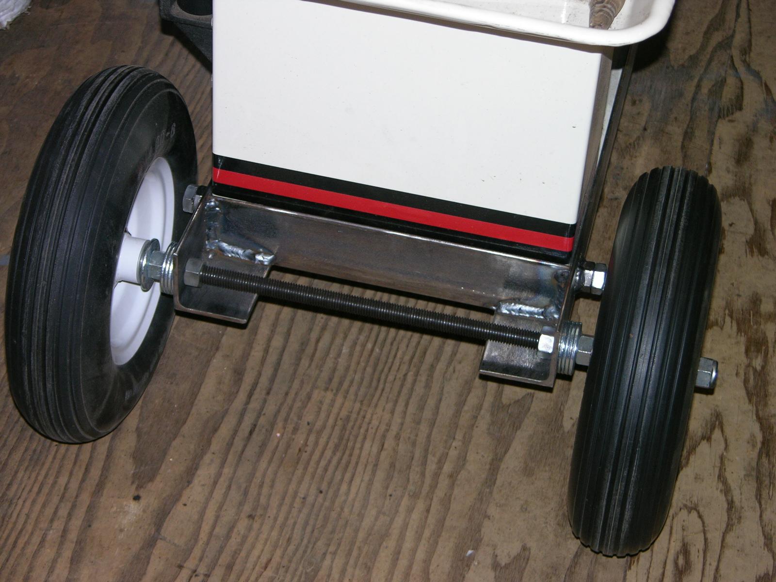

IF I were doing your cabinet (and did NOT need "offroad" capability), I'd build an angle frame, go "outboard" with HF's 10" solid rubber rear wheels (so I could do a "dropped axle" to keep things low (same with front casters) - the angle frame would leave room for a plate (lower CG) and if the angle frame interfered with bottom drawer operation, just cut that side down a bit - This one's for a Bridgeport, but it's what I meant by "dropped axle"
Doing it that way would keep tank swaps no more difficult than they are now, keep the CG as low as possible, make it easier to roll, AND those casters will make you wish you'd tossed the OEM's a LONG time ago :rolleyes:

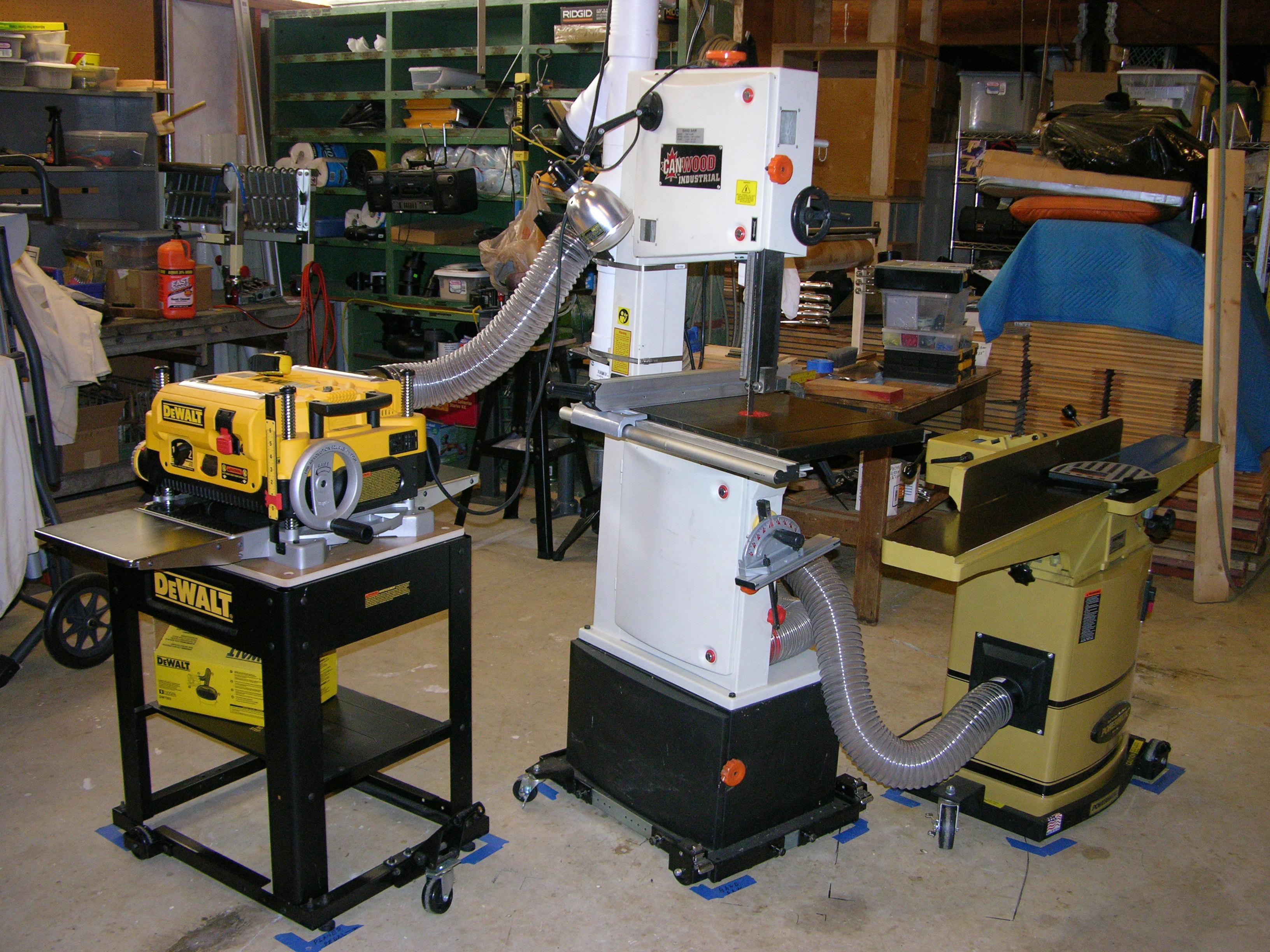

And this is my bandsaw, rear wheels are 13" no-flats - in that particular case I WANTED more height, so no dropped axle :thumbsup: Also, the rear setback is to keep the saw from "doing a wheelie" when it's in vertical position...
To keep your cart low, the "drop axle" would be a "Z" bracket outside the angle frame with a 5/8" hole thru the vertical part - then a 5/8 bolt (axle) thru the larger tire, and 2 nuts locking the bolt to the Z bracket (kind of the reverse of my bandsaw version)
The bigger better wheels would lessen the "bb" effect, the frame and plate would help lower the CG, and if you use the casters I linked you wouldn't have to scratch your head to figure out which way is "locked"; it's MUCH more obvious :D
If my description wasn't clear enough, holler and I'll do a sketch... Steve

No, I got it... thanks for the pic however, might just steal that design. :D I like the idea of a dropped axle and outriggers for a bigger footprint. Not sure I want to give up the shop real estate but probably is the prudent thing to do... one tip over and I might be crying for a long time. I might just sketch up a couple designs and see what the weight would be and how much it would lower the CG, with and w/o the outriggers. I think I have enough scrap material to do this without much, if any additional $$$.

Glad you've had better luck with HF casters than me, the ones I linked get fairly $pendy even on sale :confused:
Once I get more "supplies" out of shop space and into containers I'll need to build one of those "tank transporter" bases for my 12" helical head jointer
It doesn't look like it, but if I can keep the base low enough to NOT raise the beds more than about 5/8", I can put that 1000 pound "aircraft carrier" on the far side of the small planer and band saw, and still maintain my goal of a minimum 10' in AND outfeed on each machine (bandsaw fires OVER the 6" jointer, DeWalt planer fires OVER the "aircraft carrier" outfeed table, etc)
Oh, and if you do your outriggers like the heavy gray base (Bridgeport but lighter) only the SWIVEL casters would stick out a bit further than your leads ALREADY do... Steve

I don't have any super heavy loads on them so that is probably why... and very good point on the width of the base with outriggers not sticking out past the leads. :duh:
Now I am sold on your design... in fact it might protect my leads by reducing the chance of scraping/pinching them while trying fit/park in tight spaces! :dance1:

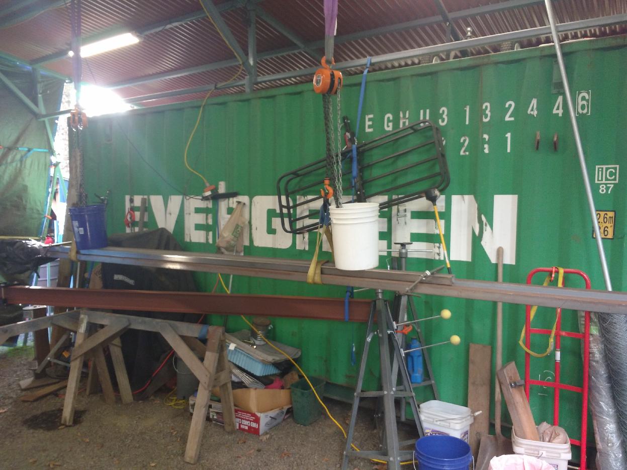

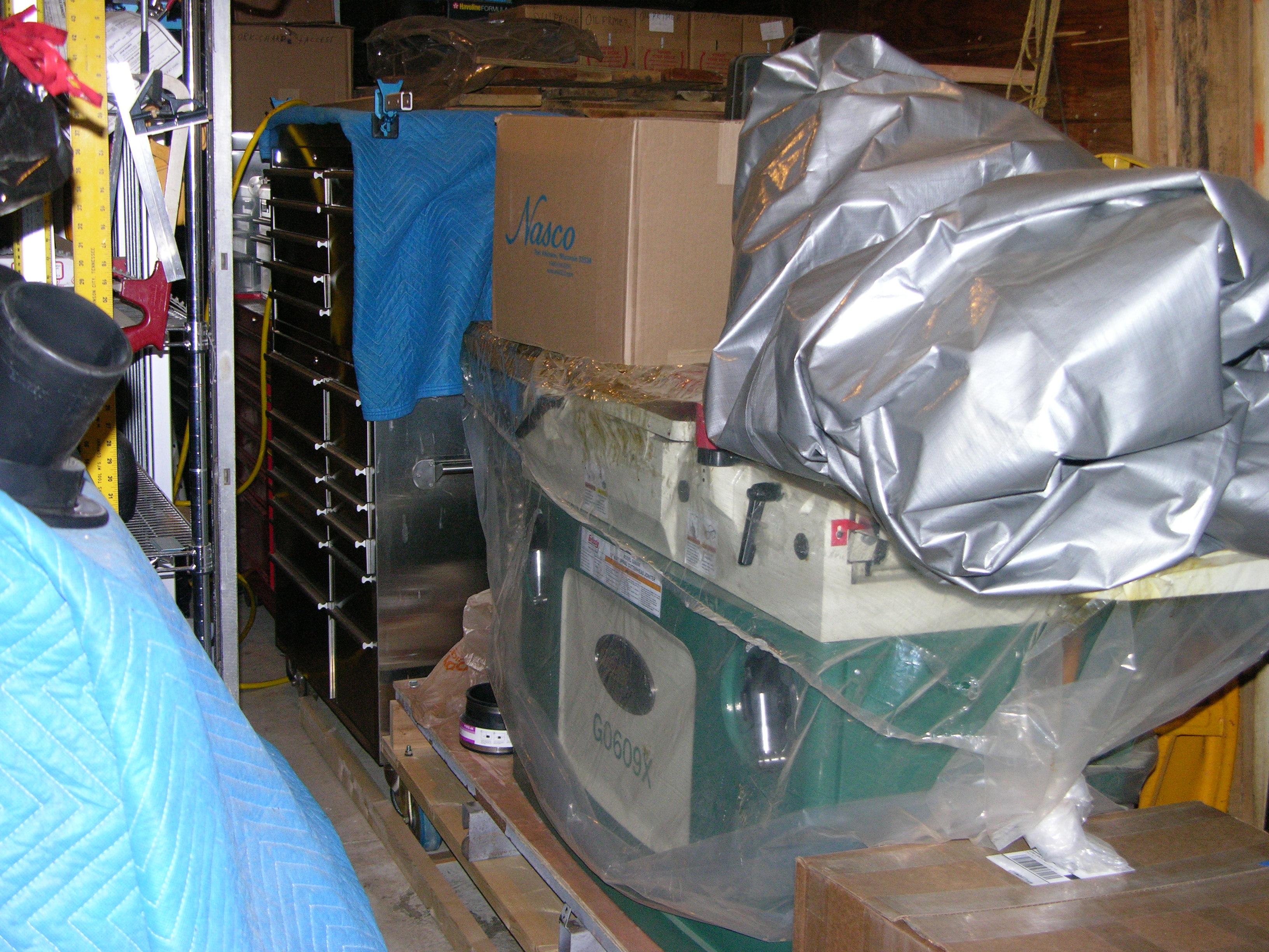

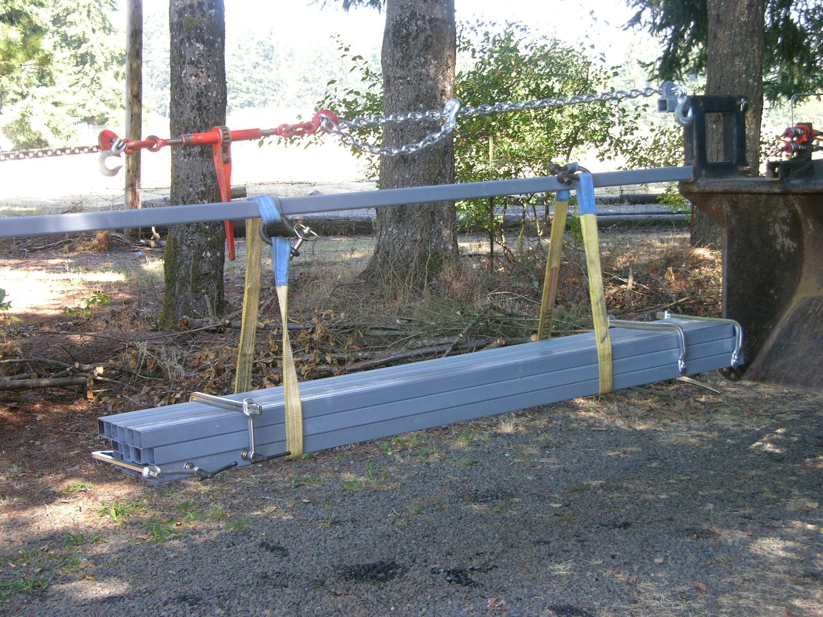

Yesterday I realized that the small bundle of 2" tubing I had hanging in the small work area next to the 20' container (with a 24x24 roof over it) was mostly in my way til I got a few things more under control ("control" part is mostly a fantasy of mine :rolleyes:) - Among other things, the increased winds have shown me that I need more areas blocked, including the area on TOP of the container, which presently is open; kinda hard to get to it with all the stuff in the way -
That bundle has a piece or two that're still 24' long, so not a lot of "wiggle room" under a 24' roof :confused:
Decided it wuz time to test part of my "container weld shop fantasy system" :laughing:
So here's the "Tinker toy" setup for long bundles -
Picked up, ready to go -
A wider view -
Almost there -
Done, resting on the HF 1000 lb. hydraulic cart so it's still semi-mobile -
All in all, the TinkerToys ruled again :thumbsup: - once the bridge crane's built inside the container, this type of move should be even easier - and all those pieces will get cut to size (max. under 10 feet) for the afore-mentioned "porch roof" frame, so they can be just tossed into the brush bucket (their temporary "build site") after getting cut in the weld shop container (cuz the Jet saw lives there now) -
If all this gets too confusing (I'm good at that :rolleyes:) you might wanna go back a few pages, it's all there (Notice I did NOT say that I wuz all there :laughing:) ... Steve

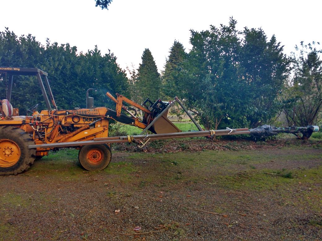

I made a temp set up similar to your side bucket lifter upper, sometimes a tractor just cant get from point A to point B, I had two heavy 16' beam to lift up on 3 post couple years ago and with no sky available I clamped some 2x4s to my forks and easy does it.............

What you did obviously worked fine; I seem to wanna do stuff that shouldn't be possible, a LOT of the time :laughing: - that's where my "tinker toy" set got started; every time I can't think of a way to do something with what I already made, the tinker toy set gets expanded - after a while it gets easier to "mix and match" pieces to get where I wanna go, haven't needed to fab more pieces lately...

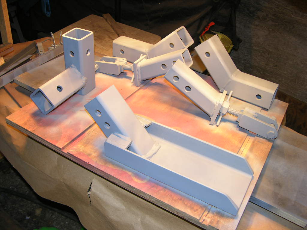

Here's more "eye candy", several pics of pieces and some of in-use - pieces -
First, fab stuff -
DSCN1690.JPGDSCN1702.JPGDSCN1703.JPGDSCN1994.JPGDSCN2218.JPGDSCN2220.JPGDSCN2221.JPGDSCN2689.JPGDSCN2690.JPG
Next, some usage pics... Steve

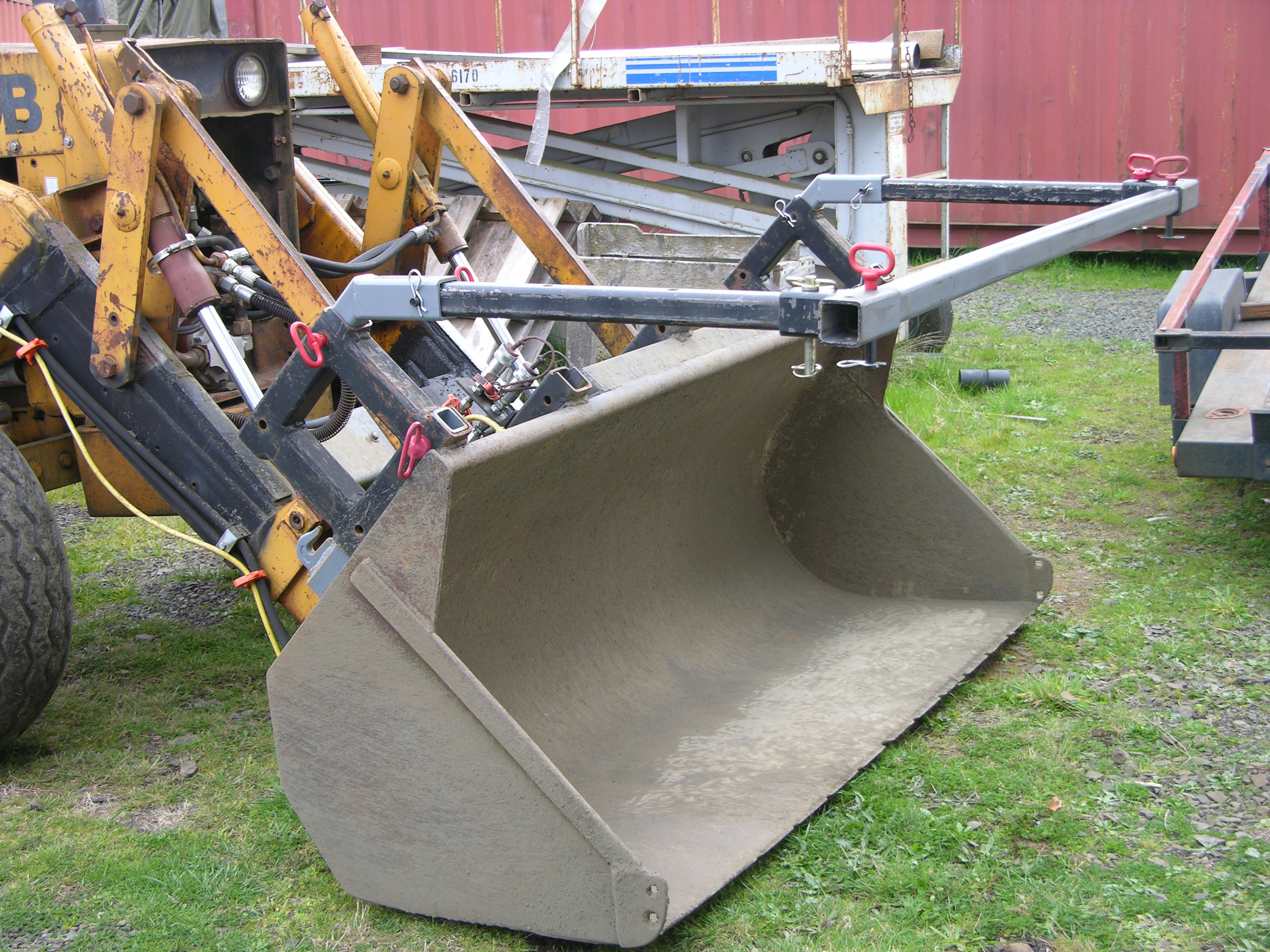

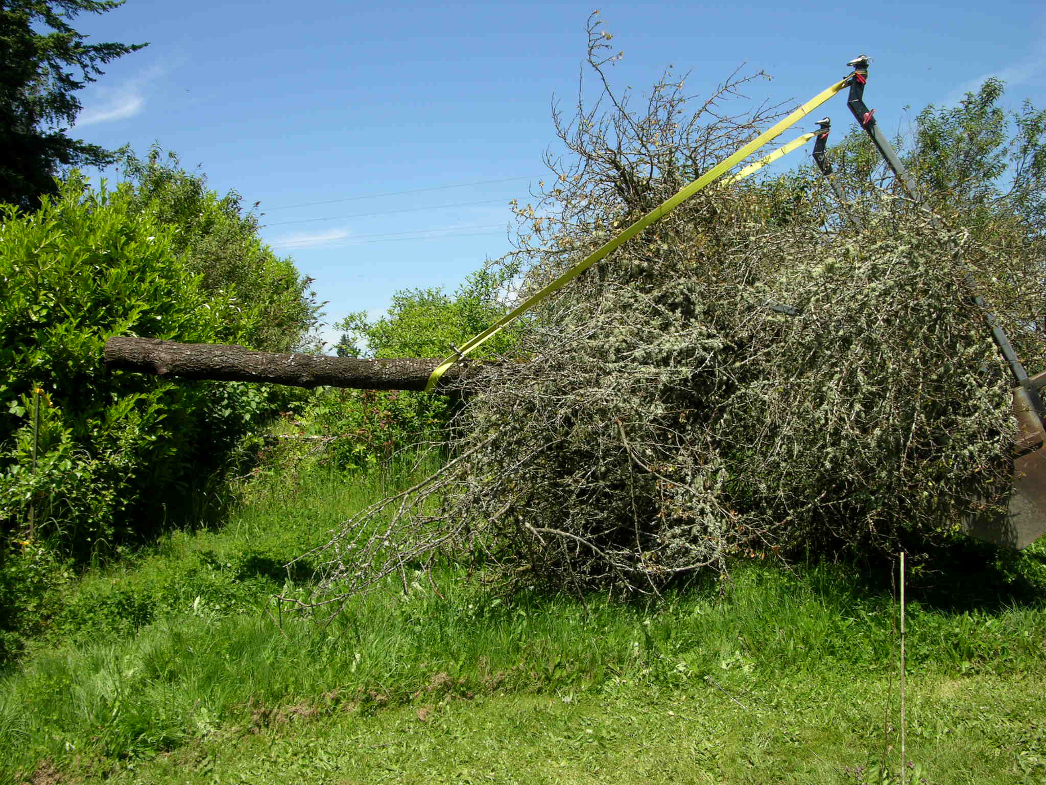

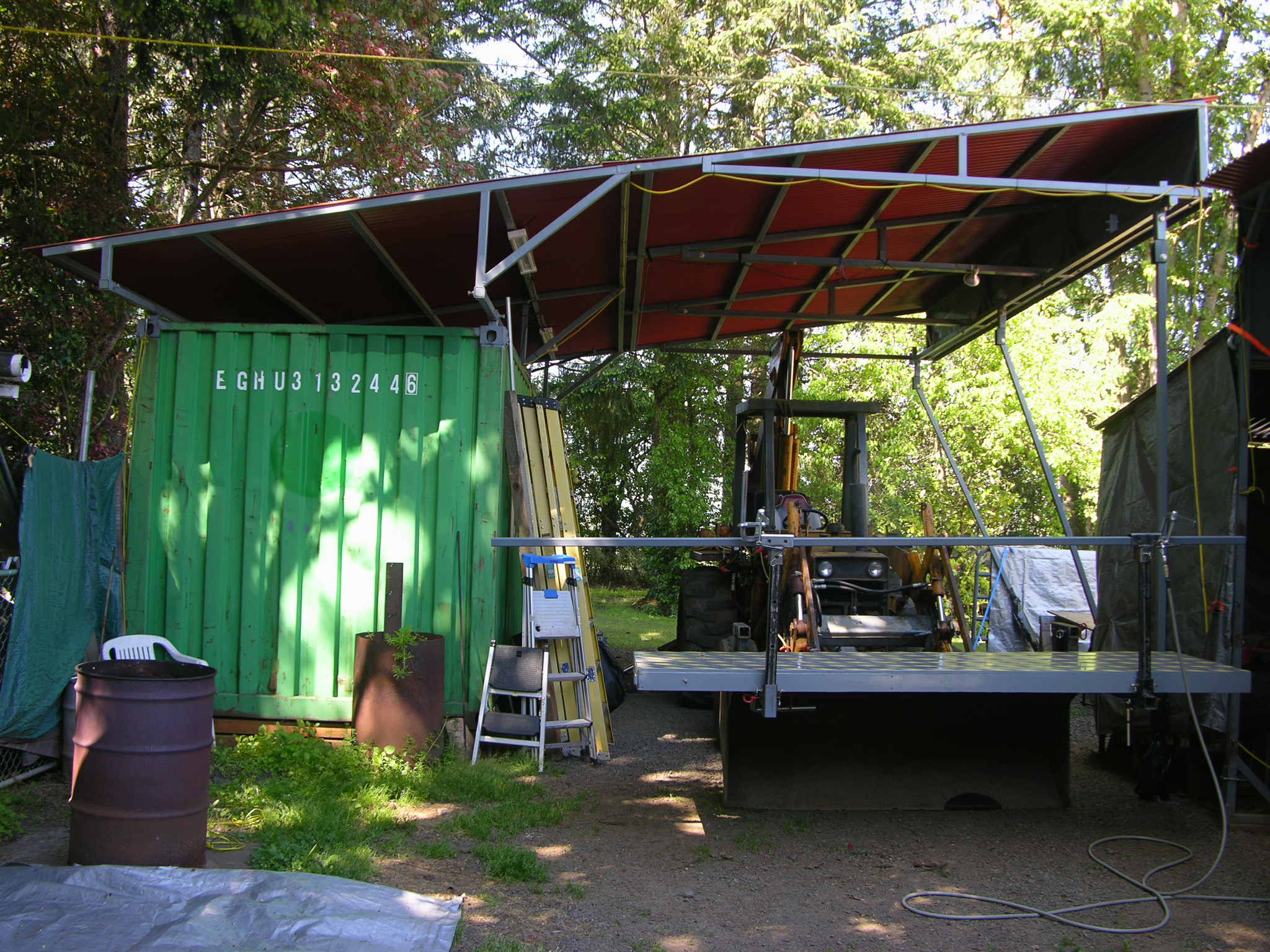

Here's a volunteer prune tree that committed suicide in my neighbor's yard (high winds) while taking down the fence - medium length bars are used like a "bale spear", 45* adapters put 'em parallel to the bucket bottom - longer bars and strap for holding the trunk centered - picked the whole thing up and drove it to my burn pile, left a couple TWIGS in his yard; chainsaw sorted out "burn now, burn later" stuff...
Ready to fly a subassembly up for the roof over the 20' container -
And moving some pre-cut tubes for the outer half of same roof (built in 3 modules, each 8'x12') - weight woulda been too much without that chain/binder from the UPPER receiver -
Almost forgot your question - yeah, with all those adapters I can go high, low, straight out to the side, straight up, at 45* or 90* any direction, and (so far) with 3 different length choices; 30", 48" and 72". As you can see, I have grab hooks, slip hooks, shackles, clevis, pin hitch, trailer hitch for 1-7/8", 2", 2-5/16" (not shown here) - also got a couple of these
Hitch Cargo Carrier - 5 lb. Capacity
- got em when on sale for $39 - work pretty good for throwin' a bunch of stuff in a big cooler and pluggin' 'em into the bucket with a couple 45* adapters (so they sit level with the bottom of the bucket)
Then there's always the combo of the brush bucket AND 1 or 2 carriers - brush bucket needs 2 lower outside receivers/big hooks, which leaves 5 OTHER choices for carriers, hooks, etc -
Oh, the tinker toys ALSO let me pick up the entire "porta-shed" (12'x12', 11' tall, steel frame) and move it anywhere I have more than a 12' wide path - haven't done THAT yet, but it's comin' eventually...
In short (I know, too late fer that :rolleyes:) if I can't do it with that stuff I probably SHOULDN'T :D ...Steve

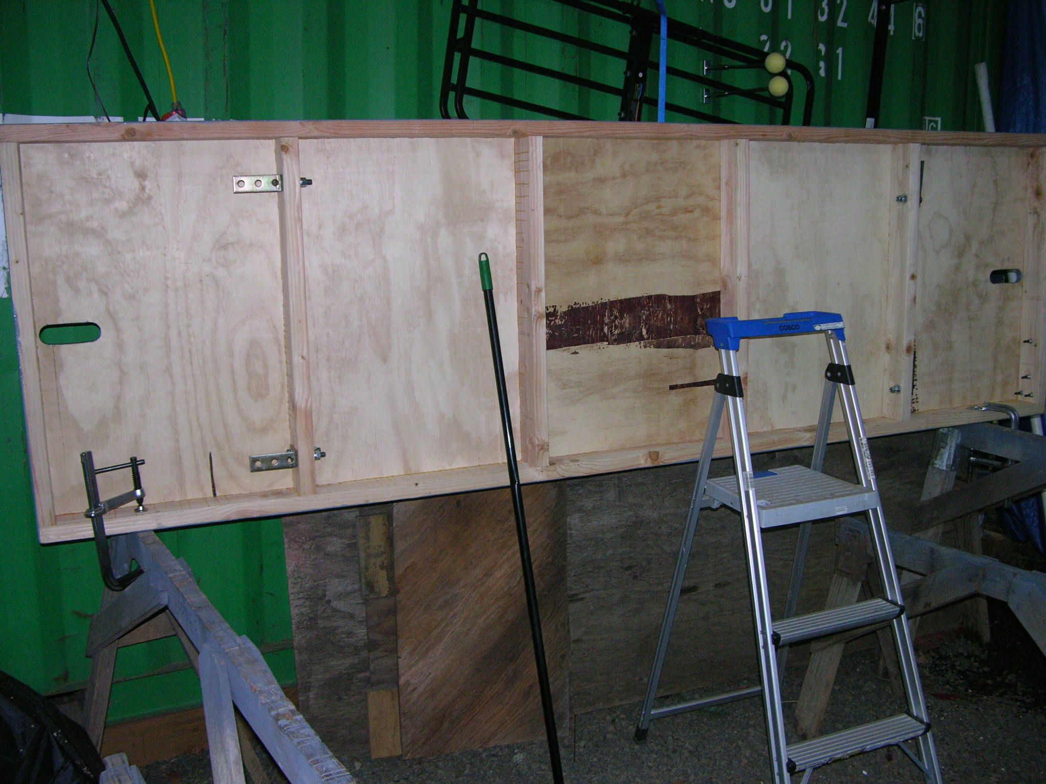

Except for these -
3/4 A/C ply/2x4 frame, all joints glued and screwed, 3 coats machine grey enamel, carry holes both ends, optional detachable "wheel barrow wheel",(not shown) and mucho non-skid tape; dim's are 3' x 10'. Metal pieces shown are a SMALL part of a Unistrut stash off CL - about $1200 worth for $100, most was NEW (moving sale)
In use as a work bench -
Sitting on the tinker toys -
Locked in place -
Needed a sun hat and some tools -

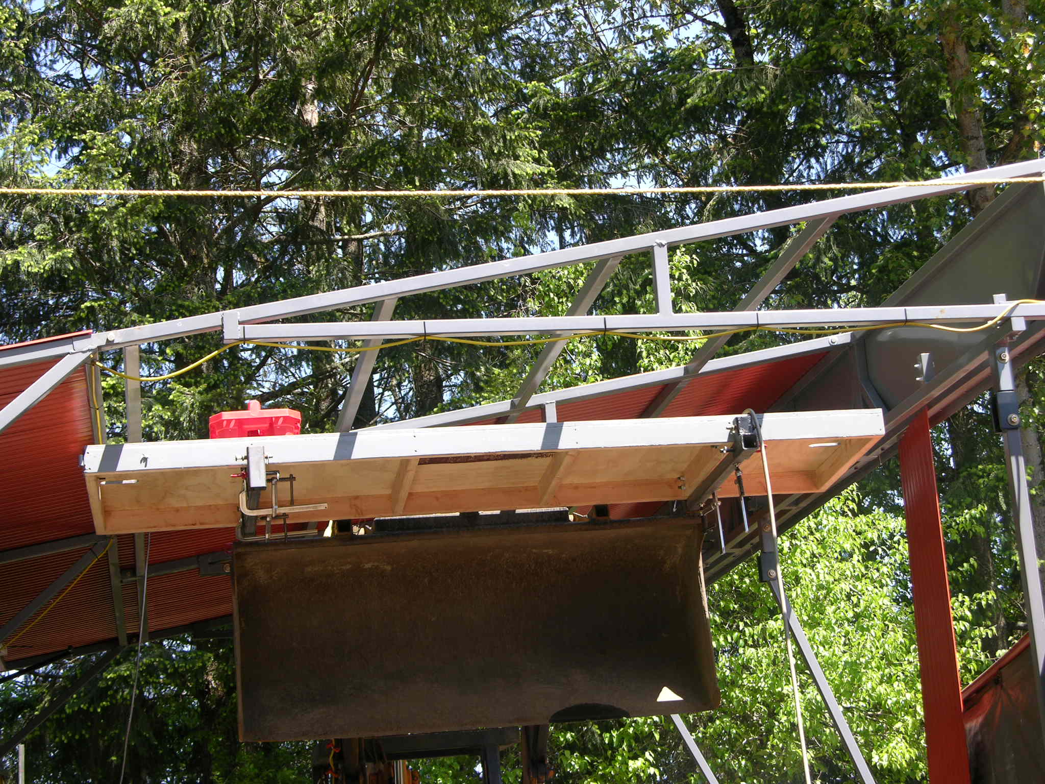

#215
Using the "super plank" withOUT a rail let me stand between frame members and put my full weight on the self-drilling screws (going into .120" wall steel tube), WITHOUT the irritating side effect of my ARMS falling off :eek:
And the temporary rail (NOT in the way for the LAST piece of roofing) -
Container roof done -

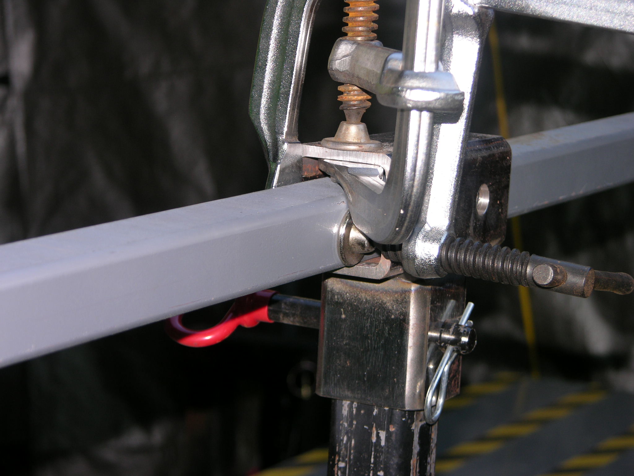

And the "wobble fix", for when you don't have a 10' long piece of 2" tube handy (but DO have a 12' piece of 1-1/2" :D
Oops, sorry; guess ya DIDN'T get me after all (but keep tryin'; when ya DO, it's BOUND to be somethin' I SHOULDA done :thumbsup:) ...Steve

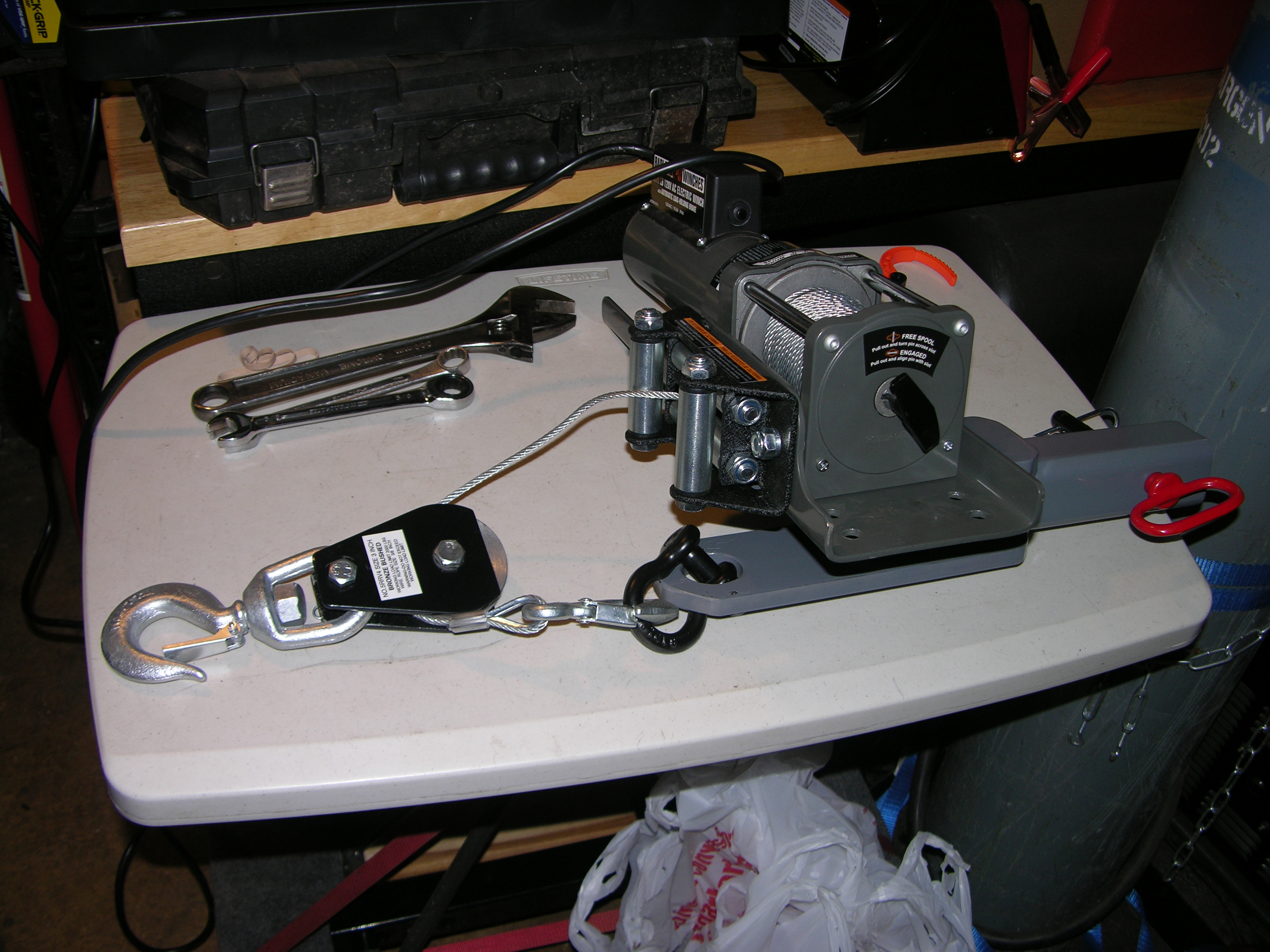

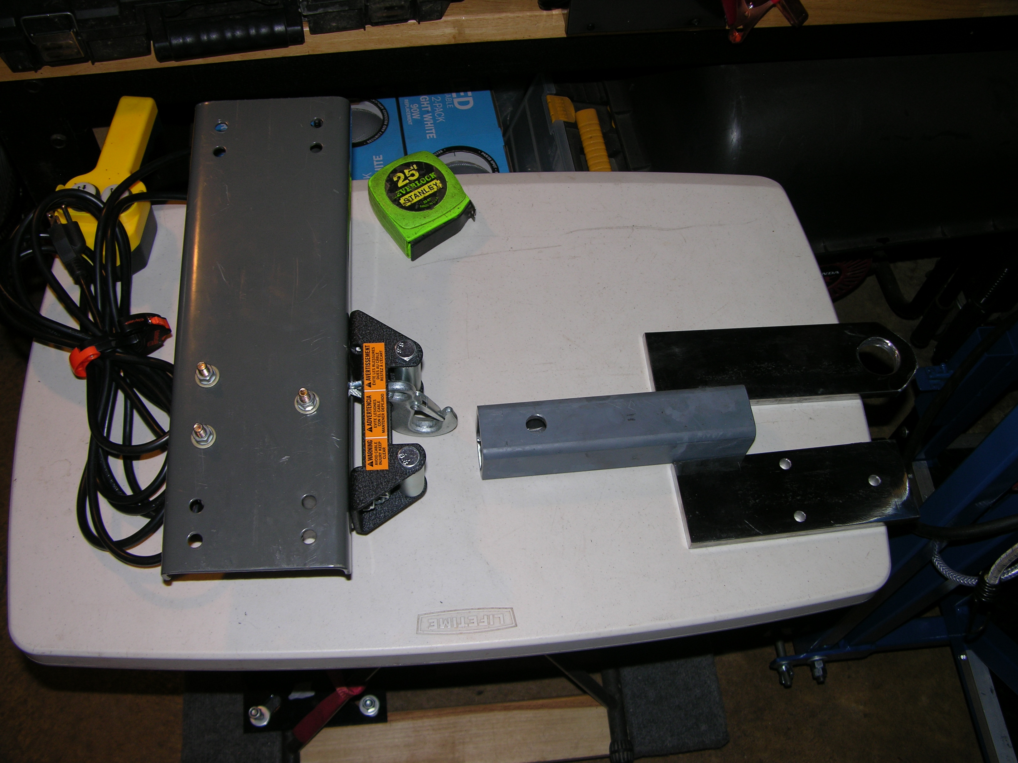

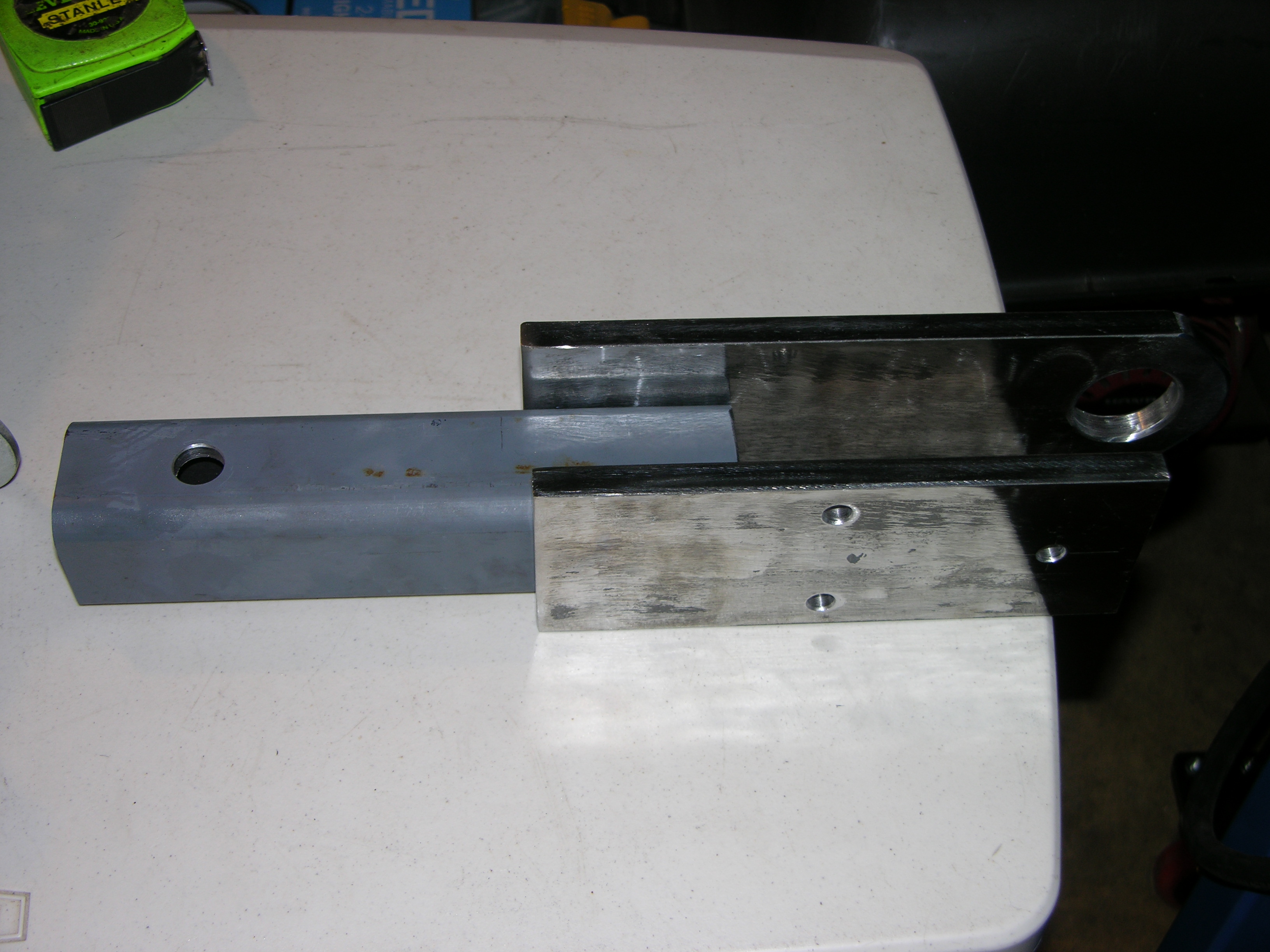

Added a small winch to Tinker Toy pile...
I've had one of HF's 120 volt/1500 lb. rated winches for a while now, got it for a "universal little stuff mover" - but it was usually a PITA to jury-rig a way to HOLD it without resorting to MORE tinker toys, weld clamps, etc, so I ended up doin' more than I should WITHOUT it...
The winch - 15 lb. Capacity 12 Volt AC Electric Winch
Note that it does NOT come with a base, so the marginal, NON-roller "fairlead" has no place to mount :rolleyes: HF must've discontinued the base I bought at the time, now they only offer an "ATV" version, smaller than mine but same mounting holes...
I wasn't impressed with a non-roller "slot" for the cable to rub on every time you used it, so I found a ROLLER version @ Amazon
Amazon.com: Champion Wire Rope Roller Fairlead for 35-lb. or Less ATV/UTV Winches: Automotive I couldn't possibly cobble one up for less than $9, ain't gonna TRY :rolleyes:

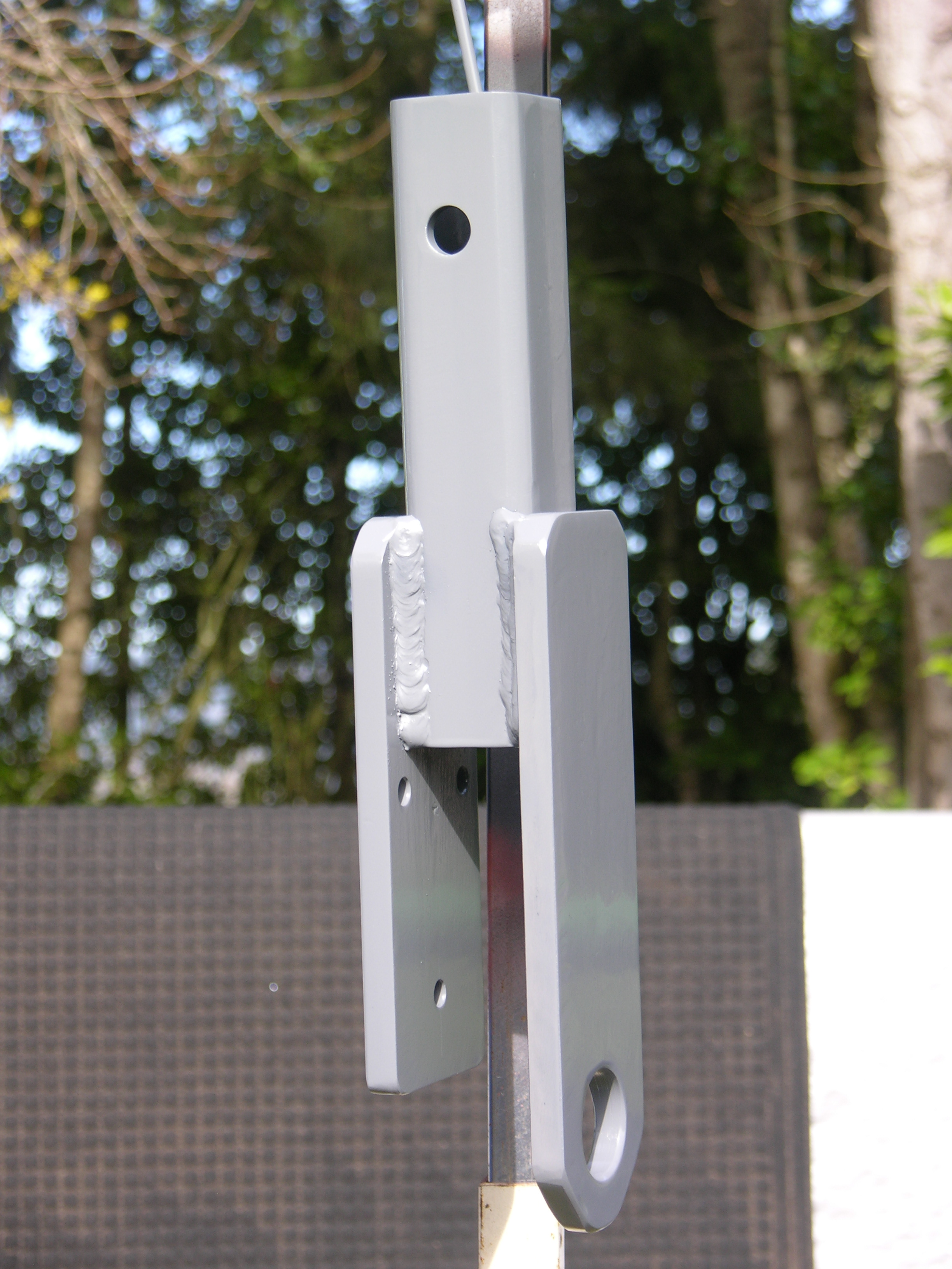

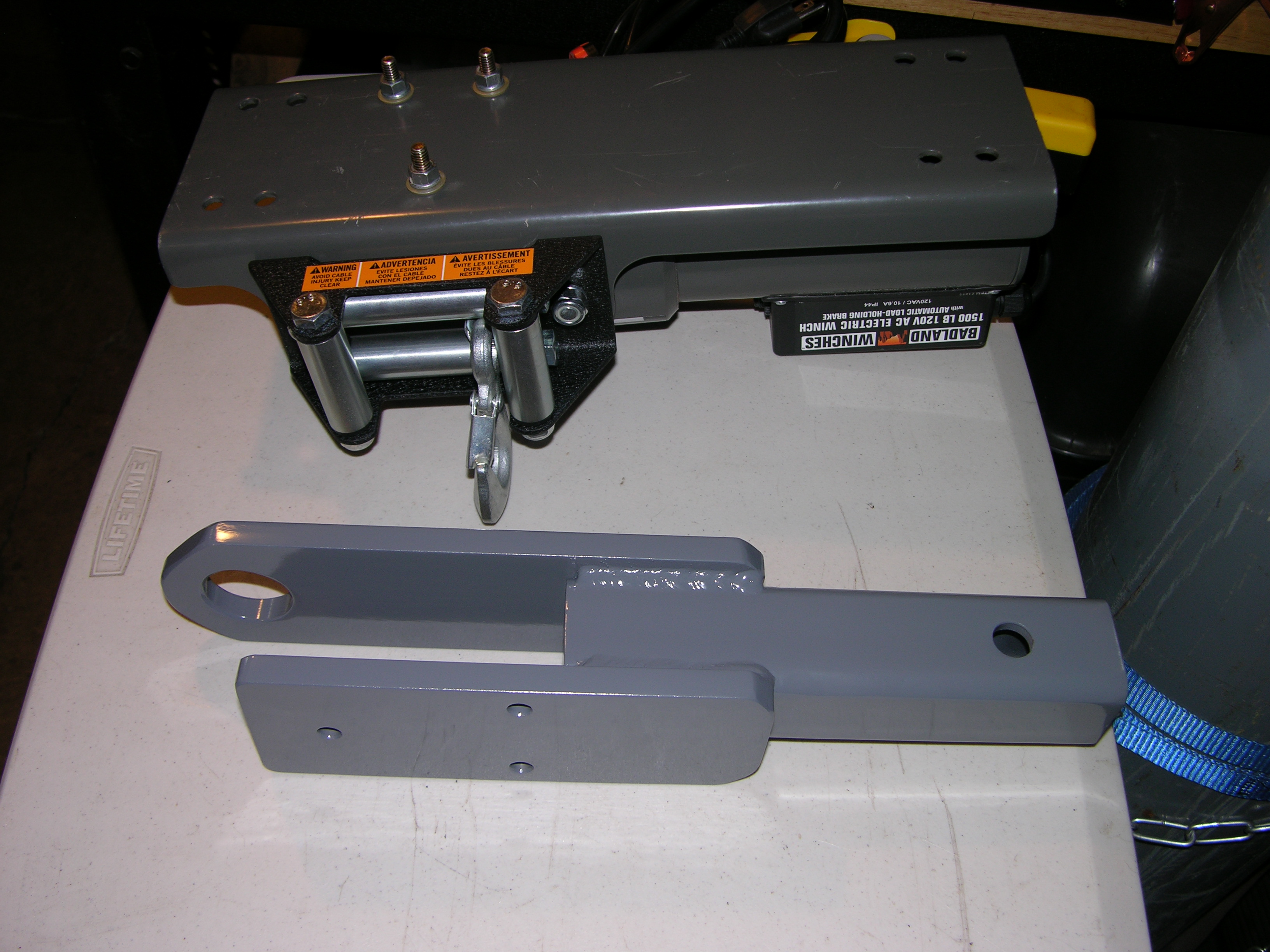

Yesterday I finally came up with a decent "tinker toy" for the winch - 2 pieces of 1/2"x3" FB (3/8" woulda been enough, didn't HAVE any wider than 2", needed 3" minimum) and a 10" piece of 2x2x1/4" wall tubing - The pieces -
Note the big hole in ONE of the pieces of FB - it's for double-line operation. HF wanted almost as much for a snatch block with a 2" diameter pulley as Amazon wanted for a 3" one, and I don't like small radius pulleys (too much "stress reversal" will cause ropes/cables to fail prematurely) so ordered this
Industrial Grade 5RRV4 Snatch Block, Swivel Hook, 3/8 in, 2 lb: Amazon.com: Industrial & Scientific
Which should be here in a couple days...
So I glued the pieces together -
Slathered some paint on it -
Stuck a fork in it (oops, I meant stuck a PIN in it :D) - sure 'nuf, it's done...
Now anywhere I have a 2" receiver (like the 7 on the 580B's loader bucket or the one on the back of my van) or anywhere I can CLAMP or WELD one, I can have up to 3000# (double line) to move stuff. Pretty sure this'll be a useful addition to the Tinker Toy Set... Steve
Oh, forgot to mention - my little 2kW euro style genny runs the winch AND the 2 electric chain saws just fine, and comfortably fits in the 2' hoe bucket - I keep a 25' #12 extension cord cable tied to the hydraulic hoses, so I have power at the loader bucket just by setting the genny in the hoe bucket, plugging it into the cord and starting it - on hot days I put the brush bucket on and add a 20" fan, it's nice to bring your OWN cool breeze to the party :thumbsup::D:thumbsup:

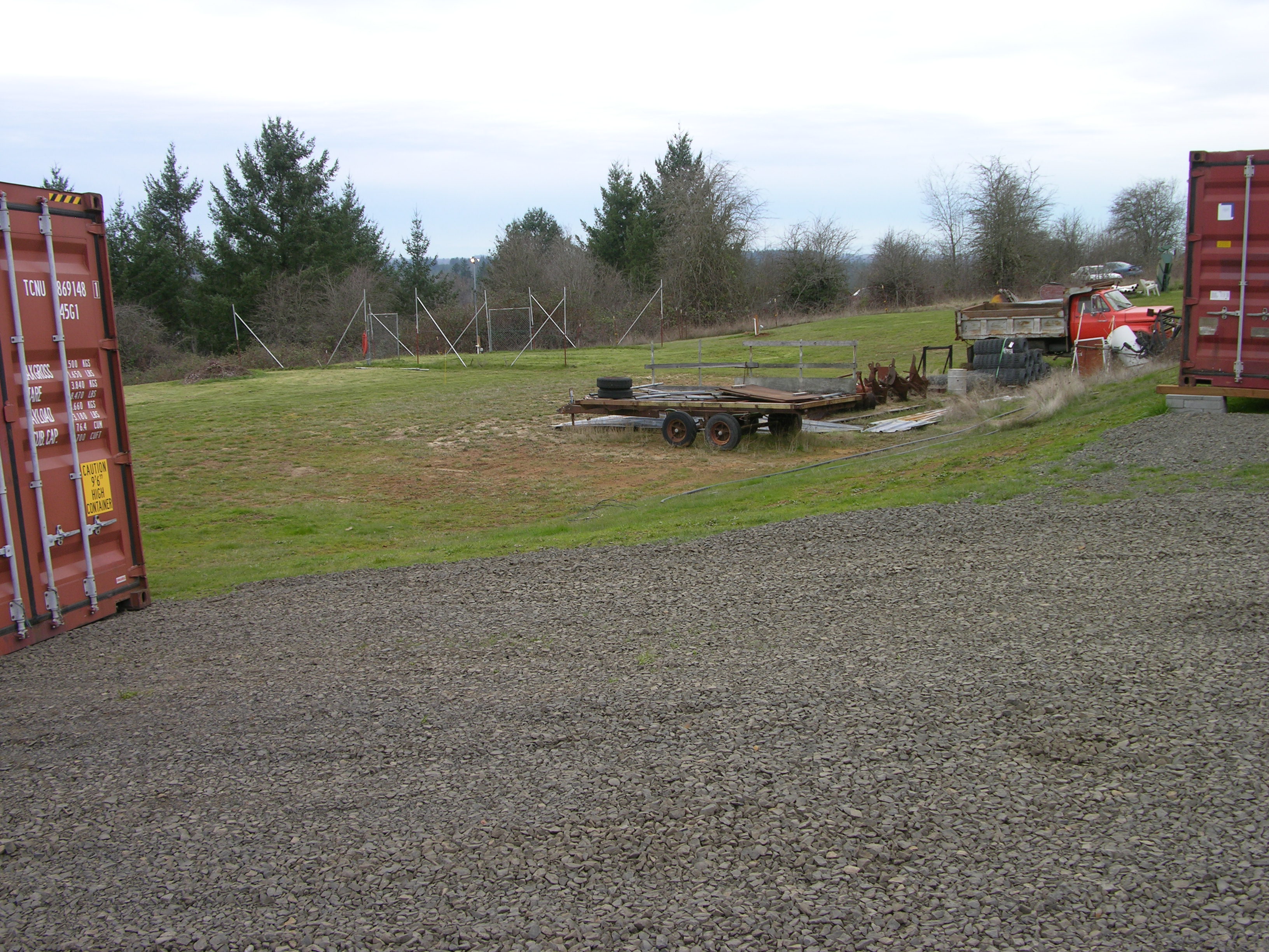

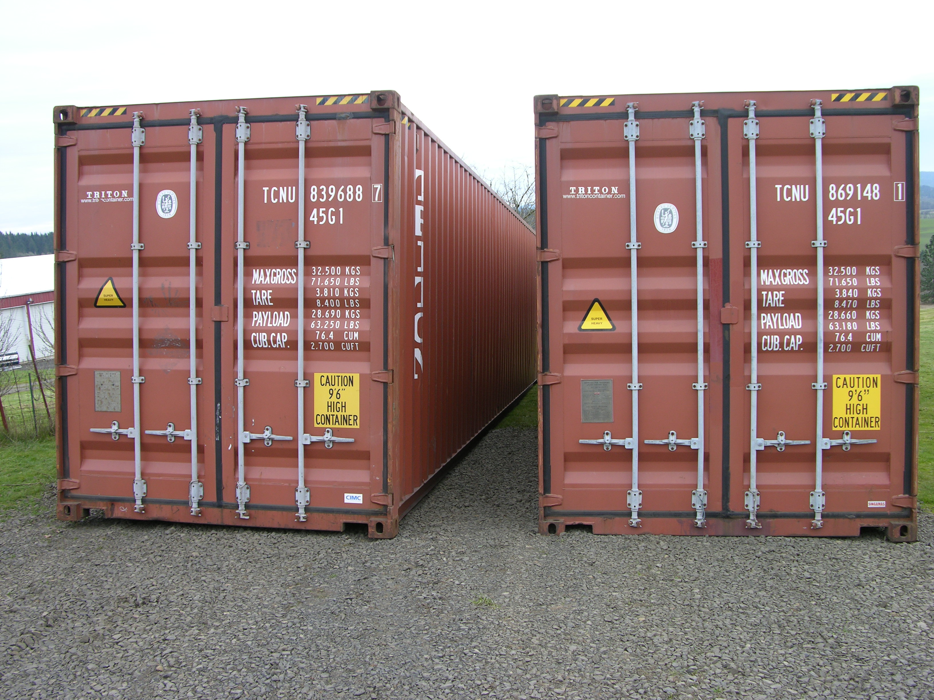

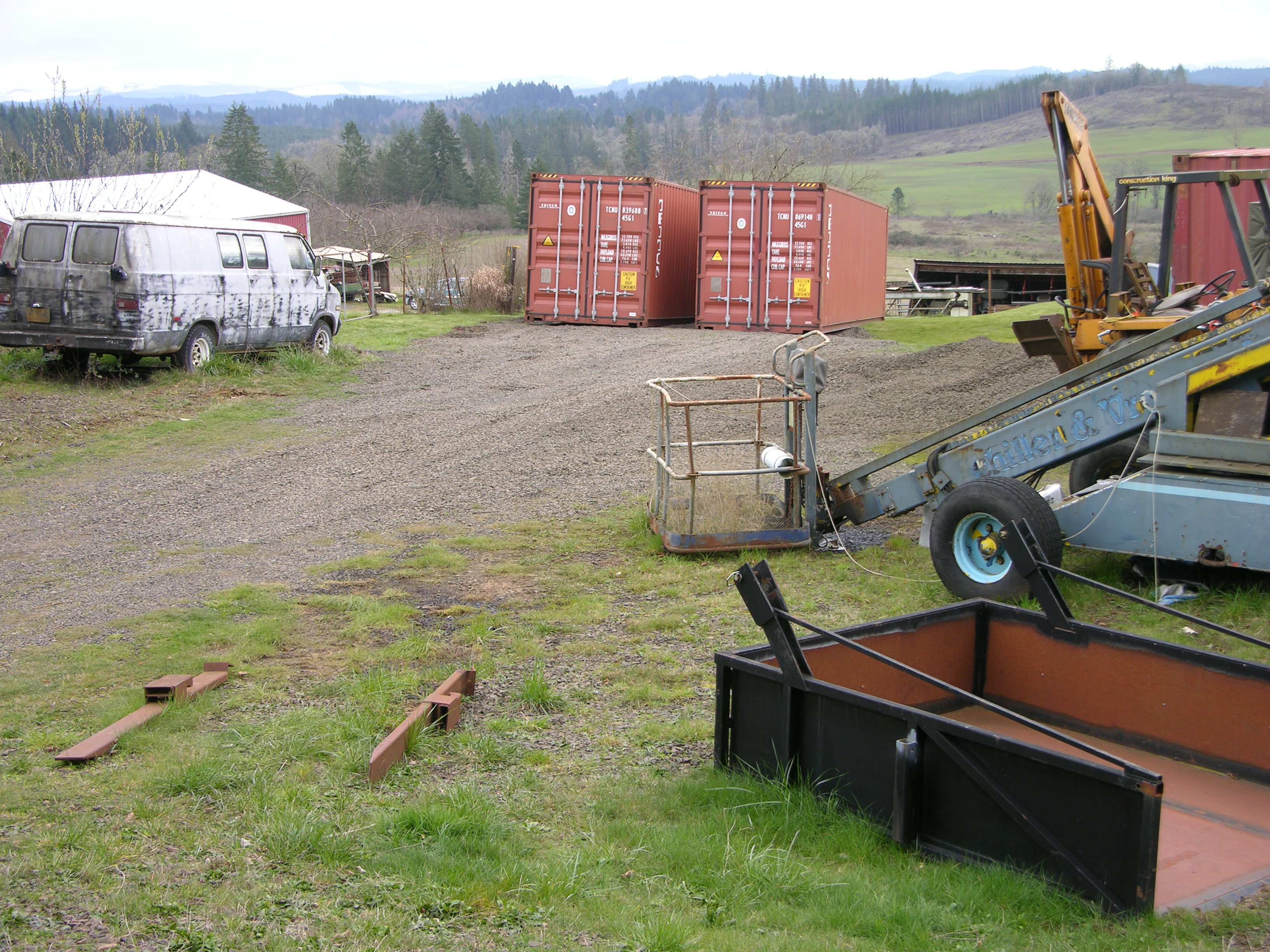

But I was already up by 7am (after gettin' to bed around 1am) 'cause THESE showed up about the time they were supposed to LEAVE PORTLAND (Oregon, that is, I know Maine has one too) - Our Portland's about a 2 hour drive...
They're not quite level yet :D
And they WON'T be, til about June when it's dry enough to move 'em HERE -

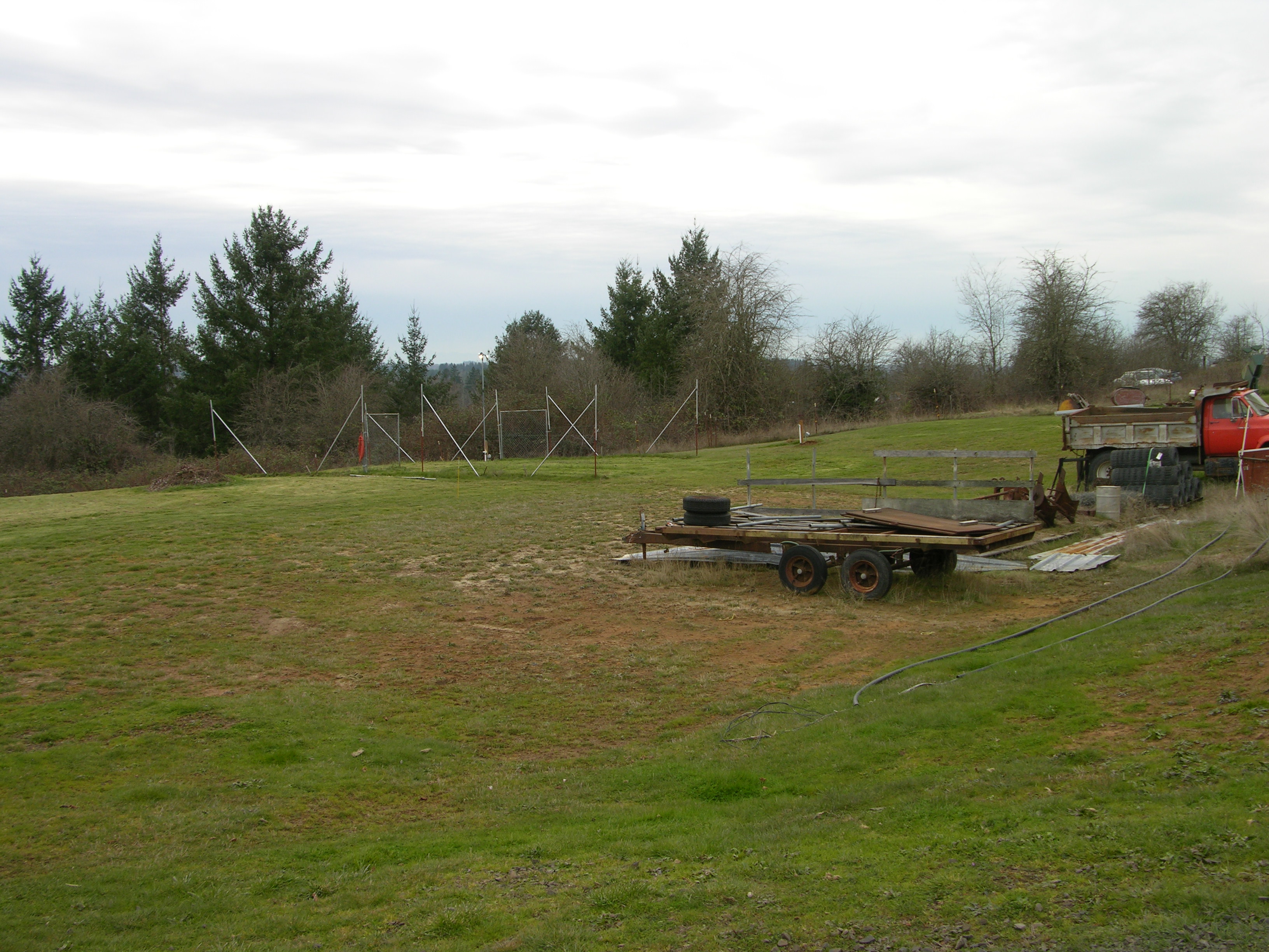

One will go down at the base of that slope (where all those "projects" are sitting now), even with (and parallel to) the weld shop container (that's the one at the right side of the first pic) - the SECOND container will go even with (and parallel to) the FIRST one, but 40 feet away - then, as funds allow, a 40x40x 5 inch slab over 6" of compacted crushed rock will go BETWEEN the containers, and a 60x60 "arena" around the whole thing - that'll give me enough room to work on (and hopefully SURVIVE) all those "projects" you see in the pics, such as -
The orange dump truck runs but needs a bunch of little stuff done, the 50 foot boom lift needs a little work on the Wisconsin V4 and a couple cylinders rebuilt and a couple tires (ouch), the 25 foot scissor lift needs batteries (ouch again, might try a "rejuve kit" first), the 580B needs about 7 more cylinders rebuilt + some new bushings, torque converter, brakes, etc, both other tractors need odds and ends, and "Mrs. Bukit" has been VERY patiently waiting for a complete house remodel - THAT can at least get STARTED once I get enough "clutter" (I call it "inventory" :rolleyes:) out of the garage, bedrooms, front porch, etc, so there's enough elbow room in our 1000 SF house to MOVE...
BTW, yes- there IS a good reason for gettin' those containers NOW, even tho they won't get moved/used for a few months - ones in that good a shape are gettin' hard to find and/or near new price - got these hi-cubes for $3k each, and they're still better than sea-worthy; doors and seals are perfect -
