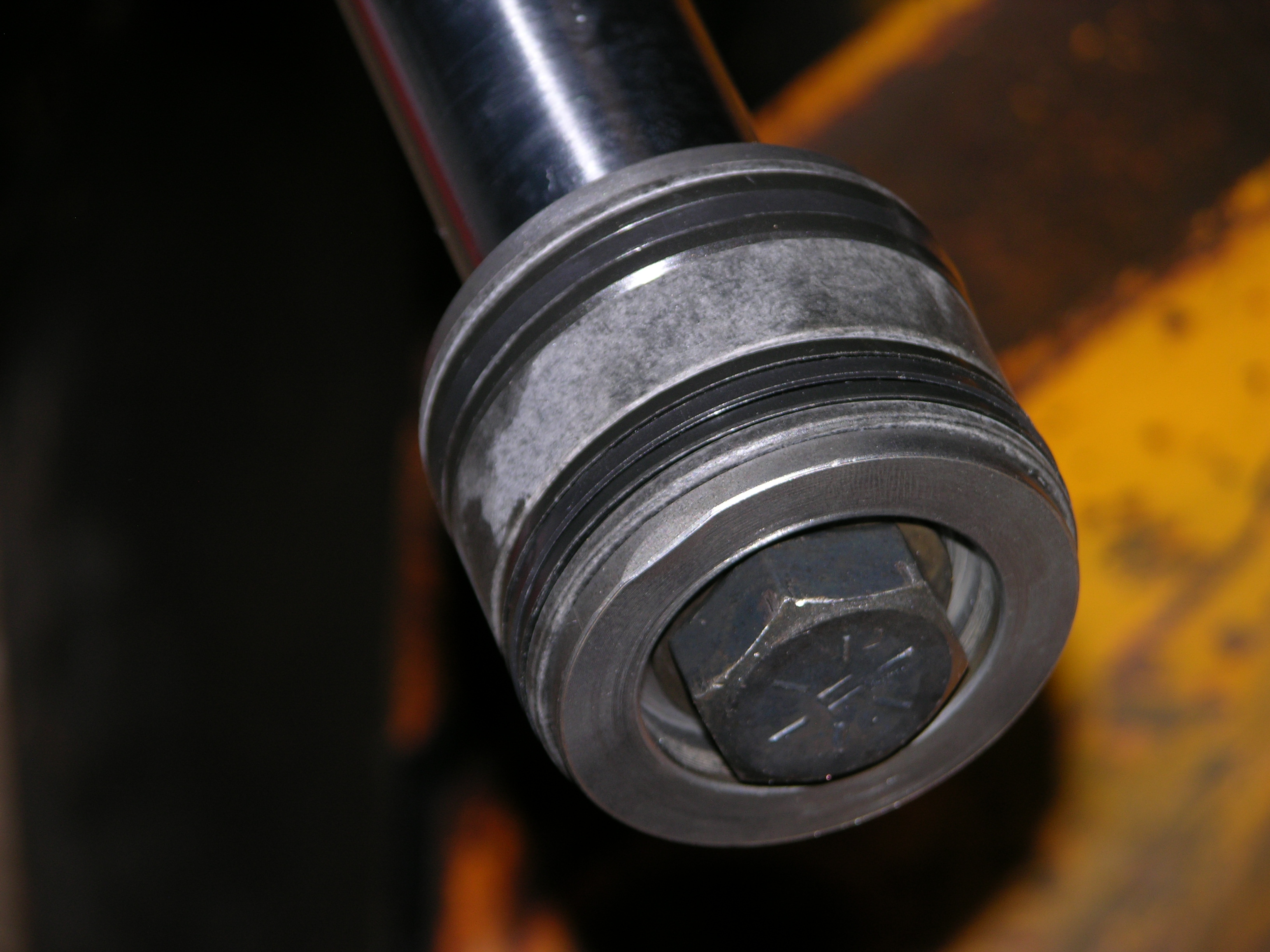

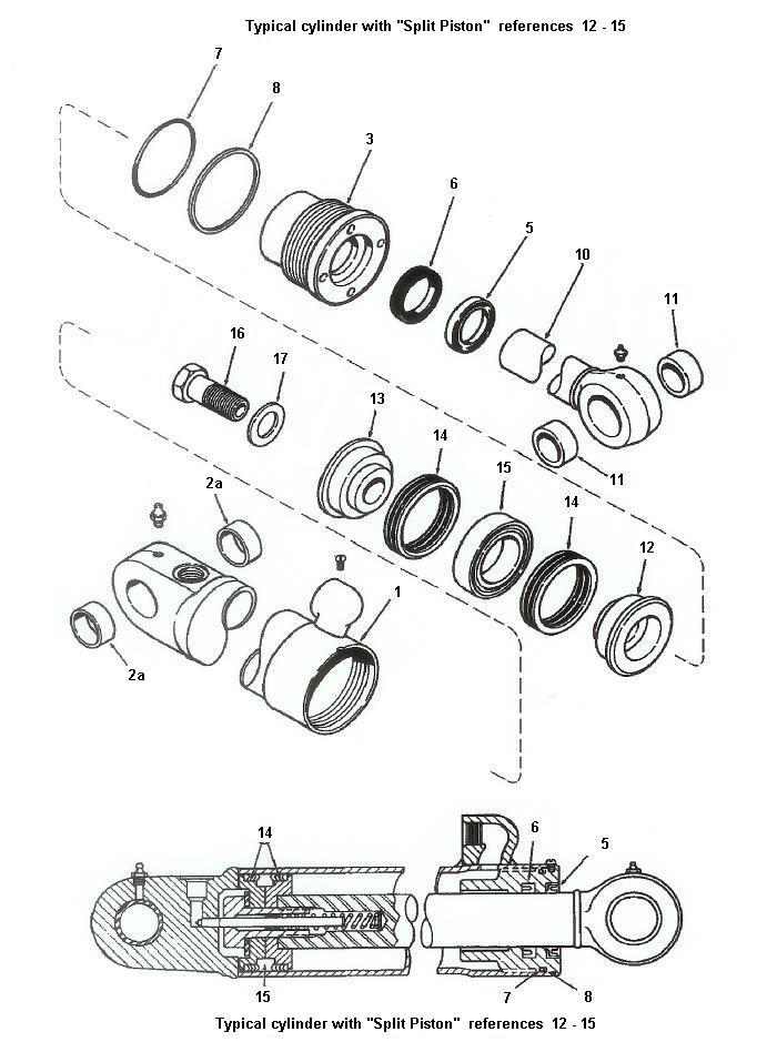

Here's a pic from the brush bucket build, and a marked up version -
Clear as mud, right??!? Steve
Oops, forgot your last question;

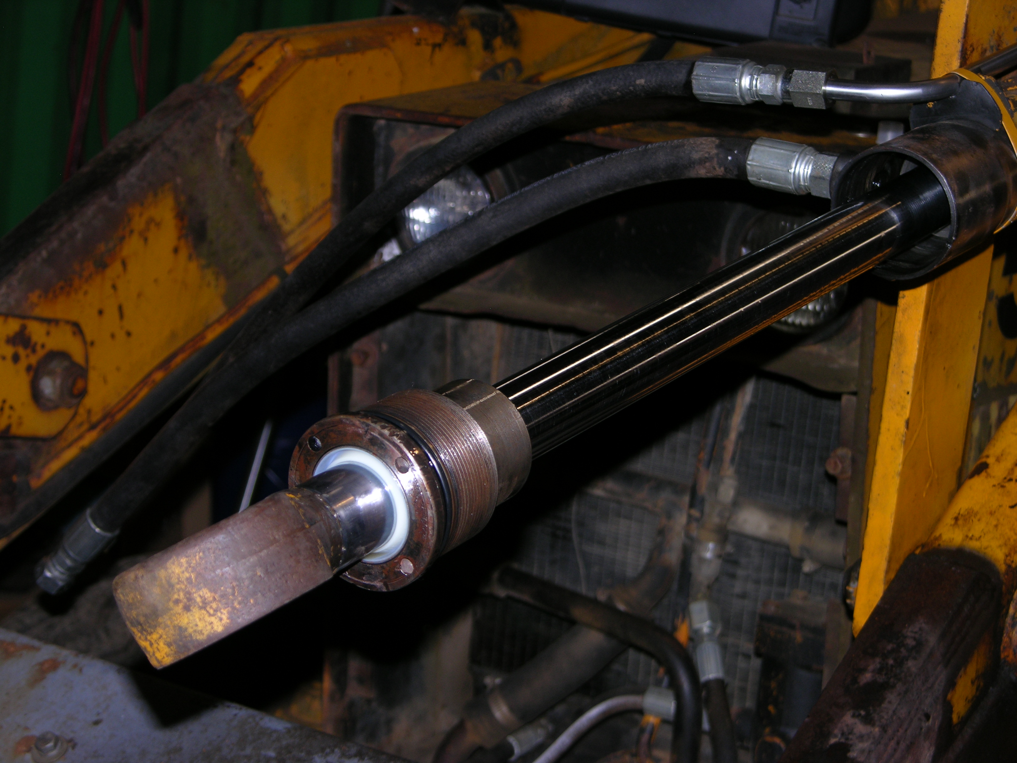

"The last picture is the rod with seals on the end, how do they come off, I'm assuming you're going to change everything?"
Yup, the gland has an external wiper seal, an internal wiper couple O rings and a "slider" thingy - the piston on these older cases is a split (2 piece) with a center piece and several "squished together" seals on both sides, with 2 recessed washers surrounding those. 1-1/8" fine thread bolt goes in the back of the rod (the straight end), and everything goes back on the rod and that bolt torqued to 450 lbs, THEN it gets shoved back into the barrel, tighten up the gland, put a new lock screw between gland and cylinder body (barrel) - here's an exploded view; #5 is the EXTERNAL wiper, 6 is the INTERNAL wiper/pressure seal, 3 is the gland, #8 and 7 are the O ring and backing ring that go right behind the outer face of the gland - Then # 12 and 13 are the "squishing washers" (NOT part of a kit), 14 and 15 are part of the kit, and 16 and 17 are the 450 lb. bolt/washer.
The outer end (gland nut end) is belled out, and the previous cylinders I did I wrapped the rod seals with some thin aluminum flashing til they started into the bell; worked well. You still need a heavy comealong or something to force things back together, and a good slather of hyd. oil if you actually want it to MOVE :rolleyes: Hope that helps... Steve
Oh, BTW - that gland nut is an absolute ***** to clean out after the "hot wrench" treatment, but so's LIFE :eek:

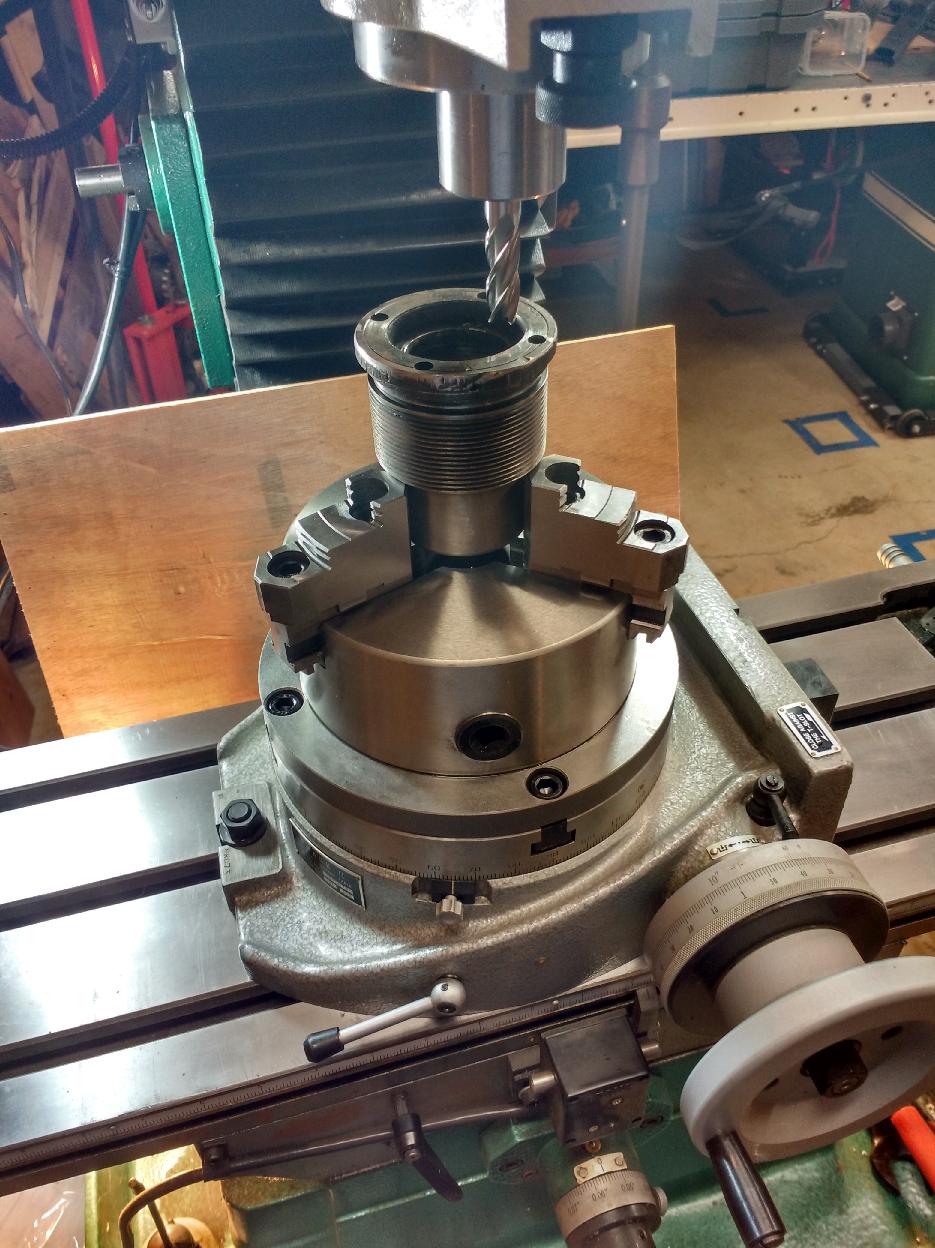

I knew when I bought my mill that it'd be awhile til I had either room OR $$$$ for a lathe, so some of the tooling I bought with the mill included an 8" rotary table, an 8" to 6" adapter/backing plate, and a 6" 3-jaw chuck - one use I considered (but haven't done yet) is to mill a curved (radial) slot for position adjusting on levers - you would drill a center hole and mill a radiused slot in a plate, then drill 2 holes in the lever - one hole would be the center pivot, the other could have (for example) a wing nut on a carriage bolt so you could loosen the wing nut, move the lever where you wanted it and tighten the wing nut...
Since the afore-mentioned lathe STILL hasn't happened (for the reasons mentioned) today I used the rotary table/chuck to clean up the outer seal pocket in the gland nut of the cylinder I'm working on - There were a couple of rough spots due to removing the old seal's steel cup with a cold chisel :eek:
centering was a bit tricky, but I got it close and went slow; result wasn't perfect, but good enough the seal should stay put and not leak; therefore it's good enough :rolleyes:
The setup - RoTblSetup.JPG - That big handle on the rotary table turns the table 4 degrees per handle rotation - A lesson immediately learned was that I should have moved the main table so the cutter was on the LEFT side of the pocket, or turned the rotation crank the OPPOSITE direction to avoid "climb" cutting :rolleyes:
Next comes the maiden voyage of the "twisty-bendy seal putter-inner kit" - can't be any harder than the way I did it previousl, so I'm predicting a win :laughing: ...Steve

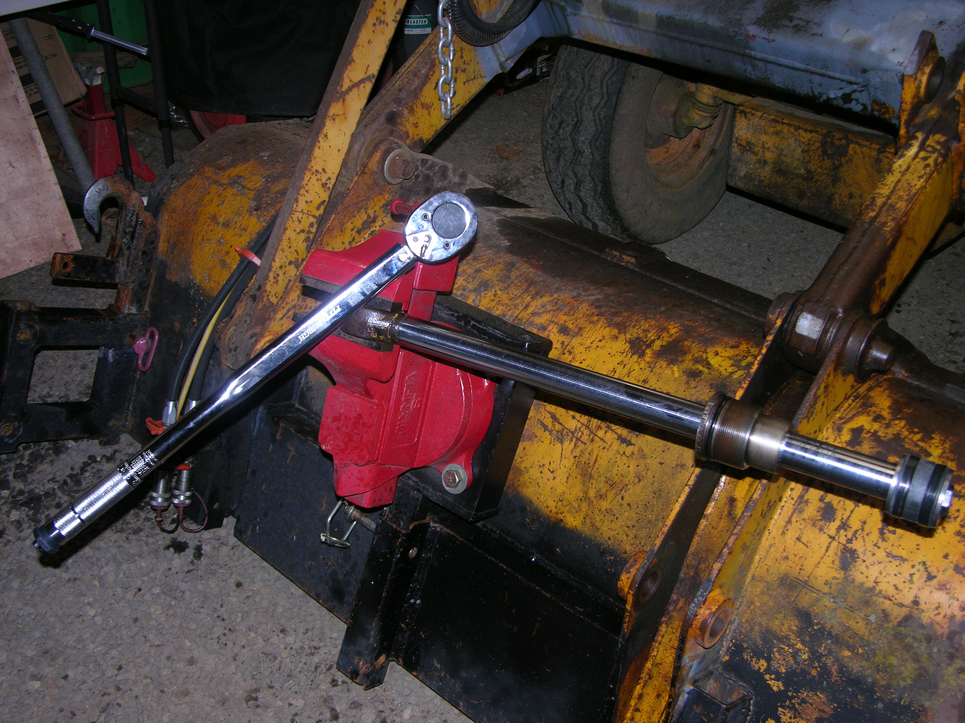

"you must have a 3/4 drive torque wrench?" Yup, got 1/4", 3/8", 1/2" and 3/4", but one (1" drive) that goes up to 1200# starts at around $1000 - $1600, a decent torque multiplier runs $3-500; so the 500# bolts will get rattled on with my 3/4 impact, and the 1000-1200# one will get introduced to the 1" drive impact. Close enough...
All gland nuts (100-200 ft lbs) will get tightened with the adjustable 3/4" drive spanner and 3/4" torque wrench...

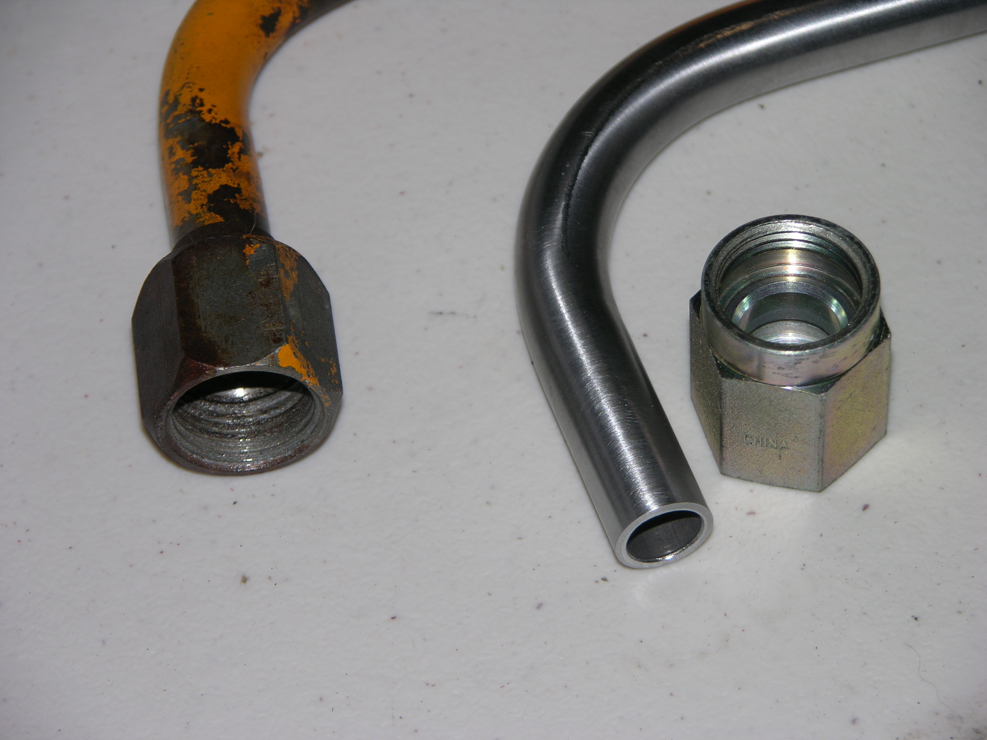

Got a little more done on the cylinder fix this afternoon -
All the relevant pieces, including the new steel tube that brings the rear port up next to the front port (including 2 "convert-a-flare" fittings - basically a swage fitting whose ferrule is shaped like a JIC flare - saves having to TIG a separate piece and/or flare the actual tubing - DSCN3273.JPG
The old and new tubes; nut on the old one didn't wanna come off, so replaced tube AND the ORB/JIC elbow at the rear of the cylinder - DSCN3274.JPG

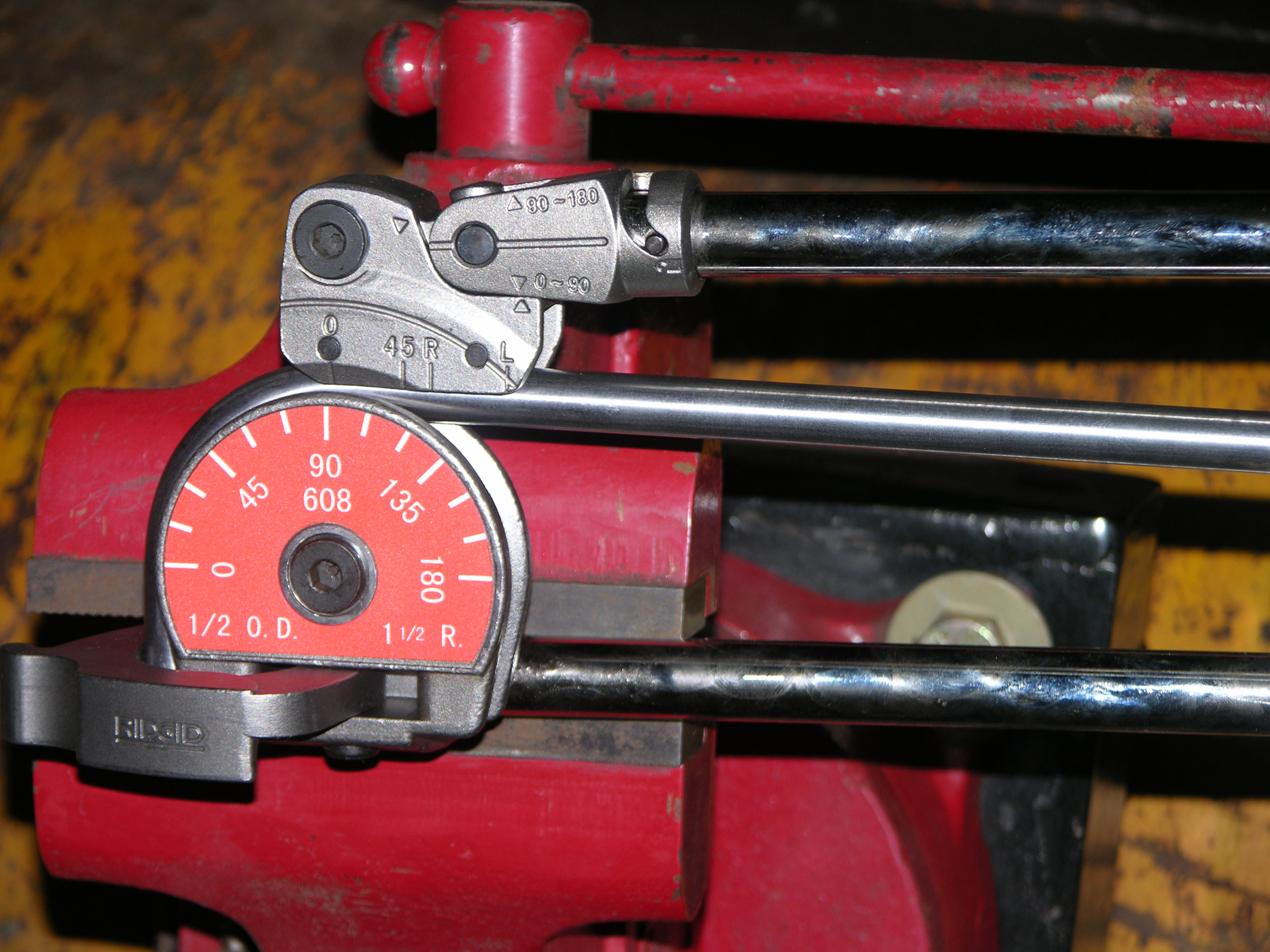

The new tube @ 90 degrees - different materials and thicknesses take a different amount of "over-bending" to get them to stay @ the angle you want; this one is 1/2" .050" wall IIRC, and it needed just over 3 degrees "over" to end up @ 90 - DSCN3275.JPG DSCN3276.JPG - For 1/2" steel and stainless tube, a roller type bender is MUCH easier and does a nicer job - this is the one I use
RIDGID 3848 Model 68 Heavy-Duty Pipe Bender, 1/2-inch Tubing Bender - Hand Tool Sets - Amazon.com
I might not have spent that much, but I have a LOT of projects coming up that will use 1/2" tube and some that want 3/4"...

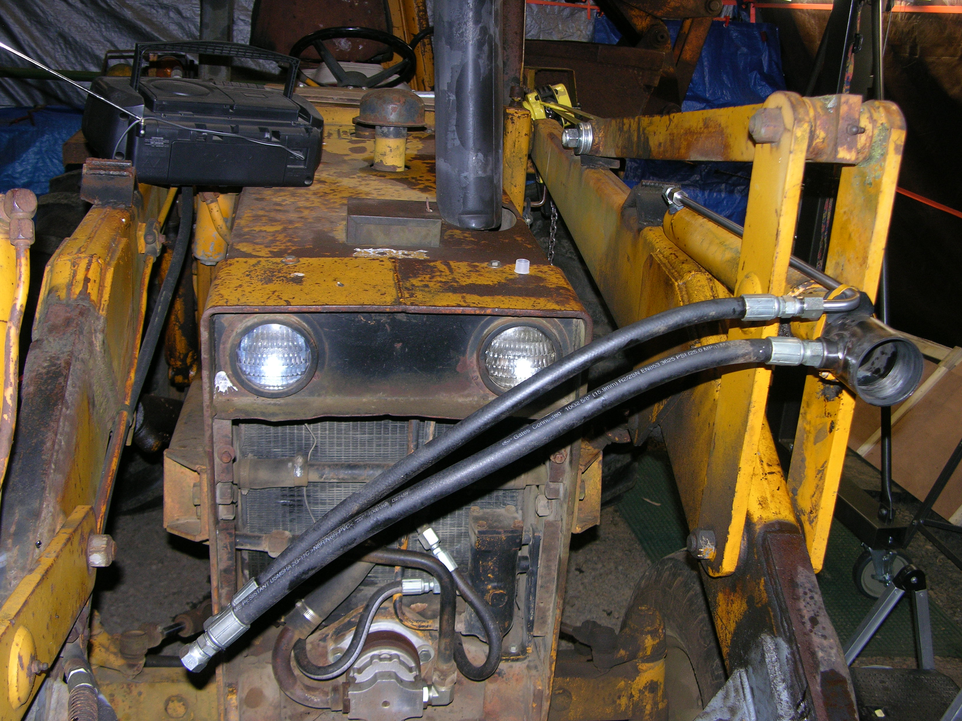

Got the crossover hoses (between the 2 curl cylinders) hooked up on one end - DSCN3278.JPG -
And this (the two JIC caps come off) is where they go, AFTER all the guts are back in the cylinder and the mechanical linkage is hooked back up - DSCN3279.JPG

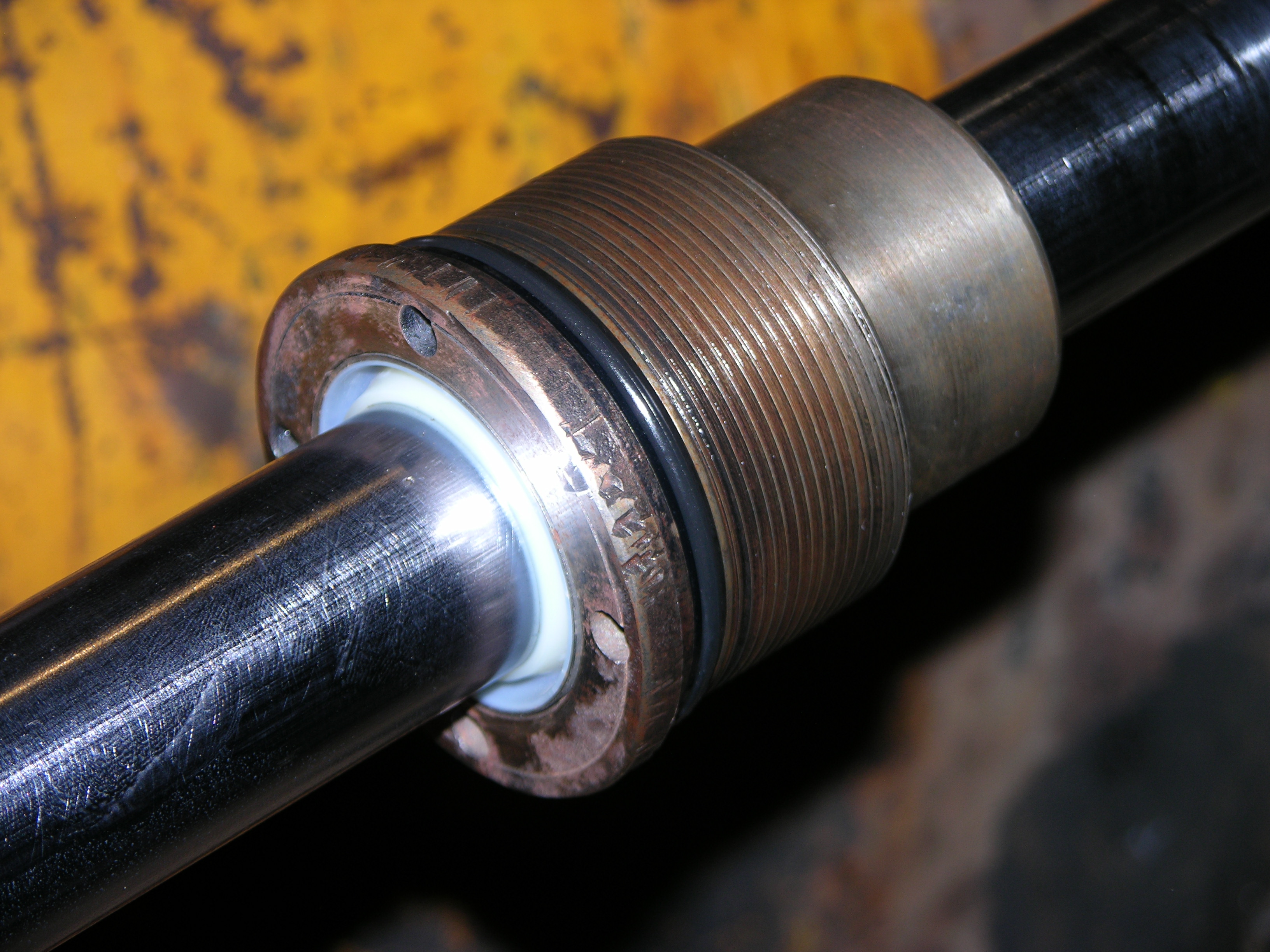

Gland nut, new outer wiper and front O rings showing - DSCN3281.JPG - BTW, that seal installation tool kit changed that operation from at least a half hour, down to about 30 SECONDS...

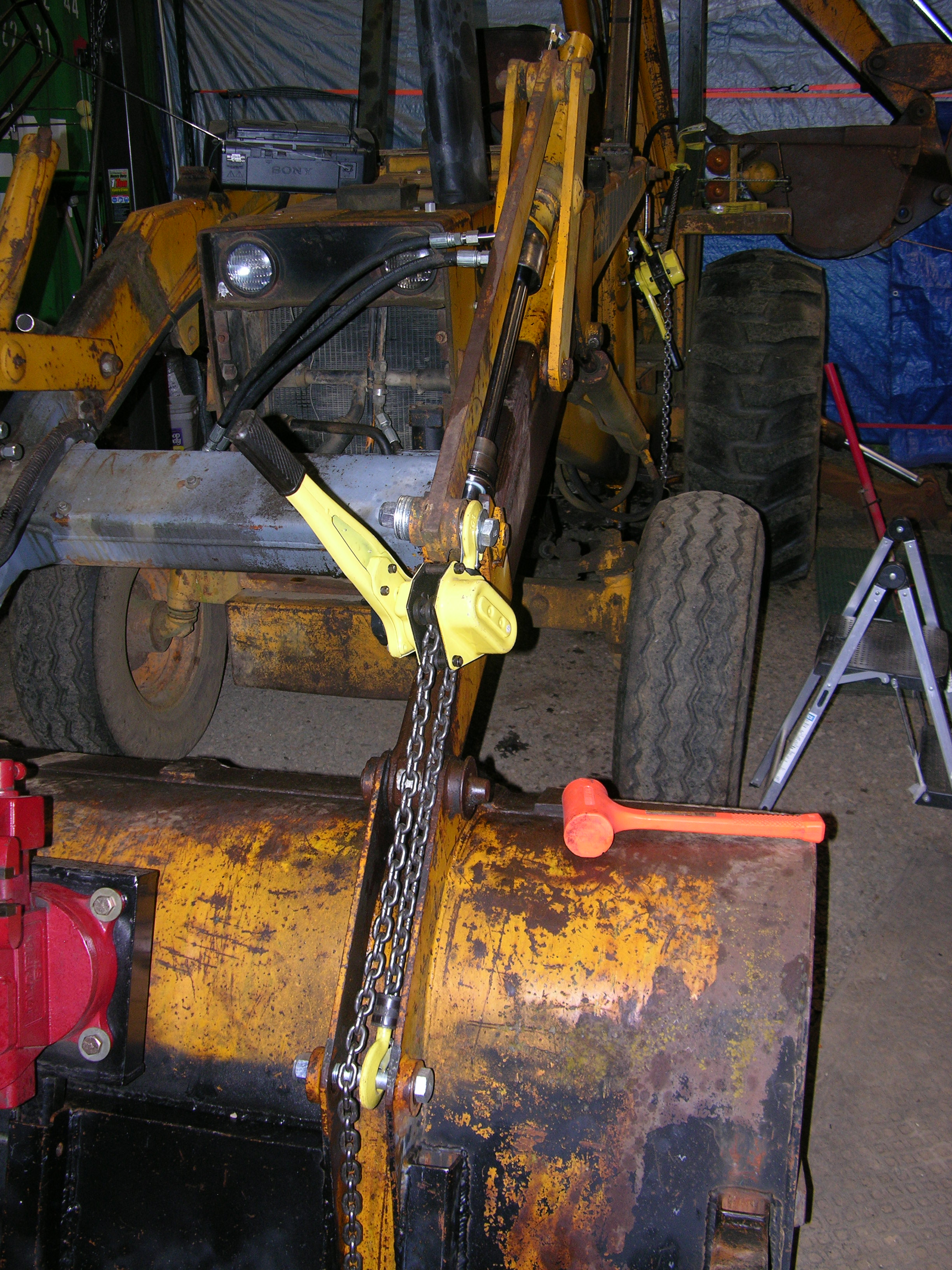

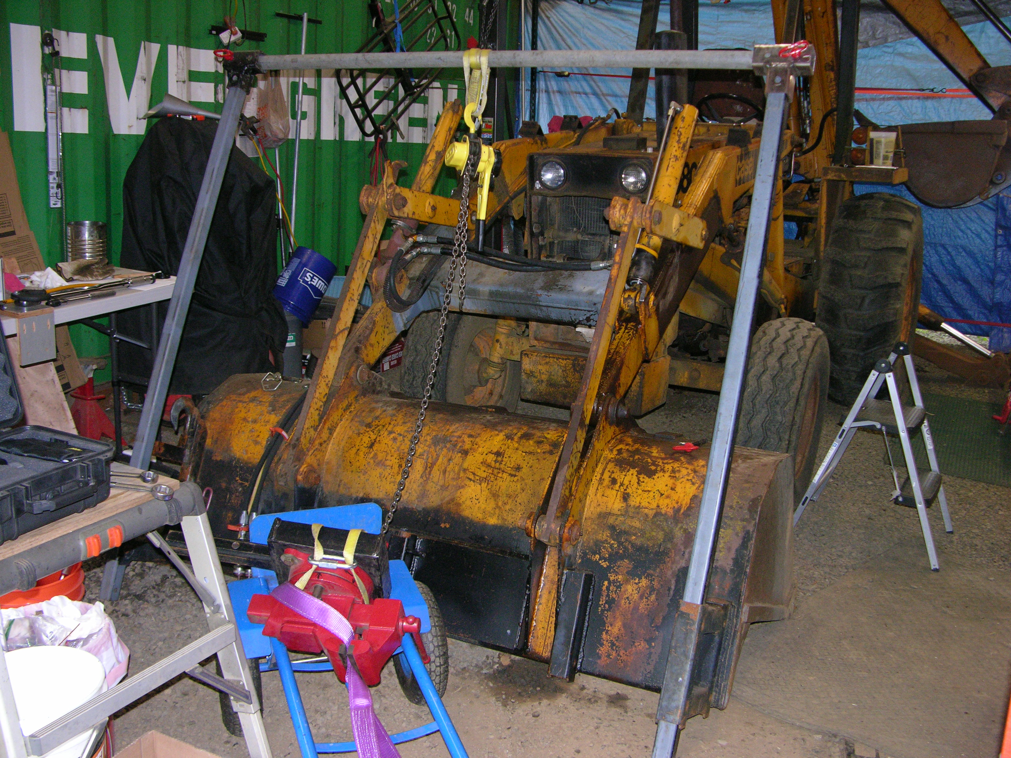

Rod went back into the cylinder barrel only as far as the belled out section, then got stubborn - DSCN3283.JPG -
So I got MORE stubborn, managed to tilt the cylinder bellcrank back far enough to get the pin end of the rod pinned into its location, then the comealong to force the bellcrank FORWARD, forcing the piston further into the barrel.
Tomorrow I'll remove the comealong and that long linkage bar; that'll give me room to slide the gland up to the cylinder barrel and get it screwed in and torqued - after that I can use the hydraulics to even things up and reconnect all the linkages without dumping fluid on the floor... Steve
/ Container Weld Shop build -
#338

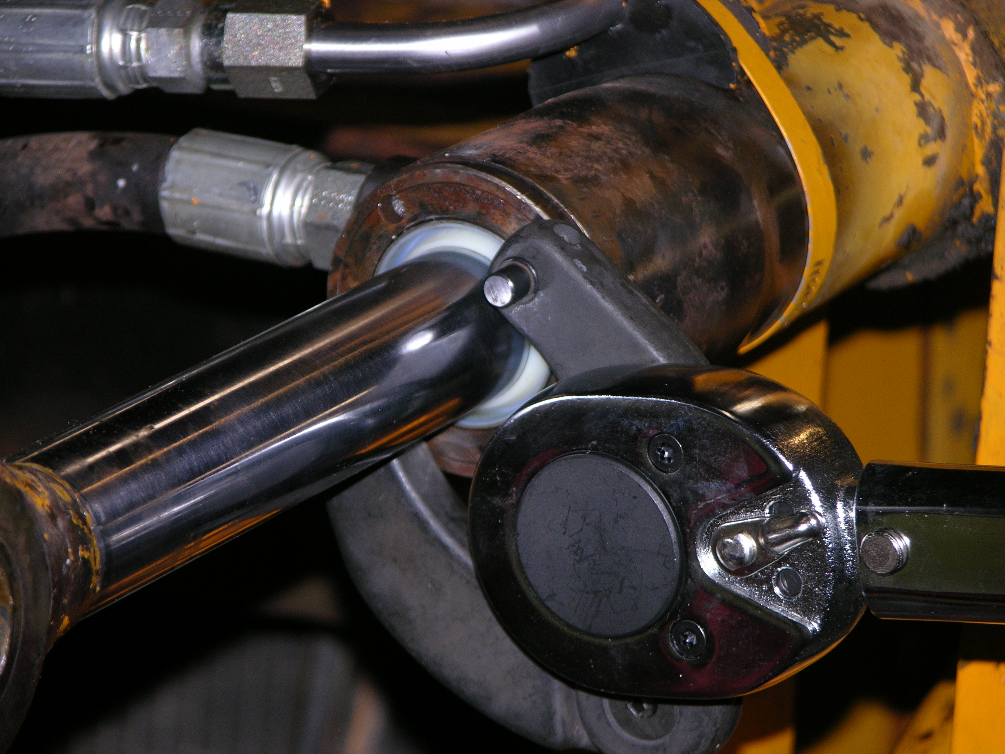

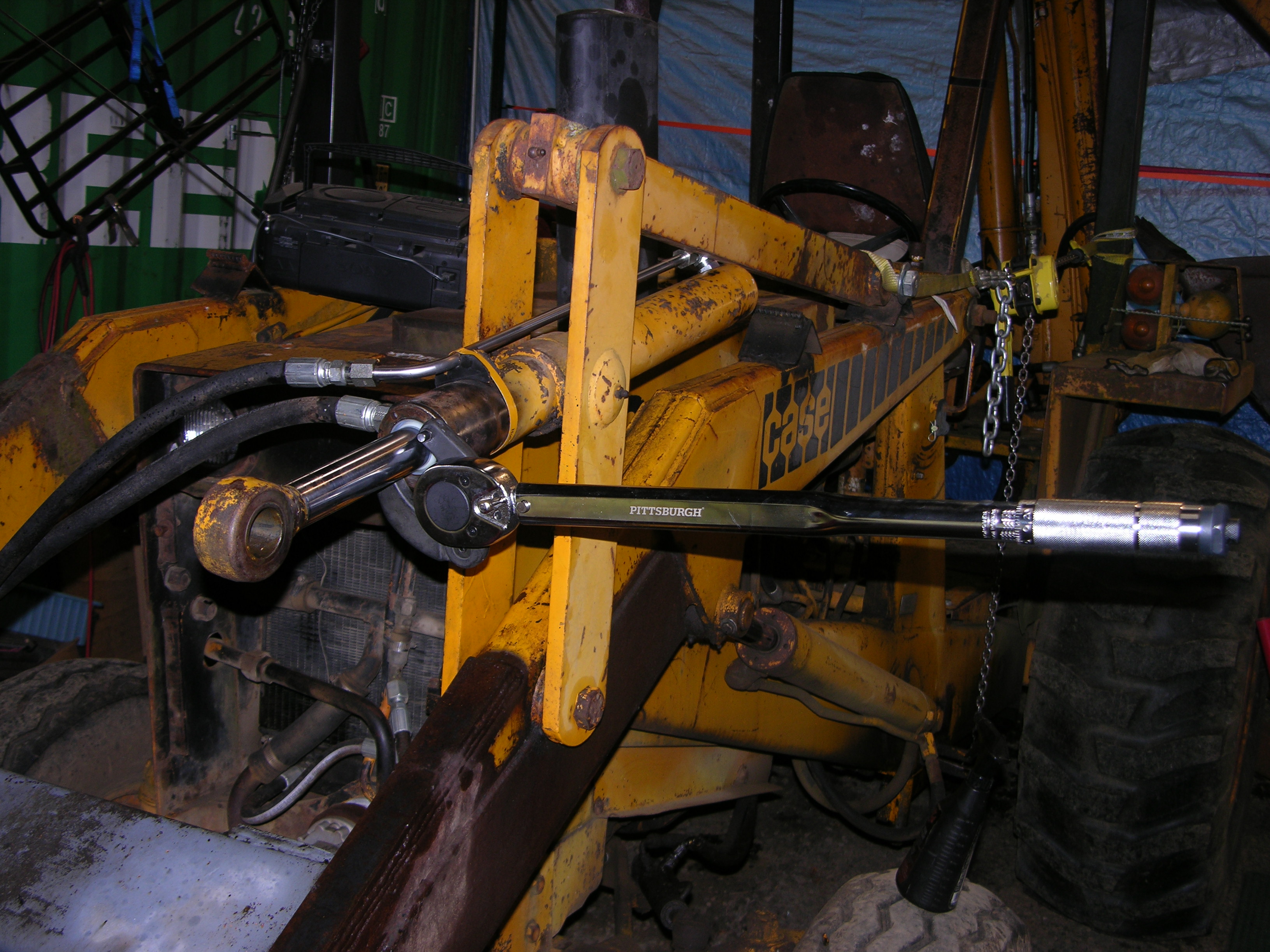

Today went well; here's the gland nut, tightened and torqued to 150 ft lbs - DSCN3285.JPG
Good thing the head of my 3/4" torque wrench isn't any wider :rolleyes: - DSCN3286.JPG
Took two comealongs and some straps to pull the linkage down far enough to retract the cylinder and get both pins replaced - DSCN3288.JPG
"nuther use for the "Tinker toys", let me get that 100 lb. vise out of the receiver and back on a hand truck with minimal pain - DSCN3290.JPG
Proof of the pudding - I topped off the hydraulic fluid, raised the bucket and exercised the curl a few times, ran it to both extremes of travel and HELD it there against the relief - not a drop of leakage (that woulda lost at LEAST a cup of fluid thru the gland BEFORE the rebuild)
