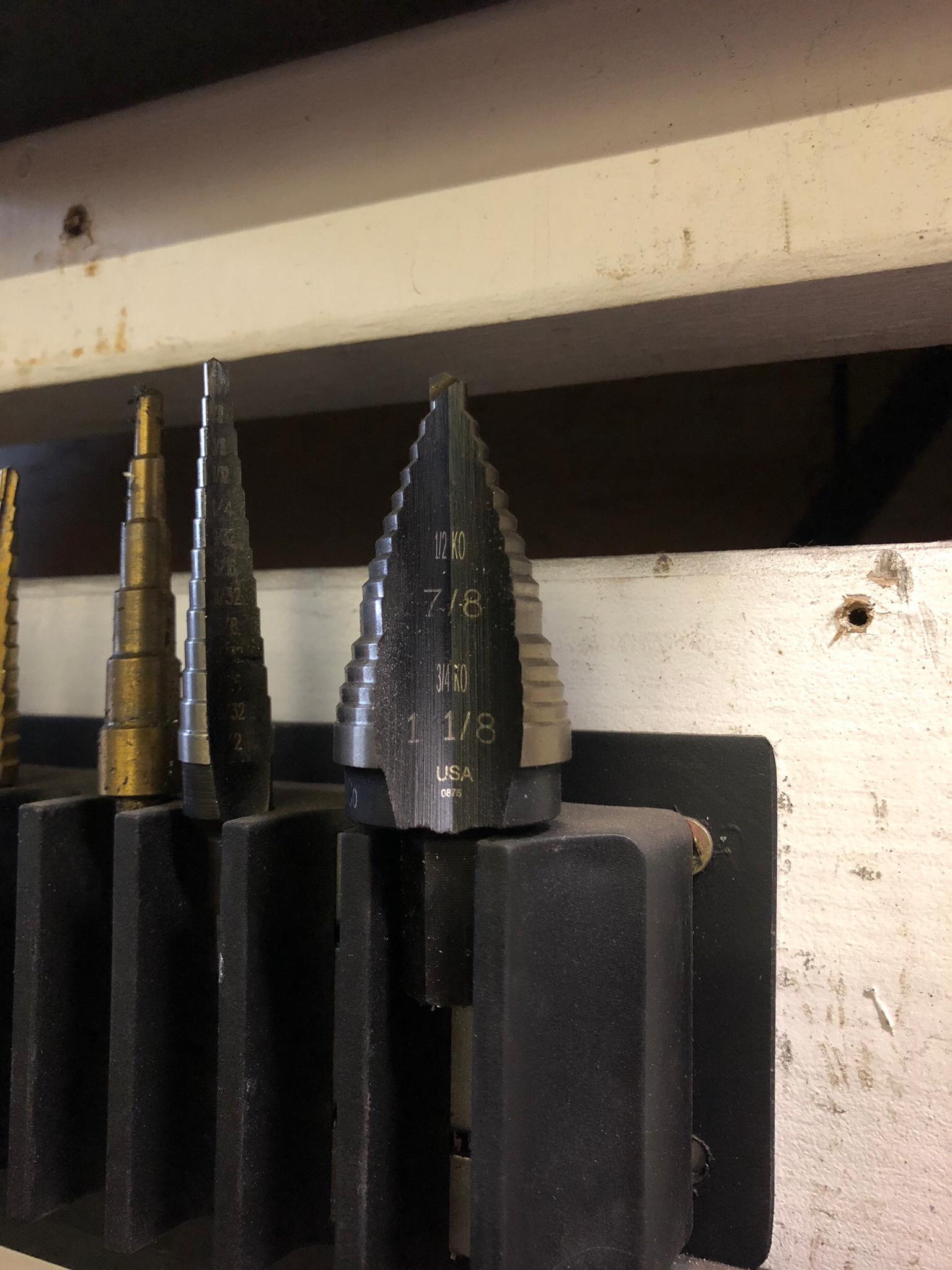

One thing I did learn in this 55 gal steel barrel hole making job, dont measure from the bottom outside lip for the hole. The in side bottom is up higher than I thought, after I got the hole up to 7/8 I had no room for the inside flange nut. Rather then try the re-weld patch do over routine on thin metal I got a long round heavy rod and banged the bottom down just enough so the nut would go on.
Other issue was the spicket tightens down to 1/16", the barrel is a little thinner so had to add washer on inside and with plenty of black gooey gasket stuff I was ready to put the spicket on, but then another problem, does anyone know how hard it is to put a nut on the inside of barrel and hold the outside spicket at the same time, after ten minutes I couldn't figure it out and then my son stop in for a second, what good timing that was. The only thing I can figure out is one must need a special 4' long wrench to hold the spicket so one can crawl inside with the flange nut, I think I seen something like this done on the Three Stooges show. Now I'll wait for rain to see if the spicket leaks, what a ordeal just for a rain barrel.

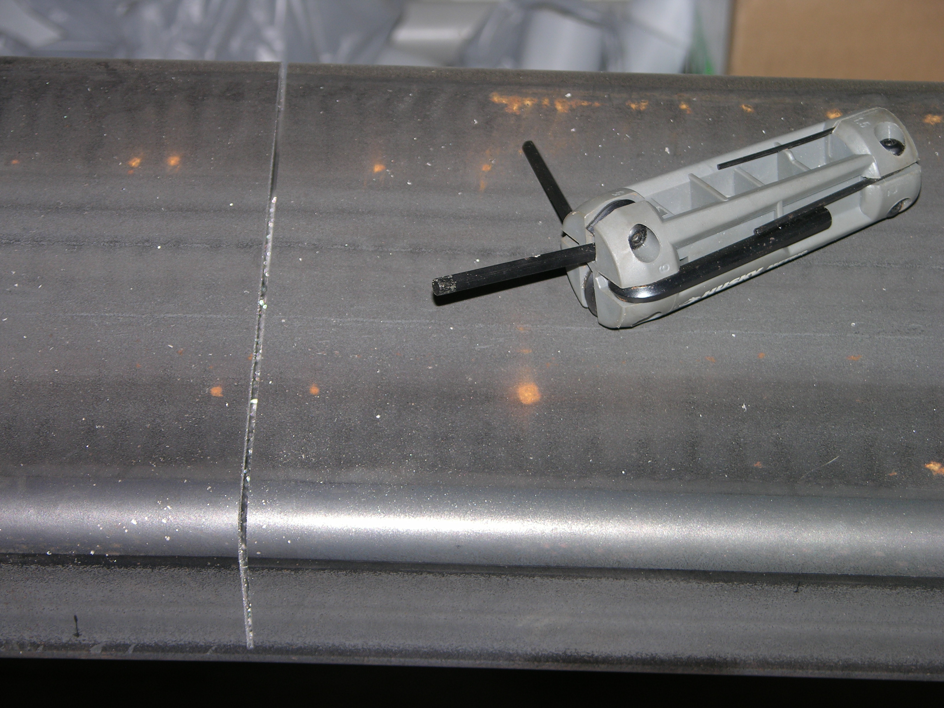

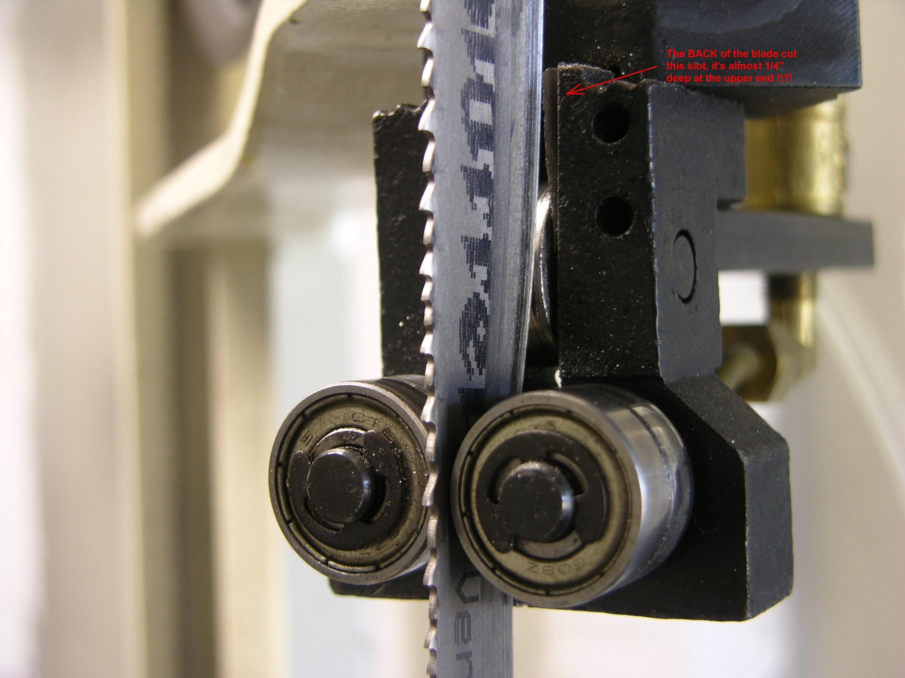

As Mark Twain reportedly said, "the rumors of my death have been greatly exagerated" - been fighting my Jet bandsaw off and on since it locked up during a cut on 3x8 tubing - Got this far on the 5th piece - CutInterrupt.jpg originally thought it was a problem in the worm gear box, til I drained the lube - BndSawGear.jpg -
Next I discovered that all 5 bearings on the blade guide that's downstream of the cut were bad (felt noticeably rough when turned) - BSBrgRepl-1.jpg BSBrgRepl-2.jpg - discovered I already had some "donors", surplus center find a couple years ago - BSBrgRepl-3.jpg - Got lucky when I drove the pin out on the BACK bearing; no mention of the knurling in the manual :rolleyes: - BSBrgRepl-4.jpg - Ready to go back in (all 5 bearings in the pre-cut end were still fine) - BSBrgRepl-5.jpg - Made 3 more cuts on a brand new Starrett blade, saw locked up AGAIN - I'm omitting the copious quantities of swear words and tests/experiments, fast forward to conditions at present (enlarge pics for more details) -
At one point in all this, I was convinced that I'd over-tensioned the blade and it had been that way for about a year, and that the cast iron bow was WARPED - I haven't come up with a reason for the conditions in the last couple pics other than that.
At this point, I'm waiting for delivery of a Lenox blade, then I'll try that and the last NEW Starrett; tests on those will be at LOWEST tension they'll track, and if things are still "out of line" I'll have to decide between just buying a new BOW ($400, special order, 1 MONTH) or a whole new SAW ($1400 or more, shipped TOMORROW) - tough call, since at this time I'm nowhere NEAR 100% sure the bow will fix things.
That's the main reason I'm waiting on a "second opinion", AKA two different mfg.'s blades; if a different blade fixes this, it won't be the FIRST time I've been "led around the mulberry bush" by crappy blades (on OTHER saws) - I should know THAT part in a few days.
Enjoy the pics; I would too, if I knew what they meant :confused: Need to get this resolved and get the 2 hi-cube containers relocated before winter ...Steve

Had some good/bad news of my own yesterday evening;
The bad: I was wrong about having another of the 6-10 tooth Starretts, I had THREE of the 10-14 tooth instead...
The good: I decided to try one of the finer pitch Starretts NOW rather than wait for the Lenox to show up - put it on the saw, followed Jet's kinda sketchy instructions for setting tension - blade now rides NEARLY centered on both back bearings. Finished half-dozen cuts on 2.5x2.5x.25 wall tubing with no hiccups - (Note to self: ALWAYS try a new blade FIRST...)
I have 4 more cuts to do on the 3x8x.25" wall tube, I have the saw aligned well enough to stand that tubing on EDGE for the cuts (maybe, hafta check clearance for an 8" TALL cut) - if I can get away with that, cuts should go faster by NOT having to cut 8" wide on the flat sides...

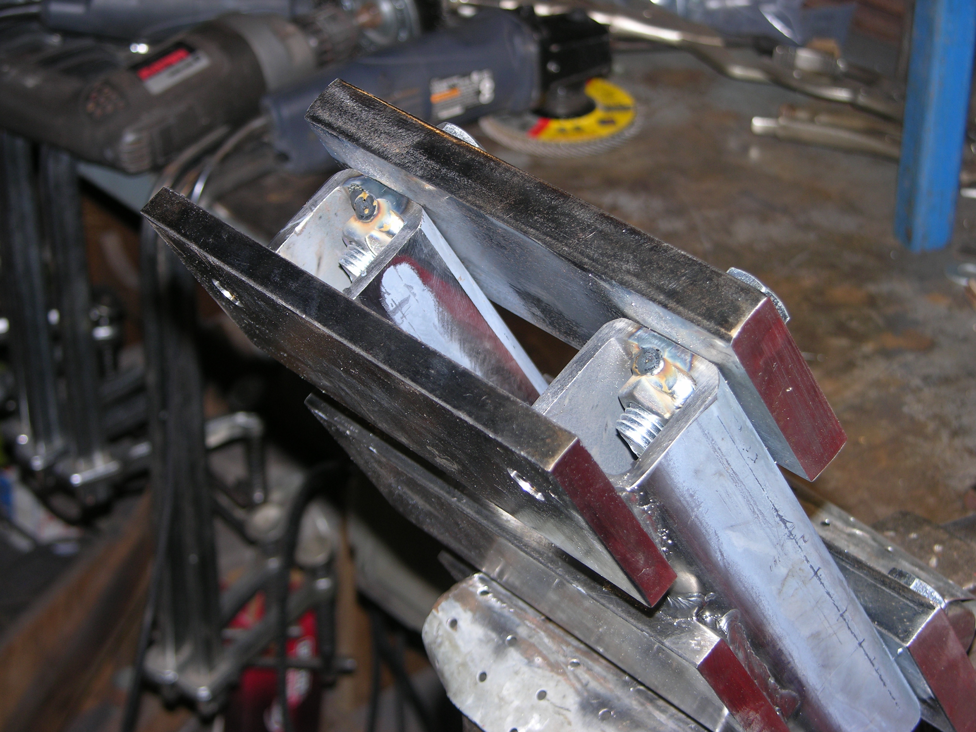

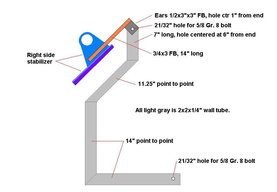

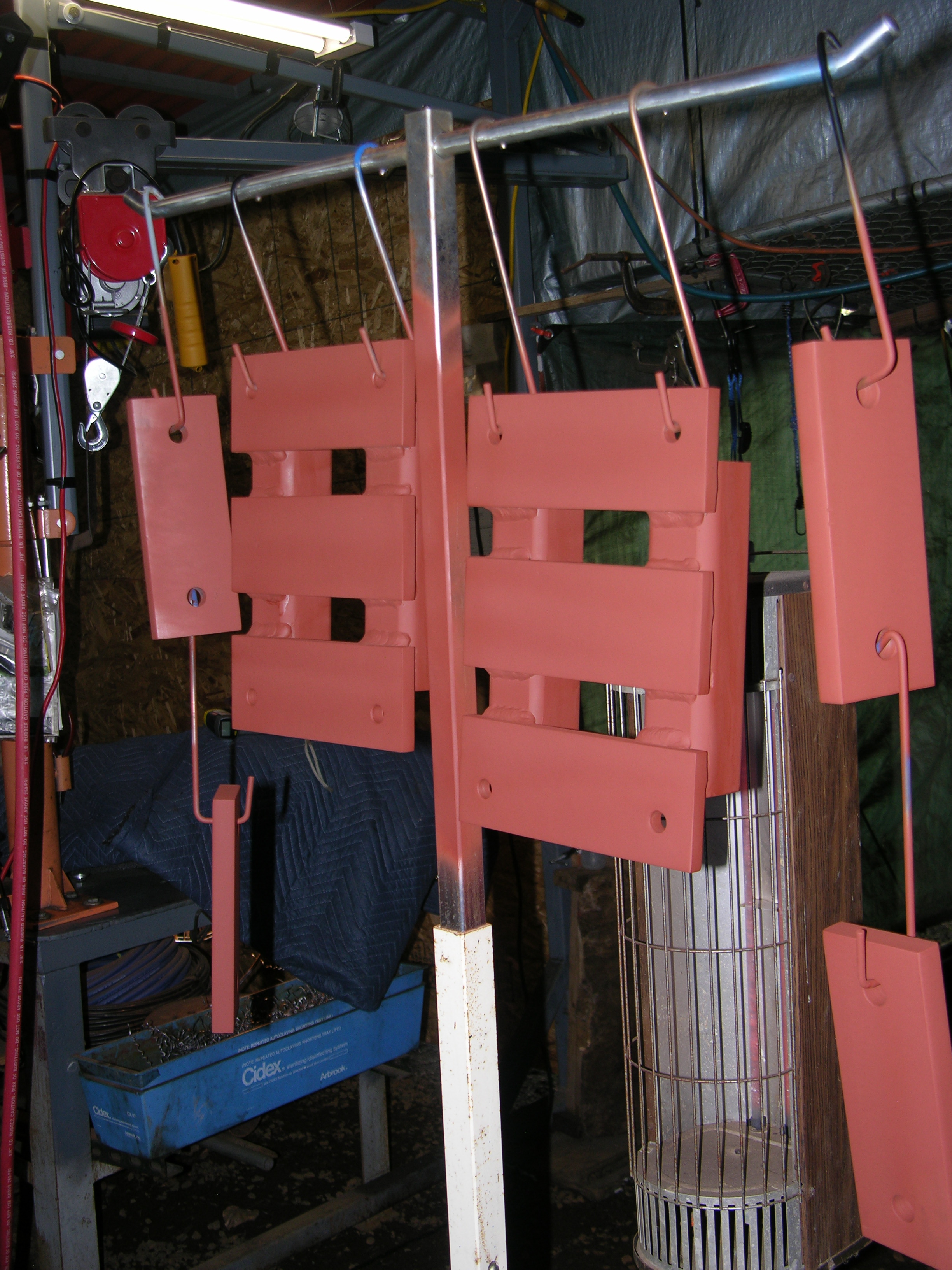

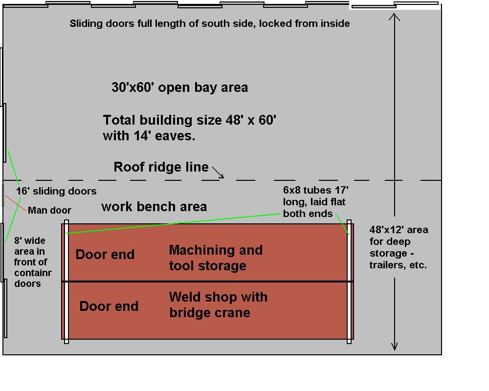

Forgot to mention - all these cuts (and some torch cuts on 3/4" plate) are for leveling/support "pads" for the two hi-cube containers that will be part of my new "last ditch effort" at a separate weld/machining/maintenance shop (spent a half hour tryin' to find the post with the floor plan, screw it; here's a re-post) -
No pics yet, each pad (6 total for the 8 container corners) will be a 16" x 27" base (3/4" plate) with "pyramids" centered on it, made of various sizes of square/rectangle tubing - these have been calculated to make the CONTAINERS level, even though the site is NOT (quite) -

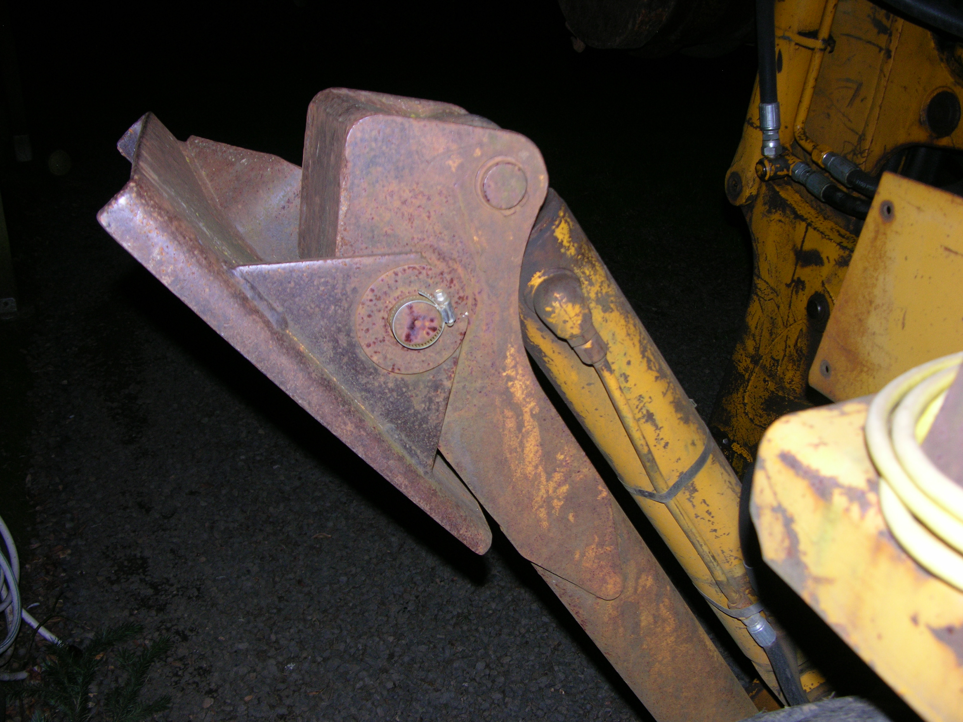

If I'd already modded one of my tractors for hydraulic SIDE link I probably woulda worked harder to get the actual site scraped level, but it's too much of a PITA to accomplish that with a manual crank for side link. As it is, both ends of where the 2 containers go have a 5" drop side to side, plus the non-door end is 3" LOWER than the door end (hence the 3" tall rectangle tubes - then there's a 2-1/2" difference side to side at the mid-point (where 2 containers touch) and a 5" drop at the side where the REST of the building will be....
Those numbers are the reason for using 2-1/2" tubing (1 or 2 layers, depending) and 3" tubing (2 layers at the low end, ONE layer at the high ends) - pieces will all get welded together and CAPPED (I HATE "Squitters" - that's a made-up word for the combo of squatters and critters :laughing: )
Then the containers will be moved with a rollback CLOSE to their final resting place, and jockeyed/lifted to final position by me and a few hydraulic "friends", their "pyramids" set under and containers lowered into place. (kinda makes me tired just TYPING that :rolleyes: )
Forgot to mention - those "pyramids" will replace (see floor plan) those 6x8 tubes (white bars in plan), supporting only the CORNERS of containers; center supports will be TWICE as wide to support corners where the two containers meet -
And yes, there WILL be pics; but first I gotta actually DO it... Steve

("At one point in all this, I was convinced that I'd over-tensioned the blade and it had been that way for about a year, and that the cast iron bow was WARPED - I haven't come up with a reason for the conditions in the last couple pics other than that. ")

Nope, the TOOL is fine; it's the "tool" that's messin' with it :rolleyes:- at the moment, the saw is cutting dead on 90* in every direction with ZERO blade wander - I can hold a machinist's square up against all cuts, and they're exactly square no matter which side you put the square on. Can't ask for better'n that...
Near as I can tell now, I was 'WAY OVER on tension - I set it up with the new blade (after replacing the bad guide bearings) and just tightened it a bit over one turn past where the long side of the blade straightened out. Then I cut 5 more pieces of the 2-1/2 square 1/4" wall tube, watching the blade,guides, etc, for any sign of a problem (guards off, hands in pockets :eek:)
Manana I'll cut the last 3 pieces of 3x8 tubing, (I checked, and the max vertical on that saw is just a hair over 7" so those cuts will get done flat) then I'll put all the "sissy stuff" back on and move on to torch cuts on the 3/4 plate - clean up the slag on those, then lay out my "pyramids" and weld those, then cut some 1/4 FB and close off all the "critter condo's" - then I'll hose it all with primer, let dry, paint 'em, and nag my "container guy" to get off his tush and get the hi-cubes moved.
The "pyramids" will weigh around 190 pounds EACH, so I'll clamp one of the heavy weld clamps on 'em for a "picking eye", no sense makin' an eye for each one when it'll only get used ONCE - besides, they'd just be in the way...
Shouldn't be any problem tweaking the containers into final position; the hoe loader is noticeably stronger with the redone curl cylinder, and it could pick one end of a 40' container BEFORE - difference is, now it STAYS up :thumbsup: - between that and my modded 20 ton air jacks, couple of farm jacks, various bars, hammers, chains, etc, and they'll be where I want 'em when I'm done...
