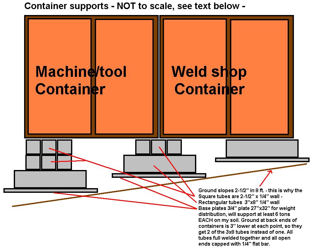

"What these pyramids made of, 1/4" plate steel? I must of missed those pictures? "
Nope, ain't no pics til they actually get DONE - base plates are 3/4" plate, tubing is either 2-1/2" x 1/4" wall or 3x8 rectangular x 1/4" wall. Here's a rough sketch with more 'splainin' - ContainerSupports.jpg
I should get a few pics manana, but just of cut pieces and my VERY temporary "crane" for those lightweight 350 pound tubes :rolleyes: ...Steve

Got ways of setting up a wind break; what I DON'T got is enough power within range of where the new containers are going to run a transformer machine hard enough to matter :( - so if I do anything "remote", it'd get done either with the "go anywhere" mm211, or the little Everlast tig/stick and some 6011/7018...
The plan (for lack of a better word) is to weld up all the individual "pyramids" on the big table with the mm252, then toss 'em in the 580's bucket for "delivery" - then jack up each container and push 'em under, fine tune with 8# hammer and/or pry bar...
If the first one takes too long using C25, I might pick up a bottle of spray mix since most of those welds will be "flatlander style" anyway - what little OOP (a few vertical ups) I'd need can be done with the mm211 without having to switch things around...
I've thought about the dual shield stuff a bit though, might need to check it out more if/when I ever get caught up enough to realize I'm BEHIND :rolleyes: ...Steve

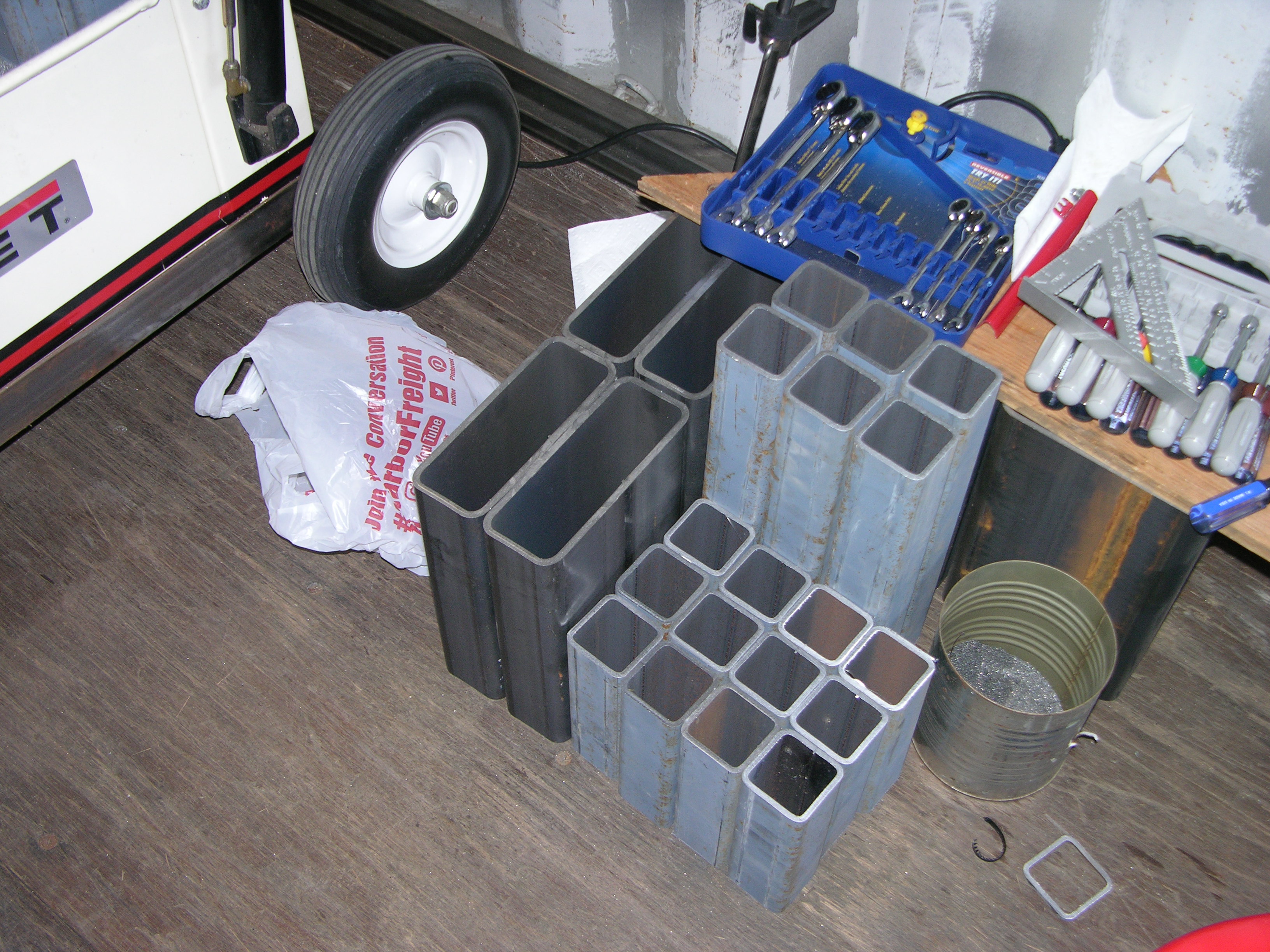

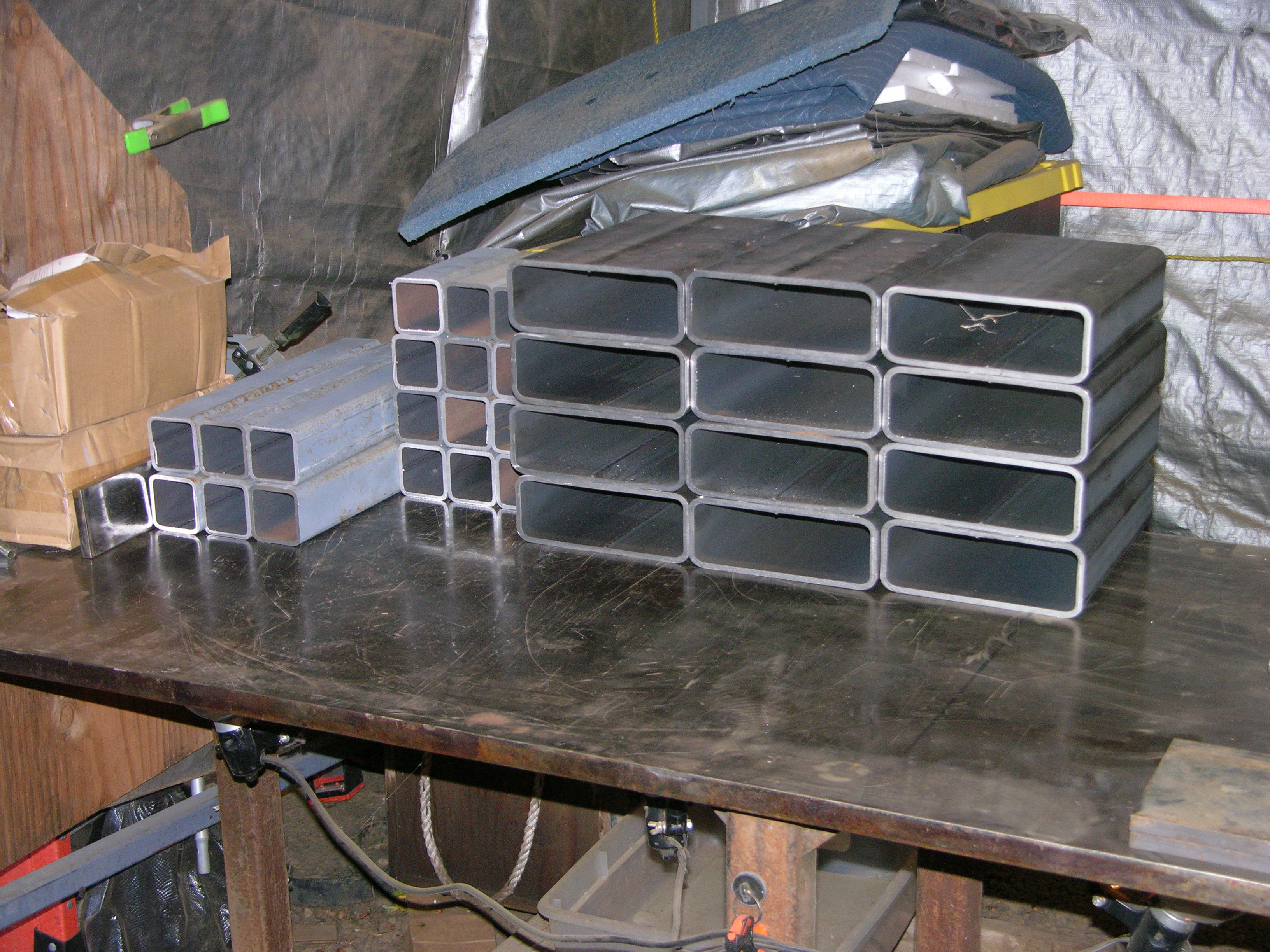

I actually started out tonite to do a different post - now I'm late and it's tired :rolleyes: so short version - here's pics of all the "pyramid parts" (stacked as they will end up) DSCN3322.JPGDSCN3323.JPGDSCN3324.JPGDSCN3326.JPGDSCN3327.JPGDSCN3328.JPGDSCN3329.JPGDSCN3330.JPGDSCN3331.JPG except for the 3/4" plate bases, which will be 27"x32" at each location - oh, and a couple shots of my new "temporary helper" - works great for getting steel from the wall near the door to the bandsaw - that piece of tube weighed just under 200# before I cut another 3 feet off it... Steve

I actually started out tonite to do a different post - now I'm late and it's tired :rolleyes: so short version - here's pics of all the "pyramid parts" (stacked as they will end up) View attachment 561128View attachment 561129View attachment 561130View attachment 561131View attachment 561132View attachment 561133View attachment 561134View attachment 561135View attachment 561136 except for the 3/4" plate bases, which will be 27"x32" at each location - oh, and a couple shots of my new "temporary helper" - works great for getting steel from the wall near the door to the bandsaw - that piece of tube weighed just under 200# before I cut another 3 feet off it... Steve

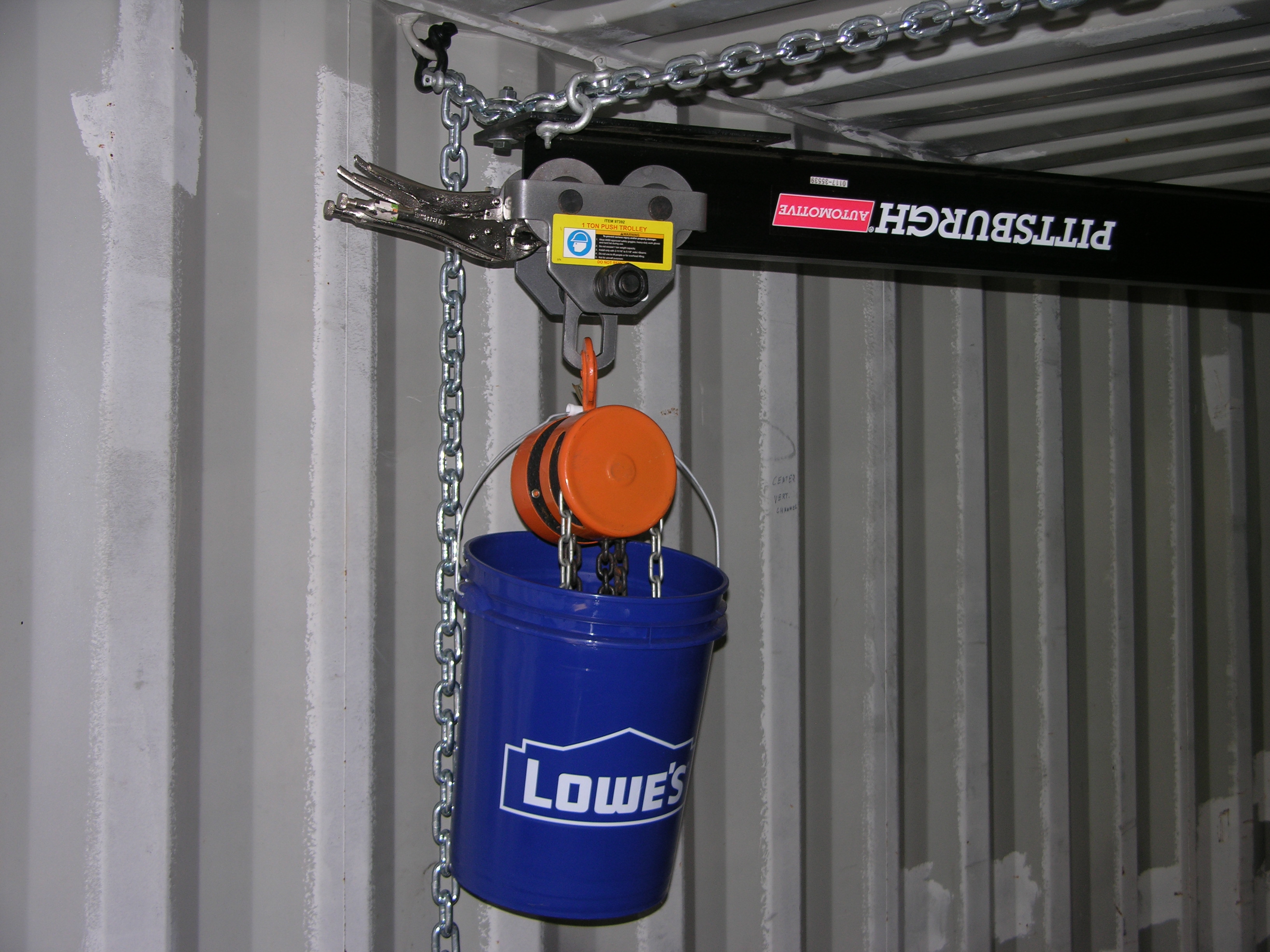

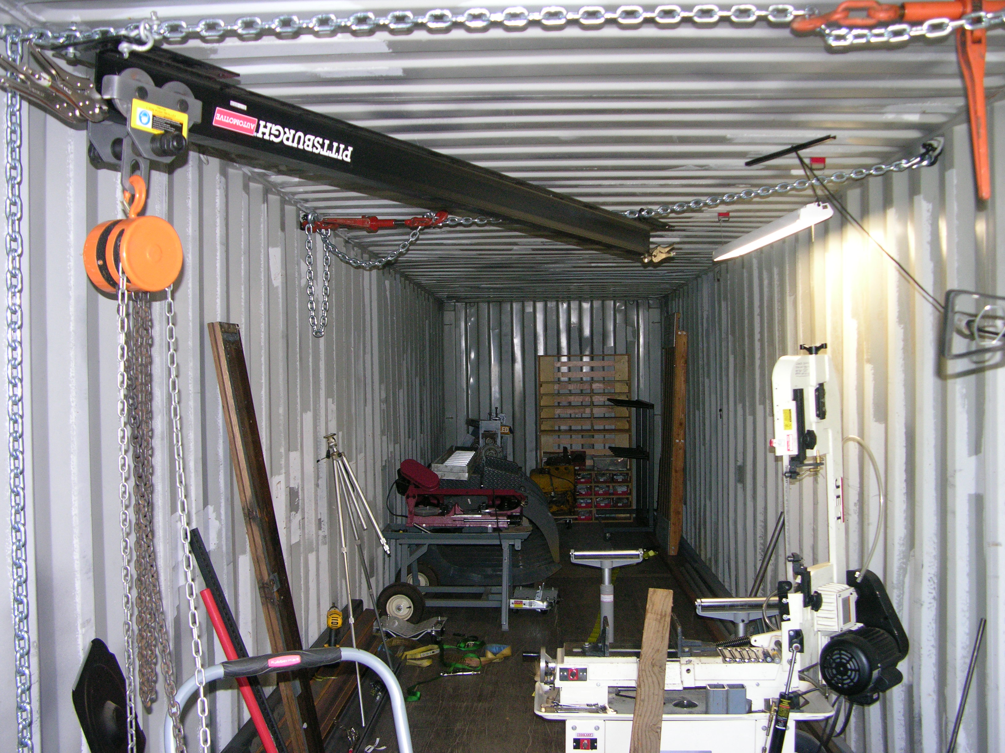

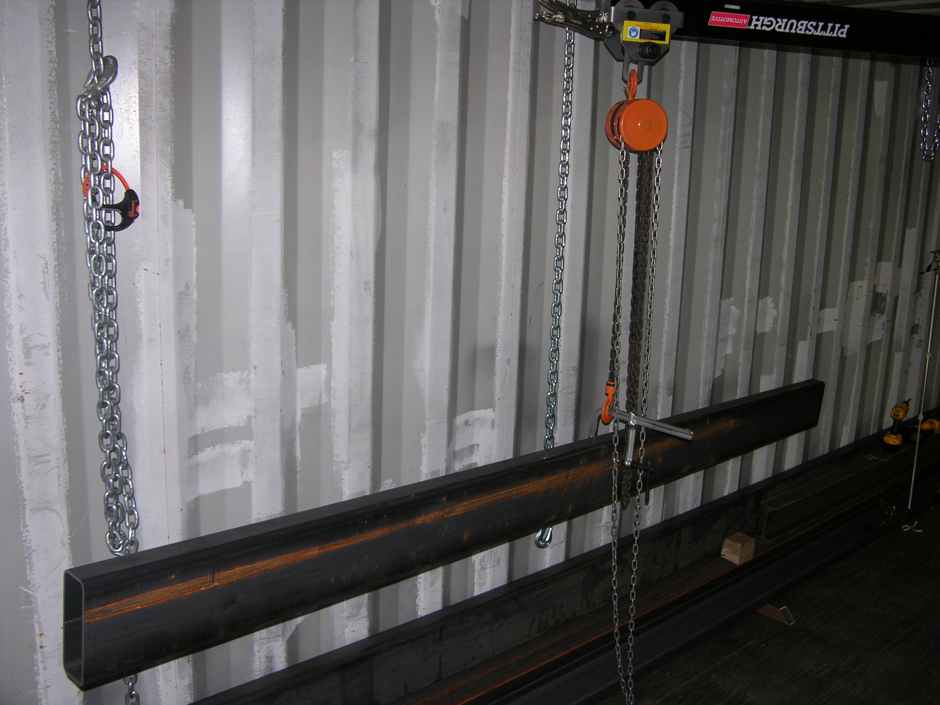

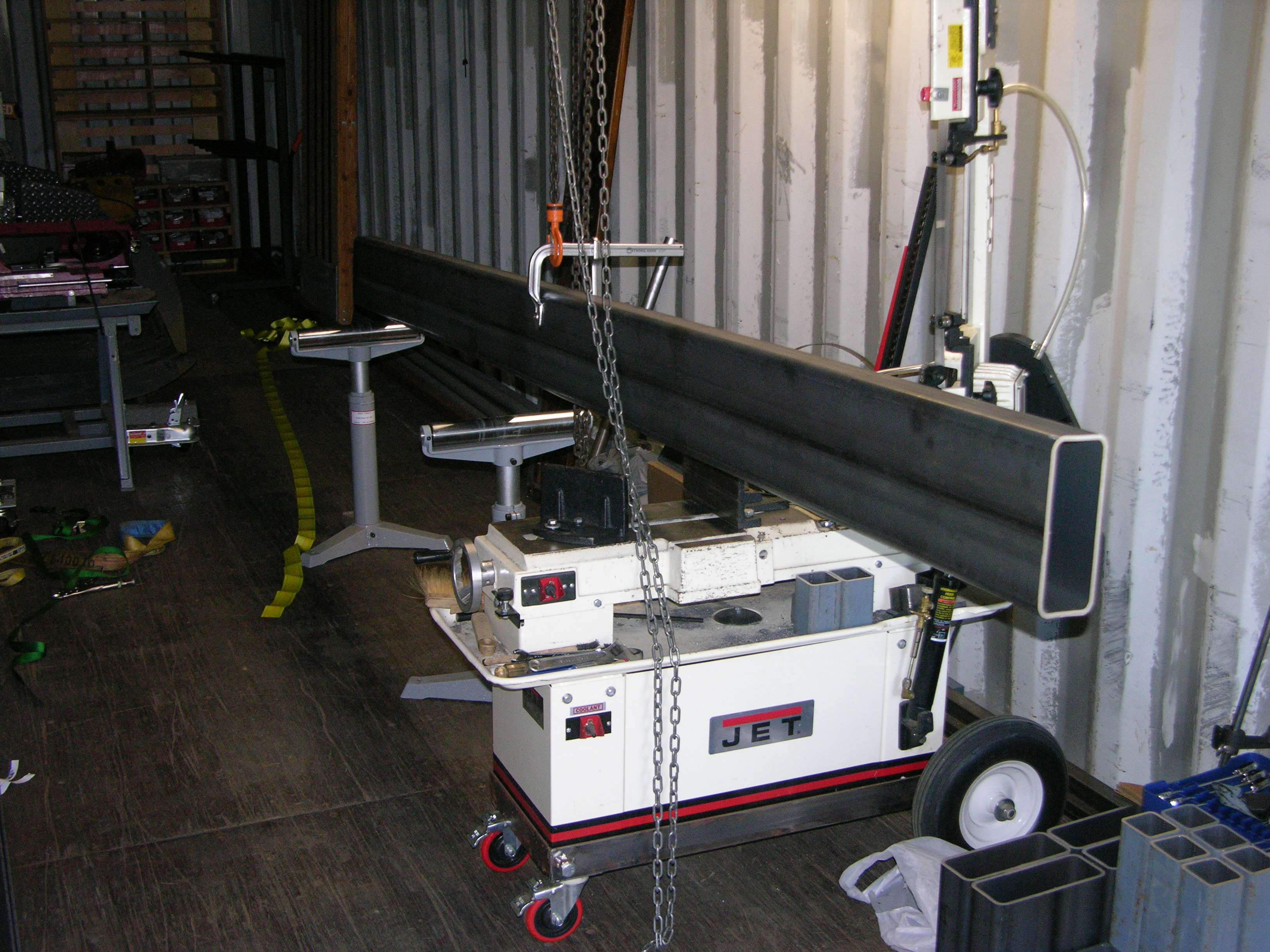

"Is that big rectangle beam sitting on that phinnakee Jet band saw, if it is where's the saw blade, behind the wall out of site?"
Nope, look at the pic again - that beam is still HANGING on my temporary "REAL black belt in lifting" :laughing: - and the saw bow (WITH BLADE) is vertical for loading - that 1200# rated F clamp is clamped dead center of the beam length (tape measure is yer friend) -
After that pic was taken I opened the vise all the way, GENTLY lowered the beam til it rested on the saw and rollers, then SLOWLY loosened the chain hoist while using the clamp as a HANDLE to rotate the beam (actually a tube) til it laid FLAT on the saw, then nudged/slid the tube up against the vise back, slid it up against the depth stop (not installed when the pic was taken, you can just see part of it in lower right, leaning up against the wall) and made the last 3 cuts...
That un-used original I-beam from the HF crane (slated for a jib crane in the other shop) is barely long enough to reach from center of a 20' stick up against the wall, to a point between the closest roller and the saw bed - but it was enough to prove (to ME, anyway) that the REAL bridge crane in the taller container is gonna be WELL WORTH IT.
In fact, true to my naturally greedy nature :rolleyes: I'm thinkin' I might just EXTEND the rails on the REAL one to go FULL LENGTH of the weld shop container -
Nice thing about that is I can just build the crane 20' long, then add more rails and posts LATER if it seems worth it... Steve

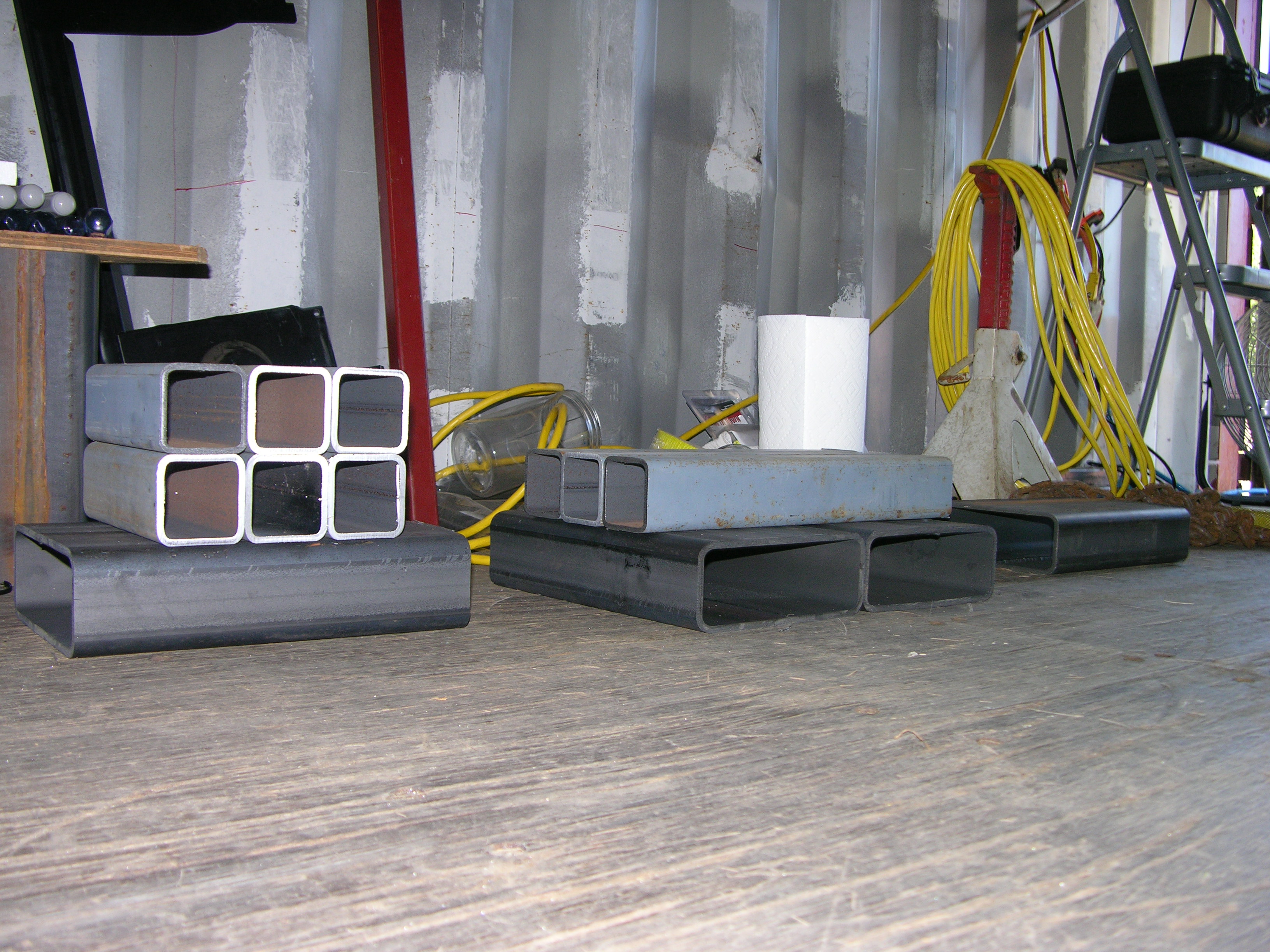

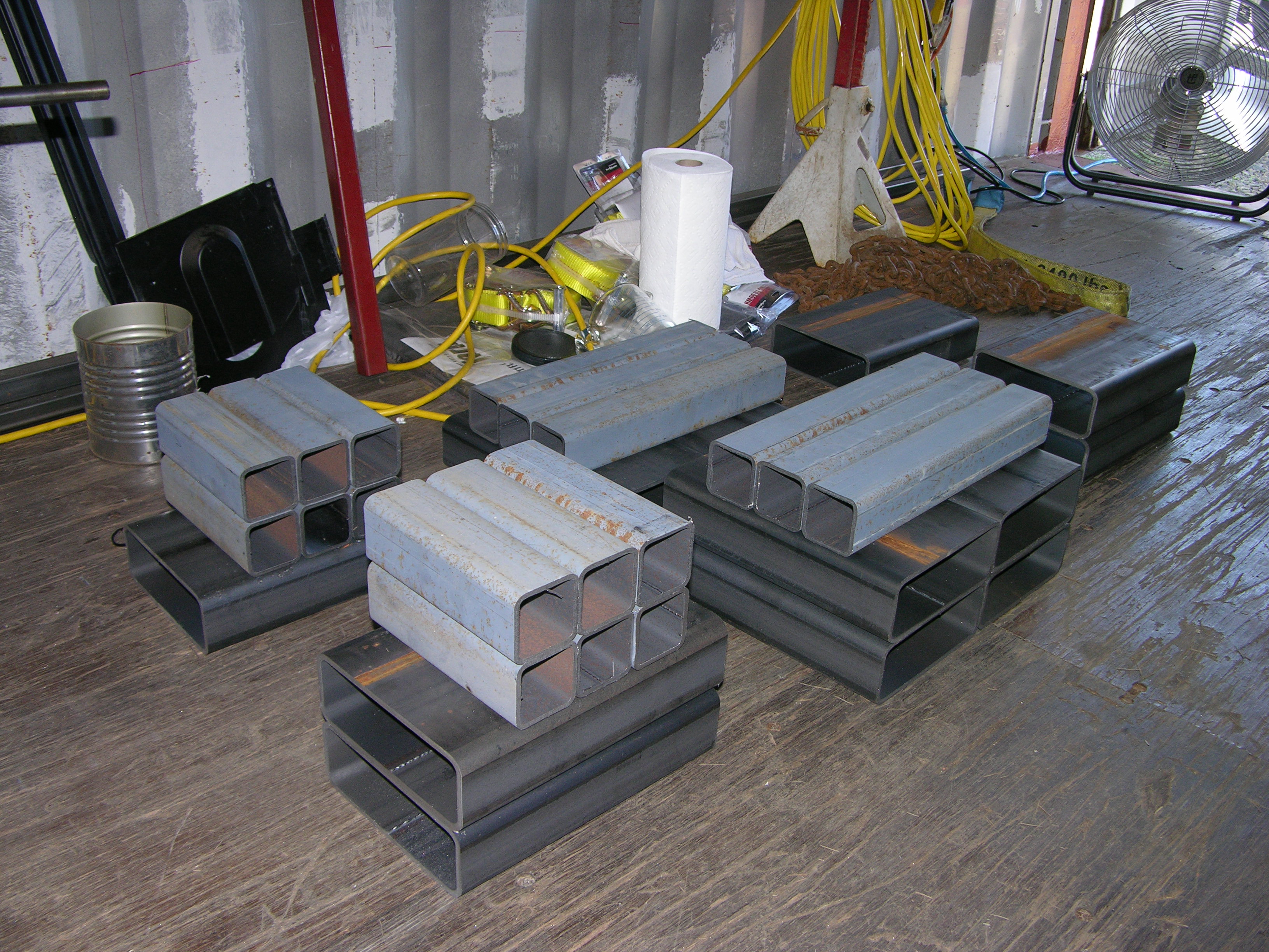

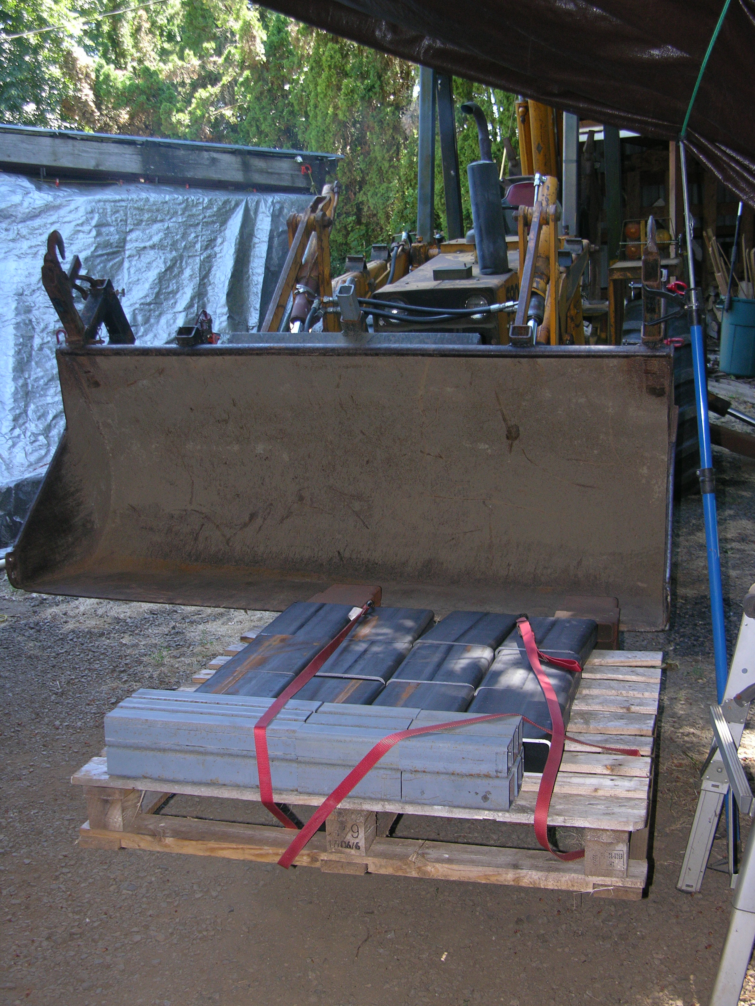

Finally got back on track a little - remember these? They're stacked the way they'll be welded together, and in the order they'll need to be so the two containers come out level (even tho the ground isn't quite) - DSCN3331.JPG
So I slipped the forks on the loader bucket, slid a pallet on 'em, set it just inside the container in the previous pic, and brought 'em up to the OTHER "shop" to clean up edges and weld together - DSCN3335.JPG
Also cut the 27"x98" piece of 3/4 plate into 3 27x32" pieces for bases under the door ends of the containers - DSCN3334.JPG Notice how that plate is a LOT thicker on the left side? It was a "blem" I got cheaper - downside is my PM45 plasma almost didn't wanna cut the last 5-6 inches; thickness there is just OVER an inch.

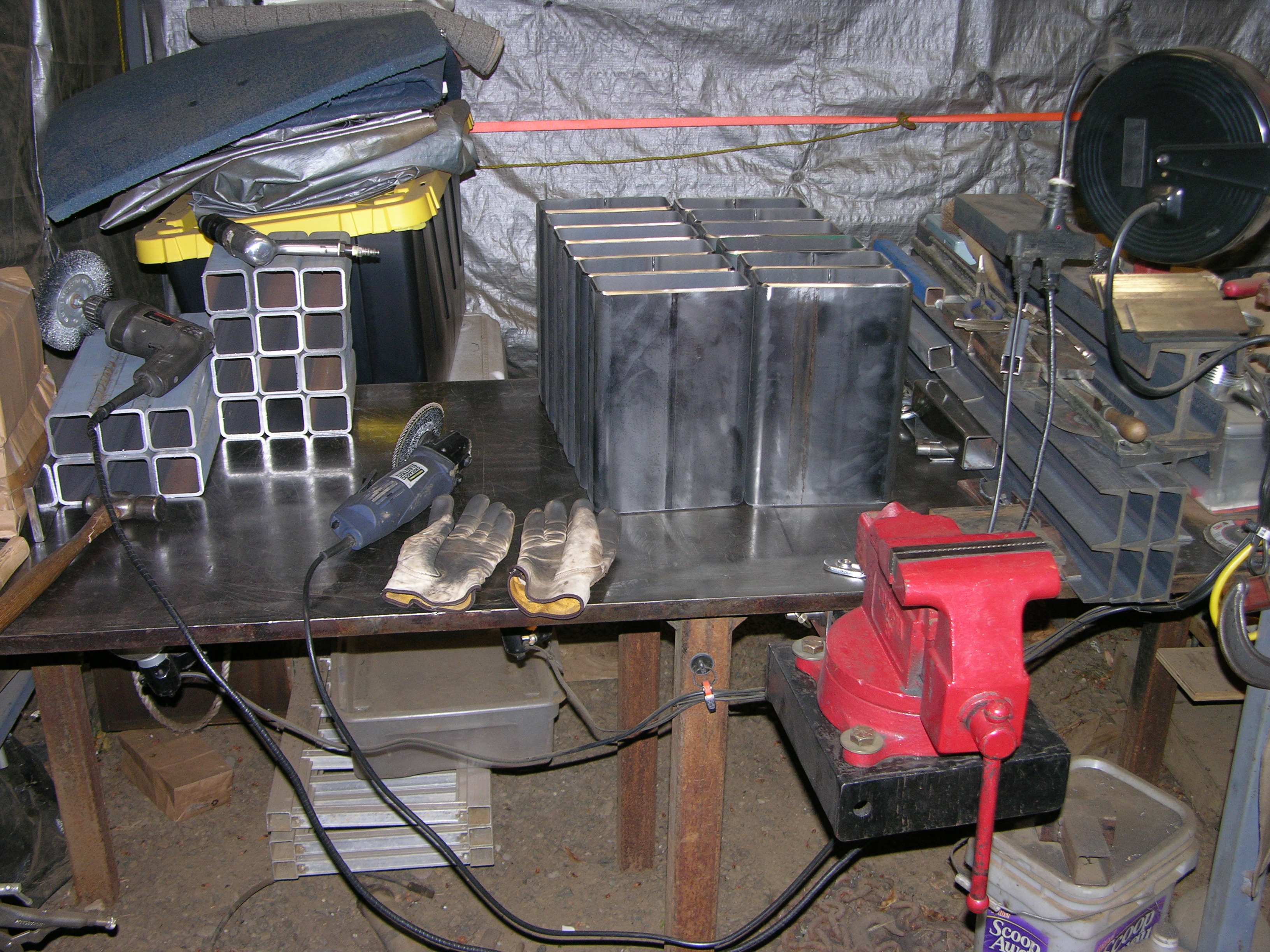

Then I stacked the tubing pieces on the weld table, will start cleaning edges and knocking mill scale off where they'll be welded together tomorrow - DSCN3336.JPG
Also found a 1/4 sheet of 1/4" plate, will use that instead of flat bar to "de-critter" all the tubing holes - that way I can cut exact sizes out for each set of tubes, and just do perimeter welds instead of using flat bar. My PM45 will be a LOT happier cutting that at 60" a minute :D
The tubing stacks won't get welded to the bottom plates til last; each plate weighs 180 pounds, don't wanna have to use the crane any sooner than necessary.
Got 2 more days before temps get into the 90's, so I wanna get as much hot work done before then as I can... Steve

Got a few things straightened up today, put the big vise on the weld table and got all the 3x8 tubes beveled both ends; should get all the smaller tubes beveled manana, then I'll need to lay out each pyramid as it'll end up so I can see where I need to shine the pieces up for welds - not lookin' forward to a week in the upper 90's... Steve
