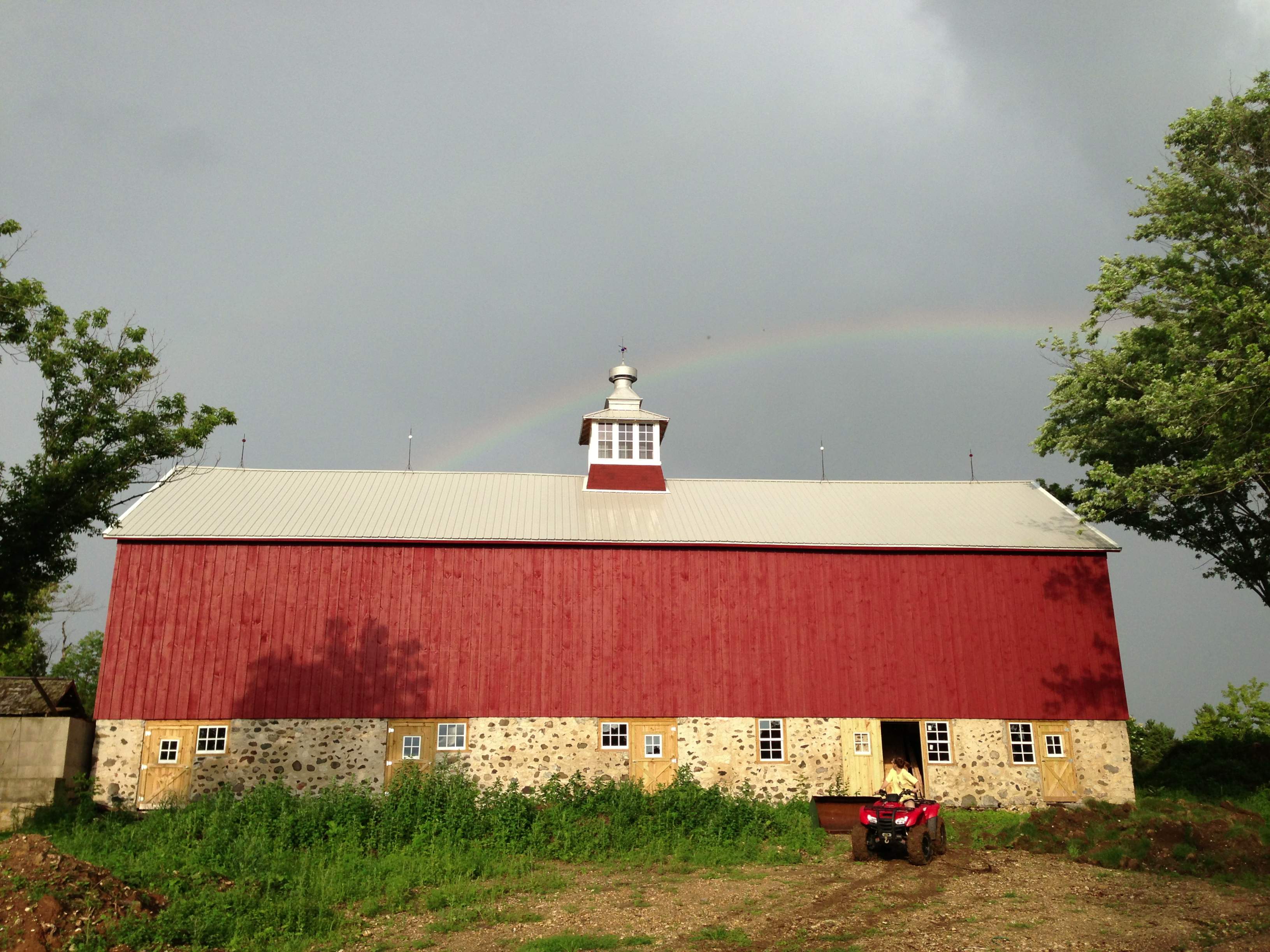

We used an Amish crew when we had ours rebuilt. Cost came in at less than half what the English quote was. I like steel roofs and wood siding. Shingles are just too much trouble. The Amish rented a all terrain forklift and manlift for the work. I can tell you that I can't find anybody to rent me a forklift, much less a crane. Insurance just won't allow it. When we moved our garage I ended up buying a old utility truck with a crane. Did the project and the sold the truck for a loss because the trunion seal had blown. Only lost a couple of grand on the deal which was worth it because we got our use out of the truck.
I've found some plans here: Free Framing and Utility Building Plans If you are in a snow region, please don't forget to figure on drift. I've seen too many building collapse for that reason. Also, never have an open sided building because the wind will get inside and rip the roof off.

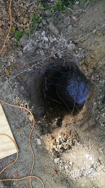

Its been 5 months since I posted about my 36x40 project because there was nothing much to post. I am happy to report that has changed. A couple months back, I had 80 tons of 12 rock, and 100 tons of fill sand delivered to build my barn drive way and building pad. After that I had zoning issues that forced me to resurvey and combine my lots which forced me to cease progress until this week. I am going gangbusters on it now and have some pics to post.

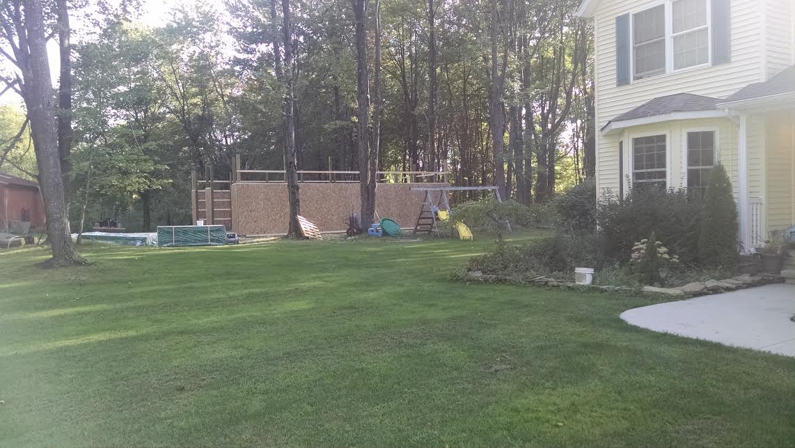

Lots of progress, all post are set, walls are sheeted 8 out of twelve feet up.
