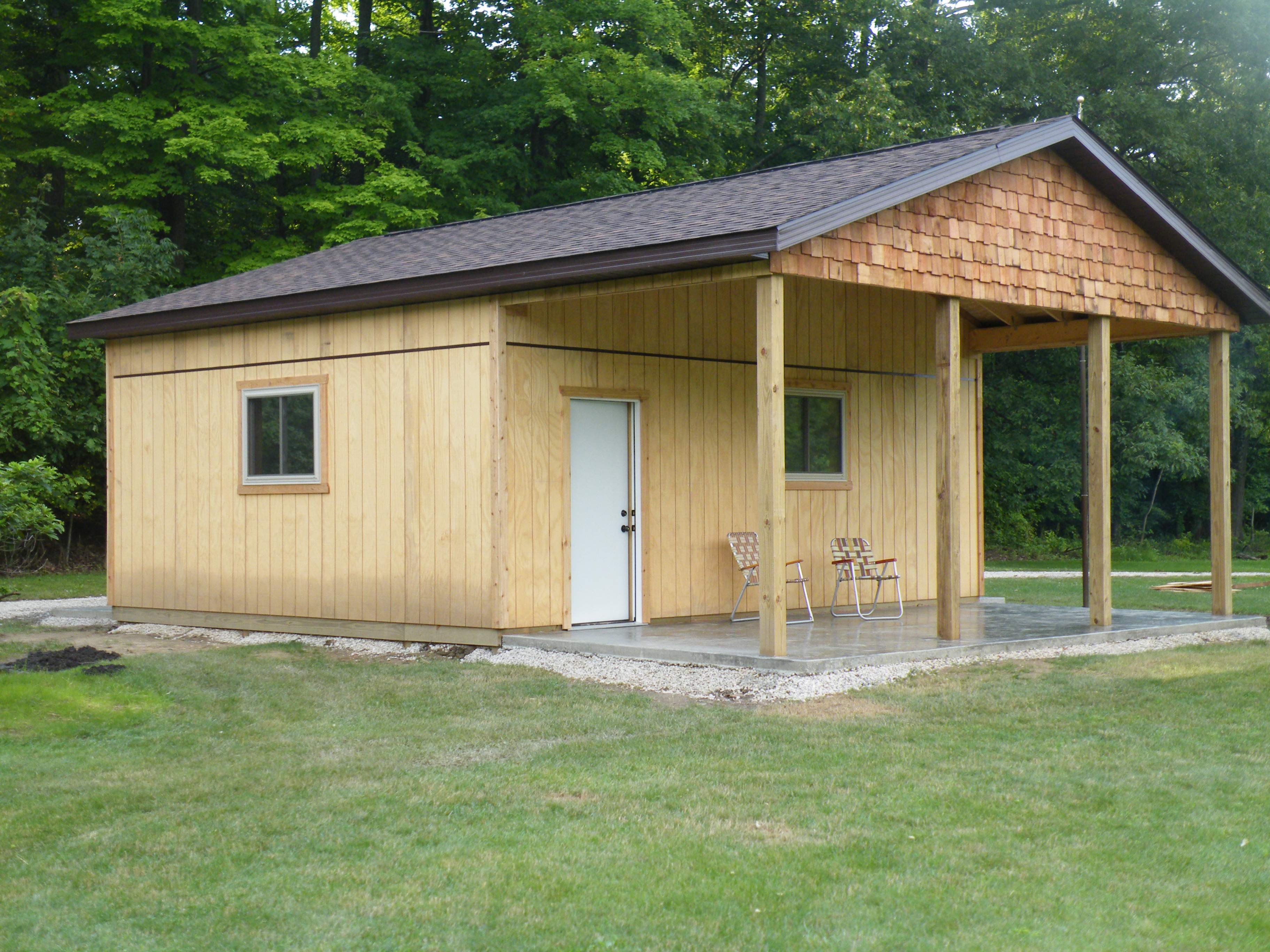

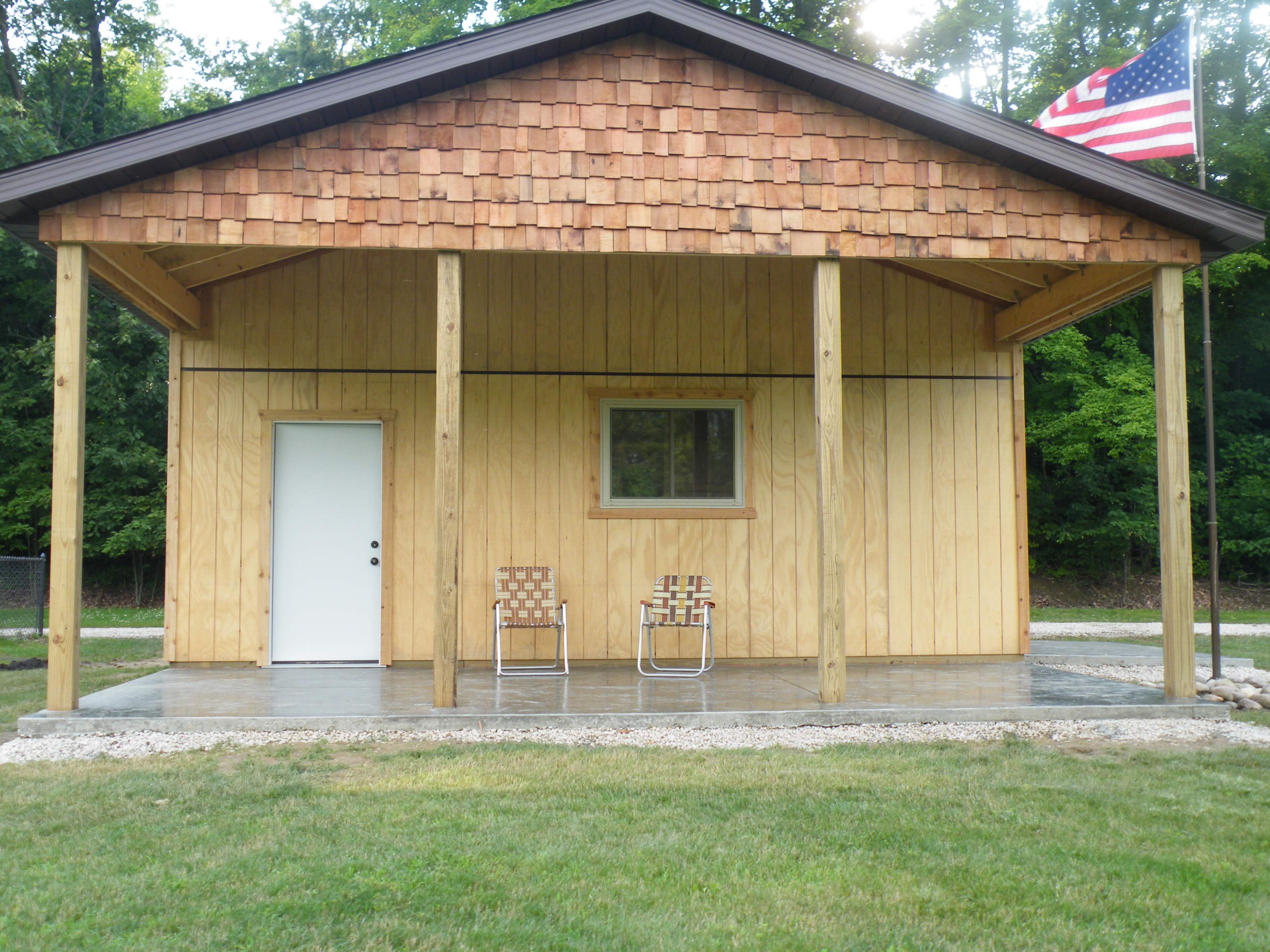

Should've made her a gazebo instead. I wouldn't waste that much good roof on a patio. :)
I stained the whole inside too. Turned out great! Mrs very happy, bought me another tractor.:licking:

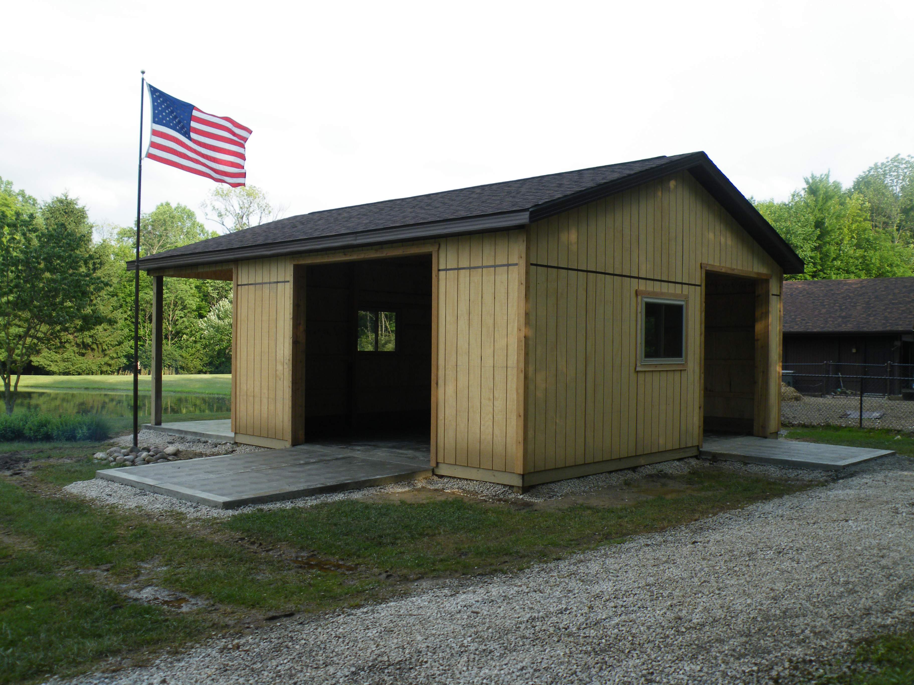

I had mine put up by CHUPPS Builders (Amish crew out of Apple Creek/Holmesville area) that is South of chardon 40 or 50 miles but probably well in their driving distance. I am heading out to do some work for their brother this weekend. I dont have the builders phone number anymore but was real good with best quality materials thru amish hardware place in Kidron Ohio. https://www.lehmans.com/
This is a pic of my barn (click it to see progress of over 100 photos) this was just after they finished my place in 2002 and cost me 20K they provided everything to that point including man doors and roll up door. It is 50x50 11 foot 1st floor and 11' 2nd floor. the 12' leantoo off one side. PM me and I can give you his brothers phone number (Amish down there have cell phones.) and he should be able to get his brothers phone # for ya.
(click pic it to see progress of over 100 photos)
Note concrete I had done in 2011 by Amish crew was GREAT Ron Weever, (very busy but did really great job.) cost me 7800 for 60 yards of 6000PSI mix with fiber, I did under layment-insulation & mesh & in-floor radiant tubing myself. I have his # for if when ya want to go that way. He is out of Holmesville area as well.

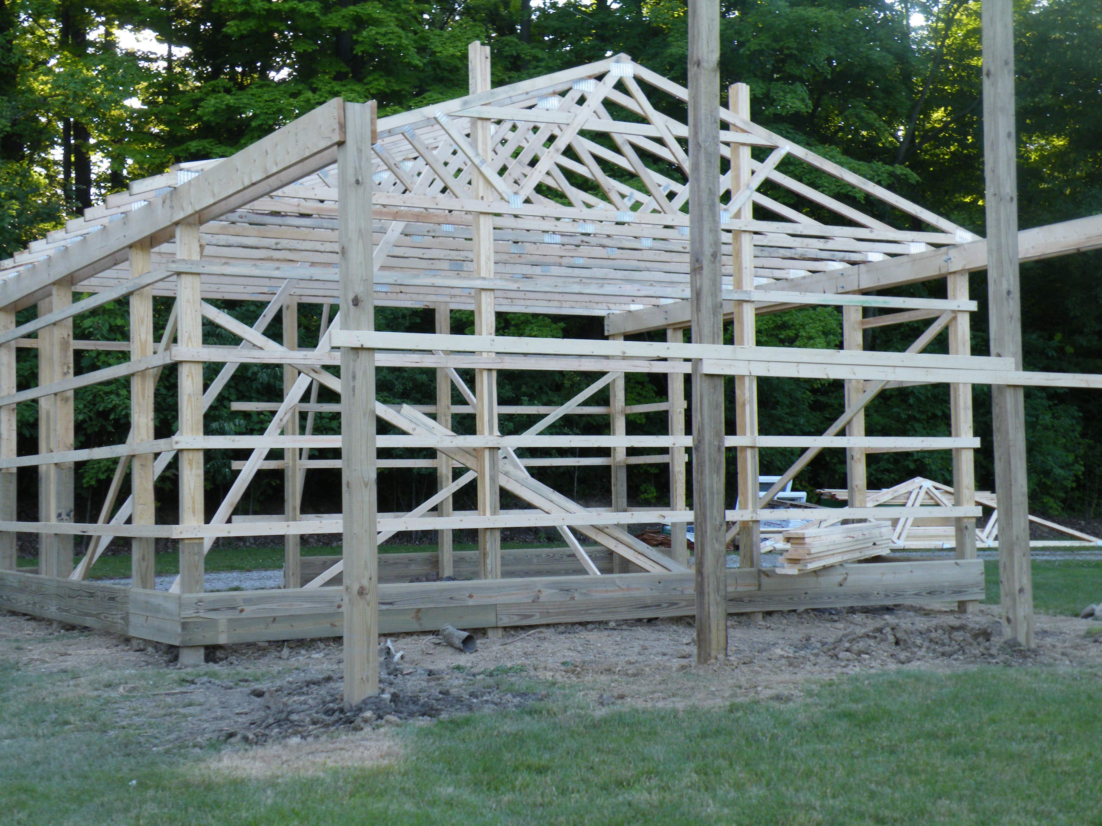

These cookies are available all pre cast in several sizes and grades. Mine were 18" x 8" of 6000psi fiber added design. The holes were 36" and 4~5' deep initially and dirt removed bottom compacted some and the cookie tossed in. The Amish boys used the POST (6x6x14~28') to flatten the concrete cookie into the bottom of the hole like a hammer! They picked them up and dropped them onto the cookie 10 or 15 times each to set the cookie into bottom of hole so it could not move during back-filling. They back filled the holes with crusher run (I provided gravel on-site) and dirt out of the hole. They compacted the crush-run gravel and added clay cap on top & compacted it more. I went back over the posts after they finished using spud bar and added some Portland cement to top of each post & spud bar tamped that in. That left me with a rounded humped up area HIGHER than the surrounding area so water sheds away from the posts.
here is pic of what SOME of the posts looked like, this one shows where I put in threaded rod for mounting beam/bender after concrete was put in. It is actually dug down and dirt removed and mixed in 3pt mixer to make a larger high psi mounting point for a car lift someday...
(click pic for full size pic.)
I think somewhere in the photos shows some of the landscaping around the barn to move water away from it. I also used 4" tile around the barn and plastic to move it farther away underground. My posts should be really dry for 50 years or more...
