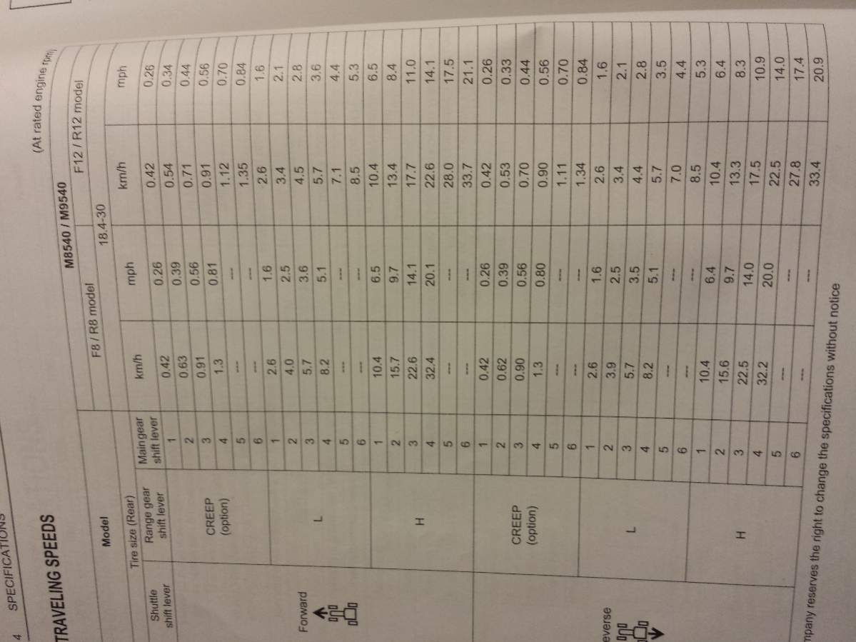

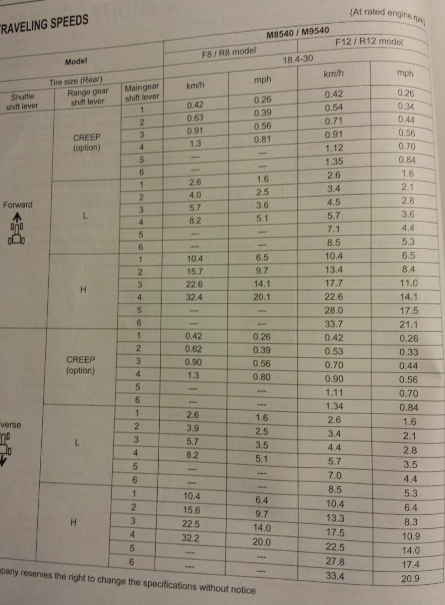

I can answer some of your questions here is the ground speed chart in attached photo.
yes they are definitely lighter than most others. I wouldn't want one without fluid filled tires or atleast rear wheel weights. The owners manual suggest loading tires for loader applications. I can easily lift 2500 lb pallets without 3pt ballast. Ive lifted a couple of 3000 lb 48" deep pallets with only about 600 lbs on the rear my wood box partially filled that was questionable. I dont hay TripleR might not sure about Ovrszd both are on here often. I do know people run round ballers on these but dont have any personal experience.

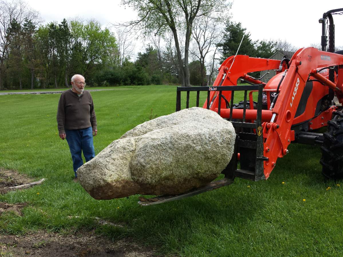

Your welcome 2000 lbs would certainly require either tire ballast or 3 pt ballast especially if 2wd. I can get by in 2wd and no 3pt ballast somewhere around 2000 lbs but I have loaded tires. With the 1300lb box scrapper and 1800 - 1900 lbs of tire ballast I rarely need 4wd unless im backing up a hill.

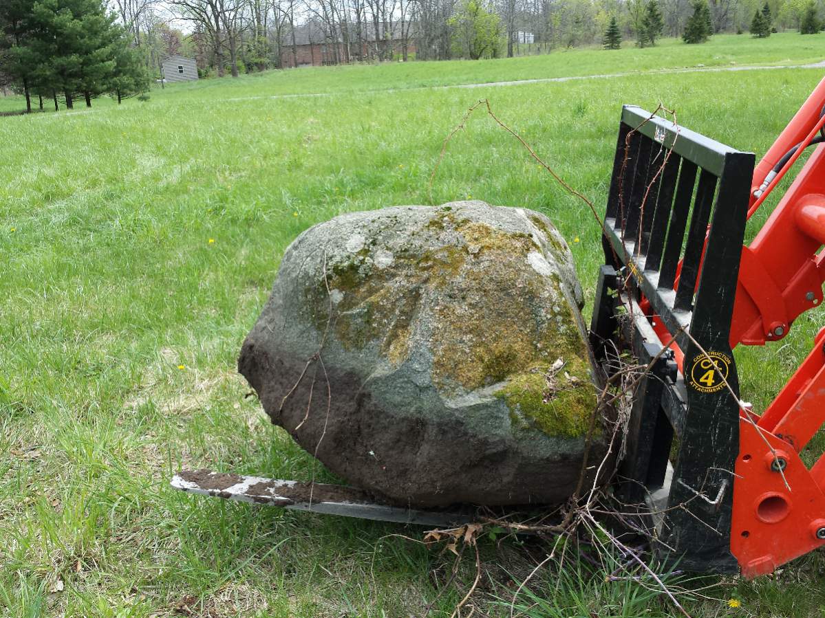

The small bolder pictured below was is north of 3500 lbs probably over 4000 I did need 4wd to back the hill for positioning I could only lift it about 42" but I had the loader set in the height position
I needed 4wd to pull this one out of the hole. But beyond that it was fine. I tried to maintain 2wd as much as possible to minimize damage to his lawn
Finished job
I understand the desire for 2wd due to cost but I would definitely go for 4wd with a loader as capable as the LA1353.

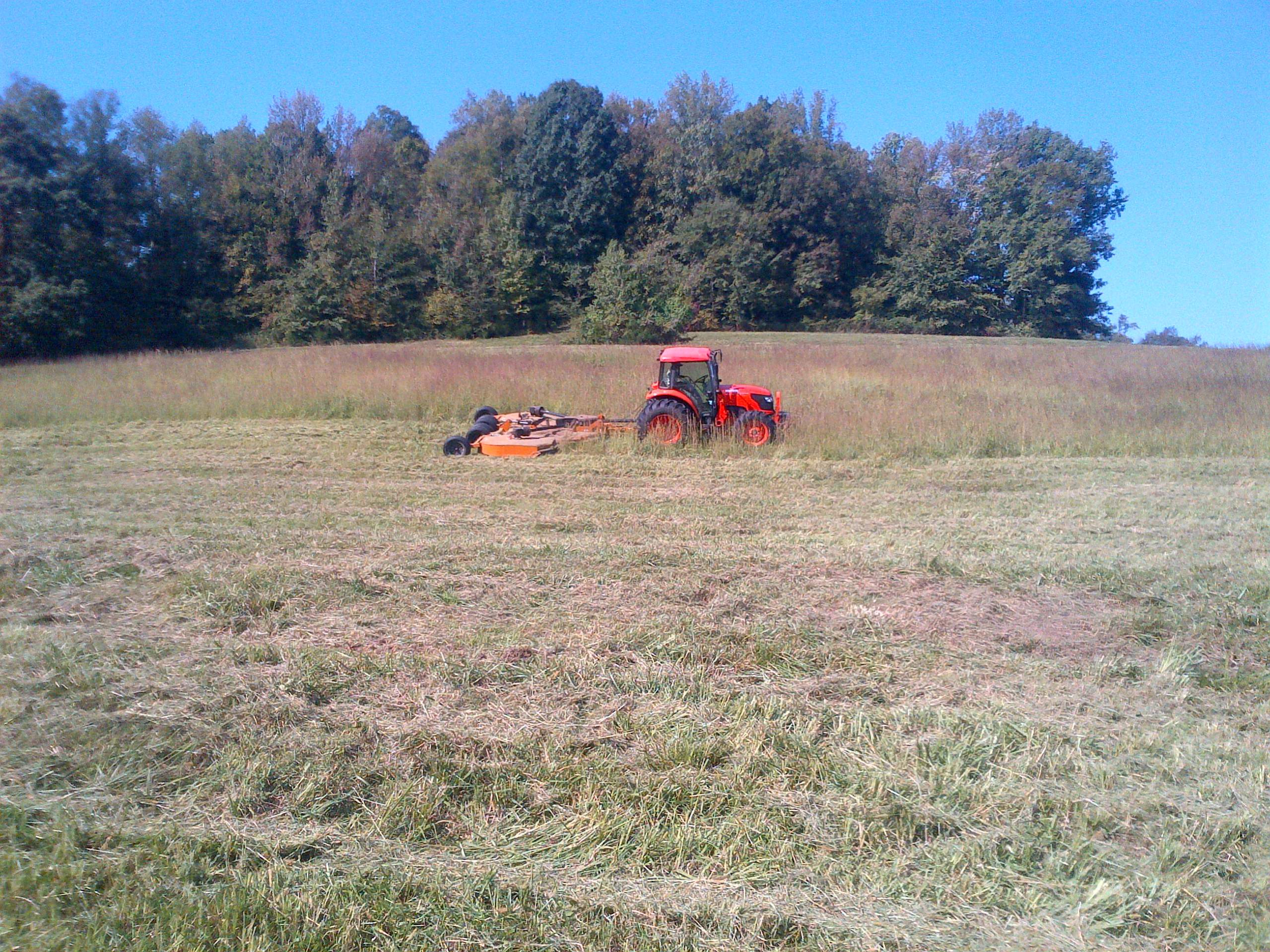

I've got a 9540 4WD. Kubotas are lighter. I have the rears on mine filled with no complaints. With a front end loader, it is a must. I don't hay but I pull a 15' Woods BW over lots of hilly ground. When bushogging, I remove front end loader and add about 700 lbs of suitcase weights to the frontend. I've been impressed with the way it holds the ground going up and down hills. The cutter weighs about 4000 lbs. but I wouldn't use it where I do without 4WD. On flatland, it would be fine.

General Rule for a rotary cutter is 5 PTO Hp / Ft so 75 Hp is what they consider a minimum. I know you hear of people with smaller tractors going to the low side of the 5hp / ft and then they end up cutting with only two thirds of the cutter or mowing at 2 mph my 7 ft BH27 with 75 pto hp @ 11 HP/Ft is fine for light brush and tall grass but hit a couple of 2"-3" saplings at the same time and she puts an awe full lot of strain the other motor. Which explains why it has a 150 HP gear box. I realize a 15 ft realistically is used for open pastures or road side mowing different than my 7 foot

I could probably be fine with a smaller hp and the batwing, but I wanted to have plenty of power. Xring100 is right on. For most of the cutting I do, the 9540 hardly knows it is behind it. However, I've have cut some buckgrass as tall as my windsheild wiper on the cab and the engine slowly started coming down to point I had to clutch and stop or it would have killed it and that was in 2 low on an 8x8. The 9540 can be choked down, just depends on what you are cutting. Weight is also a factor for hills I have. I didn't want to be pushed around and I've been pleased with that aspect, rears loaded and weights on the front.
