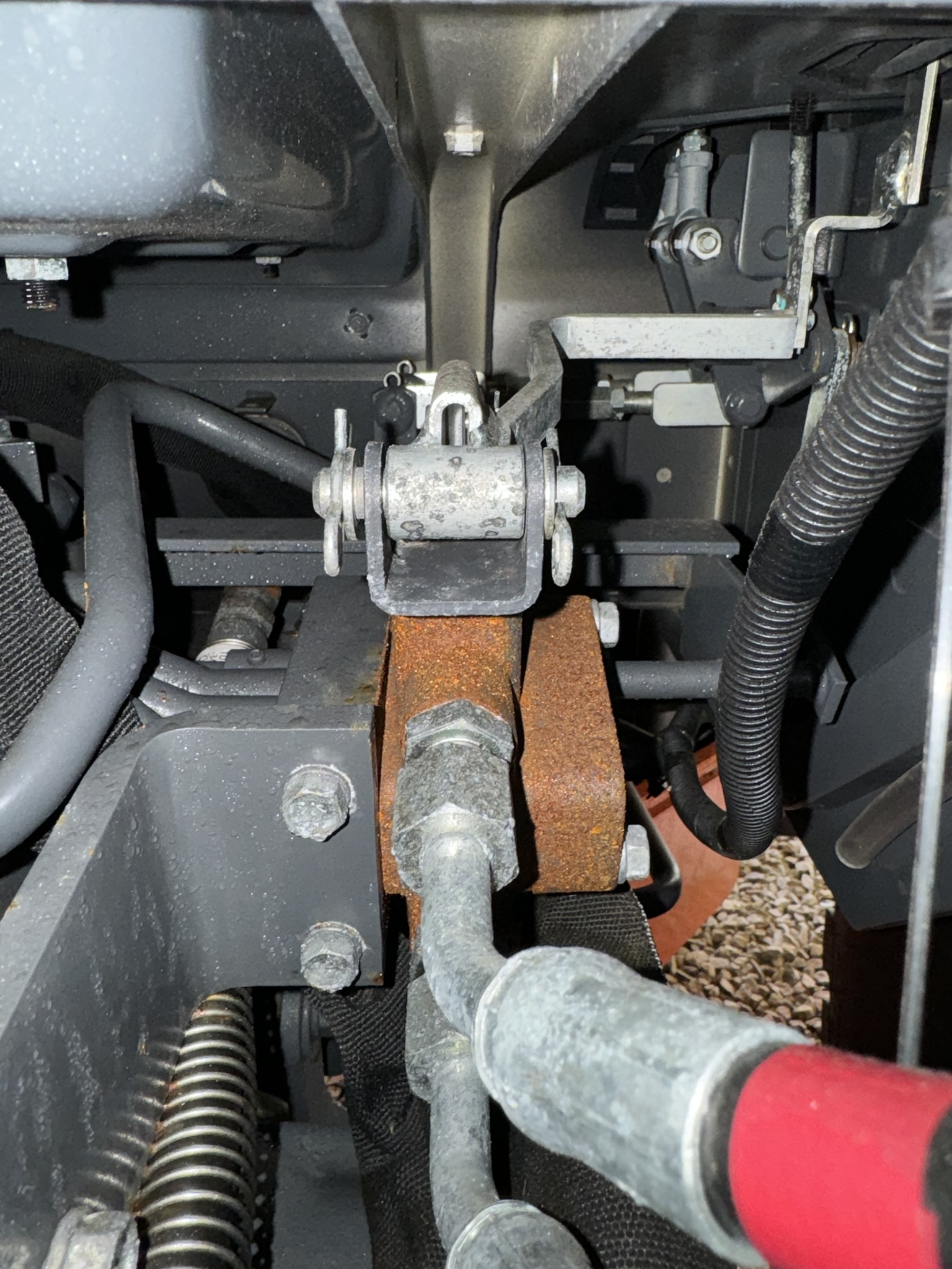

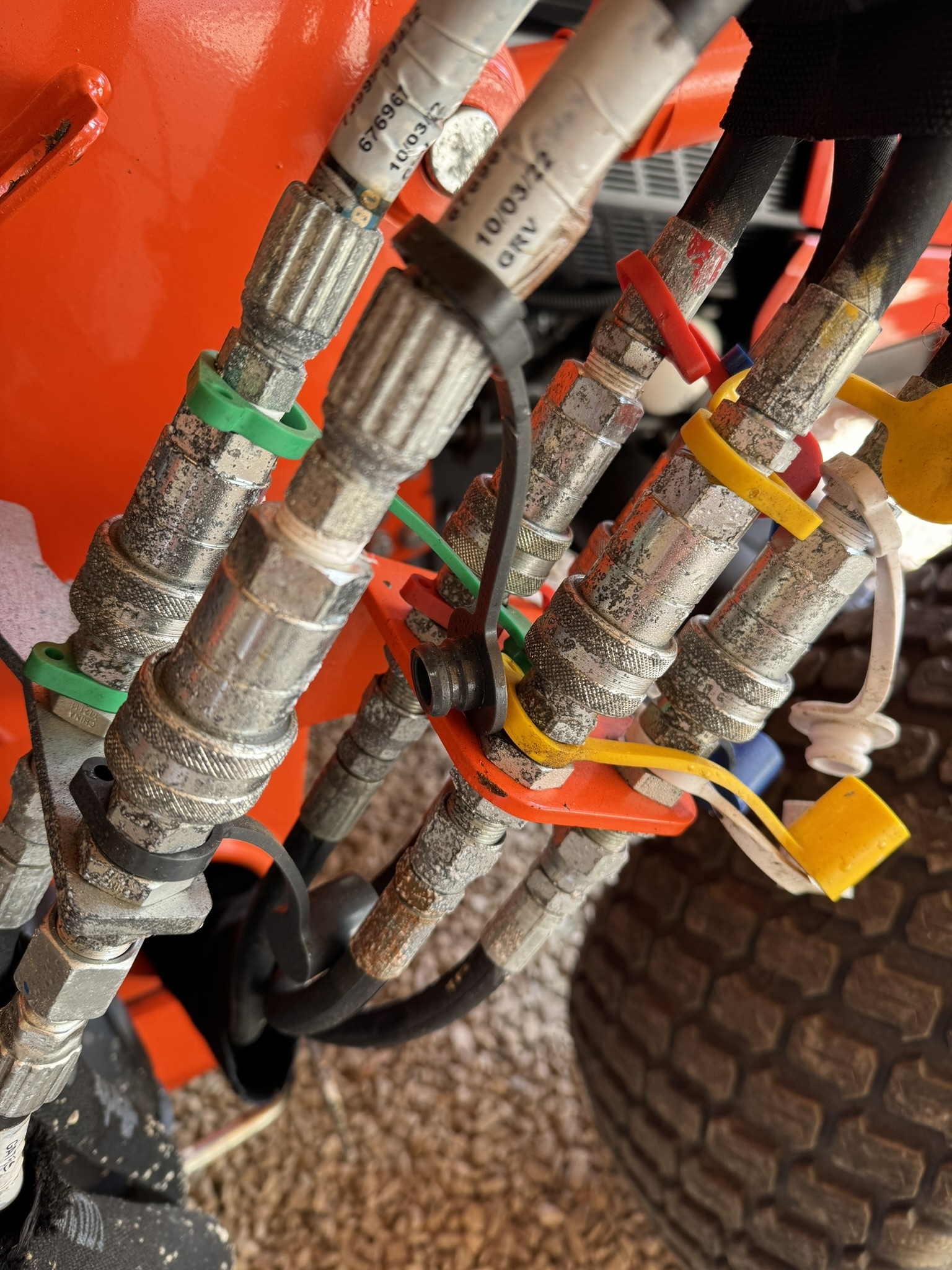

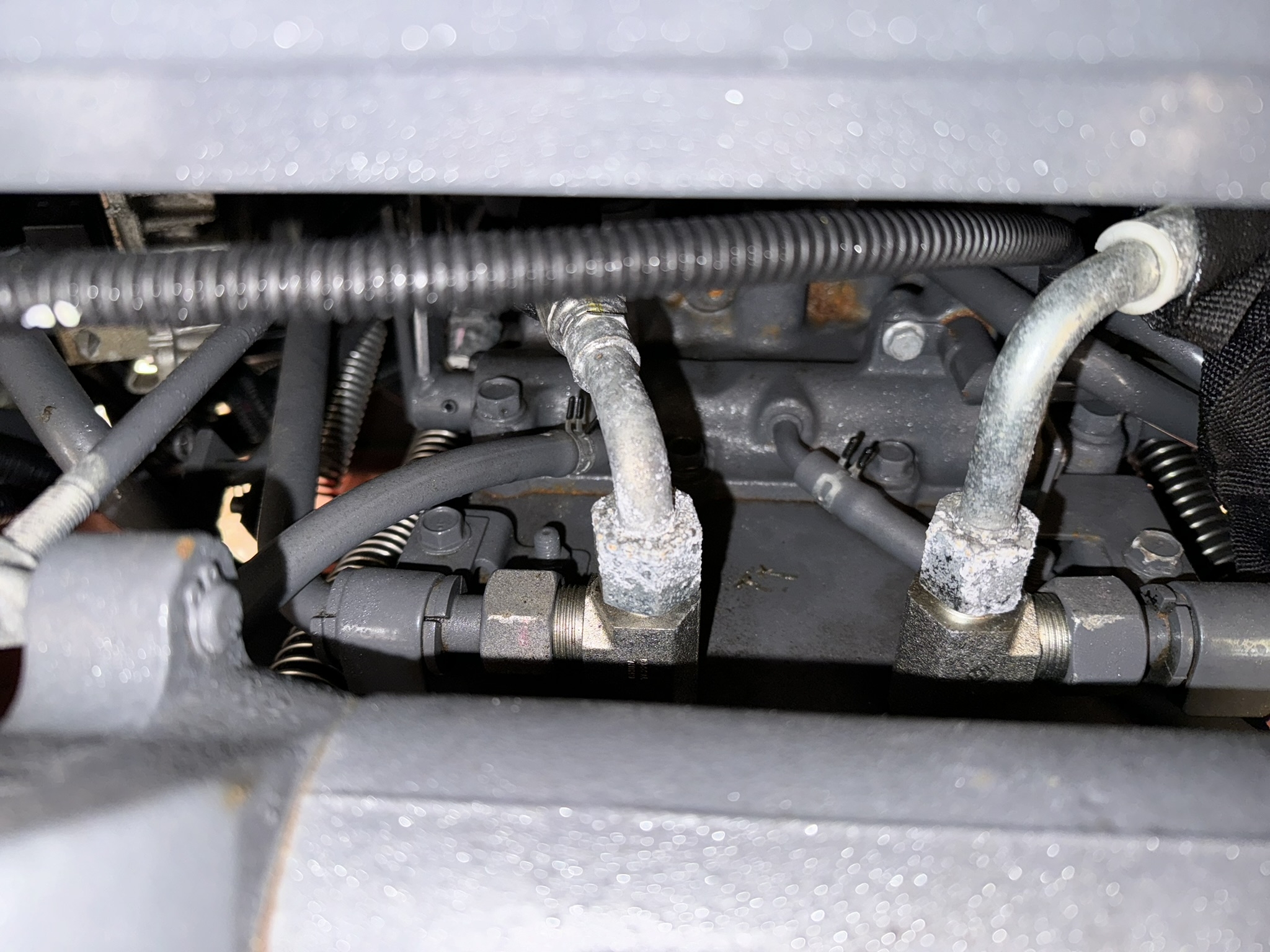

I have a 1 year old Kubota 4760, 2022 model delivered in May of 2023. I am appauled by the corrosion on all the silver plated hardware. The tractor has 55 hours on it, and is kept either in my garage or under a 3-sided barn, it does not see the rain/snow. It stays on my property and gets washed a few times a year. I live in southern New Hampshire, not by the beach. It appears that just condensation has corroded every single plated fitting/hardware item. I have a BH92 on this as well, and all the silver connectors, even hose clamps, are corroded. Am I just expecting too much?
Some of the fittings say China right on them. I'm dissapointed and will now go and try to steelwool/oil all the parts, but what a waste of time. Here are pictures of the hydro connections for the FEL, under the cab and for 3rd funtion valve. I took these pictures a few weeks ago, on a warm morning. You can see some droplets from the humid air on the cold metal. Notice on the middle picture on the cab, some connections have zero corrosion, but most have the oxidation. I really expected more for the money spent on this. Any thoughts or insite? Thanks!
It looks like hard water corrosion, I live in southern New Mexico, a desert, our water is "hard" and fittings look like yours after several washings.

There may be an electrical issue. Possibly a chafed wire touching metal somewhere. Aluminum will corrode when there is electrical current passing through it.

Are you thinking those fittings are aluminum? They look like poorly zinc-plated steel to me. But a magnet would tell for sure.
I'm guessing the corroded surface hose fittings came with some sort of aftermarket or accessory fitting instead of being Kubota tractor parts, because we've seen before that Kubota doesn't pay strict attention to the quality of their accessory manufacturers. But only subcontract manufacturers, not on the tractors themselves.
The fittings in the OP photos seem to be a different color plating from similar types of OEM fittings on our old Kubota backhoe and loader.

Doesn't matter much the metal. For example, you see that corrosion on both ends of a battery cable (copper) from the battery to the starter or solenoid. With the power off it leaks a weak backwards current to ground. Ground would be any part of the tractor that would carry a current including fluids. The plating on the bolts also shows it. The battery will usually test good or indicate it needs recharged. I've seen this quite a few times on aluminum boats. With the boat being wet you can actually see it foaming out of rivets.

I believe you have several contributing factors. First is that condensation regularly soaks the components due to your climate and storage location. Even so, corrosion on a one year old tractor is inexcusable. Next is inadequate plating. Remember that zinc plating is intended as a sacrificial anode that needs to corrode to prevent steel parts from corroding, so a thin layer of Zn turns into zinc oxide (the whitish powder) quickly in the presence of water, especially salt water, which is more conductive. Trouble is, you can't tell thin from thick plating when everything is shiny new, so Kubota's plating specs are obviously insufficient or not followed by suppliers. Also note that steel with yellow zinc plating has an additional top layer of chromate that improves corrosion resistance. Steel wool will do nothing but remove the already-corroded zinc. Oil may help short term, but I suggest cleaning then spraying with a lanolin-based aerosol like Woolwax or WD-40 LANOLIN. Another issue may be that your tractor sat on the dealer lot exposed to the elements over a long period as many do. Does your nameplate show date of manufacture? I bought my L39 used and am unfamiliar with Kubota's warranty, but it seems to me that your degree of corrosion after only one year should be covered.
