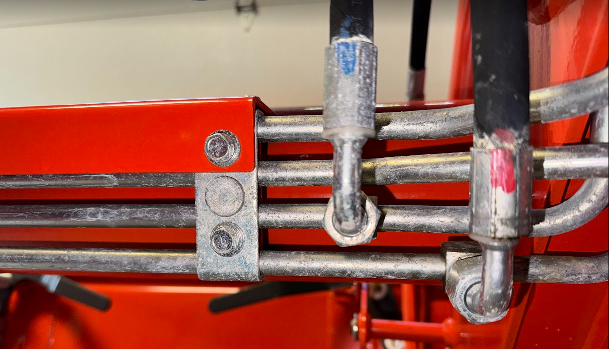

I live about a mile from the ocean and my six year old tractor is stored indoors, so the metal is only occasionally wet. The hydraulic connectors and almost every other shiny surface looks like new, except for the two control levers shown in the photo below. Since everything else is the same, the only difference is the quality of the coating on the metal of these two parts. I noticed the corrosion starting after only one year.

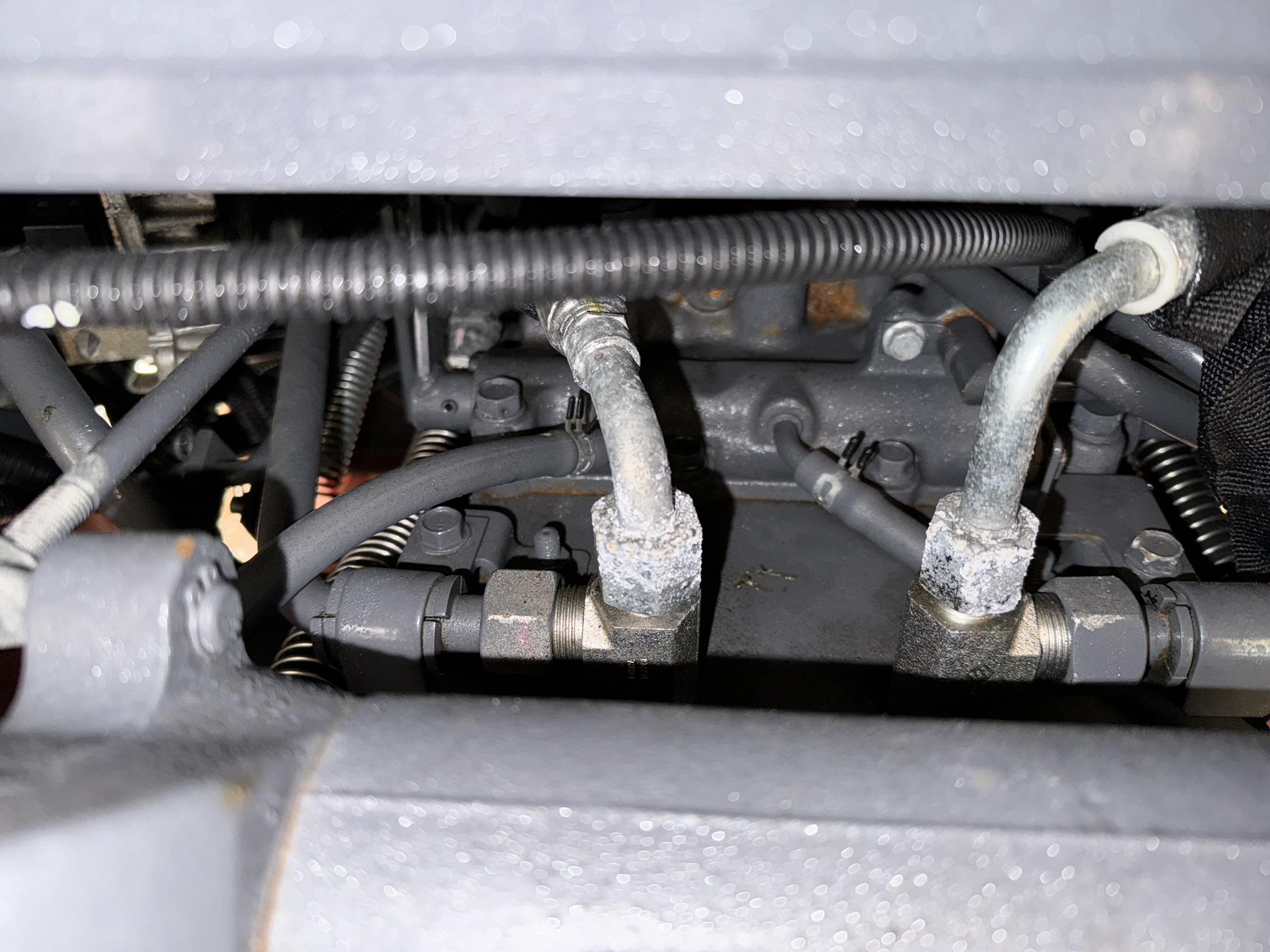

I have a 1 year old Kubota 4760, 2022 model delivered in May of 2023. I am appauled by the corrosion on all the silver plated hardware. The tractor has 55 hours on it, and is kept either in my garage or under a 3-sided barn, it does not see the rain/snow. It stays on my property and gets washed a few times a year. I live in southern New Hampshire, not by the beach. It appears that just condensation has corroded every single plated fitting/hardware item. I have a BH92 on this as well, and all the silver connectors, even hose clamps, are corroded. Am I just expecting too much?
Some of the fittings say China right on them. I'm dissapointed and will now go and try to steelwool/oil all the parts, but what a waste of time. Here are pictures of the hydro connections for the FEL, under the cab and for 3rd funtion valve. I took these pictures a few weeks ago, on a warm morning. You can see some droplets from the humid air on the cold metal. Notice on the middle picture on the cab, some connections have zero corrosion, but most have the oxidation. I really expected more for the money spent on this. Any thoughts or insite? Thanks!

I didn't read all of the 86 or so posts before mine but I would bet a steak dinner its degreaser damage.
Cheap degreasers often have very high PH values that can cause that type of damage wickedly quick. For me its the spotting that gives it away.
Sure it degreases as advertised but corrodes and deteriorates metal / hoses / plastic as well.
Maybe the dealer hit it with degreaser or maybe the OP did. Would be nice to hear back from OP on whether he uses a solvent from a can or maybe through a pressure washer.
heck even some tub and tile cleaners have ph's more than 13 and dawn dish soap is almost 10 and chlorine bleach is 11. Neutral is 7. The chlorine I use in my pool is a 12 on the ph scale and a good wiff of that stuff will teach you quickly what high ph stuff like degreasers can do if not used properly. Even Dawn dish soap can make a mess of stuff.
I'm betting somewhere along the way a wrong cleaner was used or not chamoised off and left to dry naturally.

Are you thinking those fittings are aluminum? They look like poorly zinc-plated steel to me. But a magnet would tell for sure.
I'm guessing the corroded surface hose fittings came with some sort of aftermarket or accessory fitting instead of being Kubota tractor parts, because we've seen before that Kubota doesn't pay strict attention to the quality of their accessory manufacturers. But only subcontract manufacturers, not on the tractors themselves.
The fittings in the OP photos seem to be a different color plating from similar types of OEM fittings on our old Kubota backhoe and loader.
The fittings in the OP photos seem to be a different color plating from similar types of OEM fittings on our old Kubota backhoe and loader. They are. Ours are Zinc Cad. that offer good protection.

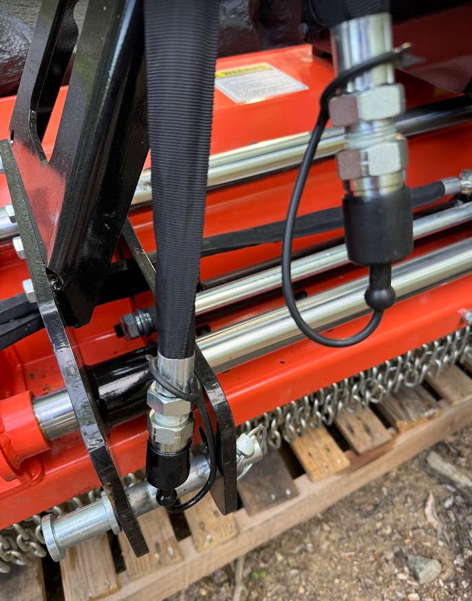

I'm thinking this is a quality problem. I'm not trying to brag up a different brand, but here is a photo I took two minutes ago of the bucket fittings of my tractor. It's a 2016 tractor that was used only for salt spreading and snow removal before I bought it two years ago. Severe duty! You can see the rust on the green painted parts, but please note two things: 1) The black painted steel hoses to the bottom left... They were dealer replaced just before I bought it as they were severely rusted, and 2) The lack of corrosion on the original, stock, plated hydraulic hose fittings.

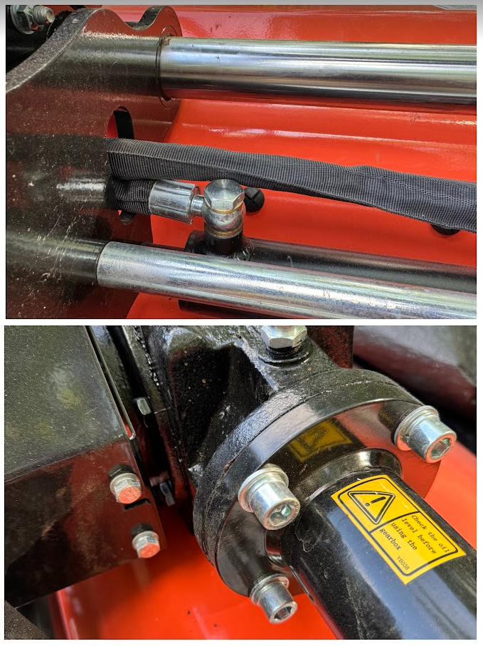

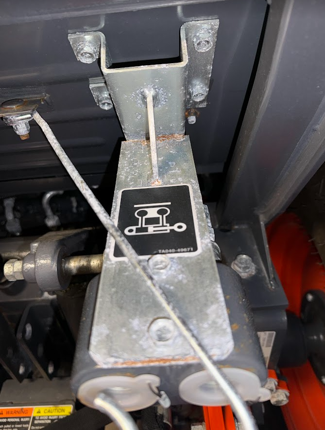

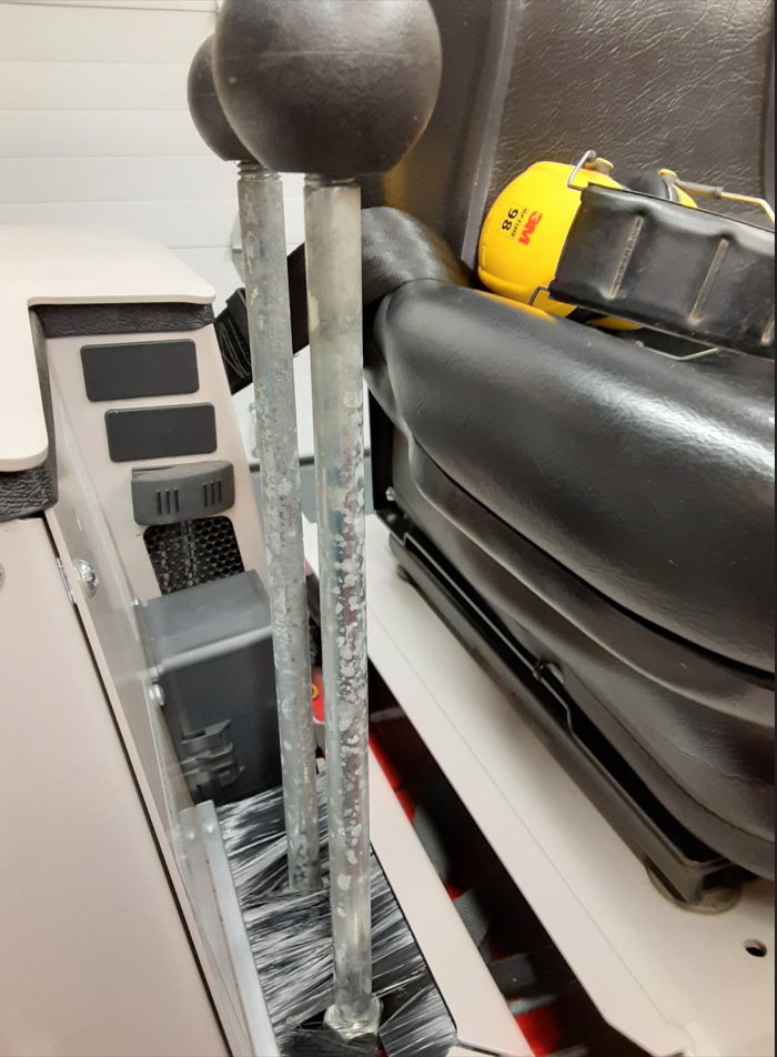

I do not use anything on the tractor other than filtered house water and car wash soap... I shouldn't have too, it's brand new and doesn't see livestock, road salt or anything corrosive. No caustic degreasers or special solvents. I've litterlly washed it maybe three or four times. In the original photos I took, that was and oddly warm humid morning in the beginning of May, everything had condesation on it. The barn I stored it in over the winter gets quite good airflow as one side on bottom level and one on the second story is open.
To reiterate, I have a bunch of other equipment in the same space that does not exhibit this corrosion.
The corrosion is the worst on the hydraulic parts. Most of the zinc plated parts on the bucket and backhoe only show slight white oxidation marks. Under the cab and by the FEL connections are the worst. Under the cab, I don't think the dealer installed a painted 3rd function valve, there isn't a spot of paint on it. I'll be asking them to fix that along with the FEL connections.
I don't think this is galvanic corrosion, or at least not yet. It really looks like the tractor was exposed to something that didn't wash off, in combination with poor plating. I will update the post when I hear back from the dealer. Thanks again.
