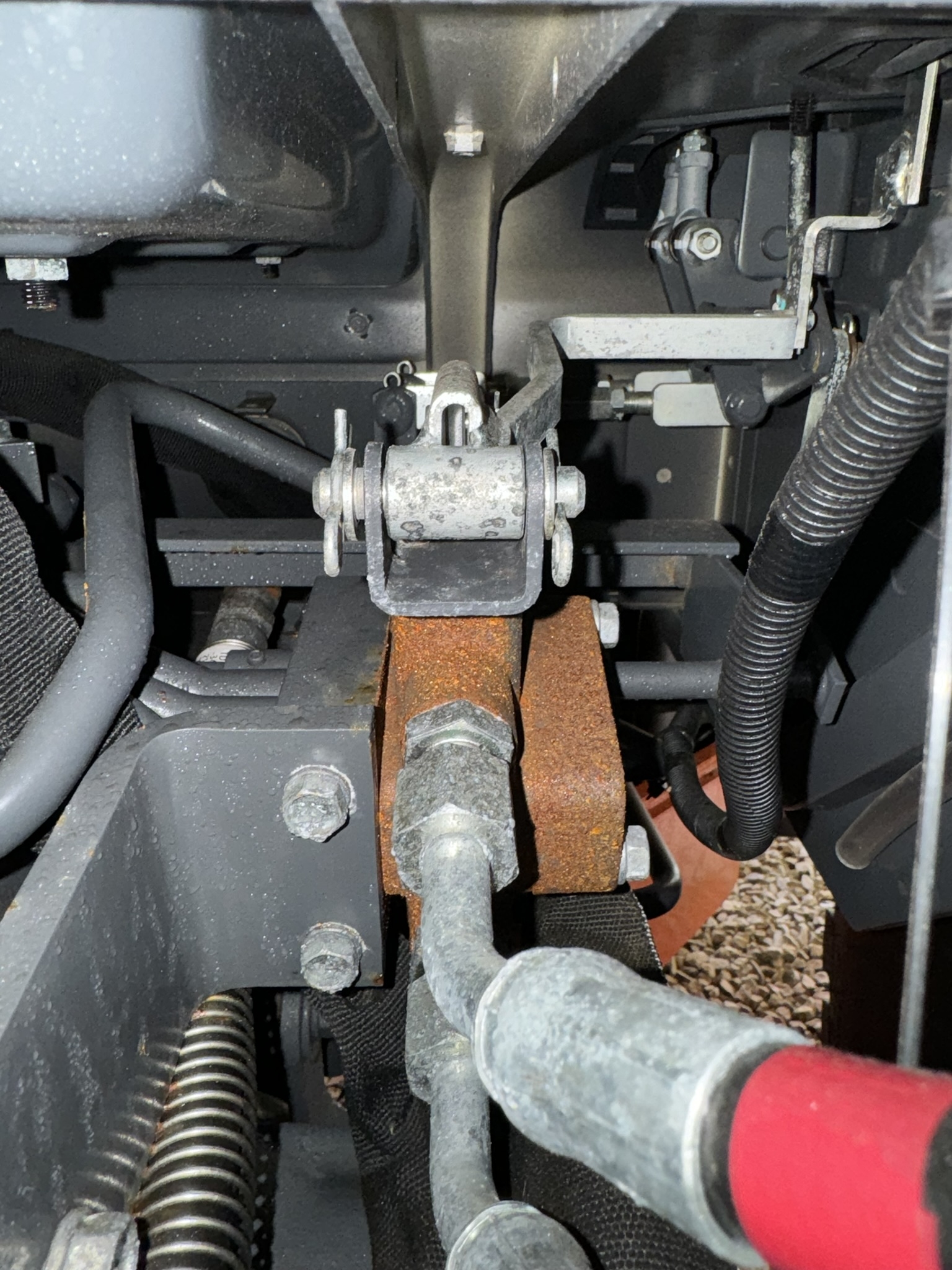

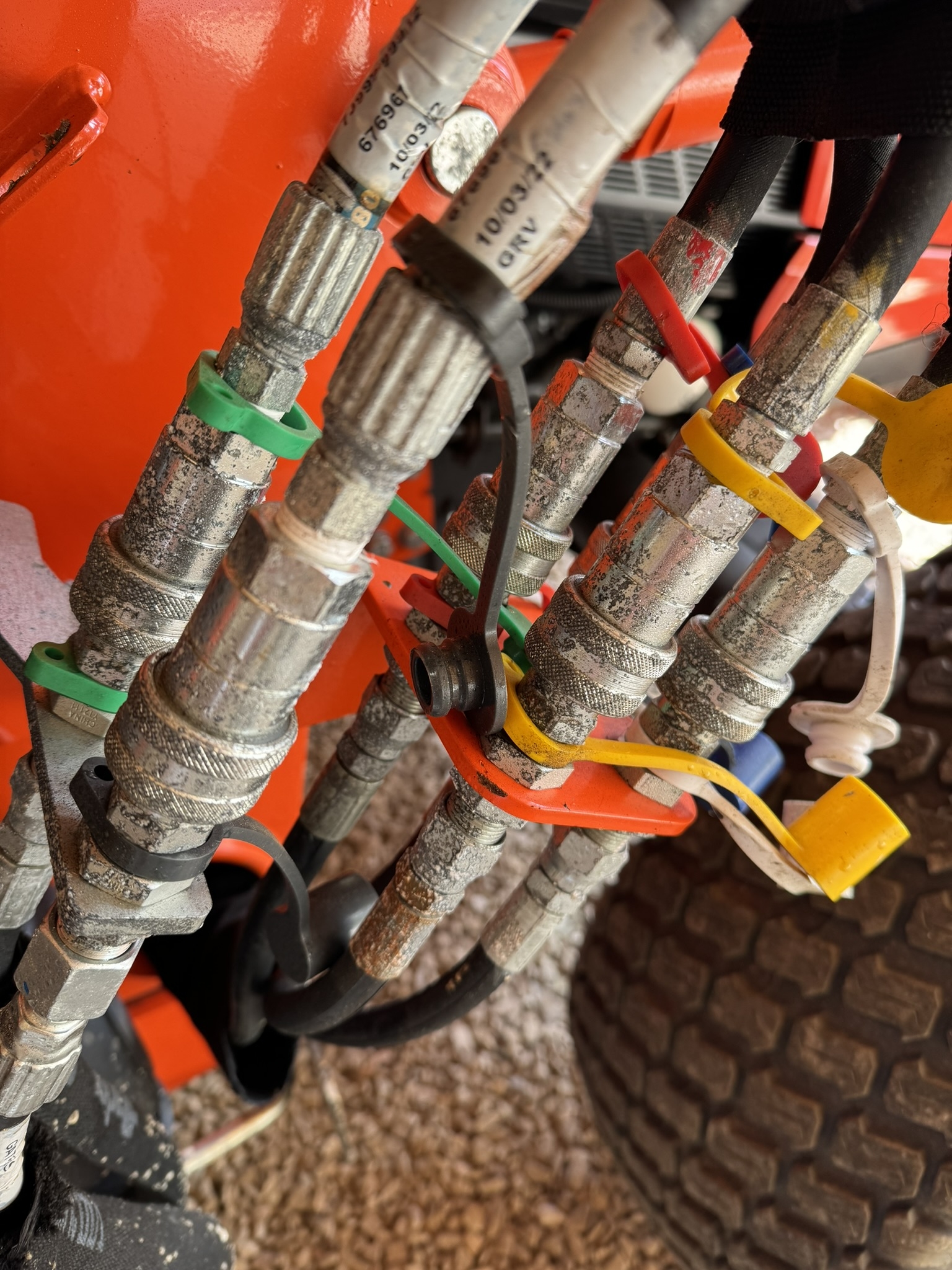

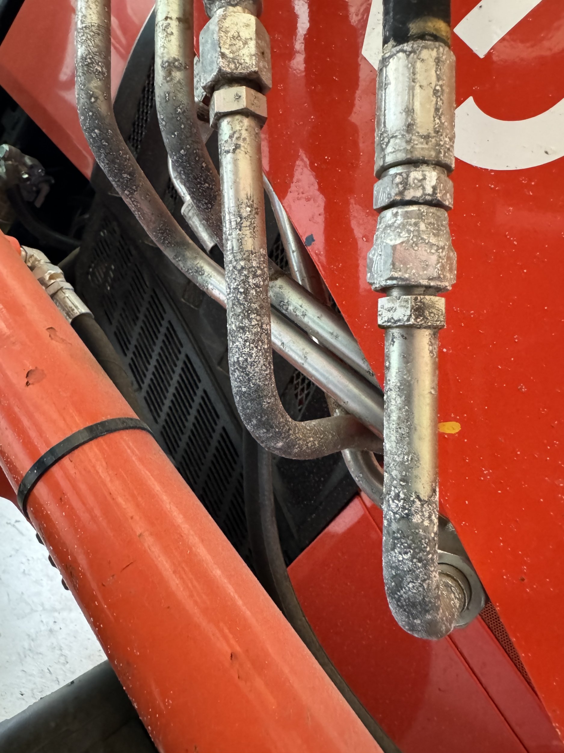

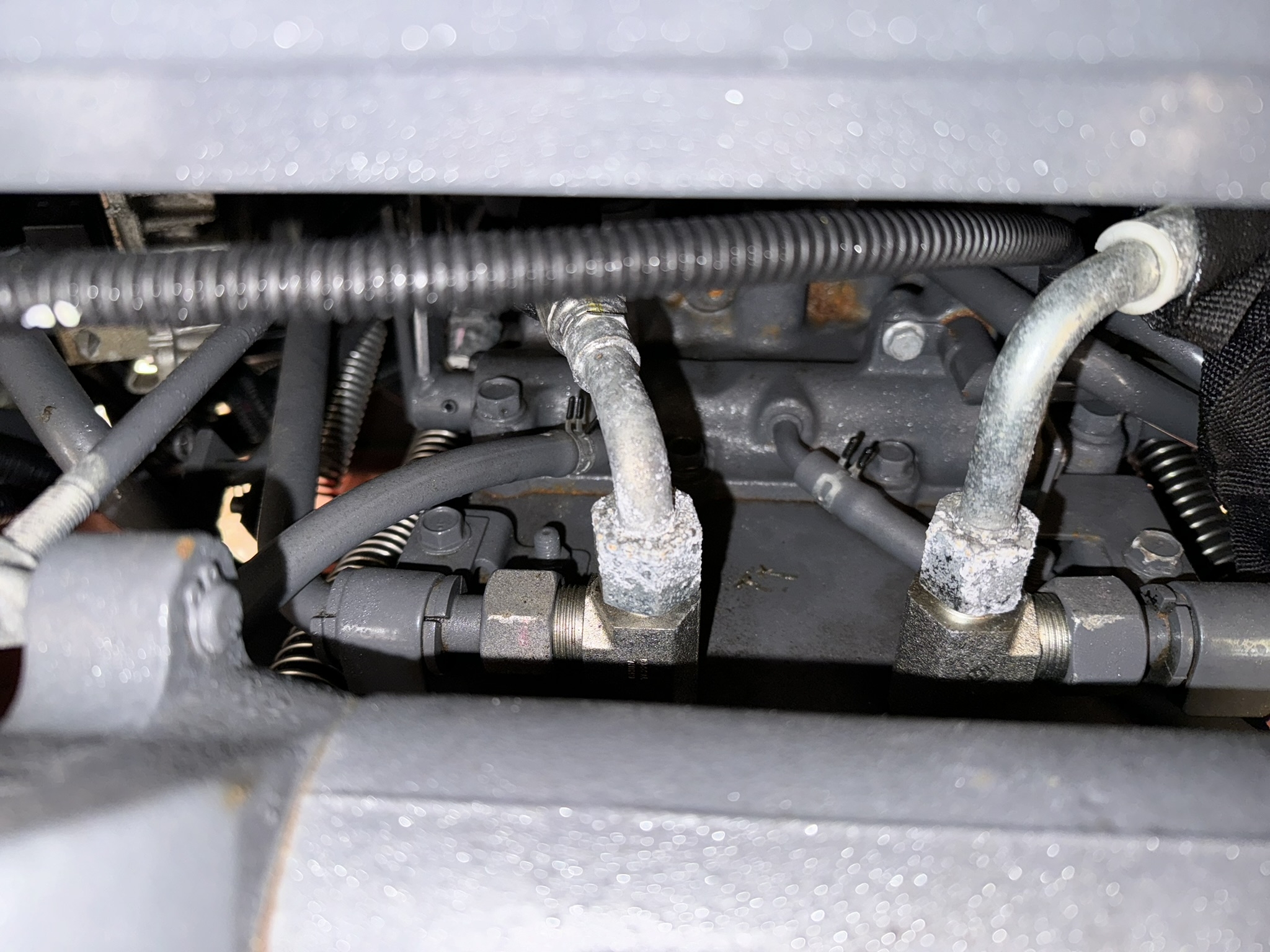

Hello All, I have been reading a learning a ton on this site. Thank you to all who contribute.
I have a 1 year old Kubota 4760, 2022 model delivered in May of 2023. I am appauled by the corrosion on all the silver plated hardware. The tractor has 55 hours on it, and is kept either in my garage or under a 3-sided barn, it does not see the rain/snow. It stays on my property and gets washed a few times a year. I live in southern New Hampshire, not by the beach. It appears that just condensation has corroded every single plated fitting/hardware item. I have a BH92 on this as well, and all the silver connectors, even hose clamps, are corroded. Am I just expecting too much?
Some of the fittings say China right on them. I'm dissapointed and will now go and try to steelwool/oil all the parts, but what a waste of time. Here are pictures of the hydro connections for the FEL, under the cab and for 3rd funtion valve. I took these pictures a few weeks ago, on a warm morning. You can see some droplets from the humid air on the cold metal. Notice on the middle picture on the cab, some connections have zero corrosion, but most have the oxidation. I really expected more for the money spent on this. Any thoughts or insite? Thanks!

Looks like salt corrosion
/ New Kubota Corrosion
It totally looks like salt corrosion, I don't use salt at my property at all. I've seen parts go through salt spray tests, this looks really familiar. I just use car wash soap with filtered well water, 8.4ph in the normal range. I'm guessing most of the fittings are zinc plated. It looks like the stainless ones are fine, but there isn't many of those.

Looks like the hydraulic block in your 3rd photo was not painted at all.
The condensation will eventually do this to most of your hose ends. The zinc plating is better on some, vs. others. Also, if you use the tractor around fertilizer or livestock, corrosion will be greater.
I like to grease my JIC hose fitting threads because eventually you get rust in there, too.

If you have a central air conditioning unit or heat pump remove one of the panels on the compressor housing and see if the compressor condenser is showing the same corrosion. You will then know if your local air is causing the problem.
