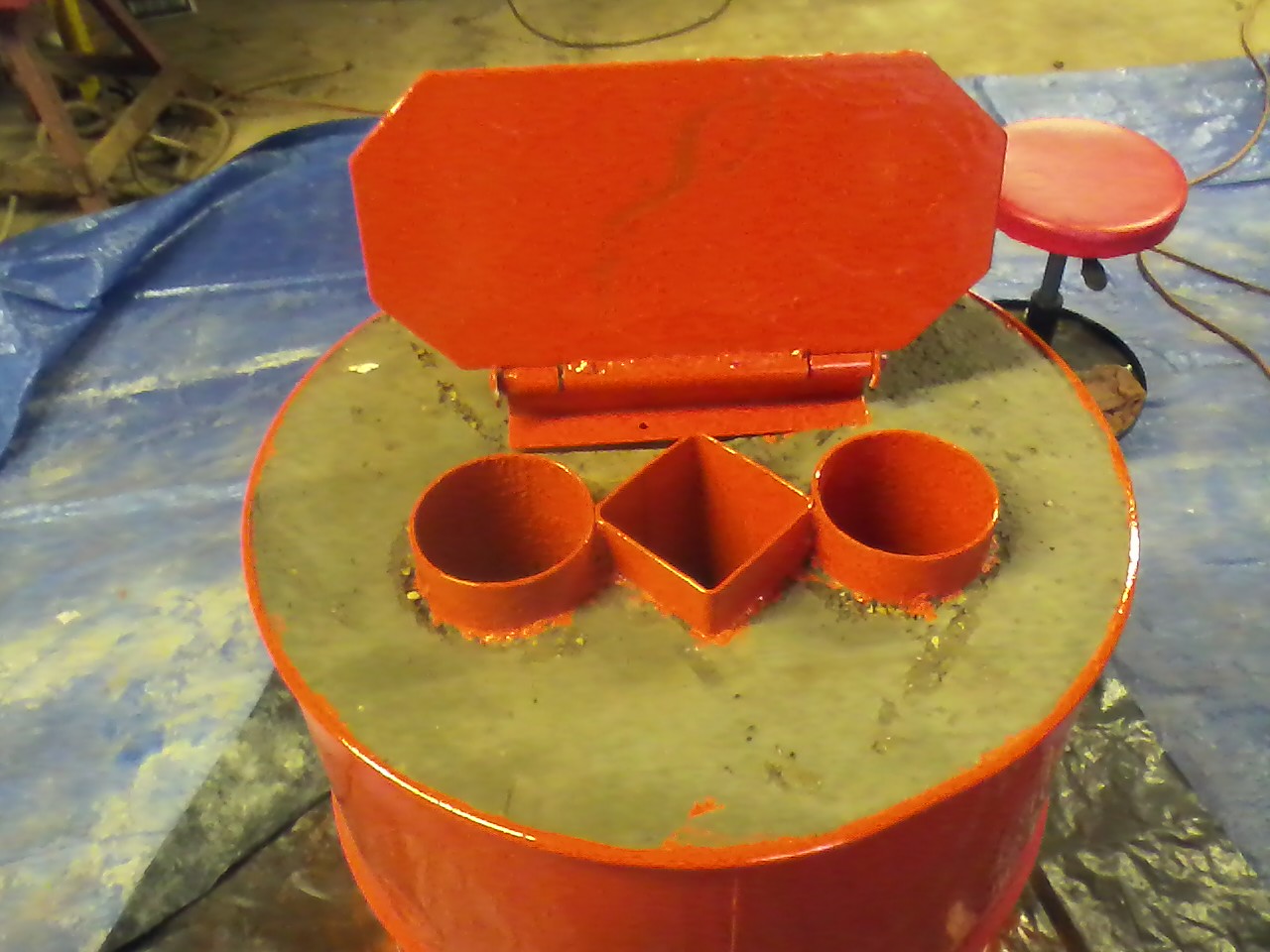

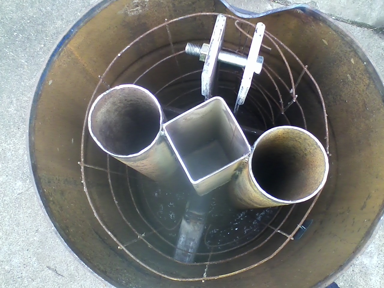

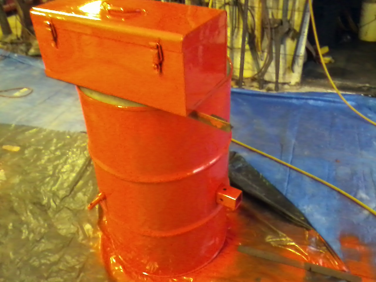

This is my second barrel ballast box. Really like it.
On my first one, mounted the three point in center and added a trailer hitch. On this one, moved barrel to rear about 5" past center and added a receiver to be more versatile .
1. Construction
2. Without tool box
/ Concrete barrel ballast box idea #11

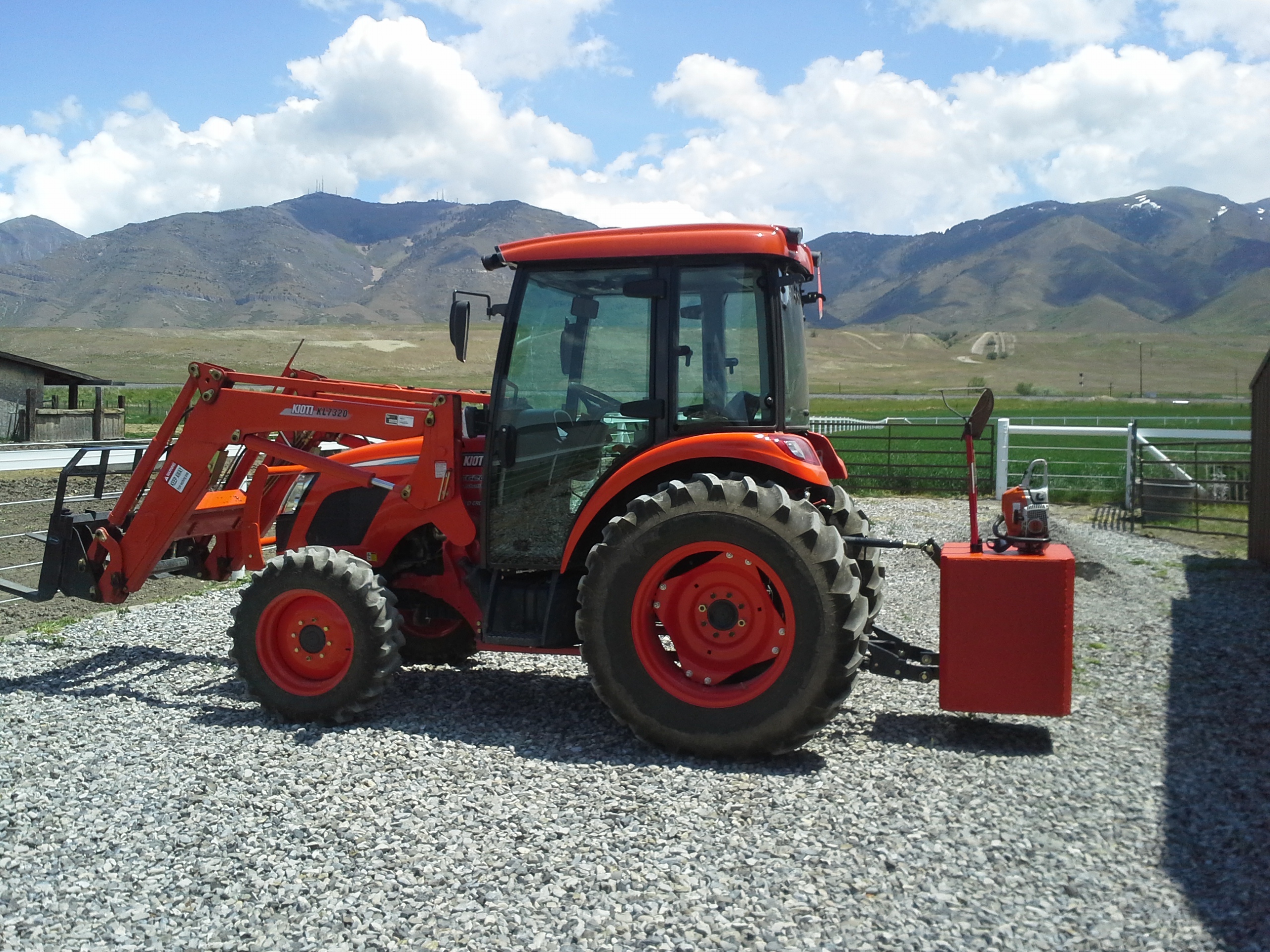

3. When we go on disaster relief, we install this tool box.

There are times when we like to have either our bush hog or our stump saw on the back, but when we are working with a chain saw disaster relief group, we wouldn't want anything but our barrel. If the rear wheels will miss any object, you probably don't have to worry about how short you are turning. It is going to miss. Between the barrel & my mirrors in the cab, we seldom ever have to look back. Working all day long with the grapple for a week or two at a time, in tight situations, it becomes very desirable.

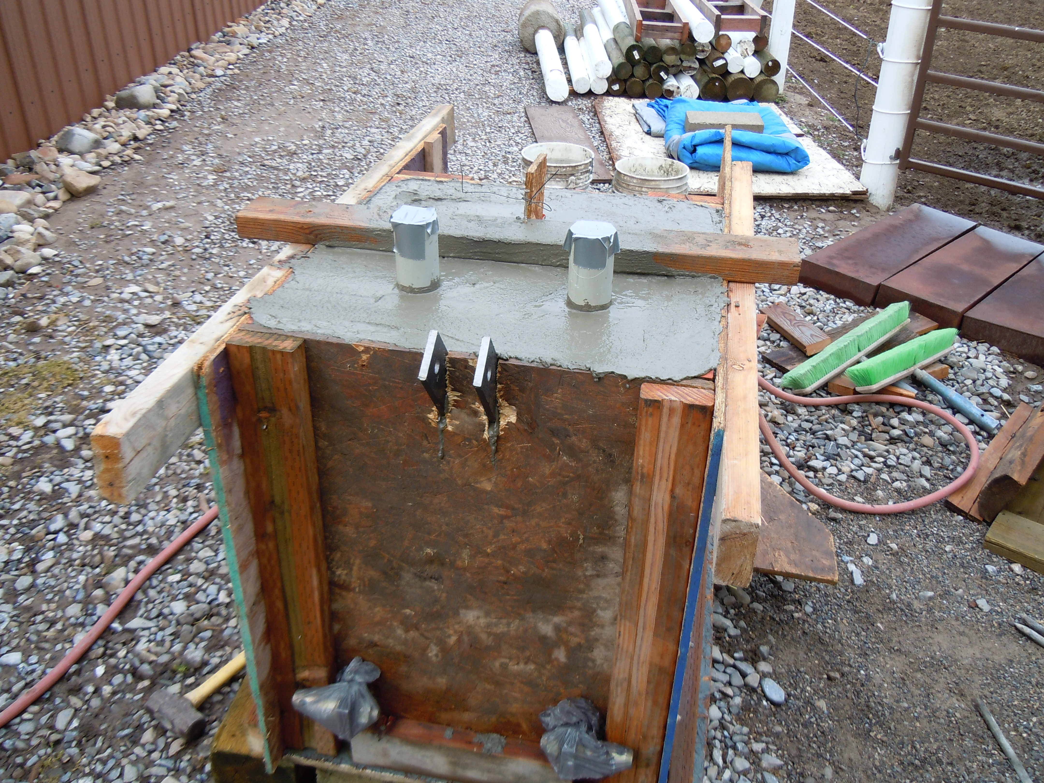

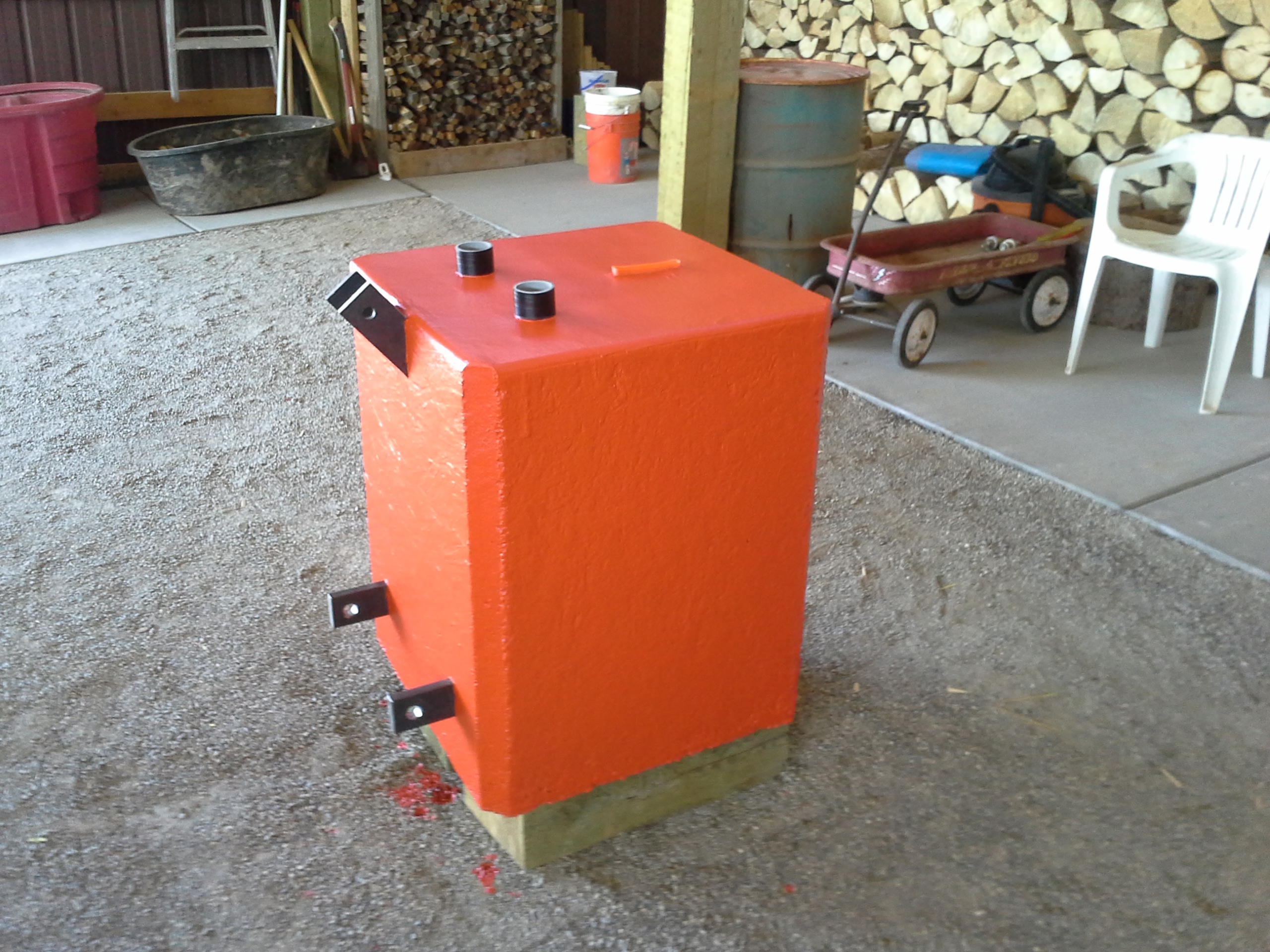

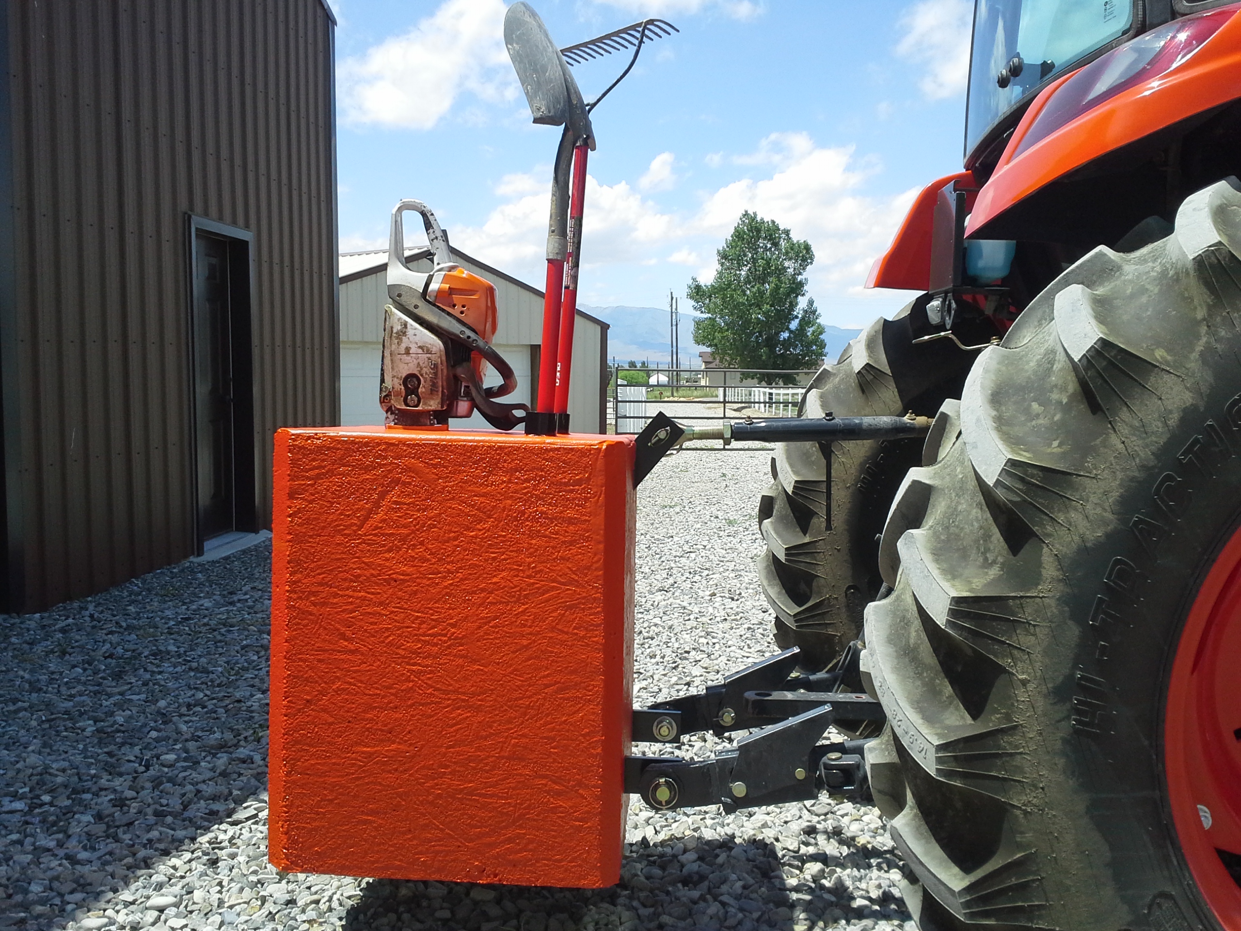

Here is one I built this year. Tips the scale between 1500 & 1600 pounds. Sounds like it's what you are looking for. Nothing is welded inside. It's all drilled and bolted together with all thread.
Just realized I have responded to you about ballast boxes in your tractor thread.:laughing:
View attachment 522554View attachment 522551View attachment 522552View attachment 522553

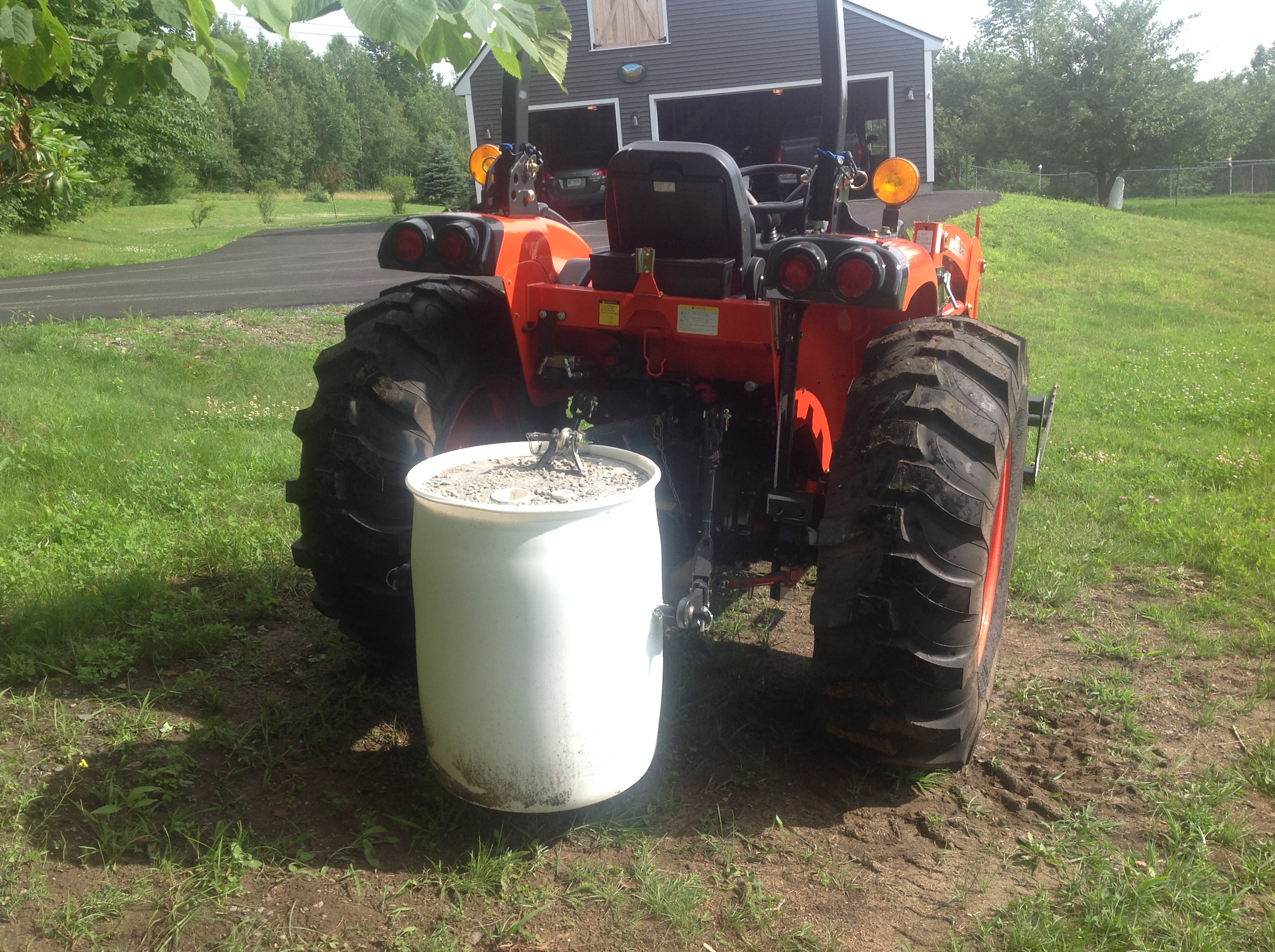

My 55 gallon drum is mostly filled with rocks with cement around them. I didn't bother putting any PVC pipe inside since I rarely use the weight with tools like a shovel. The lower pins are just ones from TSC with a piece of steel pipe connecting them together. I welded one of the nuts that came with the pin to each end of the pipe and screwed the draw pins in from the outside. The lower pins are pretty much centered. The top link mount is just made out of scrap steel and just welded to the drum. The top link is set shorter than the bottom so when lifted all the way up it tilts in but not enough to bother anything. I probably spent less than an hour on making it. most of it was cutting the top of the drum off.
If I was to do it again I might make something like Cat fever did but it wouldn't stick that far back. For me if I would rather use more cement and keep it close to the tractor for working around stuff than loose maneuverability. But I use mine for snow blowing in the winter where I want to back close to things and in the wood skidding trees.

The good thing about building your own is designing it to fit your needs.
BMan (or anyone for that matter) needs to make a checklist of potential needs/uses, then make the Ballast box to fit those needs. Crazyal's needs are different than mine for sure.
Here is a shot of the main reason for my needing a ballast box, aside from the occasional dirt or gravel moving.
Hard to see the box, but it's back there.:)
