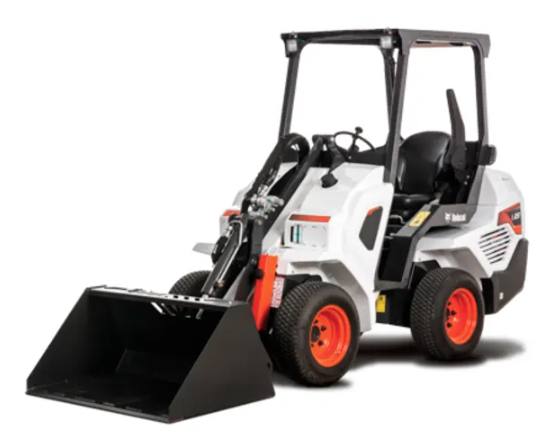

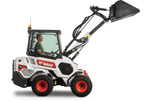

If Kubota made several smaller classes of loader than this. Make it with skid steer loader attachment and a 3 point hitch in the rear for your "old style" implements
Bruce
Bobcat makes smaller ones but no 3 point because articulated steering would drag the attachment sideways: https://www.bobcat.com/na/en/equipment/loaders/small-articulated-loaders?perPage=11
