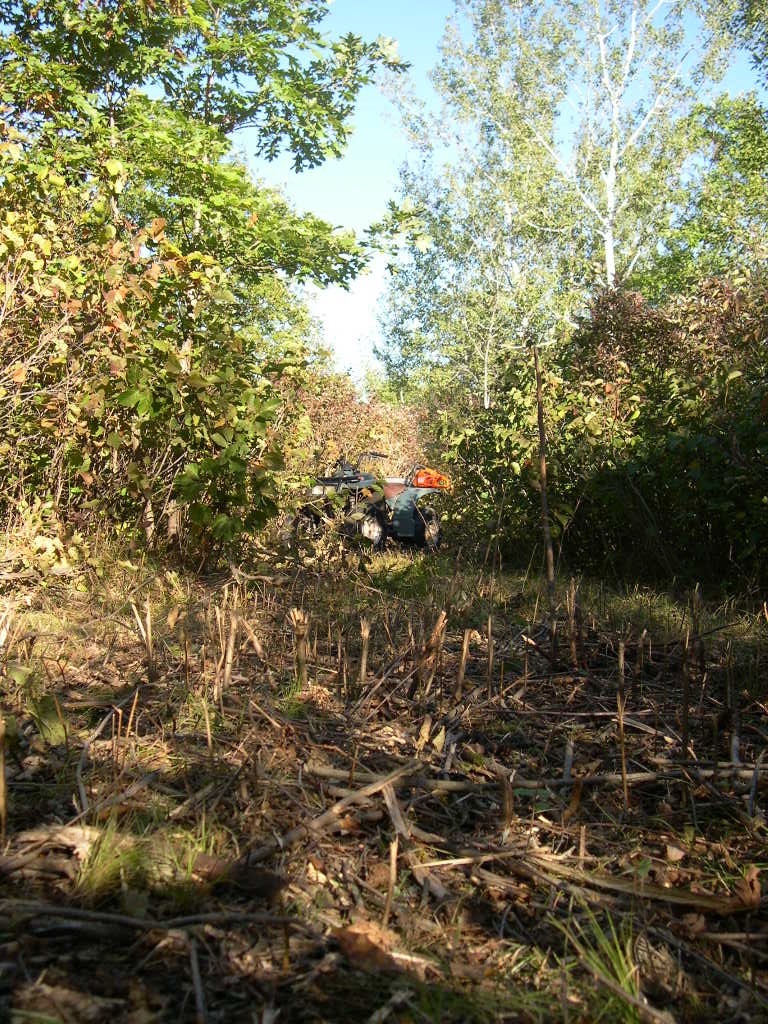

Sooooooo, I cut 8' tall brush up to 1" diameter
With this 15hp grey market CUT
I think it is as cute as those Powertracs:)

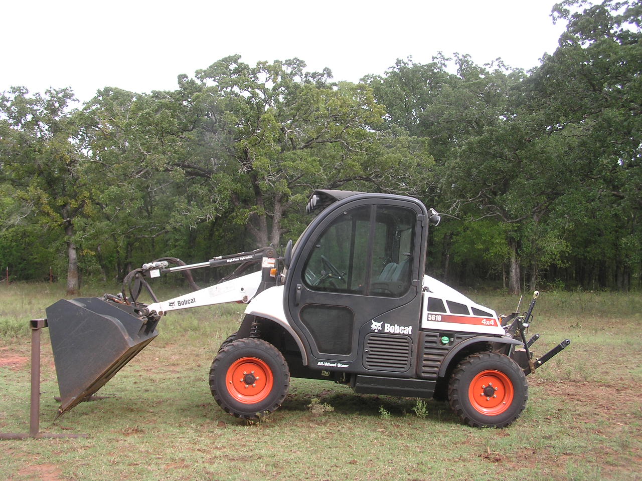

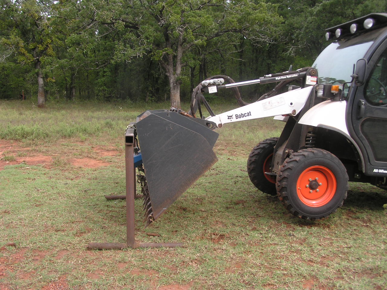

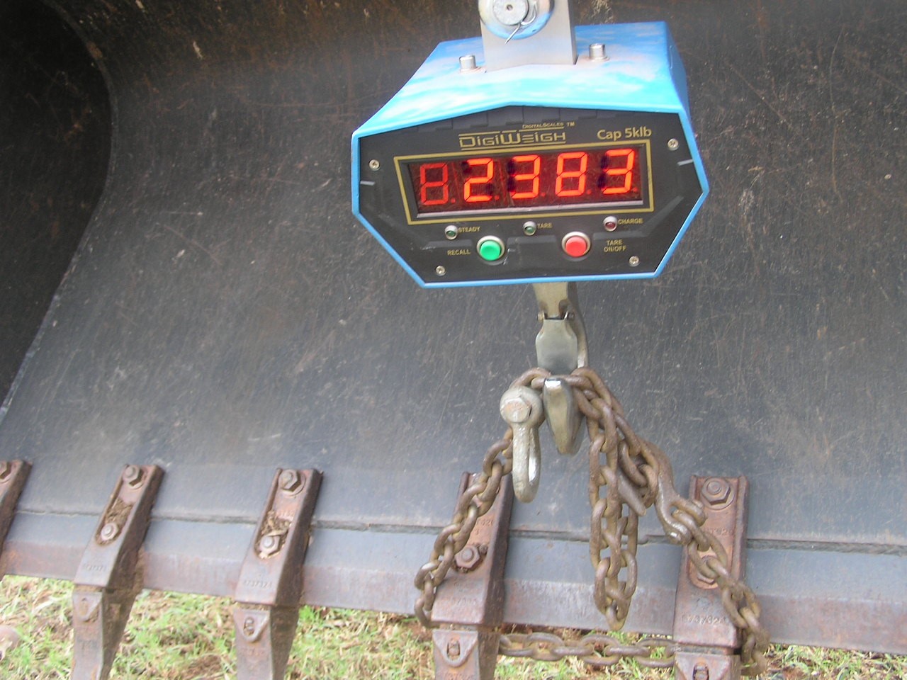

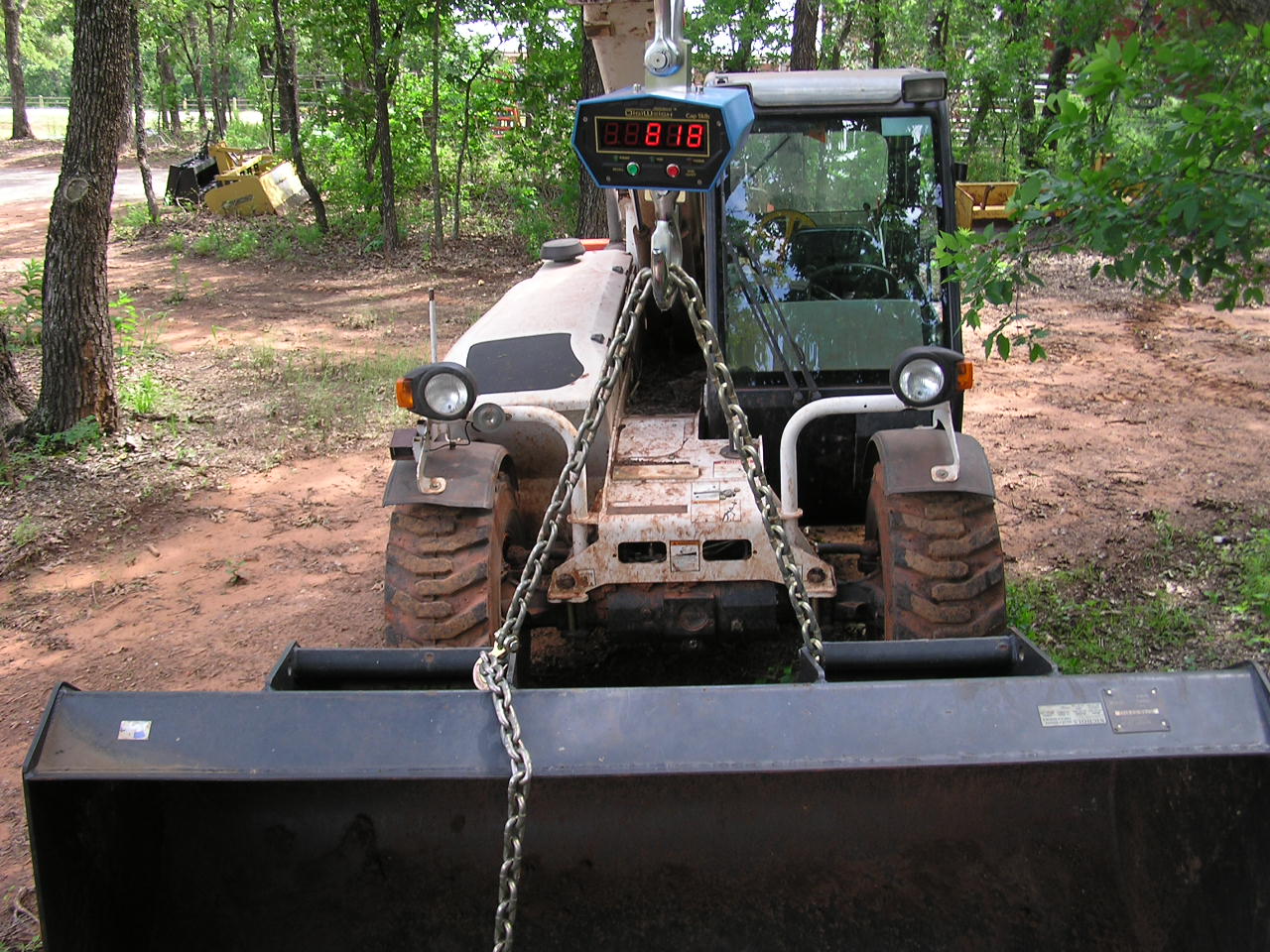

And how much weight can you bring to bear on those teeth if the front wheels are off the ground? Tons! 👍

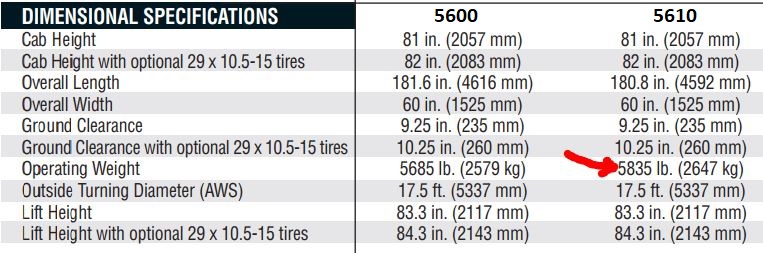

Decided to update this, since the thread became active again.
Used the crane scale to measure the weight on the bucket teeth:
2,383 pounds, not as much as I expected:
The bucket weighs 818 pounds and the Toolcat weighs 5835 pounds:

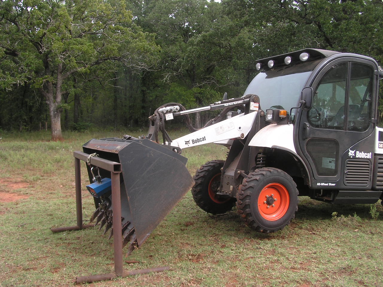

/ Compact Tractors are Designed All Wrong #399
Yep, 8 real sharp teeth:
