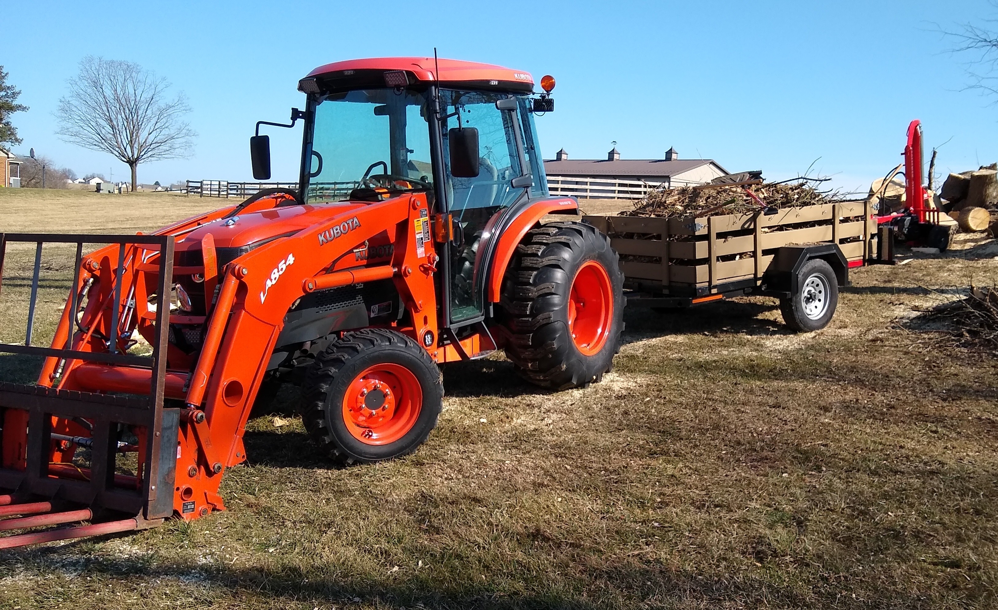

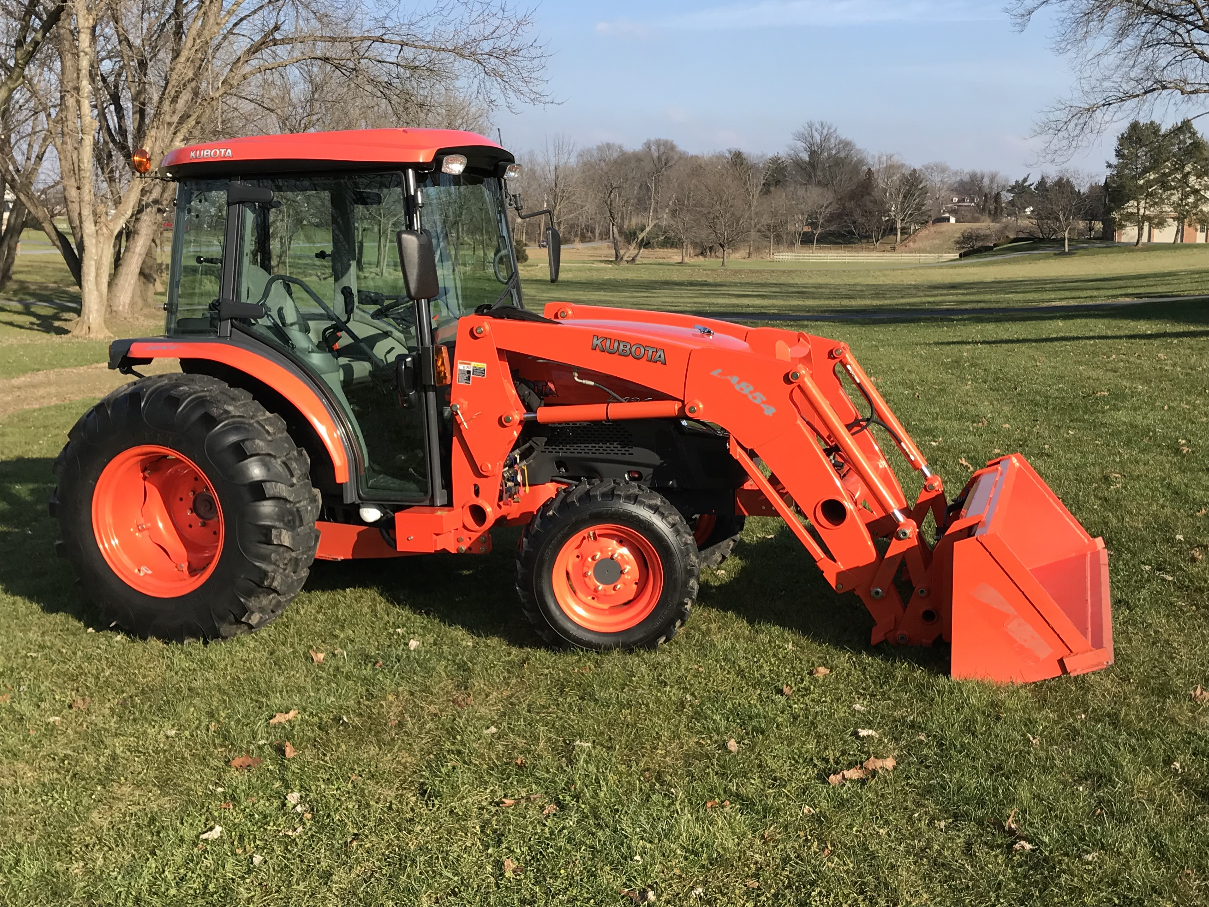

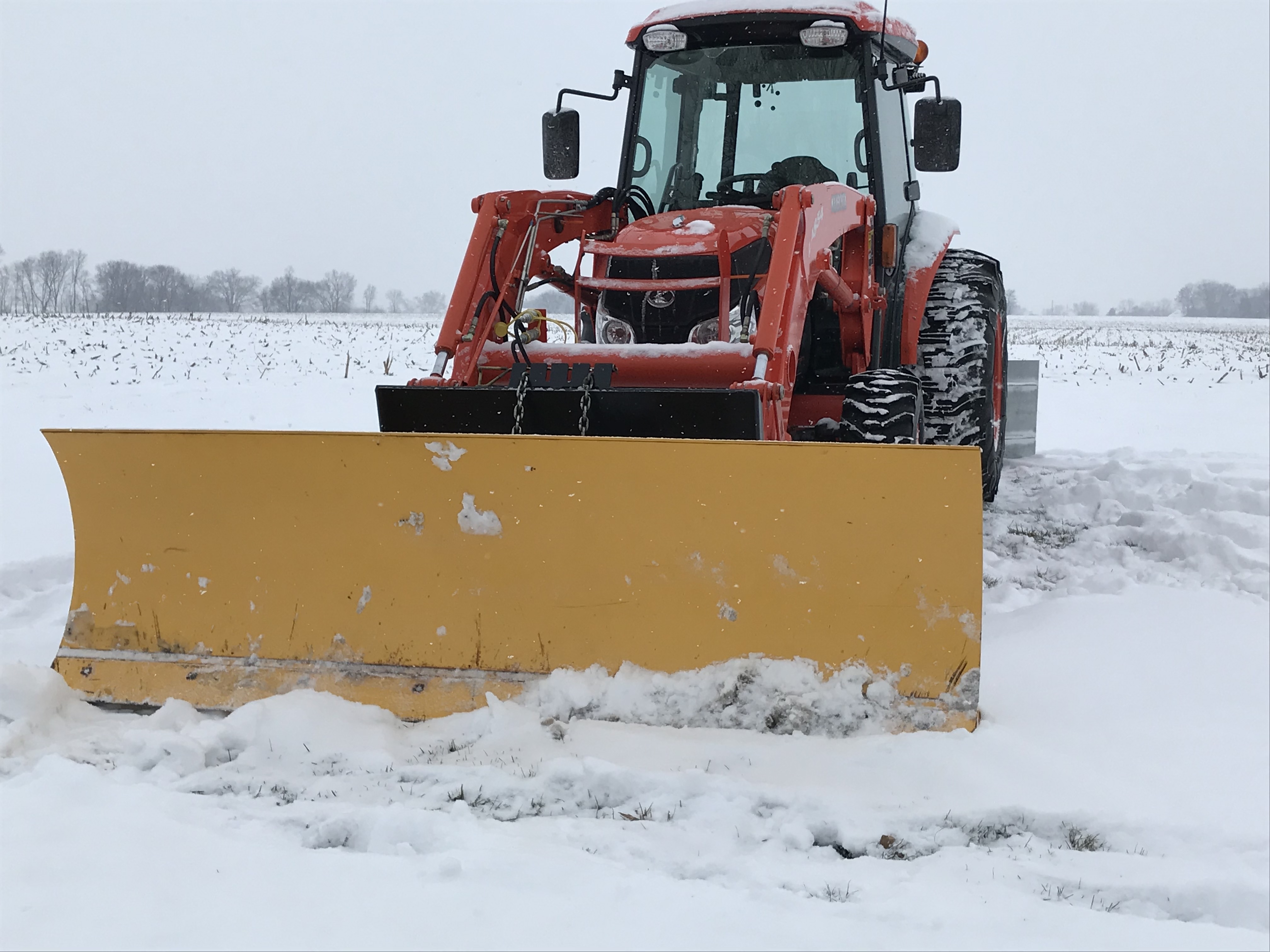

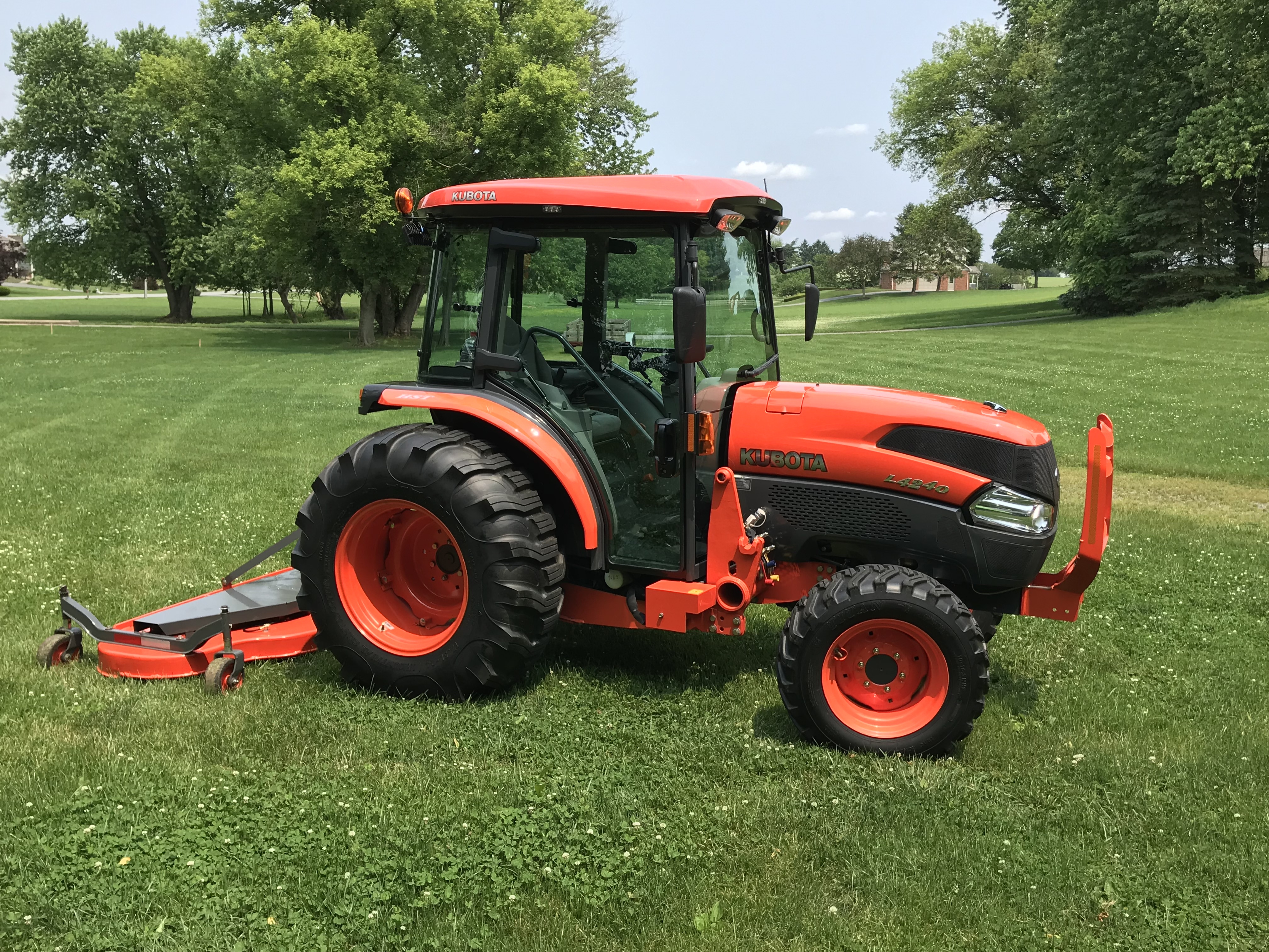

This is my 5th tractor and it does everything for me. It wears a 90" RFM, and it does our 3-1/2 acres in around 1-1/4 hours at a sensible speed (or just under an hour if beating the snot out of the equipment an your body is your desire). Prior to owning a factory cab with heating and cooling it was difficult to fully understand how nice life can be when in the hot, cold, dust, pollen, bugs, snow, rain, etc.
I do have a small Ford (first real-ish tractor) that has become my "mule" with the addition of a box 3-point attachment. There's still a 5' RFM and a few other attachments for it if needed. Right now it's handy for tossing tools and fuels in.
