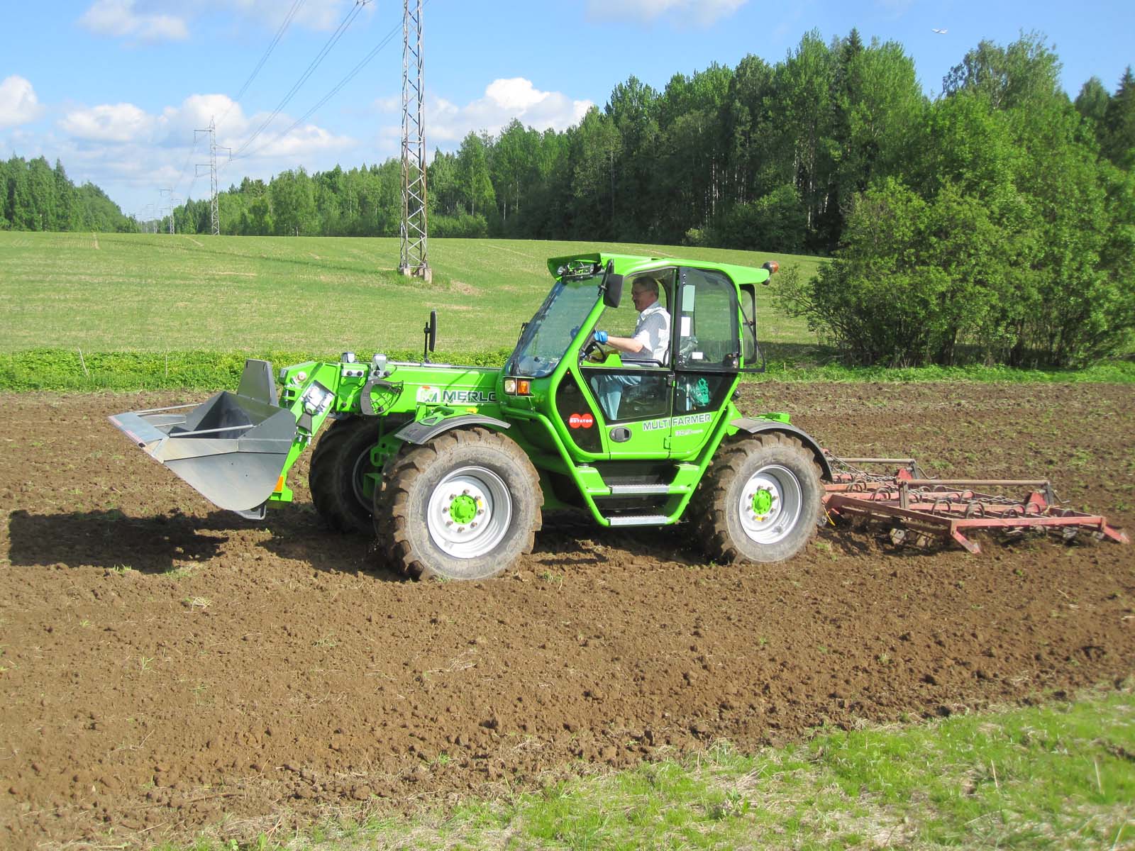

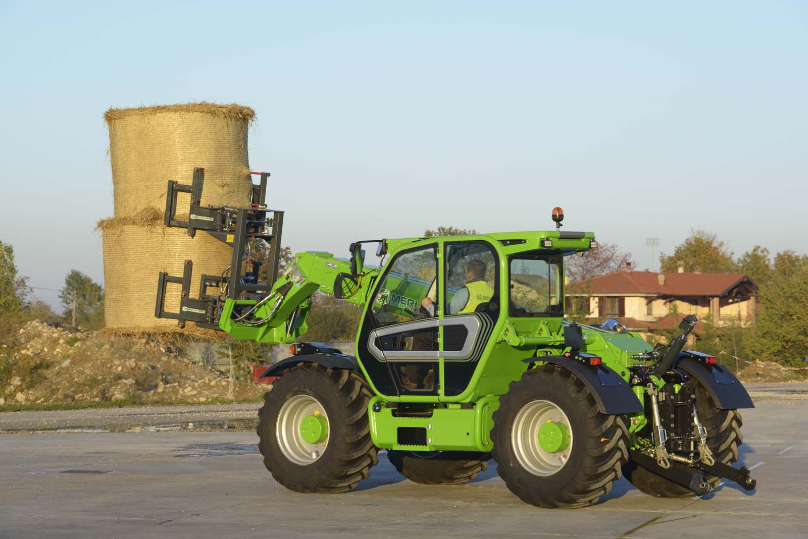

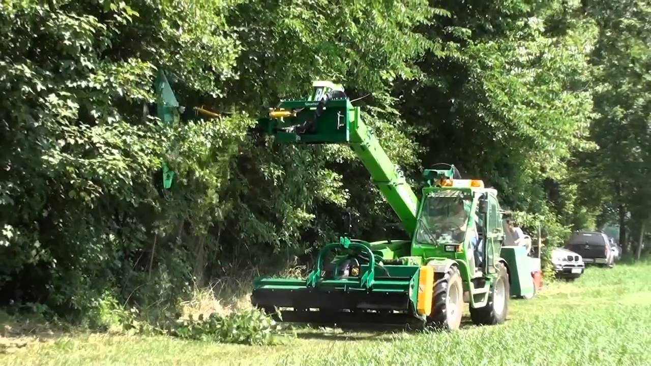

I've never seen a telescoping boom on a PowerTrac.
And one of the things PowerTrac owners like is that there are NO computers. The brute simplicity of the machine is what most of us enjoy. Keep it simple so it's easy to work on yourself.
