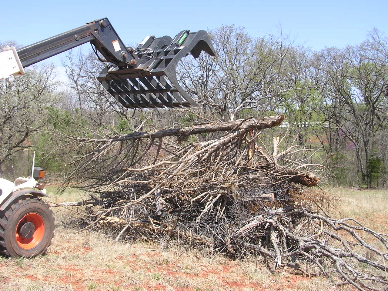

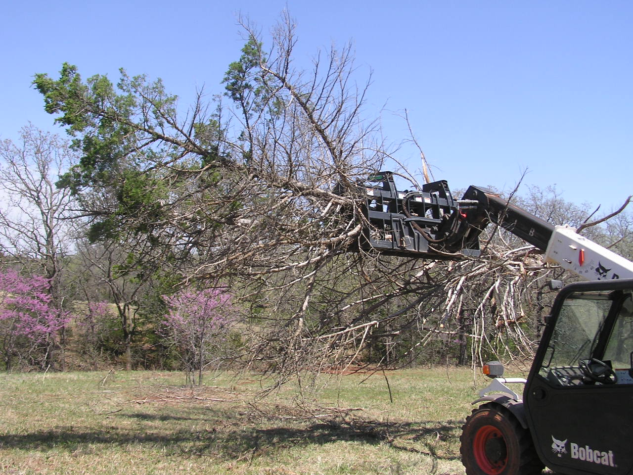

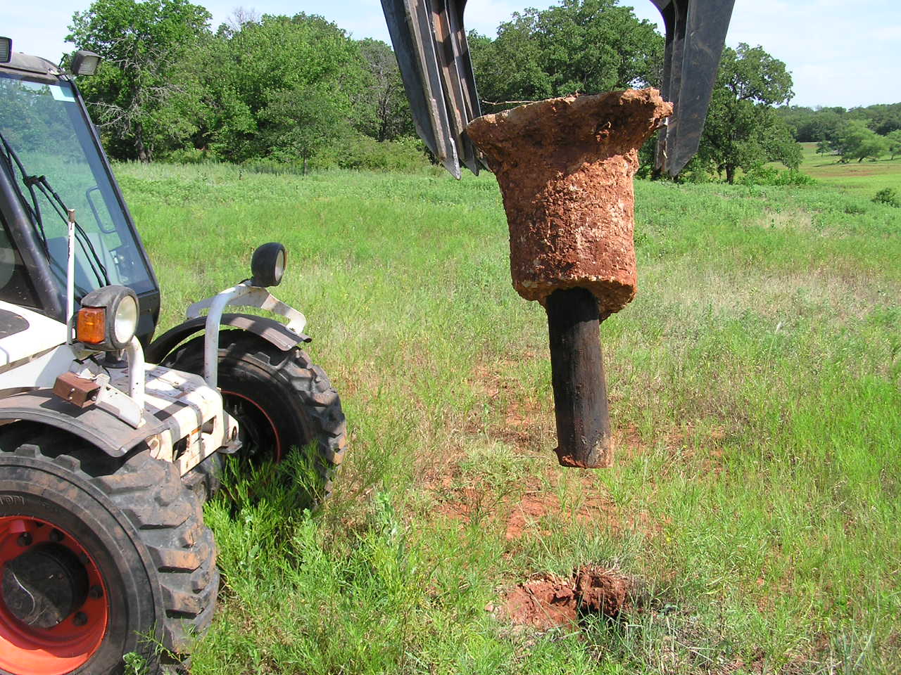

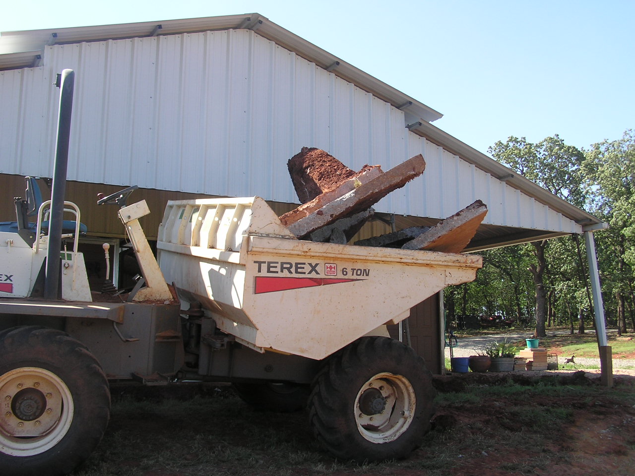

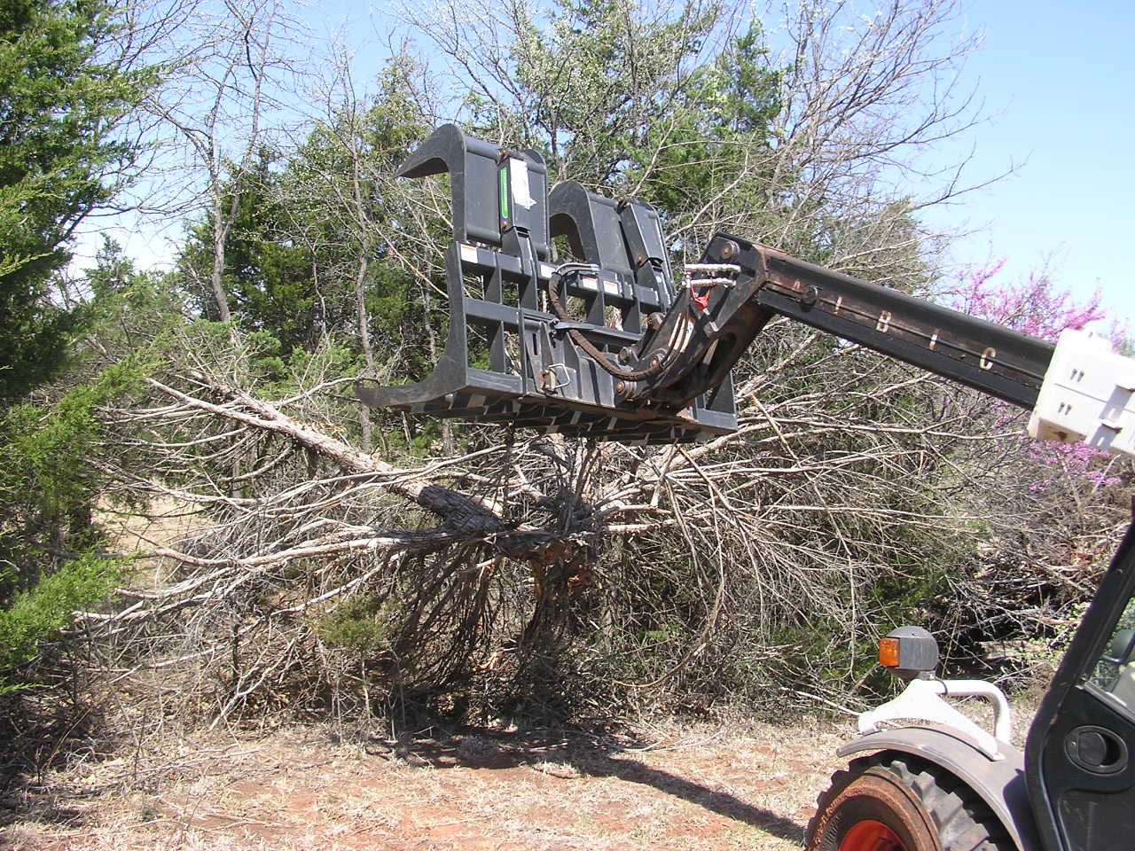

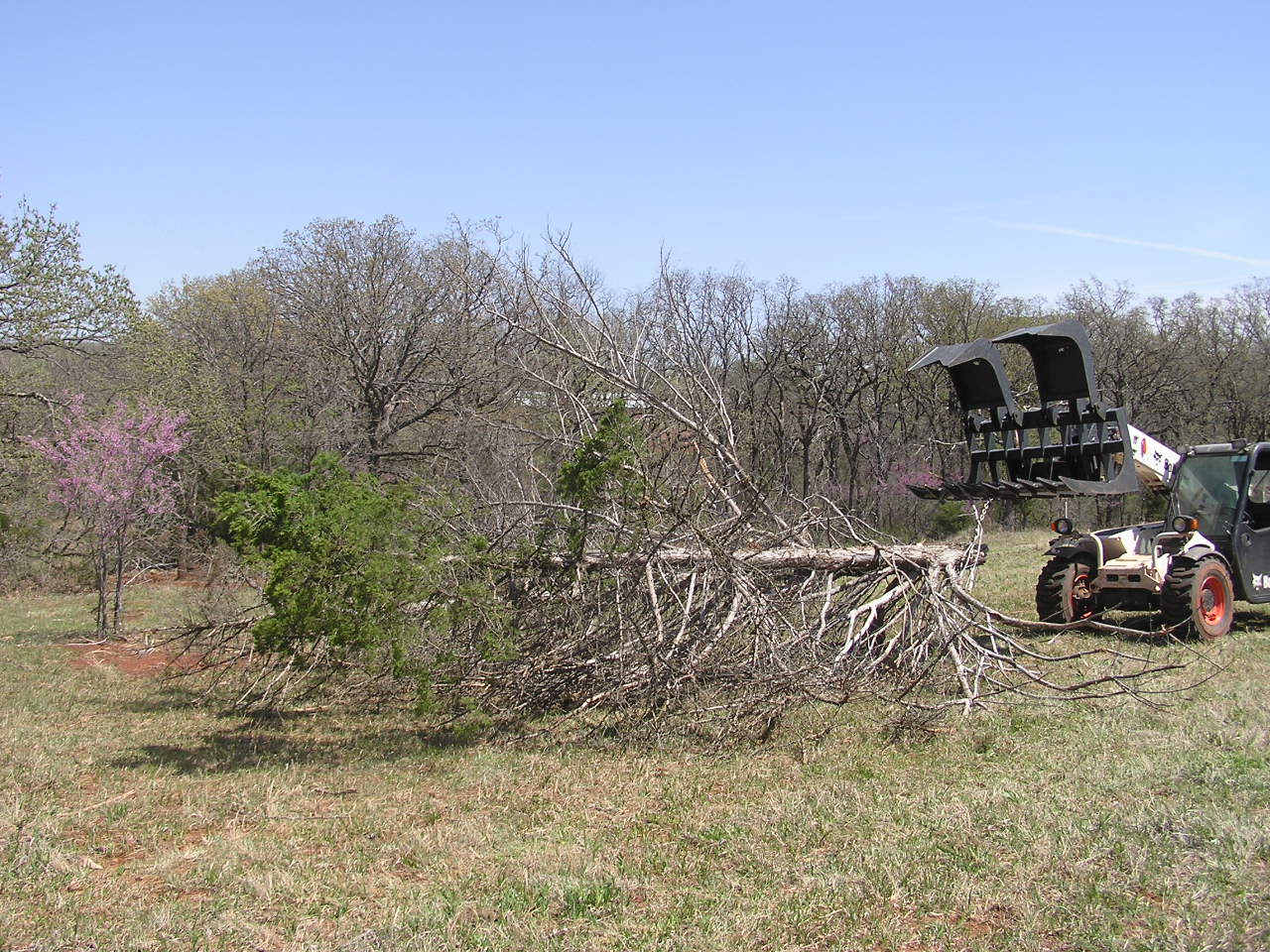

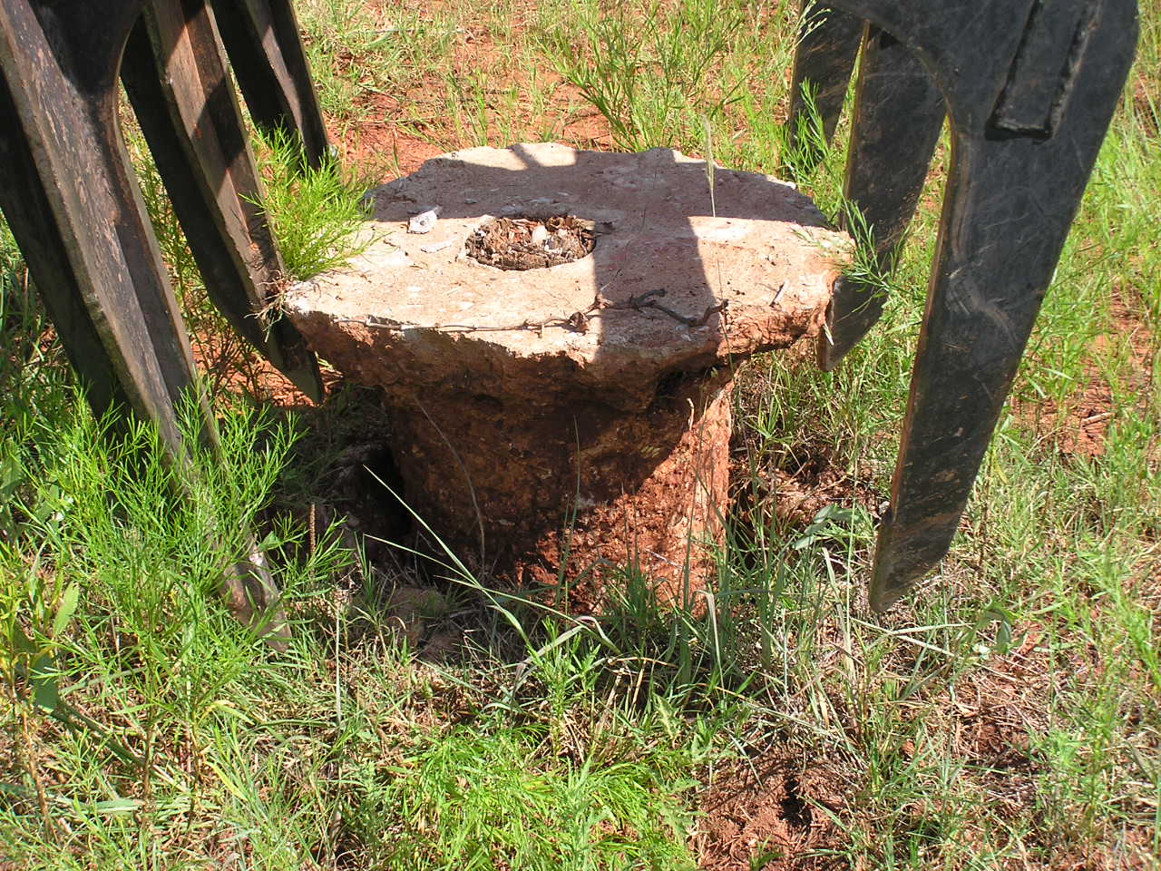

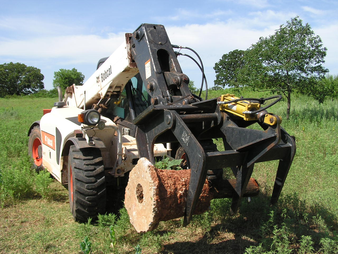

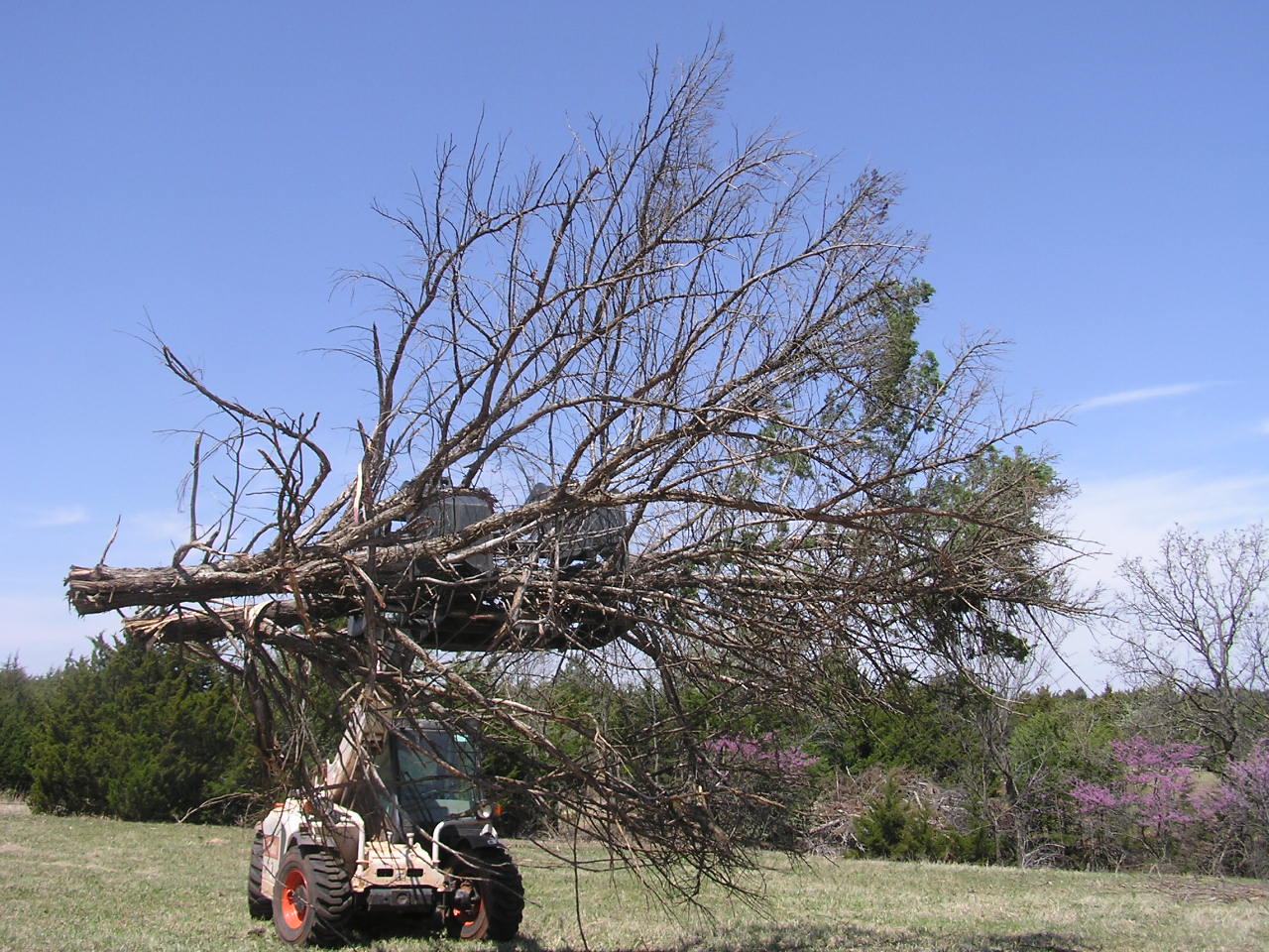

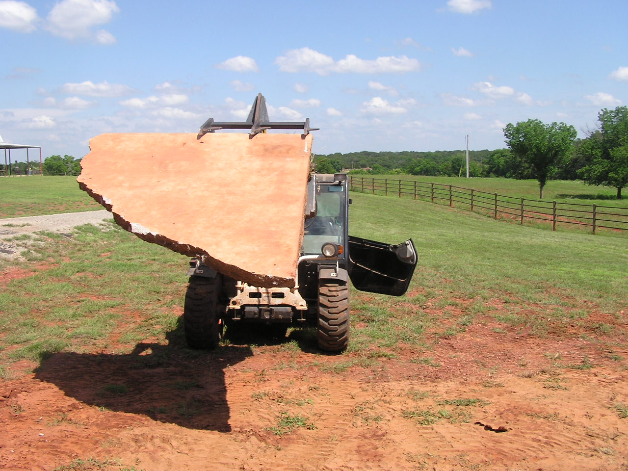

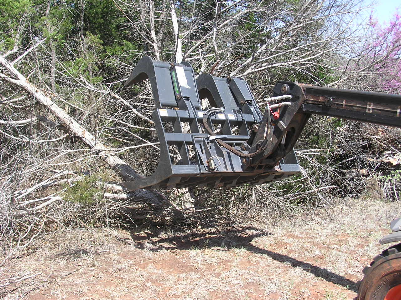

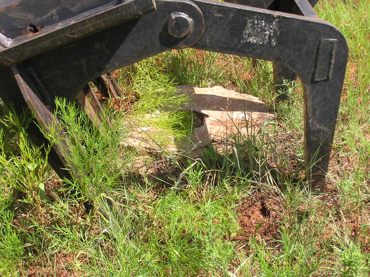

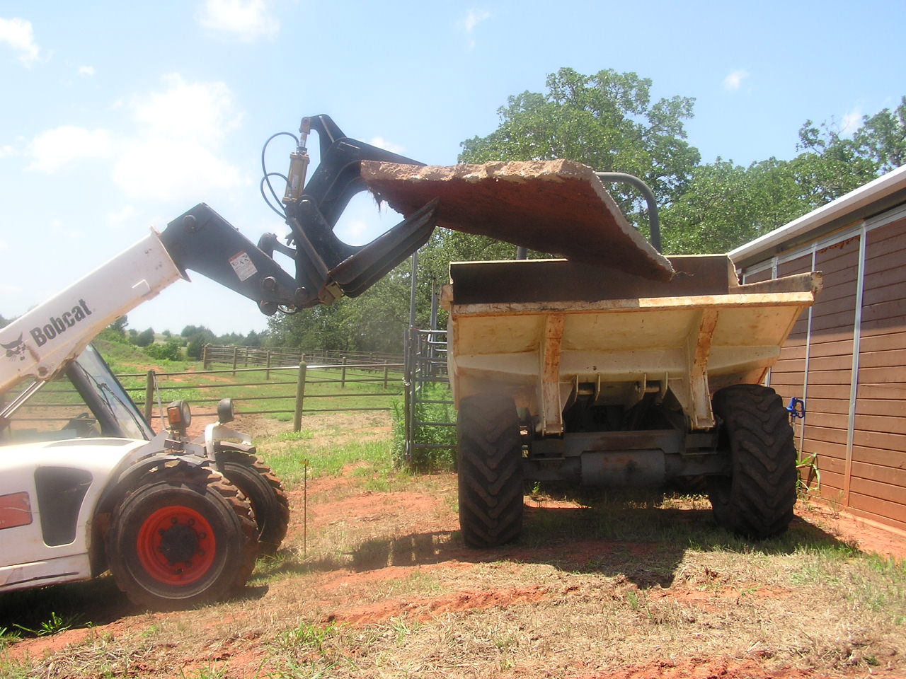

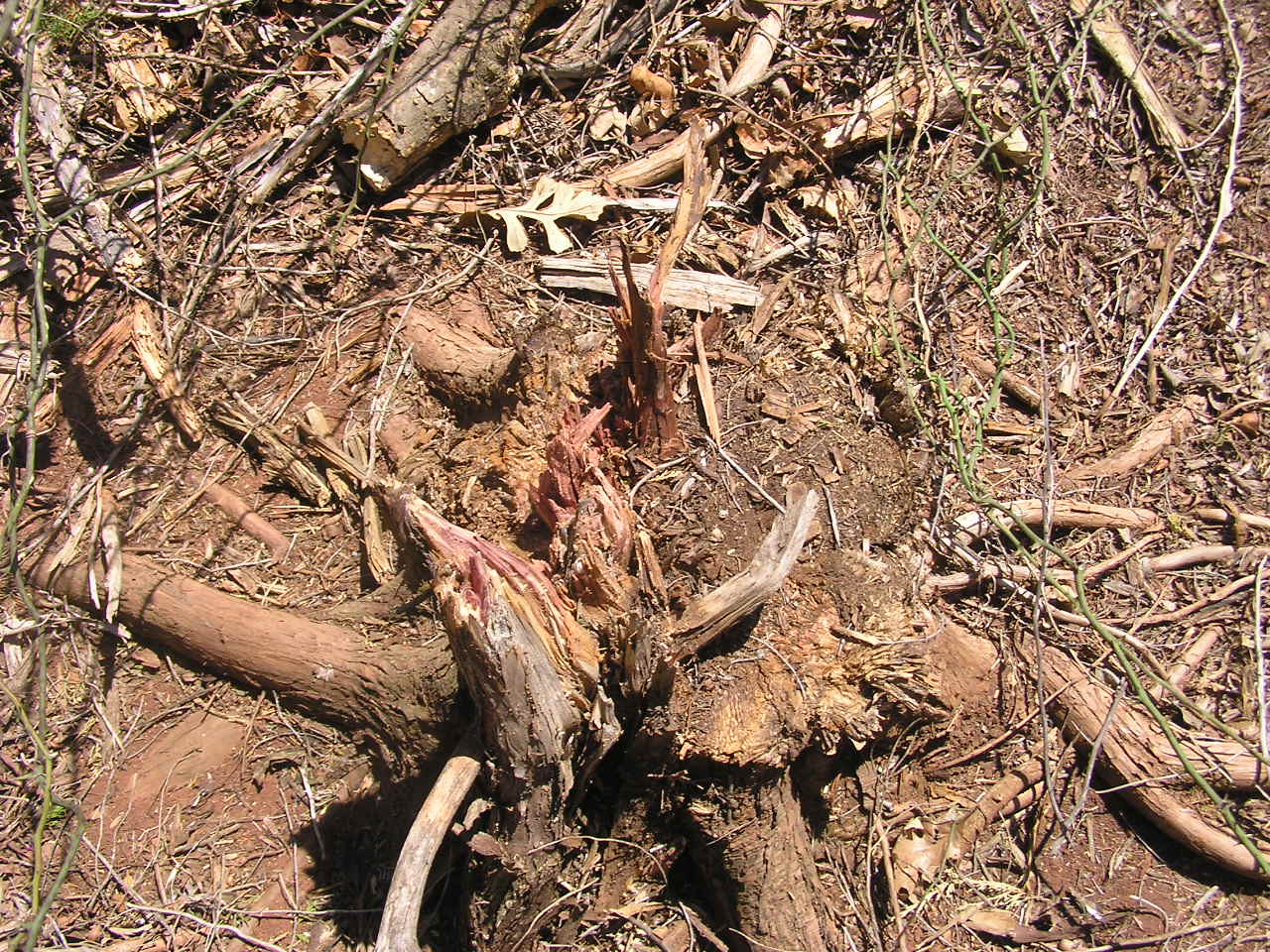

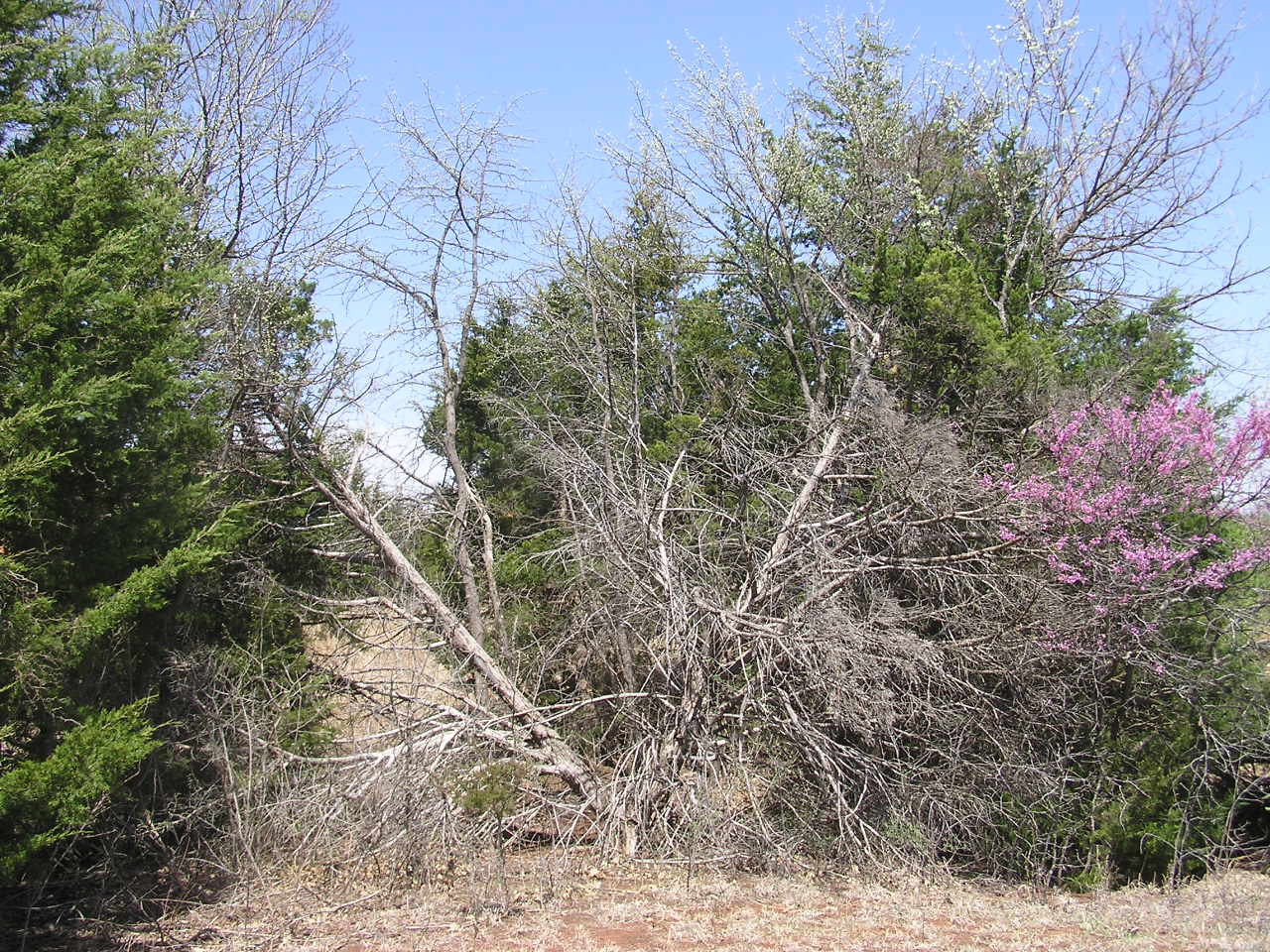

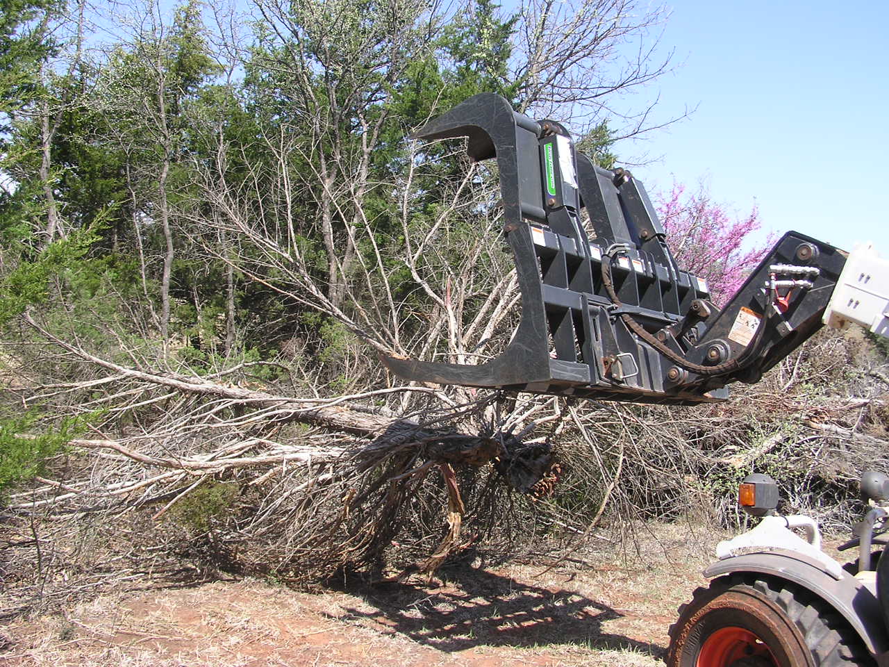

Pushed over a tall dead tree with the Monster Grapple.
Note the white rock in with the red sandrock.
Knocking dirt and rock off of the root ball. :thumbsup:
Found the balance point and took it to the burn pile.

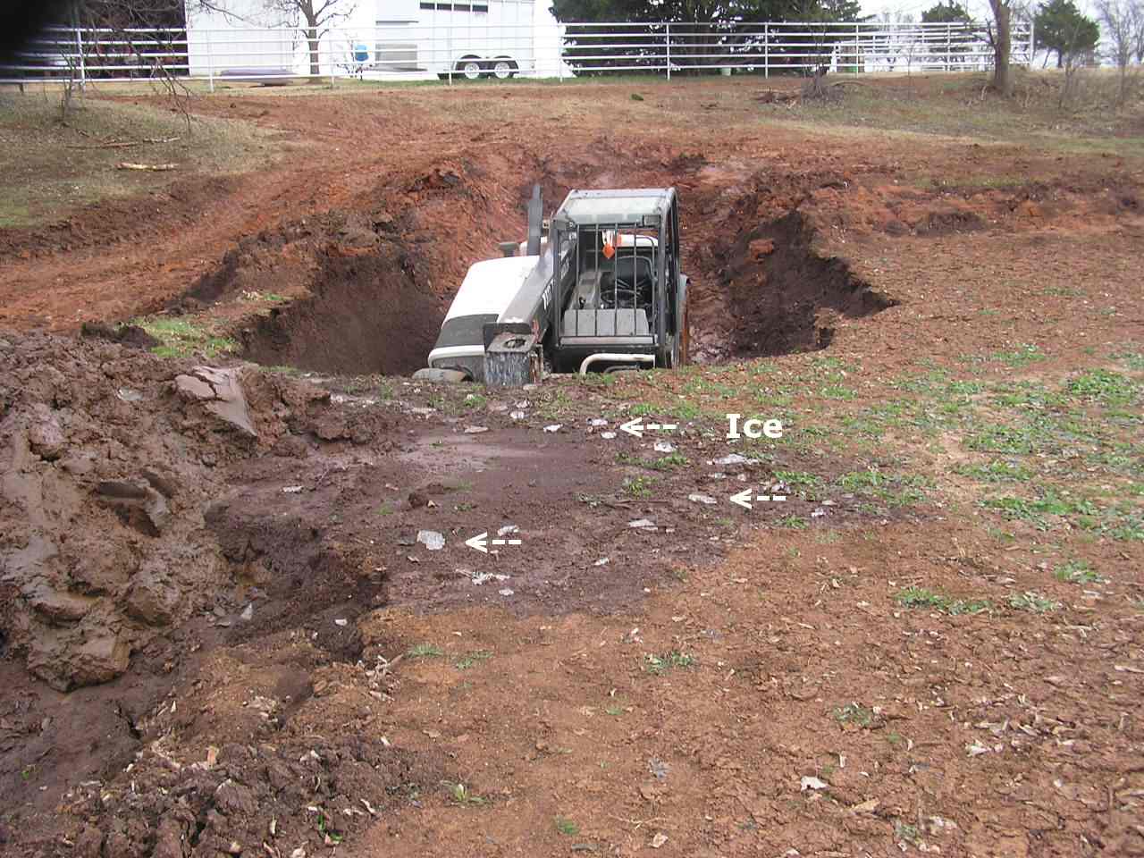

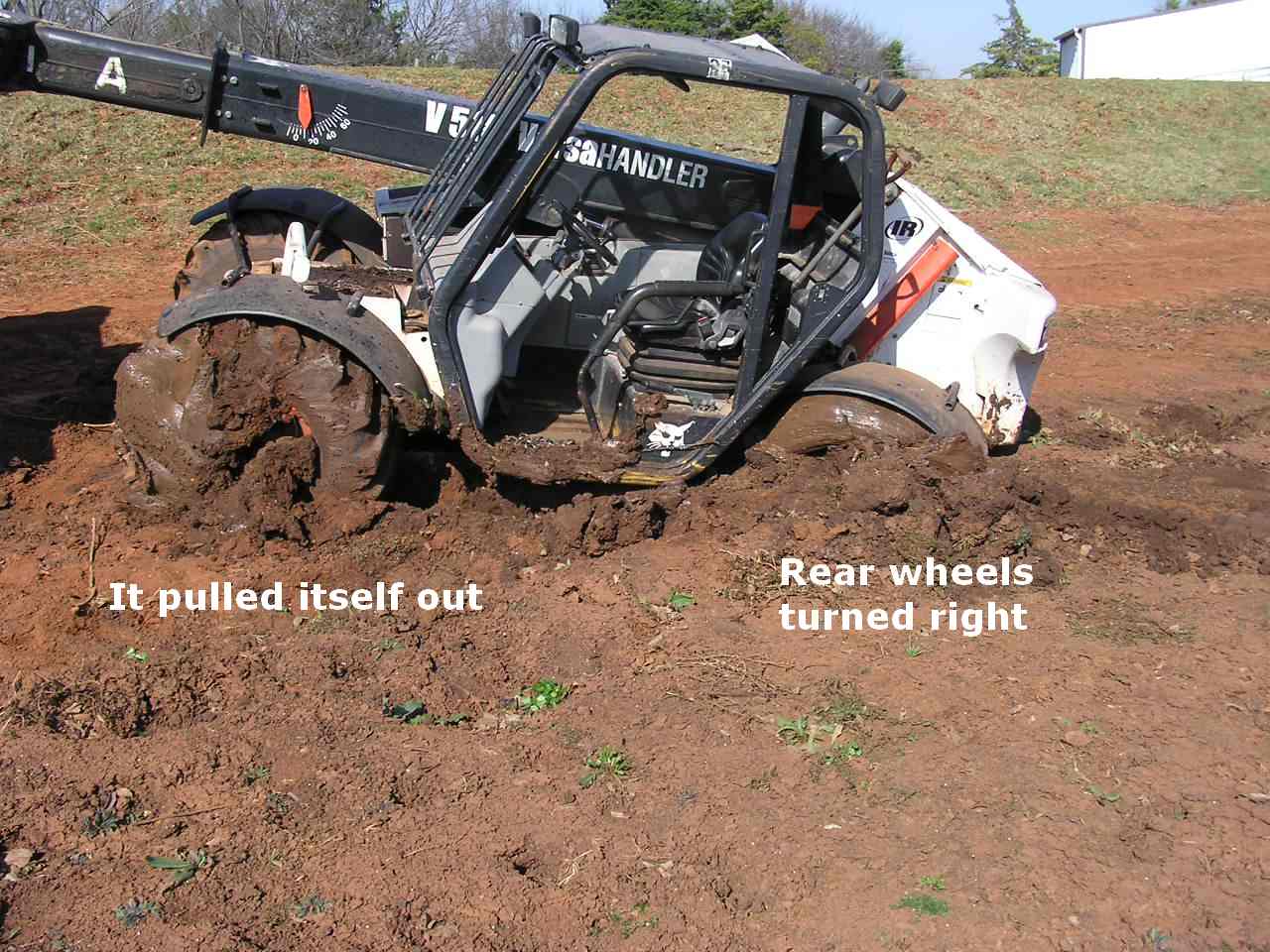

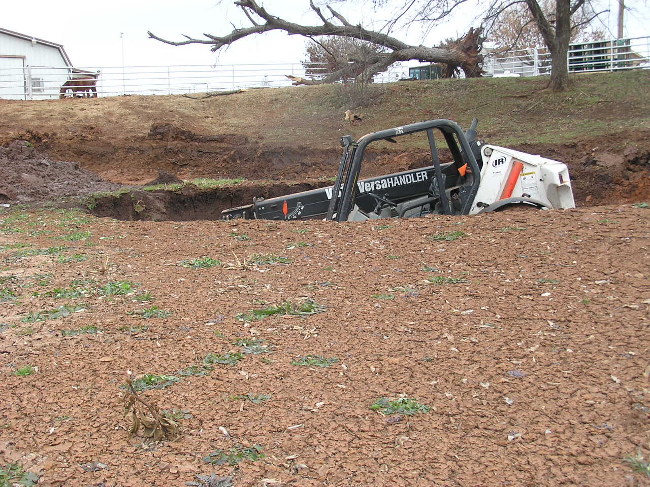

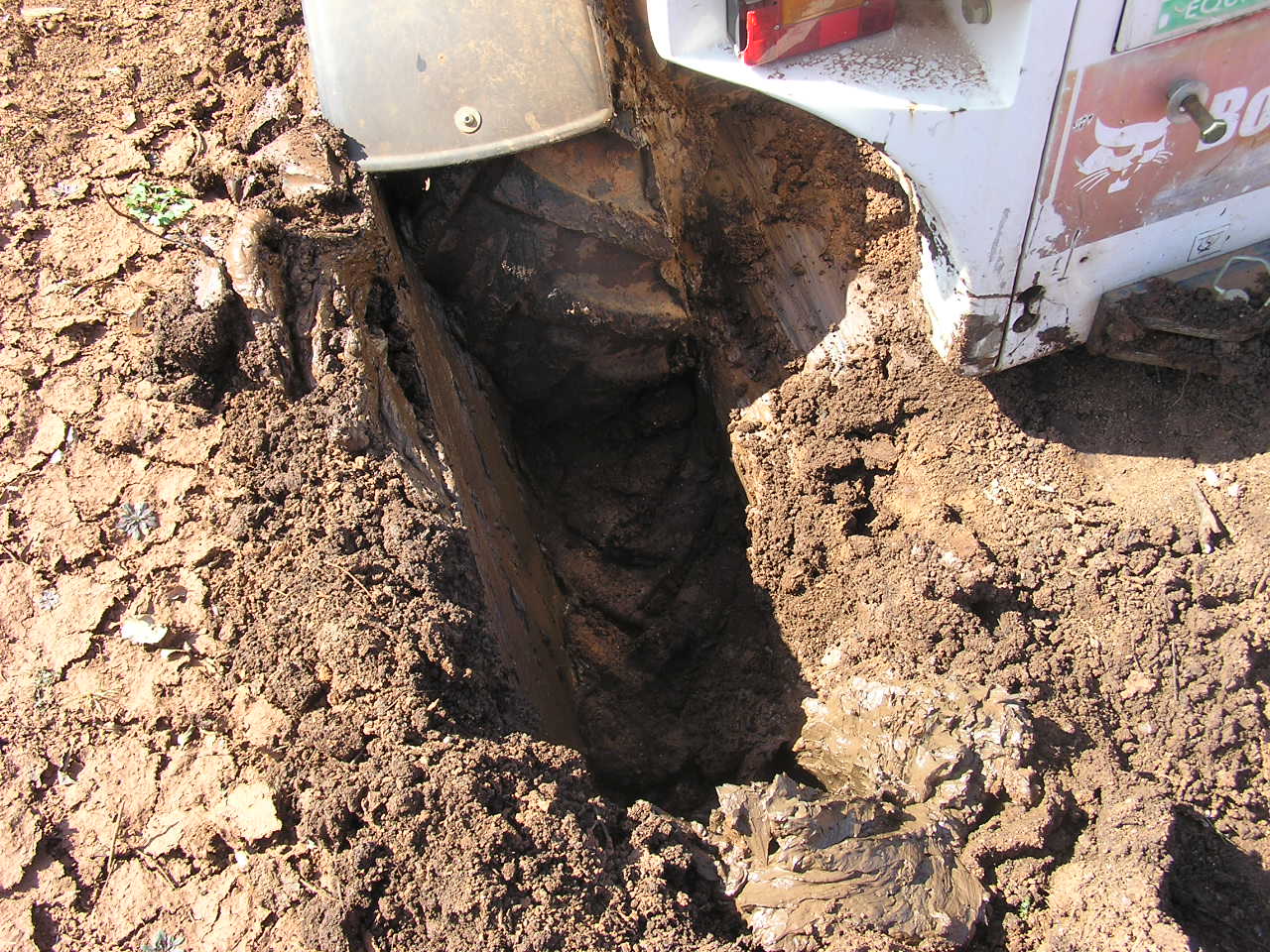

A lot of guys aren't familiar with these machines, so thought I would revive this three year old thread, since it is the only thread that I found searching for Versahandler in this forum.

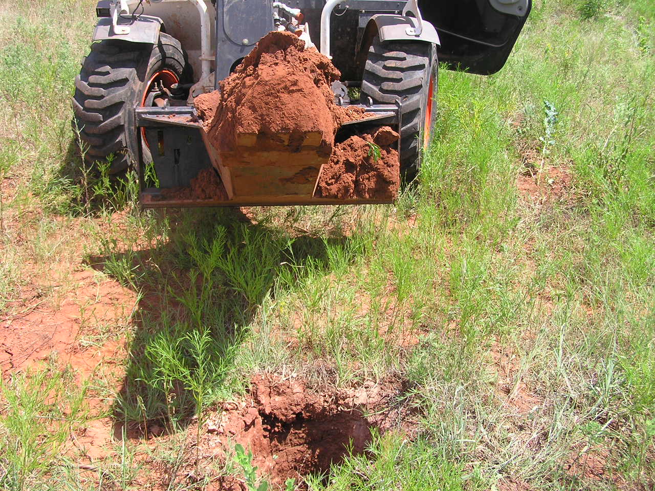

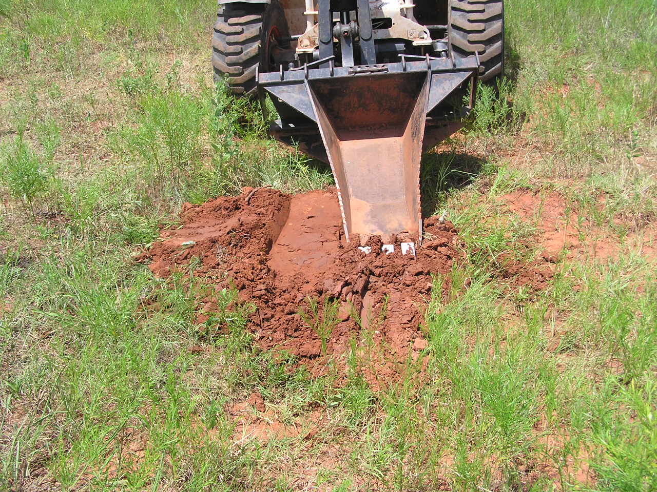

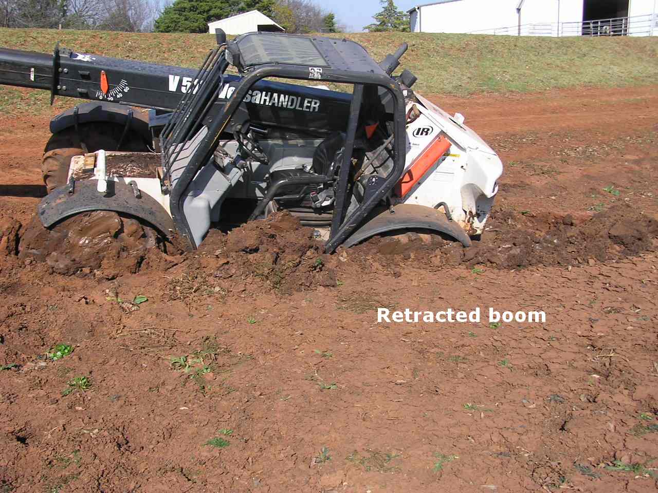

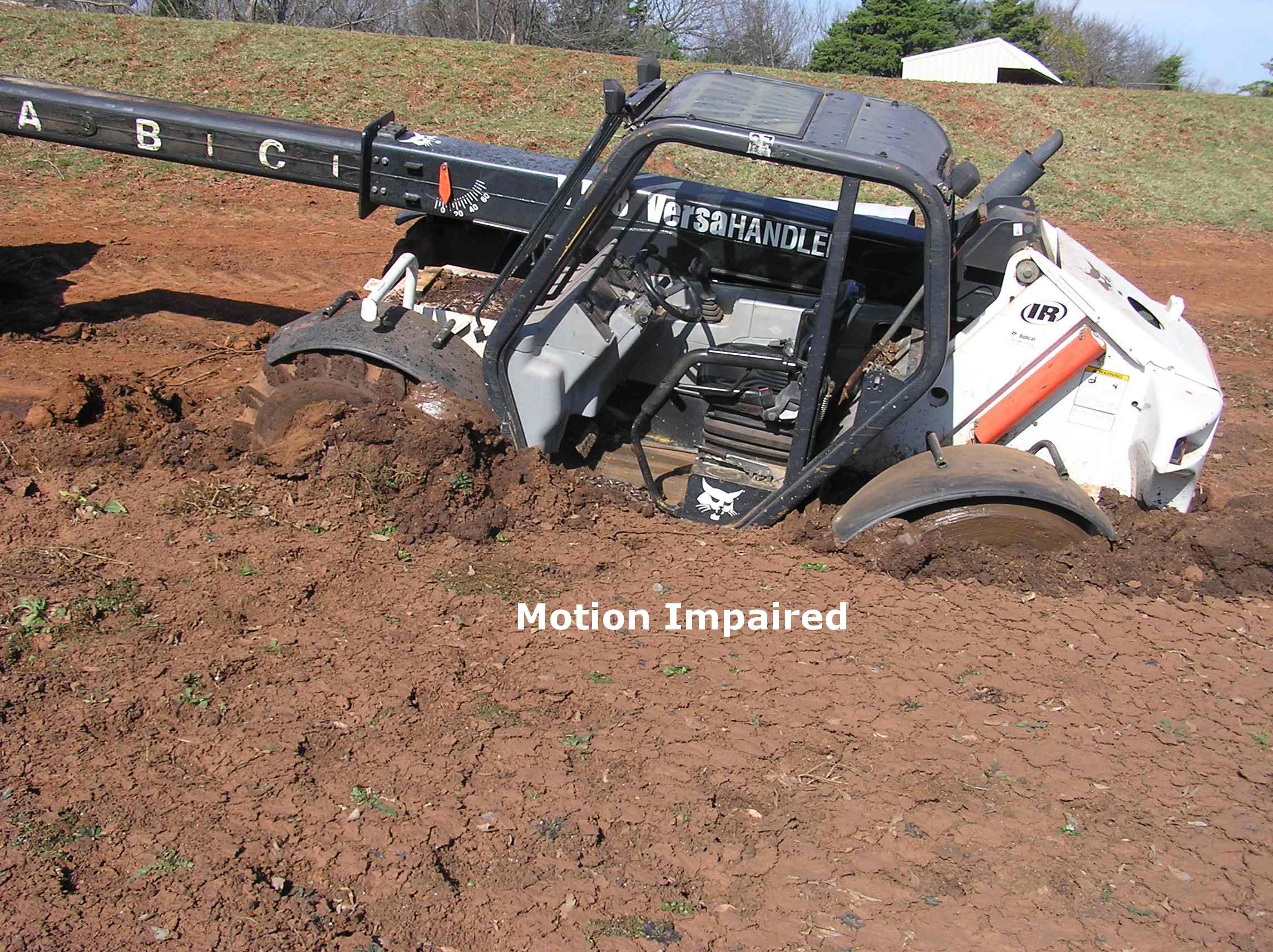

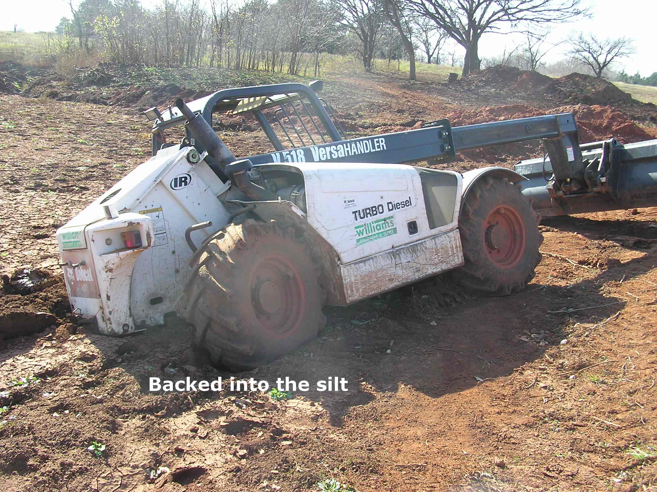

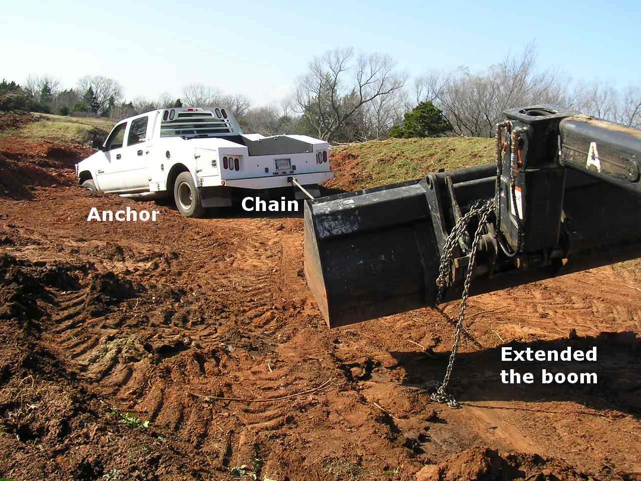

The Bobcat V518 and smaller V417 Compact Telehandlers are designed for ground engaging attachments. They will definitley out dig a skid steer. They also can extricate themselves from any stuck situation, if the motor is still running.
View attachment 309546 View attachment 309547 View attachment 309548 View attachment 309549 View attachment 309550 View attachment 309551

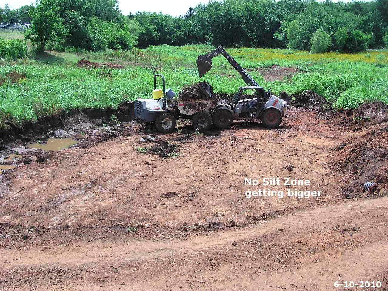

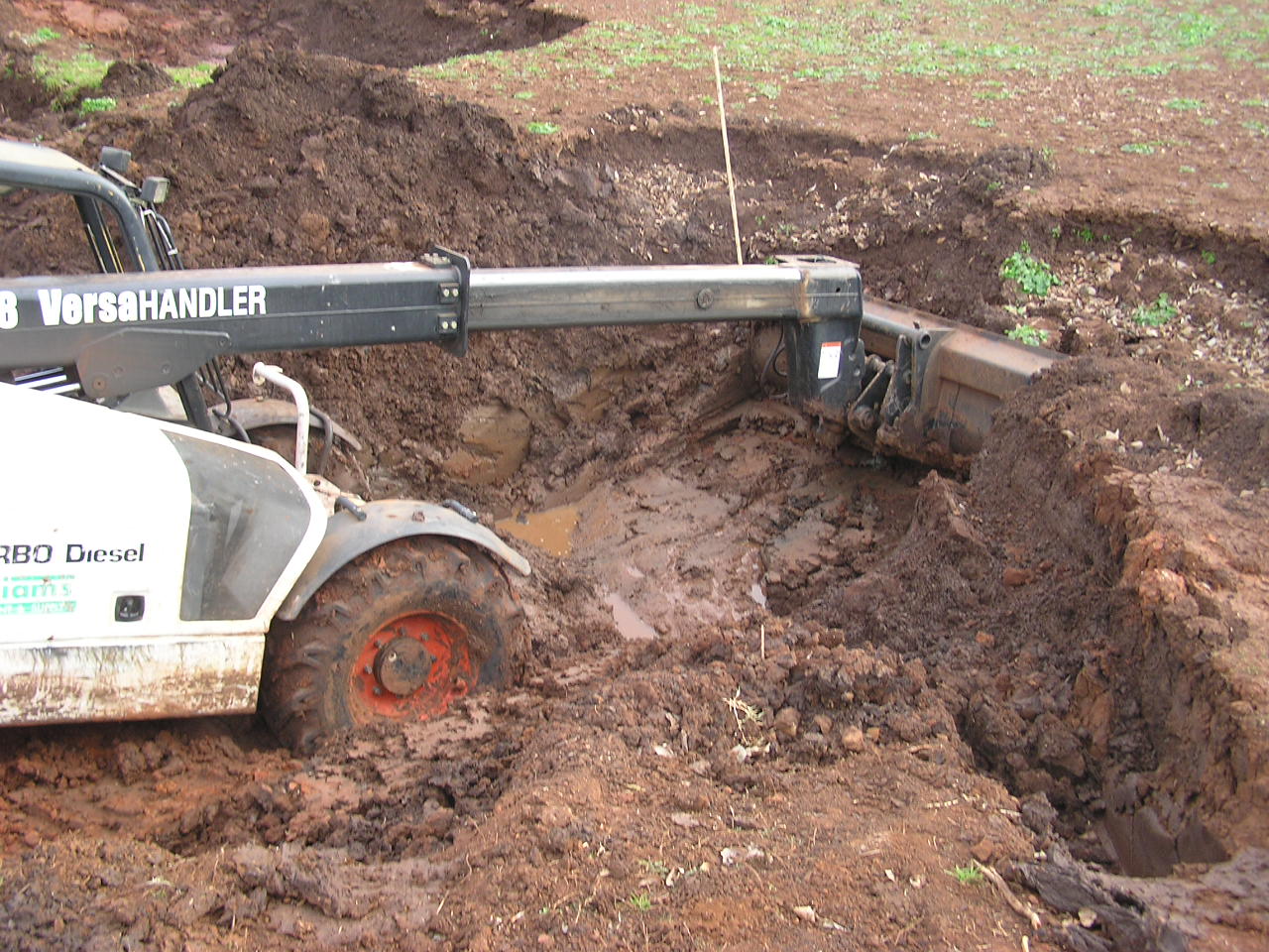

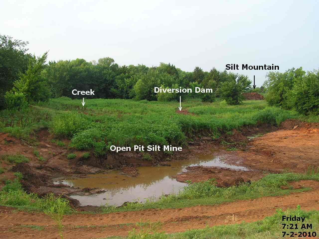

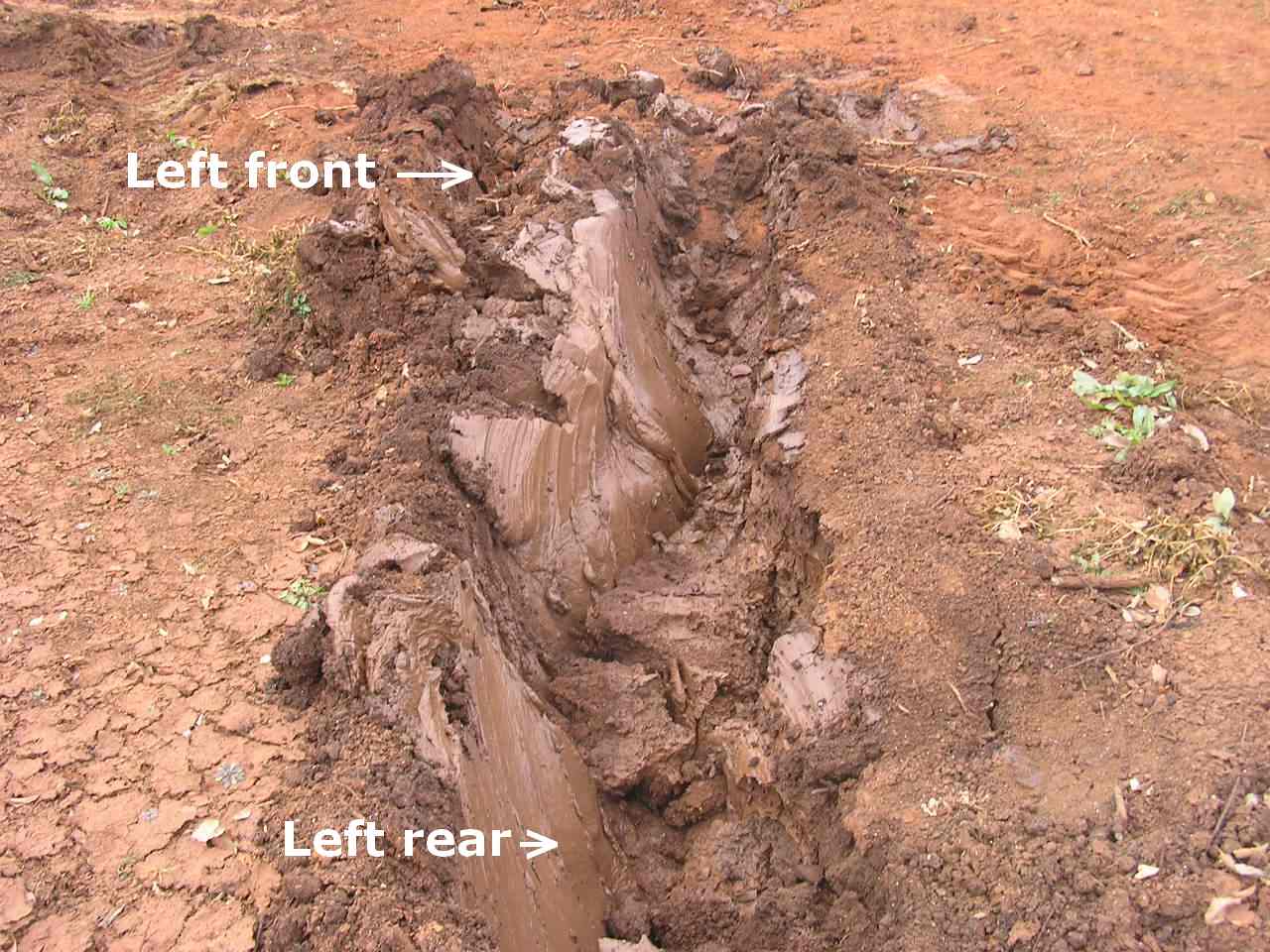

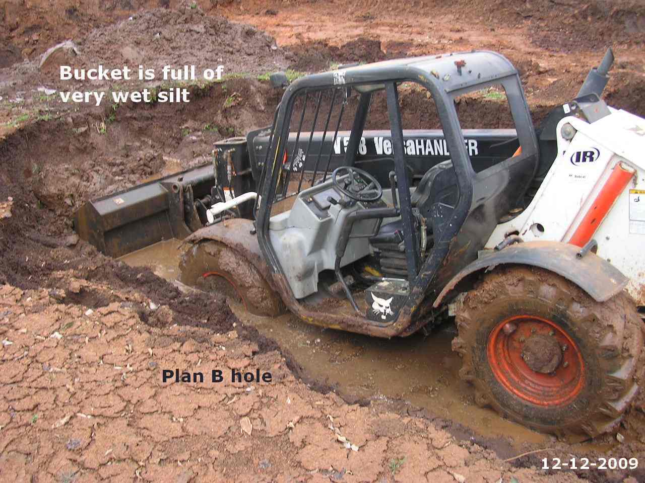

Notice how dry the silt is on top, but under the top crust it is like pudding. I had driven across it with our UTV, no problem.

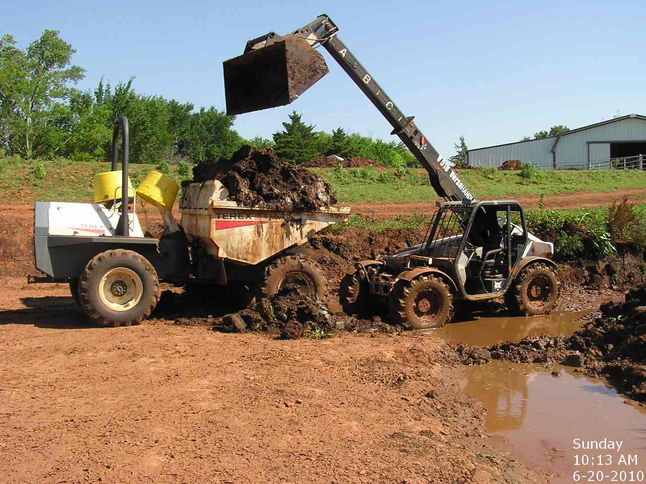

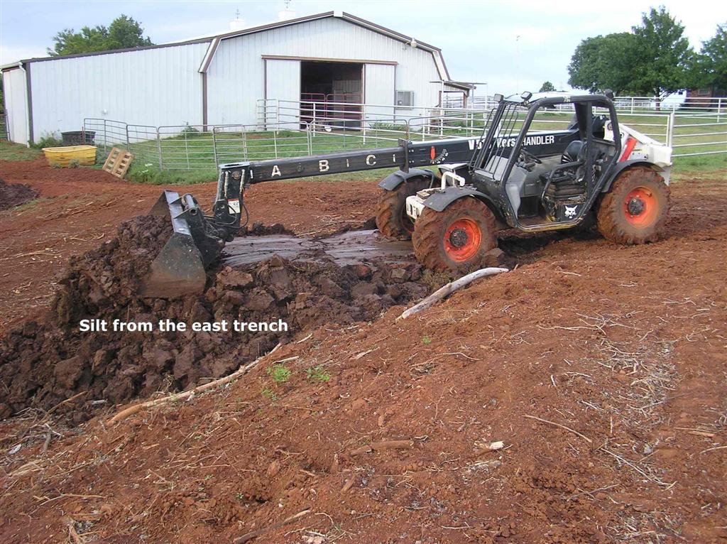

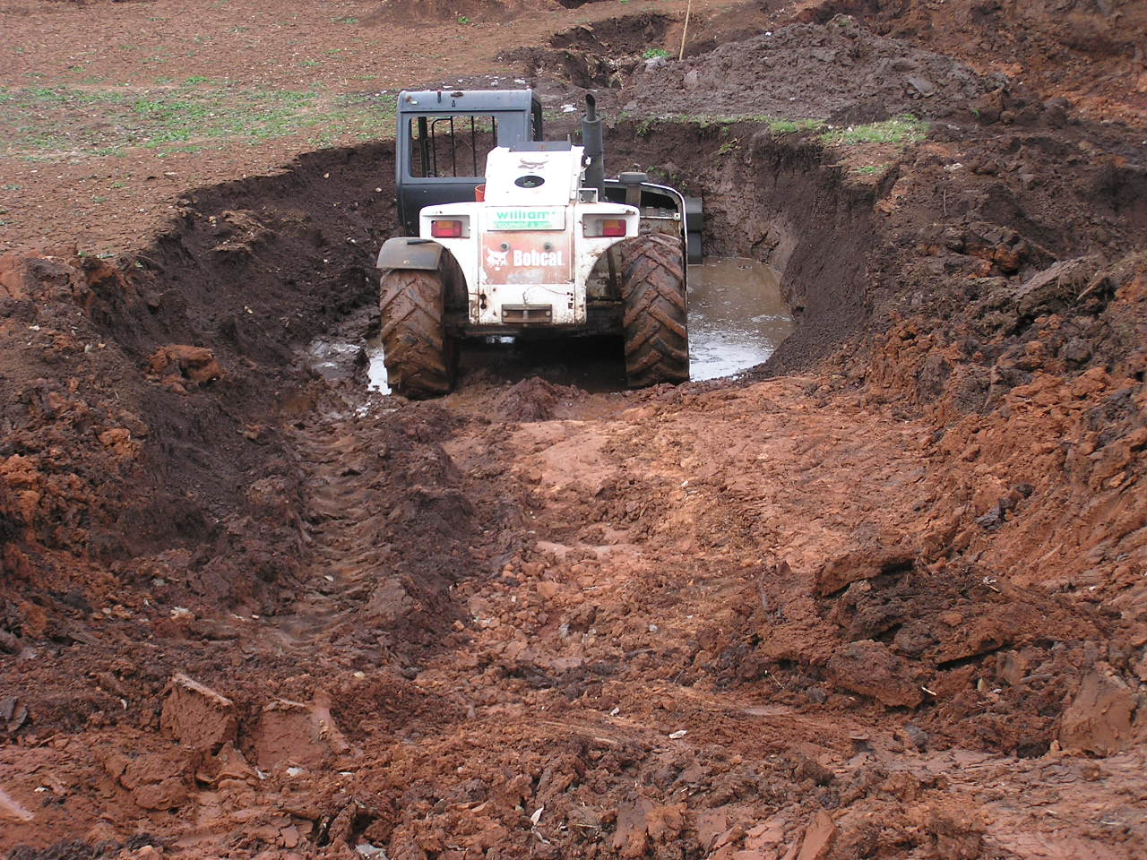

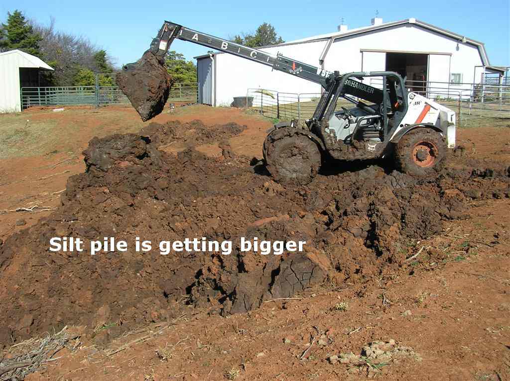

In September 2009 I bought a used V518, to clean out our 30 year old 2 acre pond. The silt was 5' deep, the plan was to dump the silt on the backside of the dam.
View attachment 309554 View attachment 309555 View attachment 309556 View attachment 309557

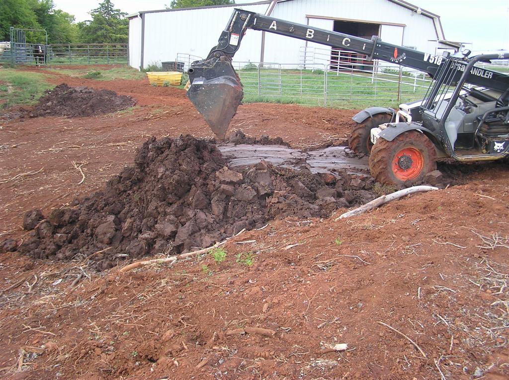

The silt pile.
View attachment 309562 View attachment 309563 View attachment 309564

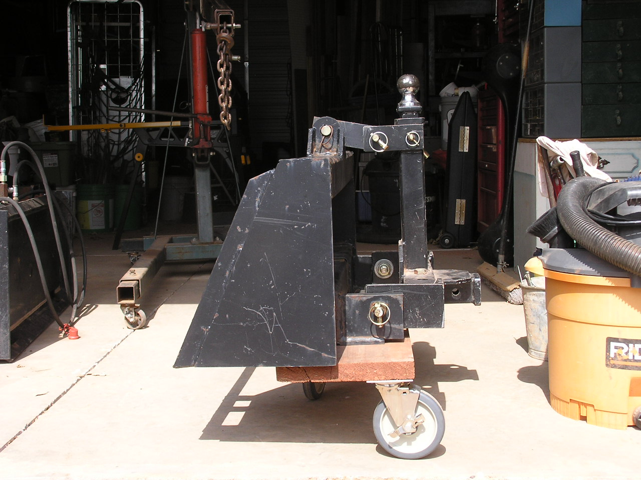

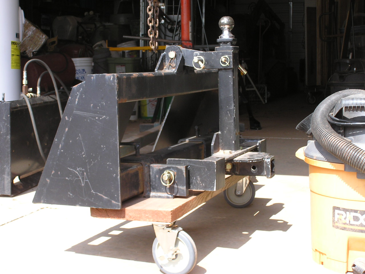

The V417 has a standard SSQA, the V518 attachment carrier is different, but an adapter is available for skid steer attachments. Both have aux hydraulics on the boom.

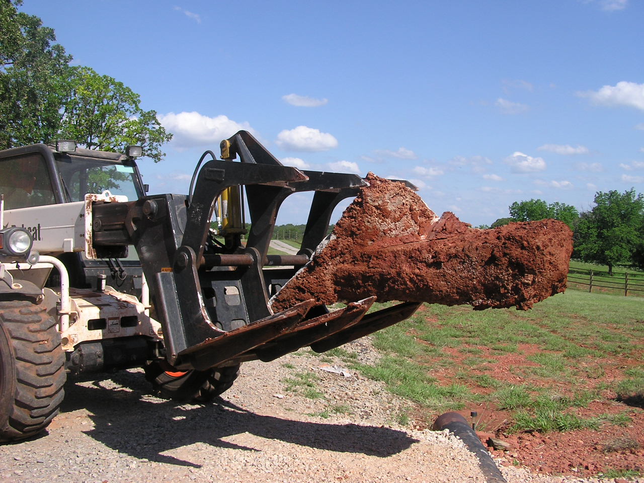

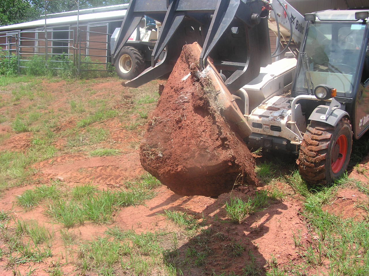

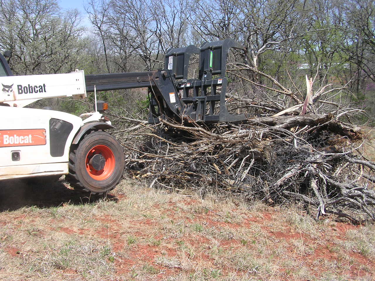

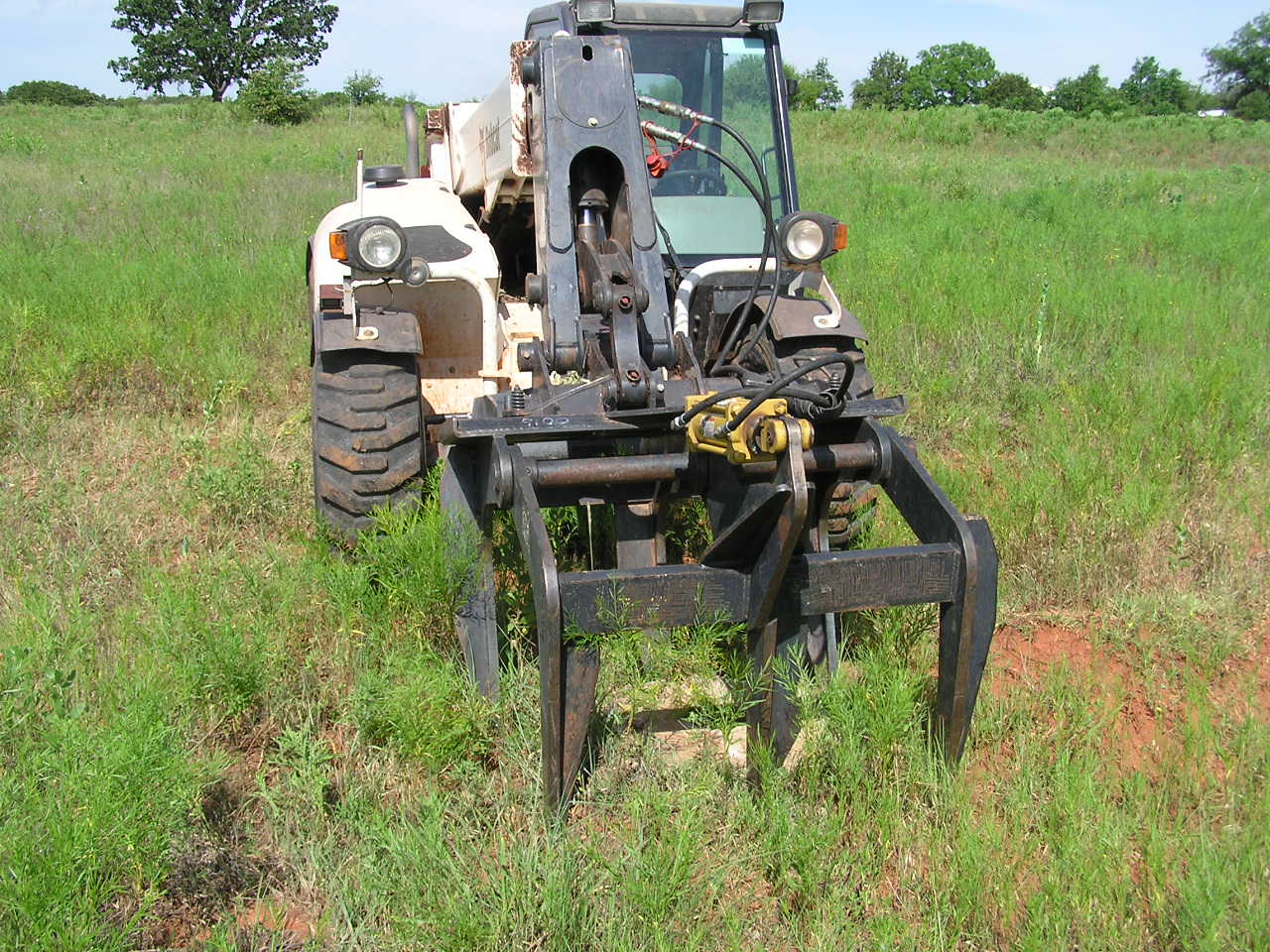

This oak tree put leaves on this spring, but fell over last month.

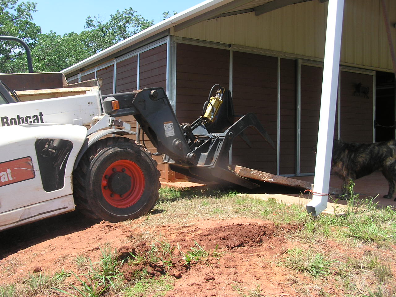

Reached in from the pasture, grappled it at the balance point, raised the boom, but the rear end came off of the ground. :eek:
Drove around into the woods and noticed it still had one big root in the ground. So I put the grapple under the trunk and pulled it up.
Extended the boom and dropped it in the pasture.
Used crab steering to drag it out where I could find the balance point and pick it up.
Took it to the burn pile. Got the camera lens dirty on the way. :mad:
I wondered if it was heavy enough to raise the rear so I slowly extended the boom all the way out, it was!!
