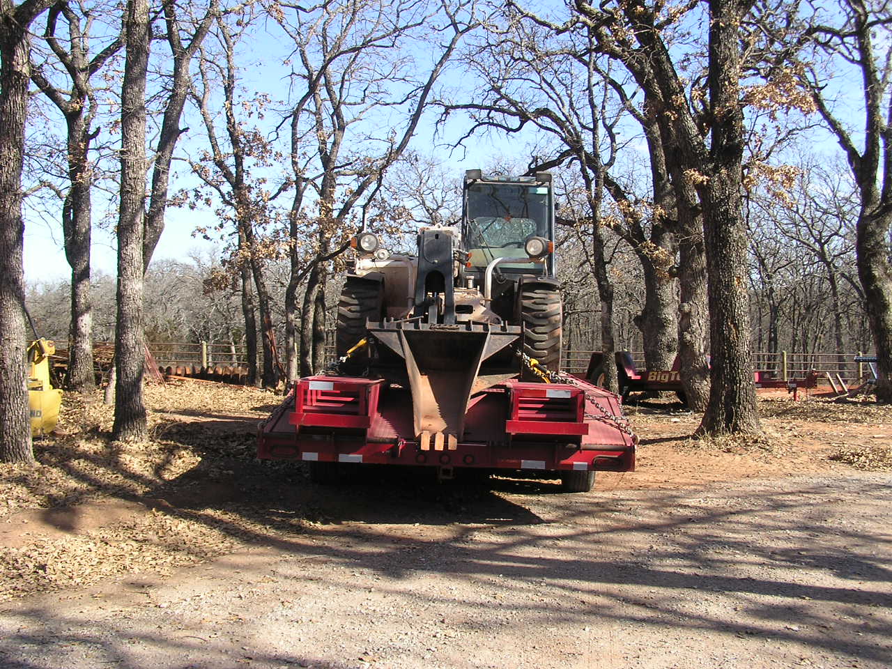

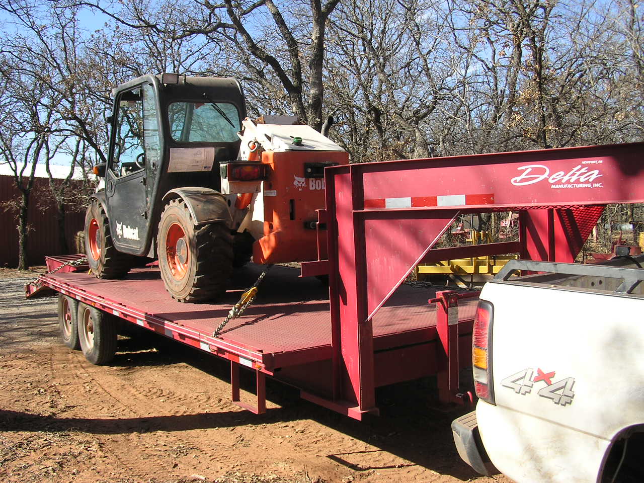

Yep, small but heavy. About 11,000 pounds with the 370 pound stump bucket, on the 22' trailer.
The steel counterweight is the orange casting on the back.

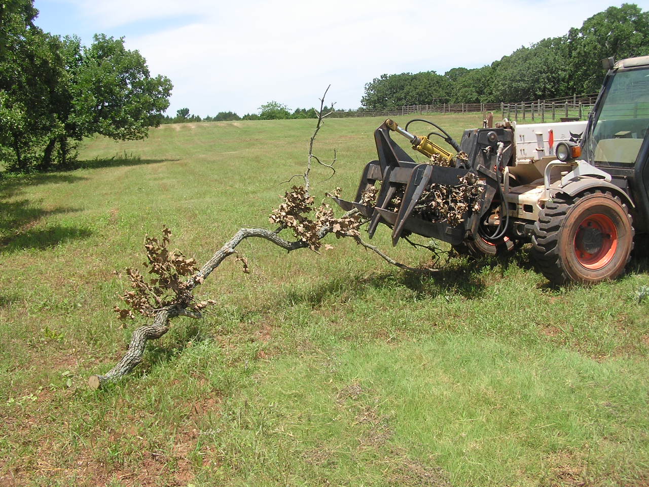

Here is a job from last June. A large oak branch broke off and was jammed in the trees. The white arrow shows the broken end hung up in a tree. The black arrow shows where a fork of the branch is behind a tree, so the branch can't be pulled out of the woods.
Used the cordless reciprocal saw to cut off the small forked branch:
Pulled out the cut off branch:
Pulled out the big branch:
Picked them up and added to the pile in the ravine:
