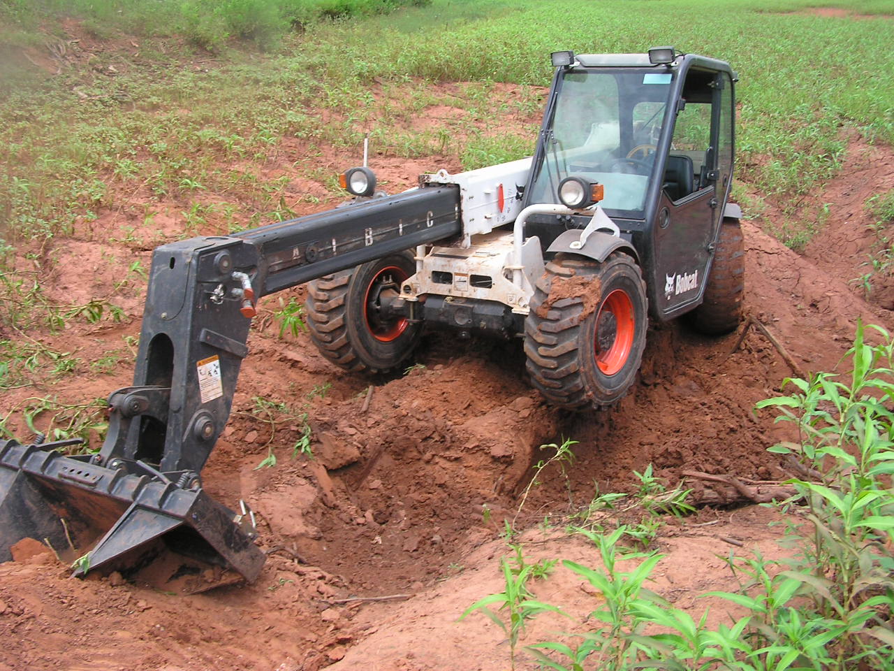

VERY dang impressive I would say. I'm curious to know what the down angle is. Or more specifically, if sitting on a flat level place, what is the deepest scoop of dirt I could take out of the ground. Assume no boom extension. Right in front of the machine. How deep can I get?
xtn
/ Compact telehandler #24
xtn
A little deeper than the length of the bottom of the bucket. The Versahandlers have a bigger bucket than a skid steer, but a long bottom skid steer bucket will work on the V417.
I did dig several trenches with the V518.
Dug a trench for a culvert pipe. This bucket is 7.5' wide, 1.25 cubic yard capacity.

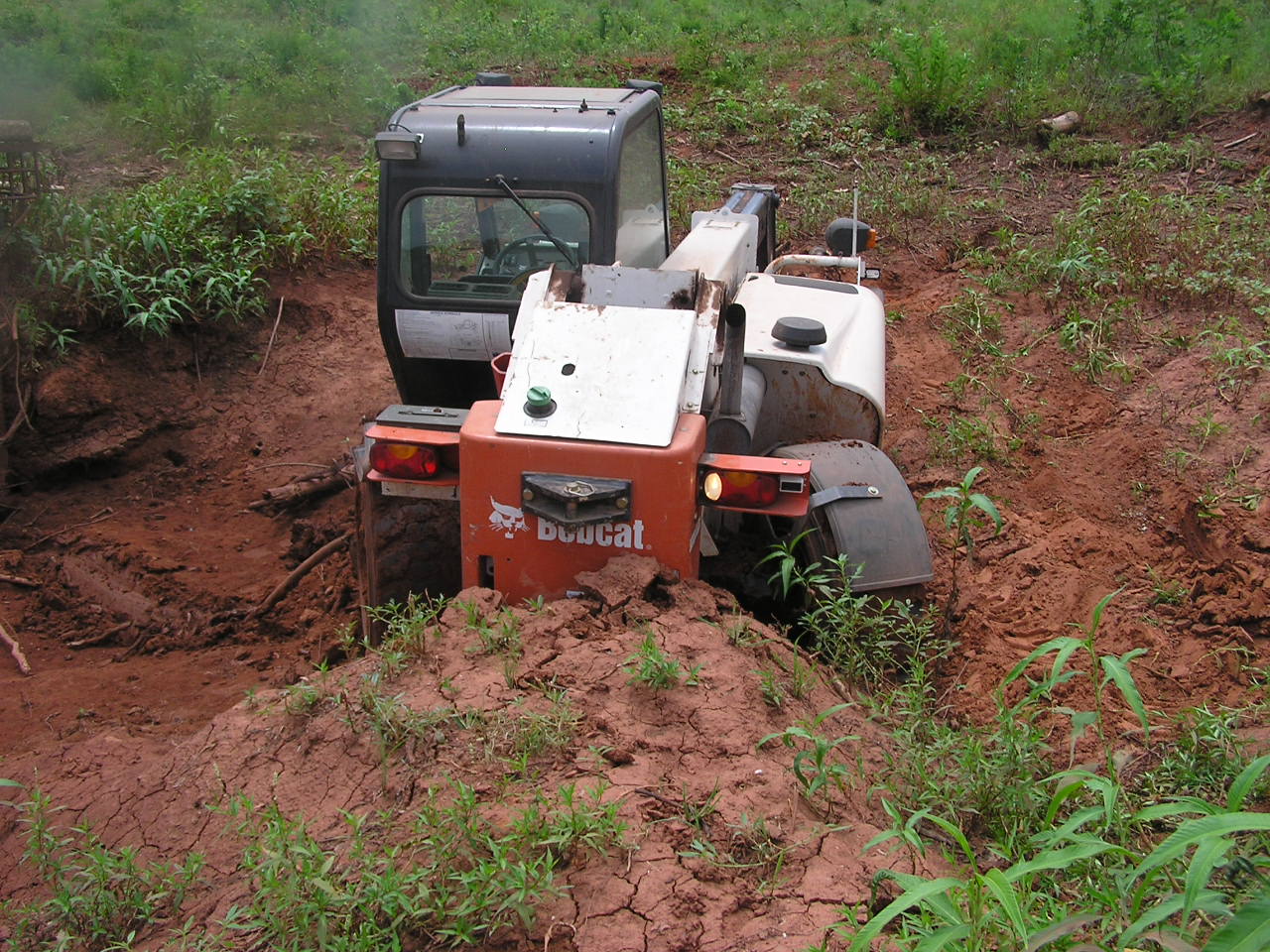

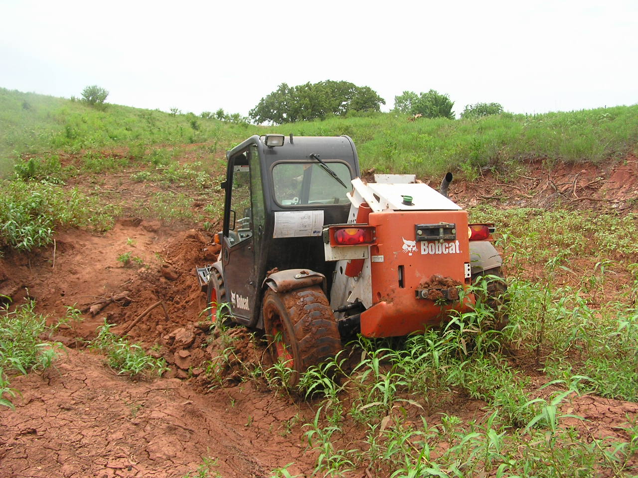

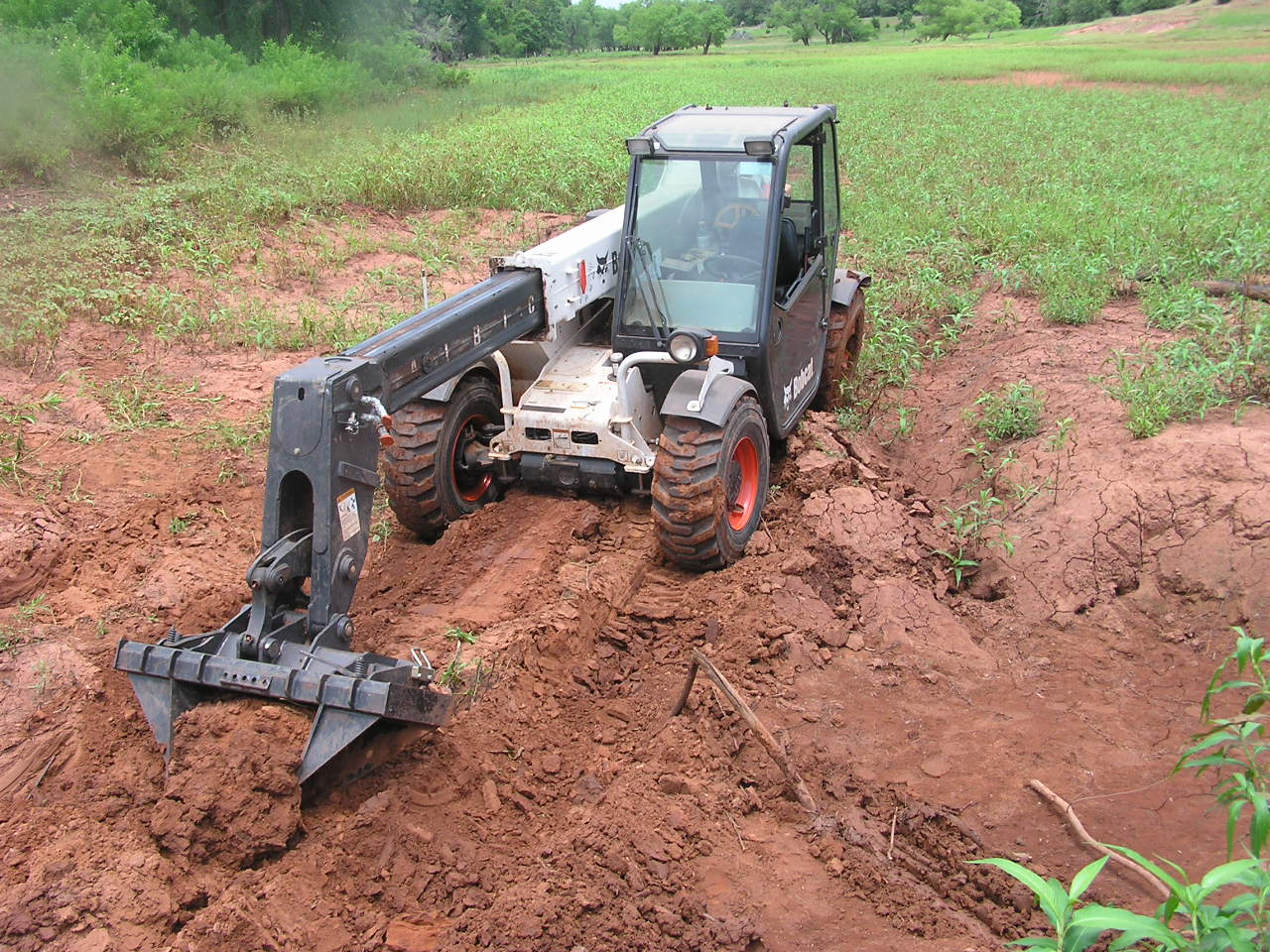

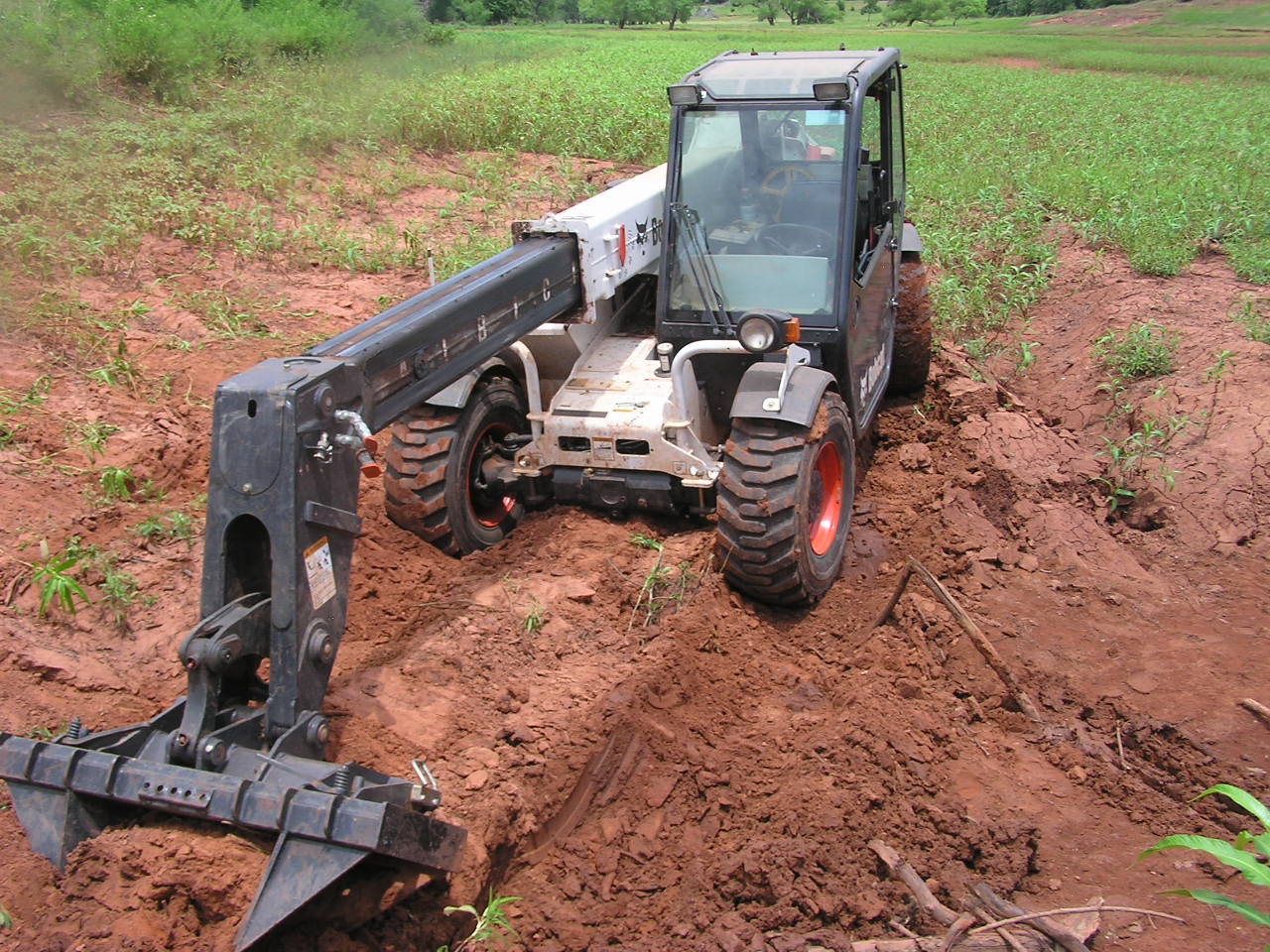

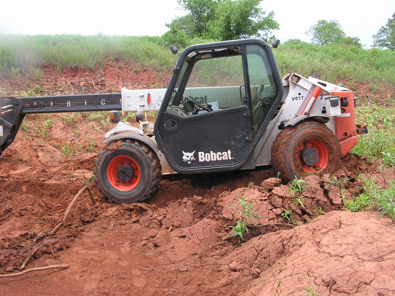

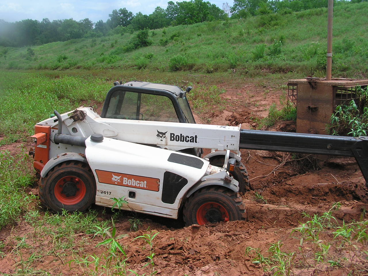

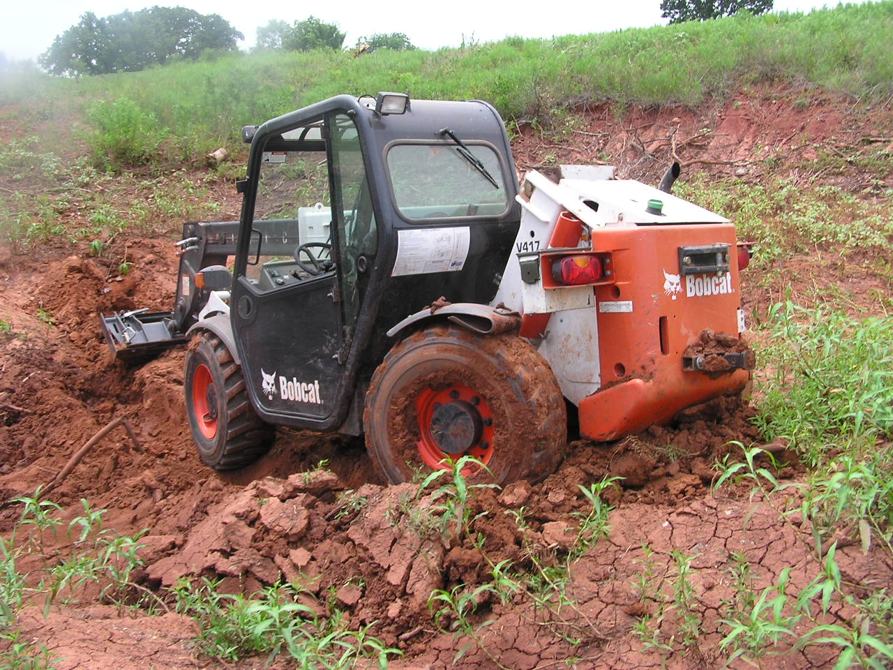

It is Unstuckable! :thumbsup:
Motion impaired. :D
Lowered the boom, raising the front end.
Extended the boom, first push back, up the hill.
Second push back, notice the receiver hitch is buried.
Third push, the boom extends about 5.5 feet.
Fourth push.
Fifth push, still no traction. Almost to the top of the little hill.
Finally made it, have traction. It unstucked itself! :laughing:

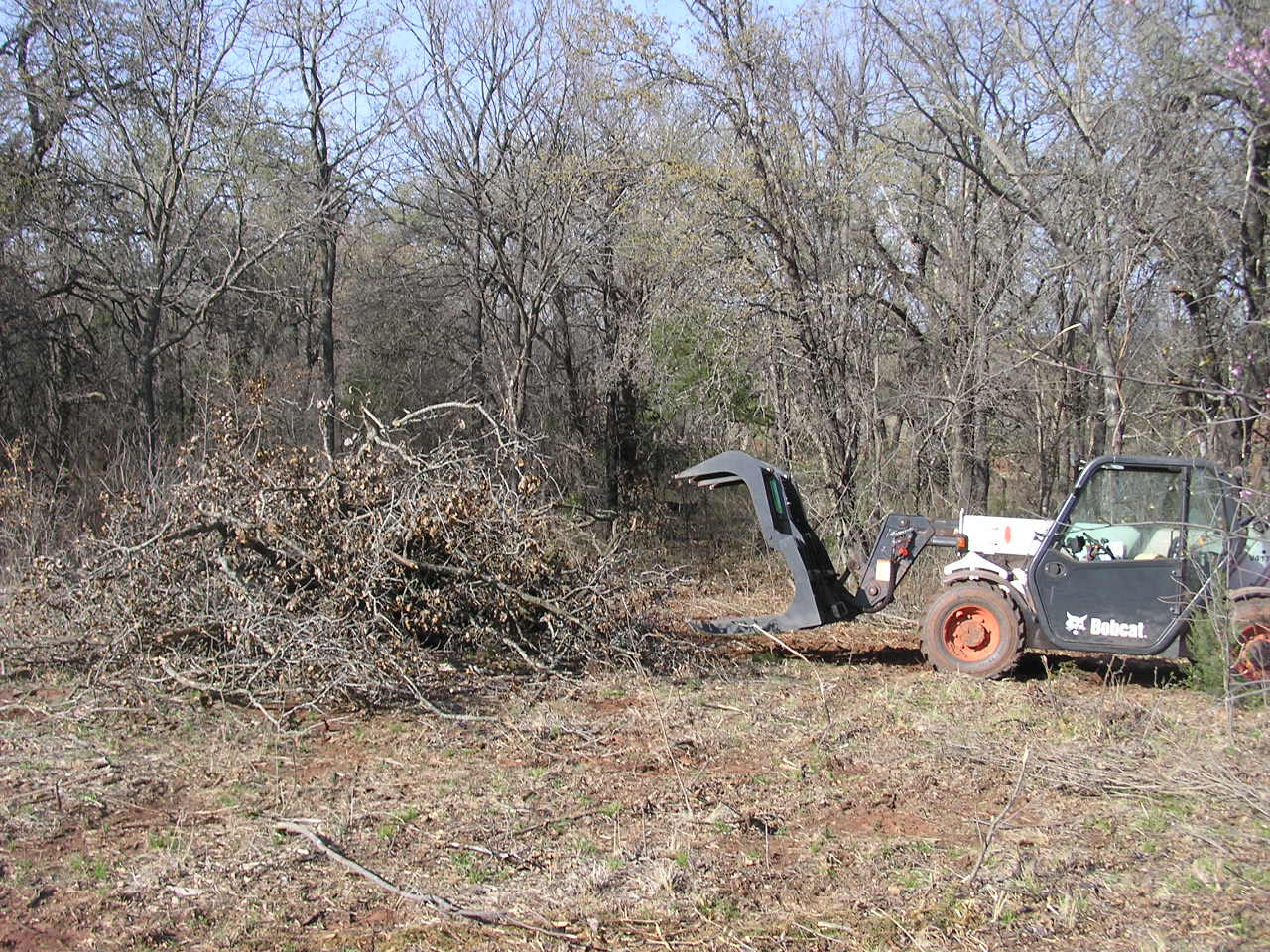

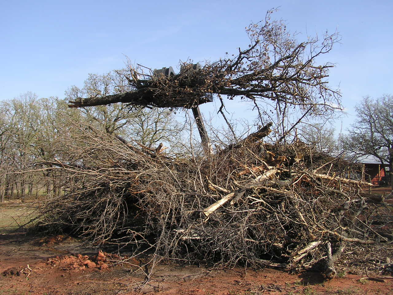

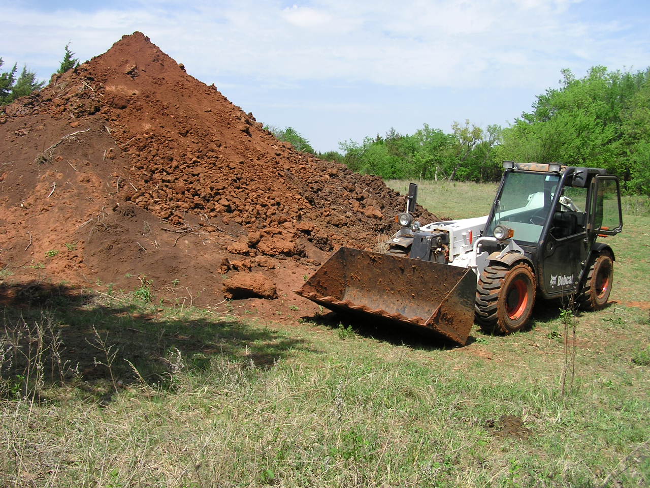

It is 16" from the front of the tire, to the front of the SSQA plate.
The inner boom slides out 66", so it would be 82" to the front of the SSQA plate..

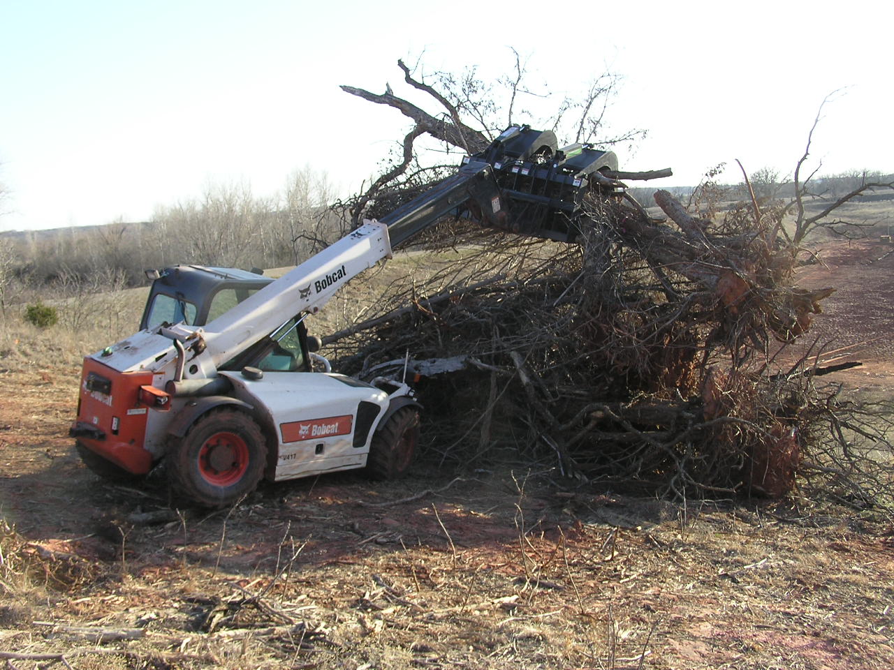

Bucket full of red clay, boom all the way up, but not extended because the ground is soft and not level.
The lift height is listed at 17', but I haven't measured it.

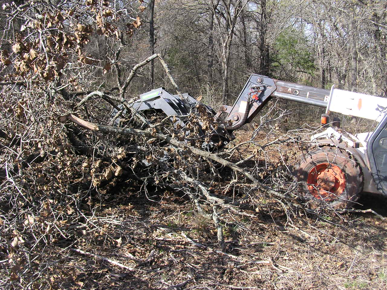

It will make some big brush piles! 👍

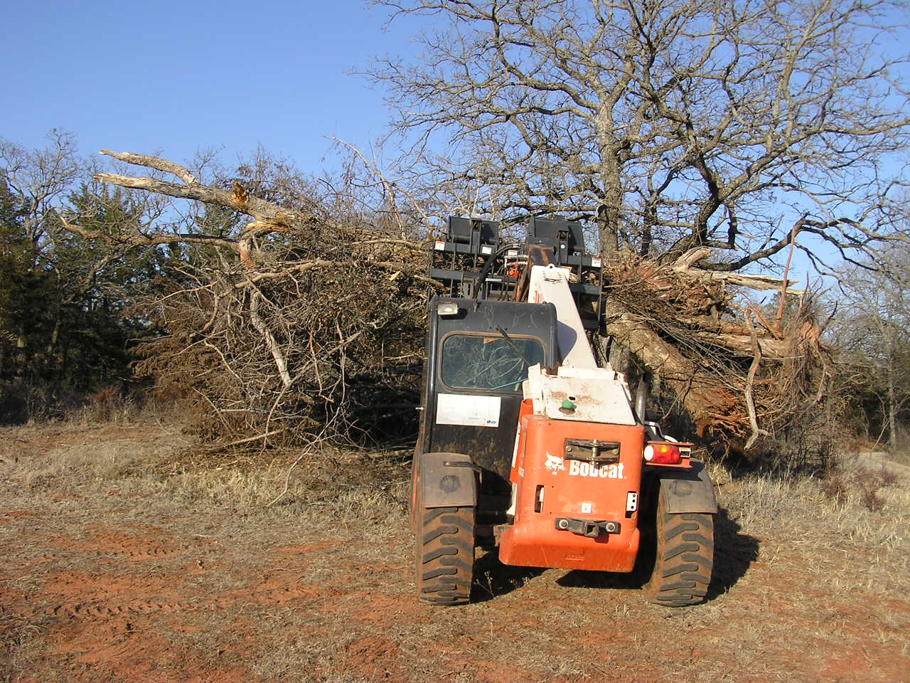

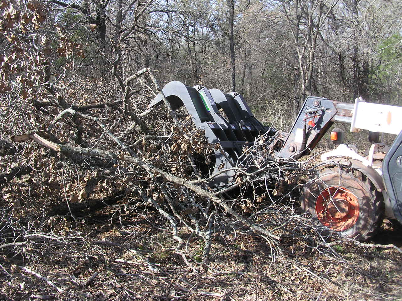

The problem, concrete around a broken wood post.
The solution, the Gorilla Grapple.
And the V417

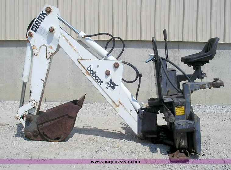

And for deep digging the full-fledged backhoe attachment.
Pictures from Google Image Search.

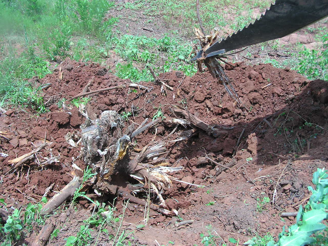

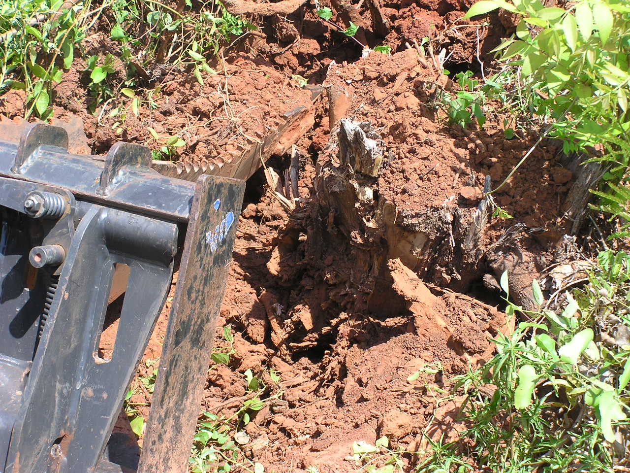

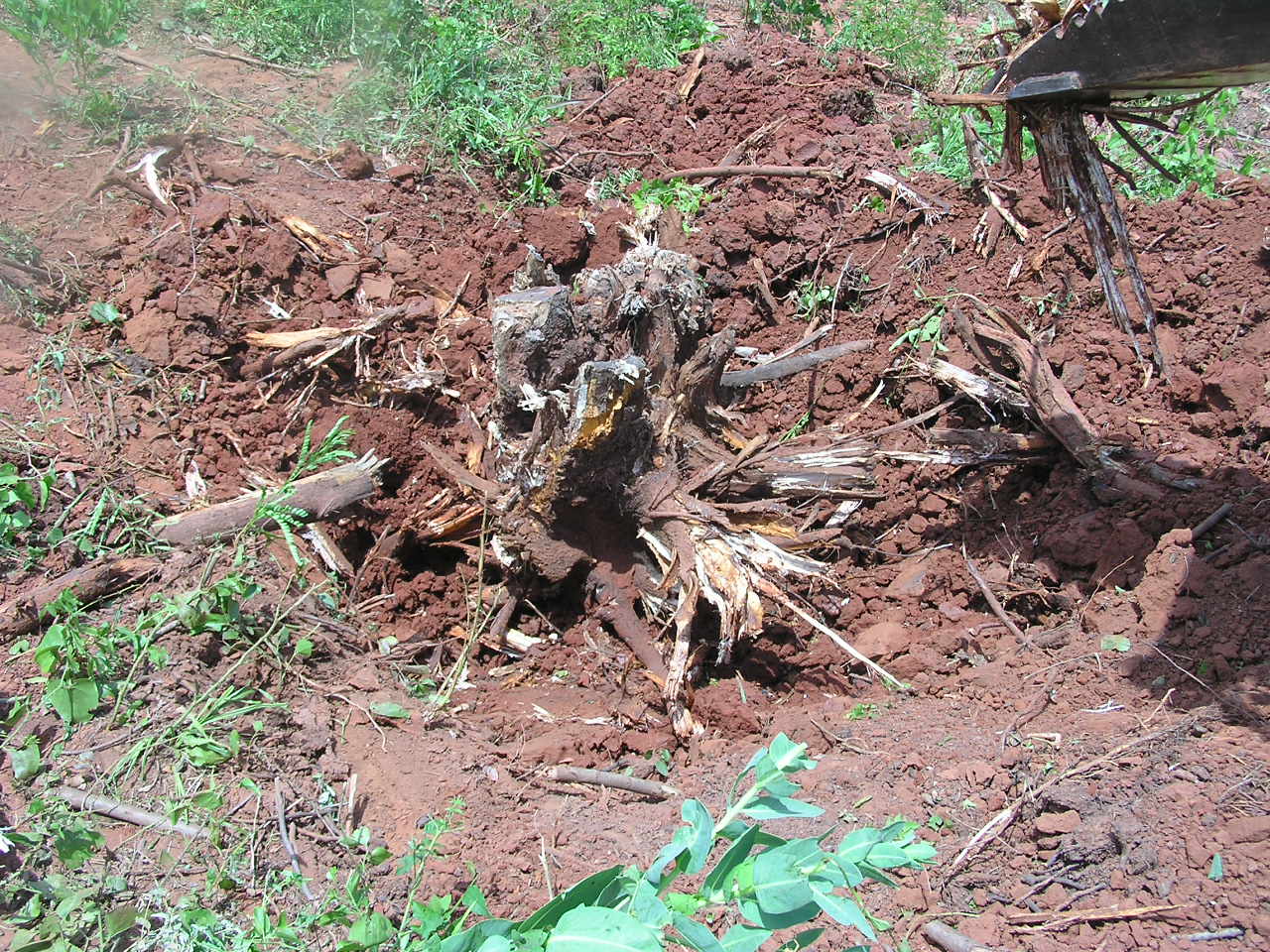

Here is a "backhoe job" that I did with the stump bucket.

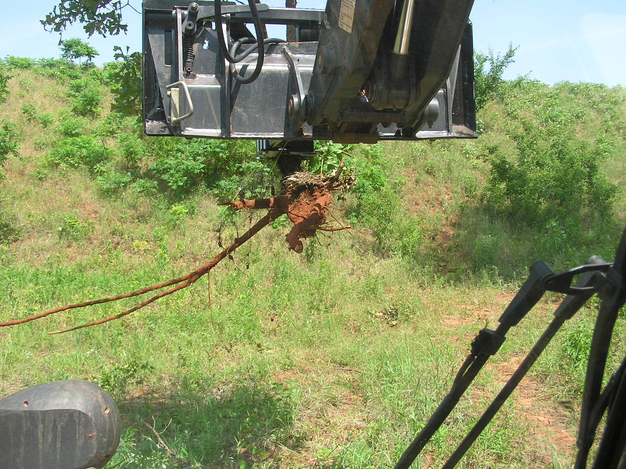

It is a small stump, with a lot of lateral roots.
Broke the roots and popped it out. :thumbsup:
Took it to the burn pile

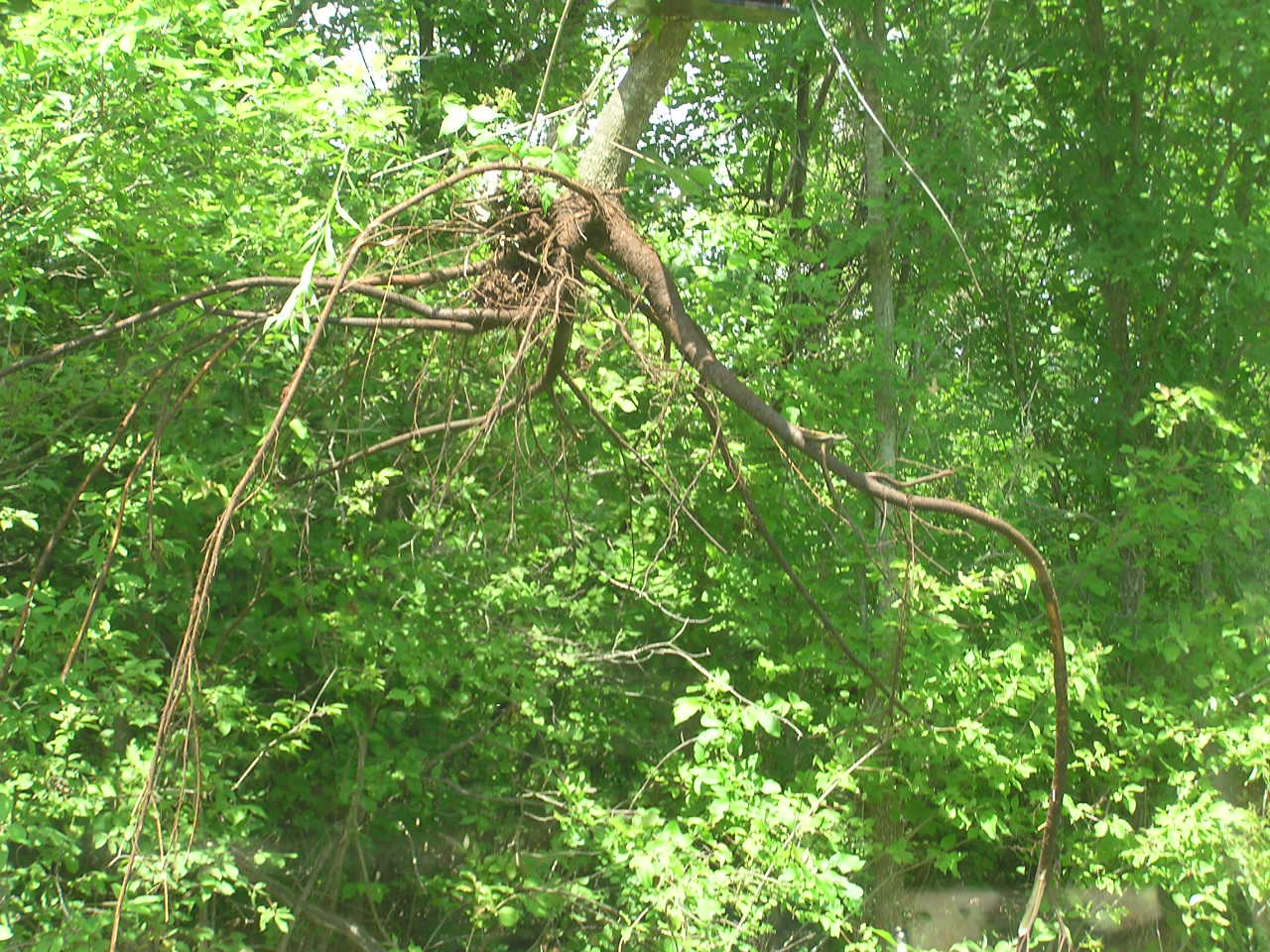

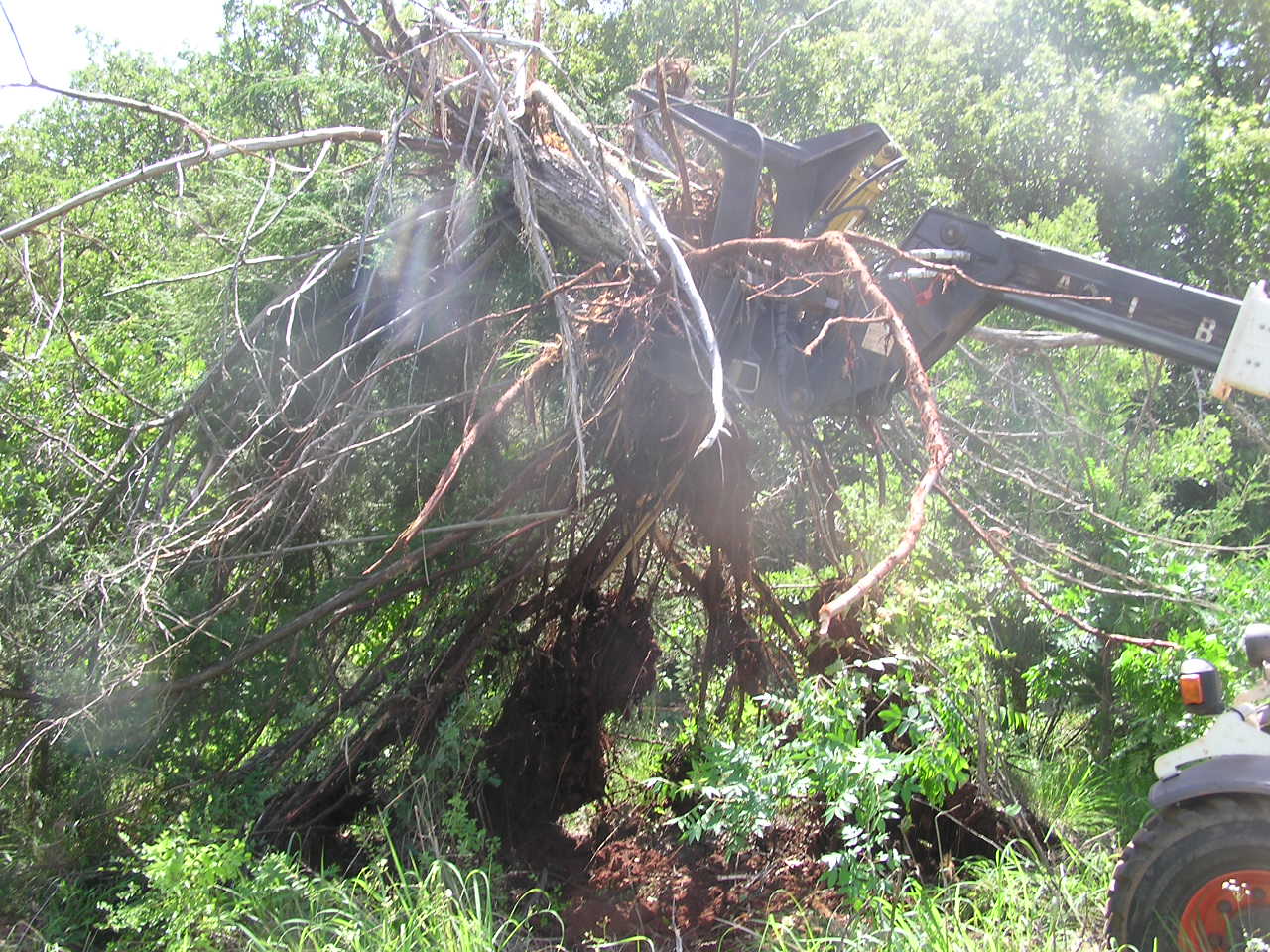

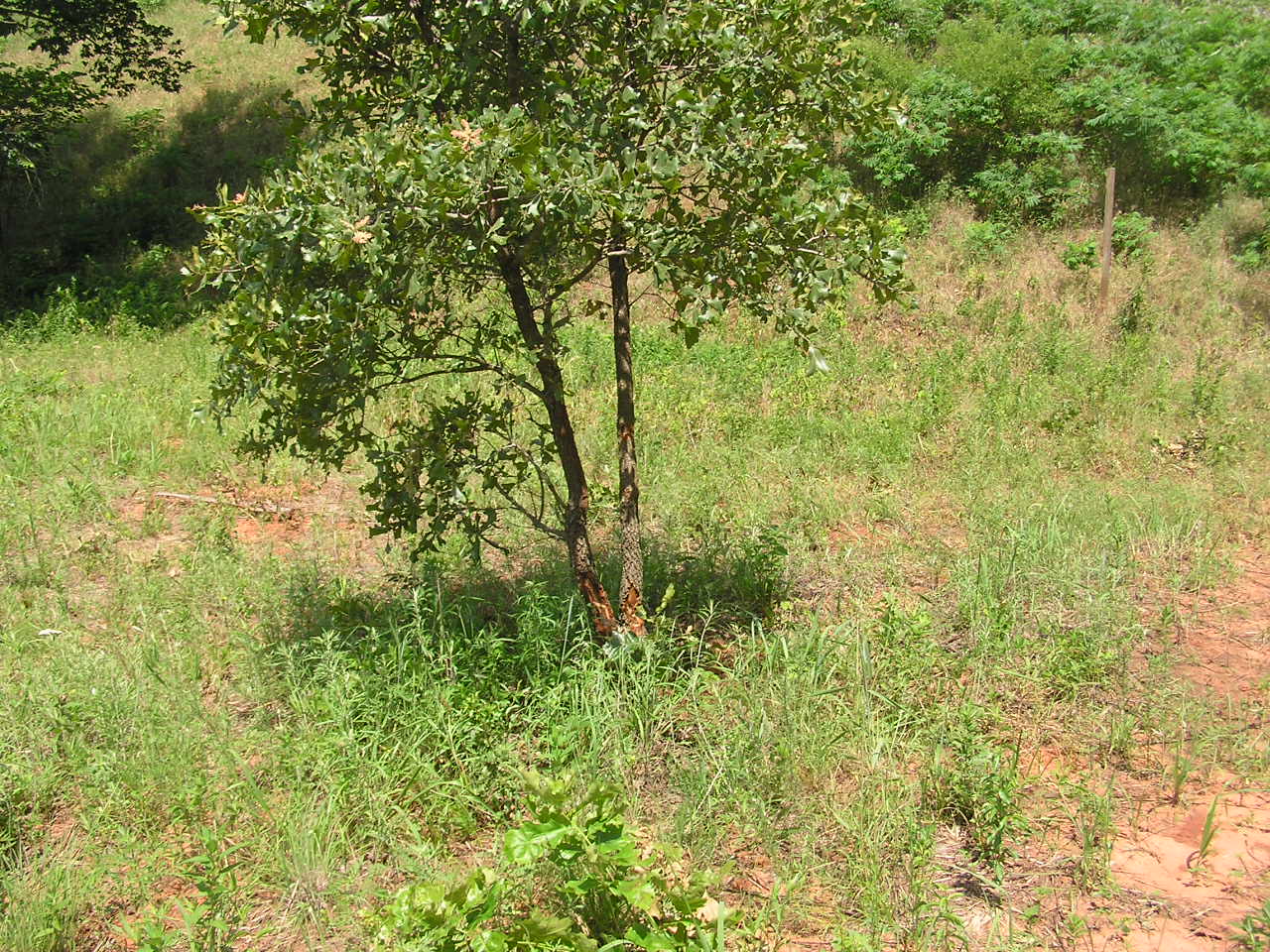

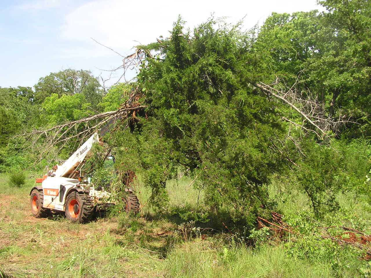

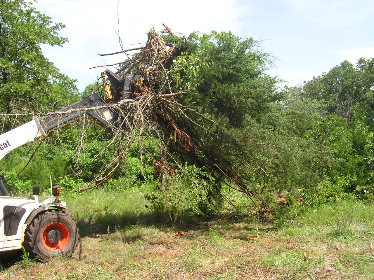

Used the tree puller on the biggest cedar tree that I have tried to pull so far. It is about 5" in diameter.
Raised the rear end when I tried to pull it straight up, so I curled down while pulling up and moving forward. That broke some roots loose. You can see the crack in the ground.
Curled up while pulling up and moving backwards. That broke some roots on the other side.
Went forward again and it started coming up.
Raised the boom, the cedar came out of the ground and brought another tree with it!
Shook the dirt off of the roots and the other tree fell to the ground.
It looks to be about 3" in diameter.
1 pull, 2 trees! :D :thumbsup:

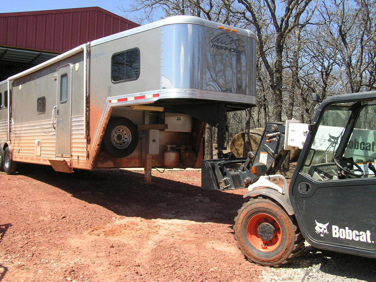

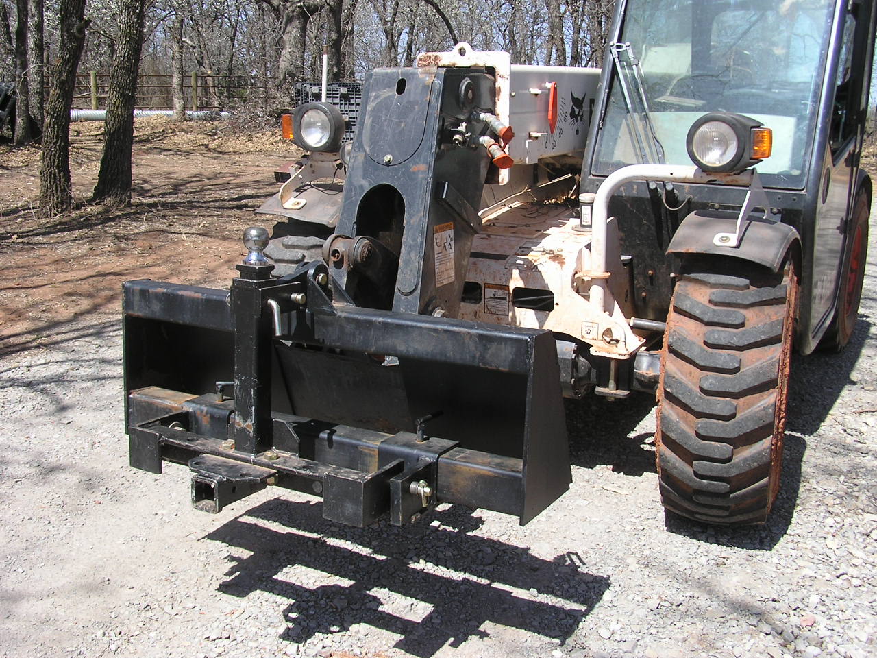

Three Point Adapter
SSQA to Cat 2 three point.
With the Cat 1 Omni Transformer and the gooseneck ball.
Bringing the horse trailer out to wash of the mud.
