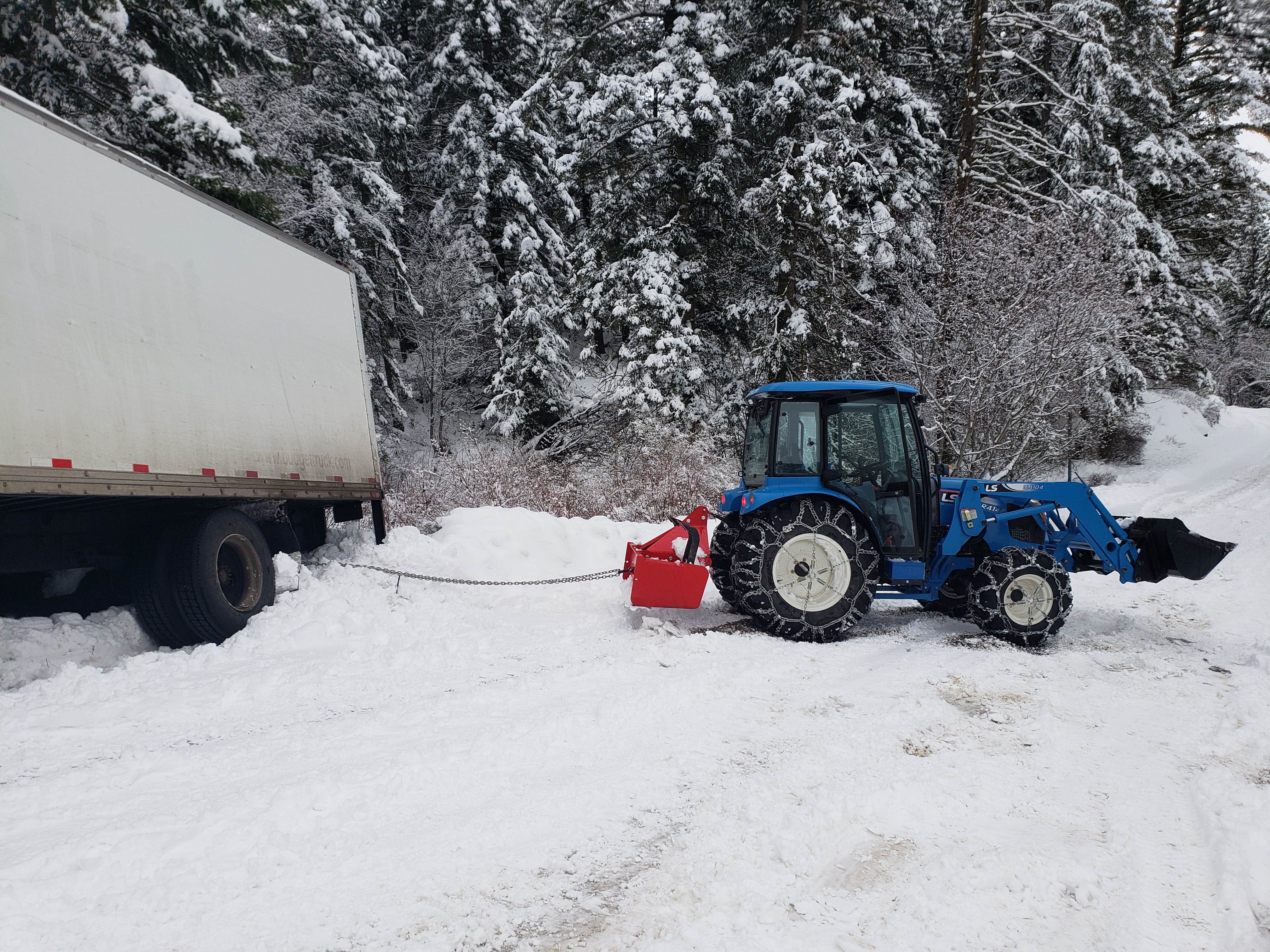

With chains, I don't slide on the ice anymore. I don't spin out (not on purpose anyway), I stick like glue. They add weight and traction. I got up and down my driveway with ease. Even pull people out of the ditch on the county road when they slide off!
That image, I did get the truck out, but needed more shoveling and tugging. But I got him out. Would not have even attempted it without chains.
You framed that and hung it over the mantle, right? I sure would.
