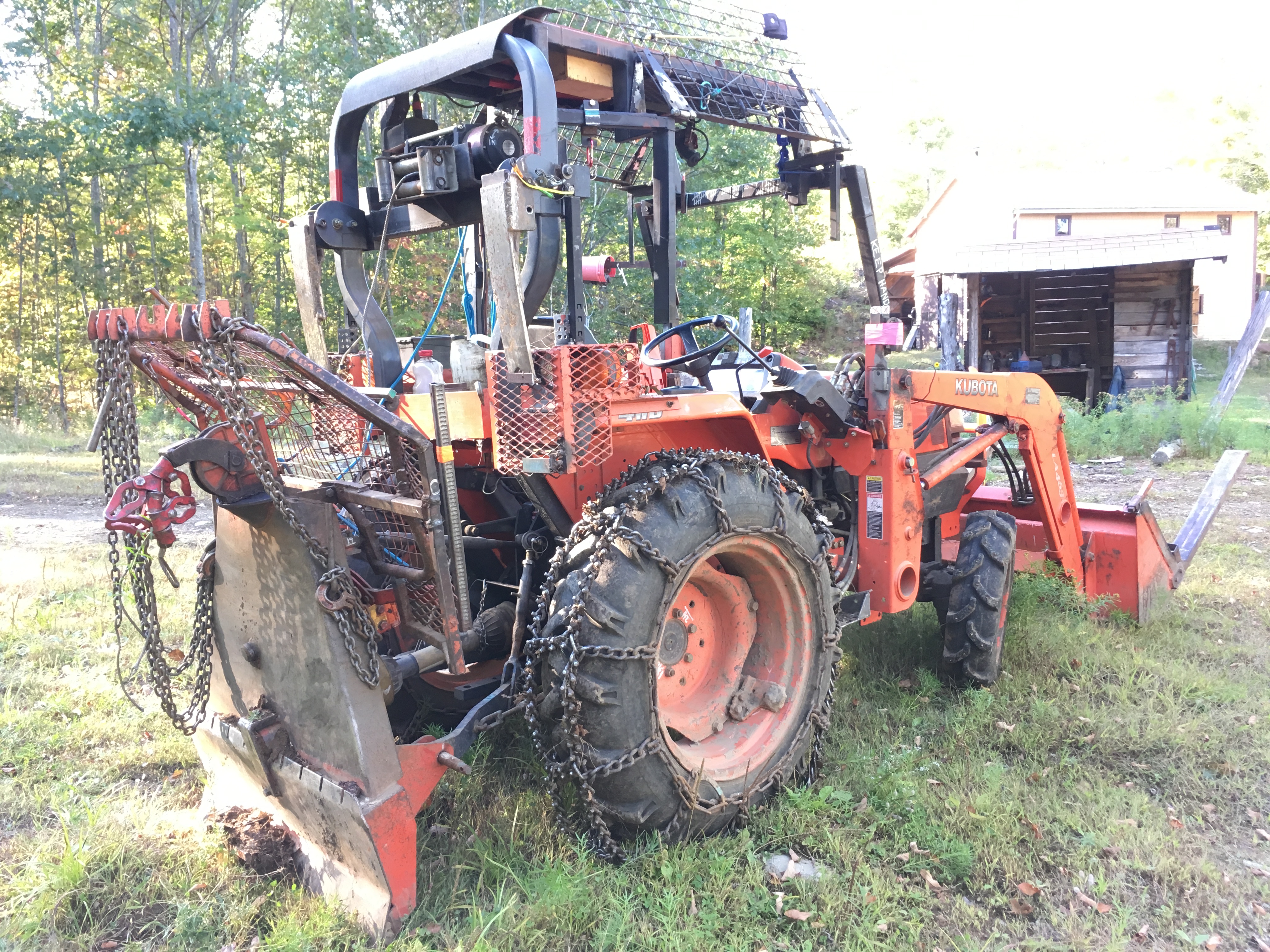

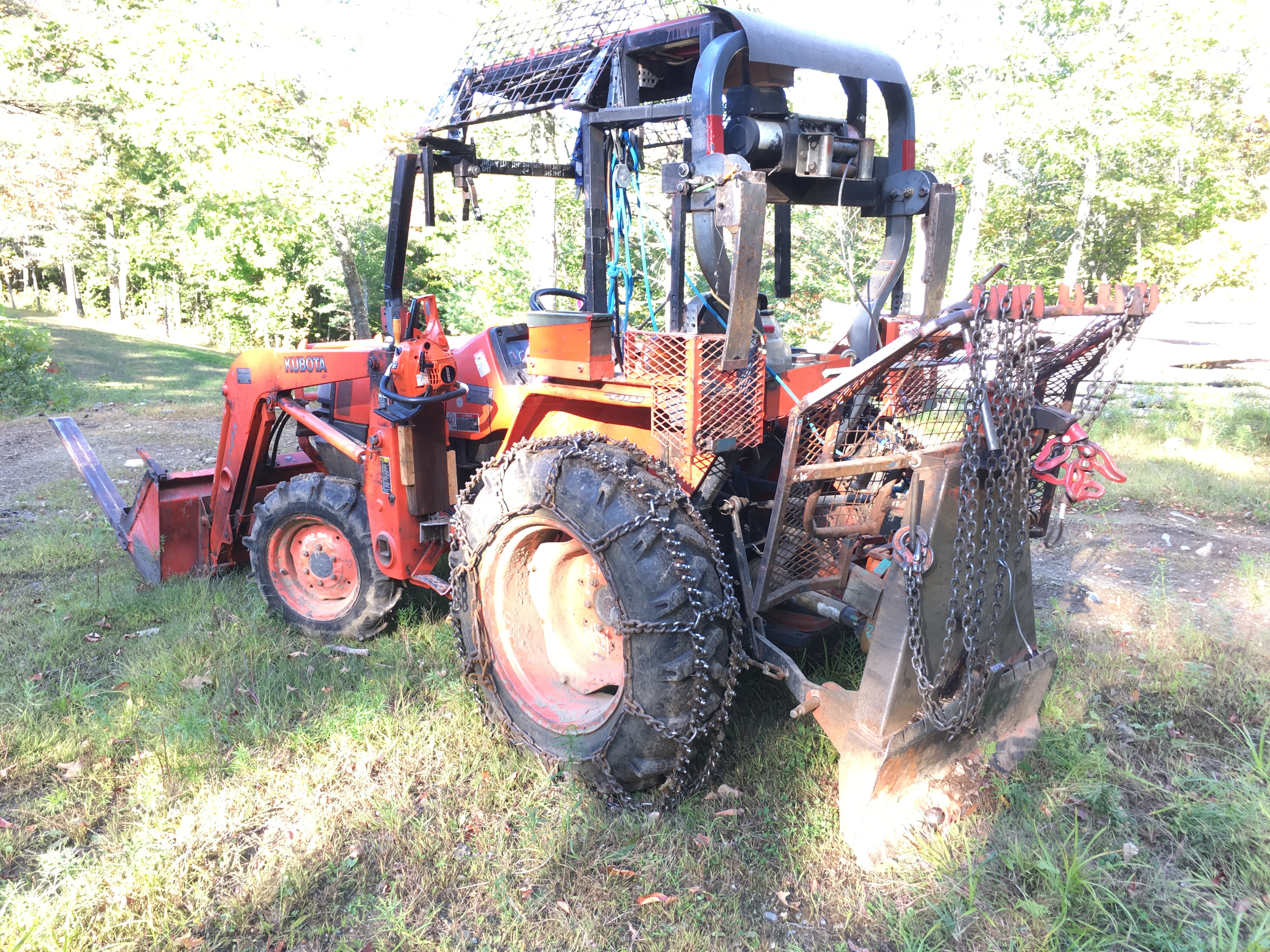

My Talon tire chains stay straight when slack, 3 years ago I put them on and left them on.

As far as tensioners I know that the Talons are supposed to be left loose,
if there is Aquillia literature when you receive your chains they may mention if tensioners are recommended or if they should be run loose.
If nothing comes with the chains the web site may have information.
On the lower left is a link for a PDF on the installation;
Aquiline Tire Chains

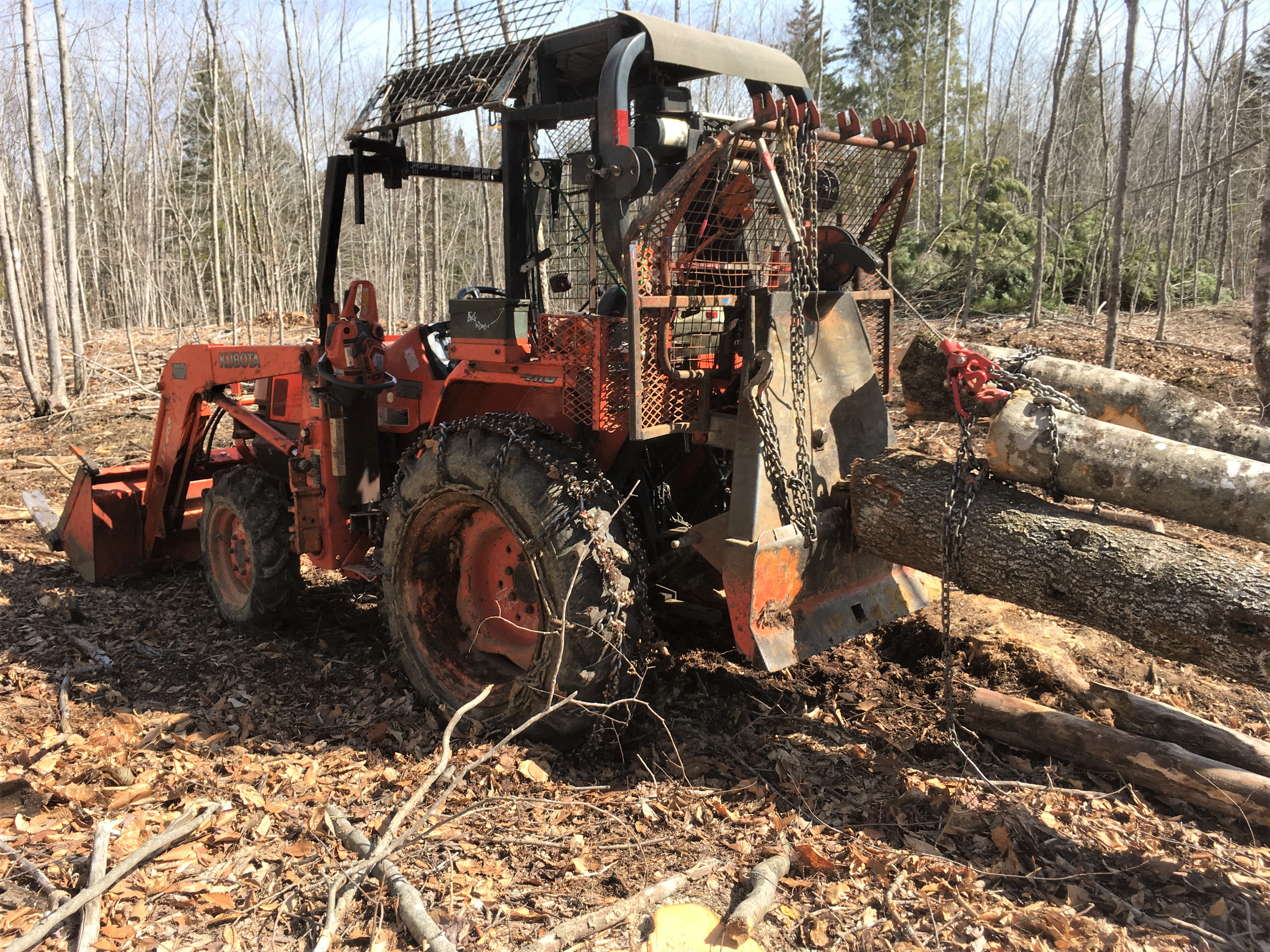

What's the second winch for?
The 12000 DC winch aids in picking up the pto winch, I without it I cant pick this hitch up below, I think it's on the weak side.
   / Chains for snow & ice -- what mistake is it most important to avoid? #50
An L3400 should lift 1985 lbs at pins, 1400 lb lift at 24” behind pins.
The winch weighs 385 lbs and pretty close to pins.
One would think that should leave plenty for the logs, no?
