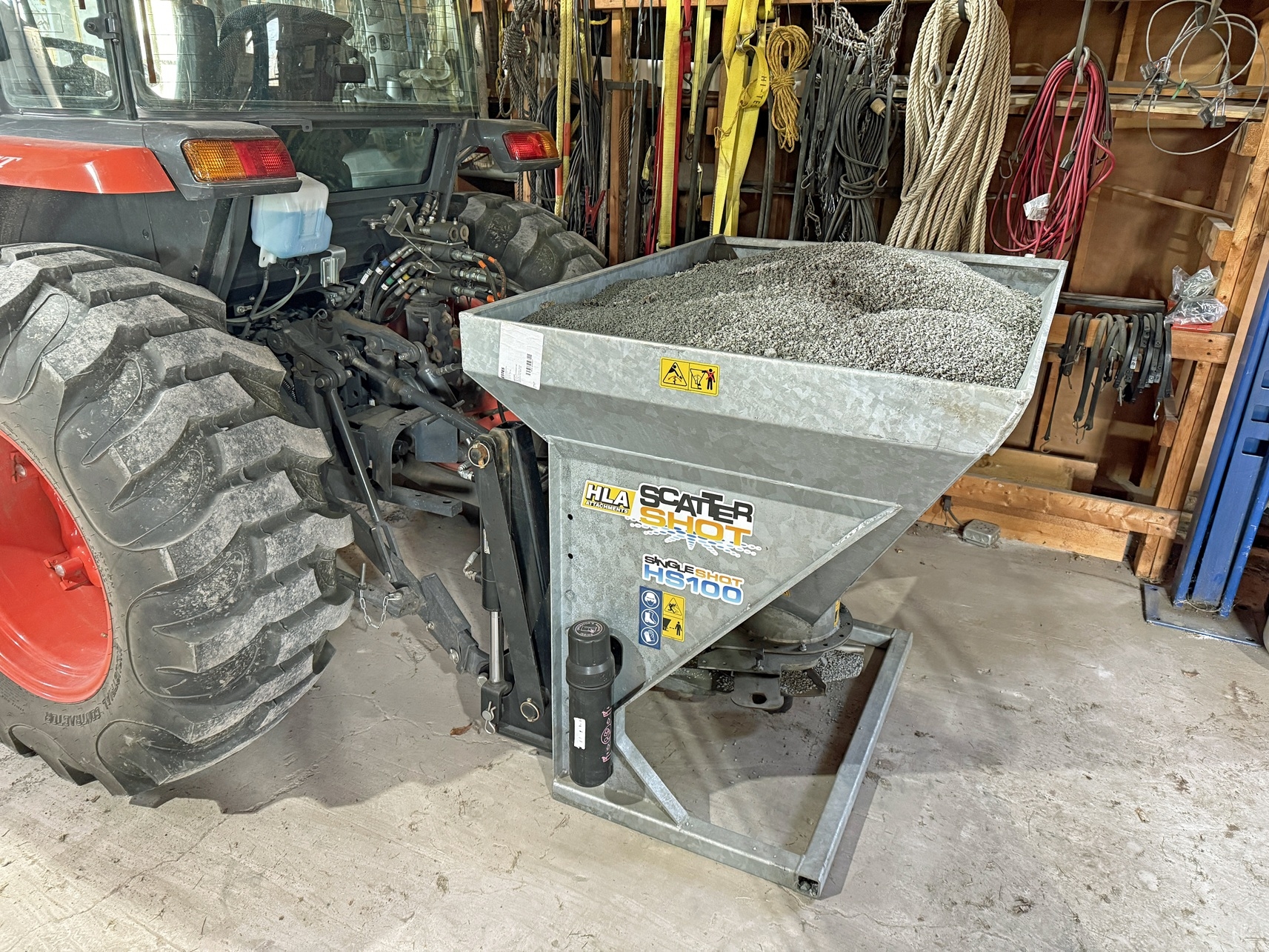

What's a self-loading spreader? I shovel sand into my sander by hand. I'm getting too old for that. Was almost considering paying someone to sand my driveway. Usually only need it a 3 or 4 times a year. But I like to be self-sufficient. Especially when you have ice and want to get down the driveway.

The self loading spreader I have is an HLA Snow Scattershot:
It has 2 hyd. cylinders that allow the hopper to tilt down to ground level. It has a cutting edge that lets you back into a pile of material and scoop it like a FEL bucket. The hydraulic spreader motor allows it to go on the FEL with an SSQA adapter & 3rd function valve, or on the 3pt using two hyd. remotes
