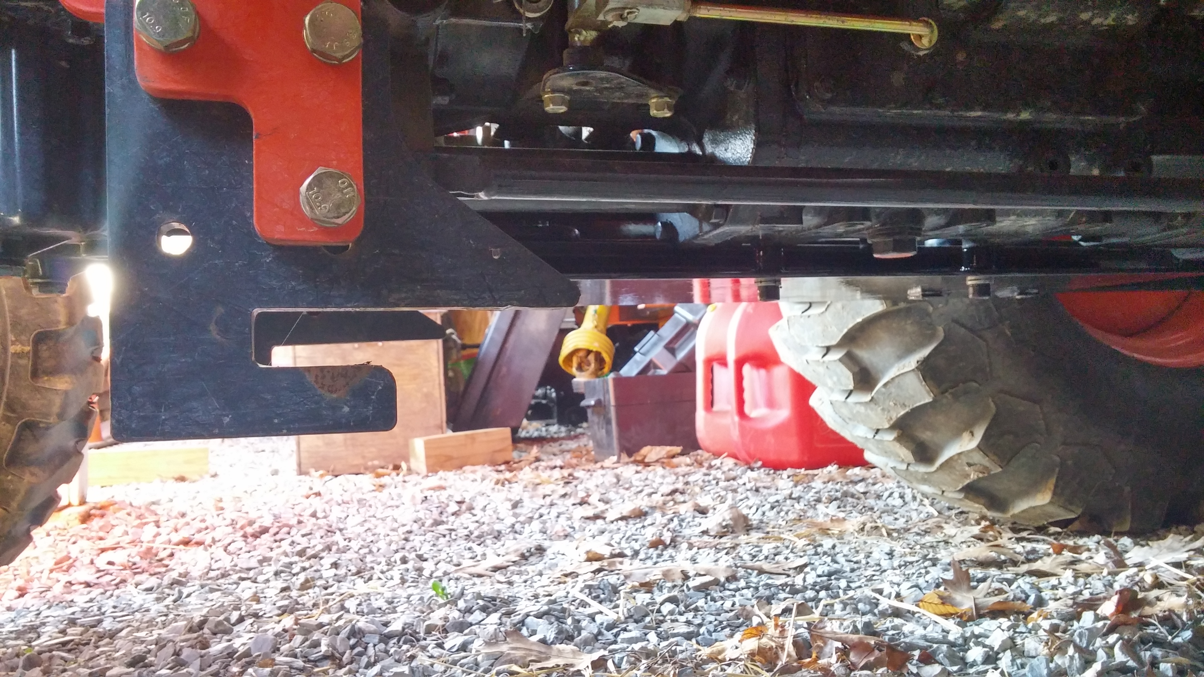

That's why I added a skid plate on my Kioti probably same location. With all the work I do in the woods around stumps I knew it would only be a matter of time.

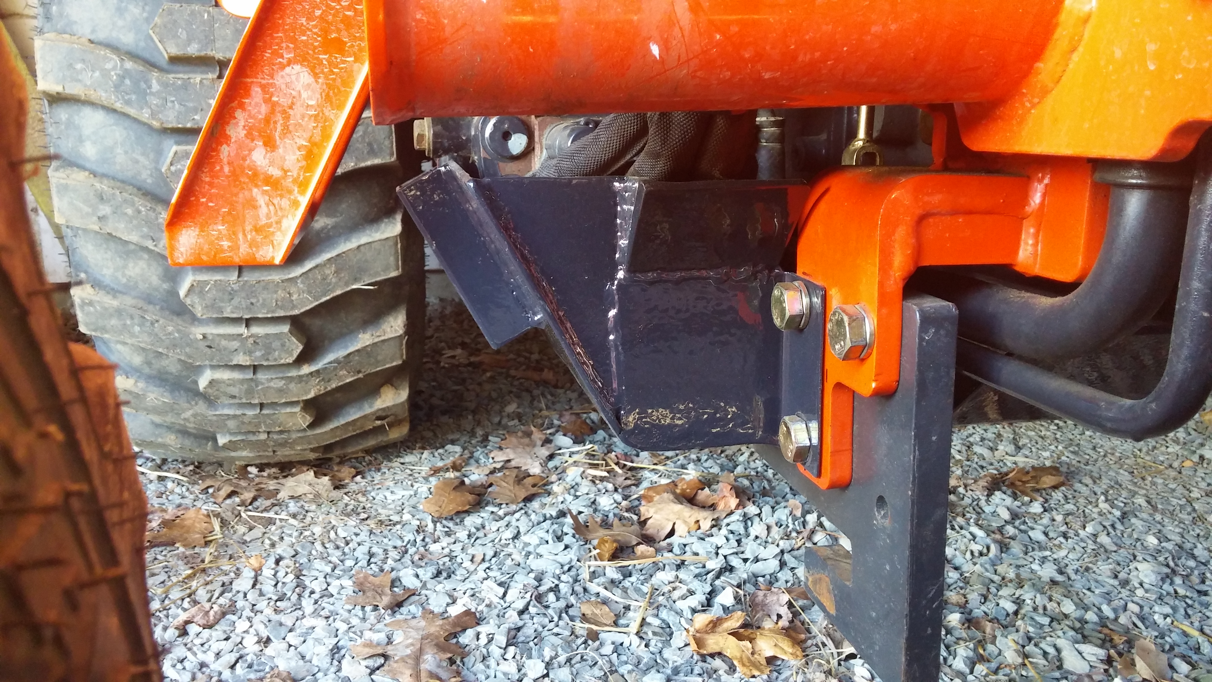

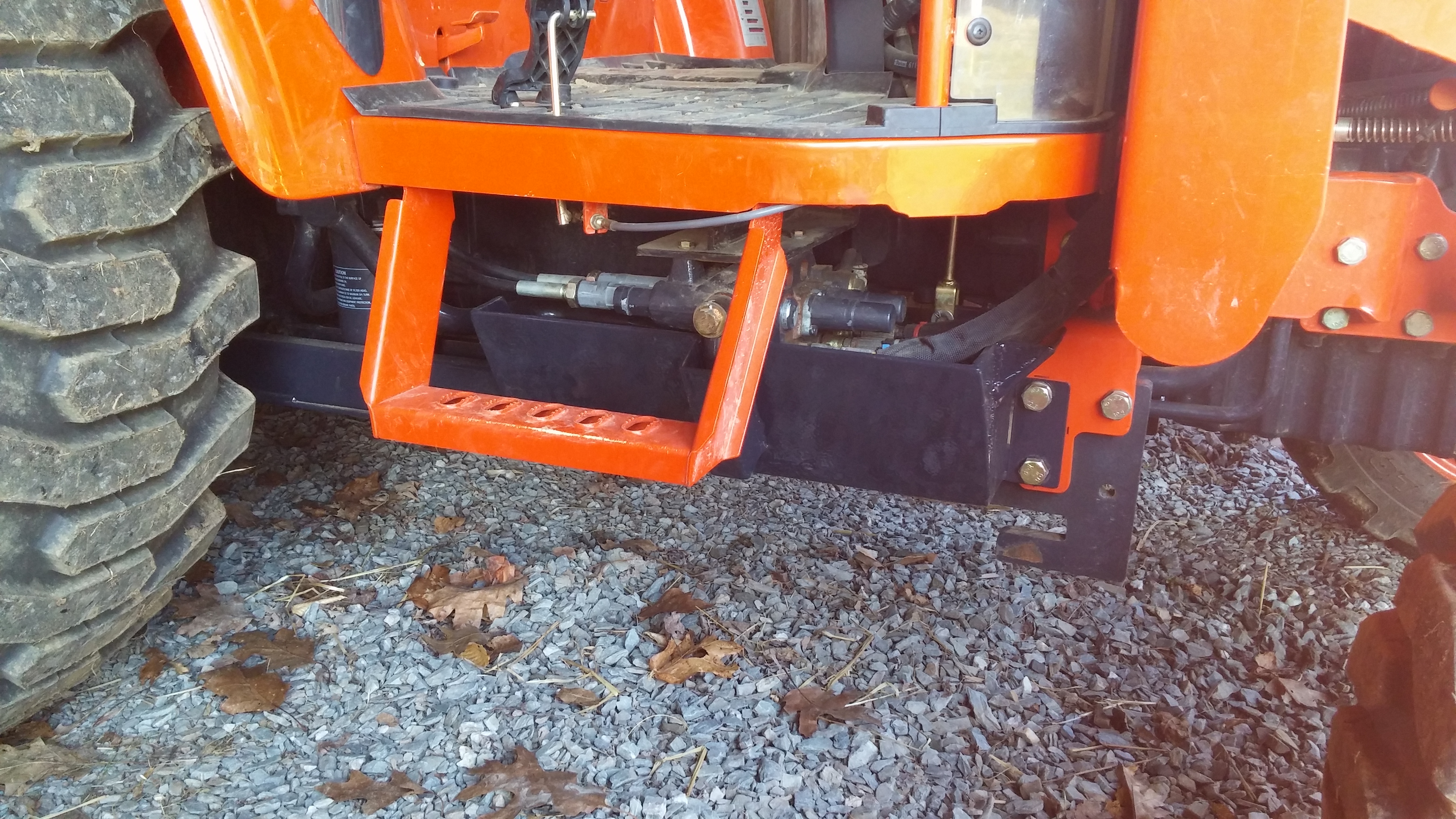

Thanks here is another picture of the plate removed I also made a port with a cover plate so that the HYD oil filter can be removed without removing the plate. It was also a bit tricky getting it in there without interfering with the backhoe sub-frame.
