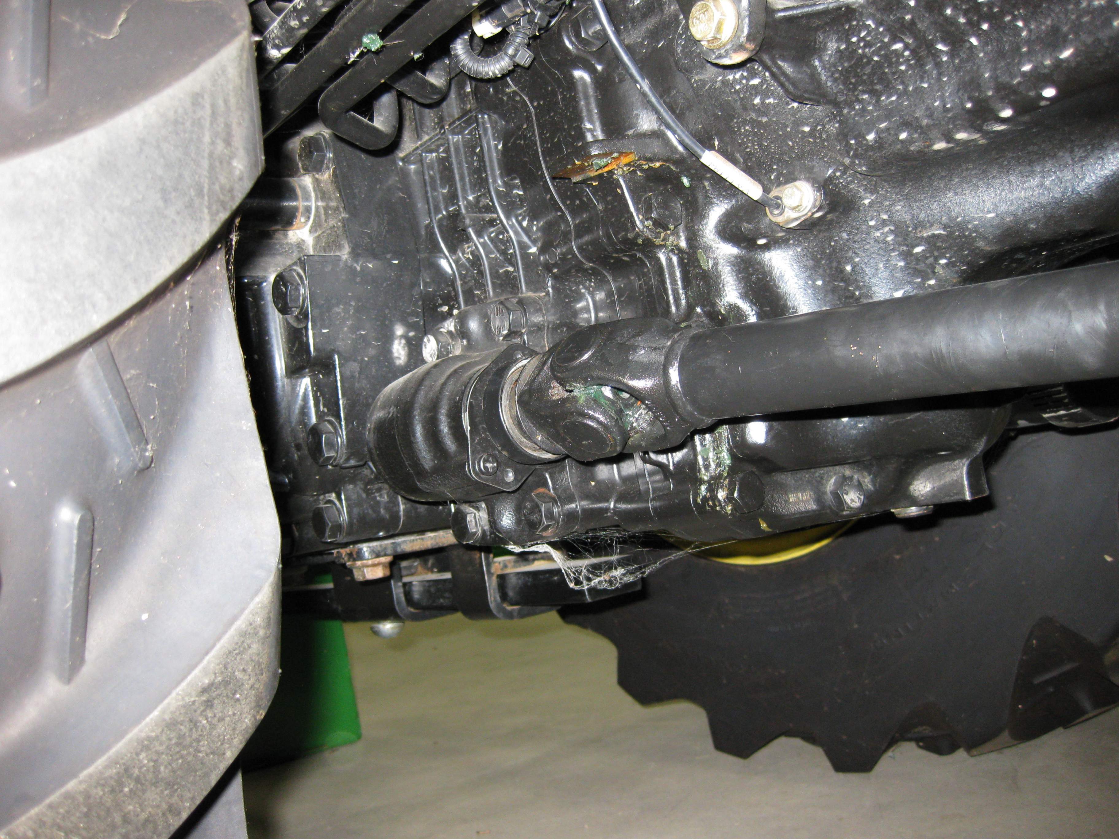

I broke a zerk on one of the u-joints on my front PTO drive shaft that I use for my 59" front-mounted snowblower. My grease gun pulled off the piece with the spring and ball bearing...who knows where it went. I got the base of the zerk out and went to my dealer; he gave me part number JD7760. This is a 1/8", 65 degree angle fitting. Unfortunately, it's close but not a good fit...its shank is a tad too long so I cannot fully insert it. I've looked through all the JD zerks on JD Parts I can find but I just can't seem to locate the one I need. I'm obviously not looking in the right place. Anyone have any thoughts? Thanks!

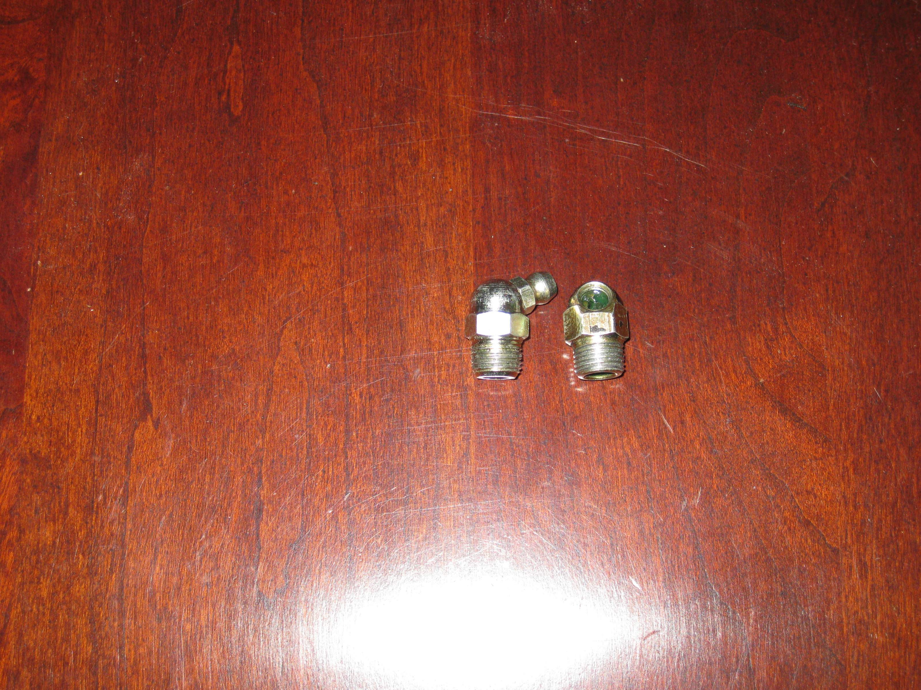

Can you post a picture of the fitting you have? Is the fitting the same in other end of the PTO shaft? Can you post a picture of it?

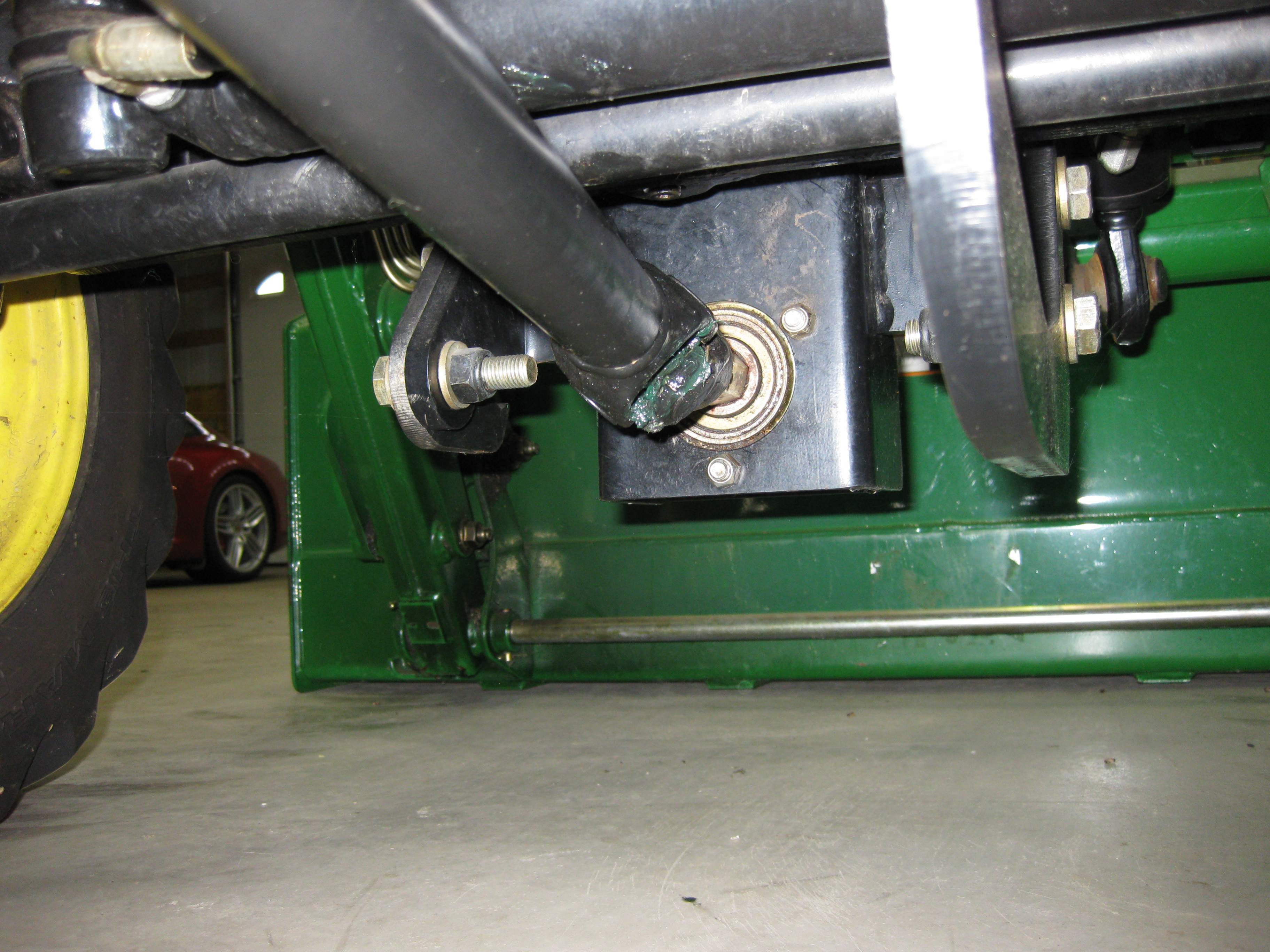

OK. My bad. I obviously did not explain my problem well enough in my initial post and for that I apologize. This darn English language! I am talking about a zerk on the front PTO drive shaft, not the snowblower drive shaft. When the questions began about the sb I was puzzled but not intelligent enough to realize I had screwed up.

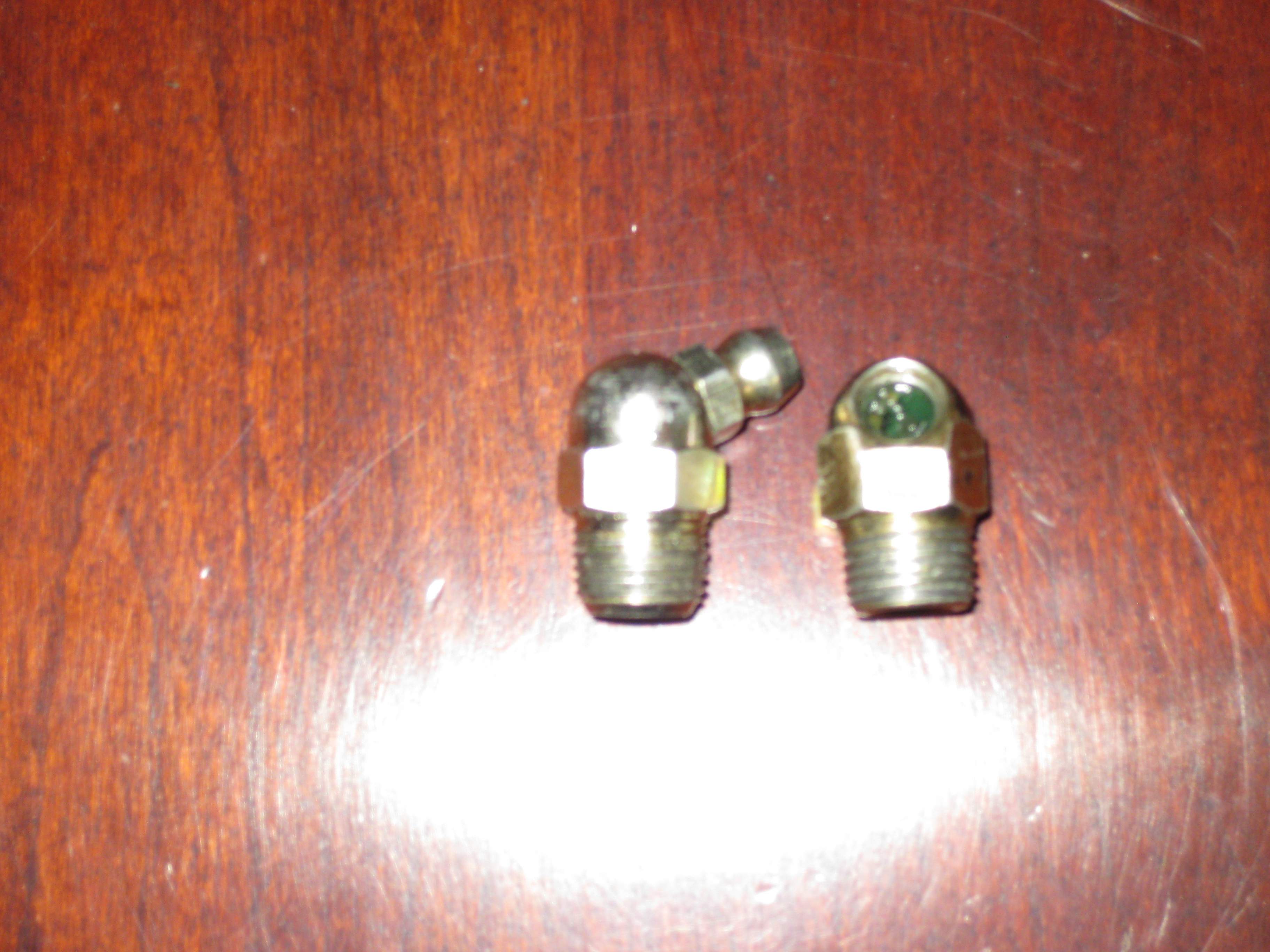

IMG_0962.jpgIMG_0961.jpgHere are 2 photos with the JD7760 zerk on the left and the base of the zerk (with top missing that I removed from the PTO drive shaft) on the right.
/ Cannot Find Part Number For JD3520 Grease Fitting #11
i bet jd doesn't make zerks but uses off the shelf fittings

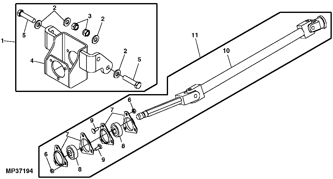

You still need to look in the snow blower catalog. Only they do not show a breakdown of the drive shaft. Key #10 is the drive shaft, LVA14109 $405. Not keyed is AN278257 cross and bearing assembly $72. I am not sure what you get with that.

Understood. We're speaking the same language now. All the diagrams I see for AN278257 do not show a lube fitting. I'll figure something out. Thanks for all your time.
