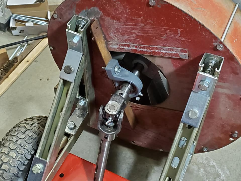

Thank you! Are you referring to the pillow bearing mountings or the Unistrut?

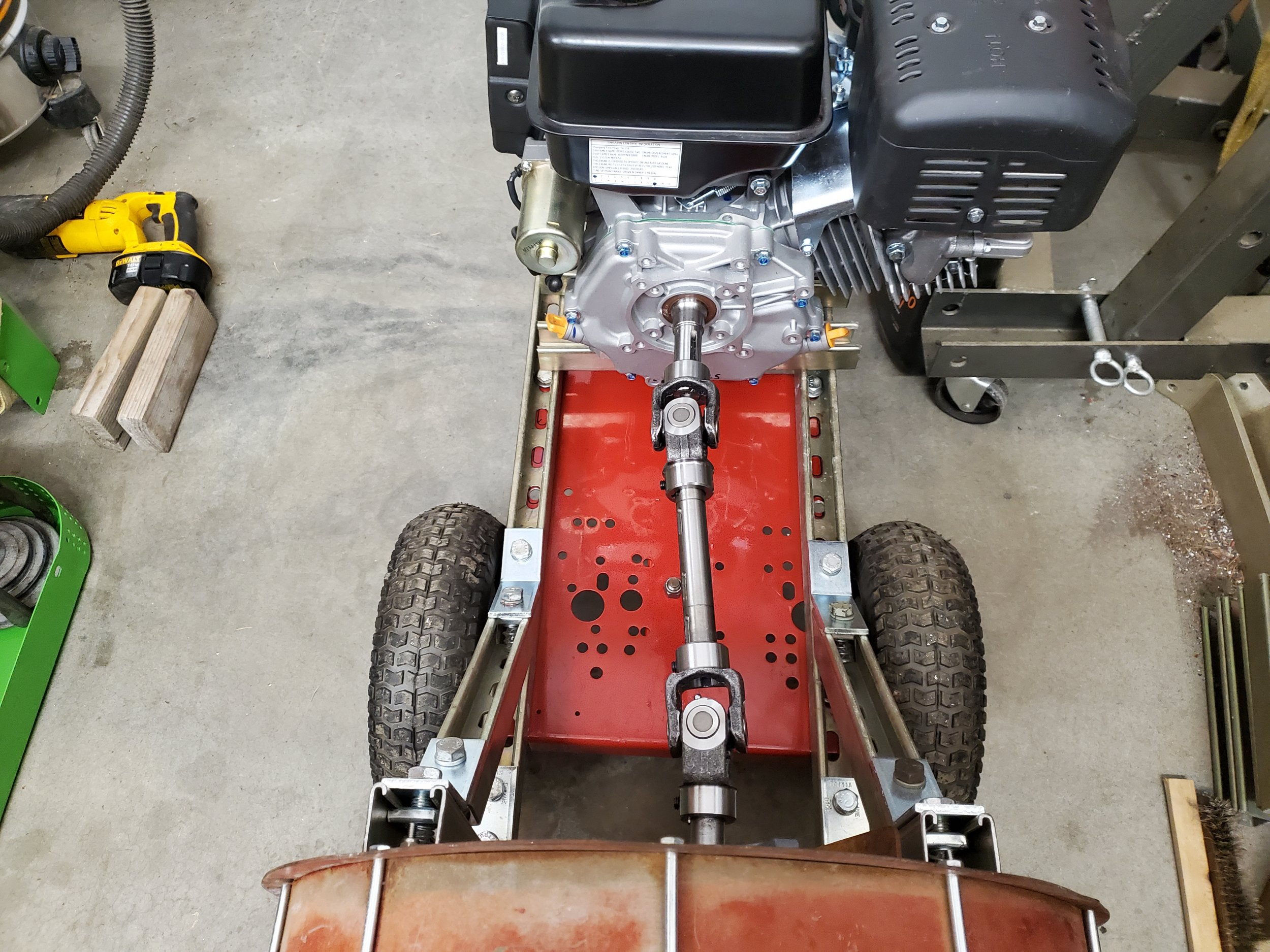

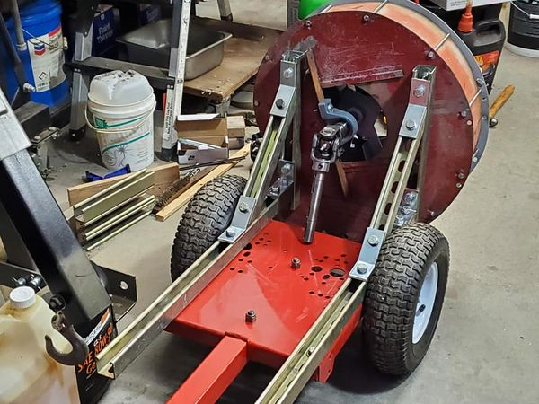

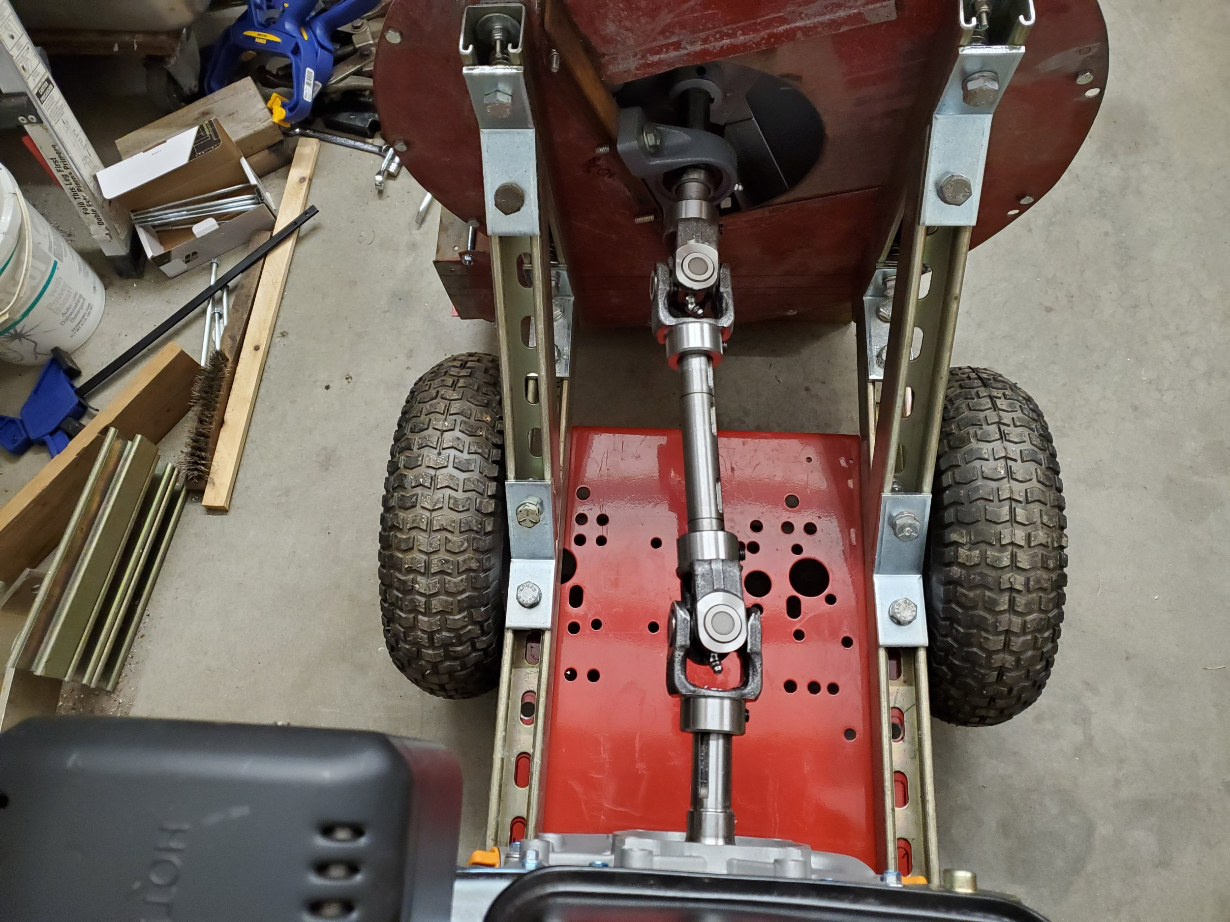

After several trials this is what culminated. The U-joints couldn't handle the speed, and the spider coupling couldn't handle the torque. The diverter can direct air to the right or left. Video shows it running at about half speed.

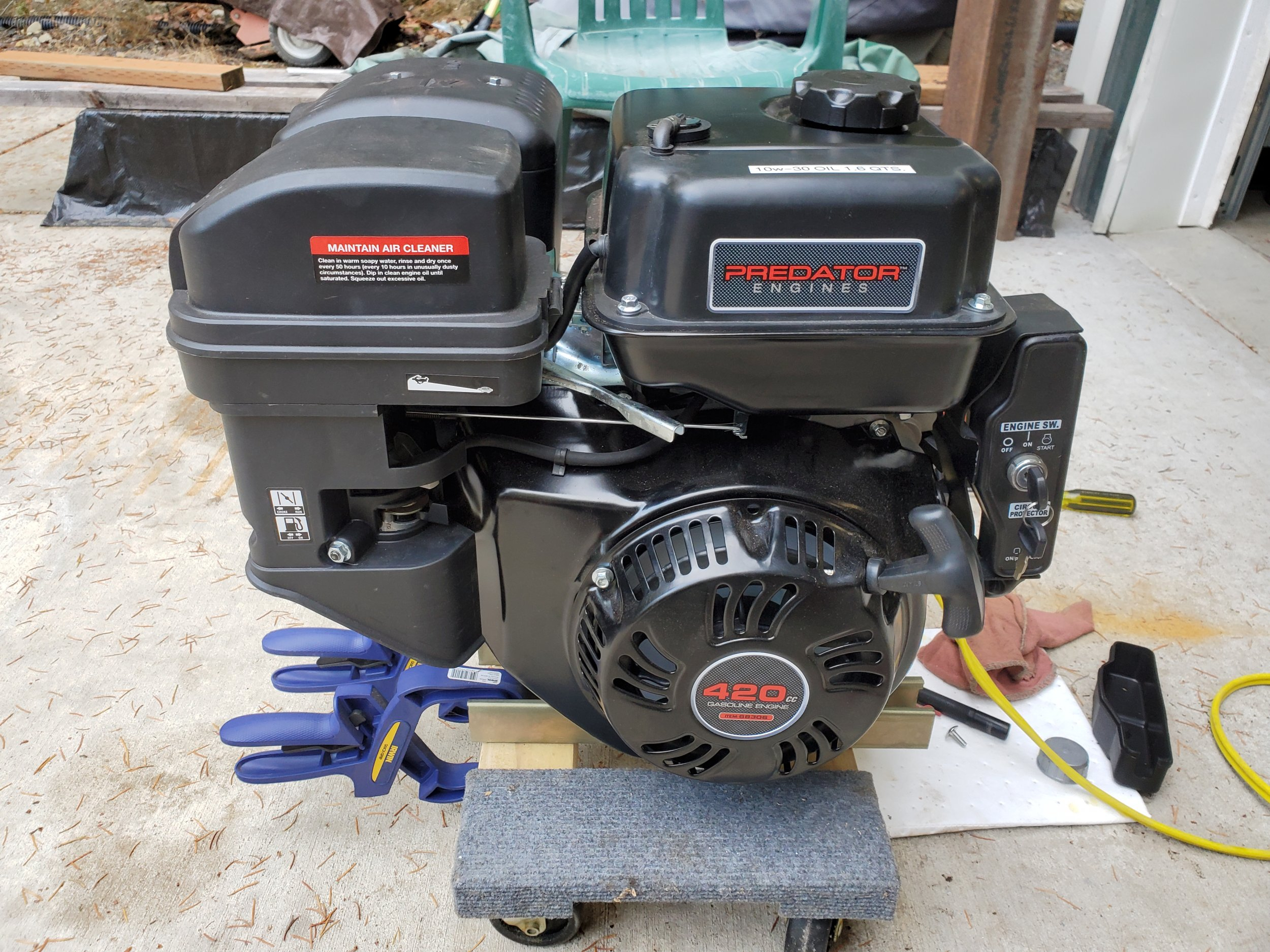

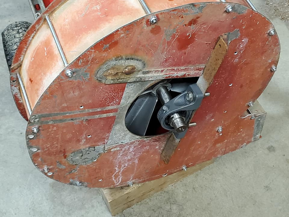

Well, it worked great for awhile, then I noticed that the fan blade welds were cracking at the hub. Not good, and new fans of the correct size are pretty expensive. So, back to Craigslist and found this gem. No information on it can be found for this model anywhere. Speculating it was built in the late '80's to early '90's by Atwater-Strong Co. As you can see, it's PTO driven but that won't work for me. Here's the question: Would you self-power it and make it towable with an ATV or lawn tractor, or just rob one of the fans for my little DIY blower?

In the video, I guesstimated the tractor PTO was turning about 175 r/m. I did all the pulley math and it came out as: 540 r/m input speed = 2,200 r/m impeller speed, but the HP requirement is unknown. The model is a PTO 25, so I'm assuming it means 25 HP? It weighs at least 400 lbs. Like you, I thought about the pulley swap. The PTO shaft is 1-1/2", and the idler and blower shafts are 1-1/4". The swap would be easy to do on paper because all the pulleys are Woods brand with interchangeable hubs, but would require dismantling half of the rusted solid machine. If I were to leave the pulleys alone and just put a 14" pulley on the PTO, belted to a small engine. it would look like the pic.
Right now I'm attempting to remove the rear impeller. It's aluminum frozen to a steel Woods hub. It may fit well in my other blower.
