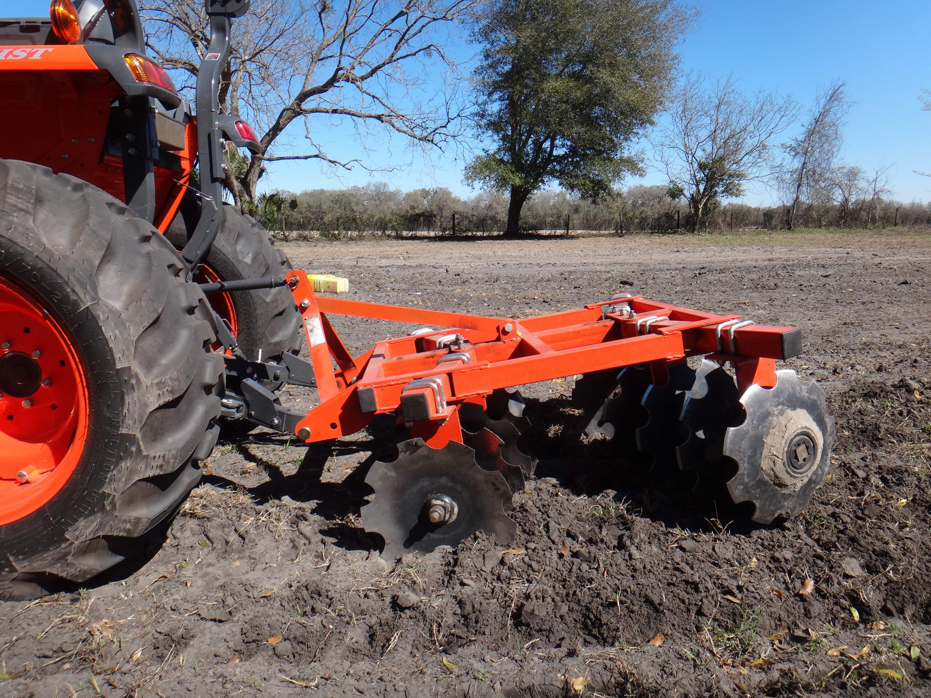

February 28, 2013 I took delivery of a Howse*, box-frame, Tandem Disc Harrow, Model DLHT16822B. The dealer, from who I bought my tractor, recommended the Howse DLHT. At the time I was researching Disc Harrows from Land Pride, Everything Attachments (ETA), TSC/Countyline and Monroe Tufline.
Howse describes the DLHT series as MEDIUM DUTY. Howse DLHT is a 16/18 Disc Harrow, meaning 16 discs, each 18" in diameter, spaced 9-1/2" apart. It cuts a swath nominally 5'-6" in width, adjustable by sliding the disc hangers in or out. The Howse DLHT16822B weighs 587 pounds. It has a 1" axle on sealed flange bearings. (There is a T-B-N consensus that to cut vegetation Disc Harrows should have 40+ pounds weighting each disc. My Howse has 37 pounds weight per disc; except when tilling optimally moist soil I wish for more weight.)
My primary Disc Harrow objectives involve CUTTING; opening new game feed plots, maintaining vegetation free fire breaks and vegetation control along woodland trails. Harrow weight on 16 discs, rather than 20 discs, puts more cutting weight on each disc. Spacing between discs is 9". If you have rocky soil, 9" disc spacing will collect fewer rocks.
Tractor users with SMOOTHING (plow furrows) as their priority may consider the 20/18 or 20/20 configuration. Both have 7-1/2" spacing between discs.
Disc Harrows are available with two types of discs: notched and smooth. Notched discs cut pasture grass and crop stubble better; in open soil notched blades jerk out trash, meaning vines and tree roots, which sporadically stick in the notches. Smooth discs roll over some vegetation that notched discs cut through.
Standard configuration for Howse Disc Harrows is notched discs front, notched discs rear.
((Synonyms for individual discs: wheels or pans.))
Discs for compact tractor harrows come in 16"-18"-20"-22 diameter. Subcompact tractor owners will be better served by a PTO powered Roto-tiller rather than a Disc Harrow. Compact, 4-WD tractors with a bare weight of 2,700 pounds can handle 18" diameter notched discs. Tractors with bare weight of 3,500 pounds can handle heavier 20" discs; tractors with a bare weight of 4,500 pounds may opt for 22" discs. Weight is your friend.
Issues with disc diameter are concavity, wear, harrow weight and clearance lift. Smaller diameter discs generally have less concavity (less "float") than larger discs, so they theoretically penetrate easier; smaller discs are thinner/sharper than larger diameter discs. Larger diameter discs generally have greater concavity, so move more soil laterally. Larger diameter, thicker discs wear longer before requiring replacement. Larger diameter, thicker discs add to harrow weight, which offsets "float", improving penetration.
Replacement 18 inch discs are available in 3mm, 3.5mm, and 4mm thickness. Replacement 20 inch discs are available in 3.5mm, 4mm, 4.5mm, 4.76mm, 5mm and 6.35mm thickness. As shown, diameters and thickness overlap. Thicker discs are heavier. (Agri-Supply offers 516 individual disc types on its web site.)

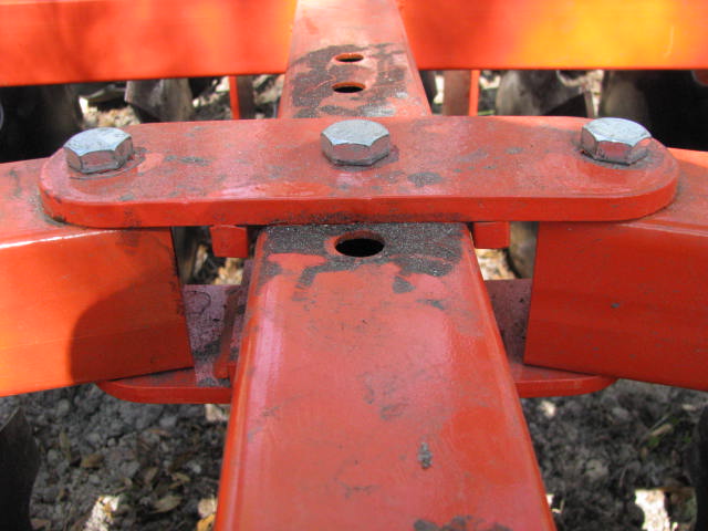

Discs of larger diameter require more lift from the three point hitch. Clearance can be an issue when crossing ditches, rough ground and loading or unloading a tractor mounted Disc Harrow from a trailer.
The three point hitch Top Link is used to adjust relative front/rear gang pressure on soil. Shorter Top Link, more soil pressure from front gang. Longer Top Link: more soil pressure from rear gang. When pulled at a good pace the front gang flings soil outward, the wider rear gang flings soil inward. I use my Disc Harrow for dirt road maintenance, with Top Link adjusted long so soil is collected from high road edges and thrown inward.
Some increase in pan penetration can be achieved by shortening the 3-Pt. Top Link until the rear gang is raised into the air, transferring rear gang weight to the front gang. This can be helpful penetrating vegetation on the first pass across a field.

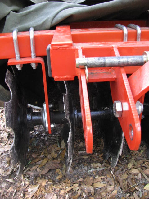

My Howse has a dropped double clevis (two "ears") to receive draw pins. A dropped clevis is desirable on a Disc Harrow for an 25-60 horsepower tractor; it allows the 3-Pt. to lift the harrow earlier. Note Photo showing my Howse in the air. Minimum disc height above ground is 14-1/2", greater than 14" ground clearance of my B3300SU tractor. This is ideal.
I prefer a wide double clevis, which accepts separate draw pins, to protruding, bolt-on "open" draw pins. The double clevis provides a stronger tractor/harrow connection, which distributes draft strain. TSC/Countyline by Tarter, 84 Disc Harrow, suitable for a tractor larger than mine, has "open" draw pins protruding from the harrow frame; in a "normal", undropped position. The Land Pride DH1560/60 has dropped "open" draw pins. Wider Land Pride Disc Harrows have preferred double clevis standard.
The Howse, with its 3" wide, dropped, double clevis is the easiest implement I own to mount on the three point hitch.

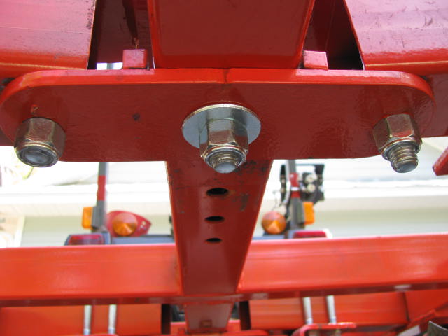

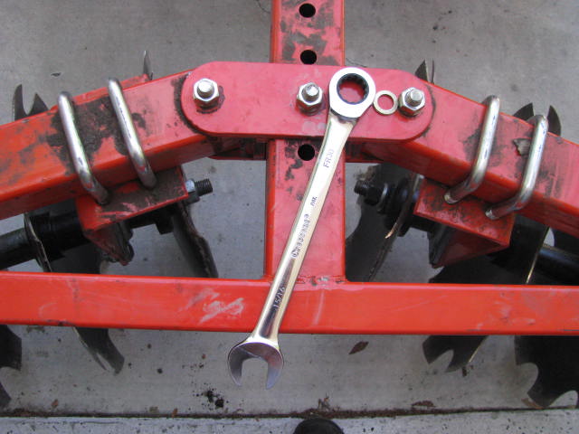

Most 5'-6'-7' Disc Harrows provide gang angle adjustment via clamp plates and adjustment holes in the frame. Clamp plate adjustment is simple, strong and inexpensive to manufacture but time consuming to adjust in the field. While the need to change gang angles will vary by user, adjustment is NOT an everyday event for me.
My Howse has five adjustment holes in the frame per gang, some brands have four.
Clamp plate adjustment works via three through bolts/nuts per gang, clamping twinned upper and lower adjustment plates, which have a pair of rib guides on the top plate mirrored by a pair of rib guides on the bottom plate. To adjust one gang angle, the two outer bolts/nuts are loosened with a wrench, the center bolt, which passes through adjustment holes in the frame, is removed, then the gang is pulled and jiggled to line up holes in sliding adjustment plates with alternate holes in harrow frame, using gang length for leverage. The center bolt is replaced and all three bolts/nuts tightened with the wrench. Repeat for the second gang. {Loosening/replacing bolts/nuts is a 15 - 20 minute process.} I have applied wax lube to the harrow frame over which the adjustment plates slide. New, it adjusts easily. I understand with paint abrasion, rust, dust, deformity, etc., gang adjustment becomes harder. However, I will settle on a 'default' gang angle setting soon and only change gang angles occasionally thereafter.
Some TBN threads suggest substituting a 5" pin as a pivot, in lieu of the center bolt. With only a center pin, it seems possible the center support could "jump" the guides under load; stay with the center bolt and nut.

Photo #1 Howse DLHT 16822B
Photo #2, #3, #4 Clamp Plate adjustment of gang angles.
Photo #5 "Double Ear" dropped clevis.
Photo #6 Lift clearance.

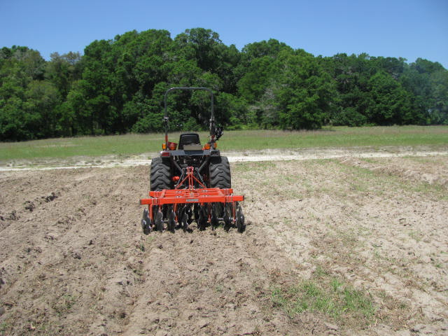

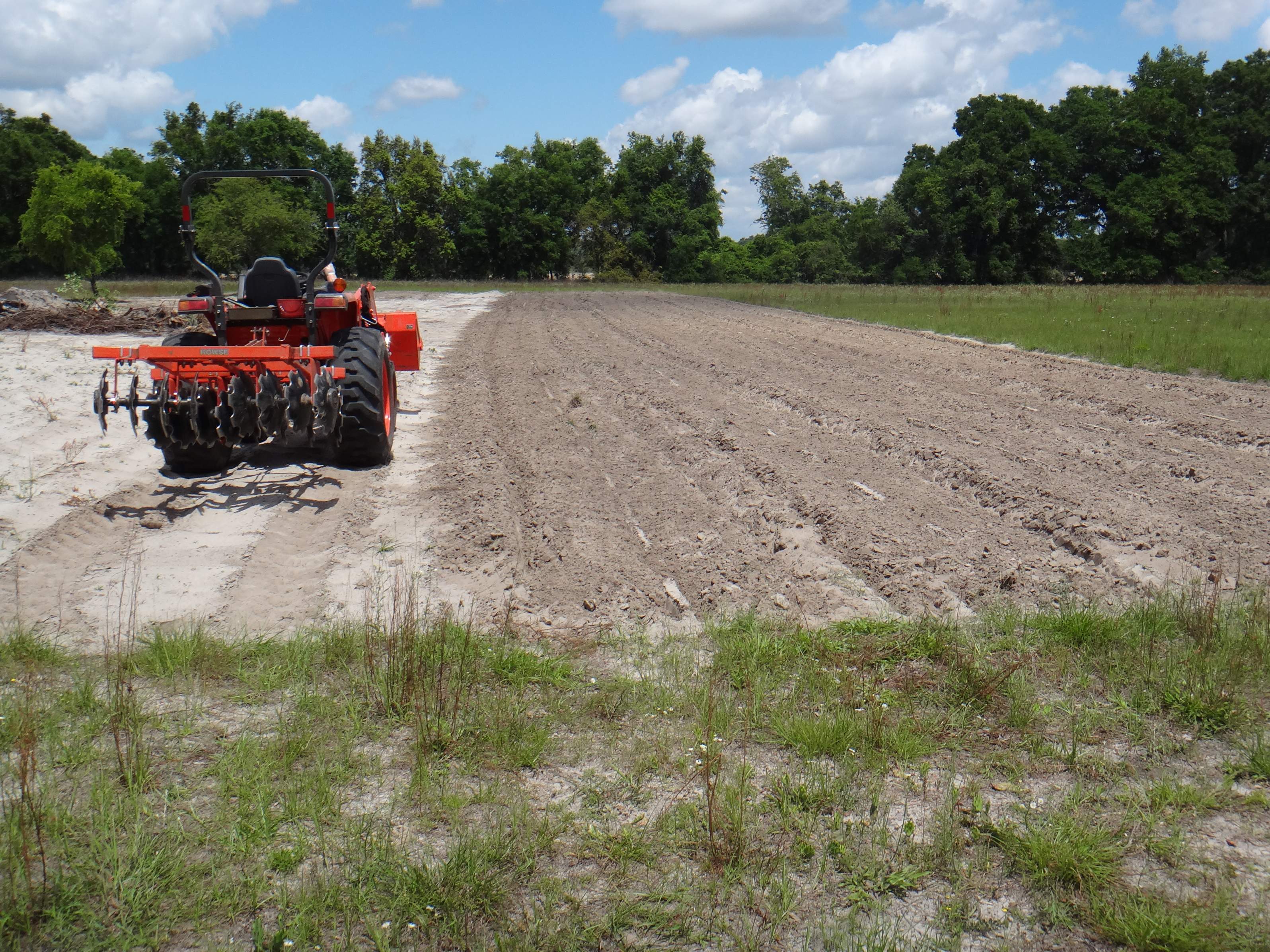

Picture below shows ground tilled by my 16/18" Howse Disc Harrow pulled at a brisk pace.
The soil thrown out by the pair of sharply angled front gangs is clearly visible, as a lapping wave nearest the tractor. The little furrows are where the ouside pans of the rear gang picked up soil to throw inward.
Location is a firebreak surrounding a community burn pit which I maintain vegetation free.

I would start with maximum angle/set in the gangs and adjust the top link for optimal cutting with front gangs. Make multiple passes in several directions. Easier after a rain soaks in the ground and you can work it again. Not muddy but not too dry.
~~ YES ~~
To get compacted ground worked deeper, you need to plow it first.
The disk is a secondary tillage tool. It also helps to add some weight to the disk. I bolt steel plates that weigh about 200 pounds onto the upper frame of my 6.5 ft 3 point disk, which helps it cut deeper.
< 400 pounds? >
Compacted soil, like you are dealing with, needs to be plowed first. In the following years, you could probably get away with just the disk, especially if you add some weight to it.
An MX has a Category 2 class Three Point Hitch. If 200 - 400 pounds is owner added to a relatively light Category 1 class Disc Harrow you may over stress the frame and pull it to distortion or destruction. Once distorted the ability to adjust gang angles is lost. I discourage adding weight. Owner added weight is outside the stress parameters calculated by Disc Harrow designers.
Shorten the Top Link and adjust gang angles aggressively for penetration. If that does not do give the penetration you need, you have too light an implement.
"If you go all notched on all gangs the ground will loot ratty and clumpy."
While I am occasionally surprised by 'exceptions' on T-B-N, few disc harrows with pans of diameter 16" - 18" - 20" - 22" are available outfitted with anything but notched pans front and rear. All these relatively light discs struggle to cut unplowed ground and only the notches make cutting through feasible. (( Dirt Dog and Monroe Tufline offer discs with notched pans in front, smooth pans in the back. ))
Discs with 9" spacing between pans penetrate better than discs with 7" or 7-1/2" disc spacing. Less important than notched vs un-notched, but a factor. Less "float" with 9" pan spacing.
When pan diameter increase to 24" - 26" - 28" - 30" there is enough weight to cut through almost any grass. You need a Utility Class tractor (6,000 pounds bare weight) to pull these.
Box frame discs are adjustable. If you begin with aggressive gang settings, then reduce aggressive set with each succeeding pass, a disc harrow can leave a quite smooth field. For reasons beyond my understanding few on T-B-N seem to adjust their disc harrow gang angles.
