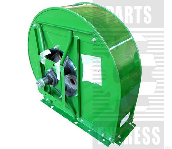

Can't find a photo of a AC stripper blower fan, but here is a pic of a John Deere fan.
