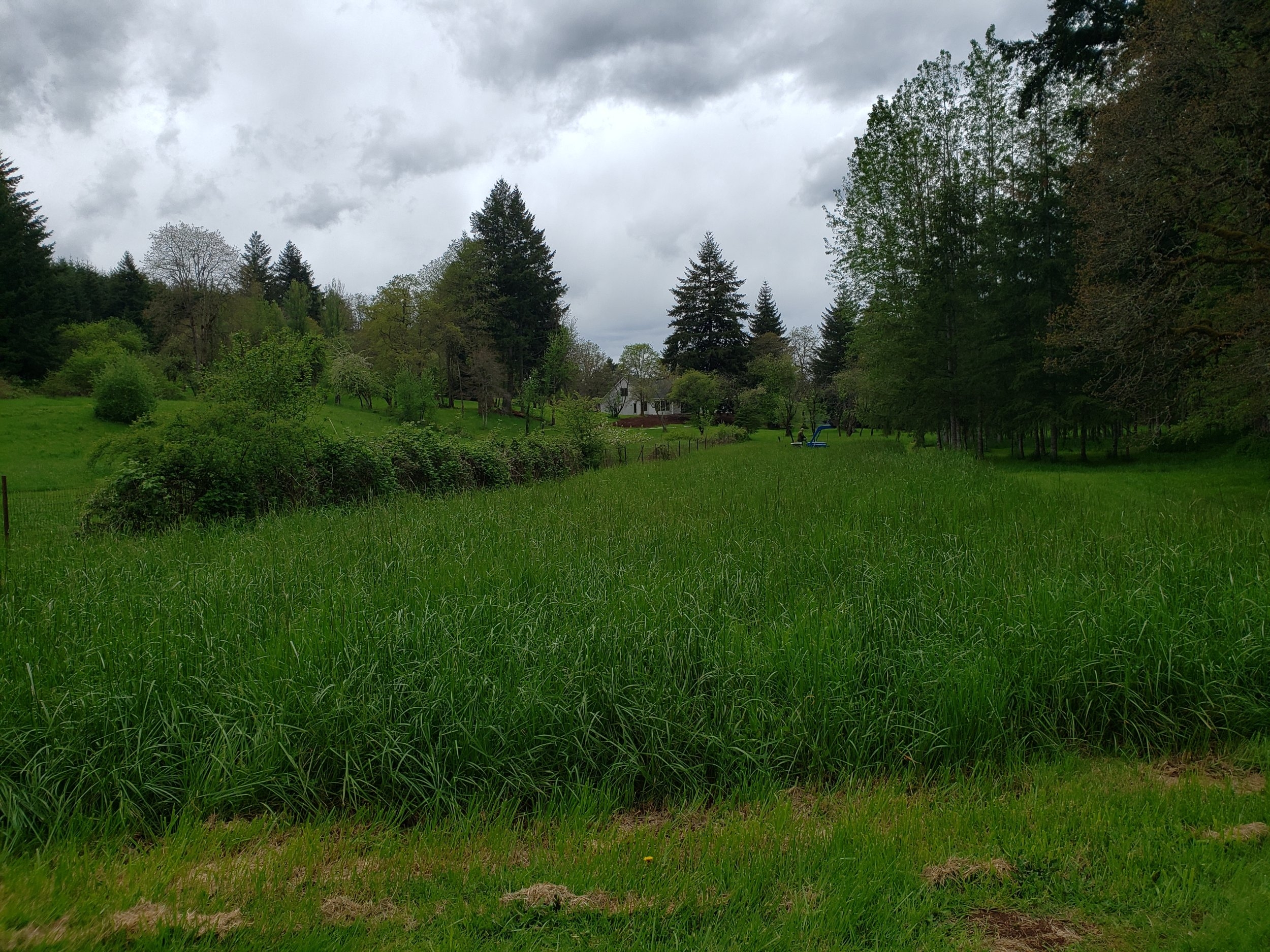

Brush hog will work in tall grass & weeds, however in my experience flail mower works also good - I think little better, but requires little more maintenance!
I have a John Deere 413 brush hog and 5' Ford 917L Special with side slicer flails.
Have not used the brush hog hardly any since I got the flail mower.
What do you like about the flail vs brush hog?
btw my brush hog is at max limits for my tractor-- 8ft connected to 44hp at the pto. Between the tractor tires and the trailing wheels on the brush hog there are certainly a lot of bumps.
I considered a flail mower some time ago with an articulating side arm so I could also mow the edge of the bank at the pond ...
   / Can a Zero Turn mow high weeds in a bumpy pasture? #55
Flails chop the biomass finer, leaving a neater cut IMHO

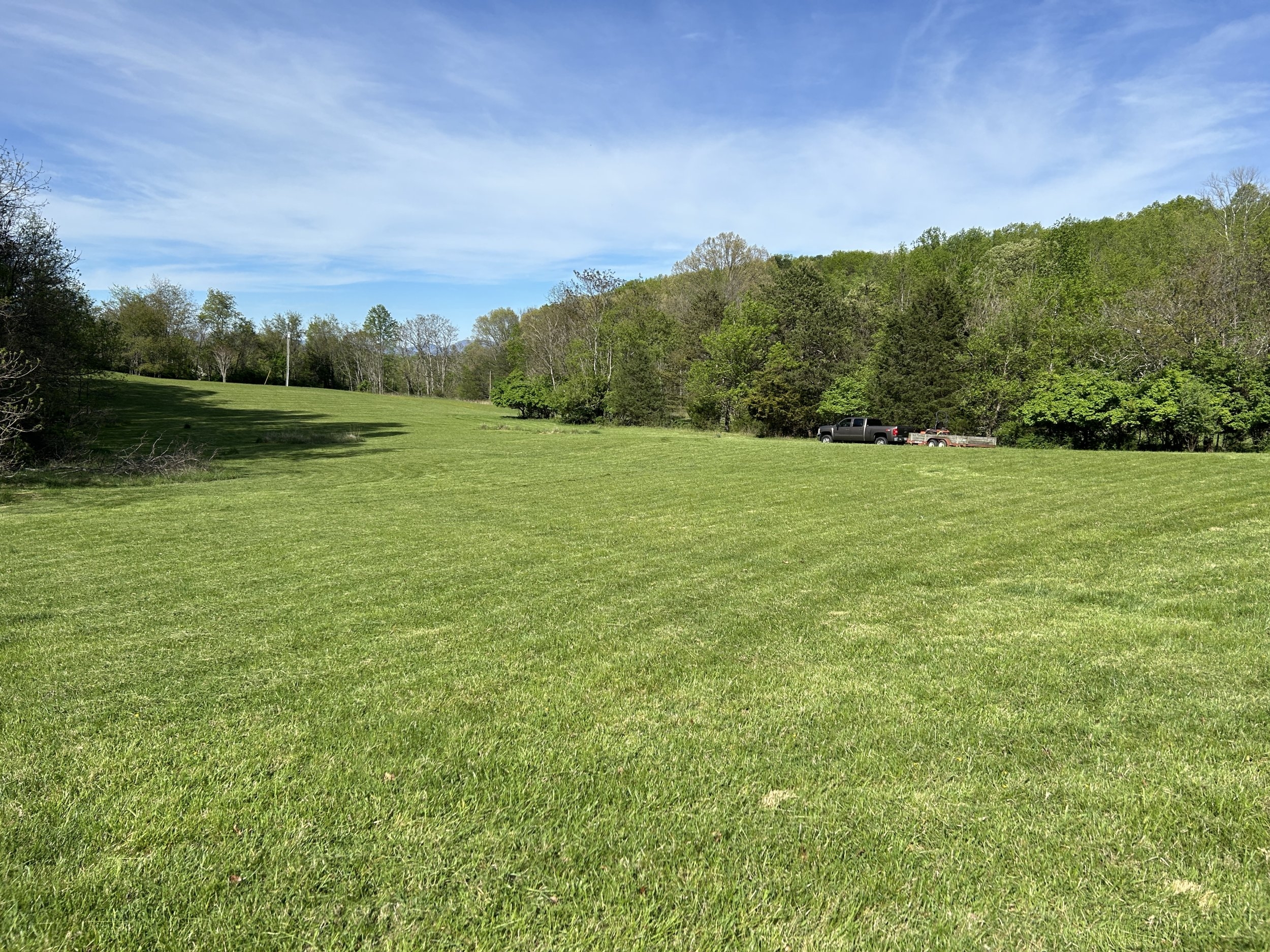

Once you do it once, you can keep it mowed down with a ZT. I mow my VA lot, about 3 acres of grass with my ZT. It was a hay field previously, now it looks like a park. I mow it once a month, takes about 2 hrs.
  • No scalping at all when set up right. Uneven forested area is a prime example.
  • Chops the tall pasture or field grass finer leaving a nicer look
  • Uses less power - comparing 48" JD 413 vs. 60" Ford 917L (side slicer flails).
  • Can mow given area faster due to width difference.
  • Takes less space to store.
My Ford 1310 tractor has 1L 19 hp engine (12 speed manual transmission) so it's pretty easy to notice the difference in power usage.
   / Can a Zero Turn mow high weeds in a bumpy pasture? #59
^^^ 👍. I’ll add that I find it’s less ‘jolting’ on me than my bush hog. It rides gracefully on the 6’ wide rear roller close in vs. a small tail wheel dipping into holes & flipping around on turns.
