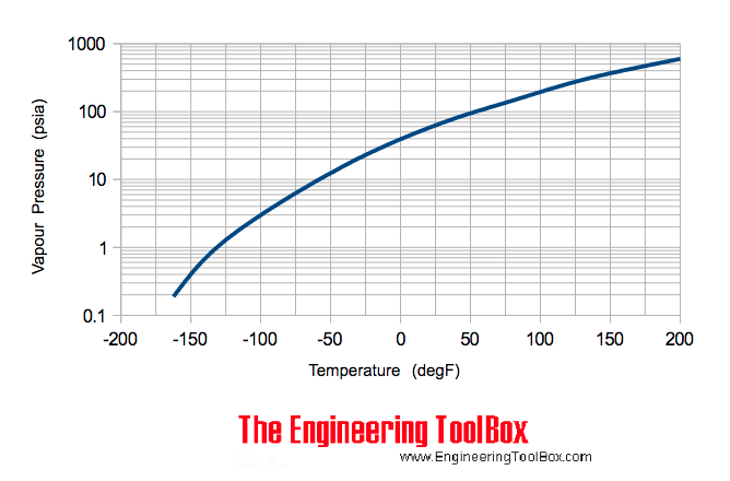

Here is propane vapor pressure graph ( log scale ) but I have no idea what the schrader pressure relief valve on top of the 1 Lb bottle is rated for.
