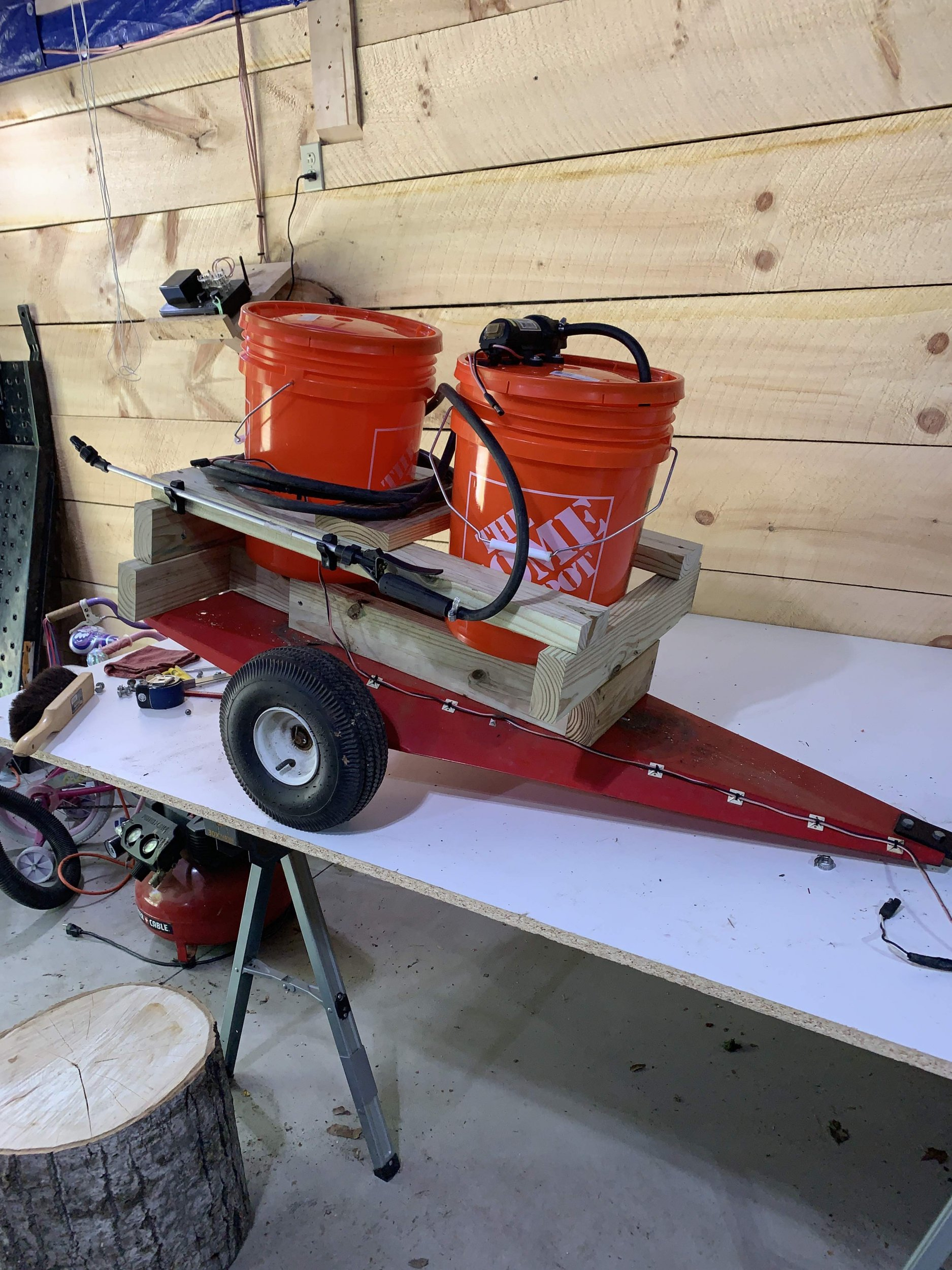

I had a small fimco. Replaced tank. Broke again. Then the pump went. Reused the trailer and hose, got two 5 gallon buckets and got a cheap pump on amazon. I'm happy.

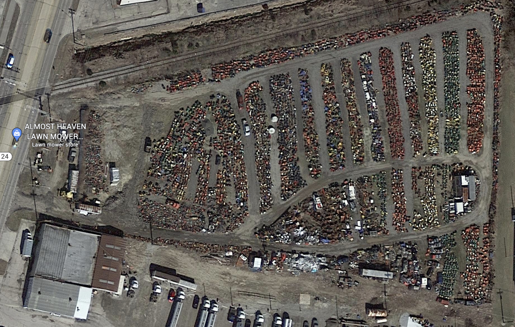

Does that guy down in Bluffton with the lawn tractor graveyard sell complete, running tractors?
You got me there. Been there a few times but never about that so I would not know. Can be hard to get a hold of and meet up at times from what I rem.

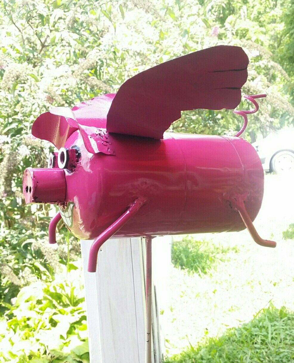

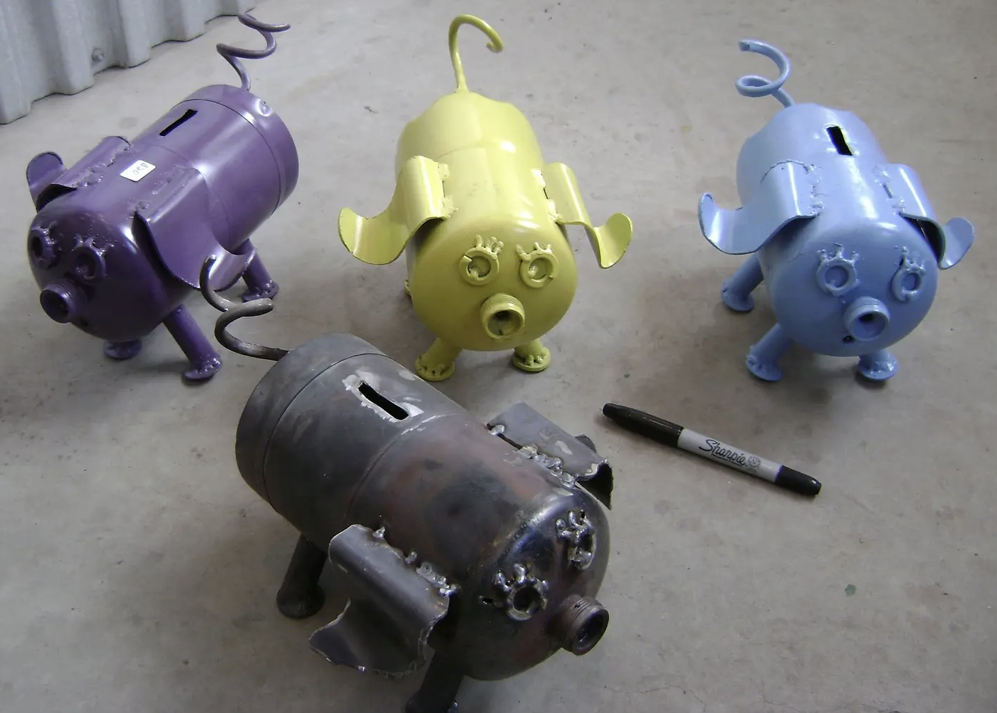

Empty propane propane bottles make good range targets and flotation devices for homemade rafts or can be upcycled into homemade scraper blades like Mazzbob's work.

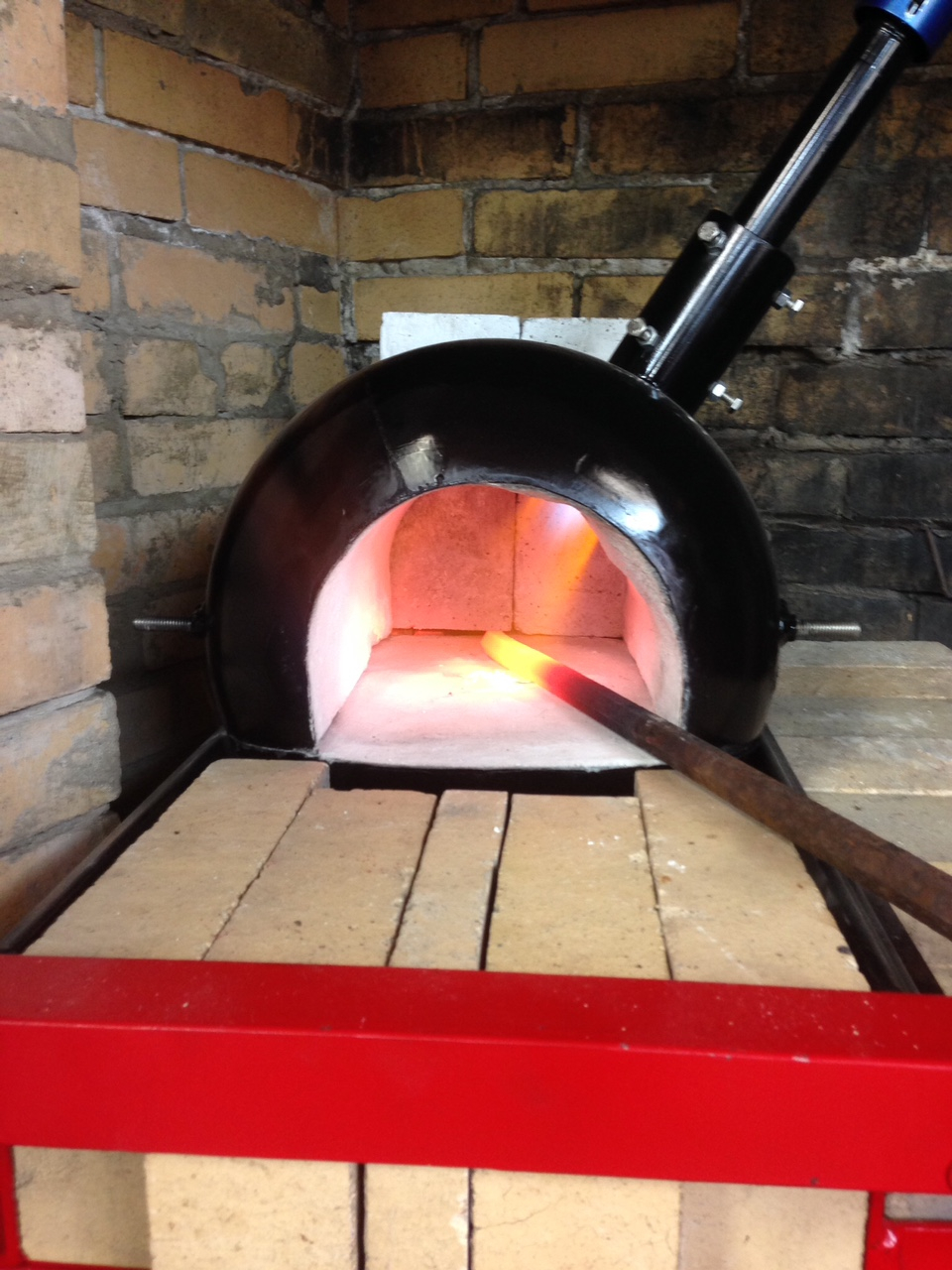

I have made between a dozen and maybe 20 HOBO stoves out of 20# tanks.. I give them away to friends and family...
I got the tanks from the local propane dealer with the valve taken out.. The valves recycle metal for good money.. The steel, not so much.. Once the valve is out if they sit upside down in the sun for a day or 2, no problems with gas fumes... I cut the tops off with a saws all as I don't have a torch or cut off grinder set up...
