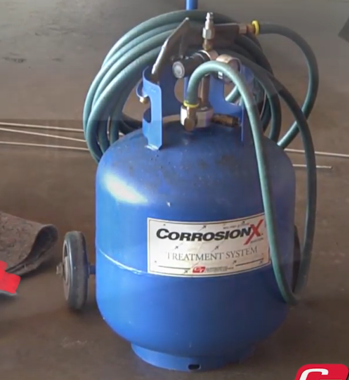

I used to have CorrosionX sprayed in my Debonair's wings and fuselage every couple of years to prevent corrosion. Usually dripped out on the hangar floor for a couple of weeks after each treatment.
/ Can a propane tank be repurposed? #157
I'm not sure WHY you wouldn't want your wings rusting... :rolleyes: :cool:
