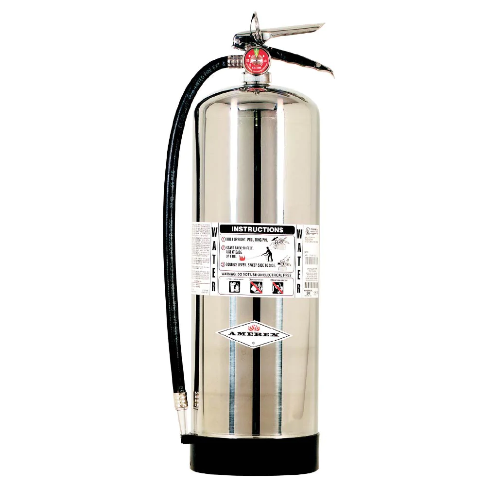

"I like the idea of a smaller, pressurized, hand held 2-3 gallon sprayer."
Find a used 2 1/2 gallon pressurized water fire extinguisher. You can fill it yourself and air it up with your compressor to 100 PSI. The hose unscrews so you can adapt a sprayer wand of your choice. We refilled our water extinguishers at the fire department after we used them, easy to do.
Per the NFPA standard once the label is defaced they cannot be filled and tagged for use as a fire extinguisher. They get sold as cheap as $10.

Would be kinda hard to apply a targeted herbicide spray with a steam from a fire extinguisher.

That is why I said to add a sprayer wand.

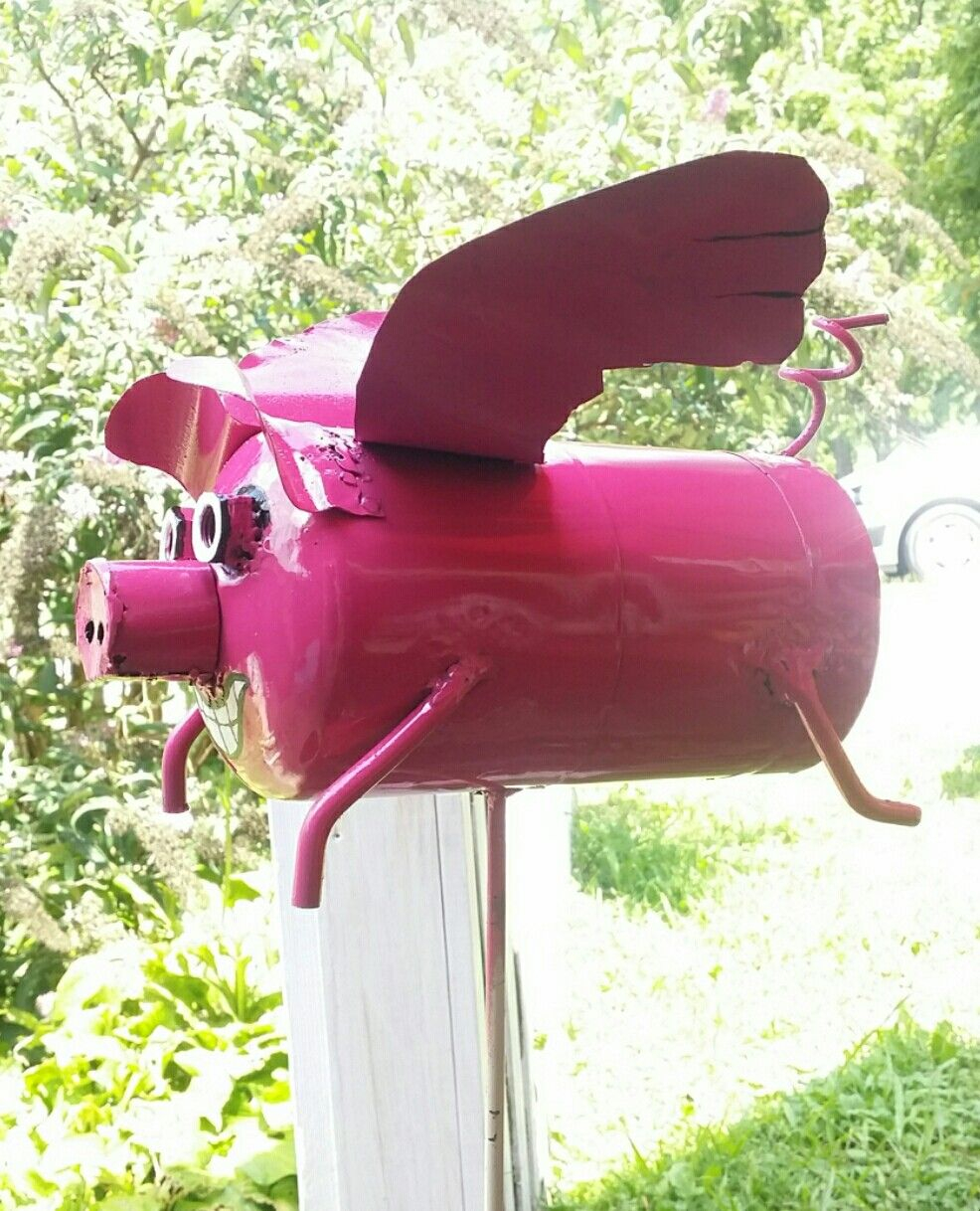

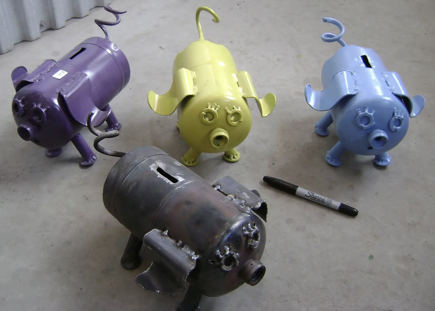

Gee, I've always pulled out the Schrader valve and crushed them in my press.
Never thought of making a piggy bank out of them.
Me neither. That was pretty clever. I especially liked the flying pig though.

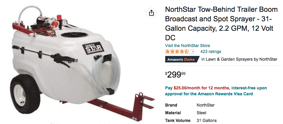

Buy a 15 or 25 gal spot sprayer, put it on your tractor in one of several places handy plug in to battery and spray all you want without the trouble you are looking at with your method.
I have a 25 gal elec sprayer. I put the tank on top of the box blade of the tractor or on the fold down back seat of the golf cart. Works great.
