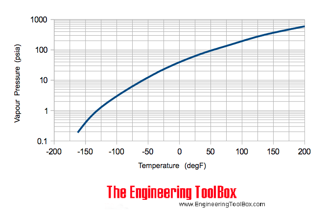

According to the national standards publication NFPA58, a propane tank with 20 pounds (5 Gal) of gas at 70°F would have a pressure of 145 psi; at 90°F
Actually doesn't matter the size. Any time any quantity of liquid propane is present at 90°F the pressure will be about 145 PSI. Increase the pressure and some of the gas will go back into liquid dropping the pressure. Decrease the pressure and some of the liquid will boil into gas restoring the pressure.

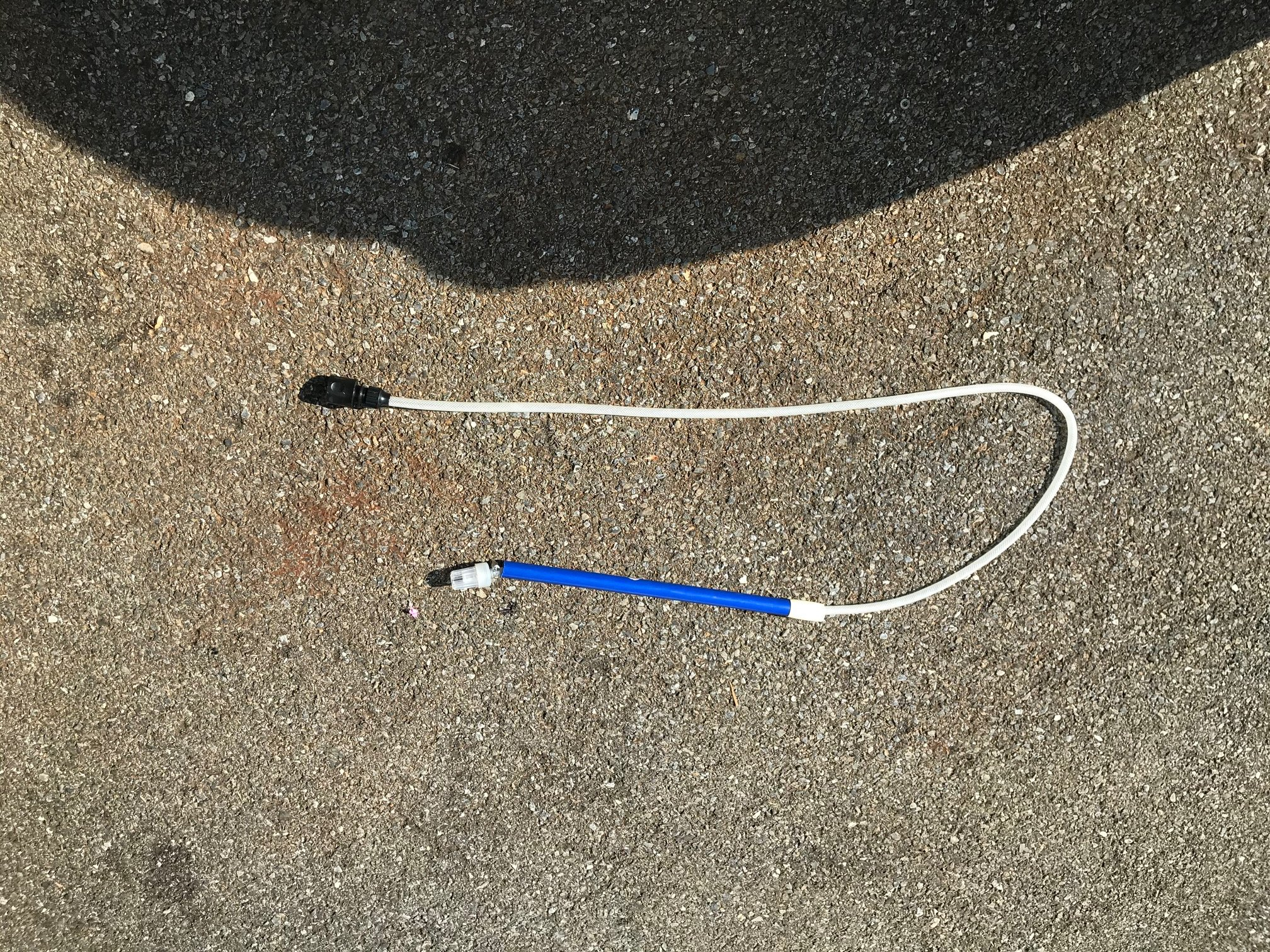

Doubt that it's a recommended use, but last week I used a DeWalt 20V pressure washer to spray Liquid Sevin where I couldn't reach the height needed with the regular sprayers. Made up a short hose with the strainer on the end to drop into a 2-1/2 gallon jug. The blue sleeve is part of an old broom handle to keep the strainer from floating up. Used the 0 degree tip from my real pressure washer.
Real long story about the Japanese beetles and our linden tree, but the systemic pesticides weren't working. One time I did fab a long extension for the regular garden sprayer. Another time I made up a pressurized tank from an empty R22 tank. Once I borrowed a bucket truck. This is by far the easiest method. A good still morning and you're in business.
I bought the little DeWalt "pressure washer" (quotes because 550# doesn't qualify as a real one) to do the Kubota in Winter after travelling on the salted roads. Much easier to fill a 5 gallon bucket and use it than to drag frozen hoses around. A local hardware store had the complete kit for $99. That's like buying a battery and getting the rest for free.

Here is propane vapor pressure graph ( log scale ) but I have no idea what the schrader pressure relief valve on top of the 1 Lb bottle is rated for.

The psi of the propane is not dependent on the tank size. The psi is function of the contained liquid and its vapor pressure. See graph I just posted.
