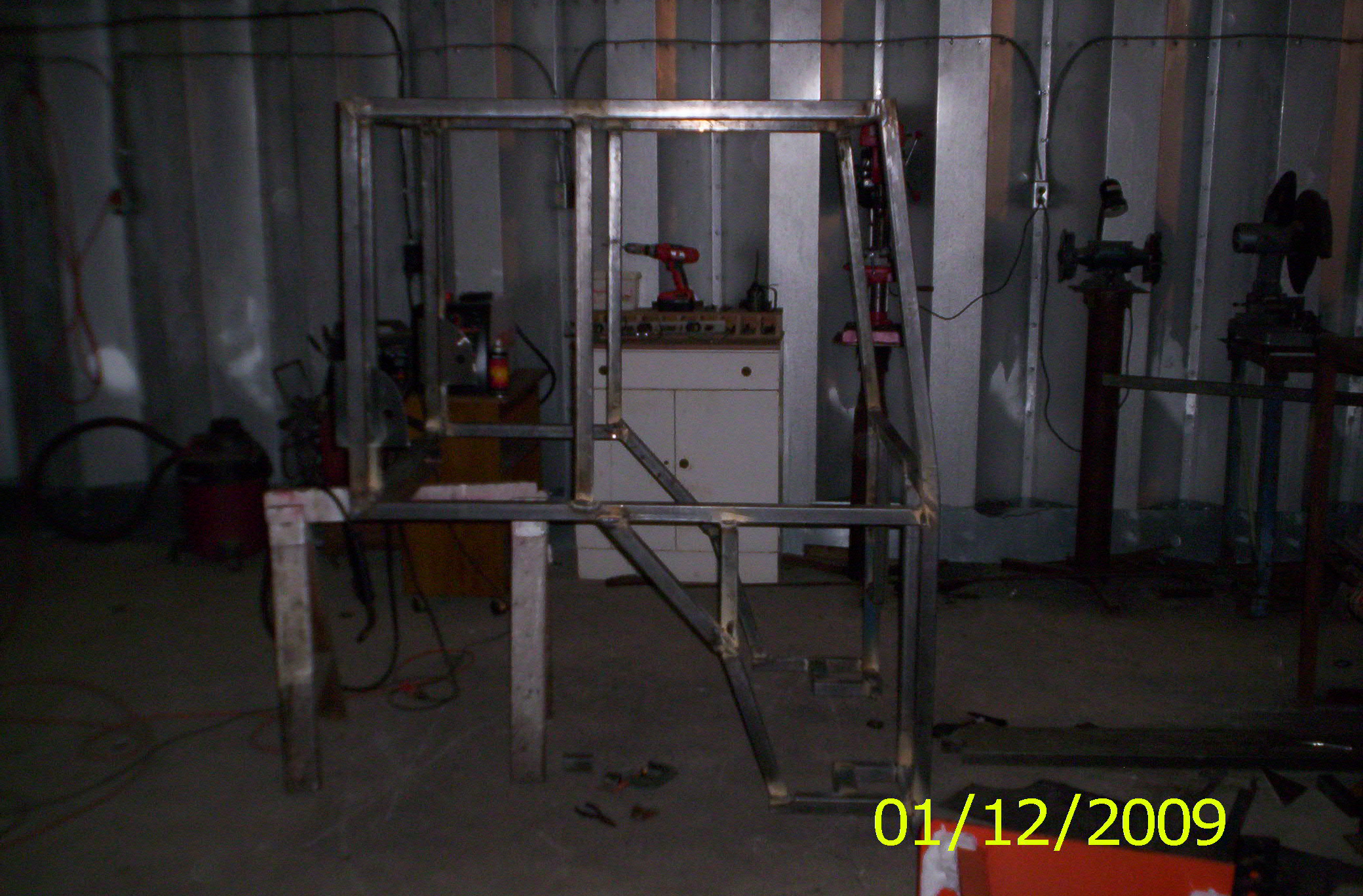

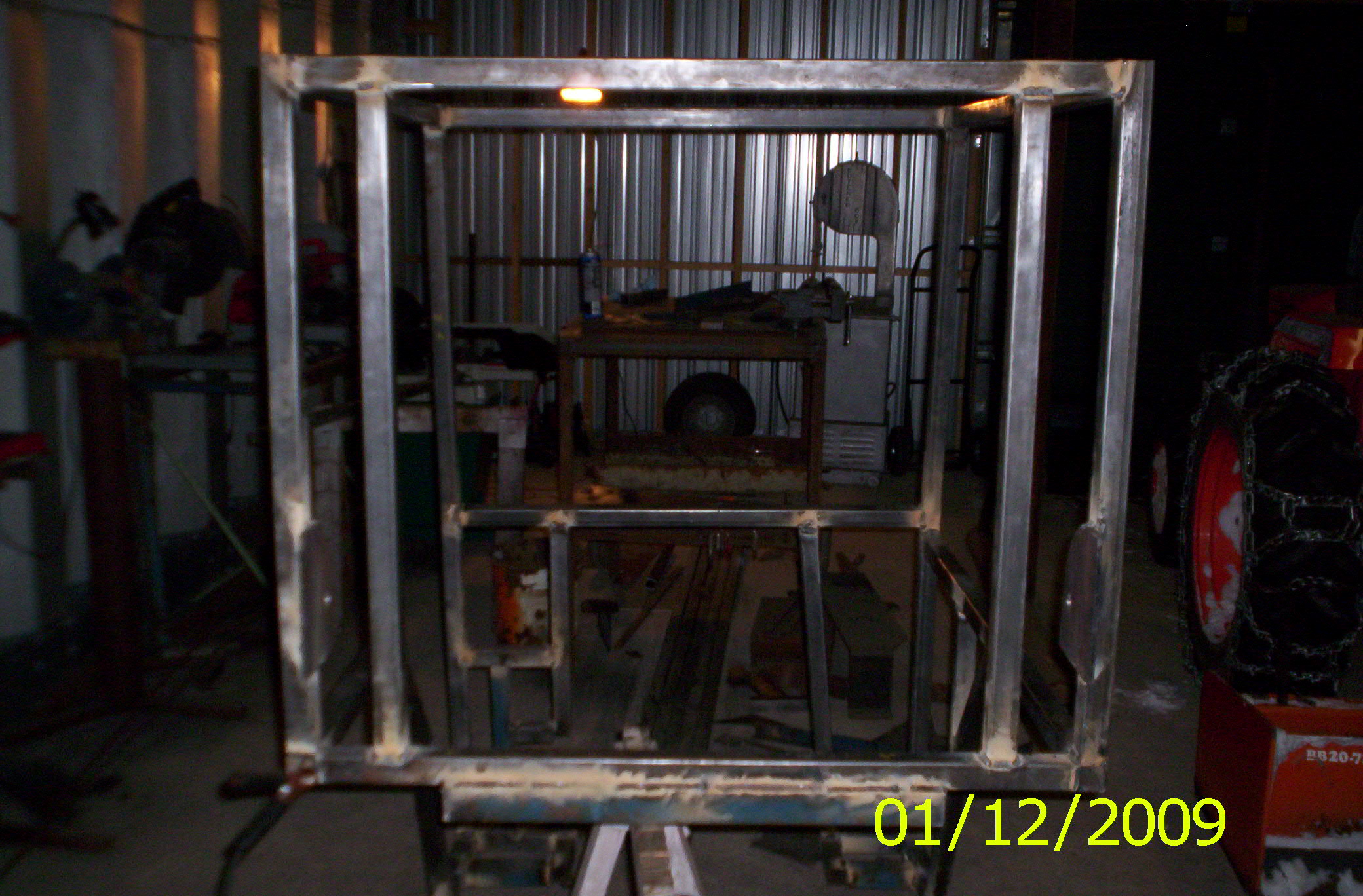

#30

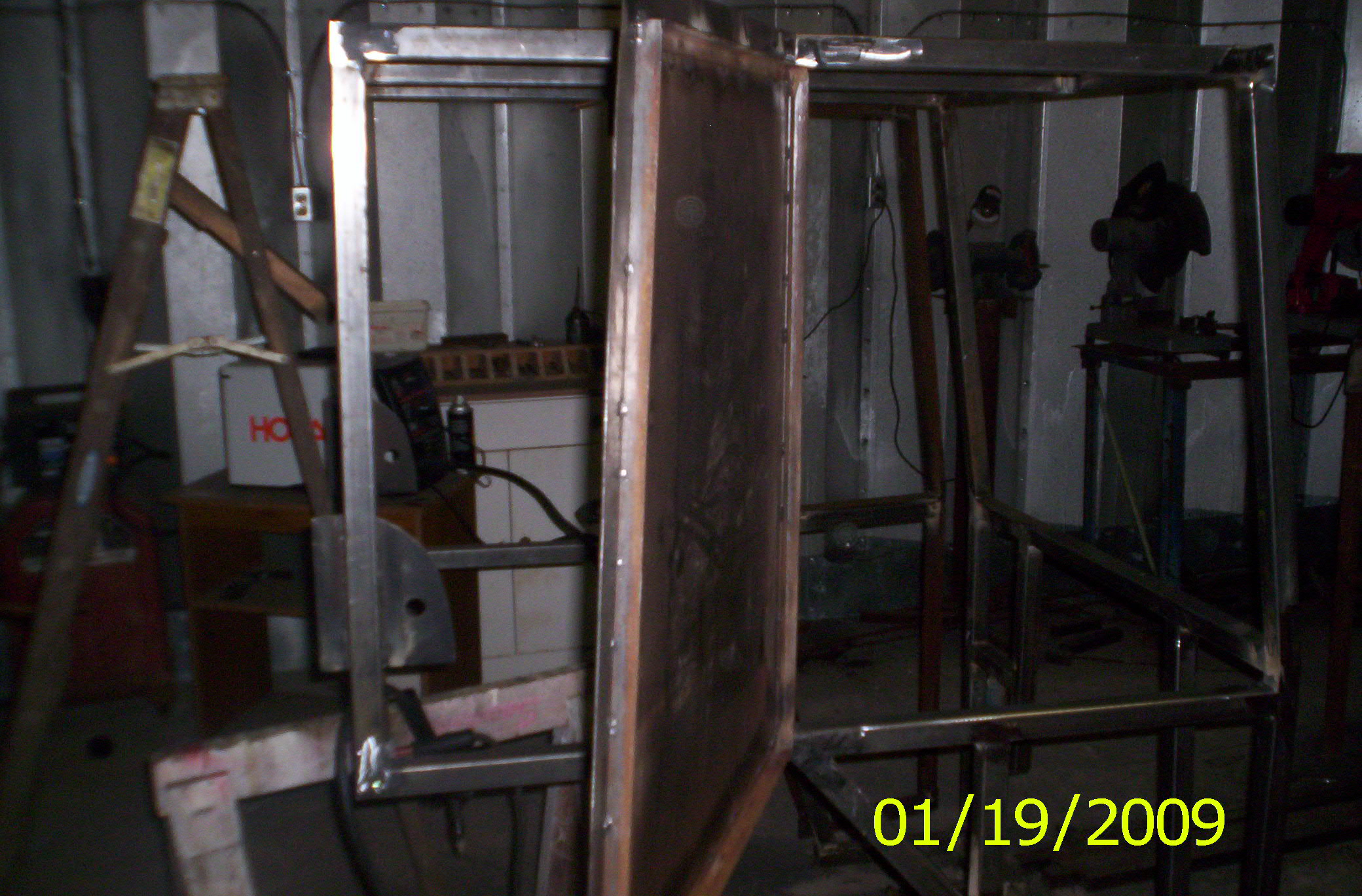

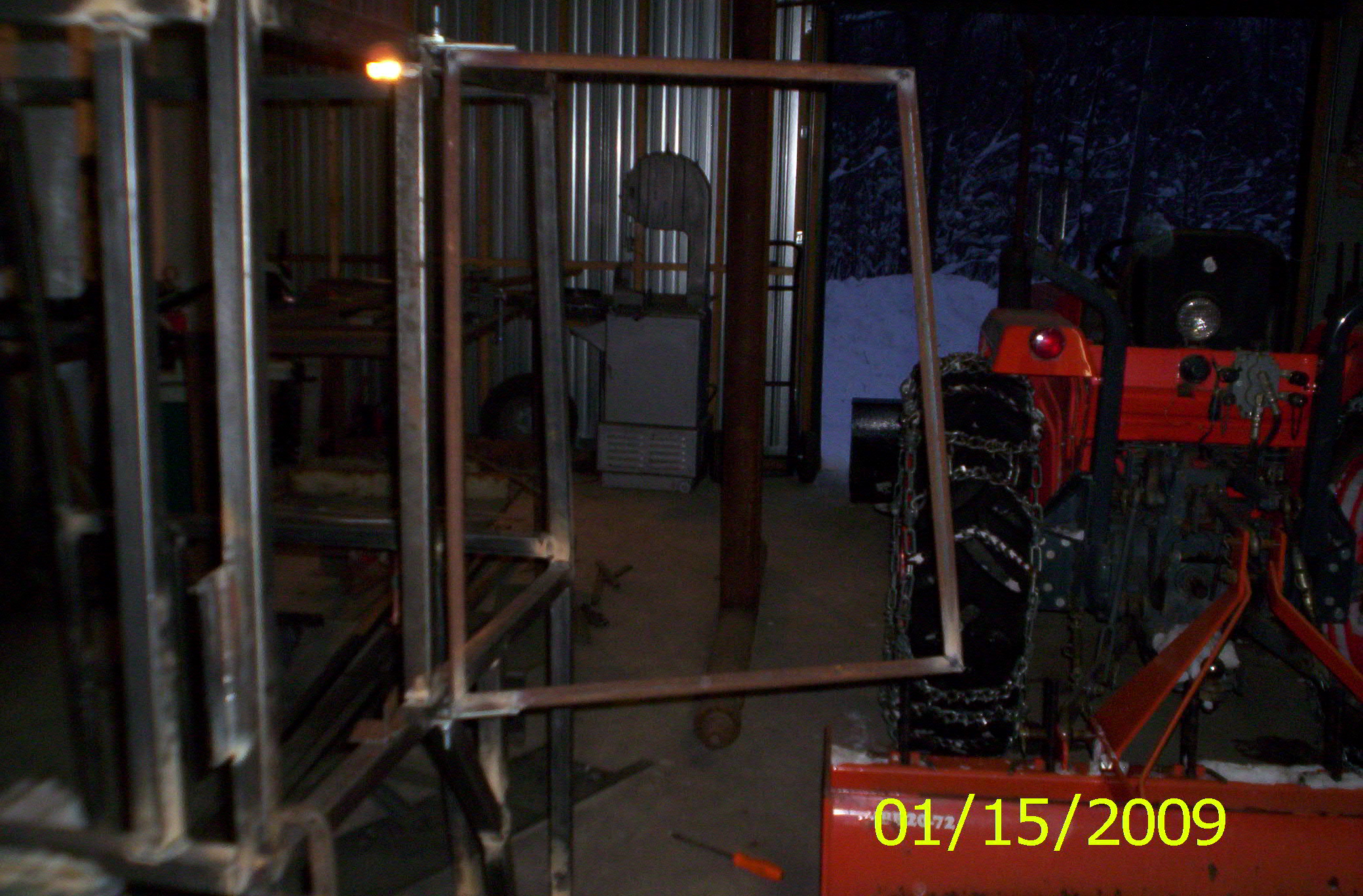

i got the door almost finished today,need to do a little more welding.did get the window frame done on the right side, i am not sure if i will be able to glue tempered glass in these they do flex a little, maybe the glass will stiffen them up without breaking (any ideas?). or should i skin the frames & use gaskets.

/ cab project #31

i dont think the windows will flex with the cab but the frames flex in and out and i dont know if the glass will be ok, if they will add strength when glued or if they will break. most crank windows on houses are only frames & they must flex some until the glass is installed, then does the glass stiffen them up? this is what i am wondering. for the rear window i am going to hinge mine to swing into the cab & latch up on to the ceiling that way it is out of the way but always there to let down.

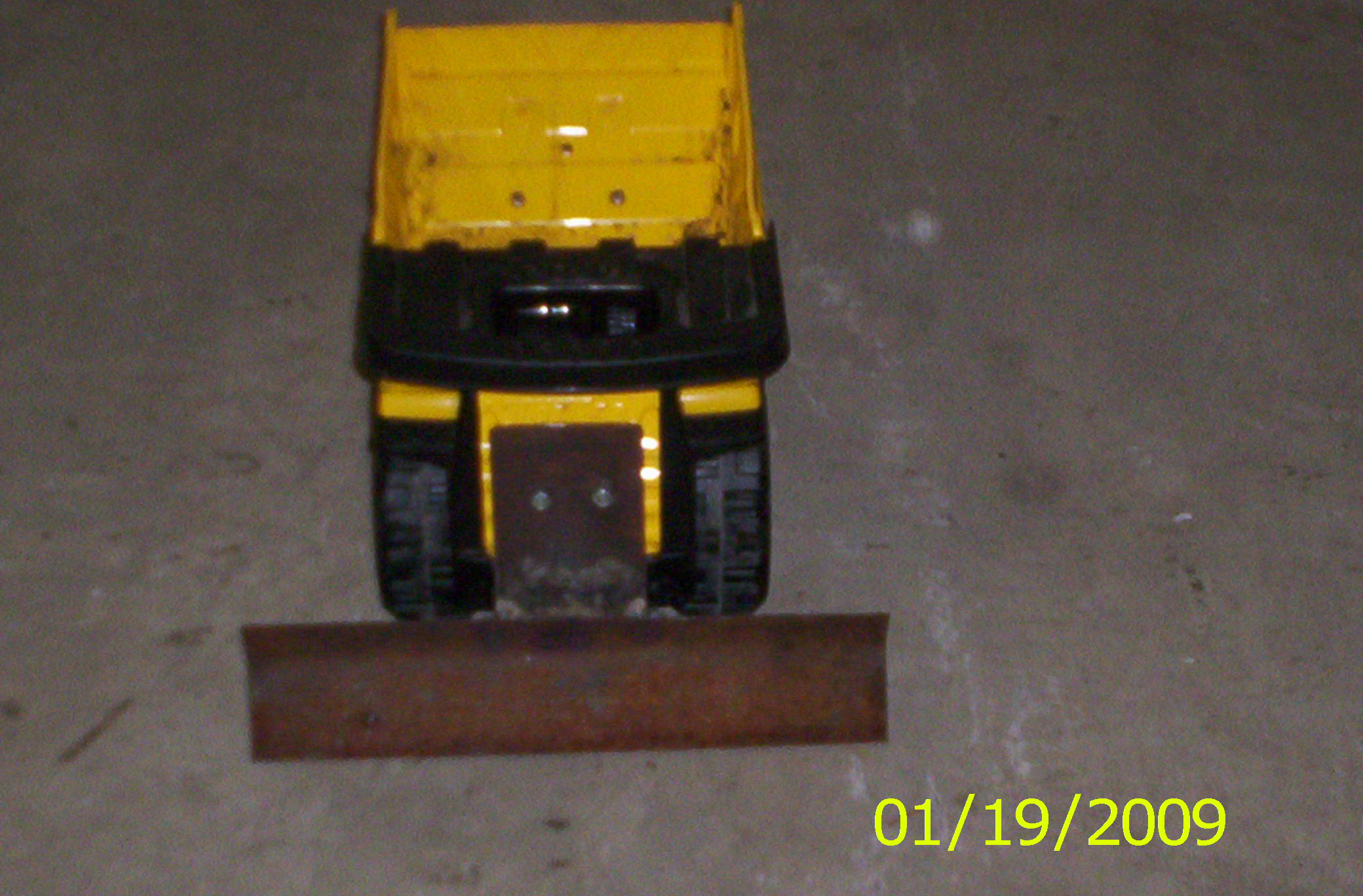

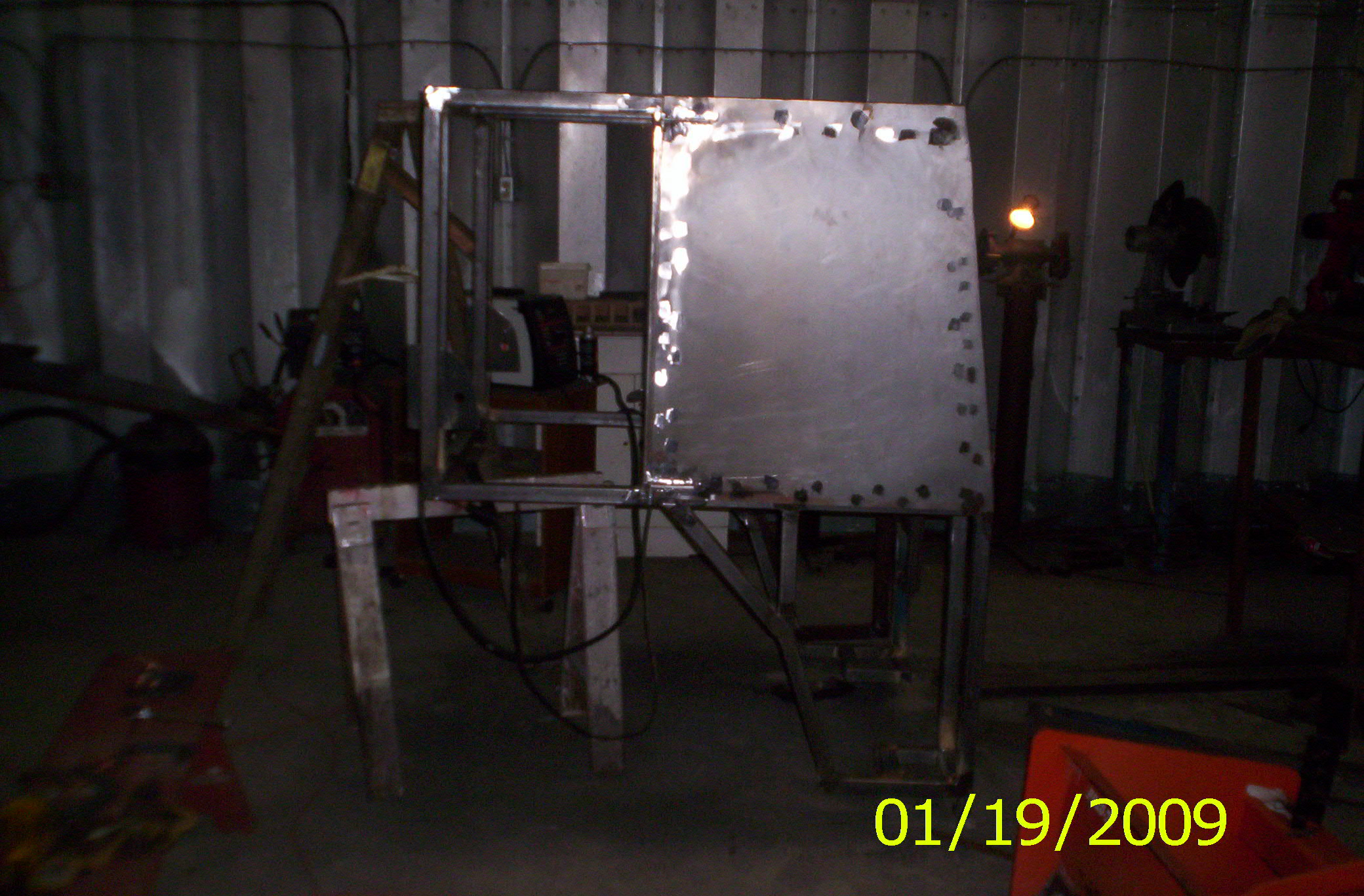

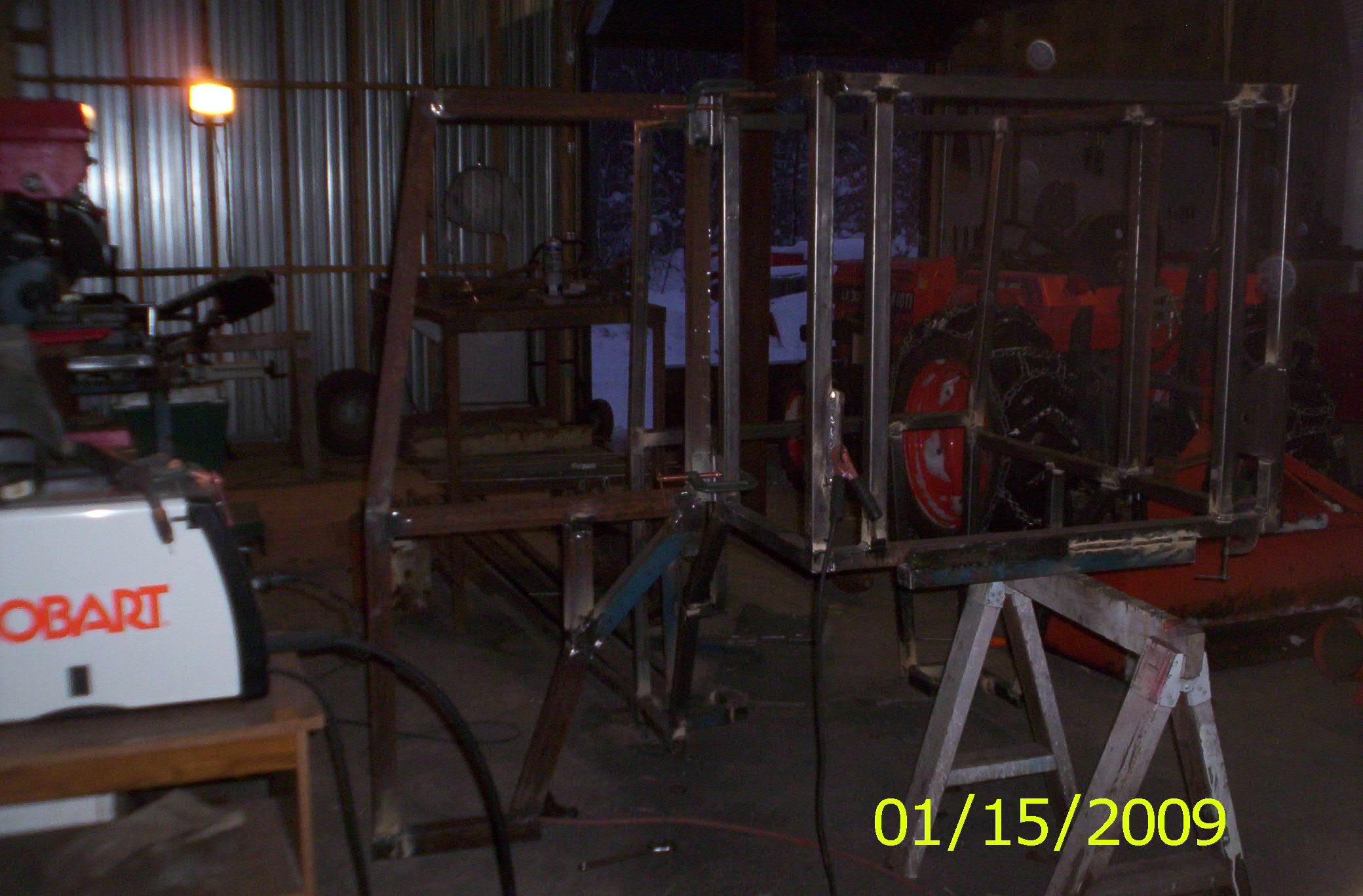

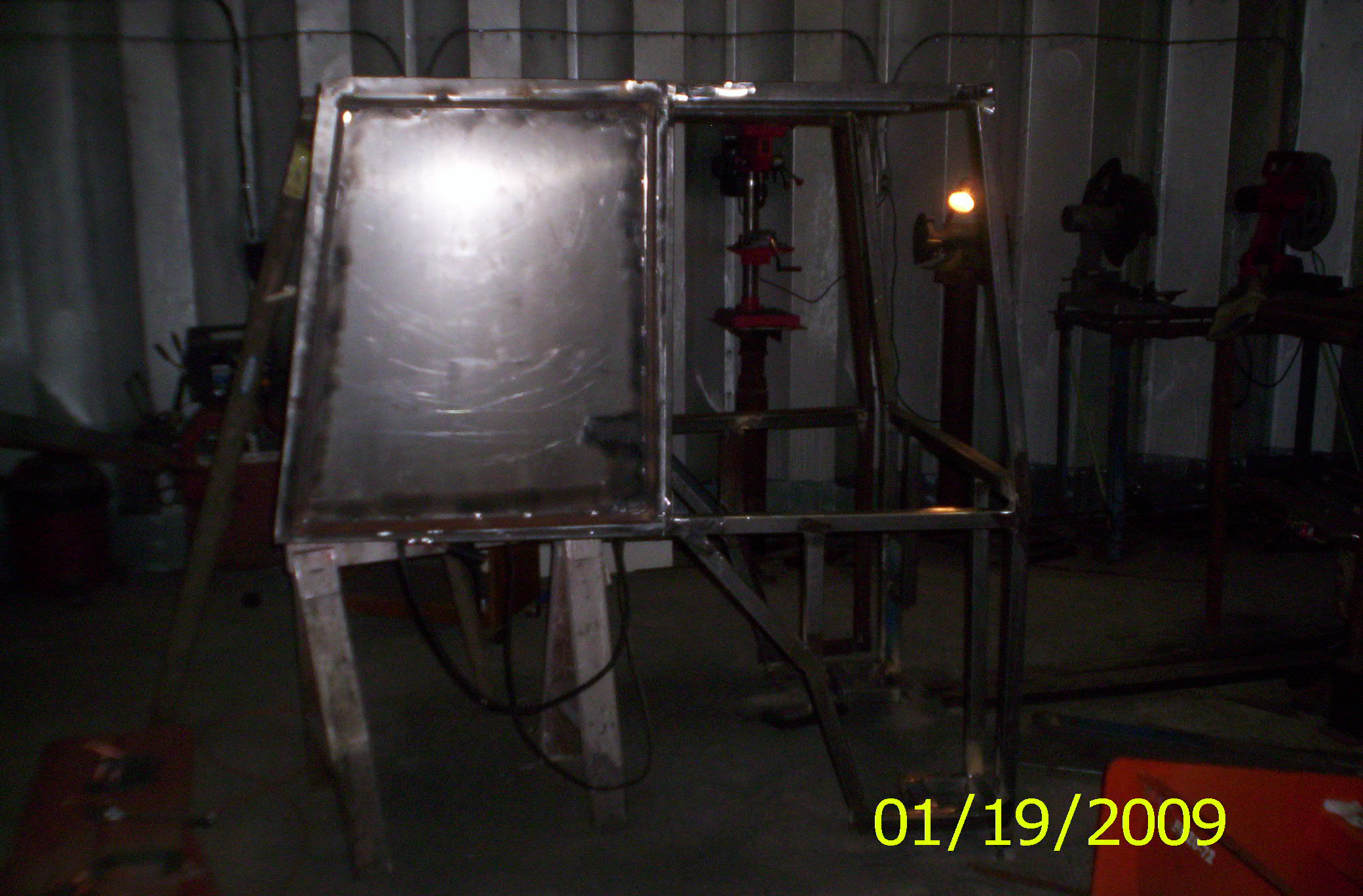

well i got a little done today went & picked up 2 sheets of steel 16-gauge 4'X8' to skin the cab. i got a little side tracked when a customer came in & needed a snow plow built for a 100 ton rock truck. i couldnt say no he said he would help me,so an our later we had it done & it works great the customer was very happy. now i did get the one side window skinned still need to cut the opening for the window. does anyone know if there is a minimum radius for rounded corners for glass.i would like to round the corners so the gasket is all one piece with one seam where the two ends will meet.
