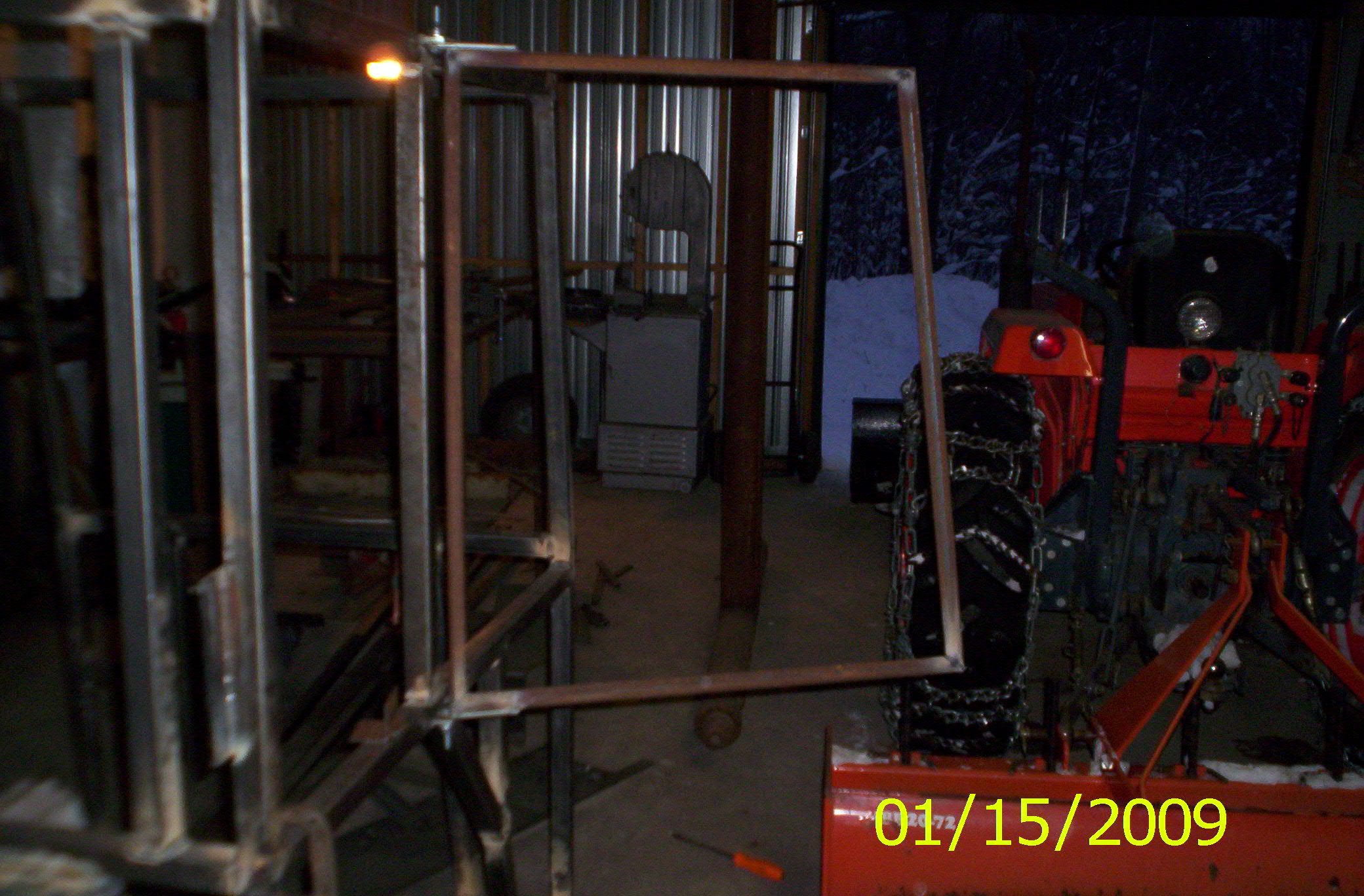

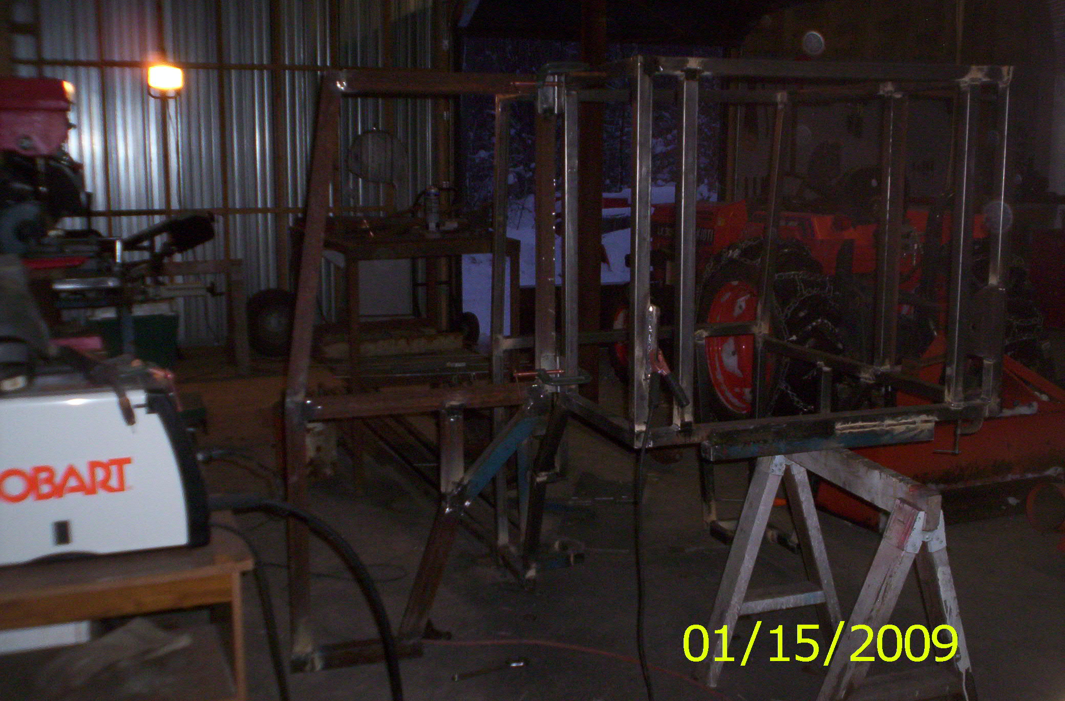

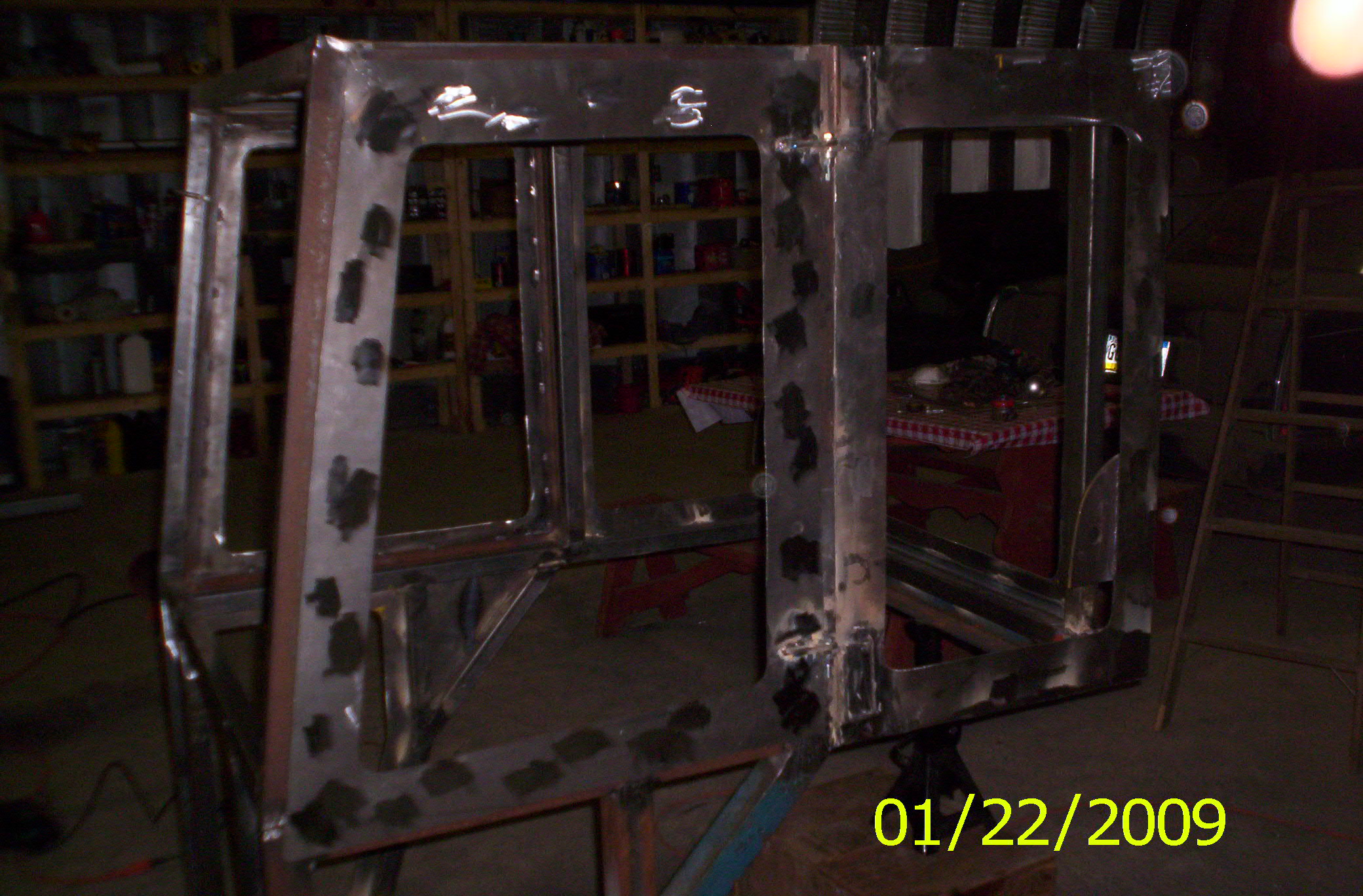

finished the window today, cut the window area out & used the blank to do the bottom window area still need to get a latch for the window. i plan on useing 1/8" for the roof.

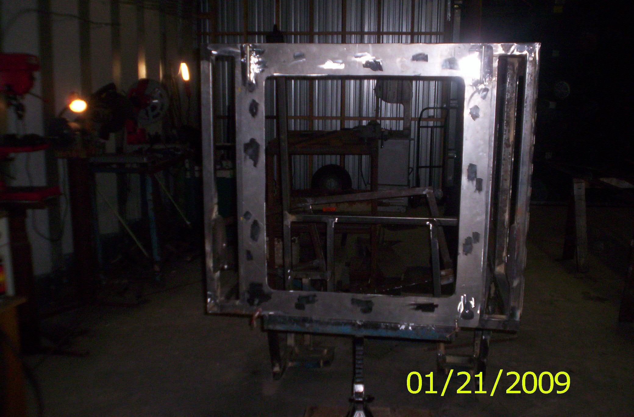

more progress today finished right side and back window.

Looks great Dirtnut! I would think 18ga - 16ga would be more than adequate for the roof, especially if you put some light weight bracing (1/2" square tube) on the underside to contain the vibrations.
I think 1/8" is overkill and will add to the overall weight in a negative manner with a higher center of gravity.
Keep the picture coming!

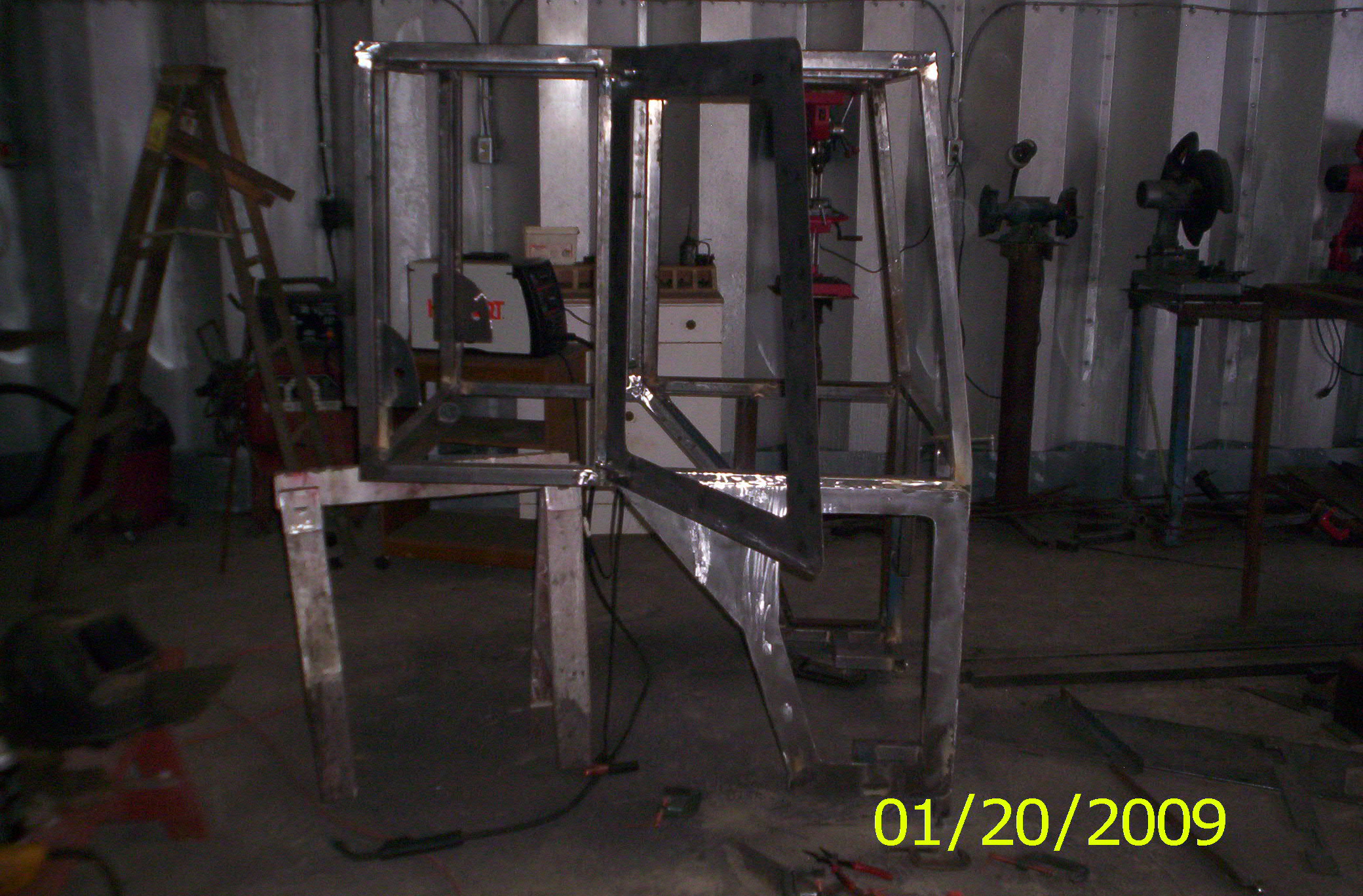

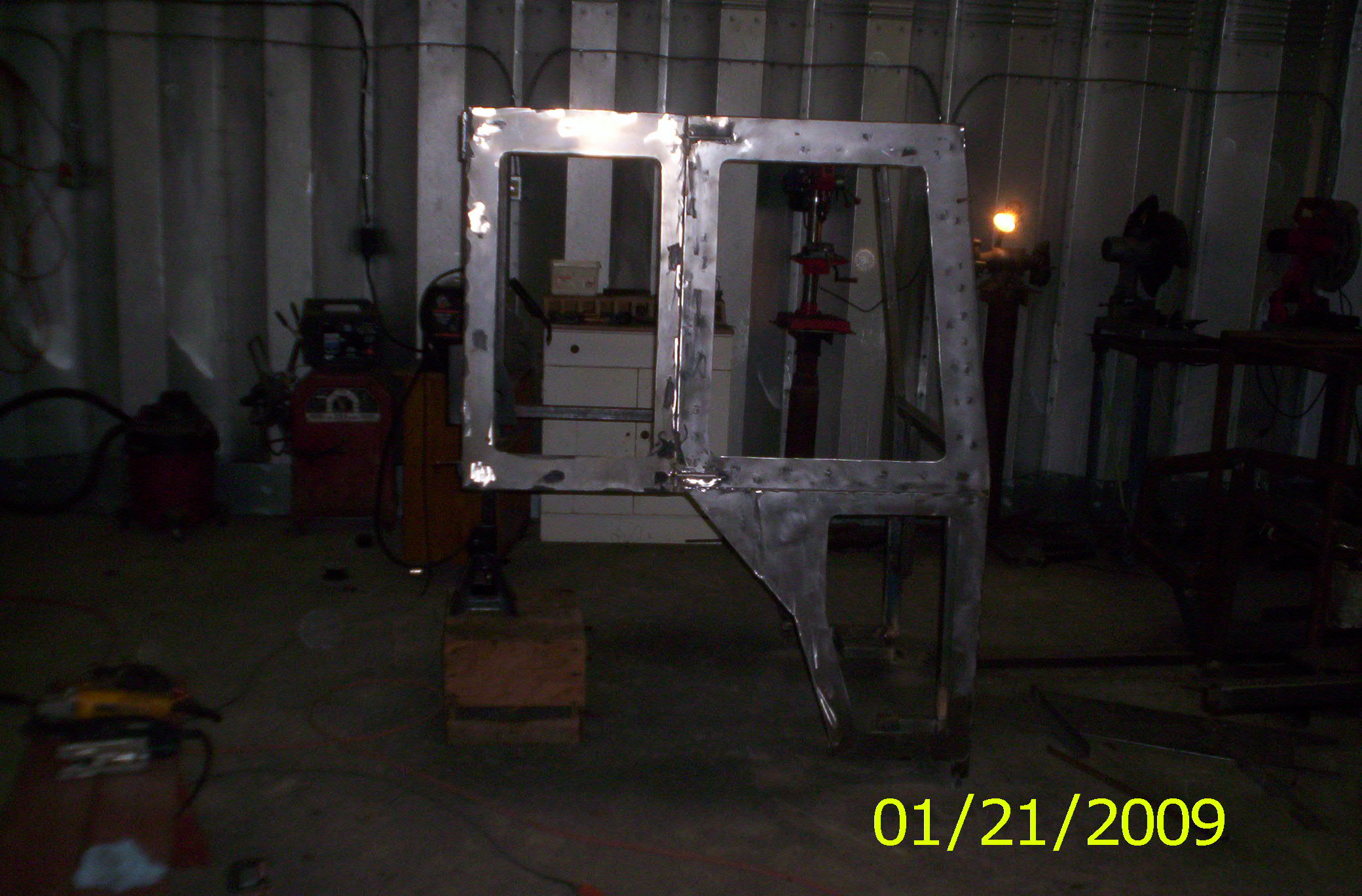

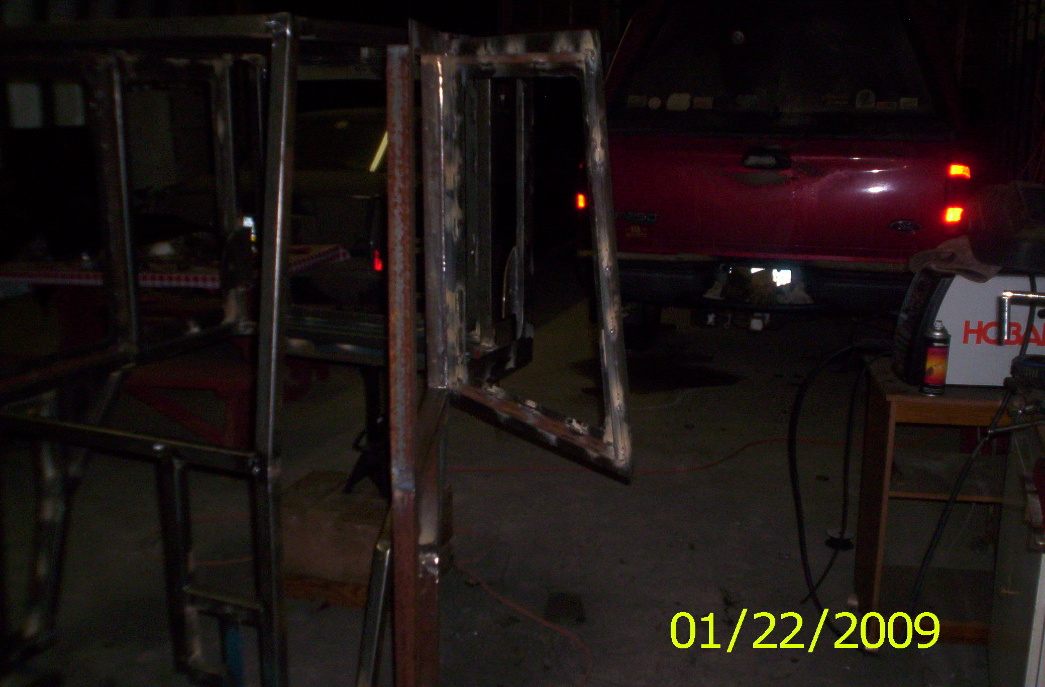

left side door upper swing window done.left side rear window done.will finish lower window on door tomorrow & front window. anyone know how much surface area is needed for wiper motor to mount on.

/ cab project #48
It all depends on the wiper motor and its mounting bosses.
/ cab project #49
Now its really starting to look like a cab, looks like you will have good visibility from the inside. I like the picture showing the door that will have two windows, rather than one big piece of glass.
mjncad is right, I think that jc Whitney sells some compact wiper
motors that has an on and off switch right on the motor.
You probably could do a search on the web to see want different sizes is out there.
Glad to see the pictures and great job.

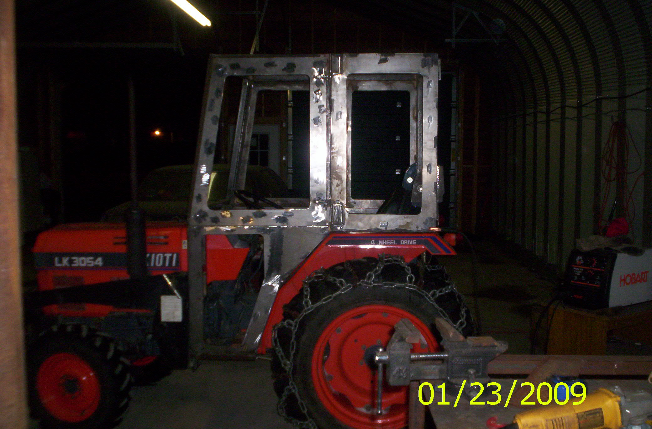

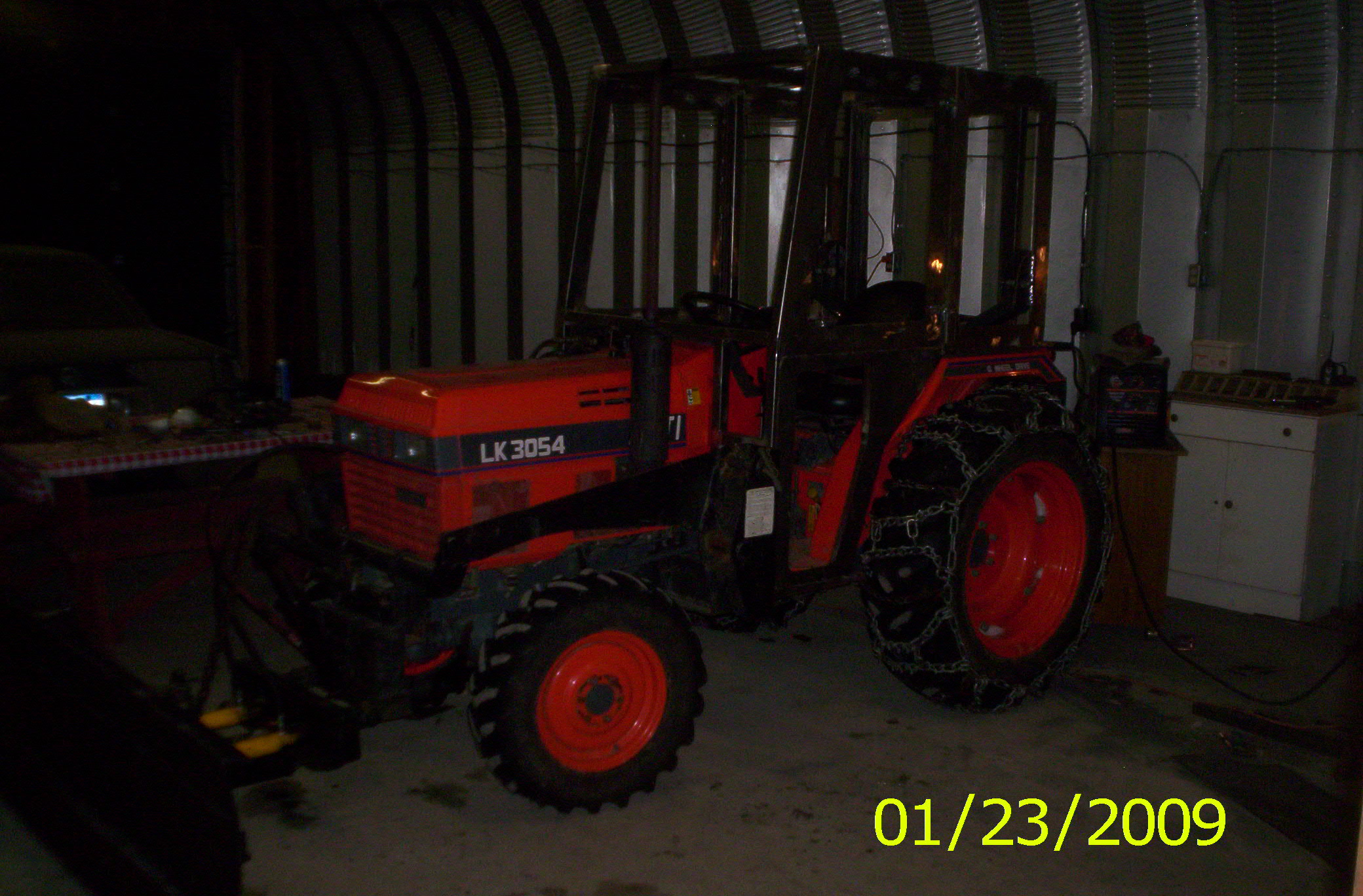

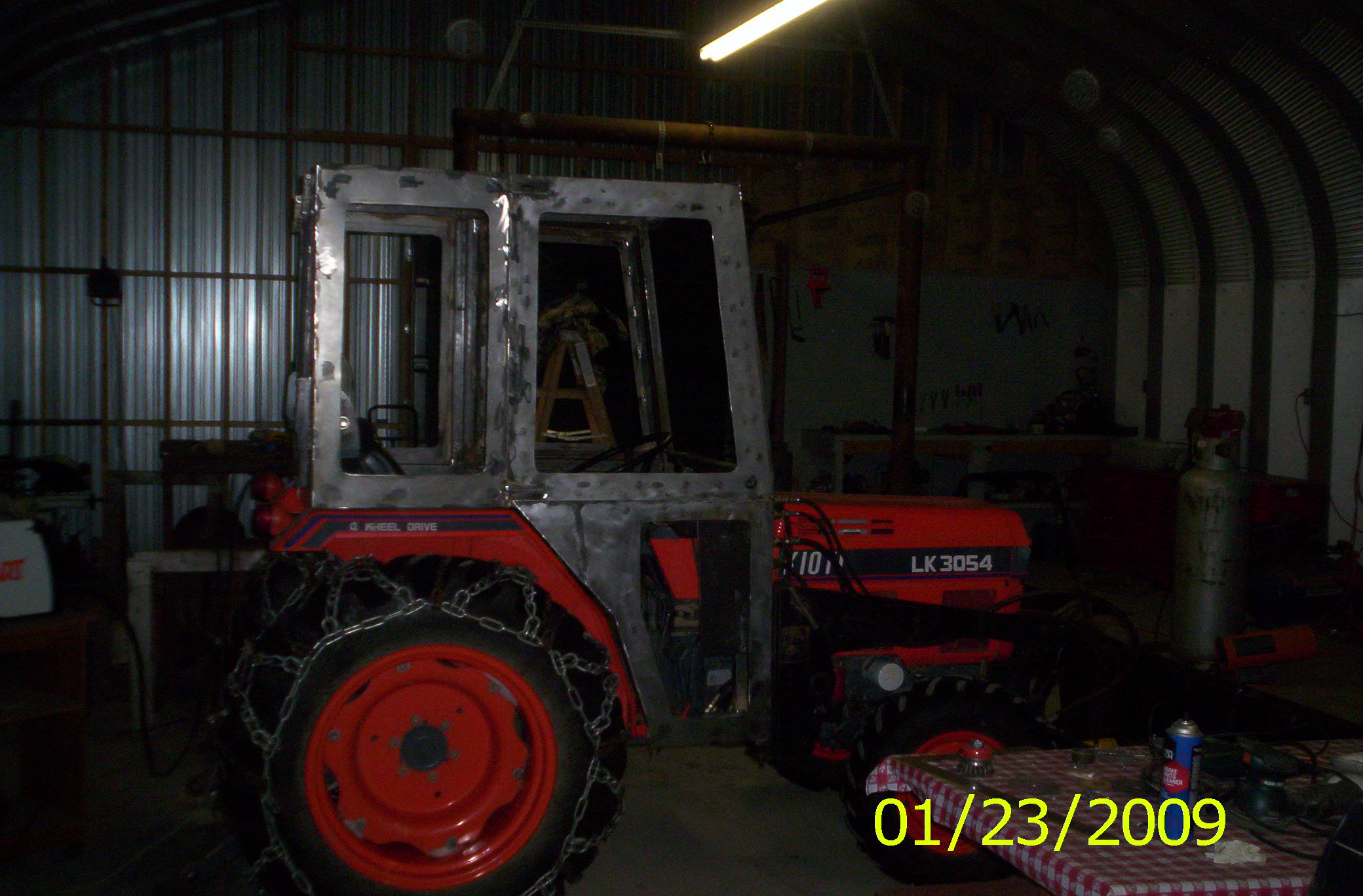

finished the bottom window on the door today. decided it needed to go back on the tractor to fit and finish sheet metal and decide if i want the wiper at top or bottom of window it will go to the bottom. it wont obstruct my view there it will on top when using loader up high. i think when i skin the front i will weld what i can. then i will drill and tap holes 1/4" in the cab frame to bolt seperate panels on that can be very fine tuned to the contours of the tractor housing,will do this with the floor panels to this will also give easy access to the tractor if problems pop up. now i need to find 2 wiper motors front & back. i would like to use kioti wiper motors but cant find any info on them.

/ cab project #51
Nice job! It really looks good on the tractor, i did a search on the wiper motors that you want and had no luck.
The only place i know is jc whitney.
how much do you think your cab weighs right now without the glass?

i looked at jc whitney the ones i saw were replacement for old vacume wipers. are these the ones you are talking about. they look like they would work great with one 3/8 hole for mounting. but how do u know about the sweep angle it says 90 degrees on the motor but how do u translate that to wiping the window as far as will it work & which length arm to get.does the motor not matter & it is based on the arm & wiper blade length. i will check surplus center. i am guessing the cab weighs 200-300lbs. well i am off to get welding supplies ran 12lbs off wire through my welder already.

Very impressive job Dirtnut. Maybe someday I will get the time to build one of these myself. A couple of questions: Did you you do any mock up with wood or use any software to come up with the final frame design. Also, how is the cab mounted to the machine. Did you have to make special mounting pads which to bolt to the tractor or add any cross members to accomplish this. Maybe you could show pictures of how this is done? Great job, look forward to the completed unit.

drivadesl-thanks.i work consruction operating heavy equipment so we are on our seasonal shutdown till the weather breaks so i have the time now to work on it.i did not do any mock up.i thought about doing one with wood but decided it would be a waist of time because what ever i did with the wood, i would be repeating with the steel so i went right into it.the design was from my mind seeing other cabs i did what would work for my tractor. most cabs have a basic design so its a matter of fitting the tractor and adding or deleting what you want. if you look in i think my first post i have pics of the mounting brackets if they are not clear enough i can take better close ups. the front vertical rail has a stud welded in the bottom which passes through a plate welded to the bottom of the loader subframe then is secured with a lock nut.above that about a foot i cut a hole in the verticle rail on the inside & welded a nut flush in the rail, this is bolted to a piece of angle welded to the loader subframe.on the back i cut a piece of plate steel to match the rops frame welded it to the cab frame then it is bolted to the rops.
WilliamBos- that depends on your design, i am not an expert. if it is framed for just holding glass it should be ok. if you are eliminating the rops it should be heavier.i will not have the upper part of my rops so i went with heavier higher strenght steel and doubled the supports in the back at the rops. i also have 6 places where it is bolted to the tractor.
