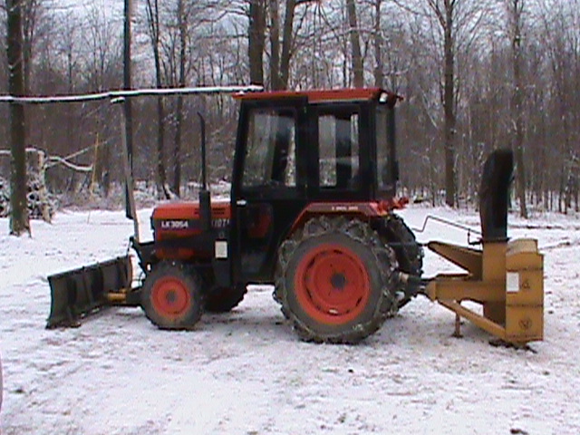

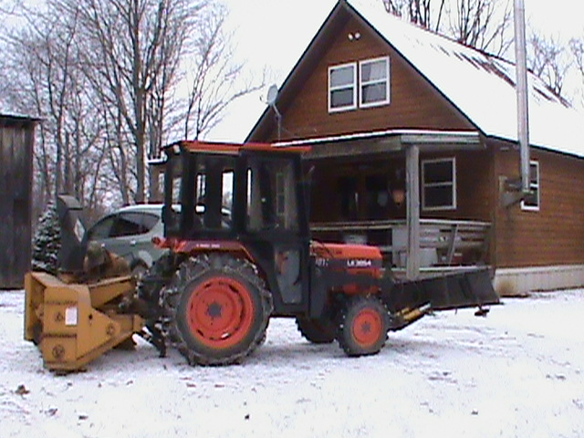

#109
Ready for more snow. I did my first plowing last night at 7:00 pm it was 18 degrees outside & it was 70 degrees inside the cab. The 12,500 BTU heater makes plenty of heat for my cab.The extra lighting up high really makes a big differance to. With cold & snow here now the work & money to build the cab will be paying me back in comfort. I did add up my cost for the cab build with receipts and a rough guess of what it will cost to finish -wiper motors,window/door shocks,this does not include my time or consumables.Total cost will be about $1,500.00

/ cab project #110
Excellent Job!! money well spent. What will you do during summer? Take off doors??

#111
Thank you. The side windows open and swing all the way back against the cab for full ventilation and the rear window opens.They can also be taken off 2-bolts each.
